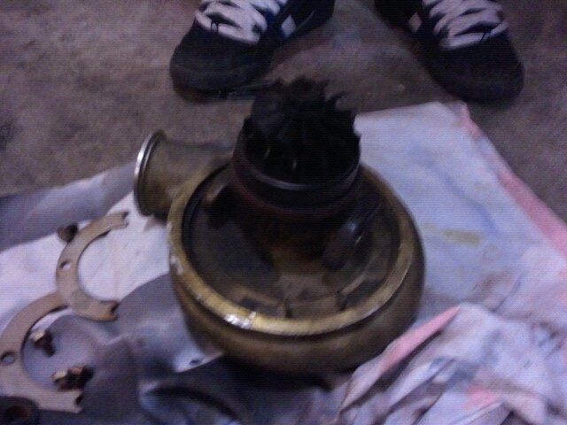

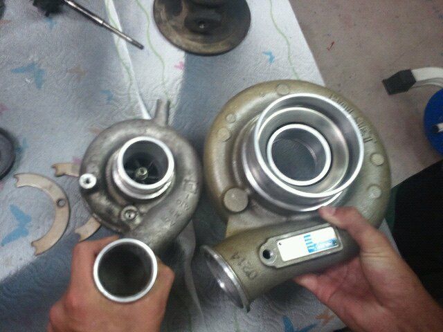

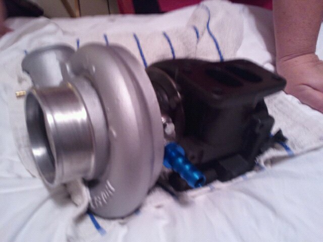

awesome whens the new turbo going on? the poor gsx in the corner should get attention
