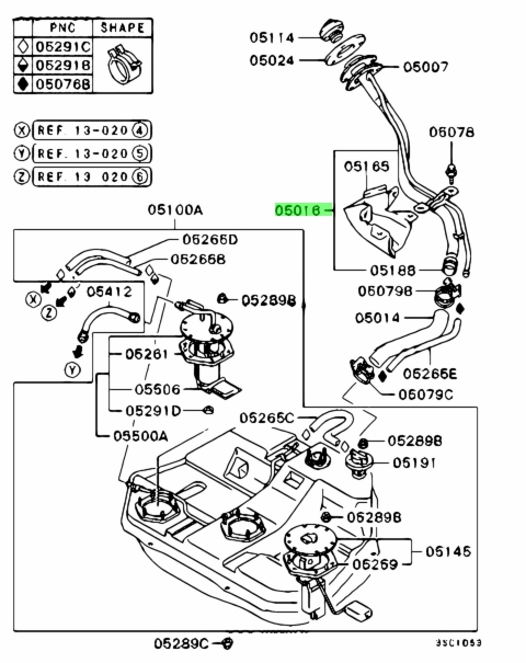

If you need the main filler hose Mitsubishi part number (or some vapor hose that you can't make yourself), tell me your VIN, and which hose, and I can look it up on the Mitsubishi ASA database. But most places don't carry those Mitsubishi parts anymore so it won't help you. Still at least you'll have the part number for searching. The one for my 99 GST is MR432575.

I actually checked my Japanese ASA database (since my car is a JDM Spyder), and it turns out the Spyder layout uses a different part number: MB923792. Unfortunately, that part is completely discontinued and there are no direct aftermarket replacements available for this specific Spyder line.
Since the FN906 won't fit, I'm planning to drop the filler neck and take it to a welding shop to cut out the rusted section and weld in a fresh pipe, then finish it off with Zinc spray and Rust-Oleum as you suggested.

Anayama claims they have MB923792.

Anayama lists your part on their web site - but I've found that doesn't always mean they actually have it. So ask if they actually have one in stock that they will send to you in Korea.
Amayama is pretty nice to deal with.
I see they do show the main rubber hose MR432575 as "out of stock" with a "subscribe to part availability" link there. They don't call it "unavailable" or "out of production" like they sometimes do.
