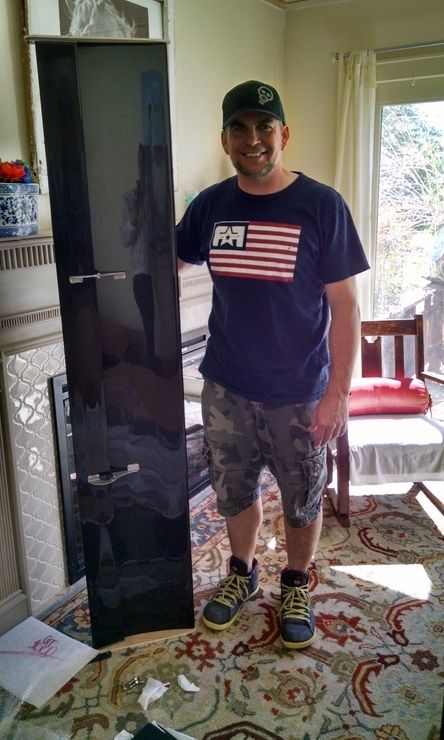

GT-1000 wing as been ordered from moddiction.com

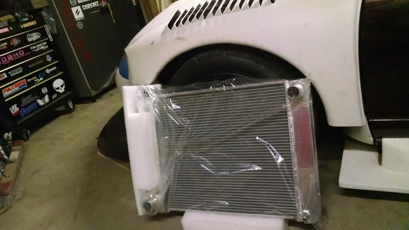

New radiator came in.

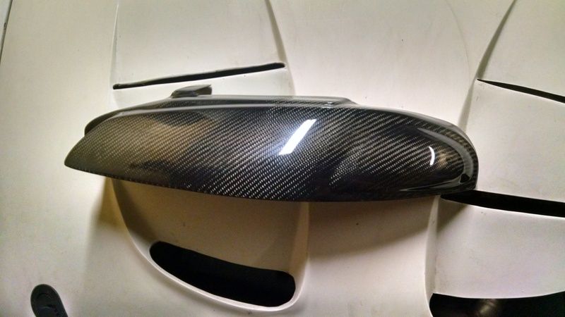

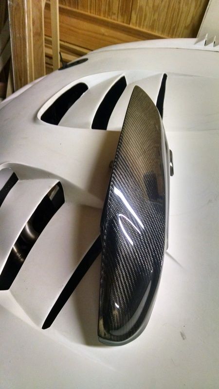

Carbonetics Carbon fiber headlight delete came in too. Finish is FLAWLESS. I'll be checking the fitment next but have no doubt it will be great Sergio was great to work with too. He is going to be building my rear diffuser. Super excited about that.

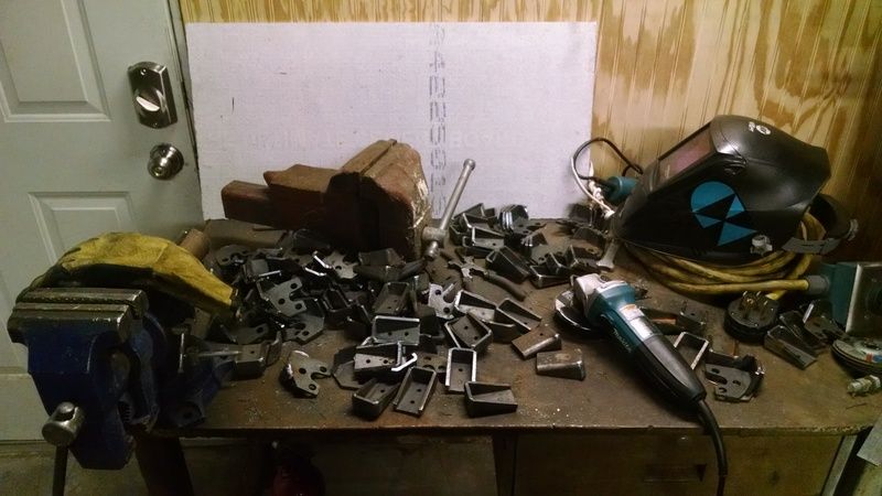

Last but not least, I'm work on a large batch of fender braces for everyone.
******** Carbon fiber headlight delete came in too. Finish is FLAWLESS. I'll be checking the fitment next but have no doubt it will be great Sergio was great to work with too. He is going to be building my rear diffuser. Super excited about that.
So how did you actually get Sergio to make your parts? I'm still waiting for the sunroof plug I paid for in 2013.
I contacted him, paid, he made and shipped them. he also replied to all my message when I asked him questions. Sorry to hear you are having a problem. 2013. That is just nuts.

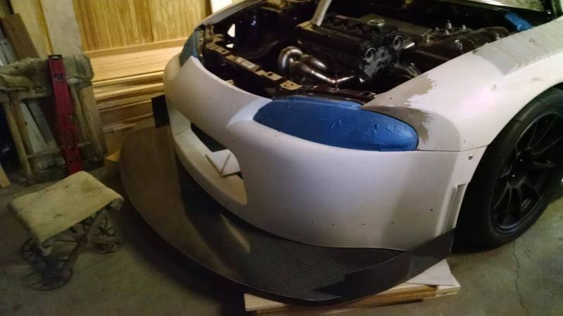

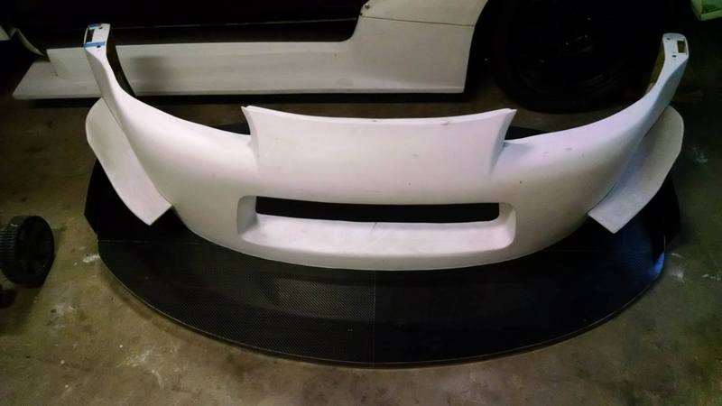

A few new part finally made it here today. It was worth the wait. To bad it will have to sit until I get all the fender braces built for everyone.

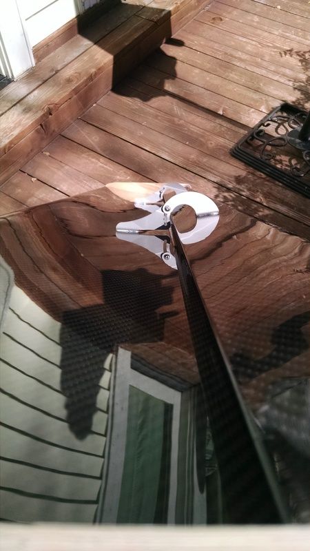

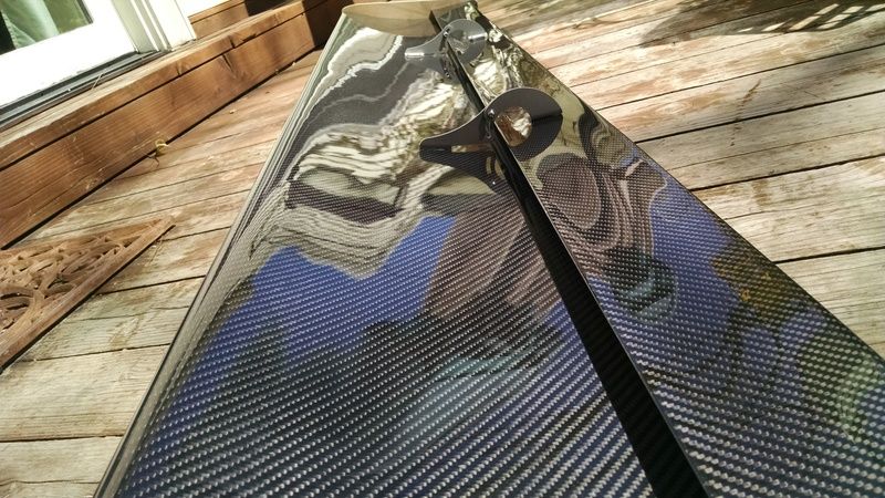

THE GT-1000 from APR. It is a flat out gorgeous bit of functional art.
