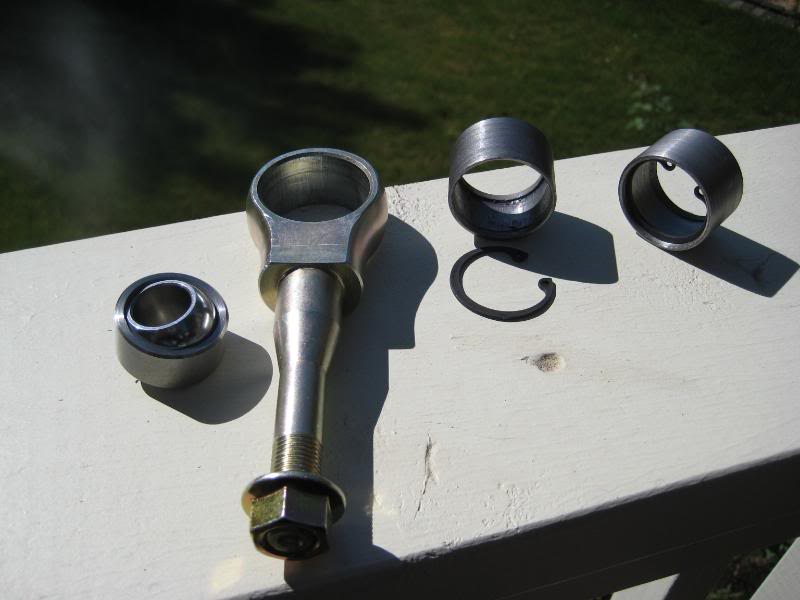

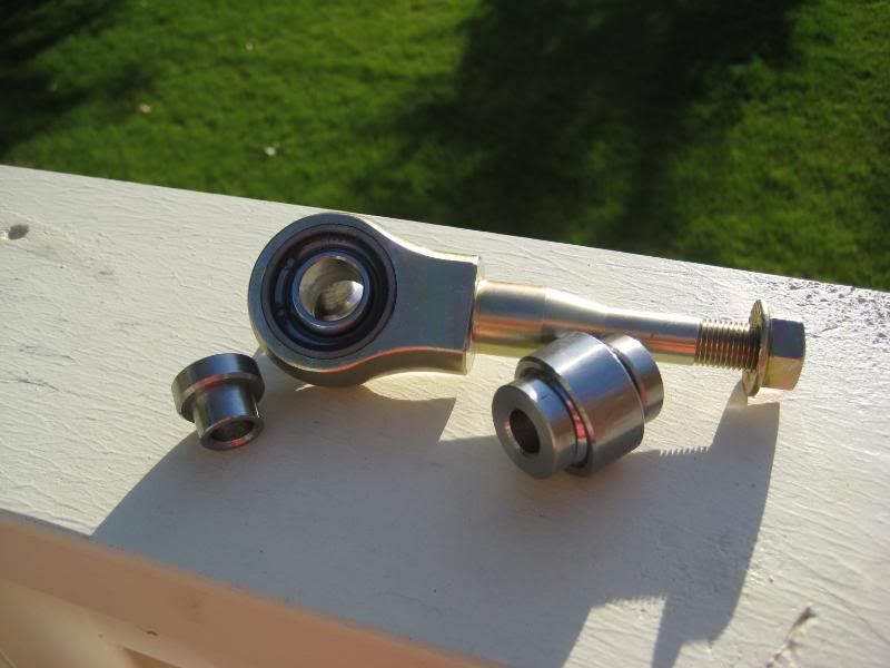

The SPC front upper control arms have crappy vulcanized rubber bushings in them that are not going to cut it. So I went ahead and load the inboard pickups with spherical bearings. To do this I had sleeves built for the bearings and cut grooves for the retaining ring. The circle clips had to have a bit of the edge ground down where the pliers engage them but the dremel made short work of that,
They turned out killer! Here is a peek.
Will these anchors bolts be available for purchase? I don't like the Energy Suspension bushings.
I recall reading that people who went to spherical bearings for their upper arms ended up with cracks in their shock towers. Are you reinforcing the towers? It has been years since I read about it so I don't have a link to share.
