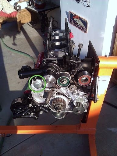

Awesome build, great quality work right there. One I thing that threw up a huge red flag in your first few pictures of the engine going in initially was the way that the front bs plug was installed. I have never seen anyone use a freeze to cover up the hole and lip as apposed to using one that sits inside the hole and lip. This ultimately cause the cracking of the lip, but I will say the washer and bolt trick is a very ingenious fix to that solution.
