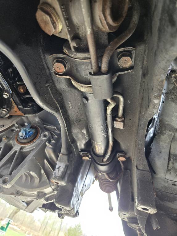

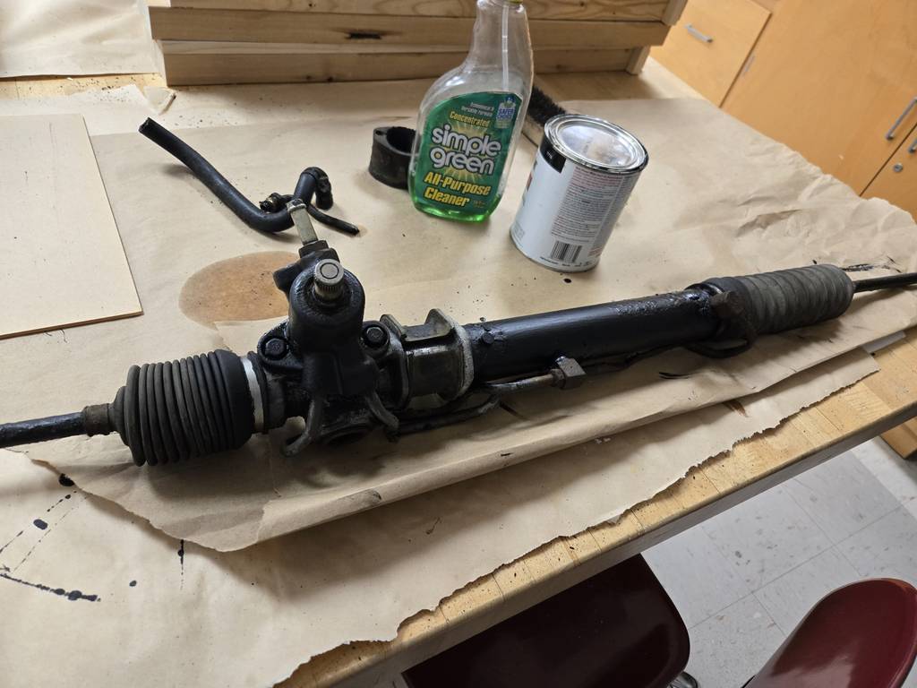

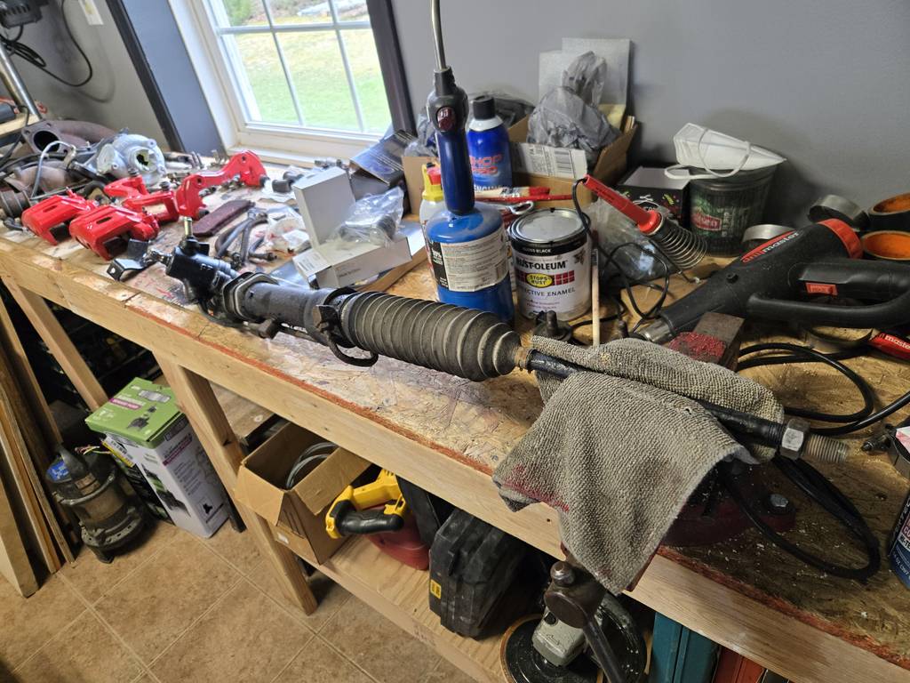

So it's finally warming up around here. I was off today for Good Friday and so was my son, so we put some time in on the car. Picked up where we left off with the steering rack and got the GSX rack installed today. This rack still had the tie rods on it, so we wanted to get them off. They didn't come off too easy, had to get the torch out and really heat them up a bit.

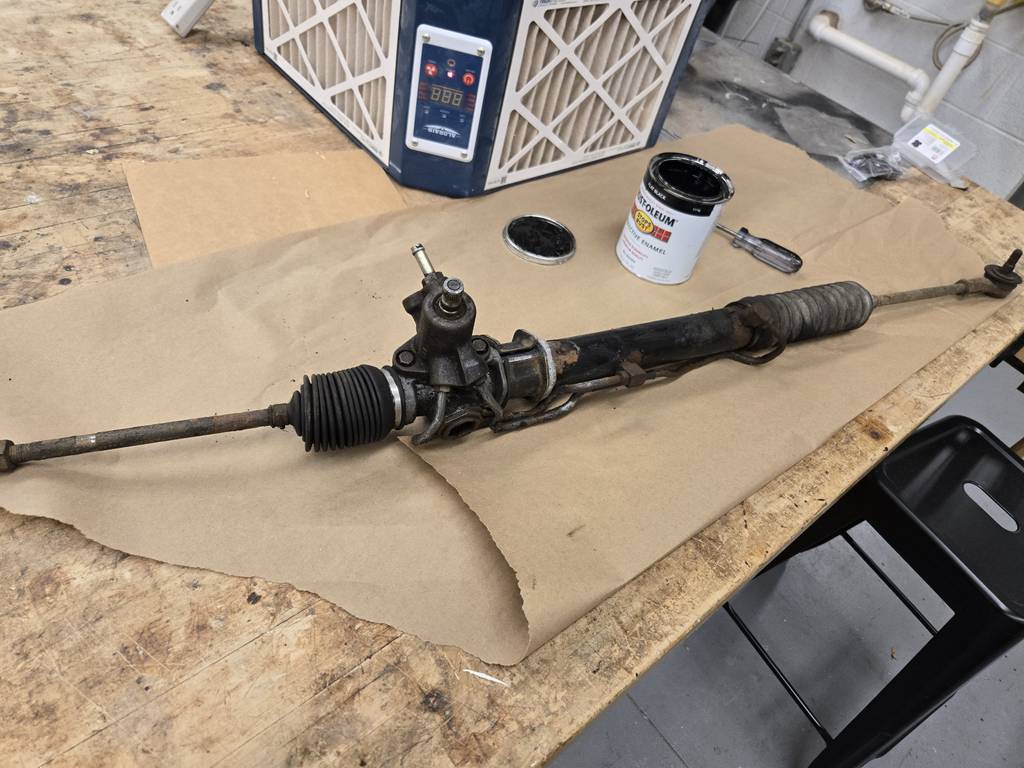

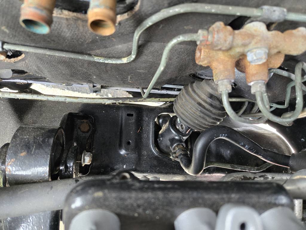

Getting the rack back in was a bit more challenging than getting it out, but with some time and effort we got it in. I still need to put the pinch bolt back in, but everything else is hooked back up.
Here it is from under the car.

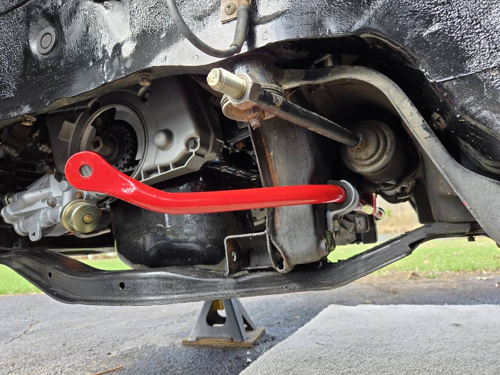

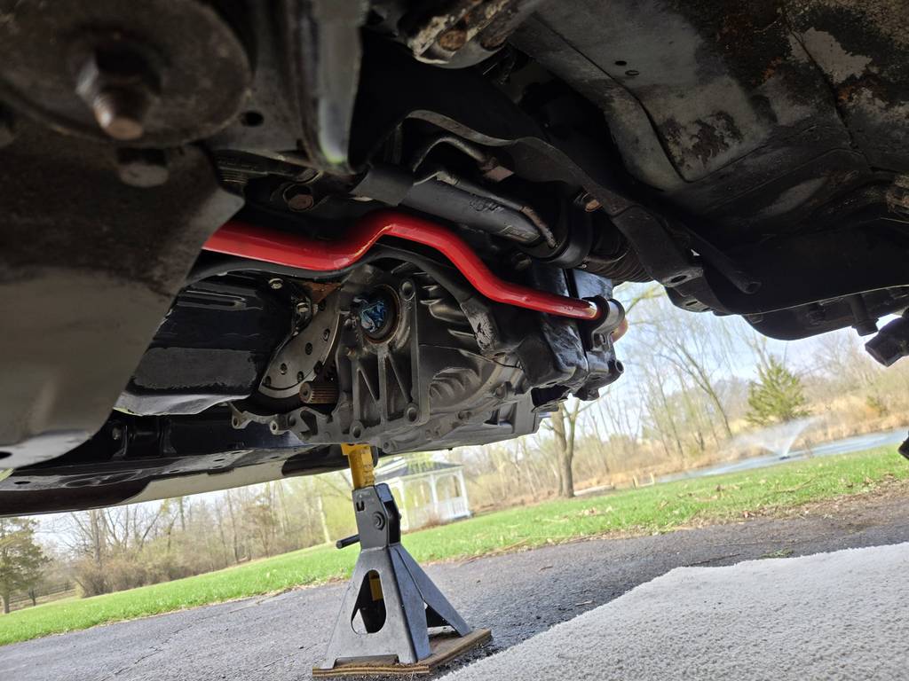

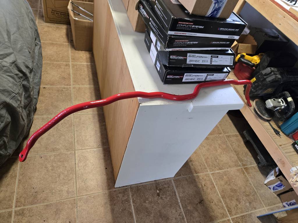

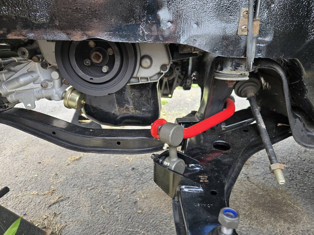

While we were at it, figured it was time to get the sway bar back in that we removed and painted back in the fall.

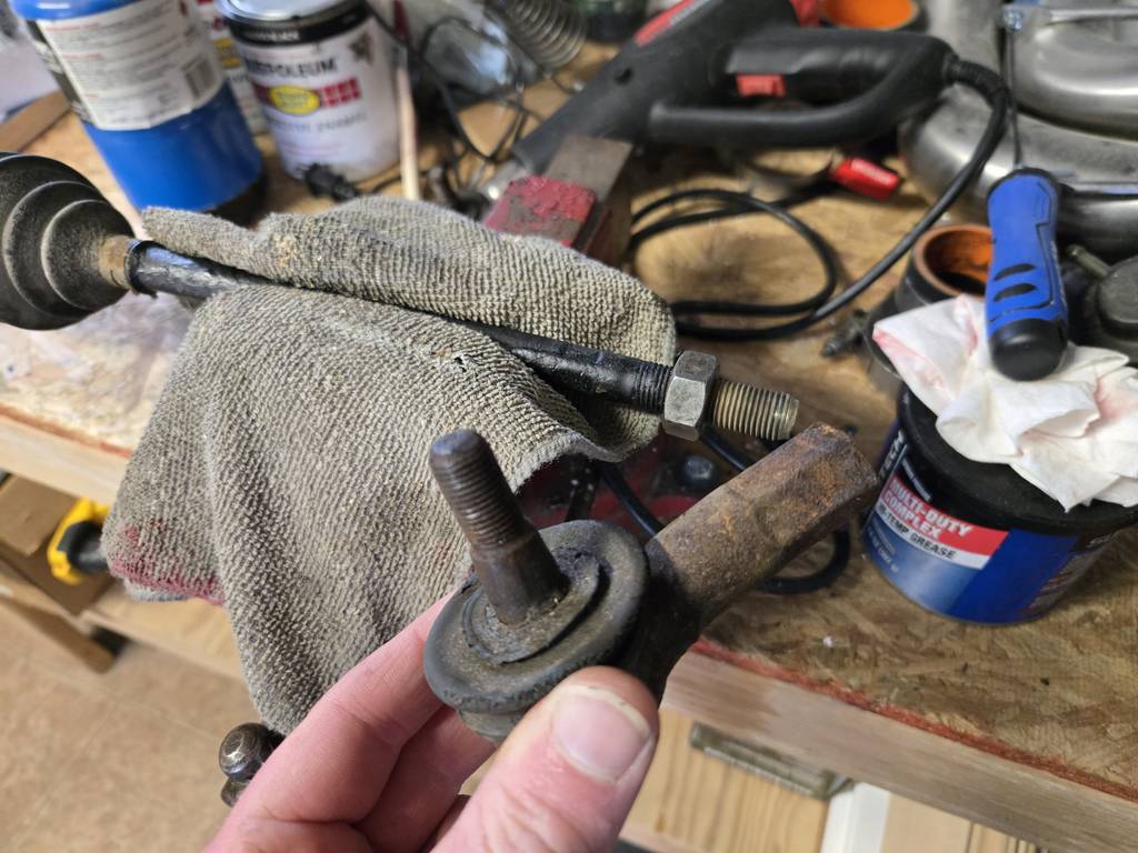

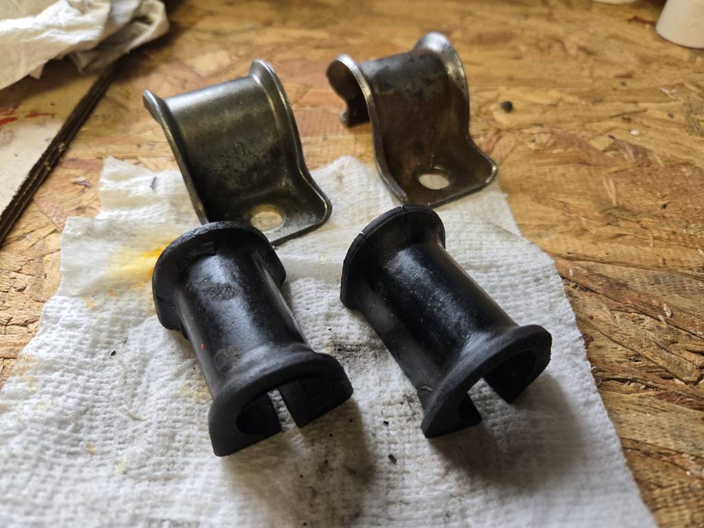

I searched all over the internet during the winter looking for sway bar bushings, but they seem to be NLA. I found a company in Australia on eBay who claimed they made silicone aftermarkets, but when I order them I got a message saying they didn't actually have any. So I ended up cleaning up the ones we got a bit, they're not horrible, but I would have preferred to go new.
Here is back on the car.

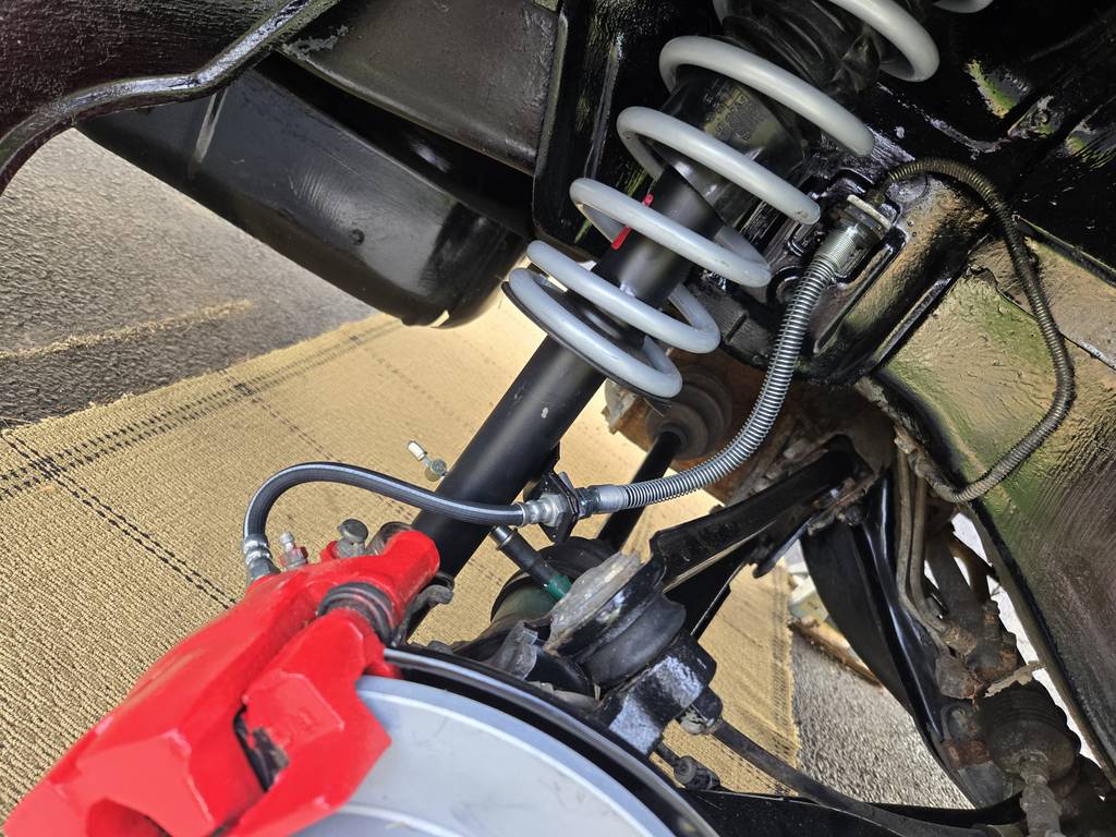

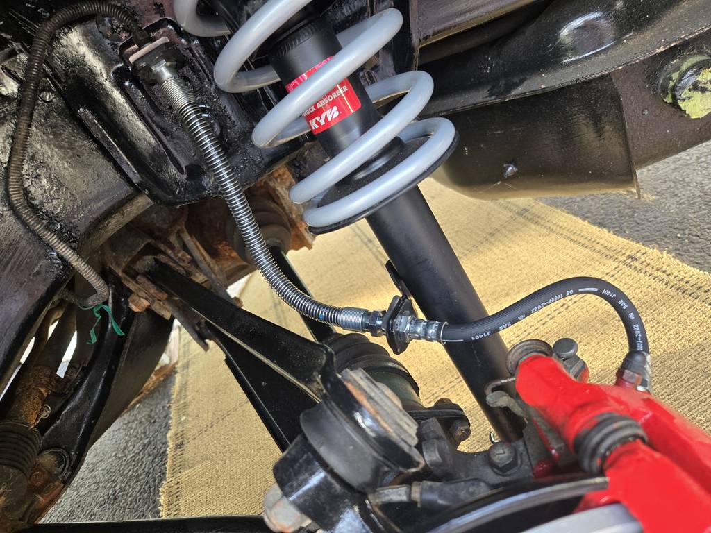

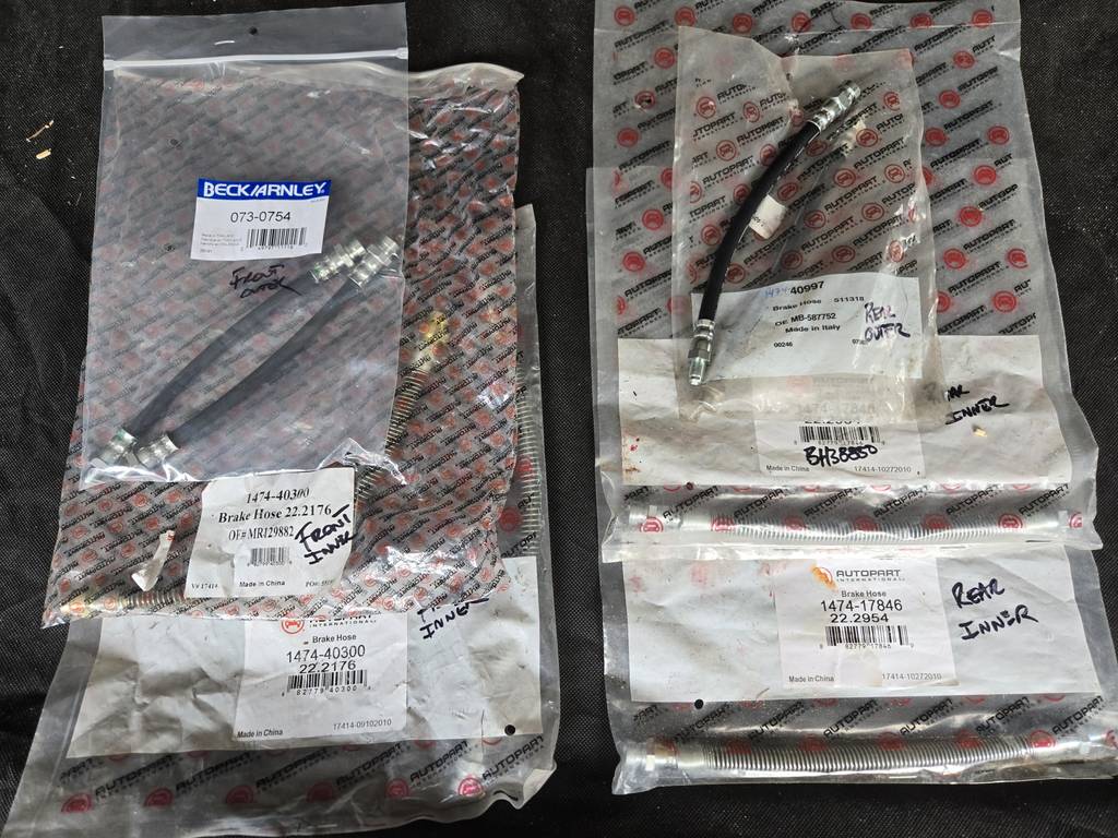

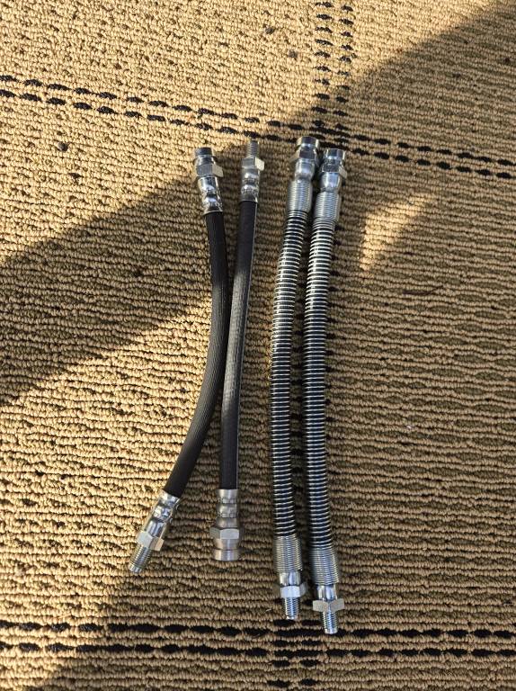

I made a comment in one of my previous posts that I knew we had purchased brake lines for this car years ago, but I couldn't find them. Found them. Finally.
With that, we are able to install and wrap everything up in the back of the car.

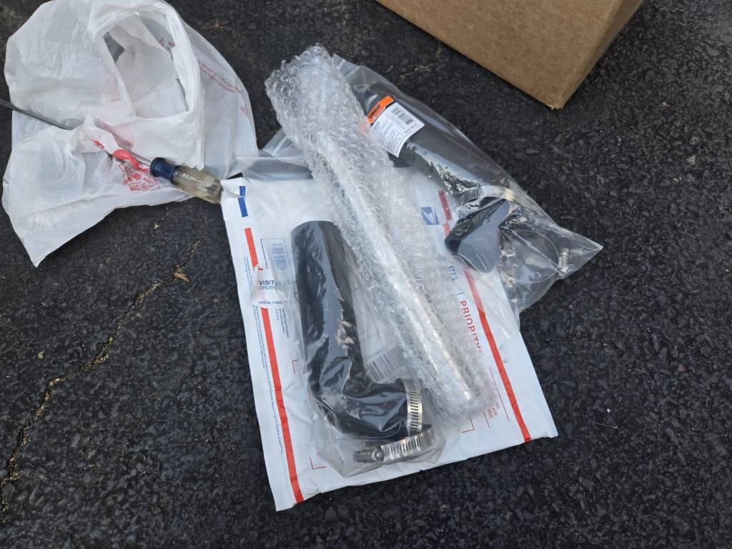

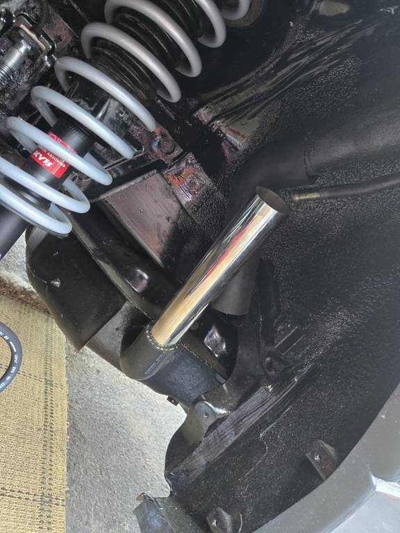

We're getting there. Gonna order some different fuel filler neck materials tonight. We need to fab up a filler neck, the one removed was toast and the OEM's are long NLA.

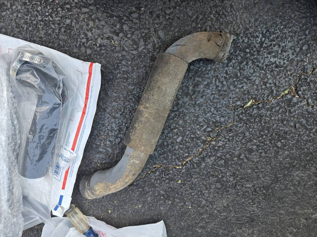

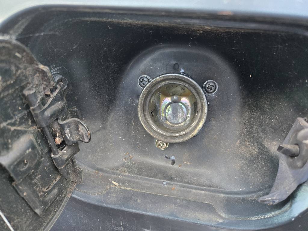

The last thing we needed to do to really finalize the rear of the car was to get the filler neck installed. Like so many VR4's, the original filler neck is totally rotted out, so we need to create a new one. With a dial caliper, the inlet on the gas tank and the solid filler neck reads 1.7in. So, we ordered up some 1.75' couplings and an equivalent size pipe to figure things out.
We started by mounting the solid filler neck in the car.
This is the OEM one that is totally shot. You can see the material cracked, split, and hard.

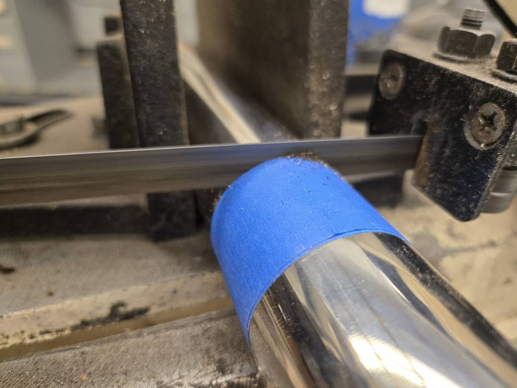

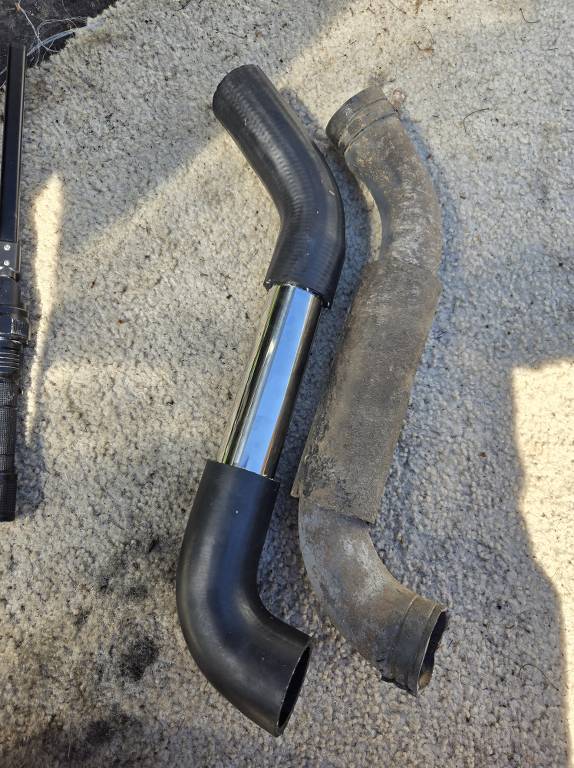

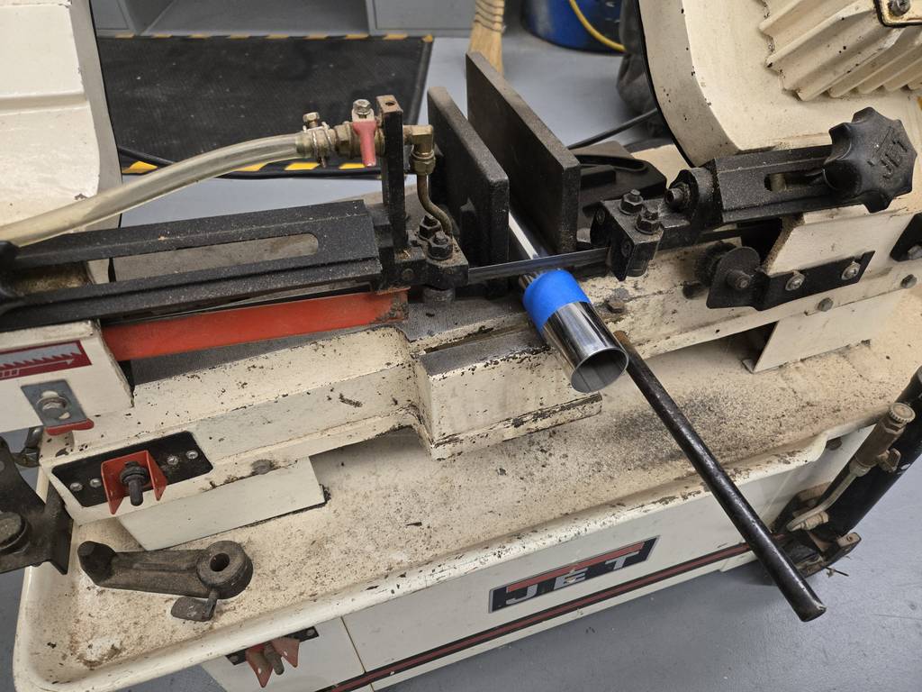

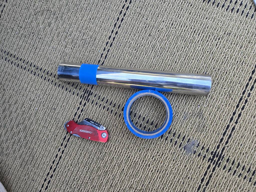

We ordered an 18 inch SS pipe, we had to figure out what to cut it down to in order to make it work.
After some test fitting and measuring, we marked where we wanted to make the cut.
Off to the metal bandsaw.
Then we were able to to cut the couplers and get everything mocked up.
Pretty happy with how this came out. Too bad you won't ever see it. ROFL

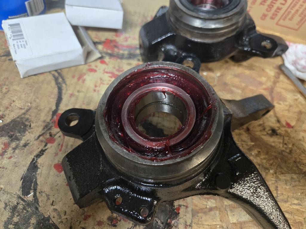

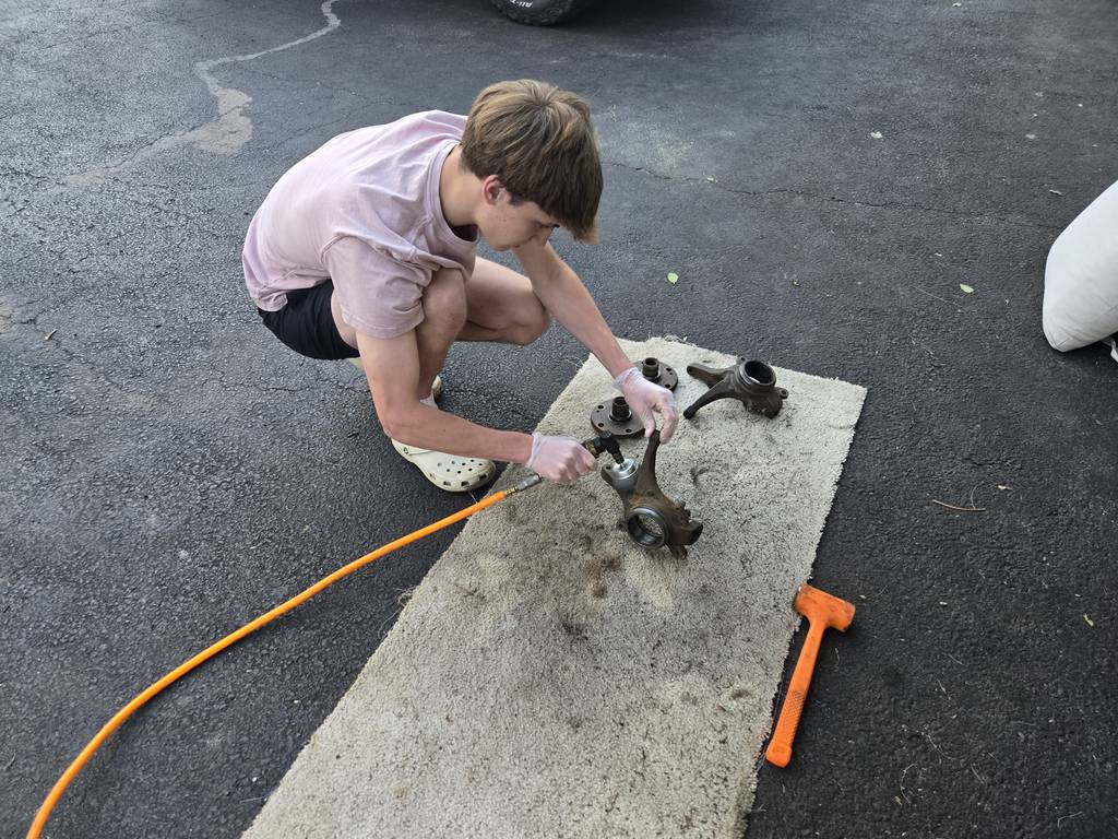

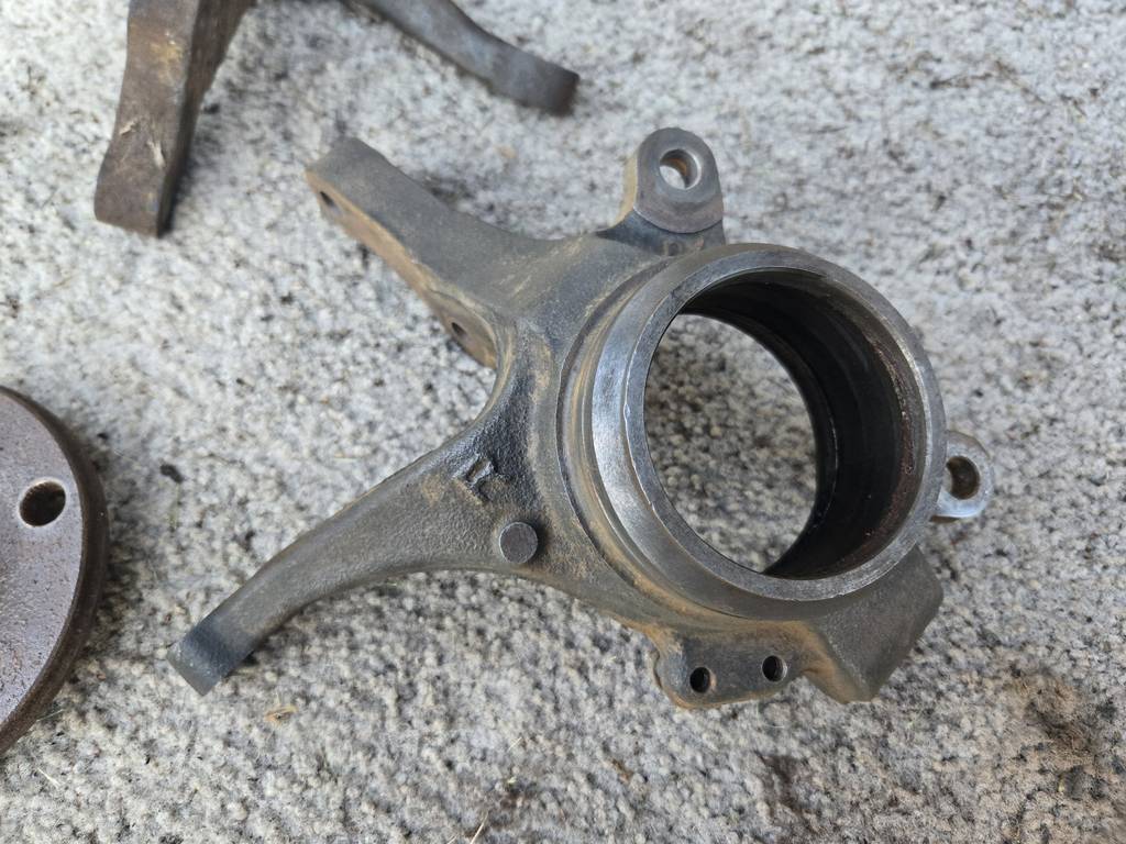

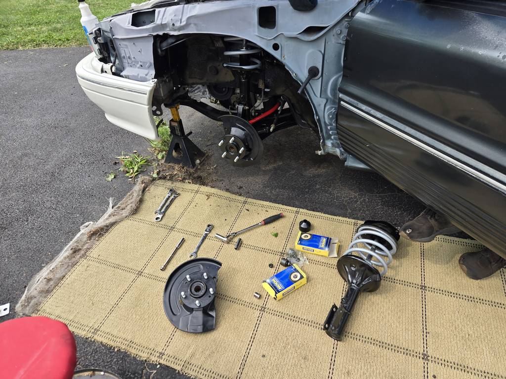

Now that the gas tank filler neck is all wrapped up it's time to start focusing back on the front knuckle/hub assemblies. We started working on these end of last summer and had a really difficult time getting them apart. We couldn't get the proper alignment on the press to get the bearings out. We took them to a local shop, they couldn't get them apart either. I kinda thought we were screwed when local member to us saturn345 stepped in and said he could get them apart. And so he did. He sent me some pics I was going to post of them getting pressed apart, but I'm getting an error when I try to load them.
Anyway, we got them back in the spring and we've working getting them back together with fresh parts behind the scenes.

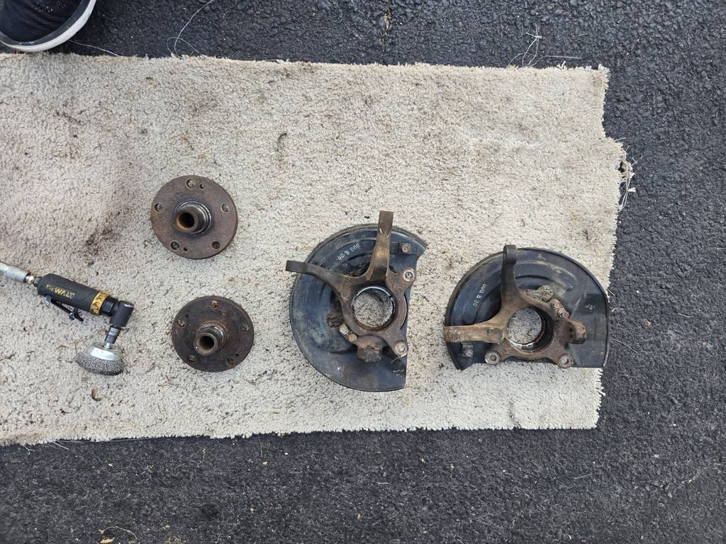

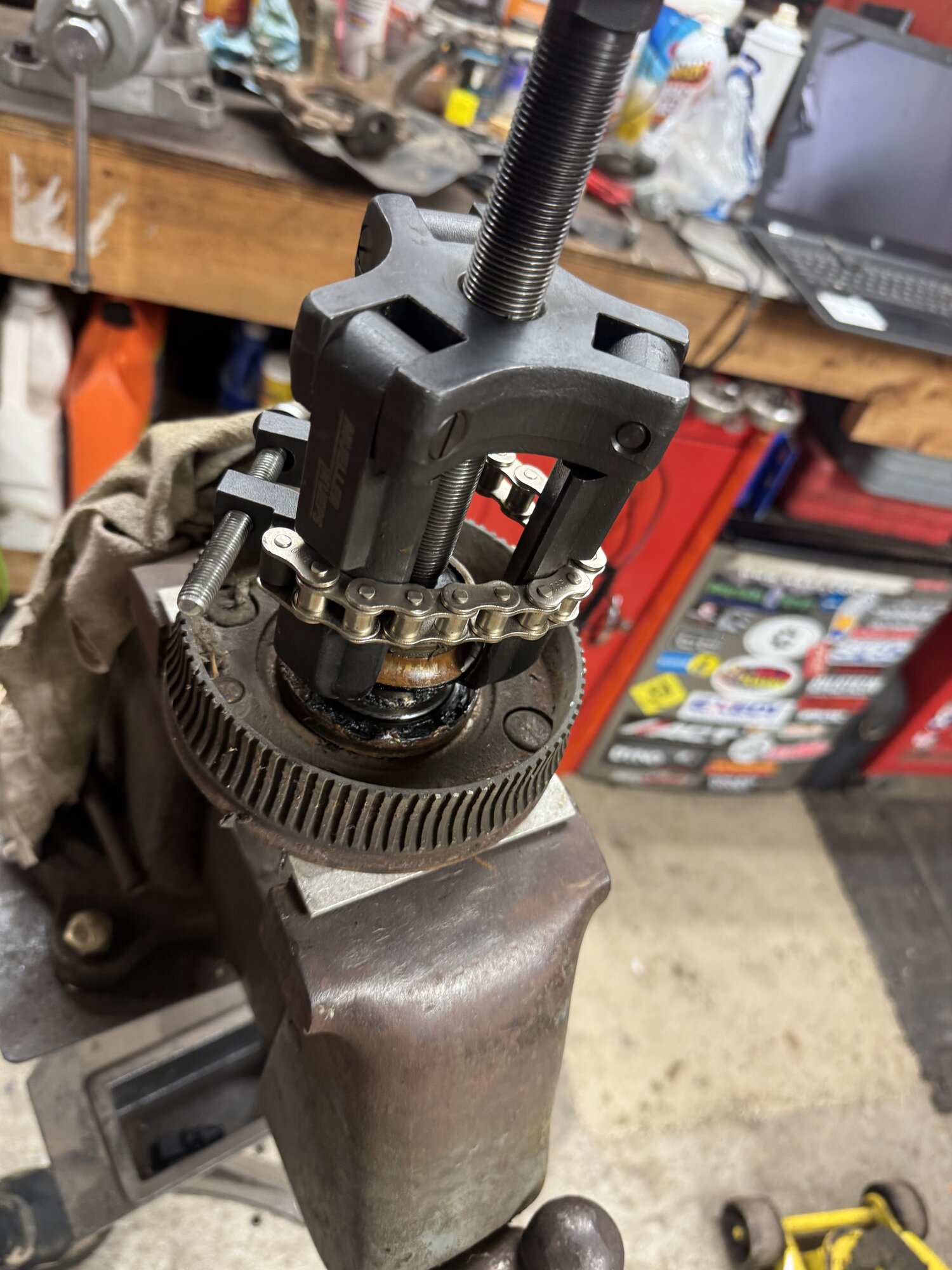

First thing we did was knock even more apart and start to clean everything up.
Came out pretty good.

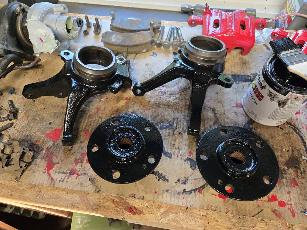

As usual, we got everything painted up then.

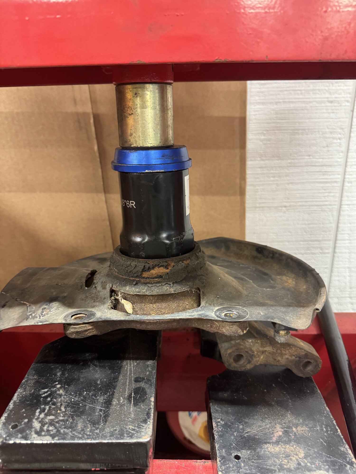

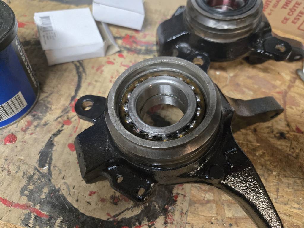

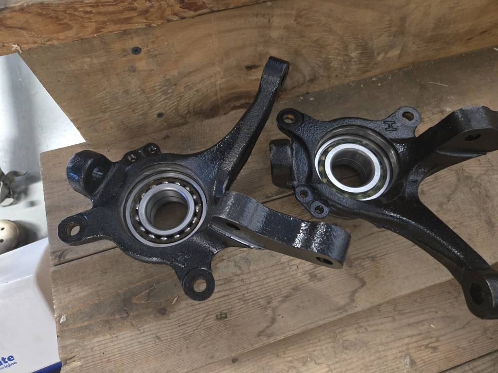

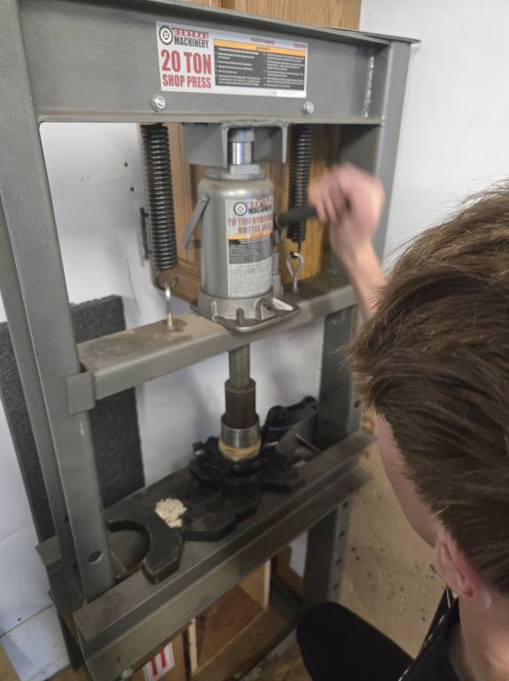

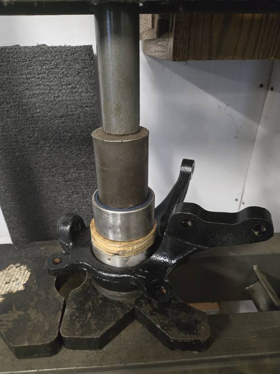

With everything painted up, we can press the front bearing into the knuckle.
We didn't have an old bearing or any metal plates similar enough to the new bearing to help press it in, so I cut a proper diameter disc out of 3/4 plywood. Sometimes you gotta do what you gotta do.
For as long as it took to get the old ones out, it only took minutes to press these new ones in. If you ever go to do this, make sure you press the bearing all the way in. There's a machined lip on the front face of the knuckle the bearing must sit on.

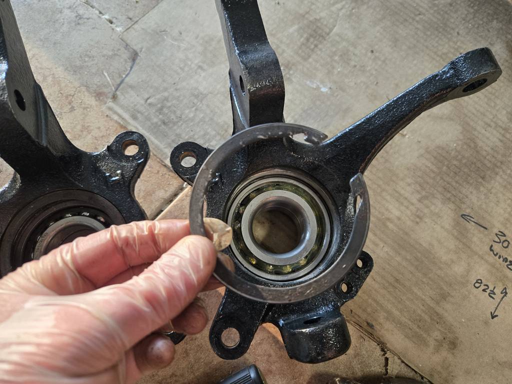

Getting the bearing in all the way is important, b/c if you don't, you won't be able to snap the giant circlip back in place.
This can be a pain in the butt too, take your time, use large pliers to squeeze it, you should be to get it to sit in the groove.
Save the old bearing and grind the outside a little. Then you've got a press tool for next time.
Be careful with those cast press plates. They've been known to chip or explode. quality plates are expensive. All I have are chunks of plate steel
There's those pictures I was trying to load ^^^^ thanks for posting them up Chad. And thanks again for your help, we wouldn't be moving forward if not for your assistance.
And thanks for the tip Pauley. My best friend has a shop about 2 miles from my house, so any time I need to do something I don't have in my garage I run down to his shop, so that's his press. It's obviously a Harbor Freight press, but it's saved me many times. I'll say something to him about those plates.
Theyre pricey but I want to buy these. I haven't because I don't press that often. My 20 ton press has paid for itself more than any tool I own.
You’re welcome man anytime I can be of help. I’ll give a Hand always.
Glad to see they are going back together and all.
Yes I have seen those also @pauleyman. I have set of those at my work for doing stuff. We have some big piece of plate steel
From scrap yard also I use.
But at home I don’t use it enough to need them. But if they break I’ll buy them for replacement

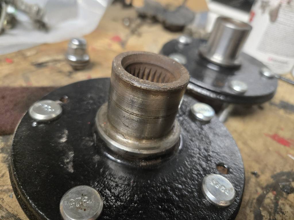

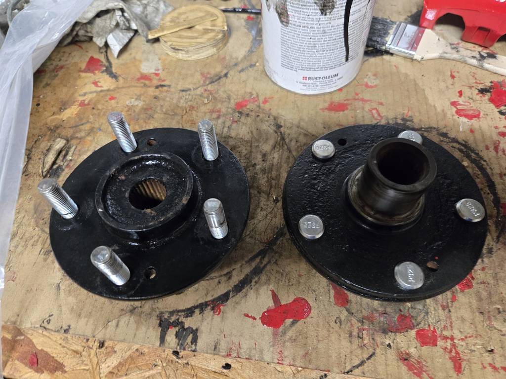

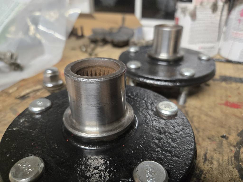

The hubs need to be pressed back into the knuckle next, so we thought it would be easier to do the new lug studs now, before the backing plate and everything else was in the way.
The spindles on these looked a little rough, so I tried to polish them up a bit.
Alright, now that the bearings are pressed in and the hubs have their new studs, we can finish up assembling them.

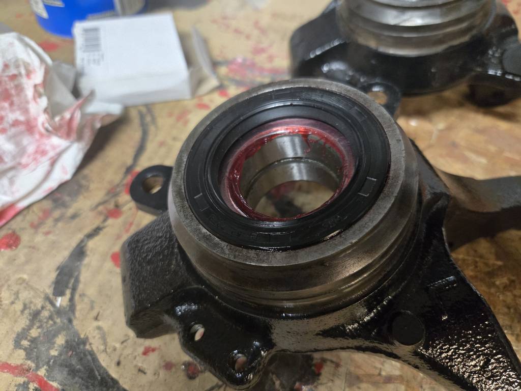

Started by adding a bit more grease.
Tapped the new front seal in place.

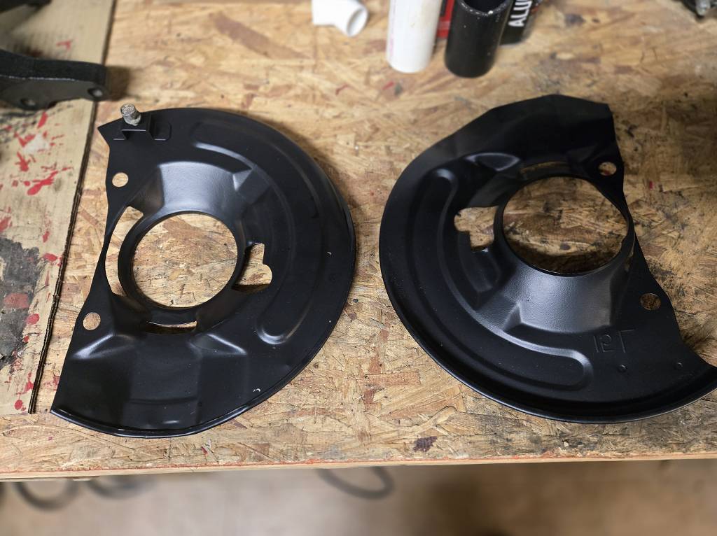

While all of this was going on, I send the backing plates out to be blasted and recoated They came back looking amazing.
Tapped these in place.

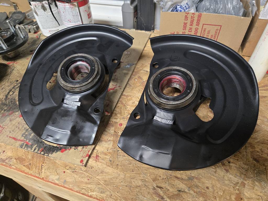

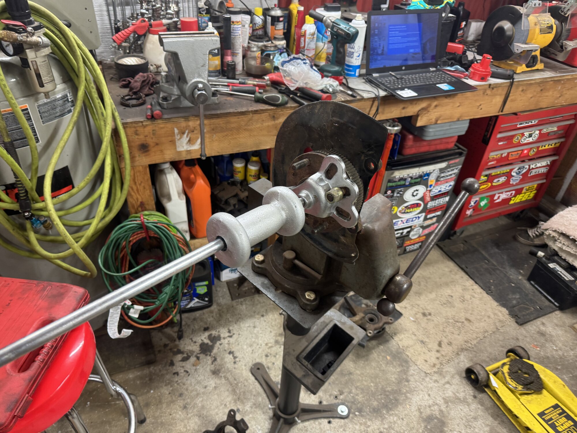

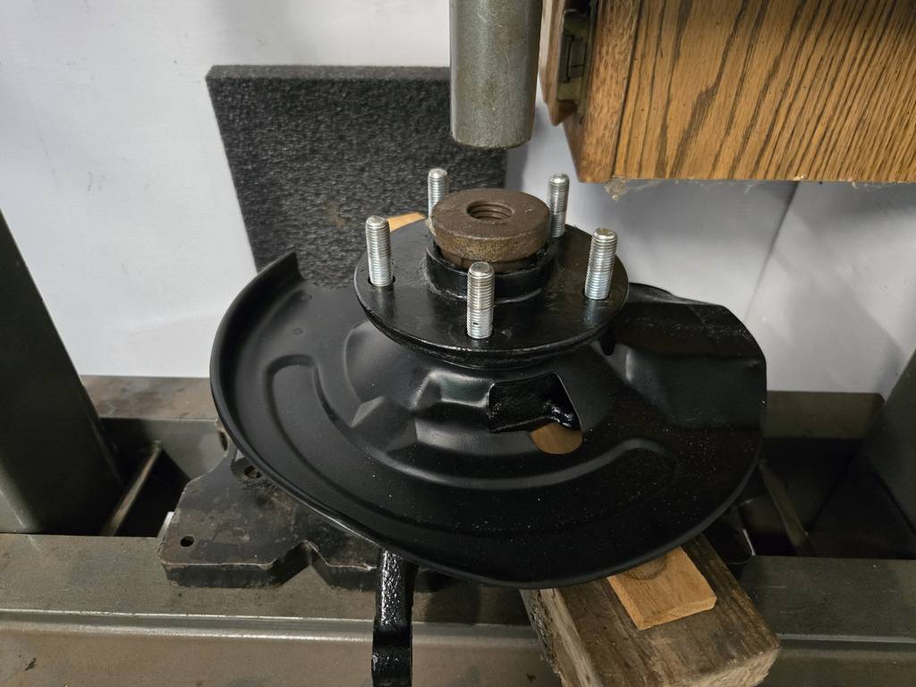

Quick drive over to my buddy's garage for the press again.

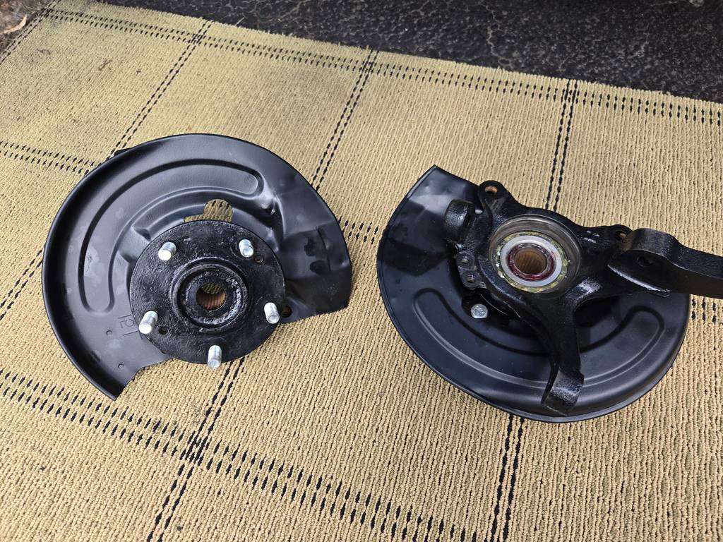

And after all this time ... here they finally are:
Not shown in the picture above, but did happen - the rear seal was tapped in place as well.

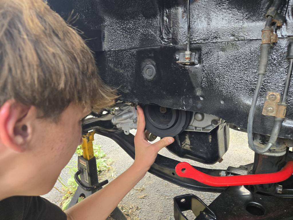

Before we got into mounting the hub assemblies back up, we decided it would be easier to mount the crank pulley now. I have several underdrive pulleys laying around, but in the spirit of keeping this thing close to stock for now, we put an OEM one on.

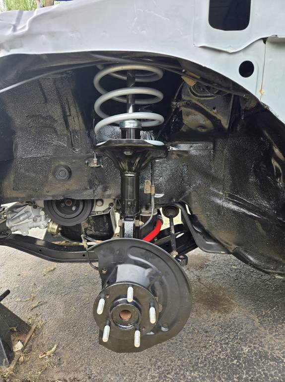

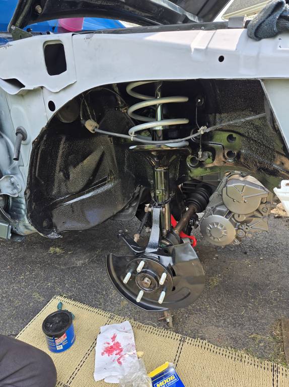

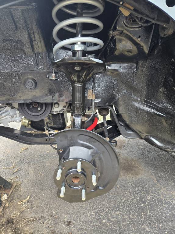

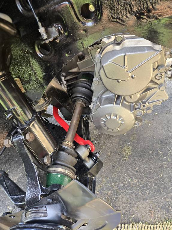

Mounting the knuckle assembly back up is pretty simple. They're literally held on by one 19mm bolt (seen above^^^) and the suspension.
Now over to the passenger side. We took a moment to pop the axle in on this side while we were at it. We couldn't do it on the driver side b/c we don't have the transfer case mounted yet.
Passenger side all done for now.

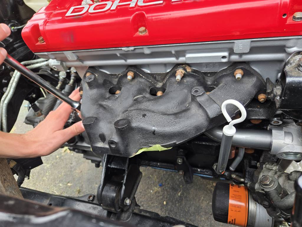

We bolted up the main water pipe that runs under the manifold first.

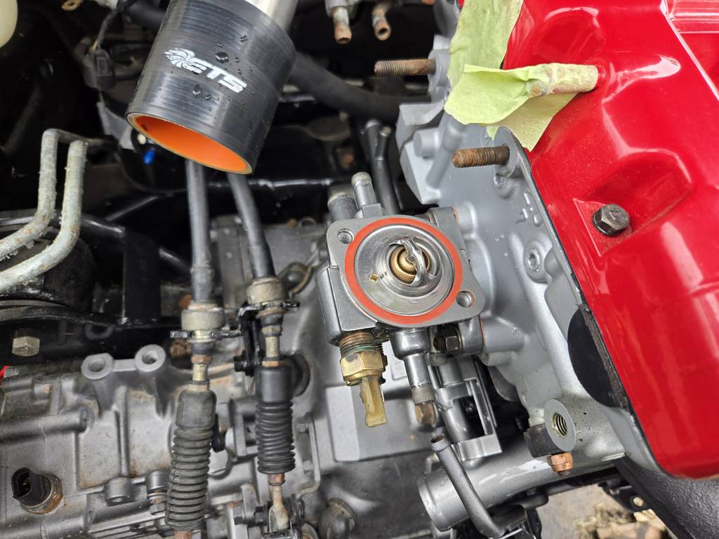

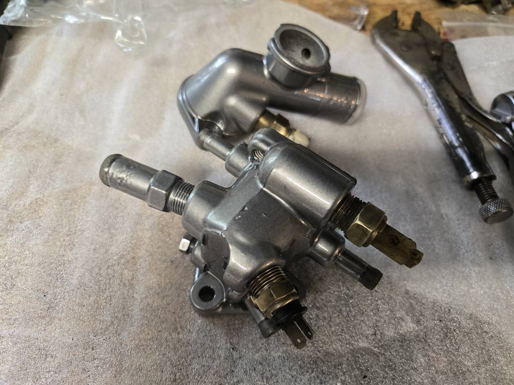

Then we had to dig around to find the thermostat housing.
Quick run to the autoparts store for a new themrostat.

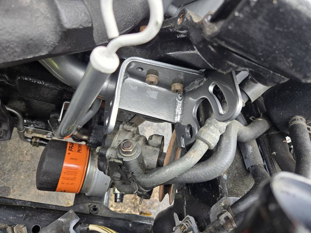

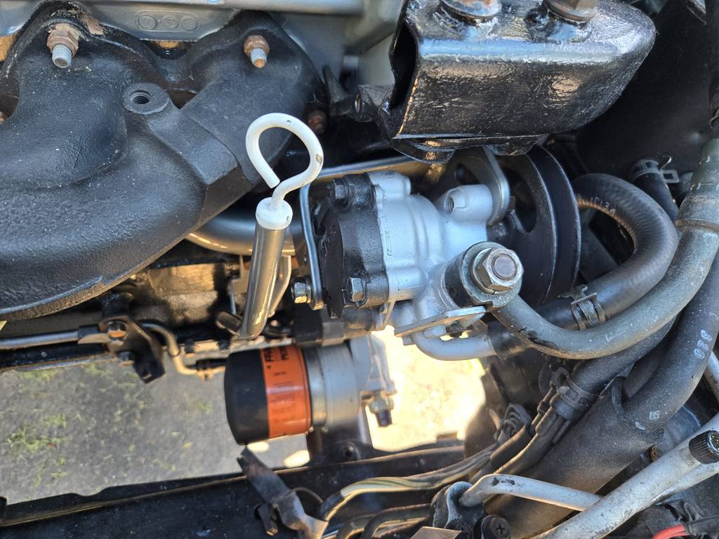

Then back over to the other side to mount up the alternator and power steering pump. Except, we discovered we don't actually have a alternator. So for now, just the power steering pump.

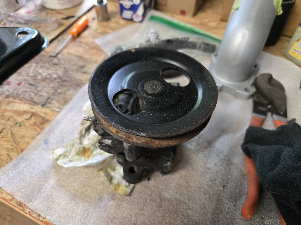

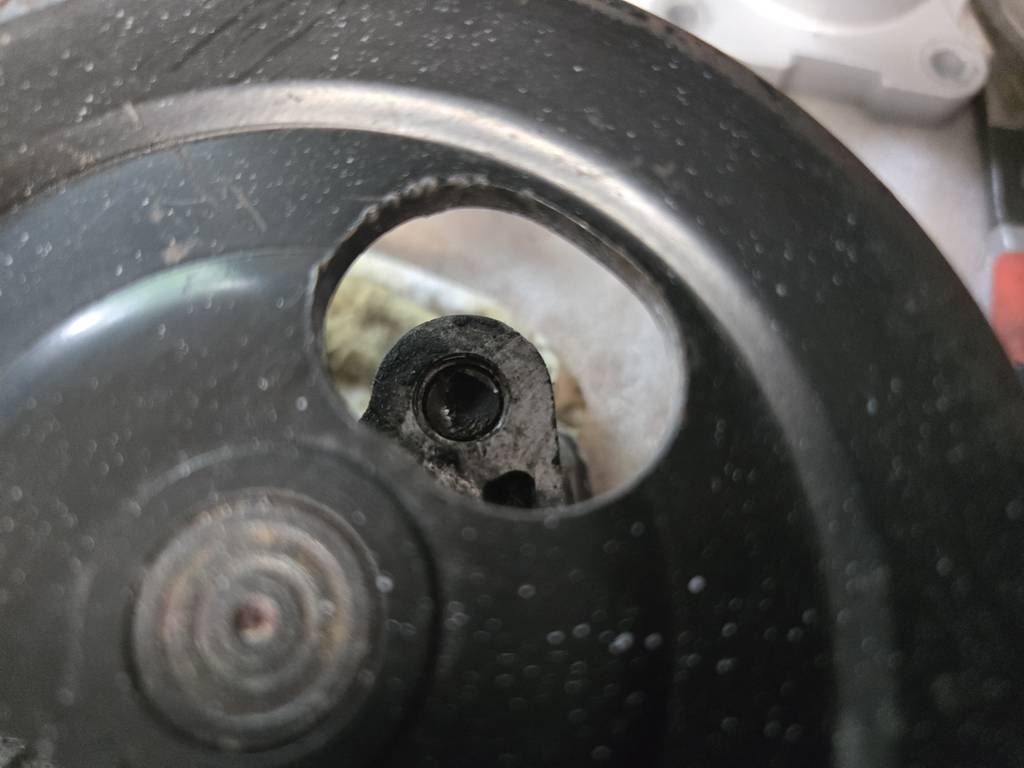

The power steering pump was hanging in the car, but I ended up pulling it out b/c I discovered when I went to mount it up the tension bolt is sheared off inside the pump housing.
So, I'm gonna have to drill this out before we can get this mounted up.
Then it started to rain pretty good, and since car is outside we had to stop there.
A little bit more progress to share ...
Got the busted bolt drilled out of the power steering pump and gave it some fresh coats of paint since it was removed anyway, and got it back in the car. That looks bettter.

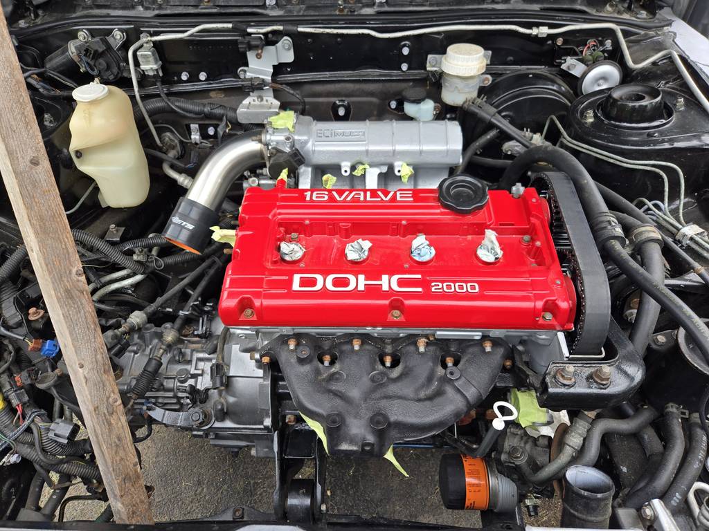

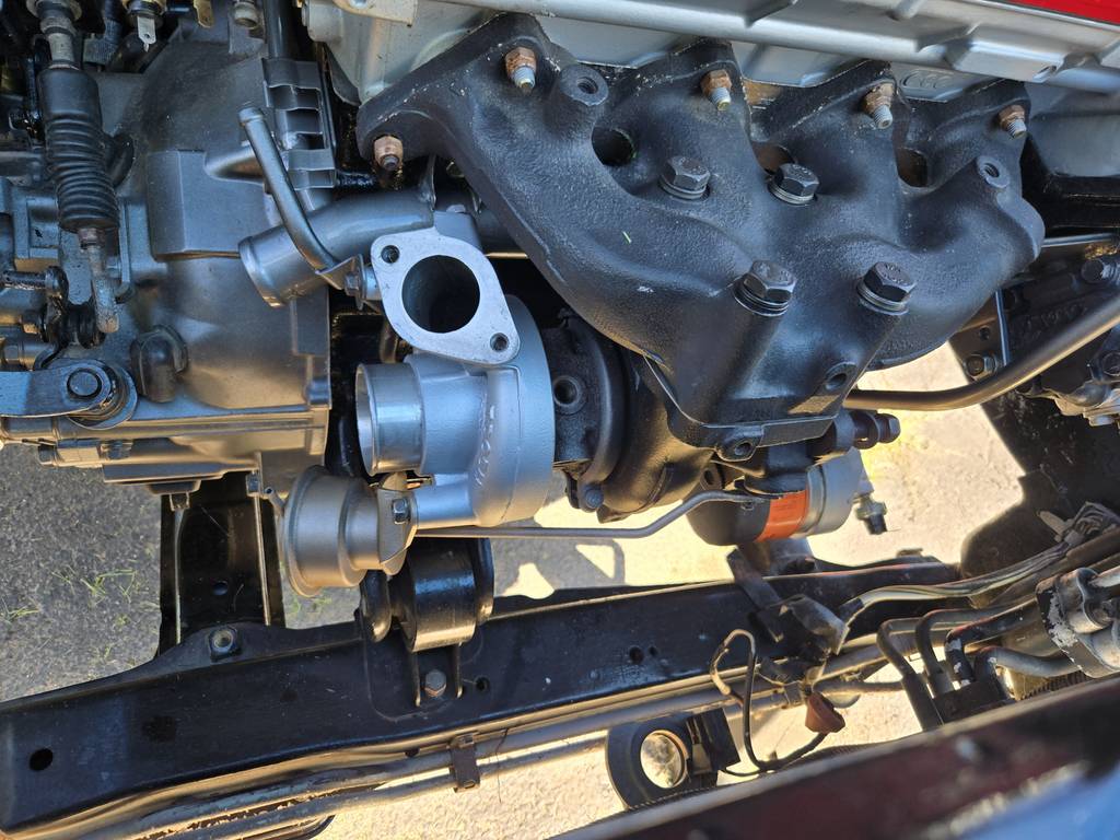

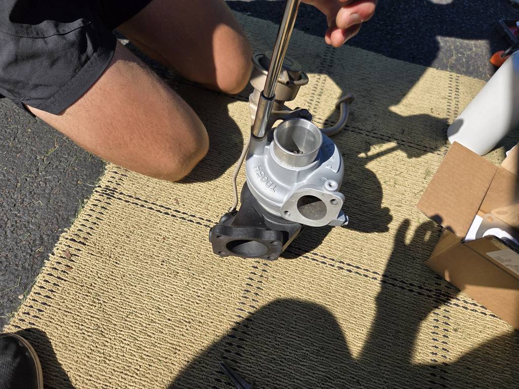

Decided to mount up the turbo today too. Reattaching the wastegate in this photo.
And then bolted onto the car. My son got to learn about taps and dies today, the one thread in the turbo was a bit boogered. so we chased it with an M10x1.25 and got the threads cleaned up.

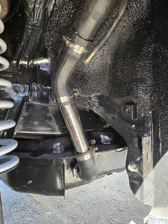

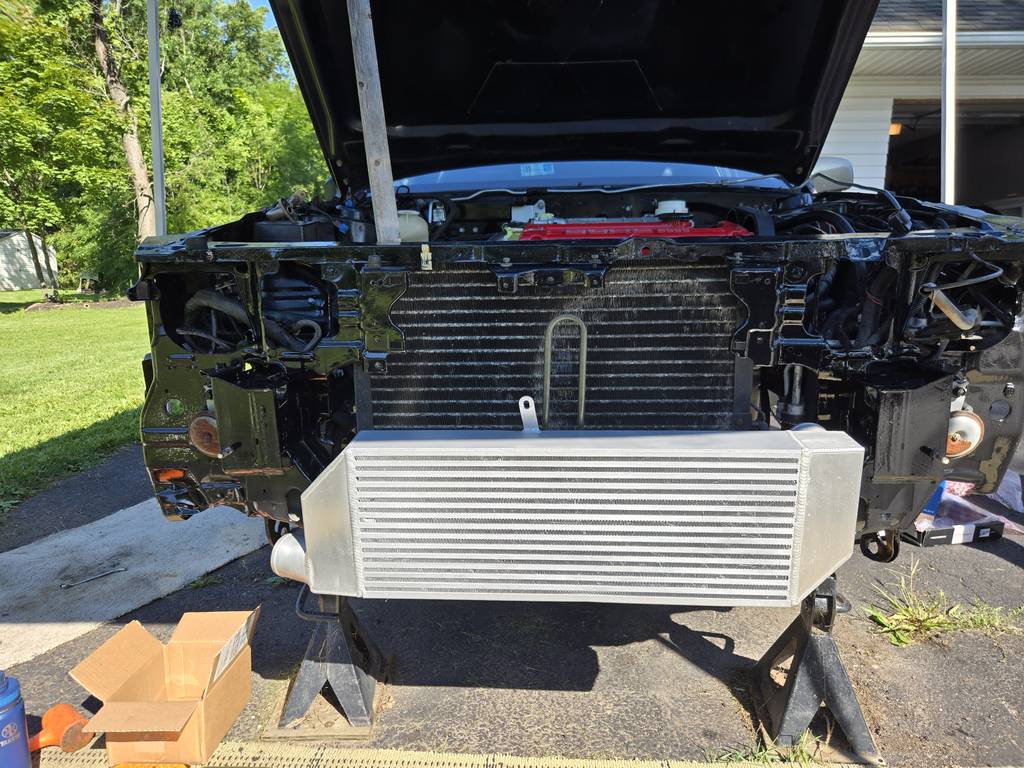

And then we mounted up the ETS IC just we could kinda start to figure out the routing of the IC piping. We're a ways away from running IC piping yet, but it was fun to figure out how the pipes are gonna run.

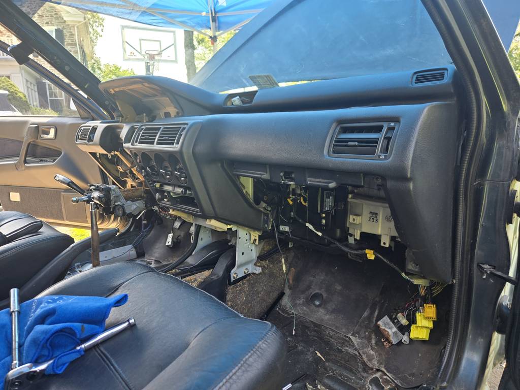

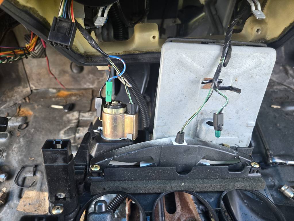

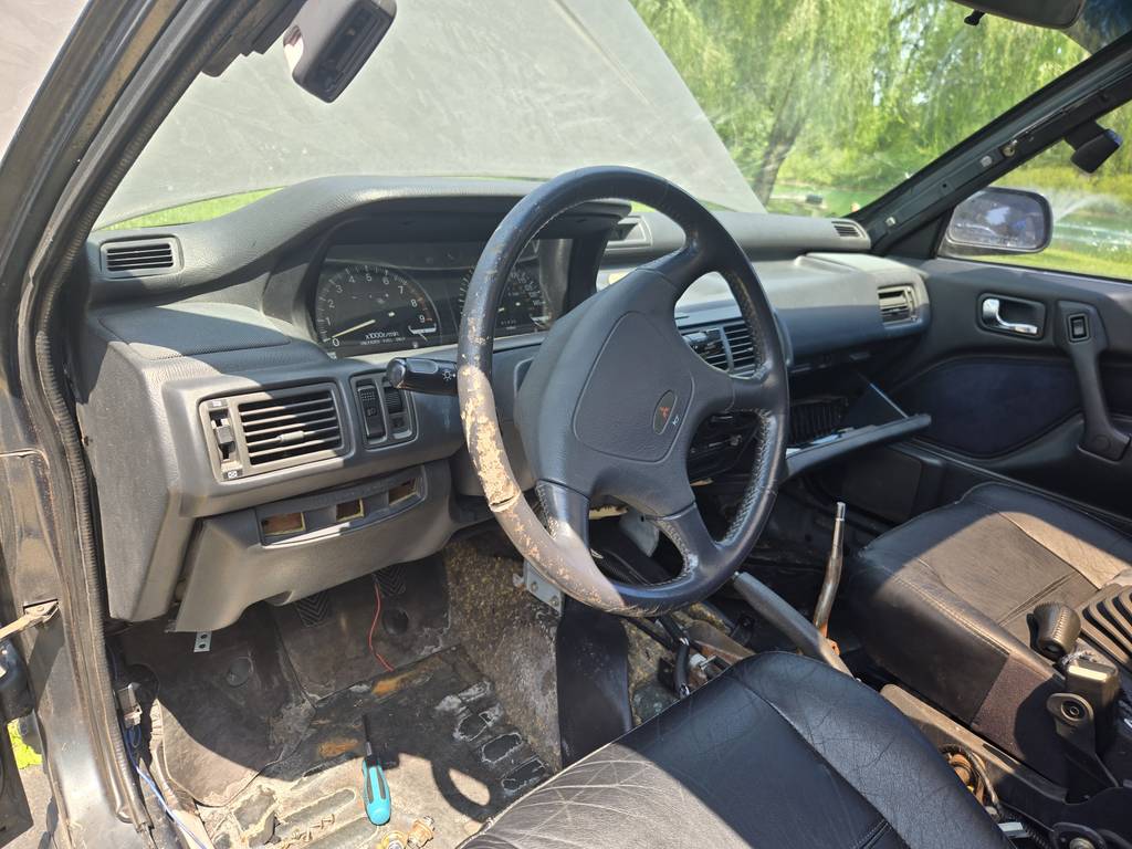

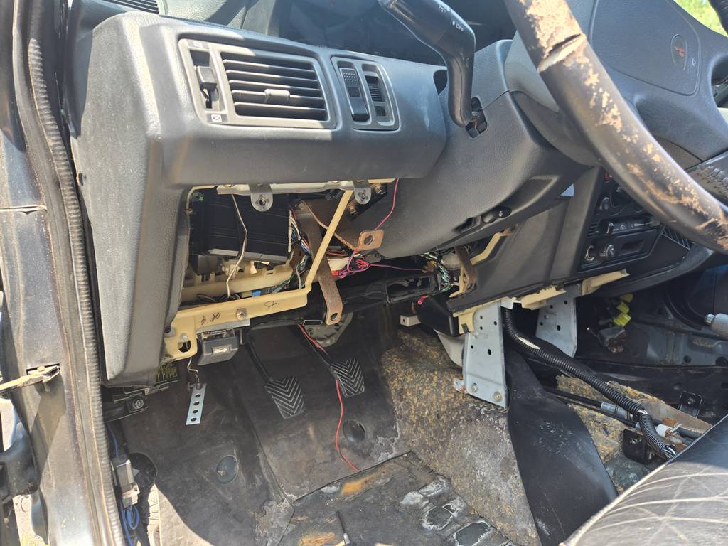

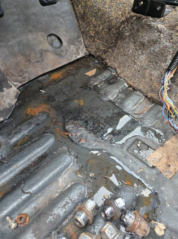

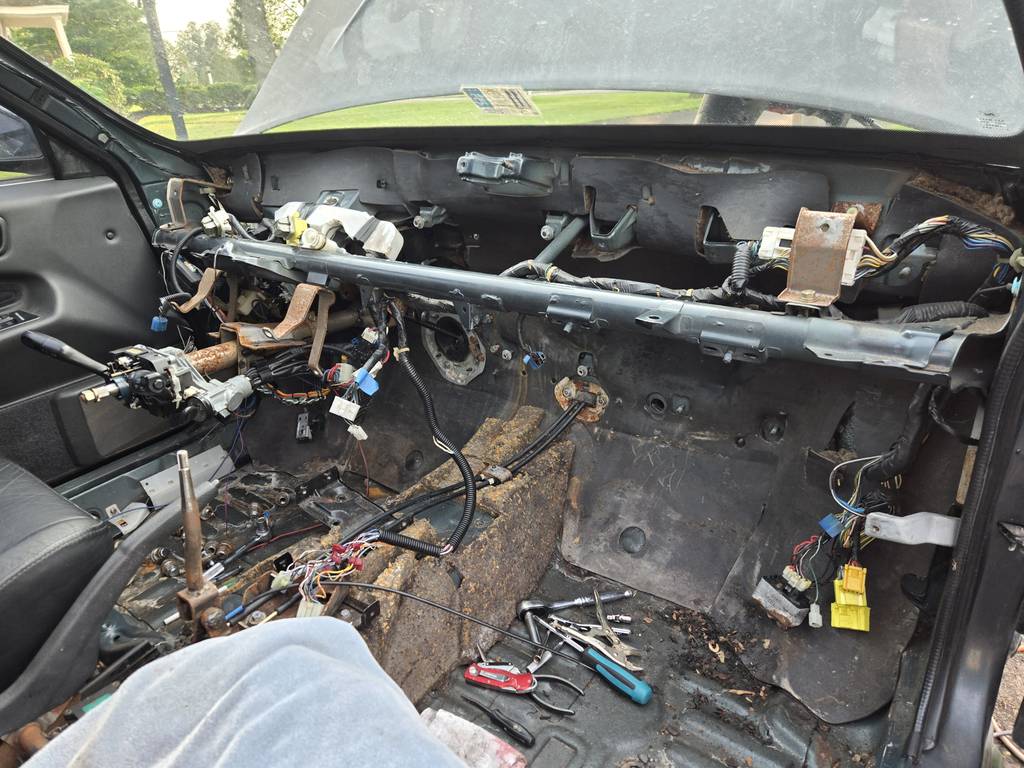

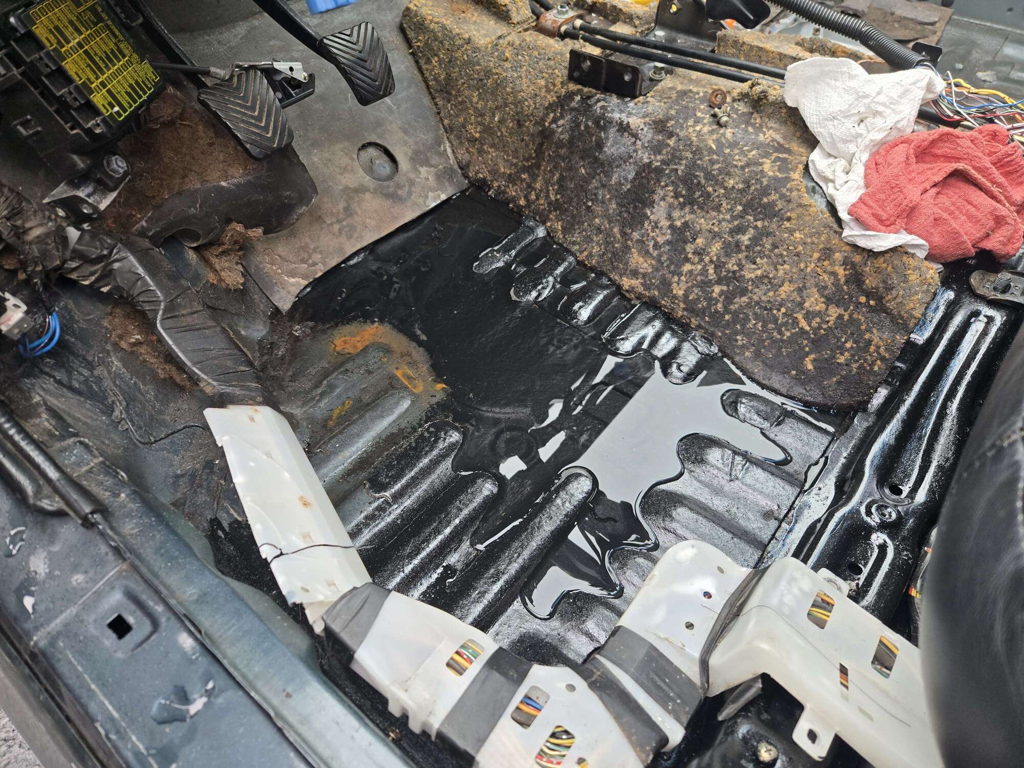

So I haven't posted anything in the last 2 weeks, and that's b/c we've been on a little bit of a side quest over here trying to figure out a leak we got. One of the things we figured out with the car sitting outside is that there is a leak somewhere getting into the front floorboards. We realized pretty early on, so we pulled the carpet a few years back. We did some "hose" tests but couldn't figure much out, so I figured the next thing to do was pull the dash. I've pulled dashes before, never a fun thing to do, but it needs to be done.

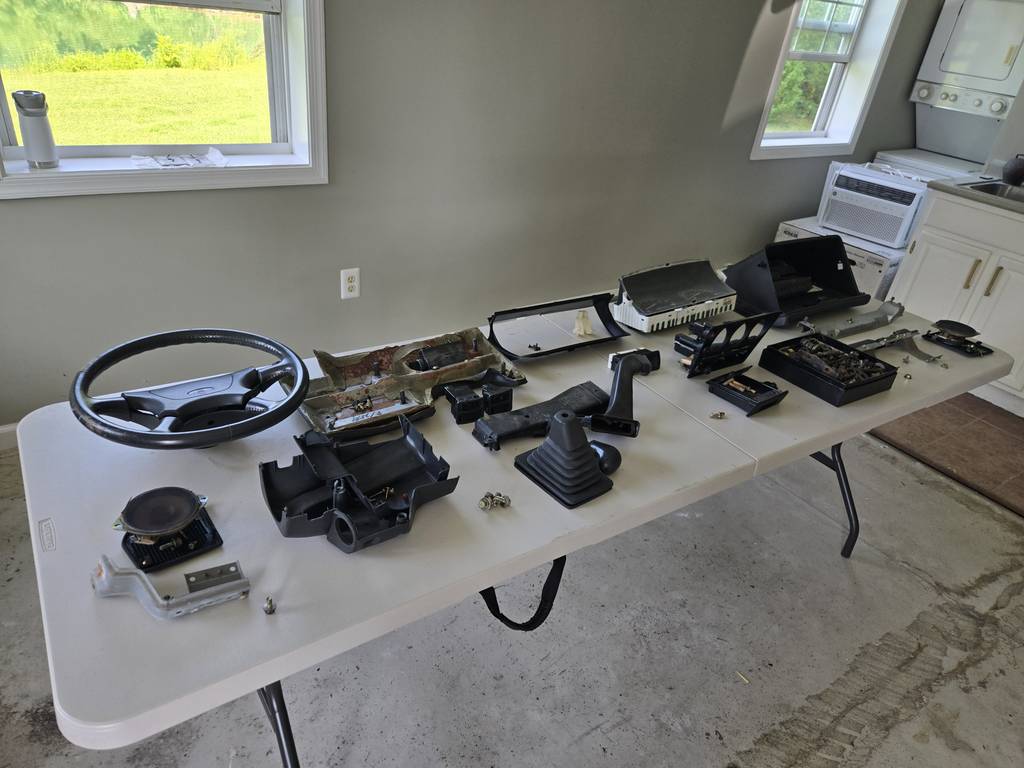

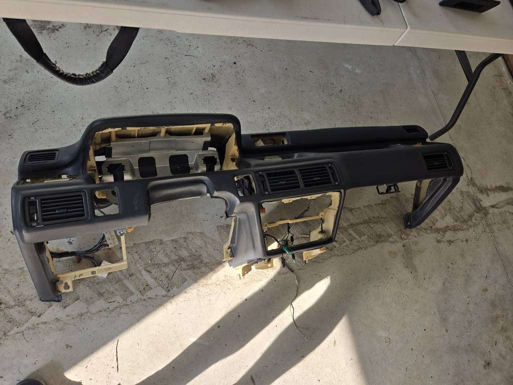

I had go follow a tutorial I found on galantvr4.org, but I eventually got it out.
Laid all the interior bits in order with their bolts so hopefully we can get it back in the way it came out.
Now hopefully we can see better where this leak is coming from. :idontknow:

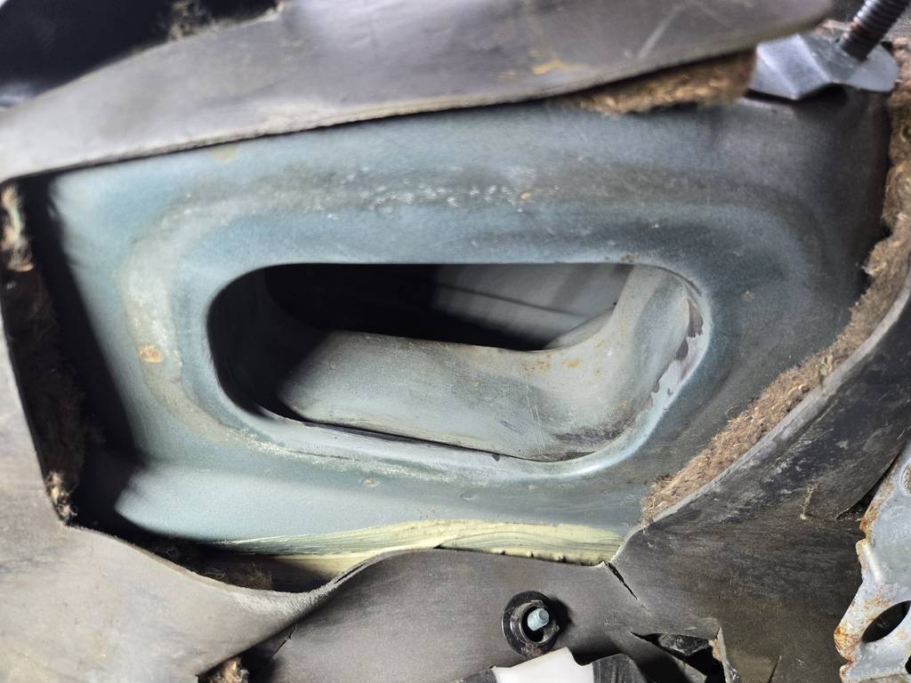

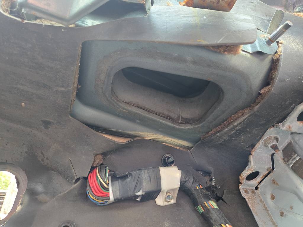

So it's been about 2 weeks since I last posted, and we haven't really worked on anything related to moving forward with the car, instead we are still trying to track down this leak that we HAVE to get to the bottom of. Removing the dash helped, but we need to see even more of the firewall, so we decided to remov the blower motor, heater core, and AC to get a better look.
We were able to determine on the passenger side the water is coming in from the blower motor air duct located in the cowl. It seems there's some sort of gasket material used during manufacturing that has broken down after 30 years.
To seal things up, we mixed up some JB weld and sealed all the way around.
Additional water tests confirmed we fixed that side. However, we are still getting water in the drivers side that we are trying to track down. We've sealed the sunroof, to eliminate that.
But this is our current situation on the drivers side every time it rains. Stayed tuned.

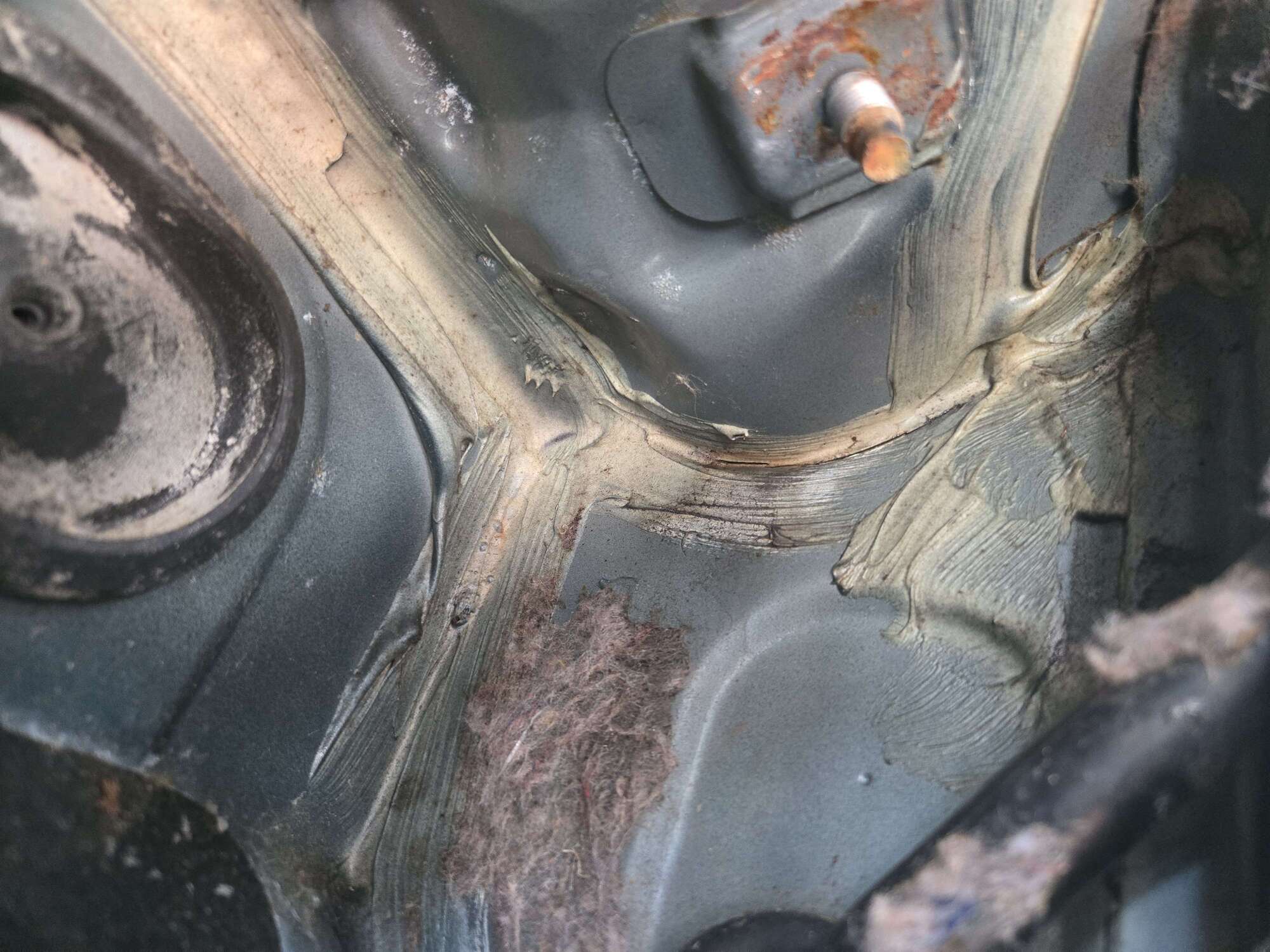

Well, it's been another 2 weeks since the last post and we're still chasing this leak. This pic is up under the crash bar where the inner fender, firewall, and cowl all come together. We know from water tests it comes in here and runs down the inside of the fender well.
So our thought was maybe the sealant is broken down where all this sheet metal comes together and is somehow inside the car.
So we got a hole saw and a sawzall and enlarged the opening to the cowl so we could get some seam sealer in there. This is how we cut it larger on both the driver and passenger side.
Lots of access now.
So we got some tubes of 3M Seam Sealant and did the whole cowl left to right.
And then we tested it the next day with the hose after it cured 24 hours and we still got water inside the car. :notgood:

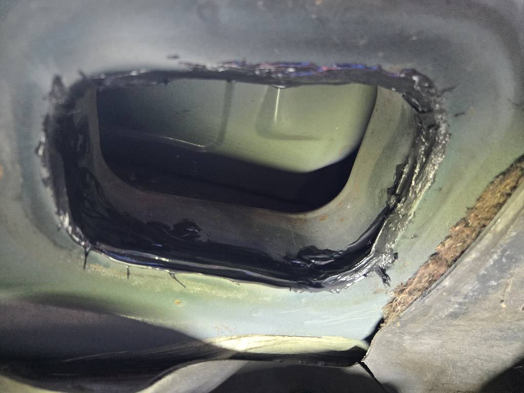

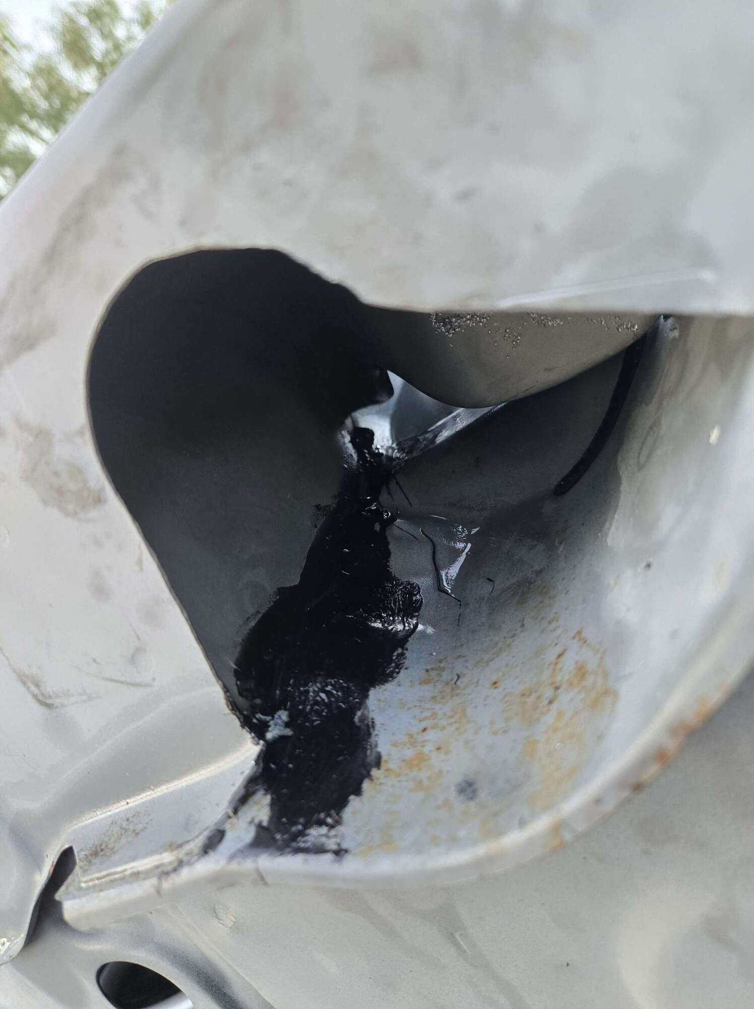

So the latest update is, we are now NOT getting water in on the passenger side. We seem to have fixed that. But still having an issue on the driver side. So I started looking closer at the windshield. It's not marked MMC anywhere, so I don't believe it's original. I noticed there's a lot less window sealer on the drivers side than the passenger, and when I spray the hose down the a-pillar we are getting water in the car. You can see in this pic there's almost no sealer on the drivers side, it's just the edge of the glass.
So I applied some sealer here.
And then replace the rubber stipping.
And then we had rain in the forecast, so we uncovered the car .... and we got water in the car. Again.

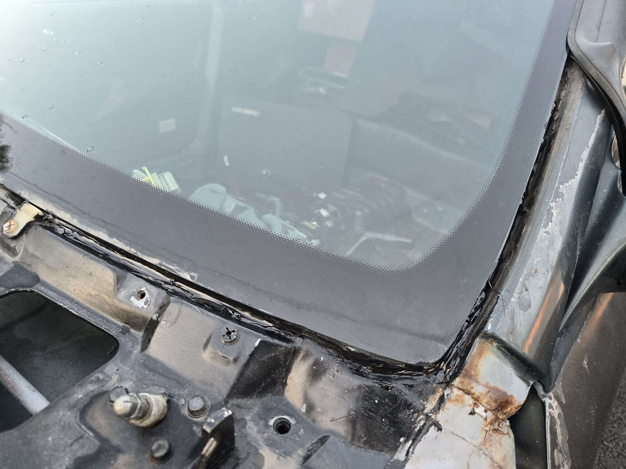

Honestly, I know we've all been there with any kind of large scale restoration, but I'm getting kinda frustrated with this car. We have so many other things we need to working on and getting too and we're wasting time. I guess I'm going to have to call a windshield place tomorrow and see if they can come out and remove the windshield and reset it. We've eliminated everything else, it has to be the windsheild.
So the latest is I called a windshield place to come out remove the glass and reset it. $195 to remove and reset. They did say they don't like to reset glass without having a "backup" windshield in case it breaks. So, I'm currently waiting for a call back while they try to source a windshield. Without looking into it, my guess is they are discontinued for these cars ...
The professional who came to remove mine literally had to pull out the sawzall with flat blade attachment as nothing else would get through the old sealant. Glass everywhere. Good luck. I found an aftermarket one through safelite but it wasn’t easy or cheap.
