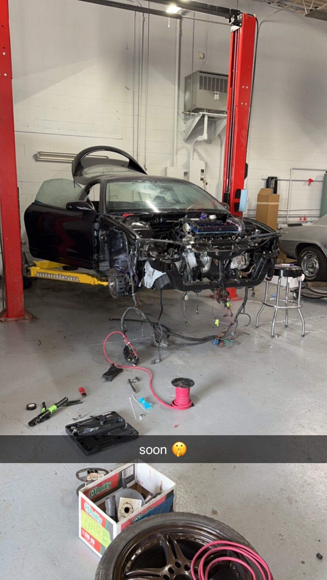

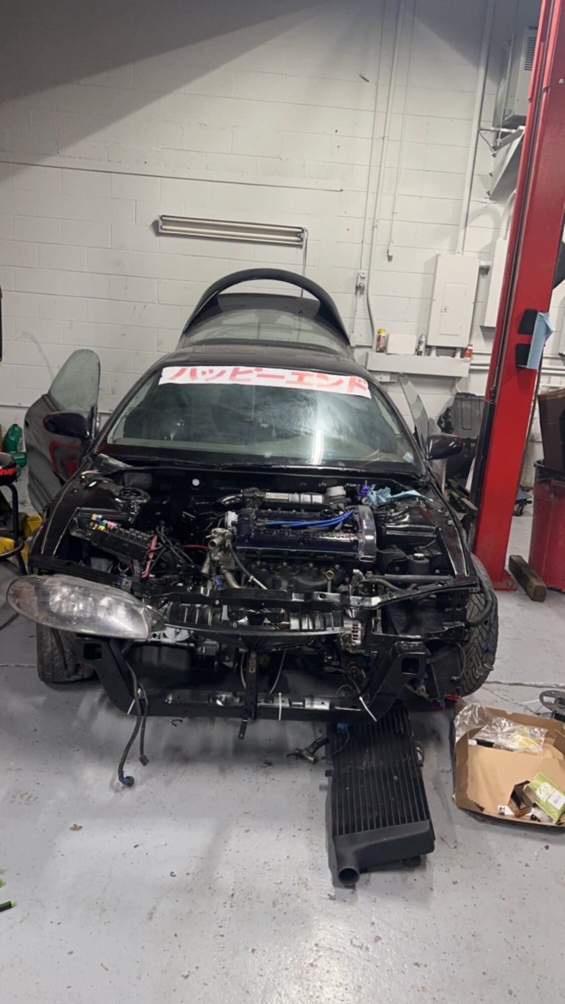

FIRST DSM STREET BUILD!!!
1997 6 bolt swap eclipse

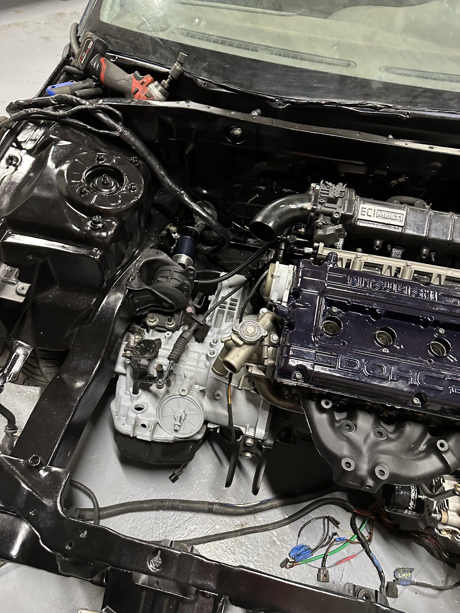

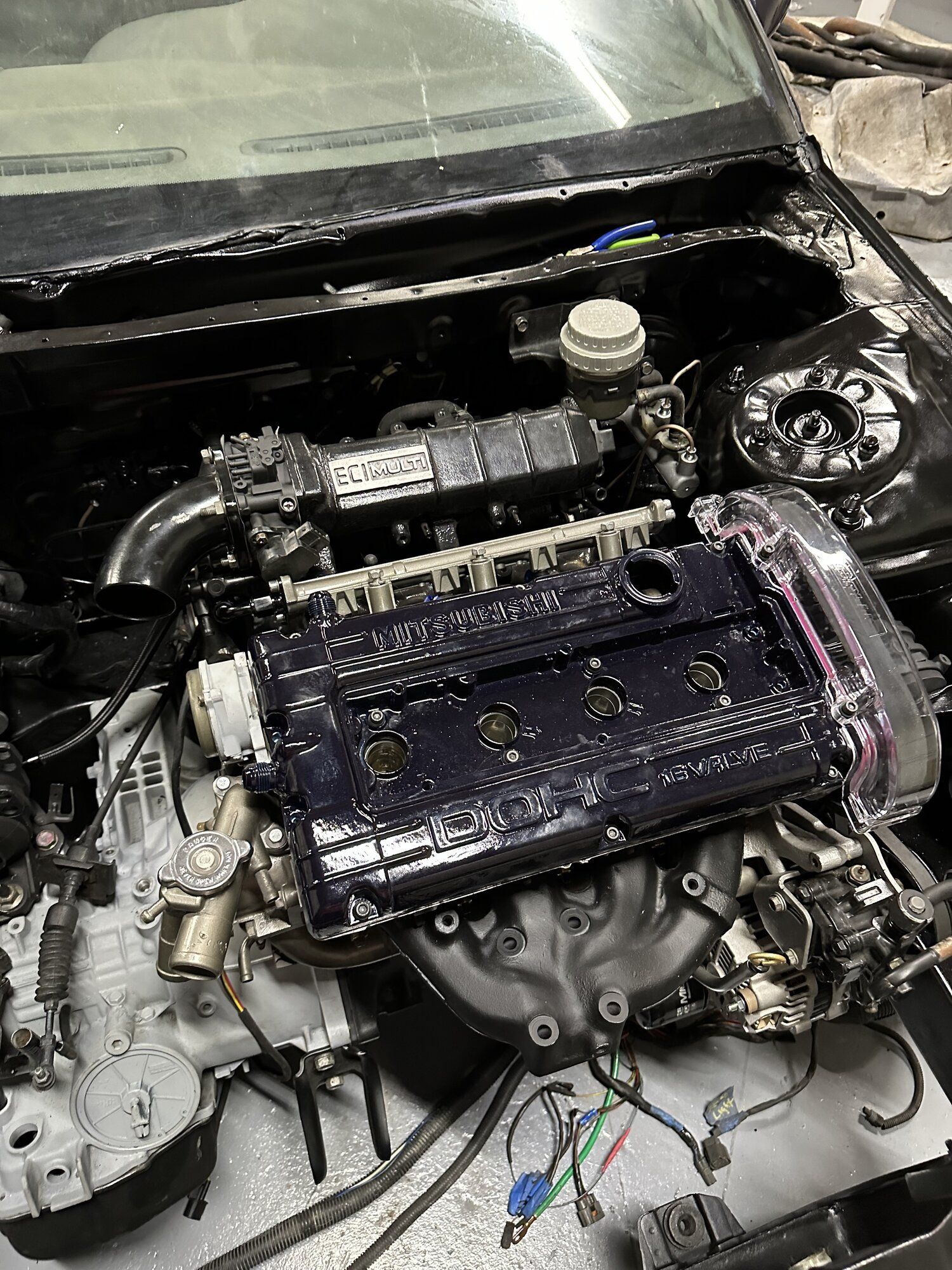

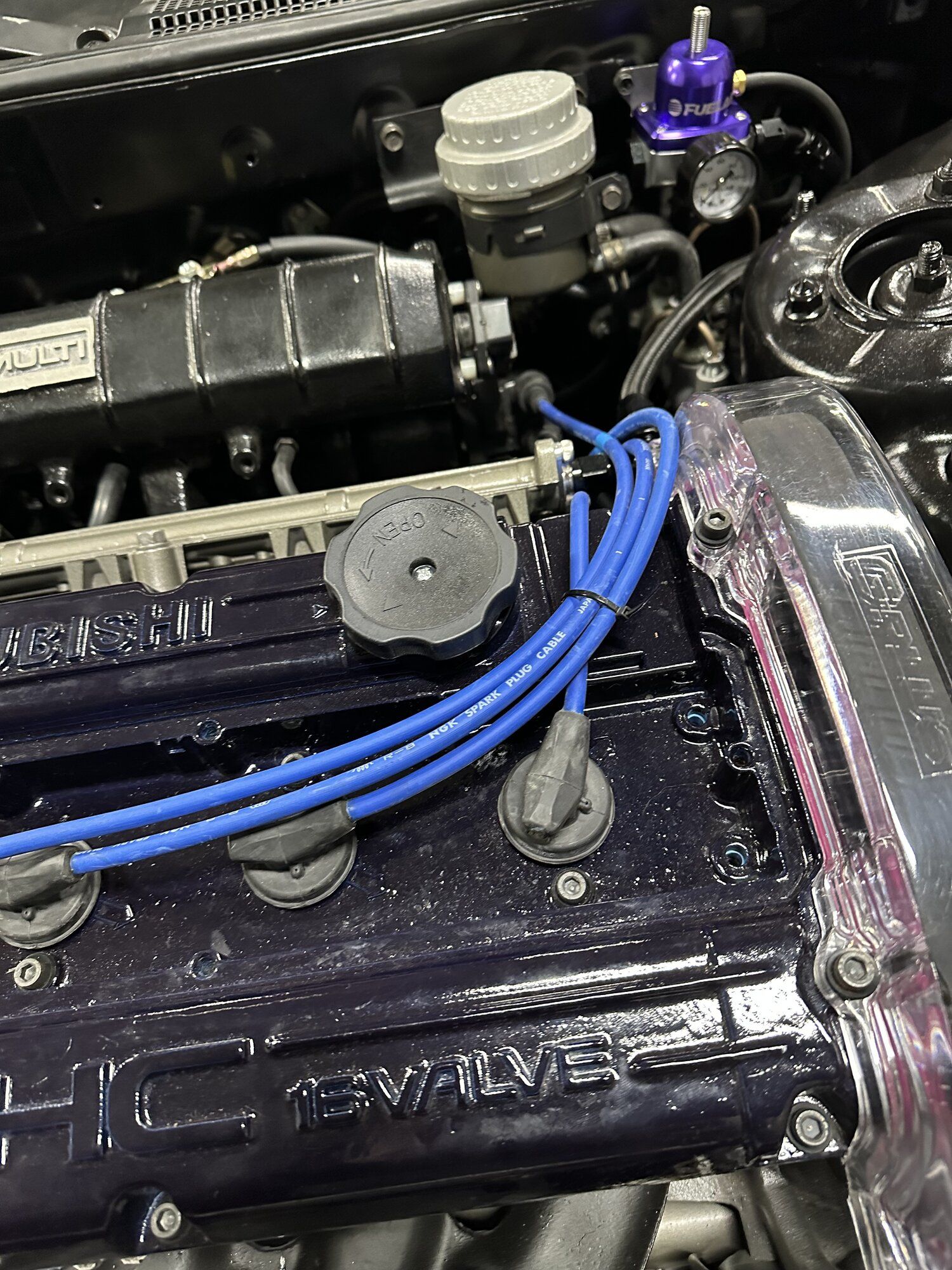

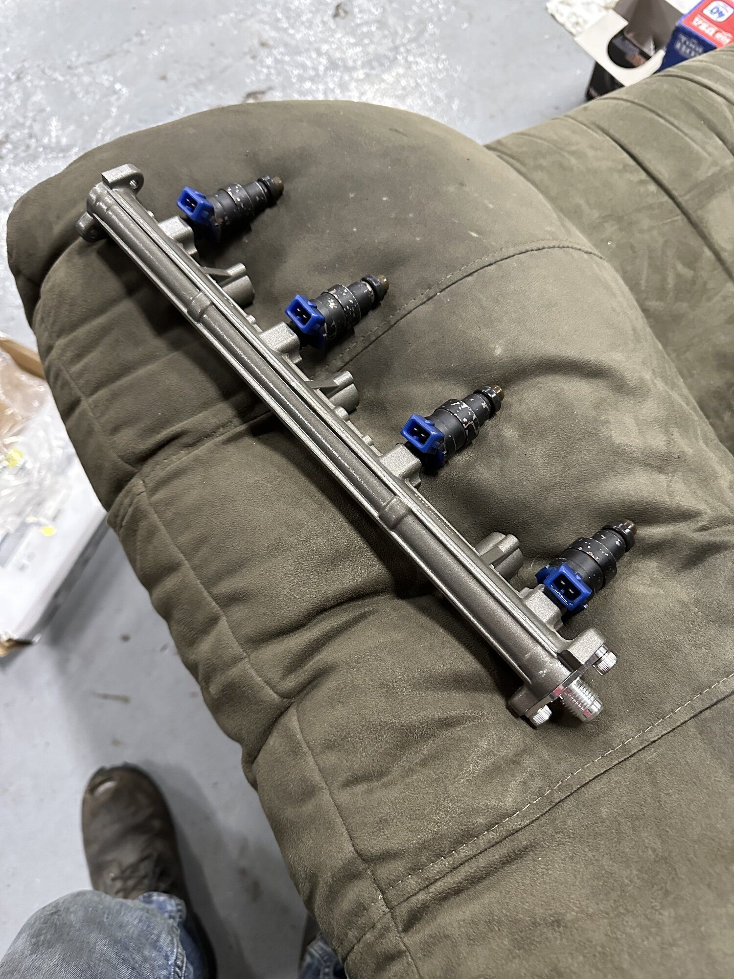

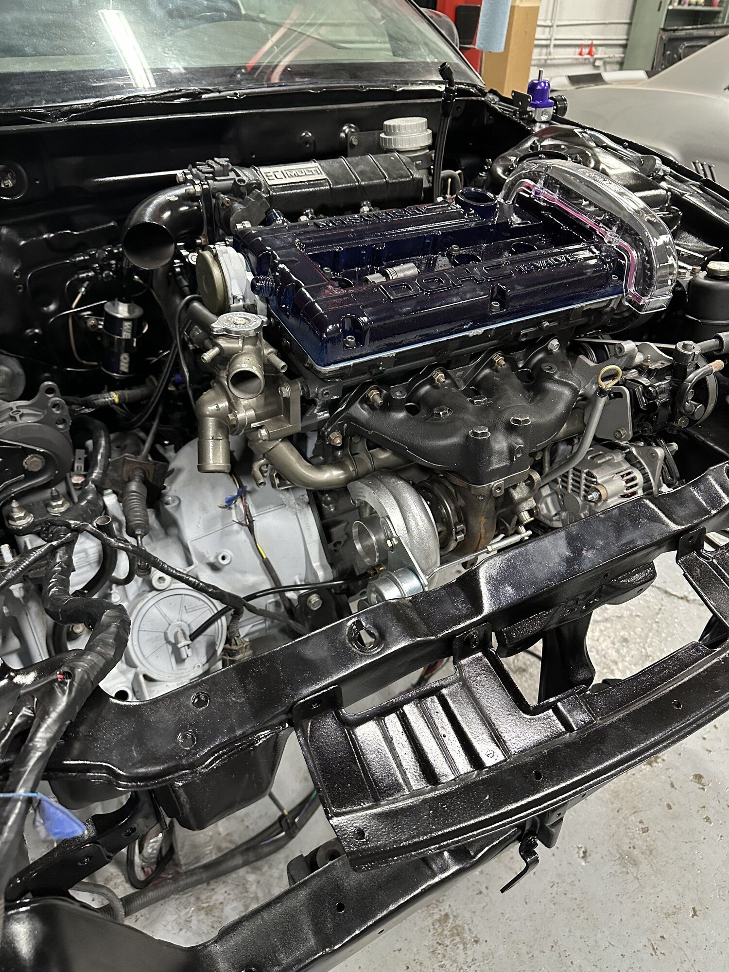

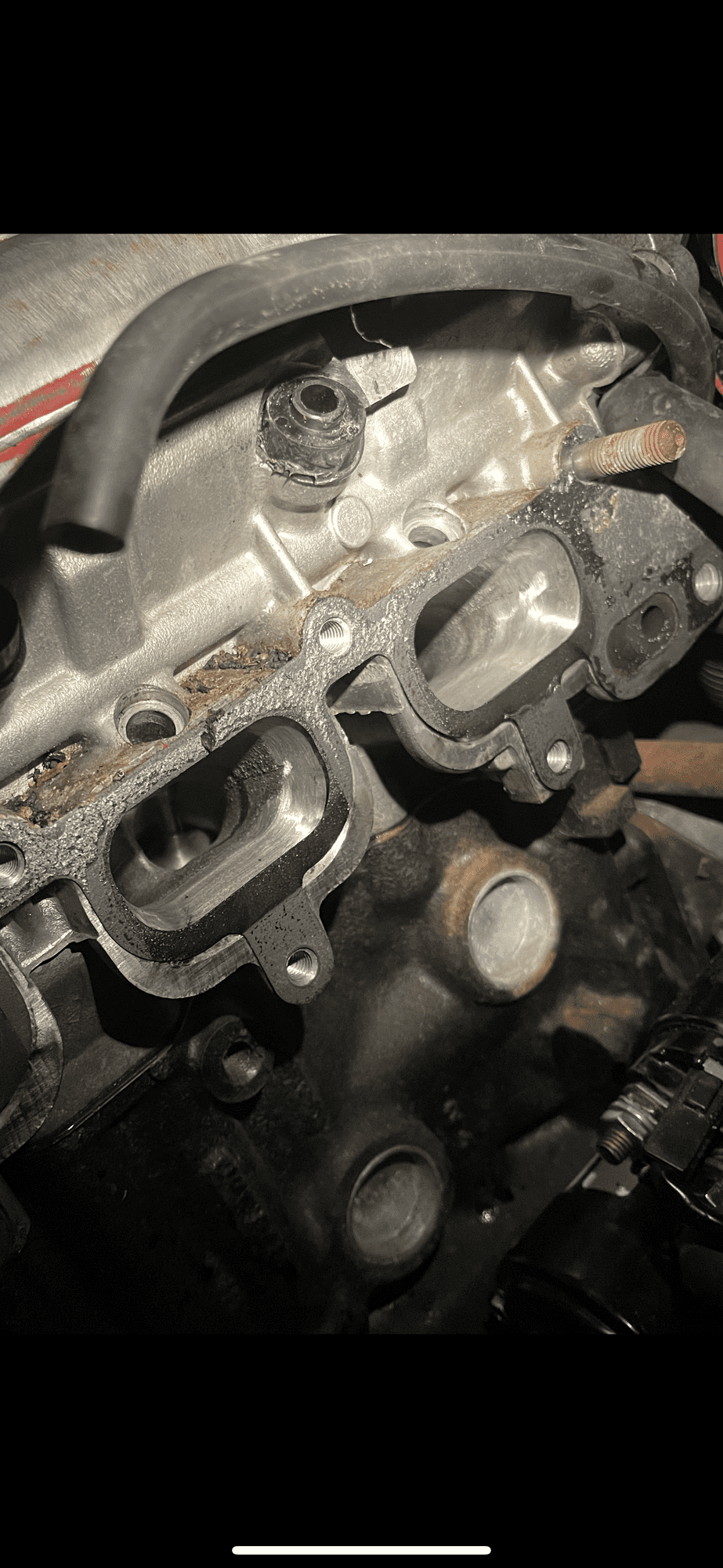

fuel rail going in with 660 denso injectors there the set that came with the car, i wanted to upgrade but would like to buy one set and just be done with it, (fic 2150s) and those were around $600 so thats gotta wait. should be able to start it up with these.
yes, is that a bad thing? its what came with the car.

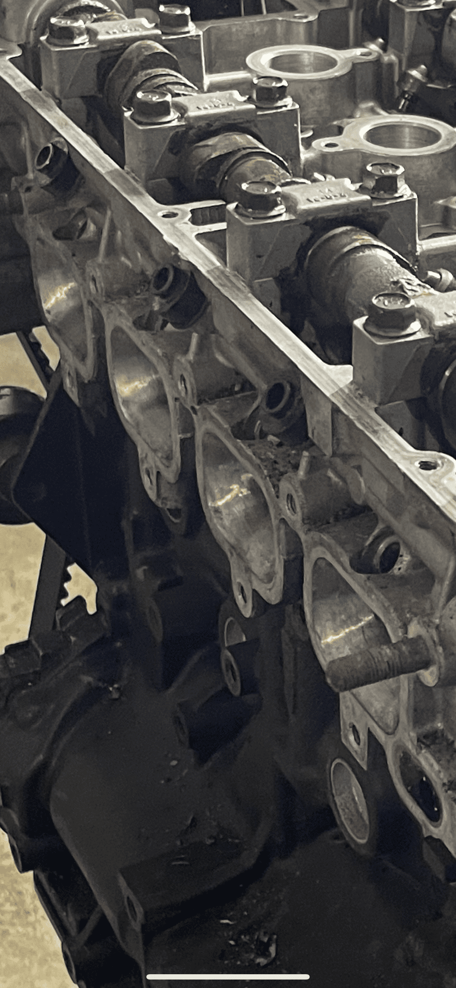

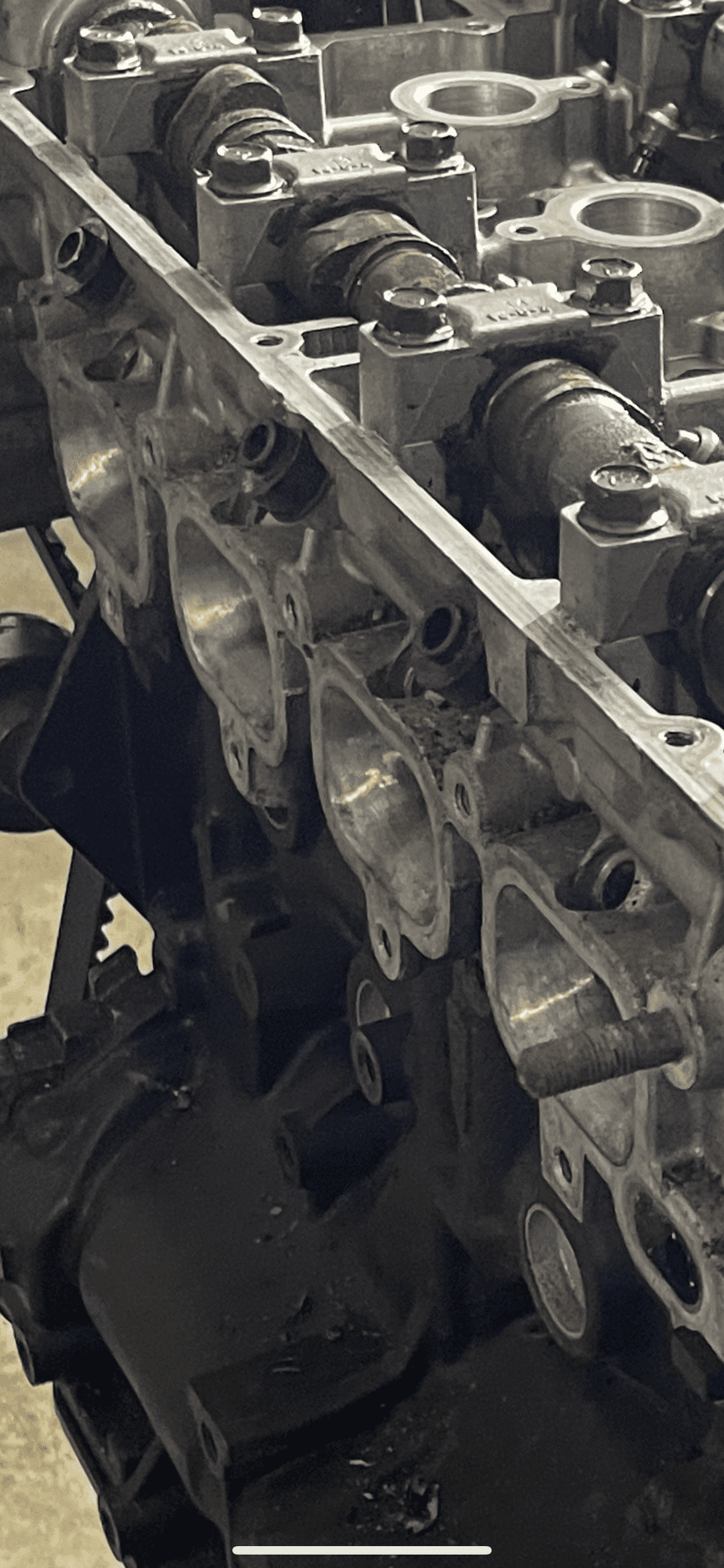

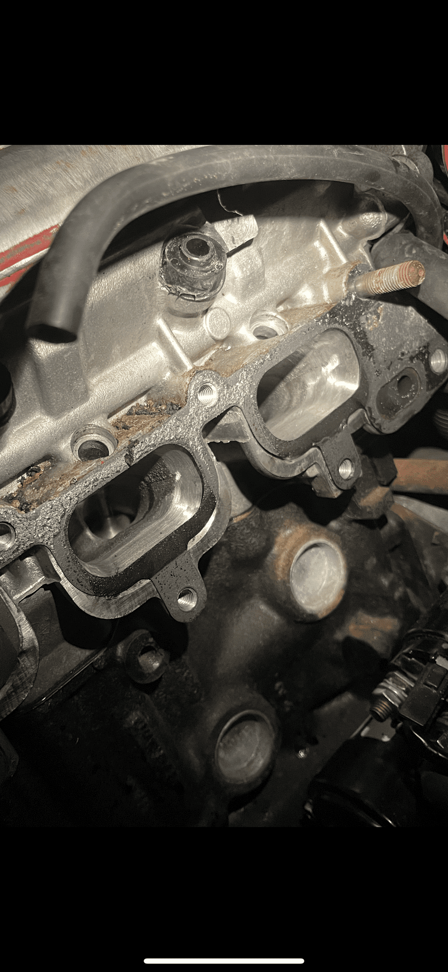

The intake runners on a stock 2G head are smaller than the intake runners on a 1G manifold. Combining these two creates a big step down into the head. Not a great setup.
School of thought is the 1G intake runners are too big, and generally only line up with a 1G head. Do NOT port the 2G head to match the 1G runners - not worth it. You would be better off locating a 2G intake manifold and porting the 52mm throttle body flange for the 60mm 1G throttle body instead.
the head was ported and polished to fit the intake.
Might as well run it for now, not a big deal. You can always upgrade down the road easily and mostly cheap with matching 2G intake, porting the TB to 60mm like Justin mentioned, and building a fresh 2g head. Keep up the good work, it's looking great!
Might as well run it for now, not a big deal. You can always upgrade down the road easily and mostly cheap with matching 1G intake, porting like Justin mentioned, and building a fresh 2g head. Keep up the good work, it's looking great!i
what do you mean upgrade with a matching 1g intake? the po had the head ported to match the 1g intake that i have on the car? its already a fresh head to all new parts in it.

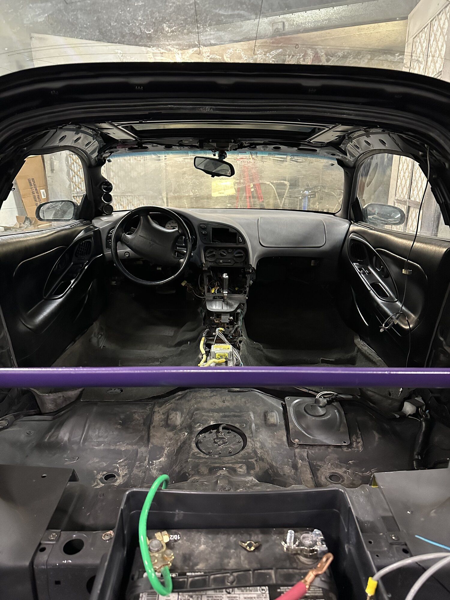

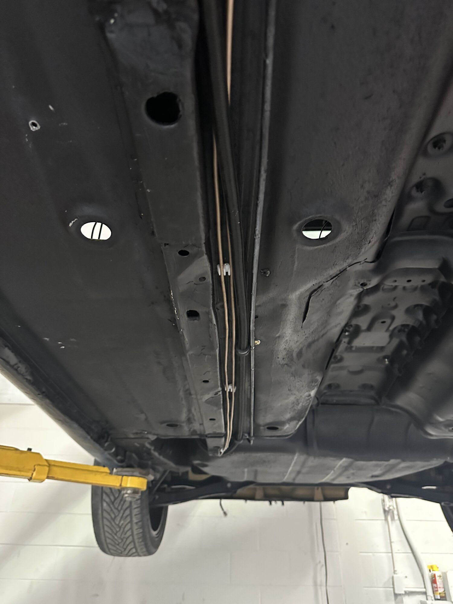

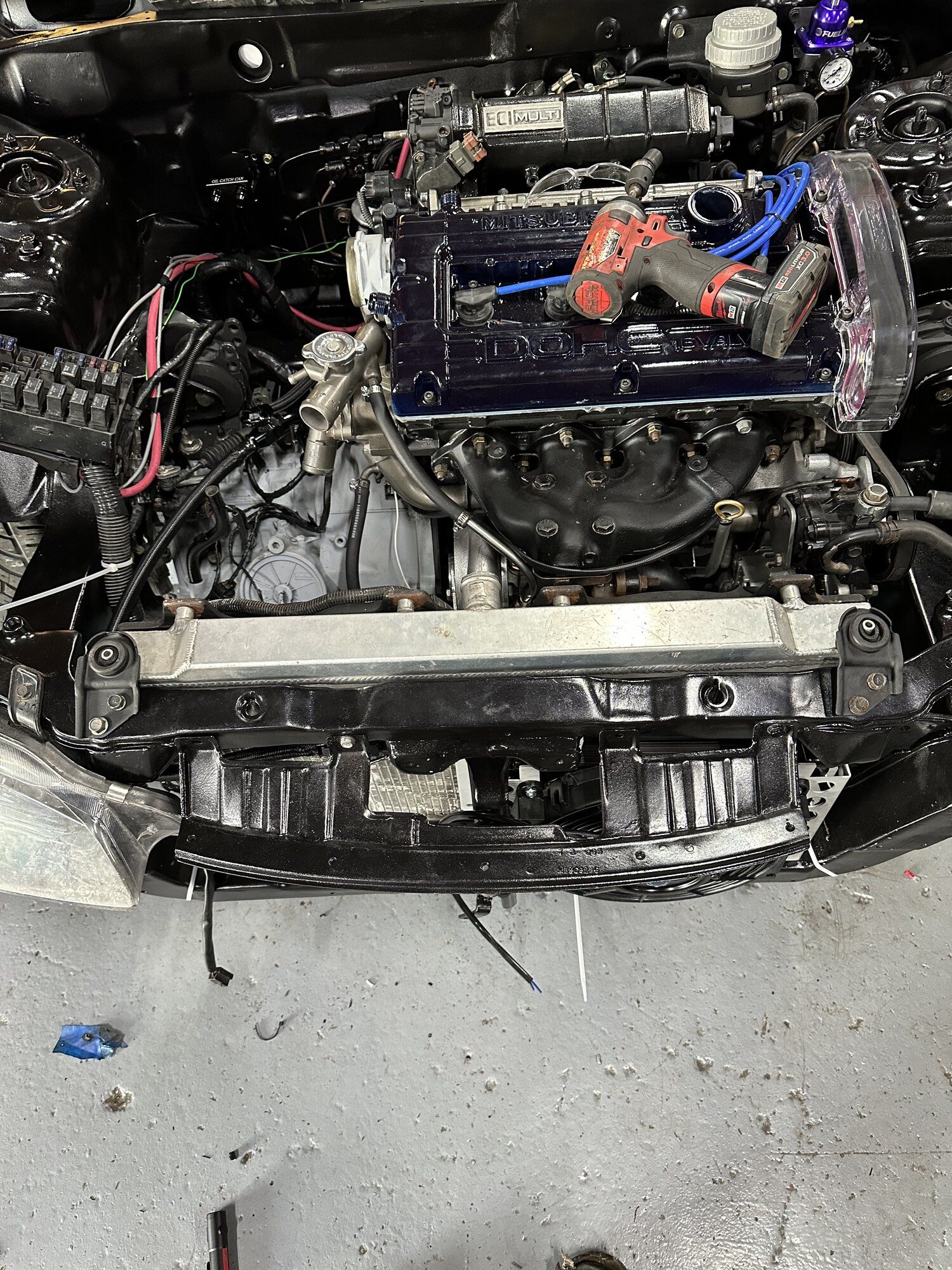

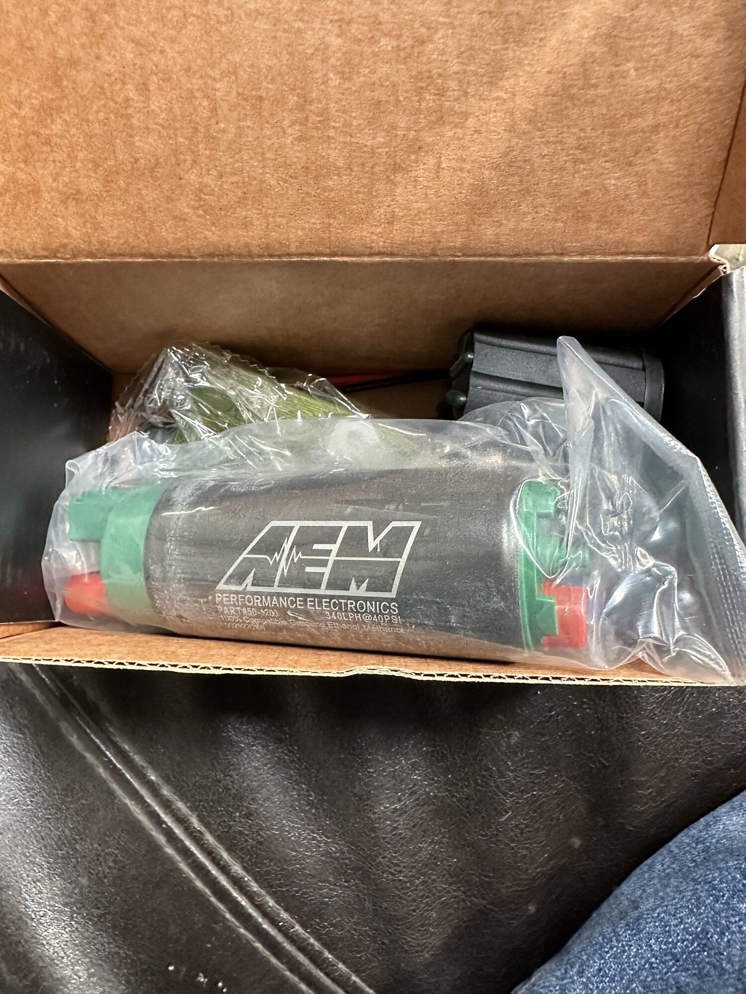

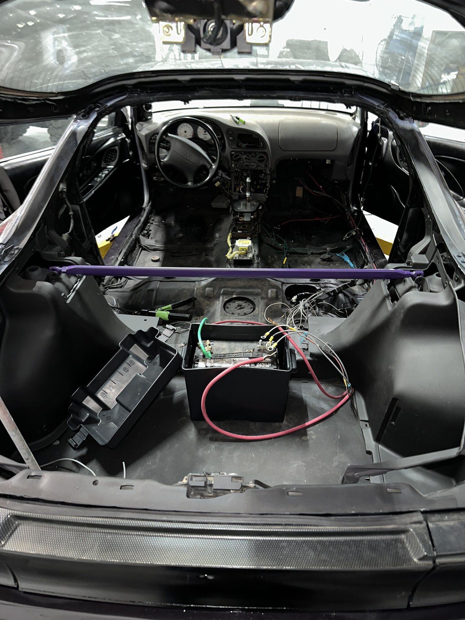

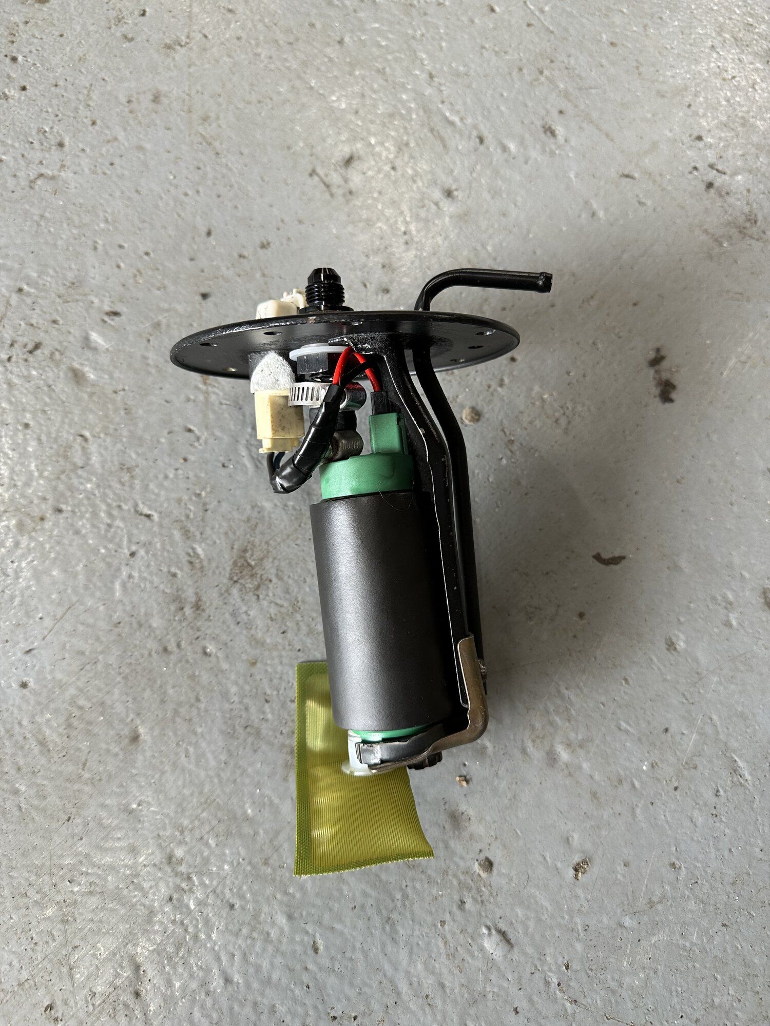

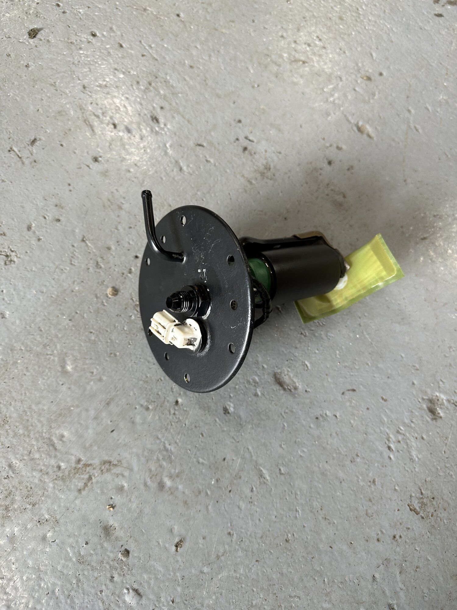

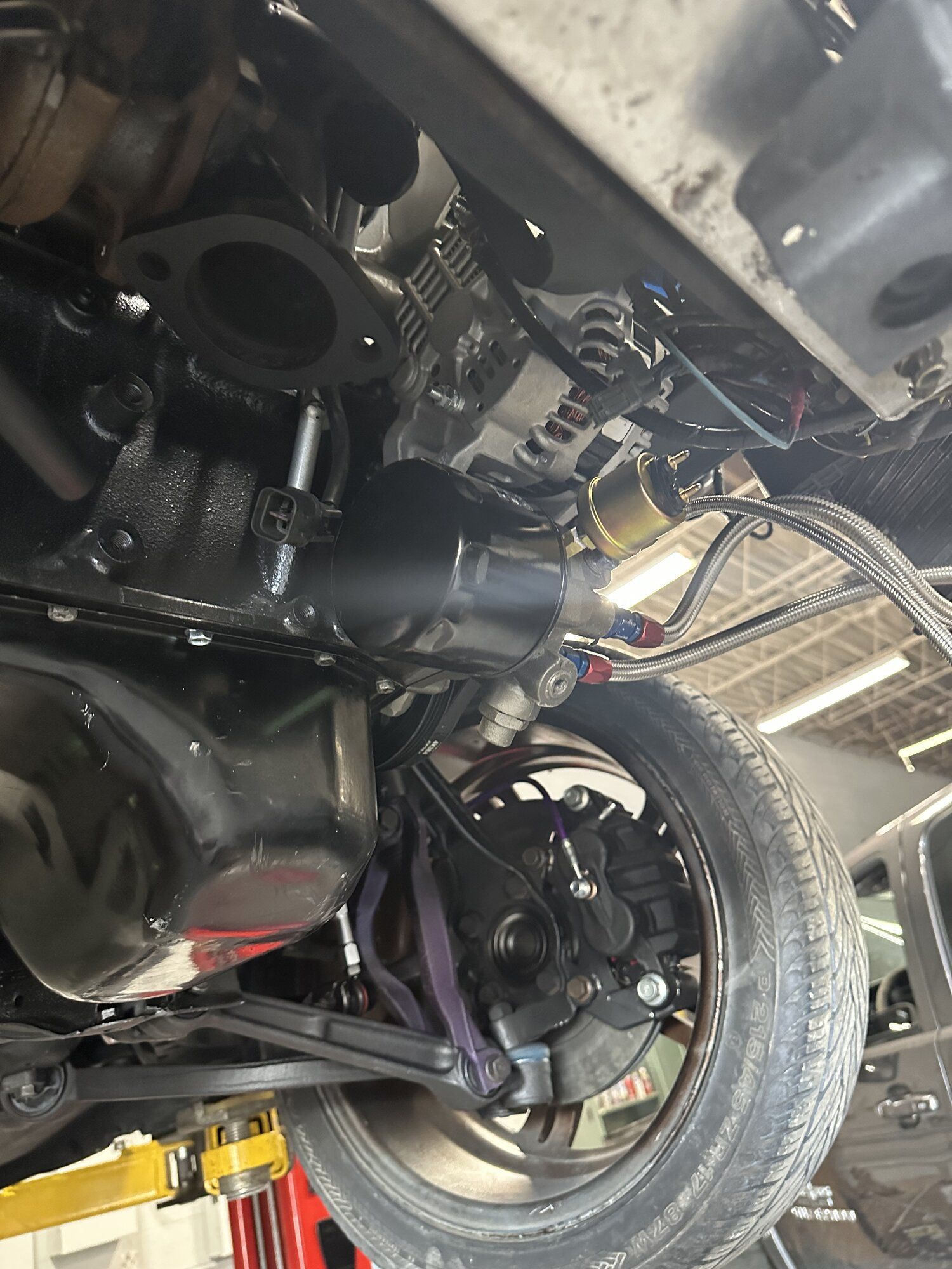

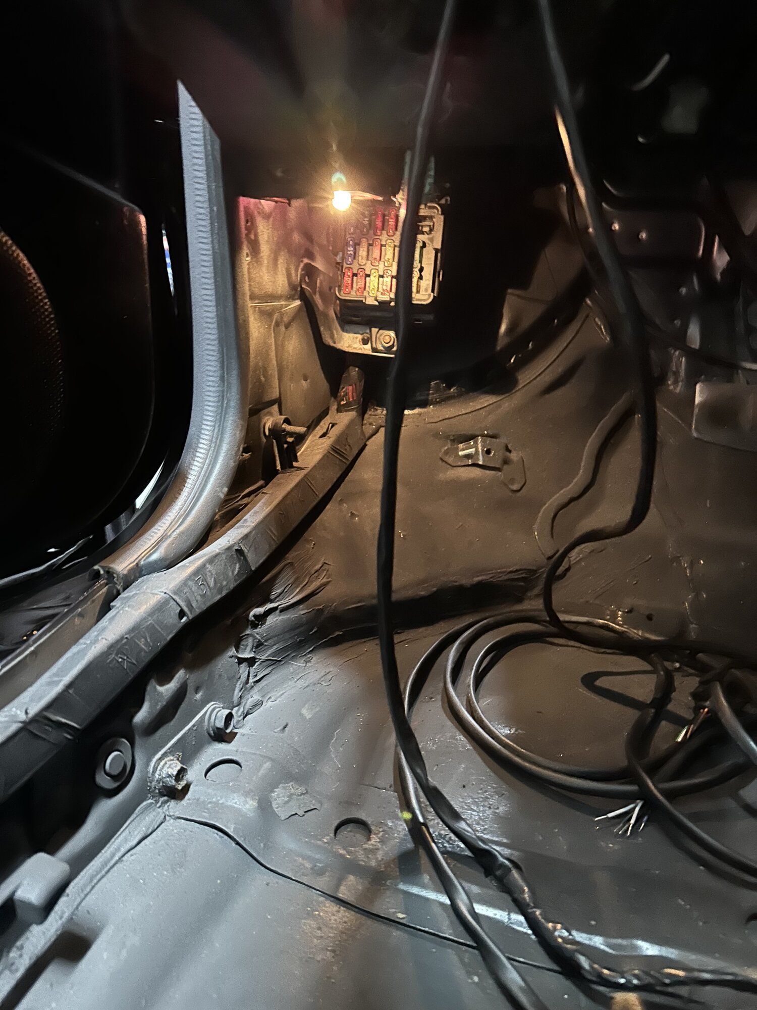

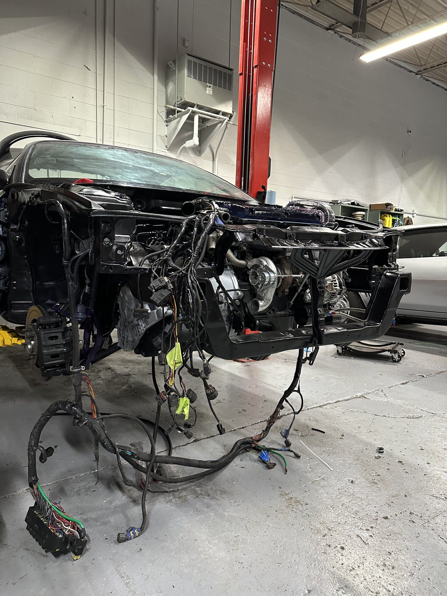

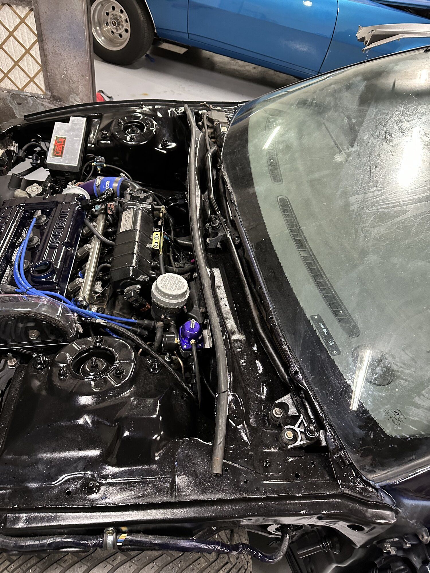

fuel pump was a joke to get alined and fit, pretty sure i finished the harness on the bay side, just have to finish running the wires to the battery in back and we should have power back!

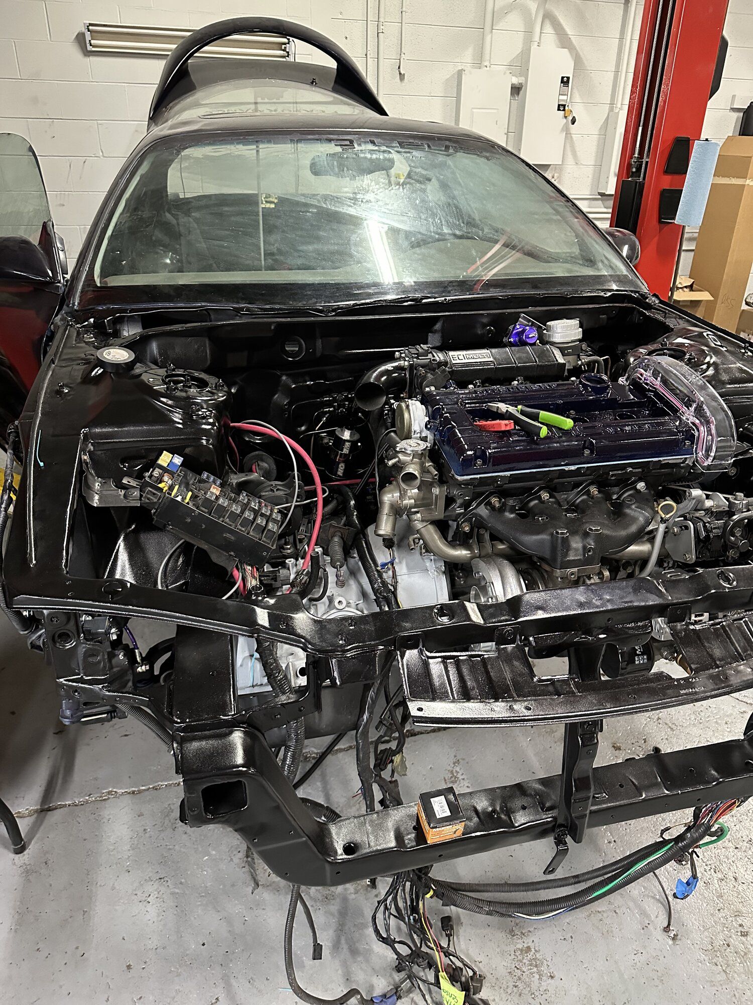

fuel pressure regulator mounted ✅
hood laches acquired ✅
o2 sensor housing installed ✅

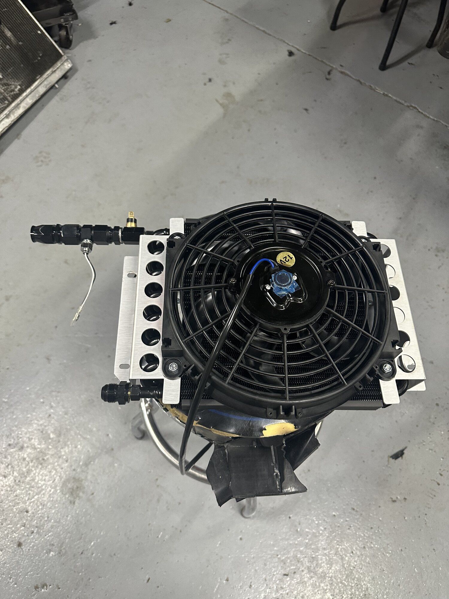

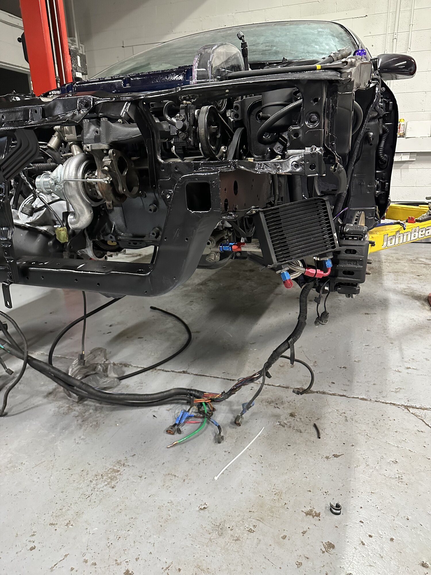

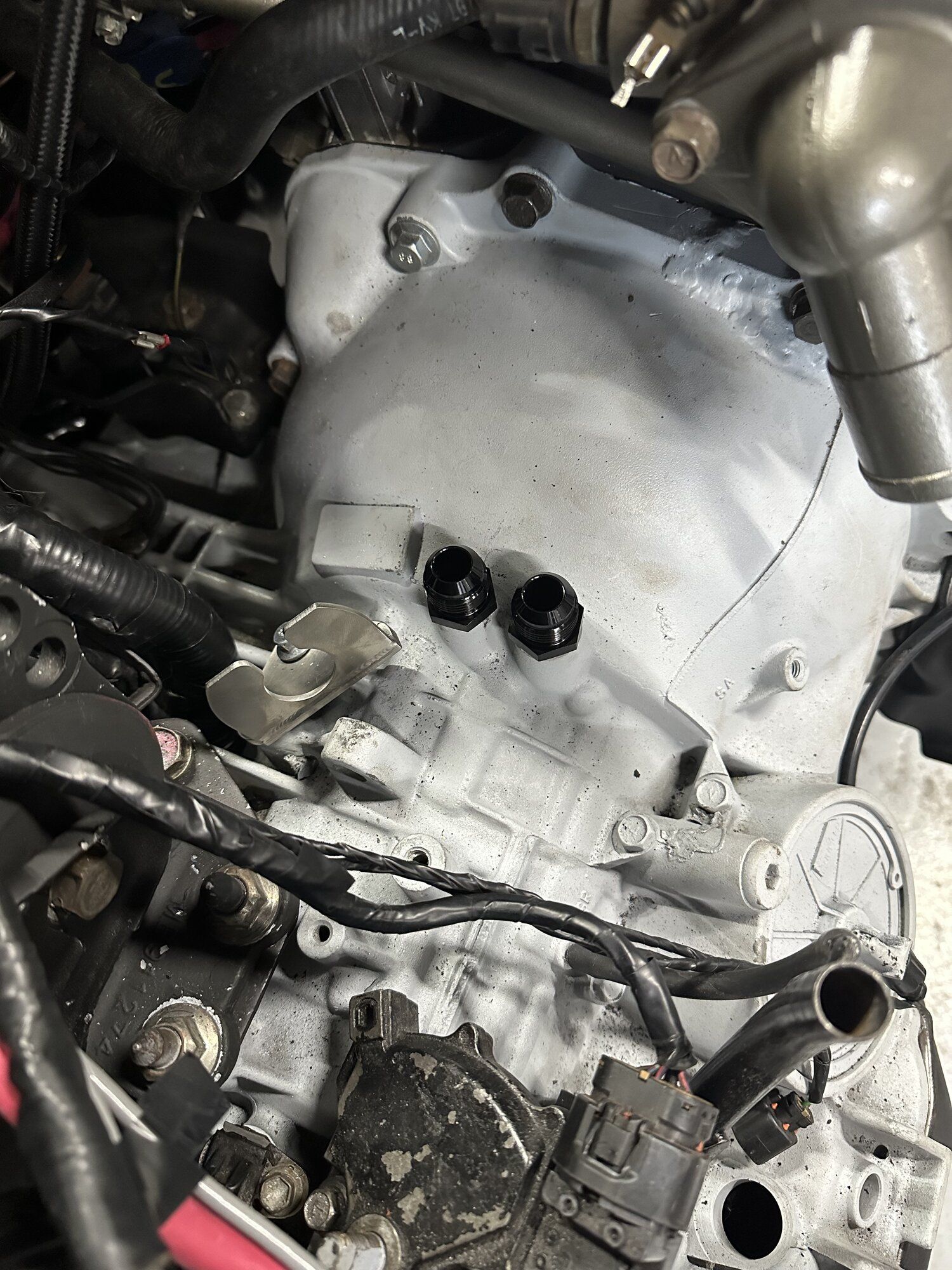

fittings for trans cooler didnt get time to make lines and mount the cooler yet tho,

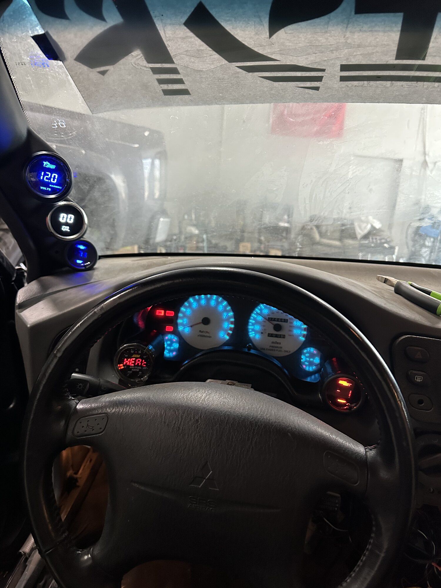

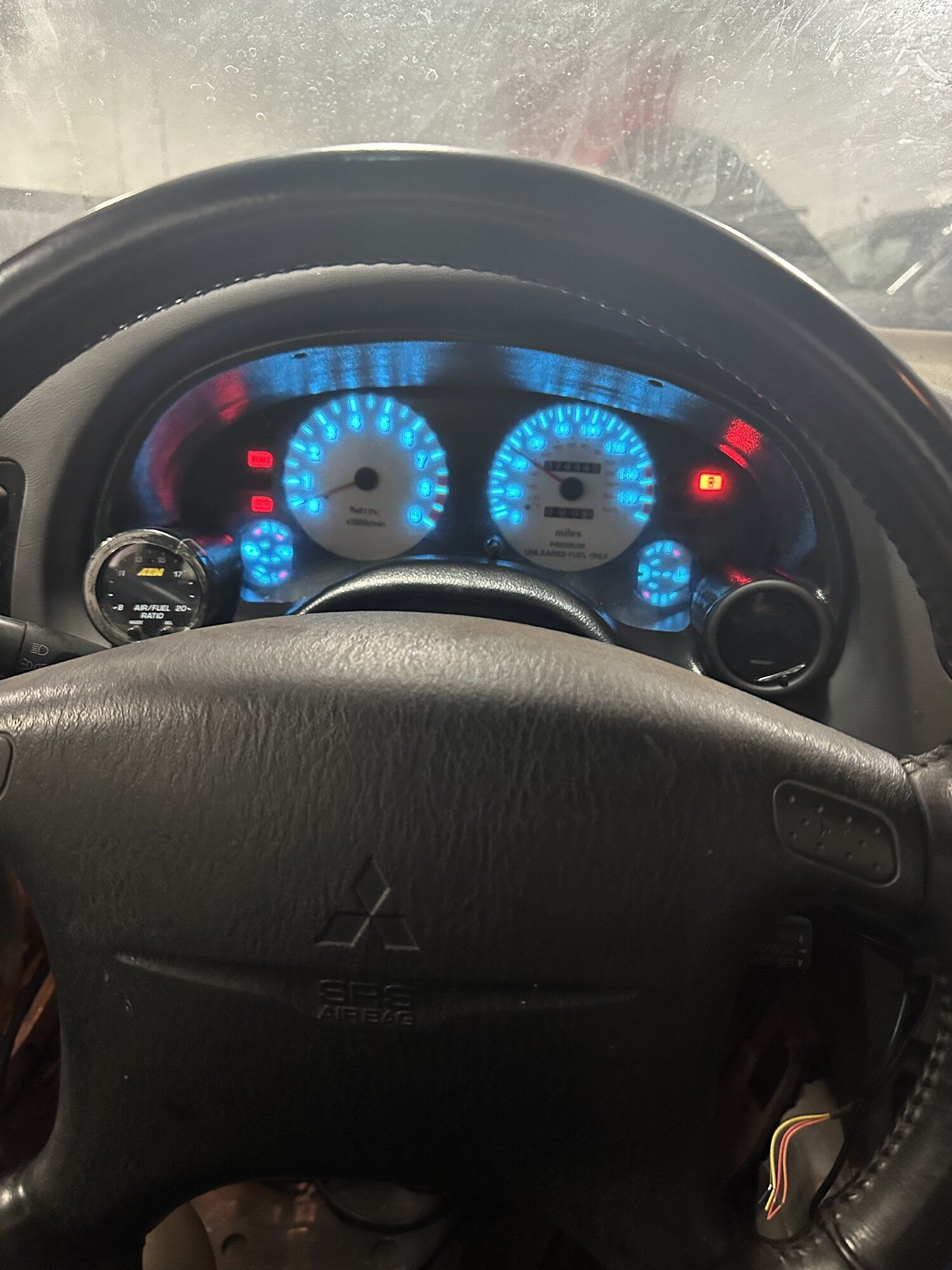

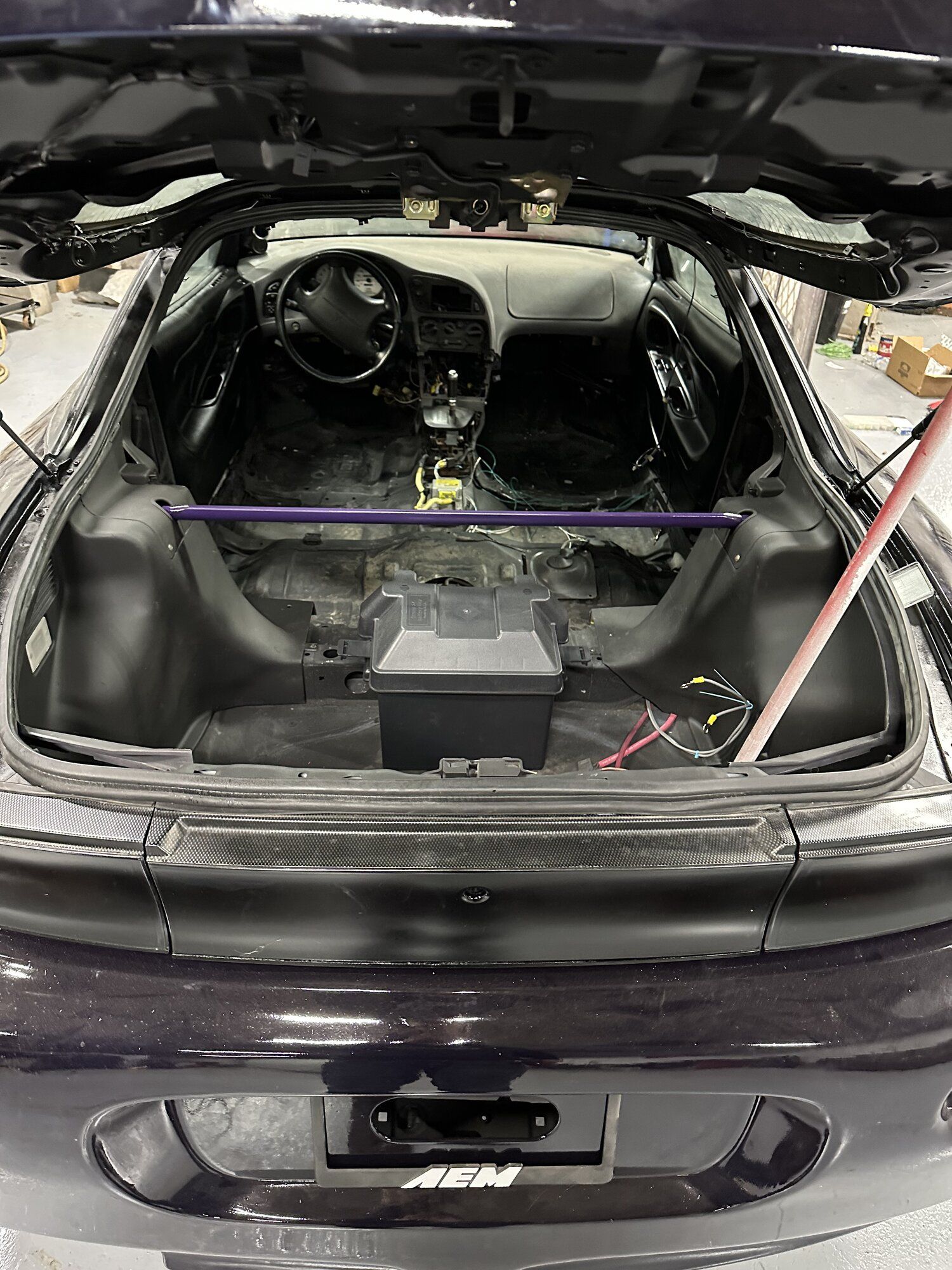

some of my harness has power the lights work, but my dash didnt light up weird.

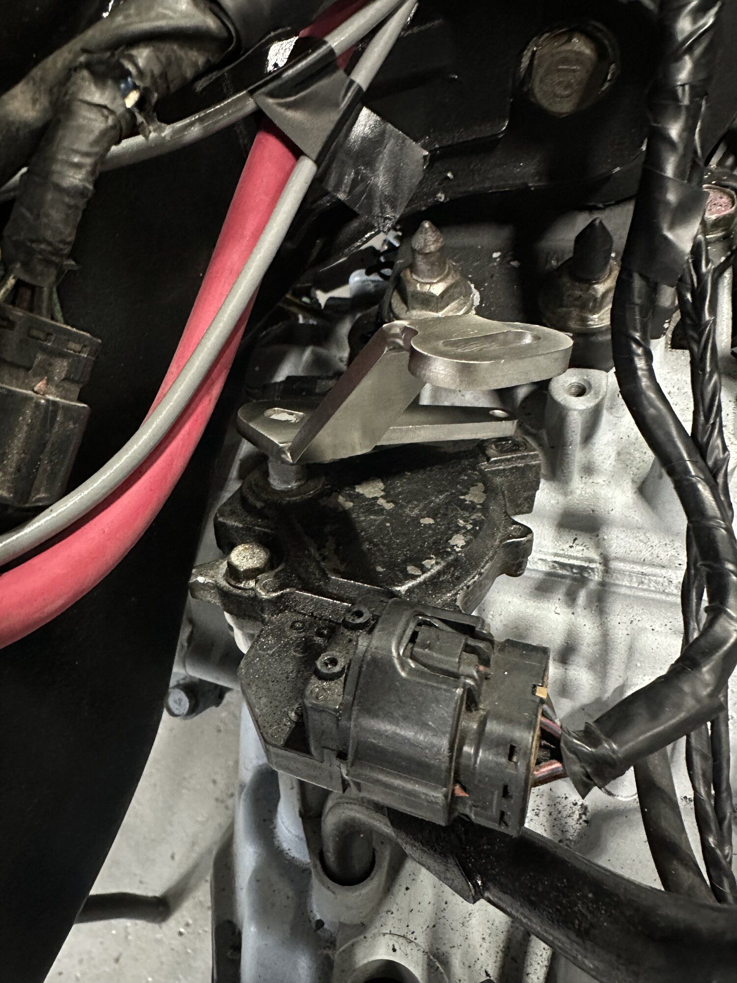

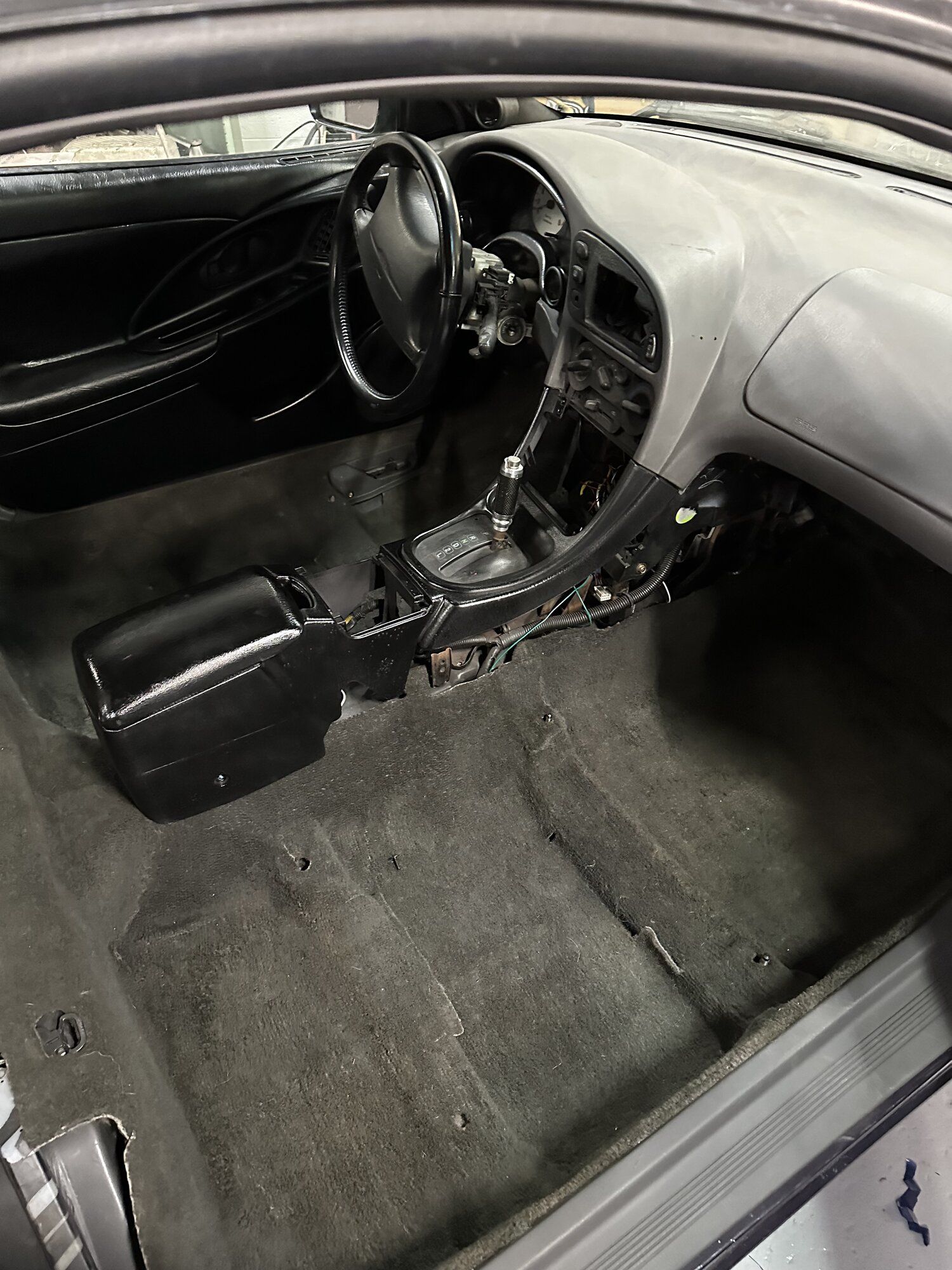

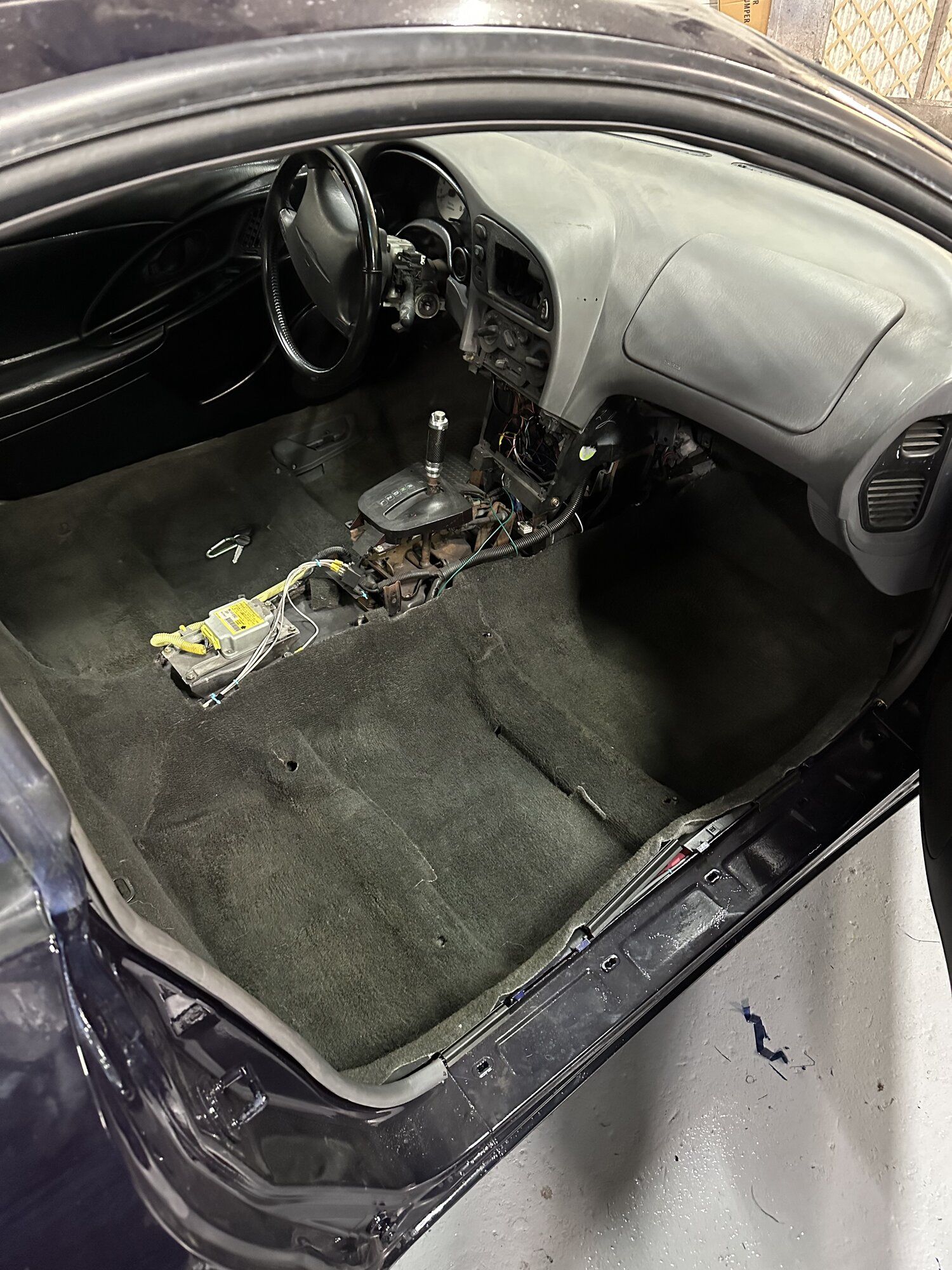

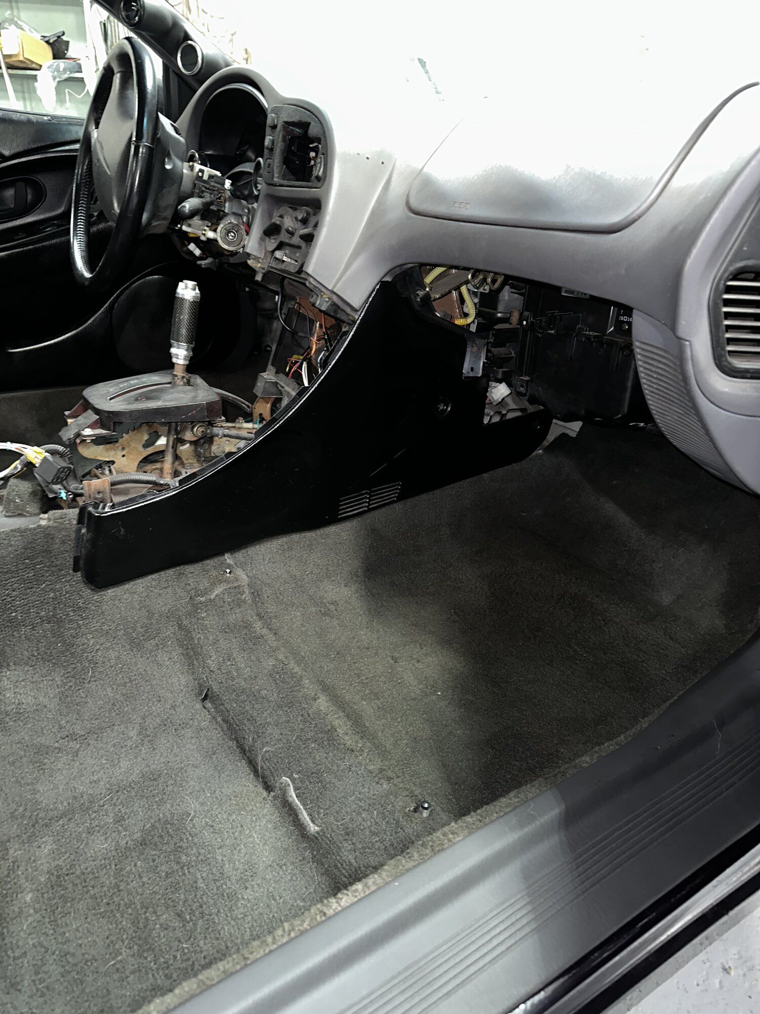

ordered the shorter shift levers the one didnt fit right away i had to dremel out the hole,

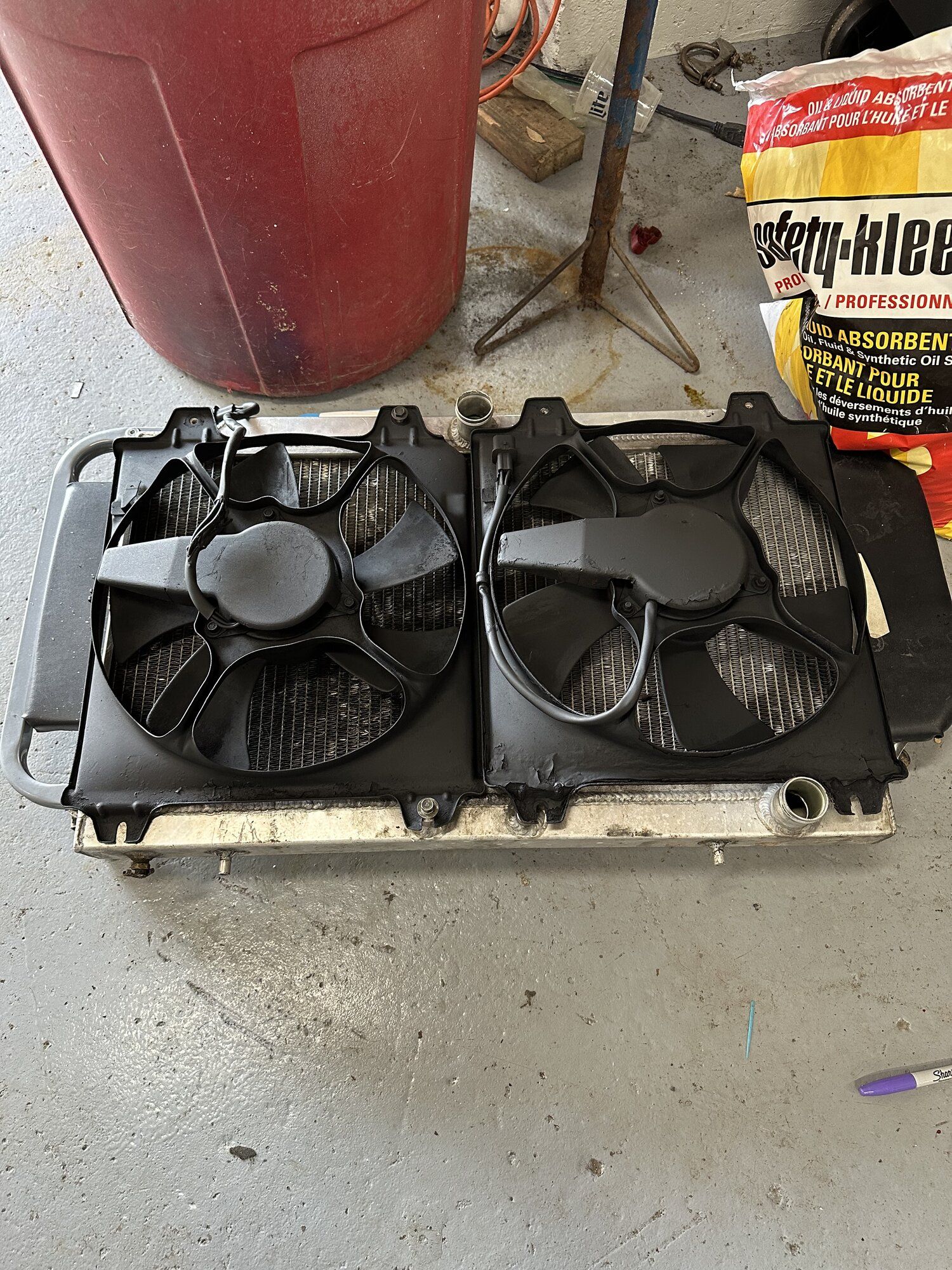

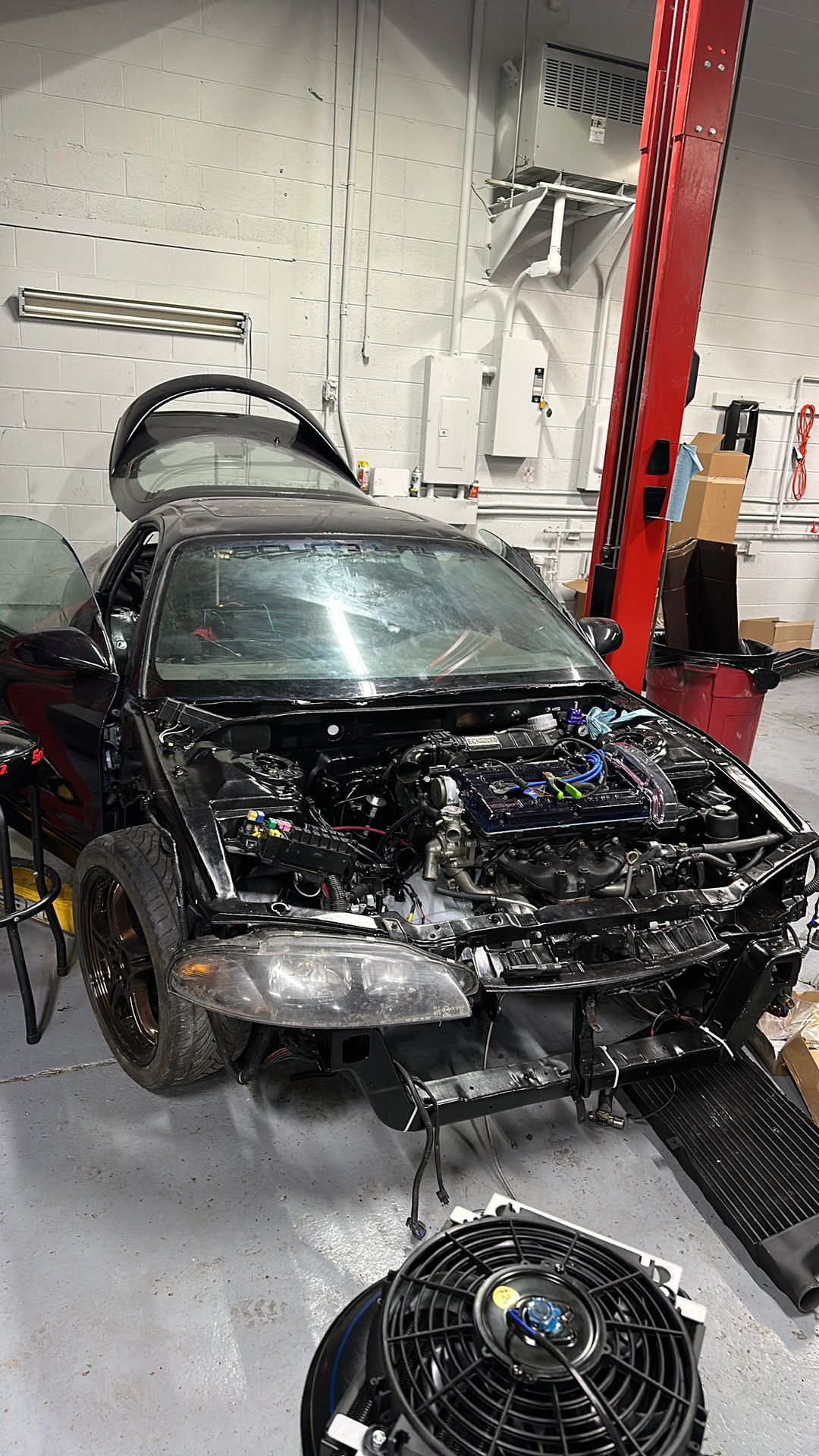

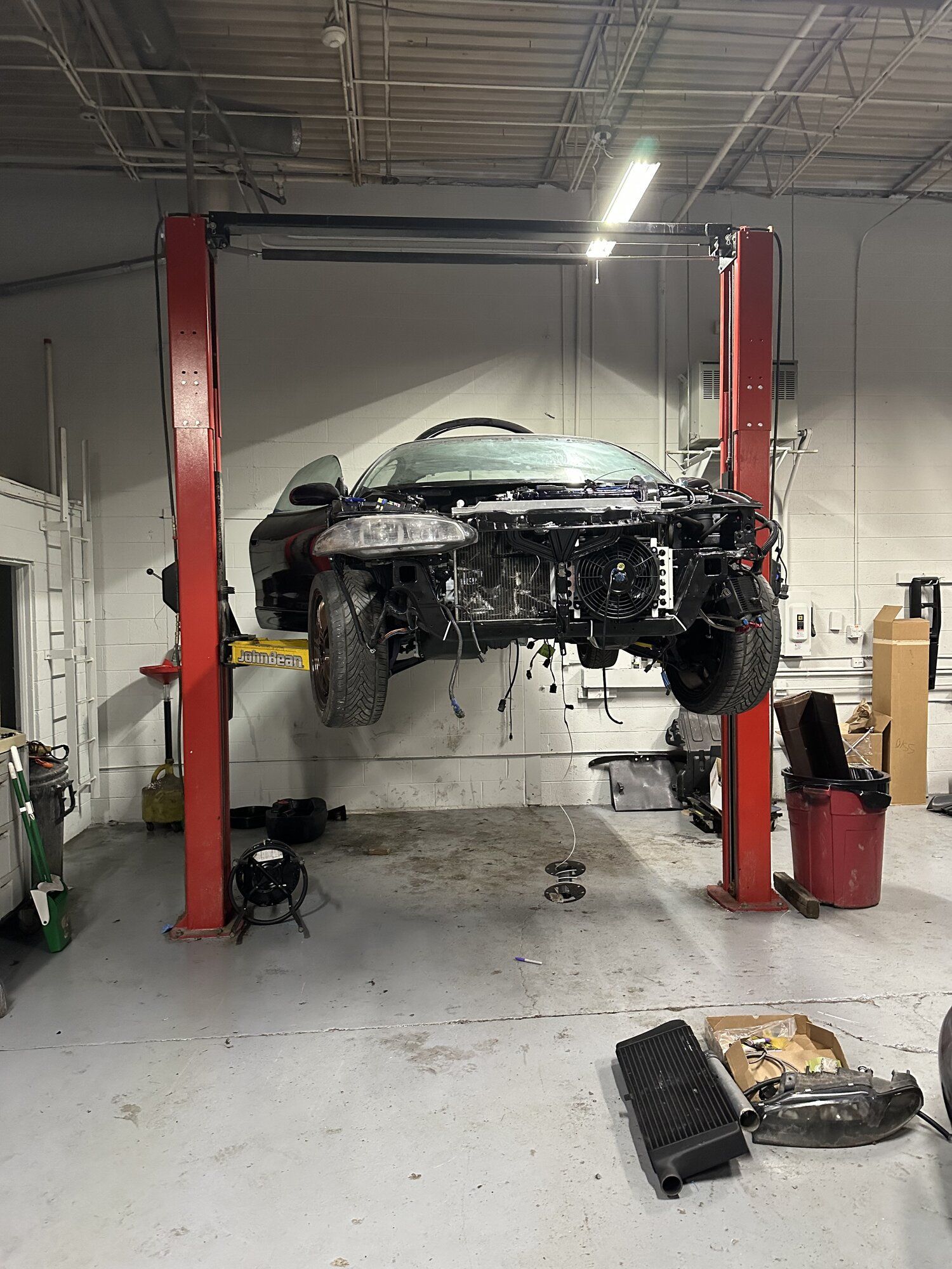

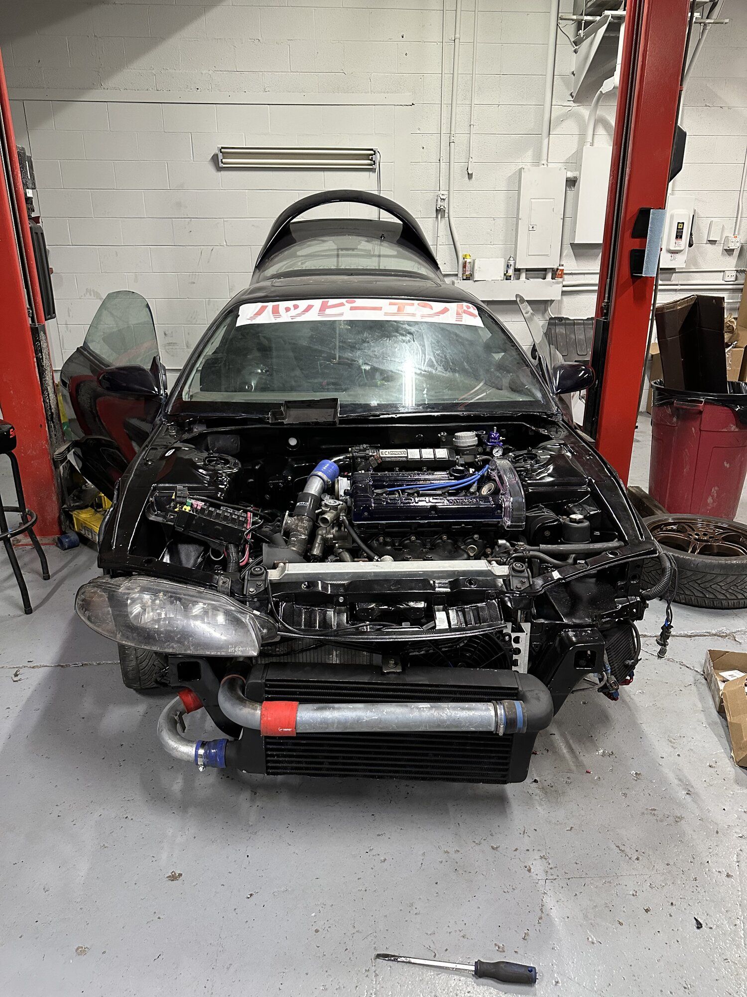

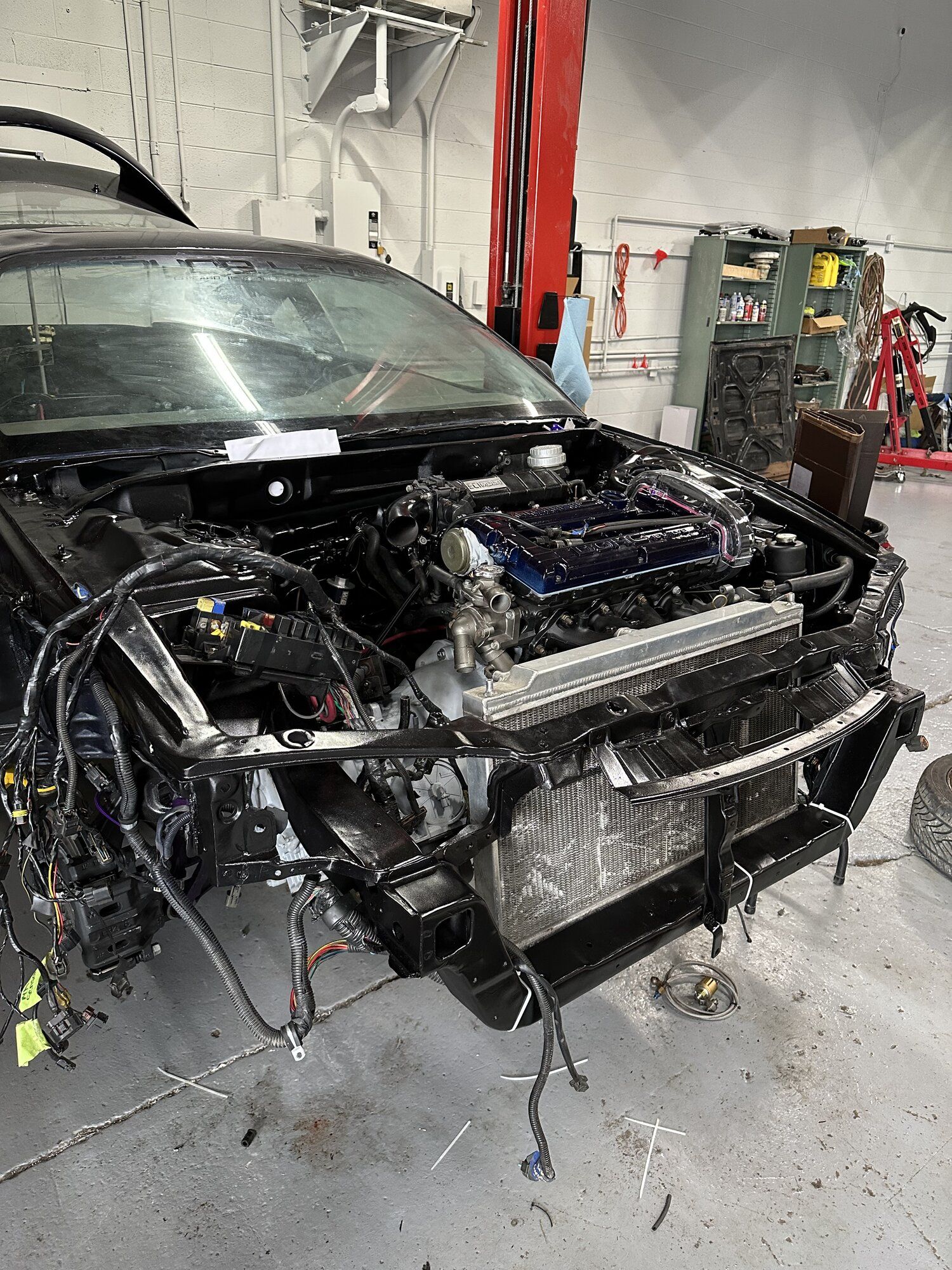

radiator fans good to go ✅
radiator and trans cooler should be in for good ✅

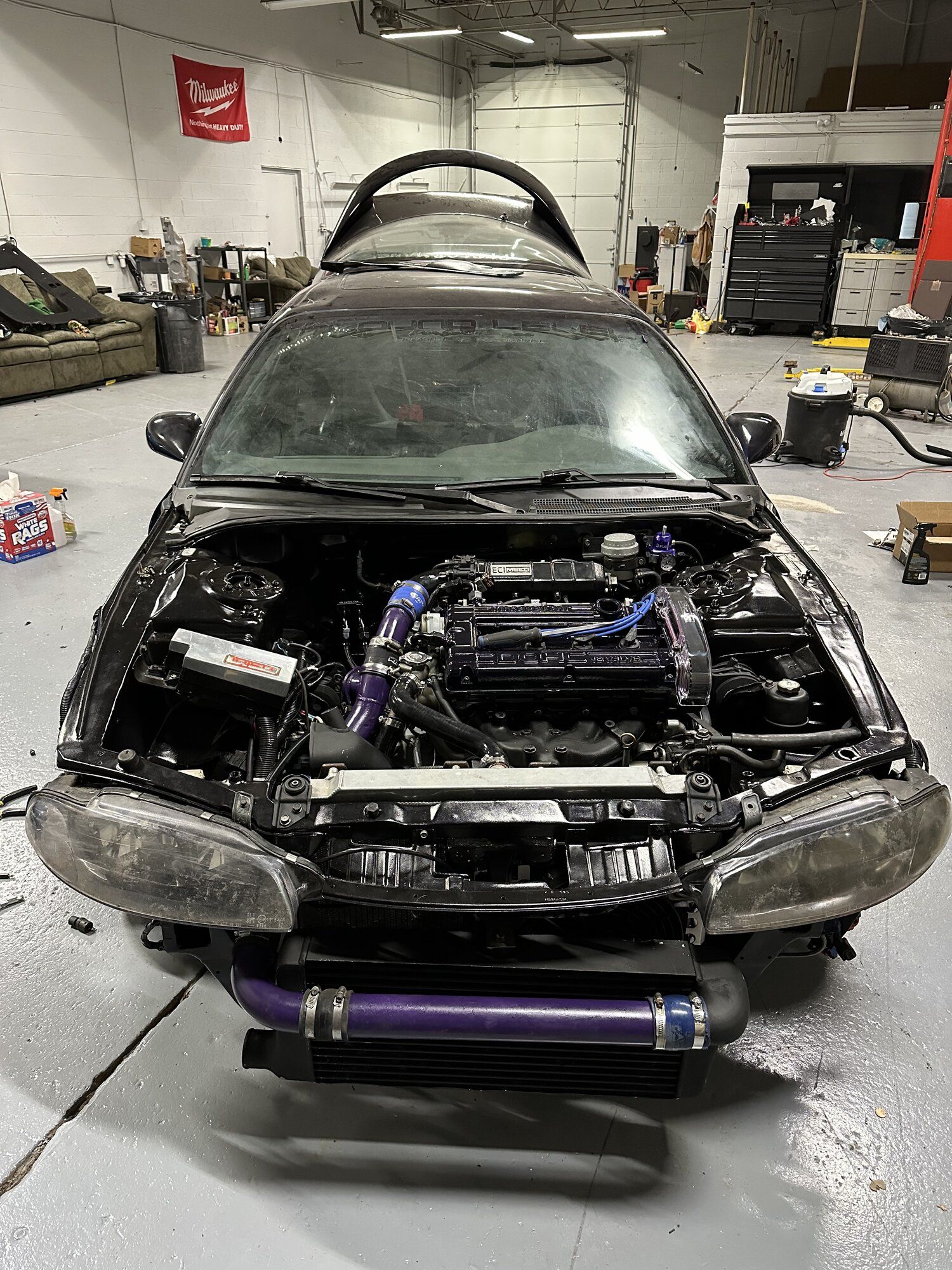

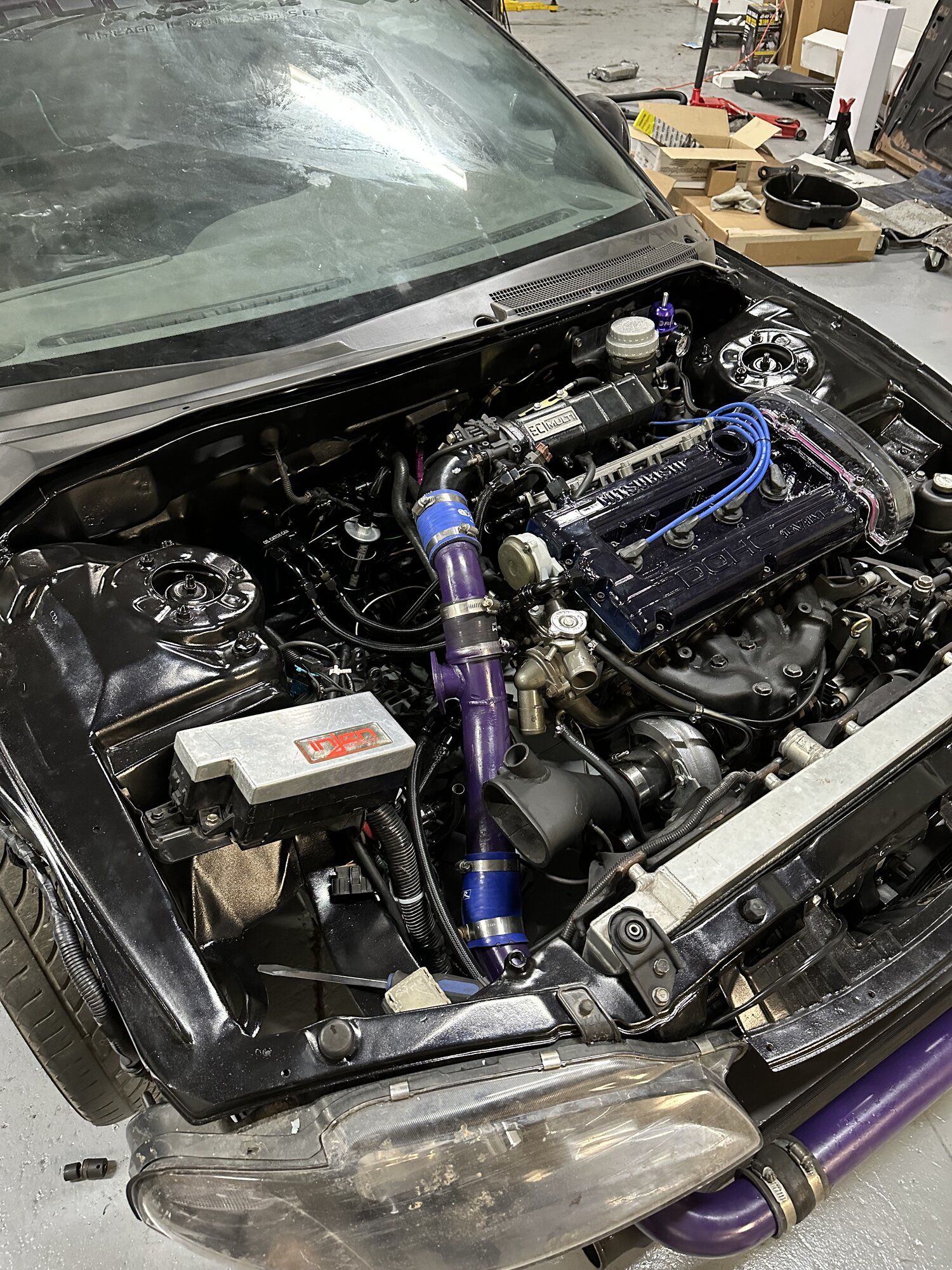

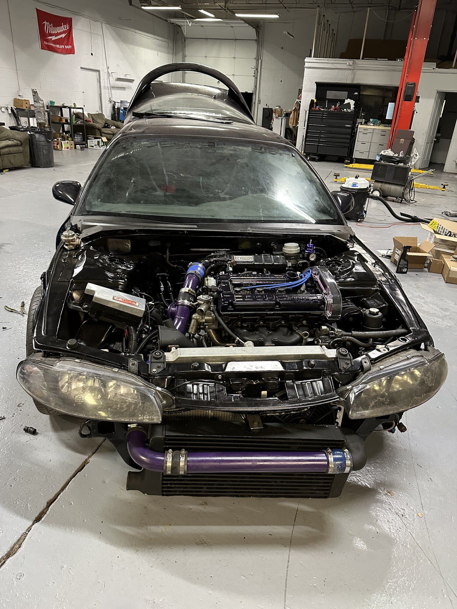

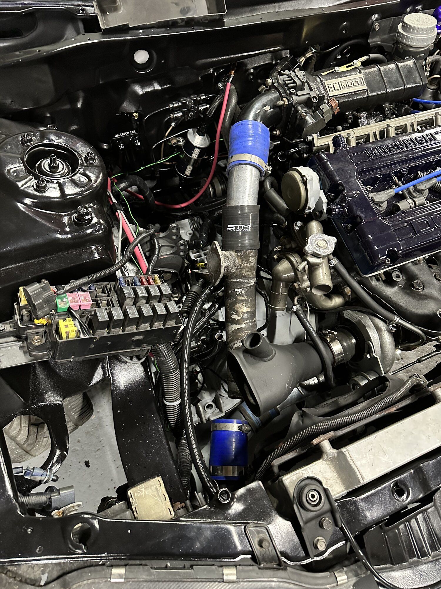

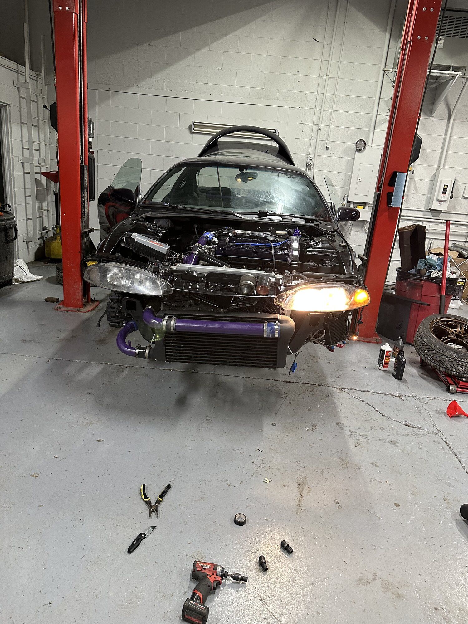

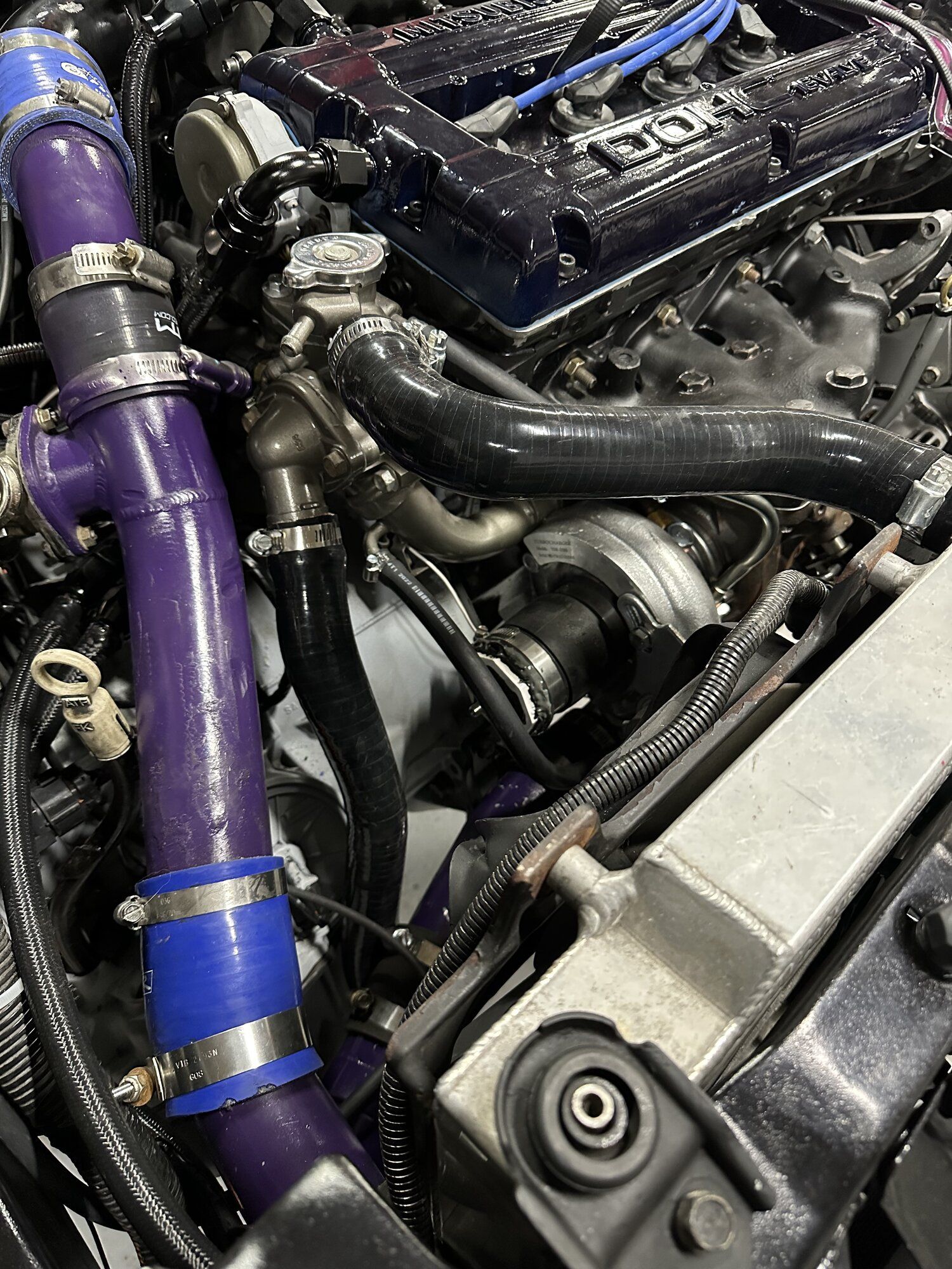

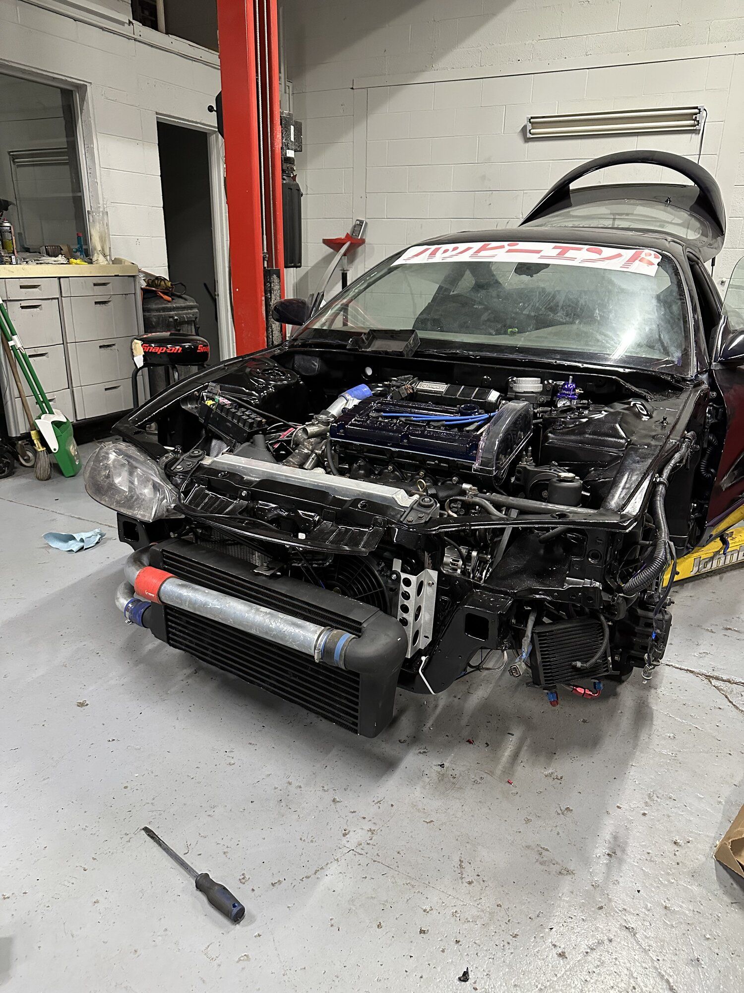

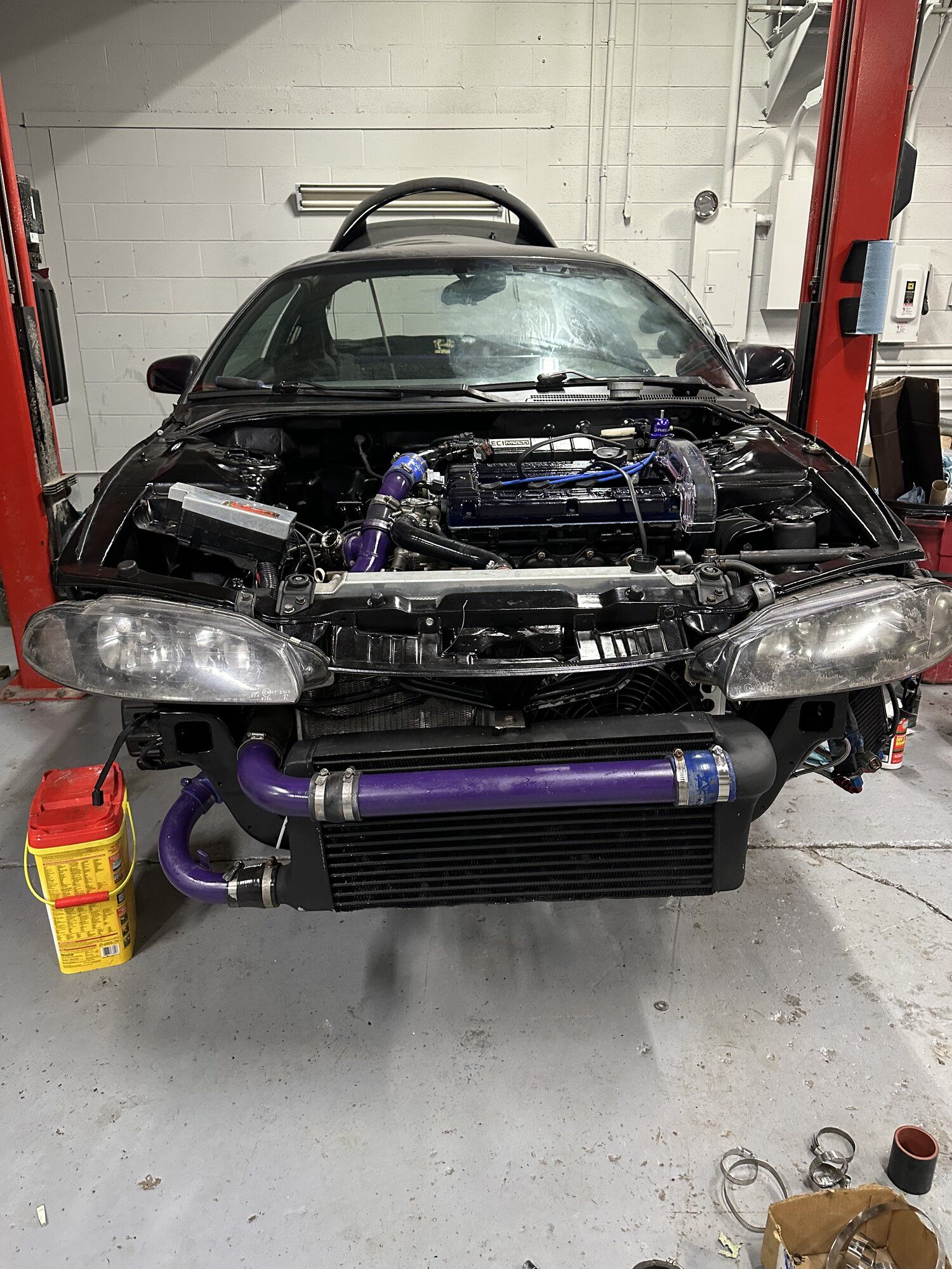

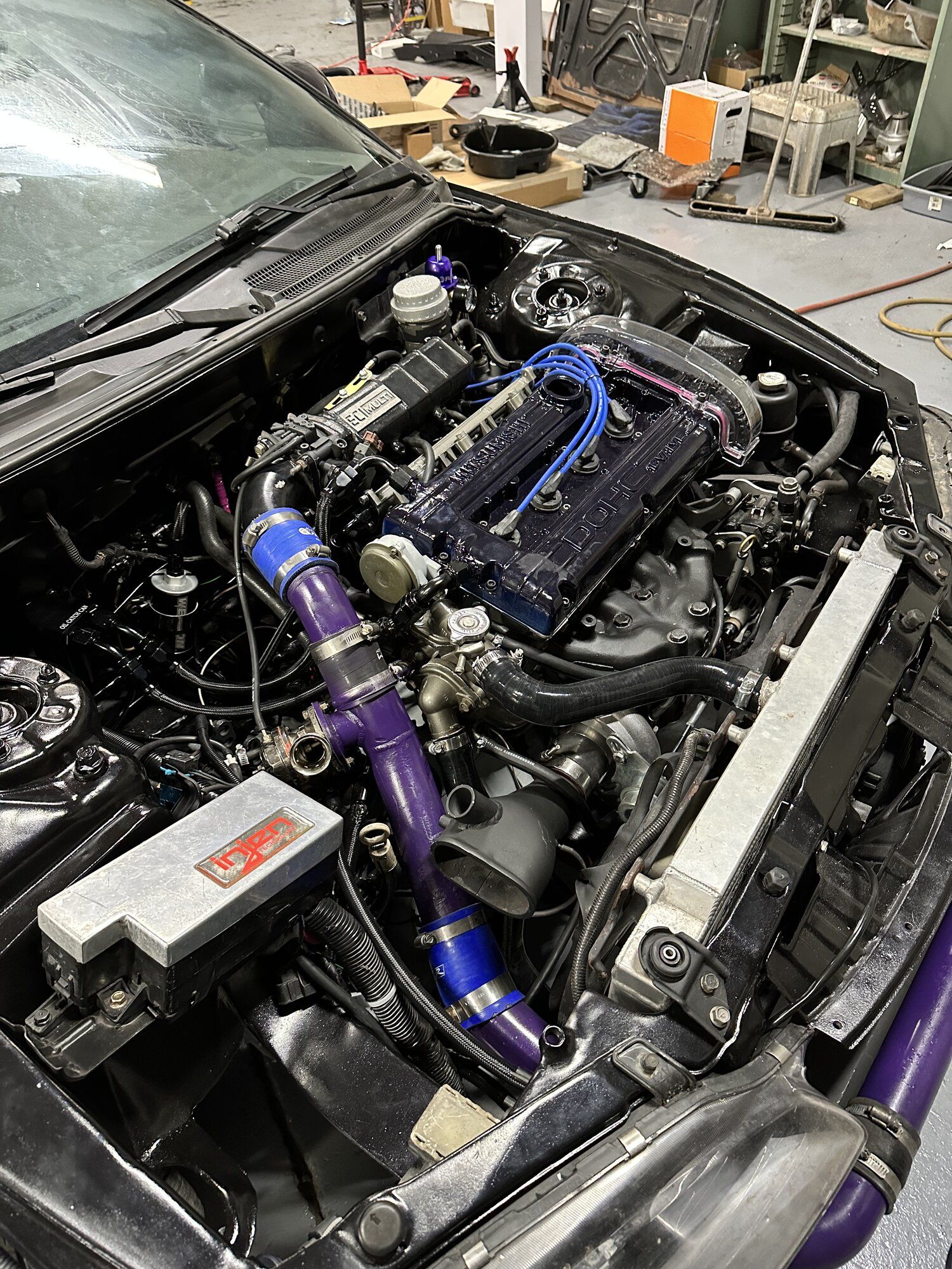

then got to fitting up intercooler piping. need some new couplers and one longer pipe otherwise everything worked out 🤟🏼

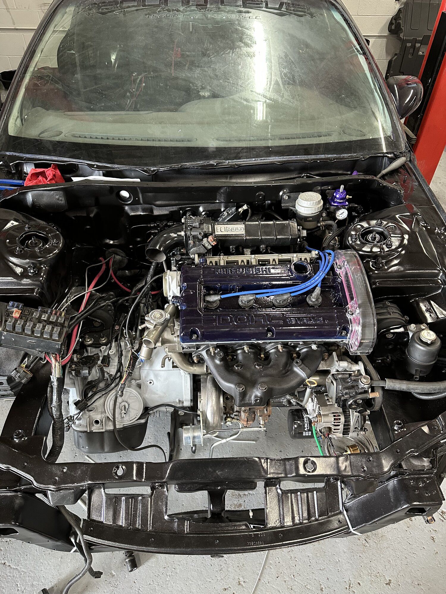

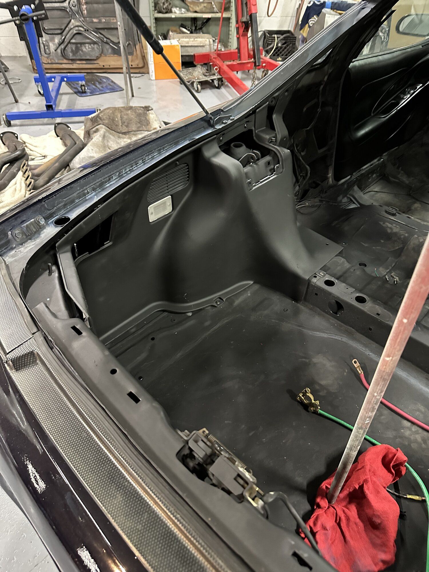

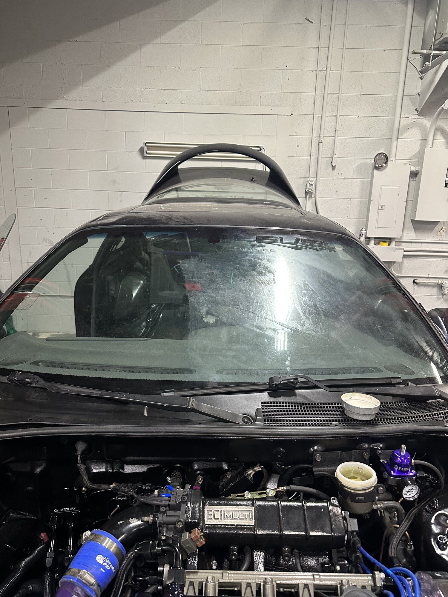

got the weather stripping in for the cowl definitely going to need a new one idk how this one got ripped up at the end but thats for later, silicone hoses came in already installed good to go. also got the bov installed and hooked up. interior is like 95% done, just need new hardware for it all.

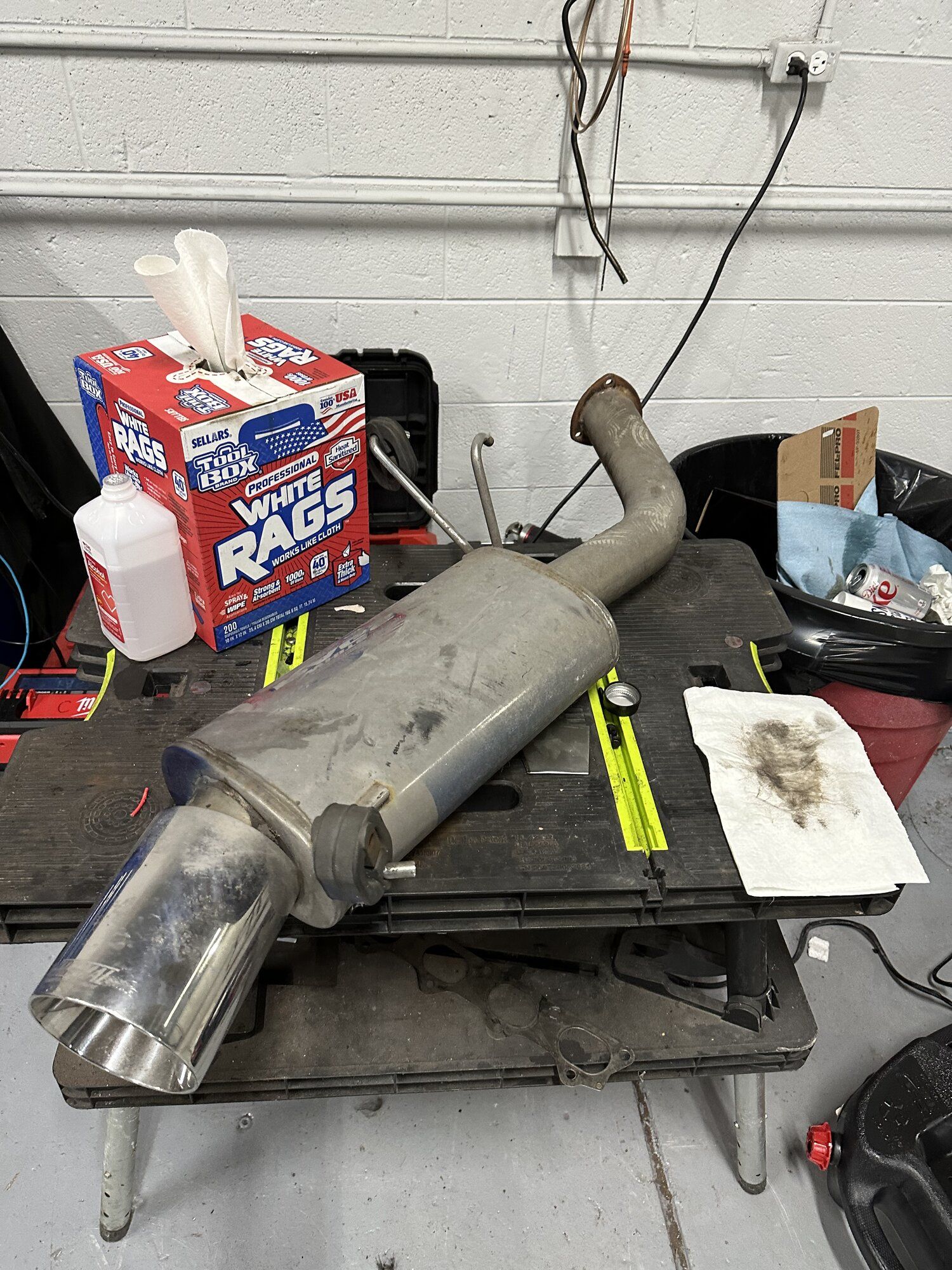

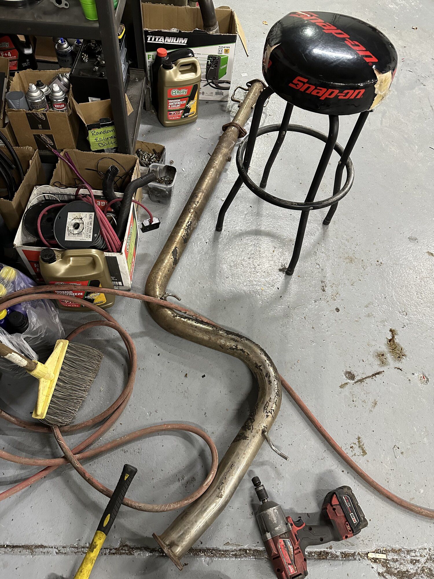

in the process of cleaning up the exhaust
got all the intercooler pipes ran, went to go boost leak test and the tester was leaking im gotta make a new one

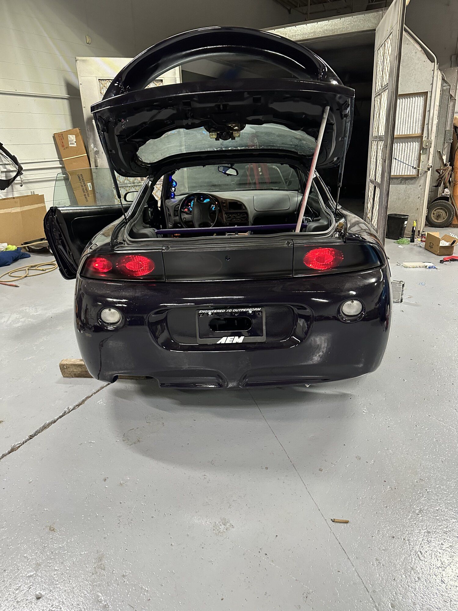

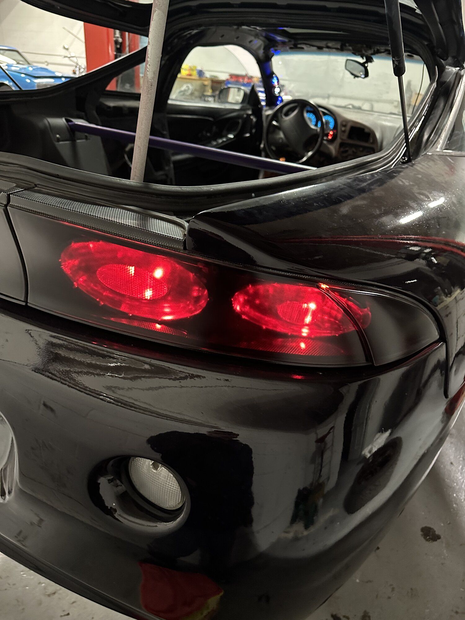

fixed the tail light socket problem

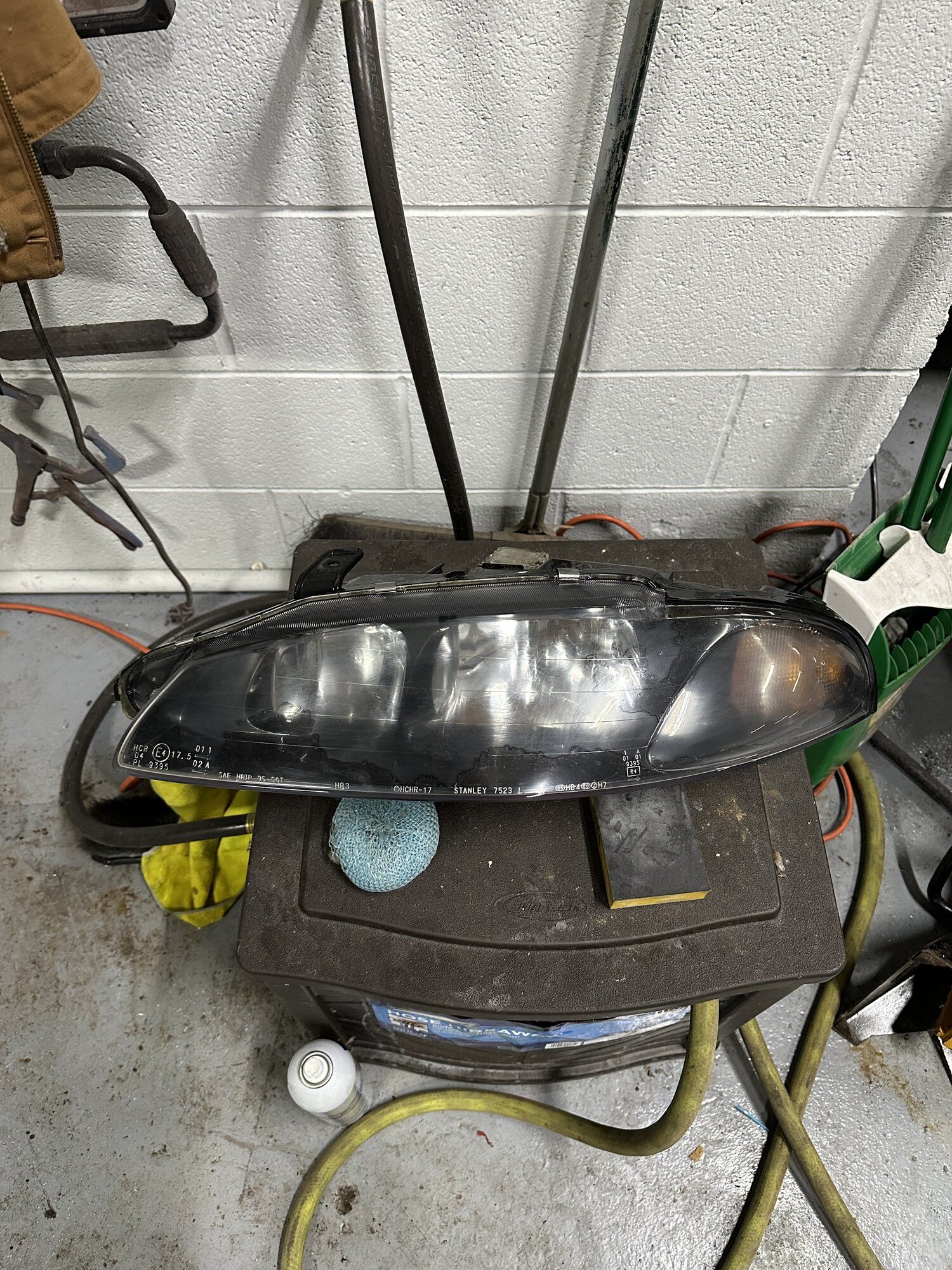

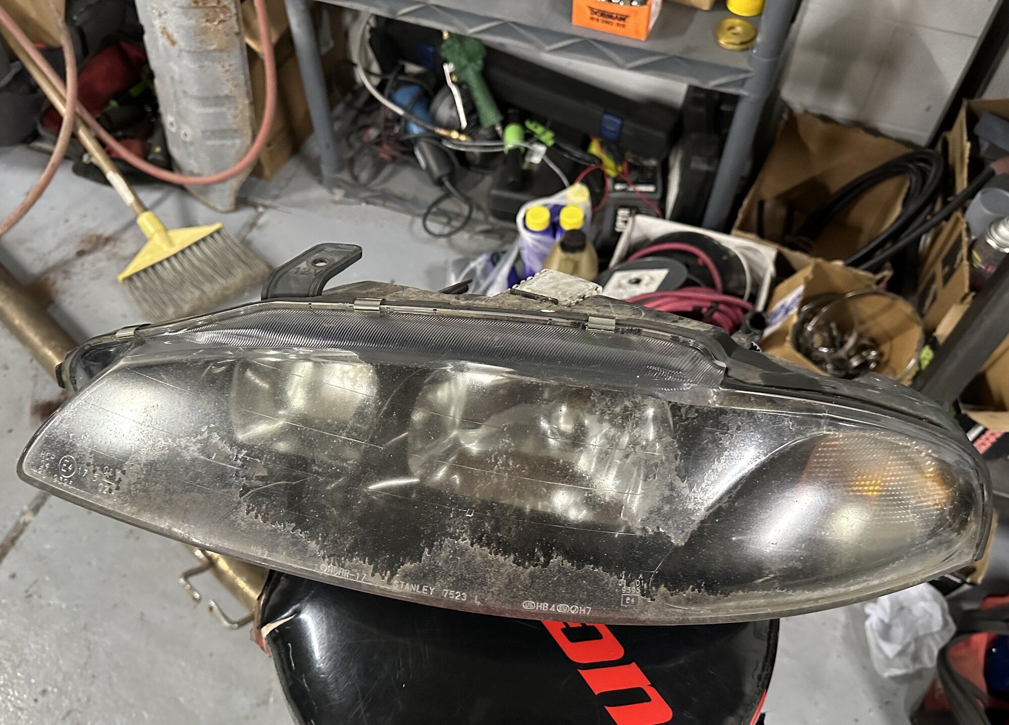

headlights look like shit but work again missing bulbs for one side, decided to just quick sand and clear for the time being.

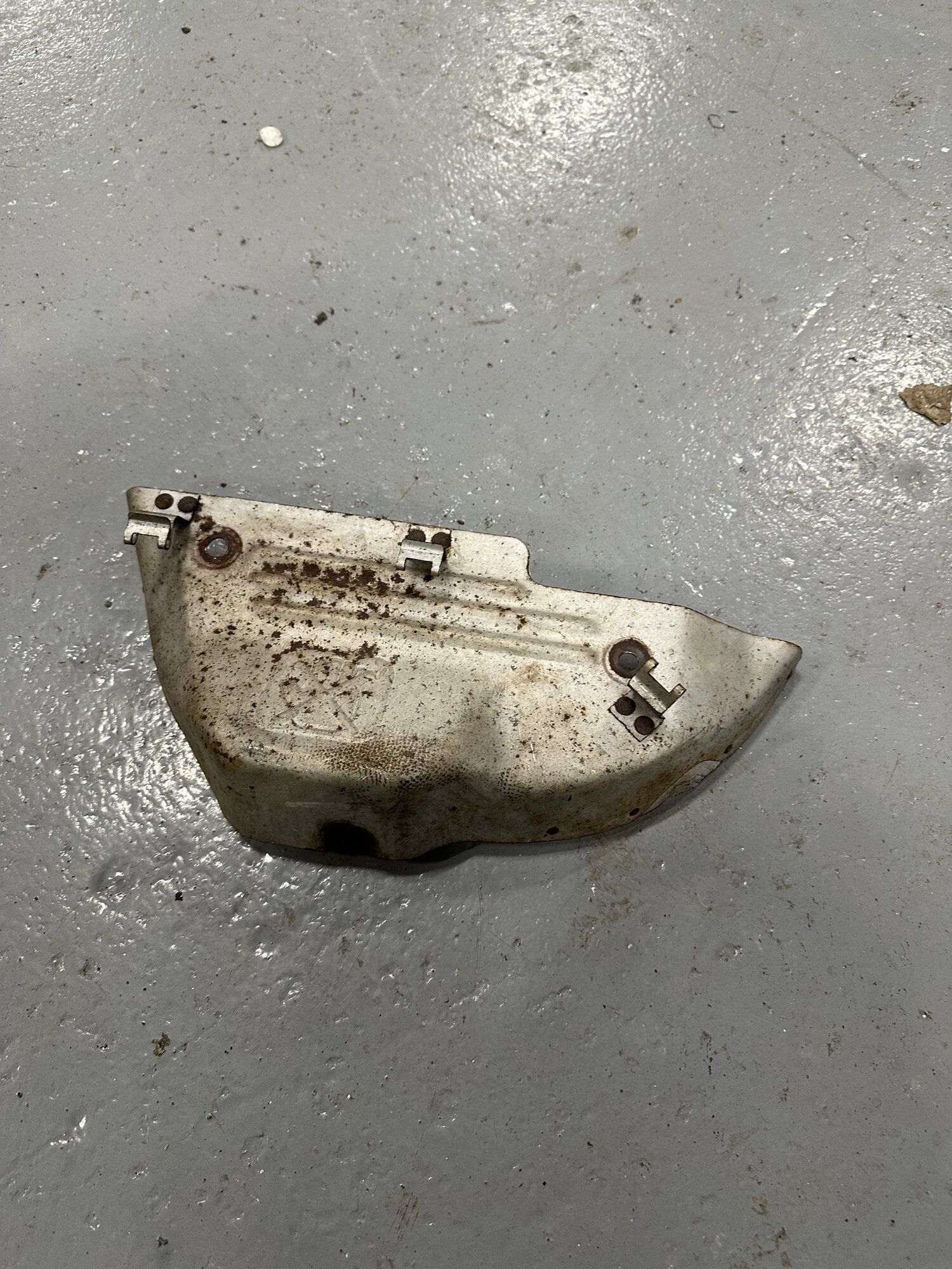

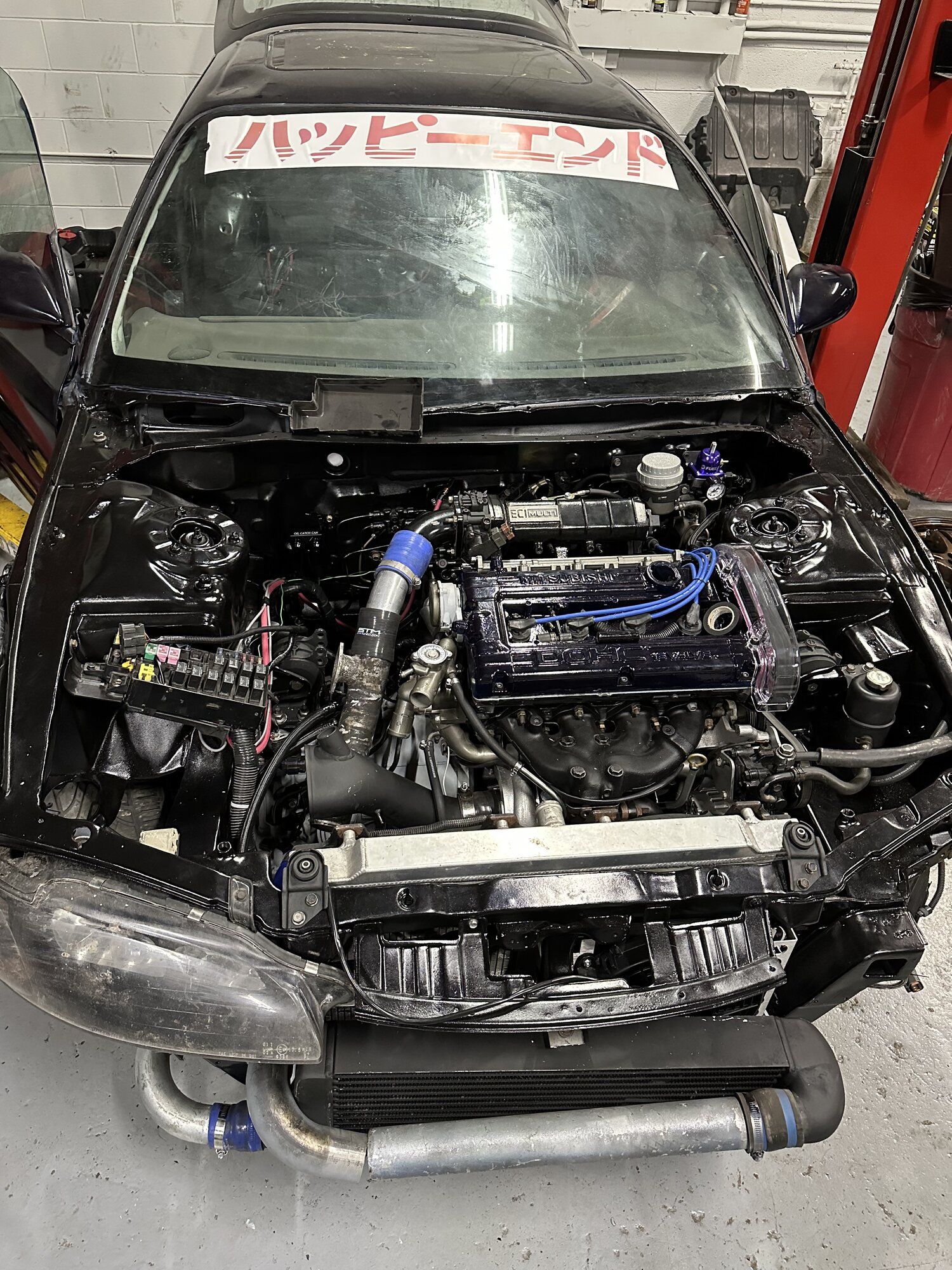

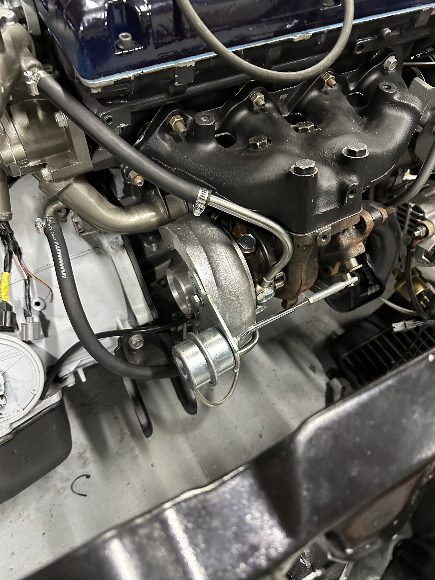

oem exhaust manifold getting shot matt black then installed
started cleaning up all the windows so i can finally see and put my new stickers on.

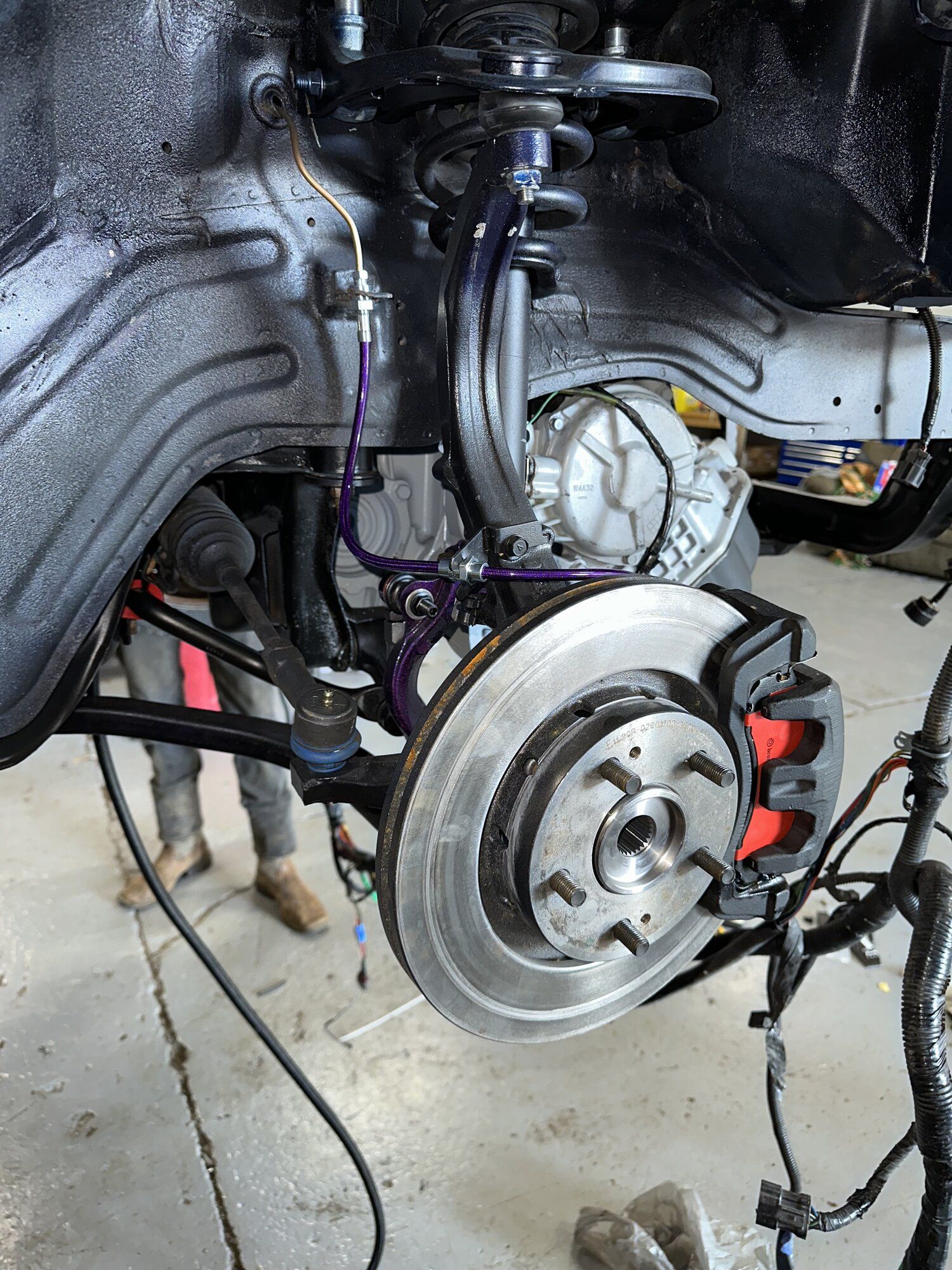

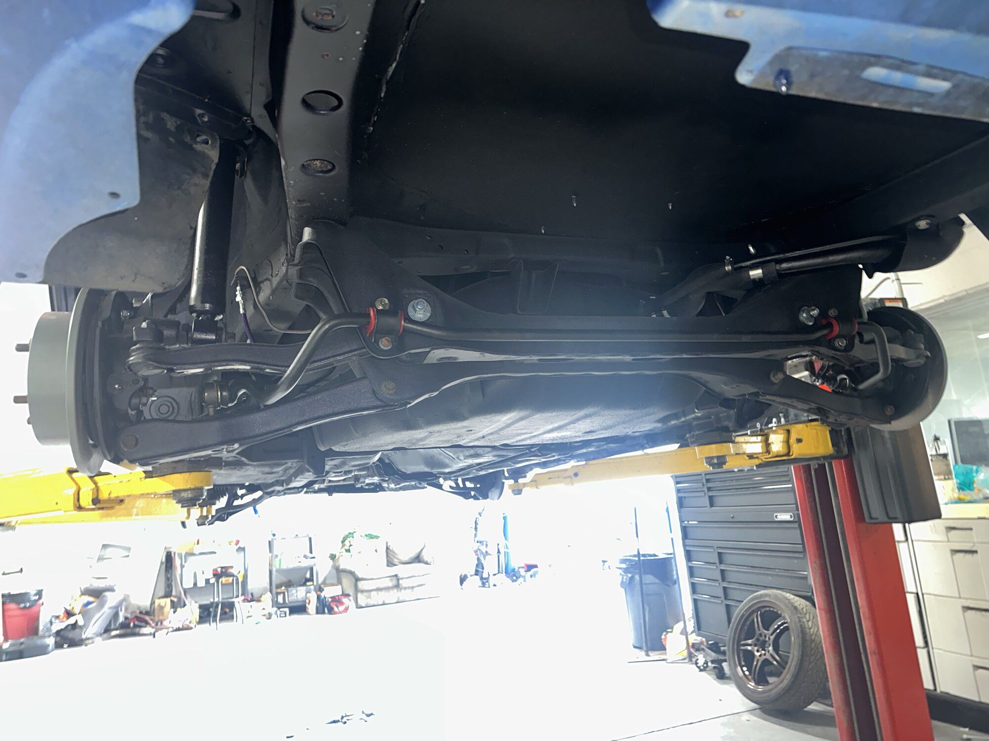

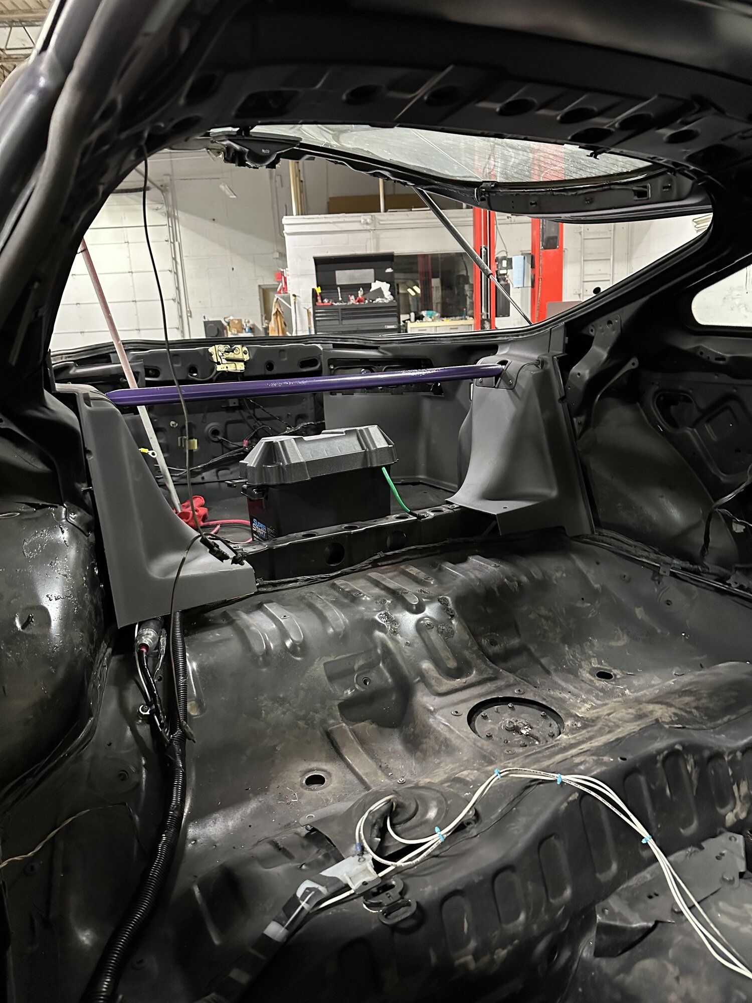

rear sway bar and links installed

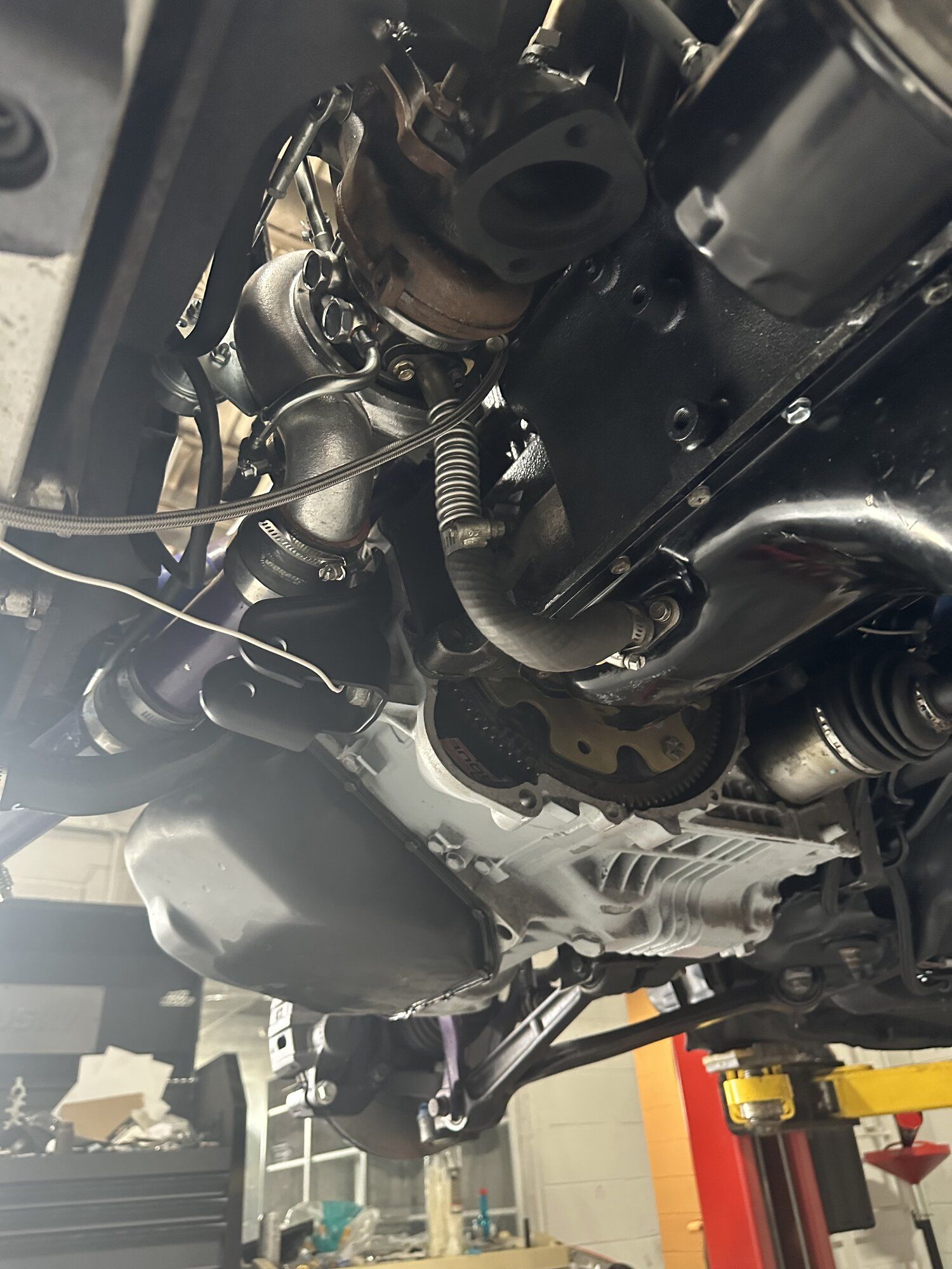

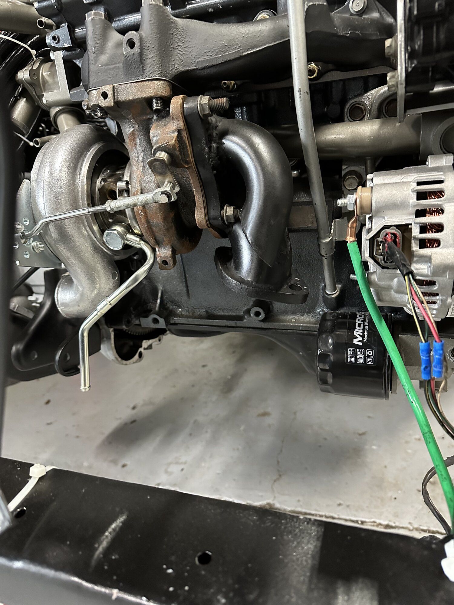

turbo oil drain finally put back on should be able to fill it with oil now 🤟🏼
