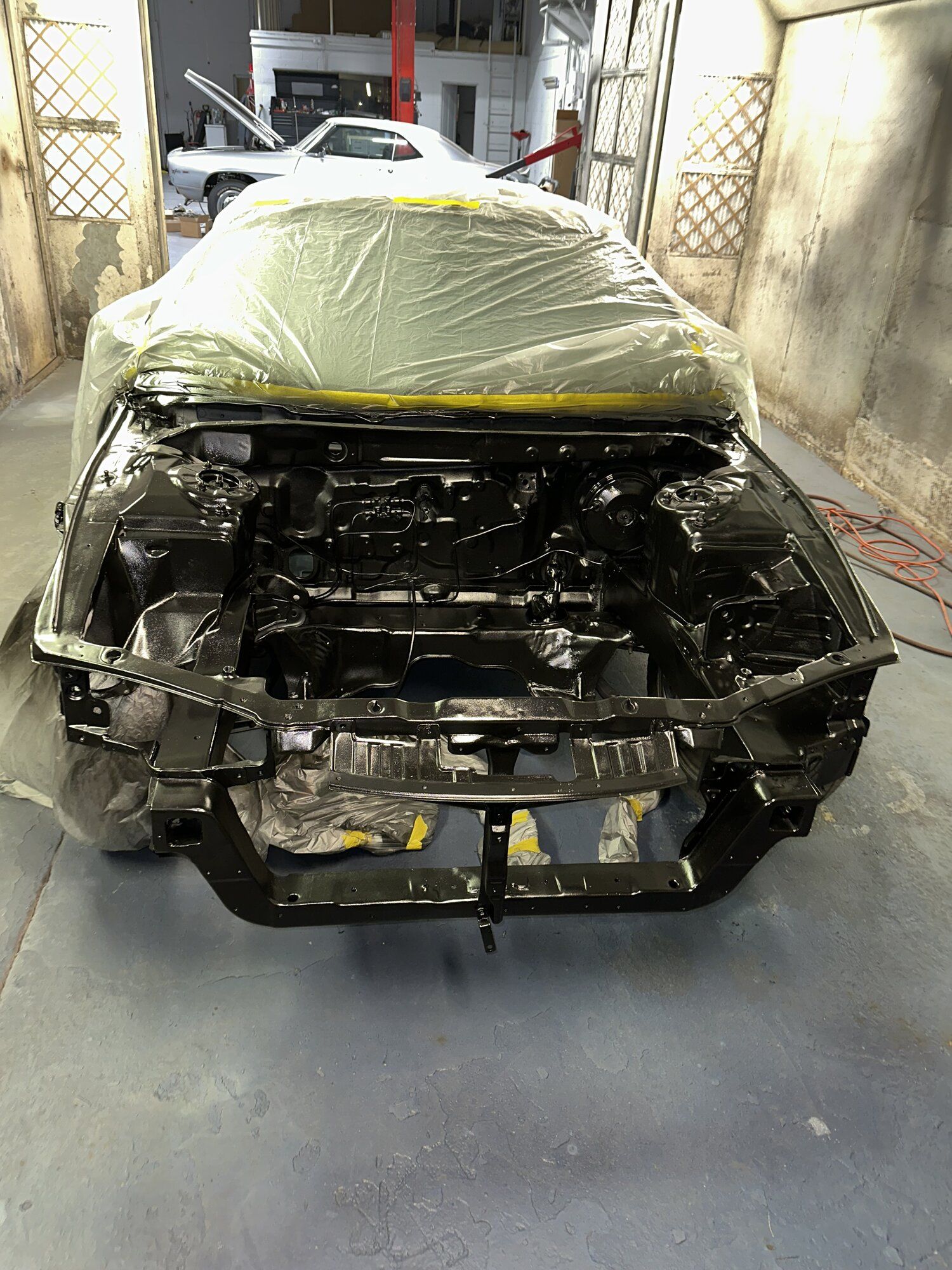

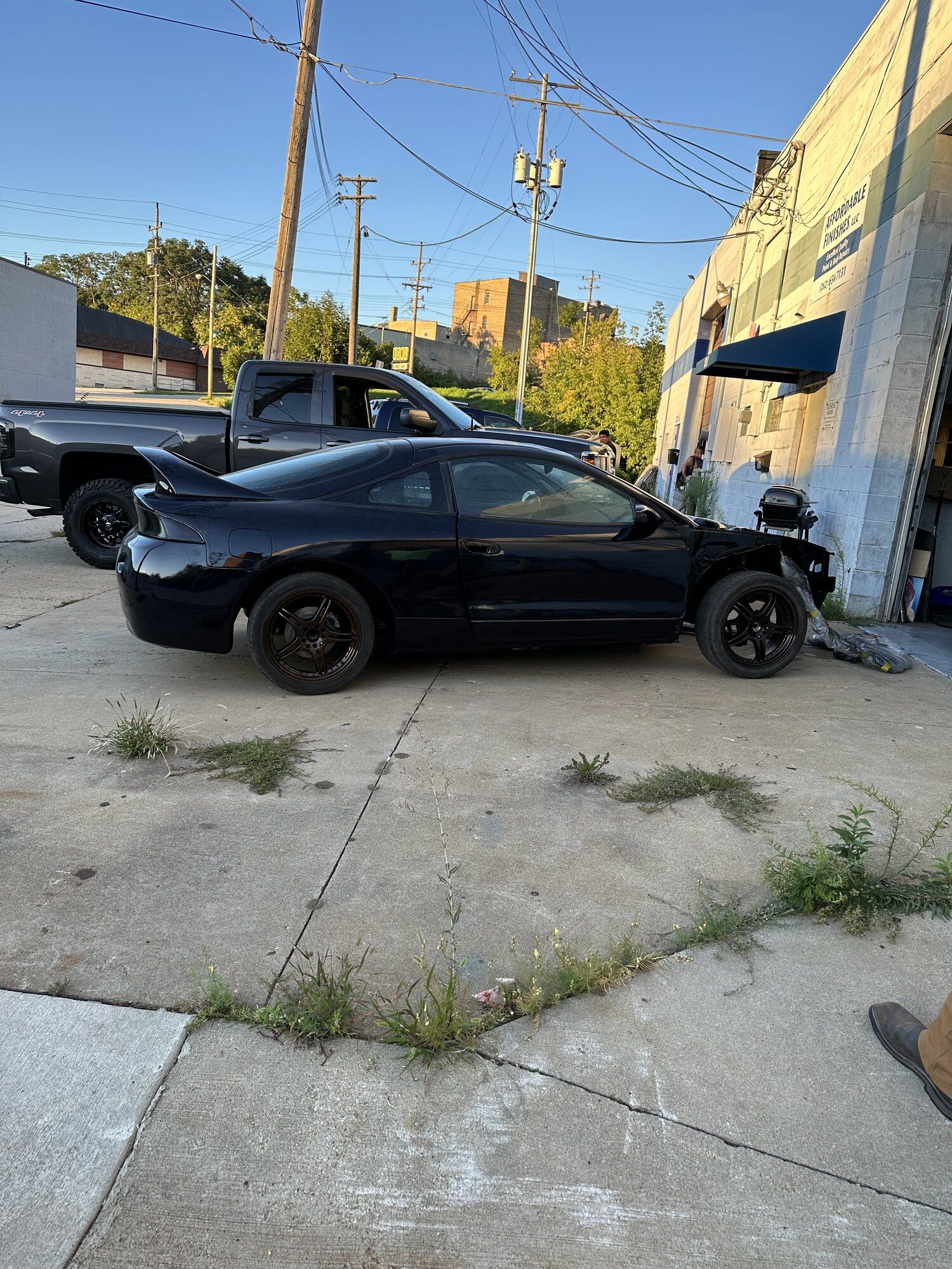

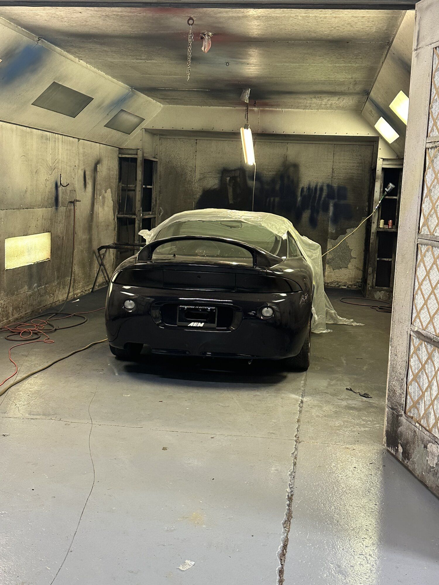

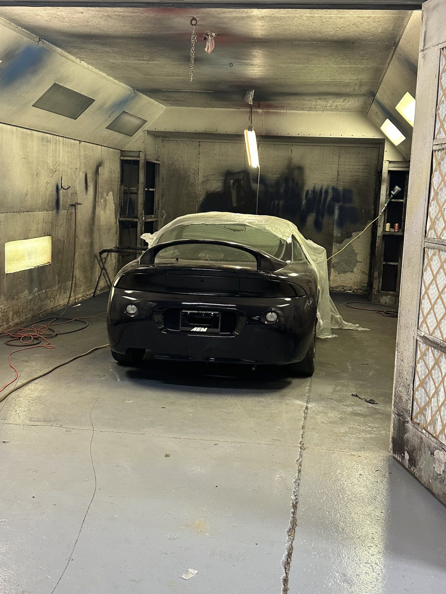

Got it - Thought it was some kind of purple. The last trip through the booth, the paint in the pics looks super dark. I wonderd if you had changed your mind.

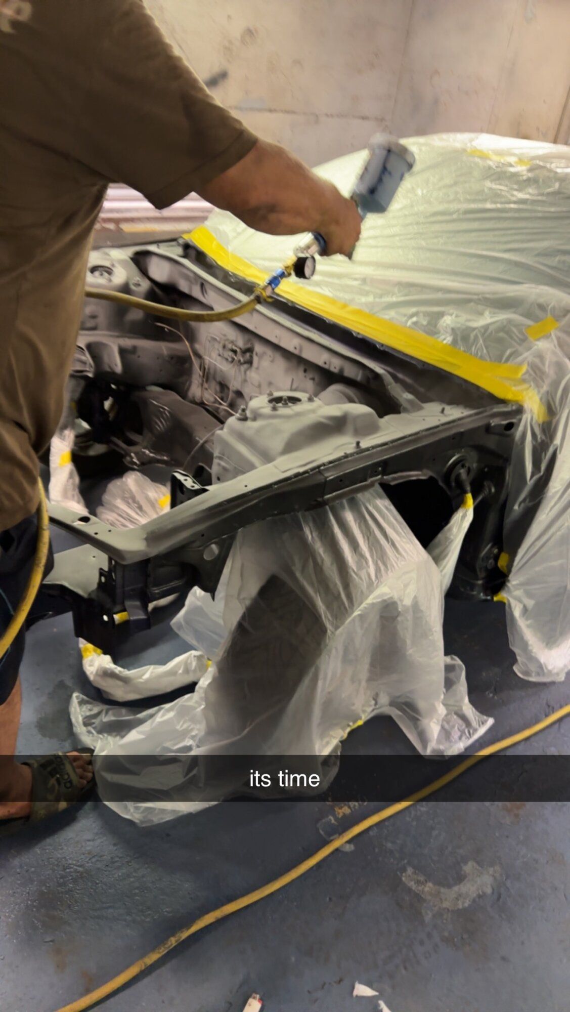

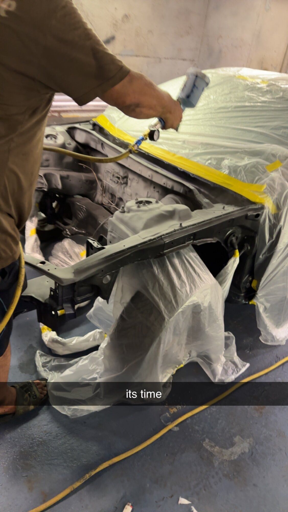

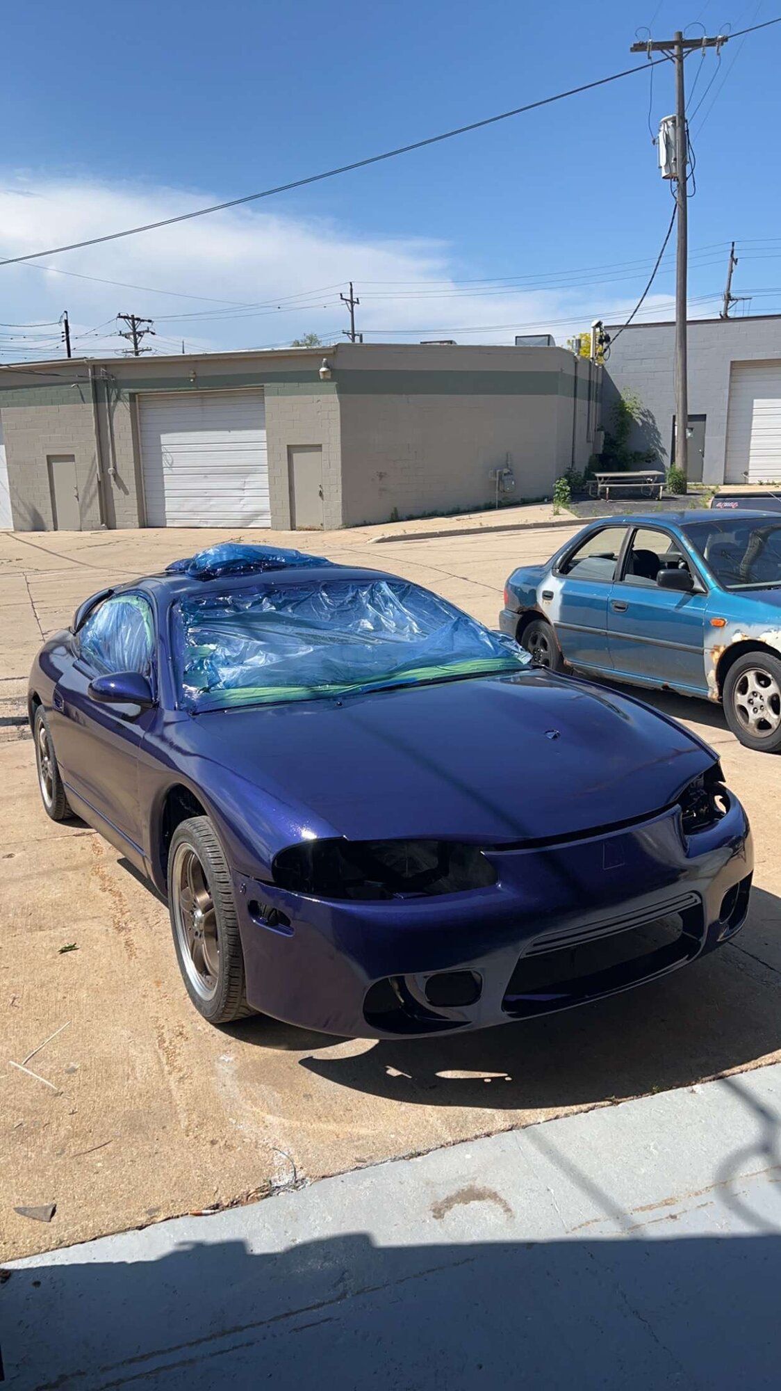

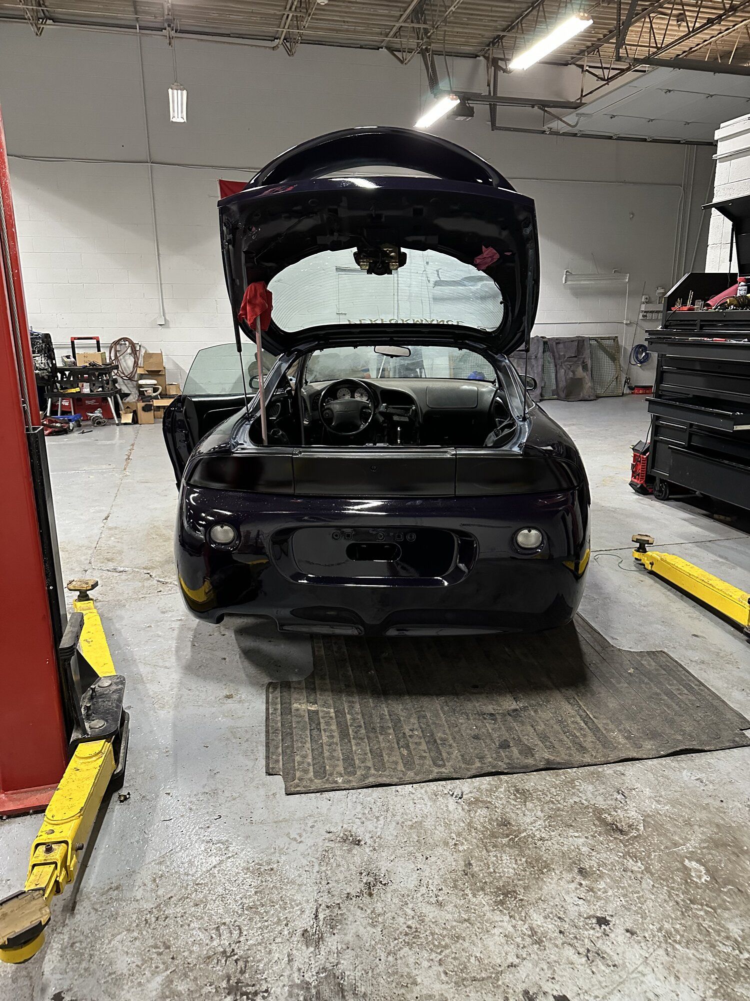

yeah no i didnt change my mind the pictures your about to see are from the same gallon of paint, just 2 different painters and how they did there mixing and coats.

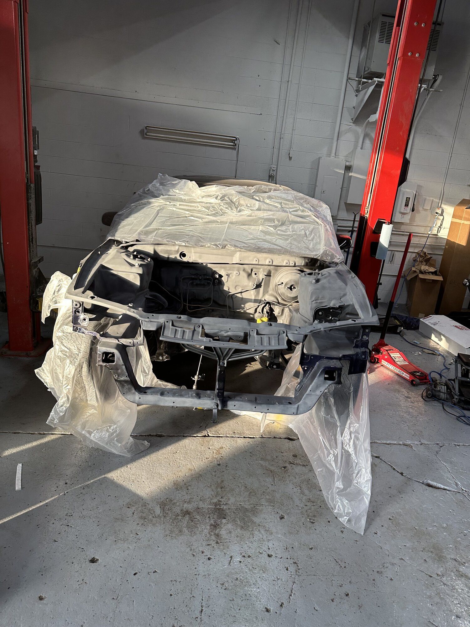

now the first guy kept bailing on me after we shot it the first time, and thats the first picture i have tagged here, the light purple. i love the look of that.
but since he keep bailing, i either had to shoot it myself or find someone who wouldnt mind helping out, good thing i got great friends, a buddy came over and shot it friday night. thats his paint job the really dark purple. i like both im totally fine with how it turned out but if i did it again id have stayed with the first color.

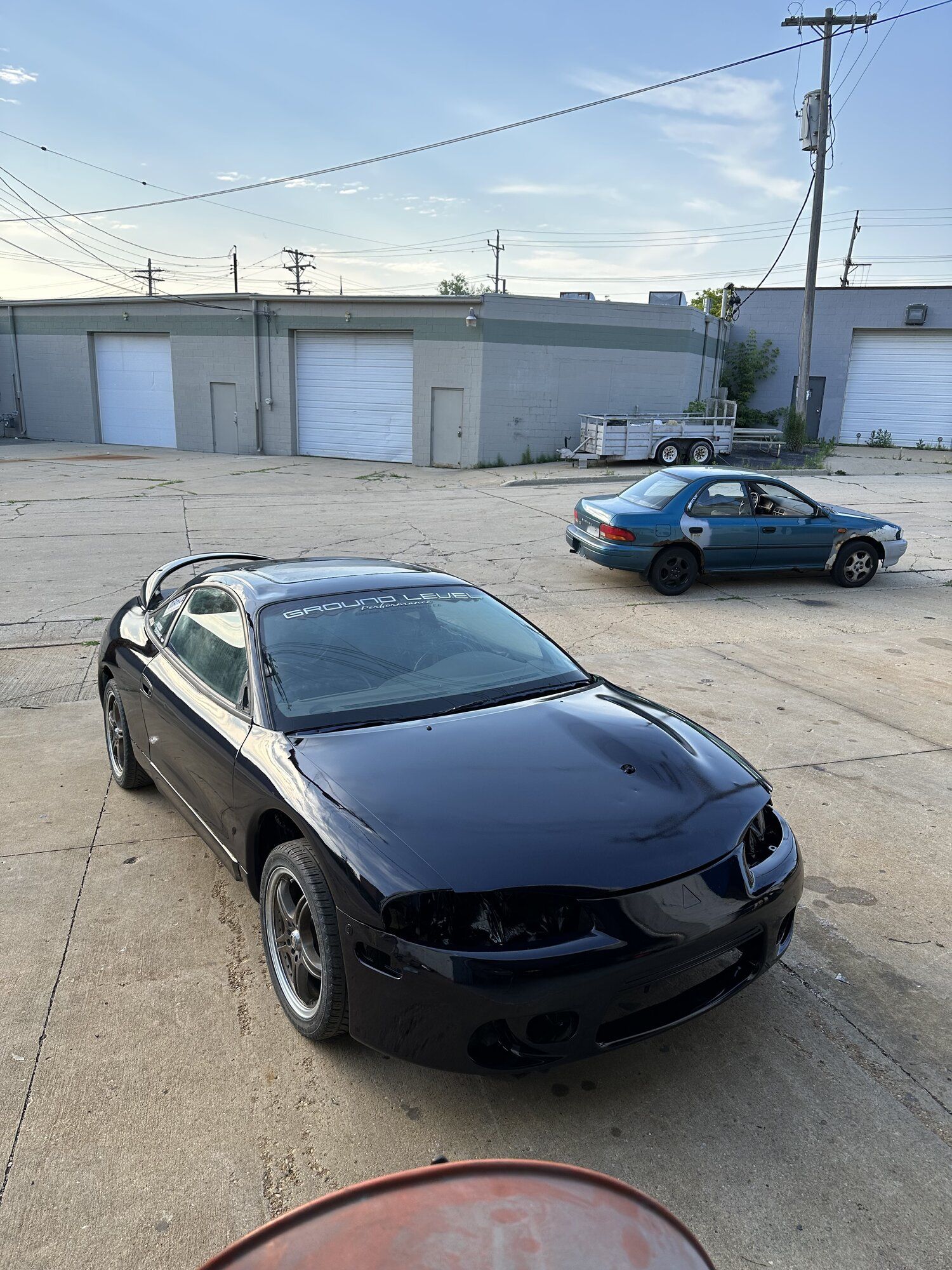

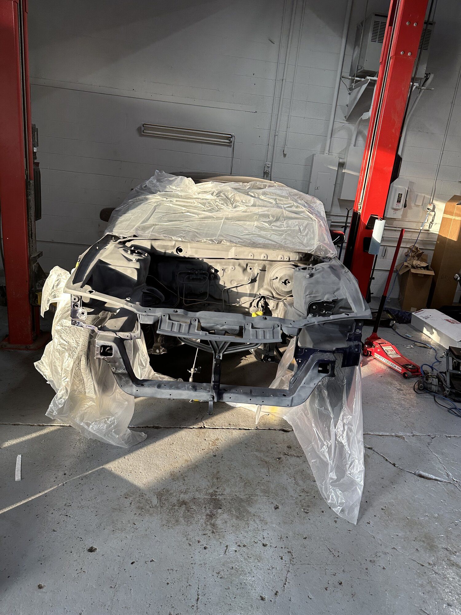

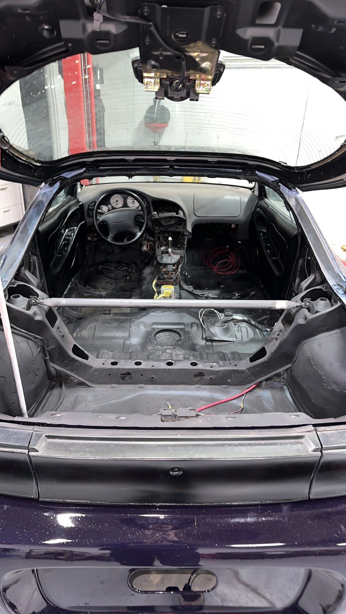

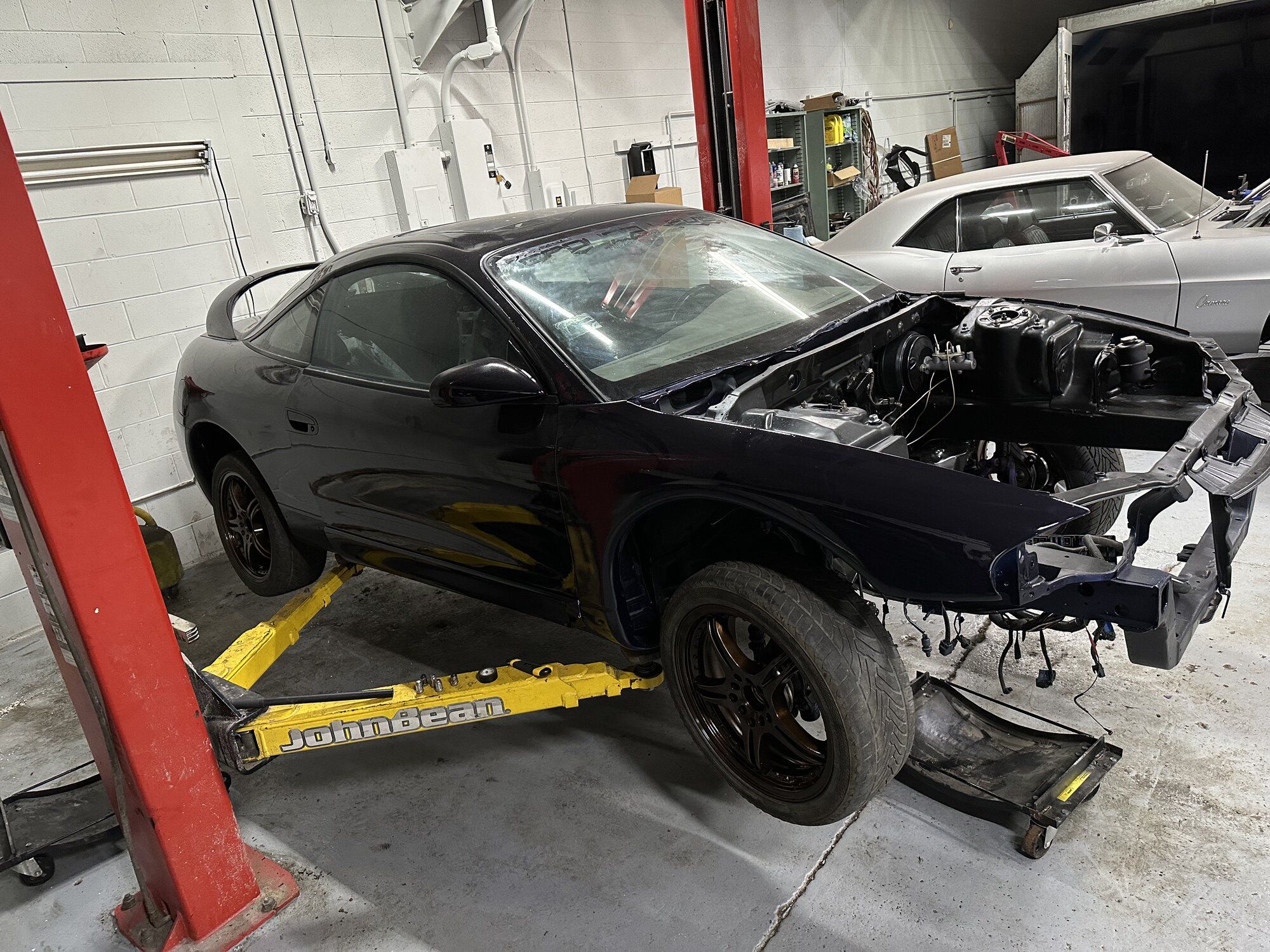

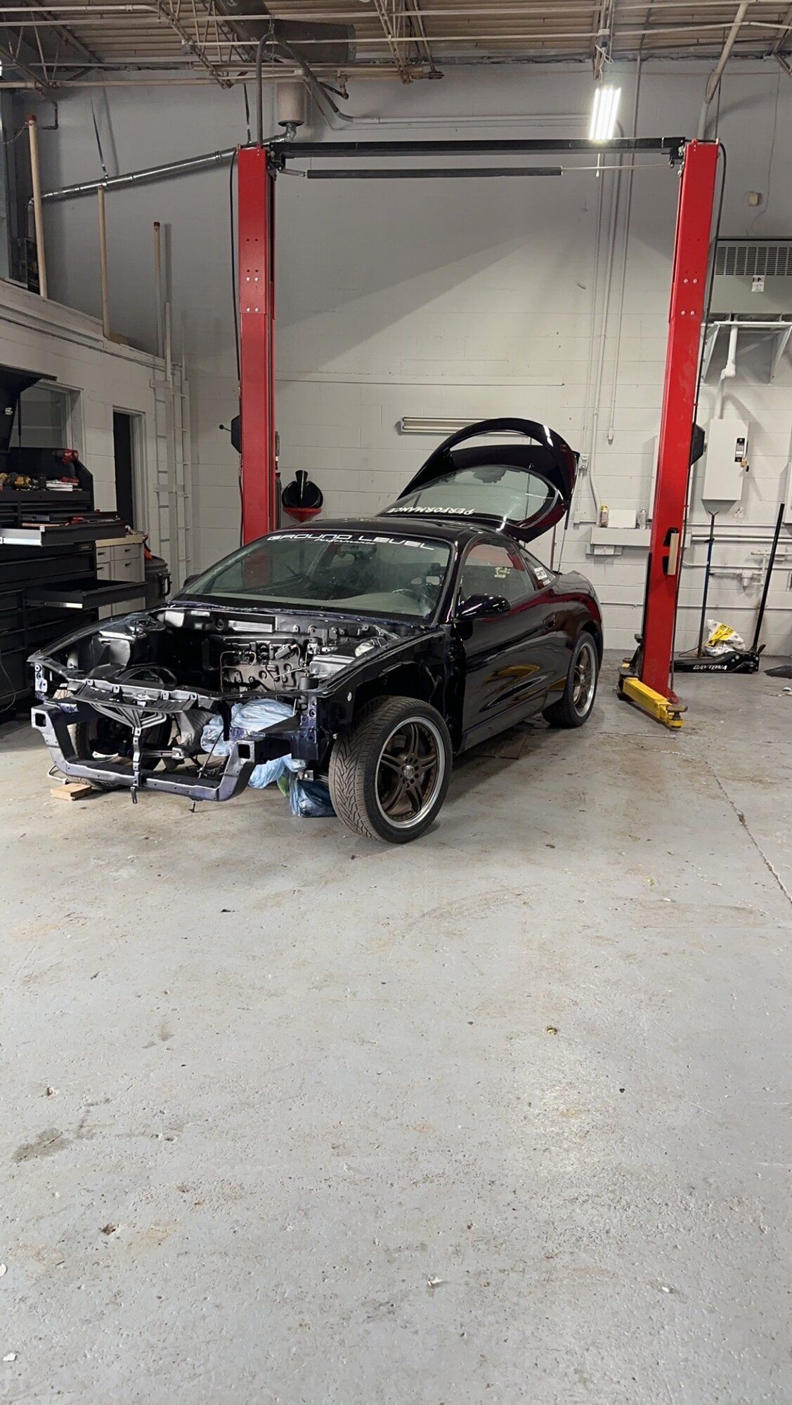

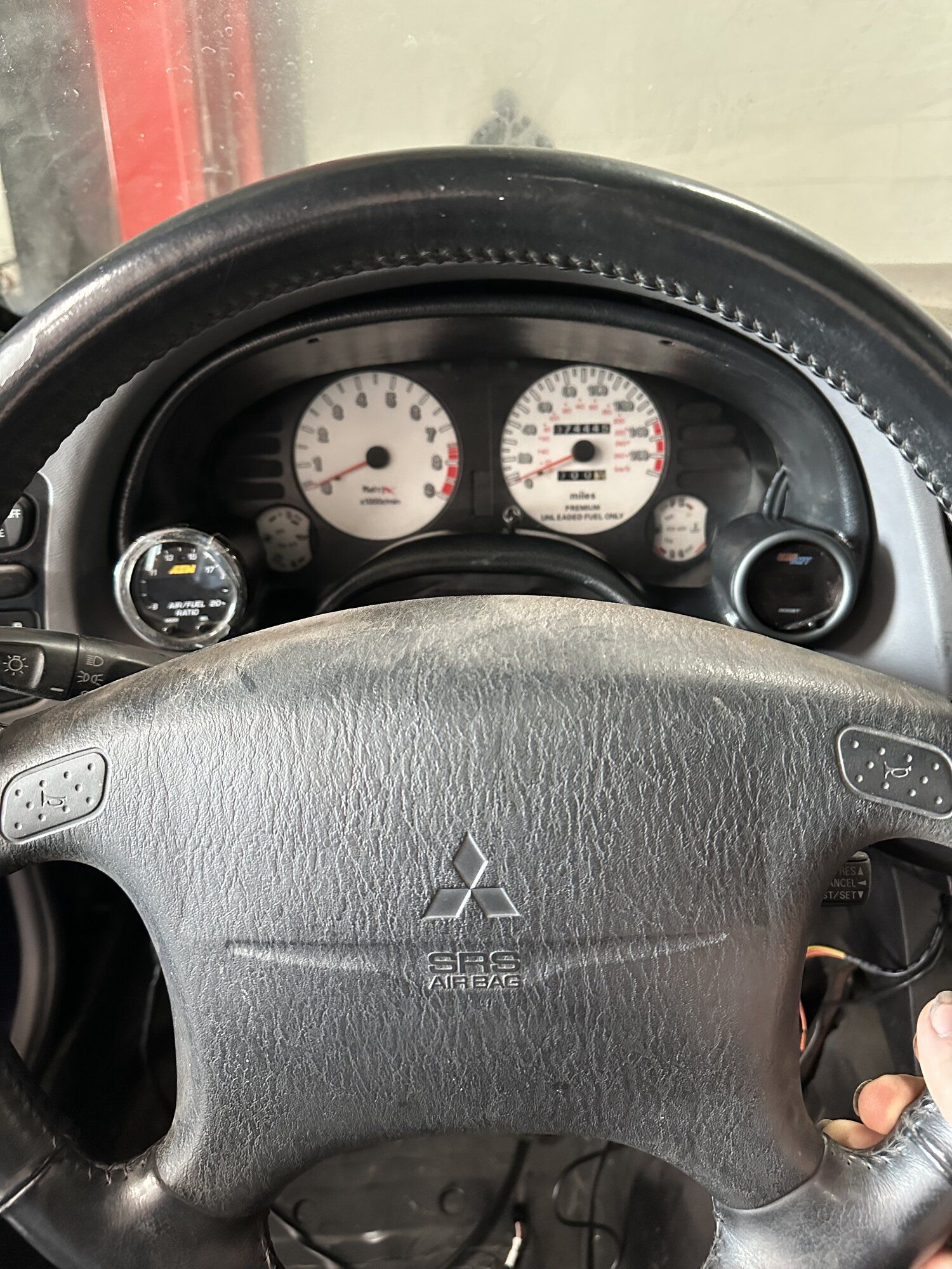

My first DSM build. 1998 GS-T. I call it Mouse Trap GS-T as the mouse ate all my wiring and seats and carpet. They made nest in the dash and smelled terrible. This is a before and now pictures. I have more of the build if people are interested on my journey. I have had the car a year and a half now was not running. Also did a manual swap in the process.

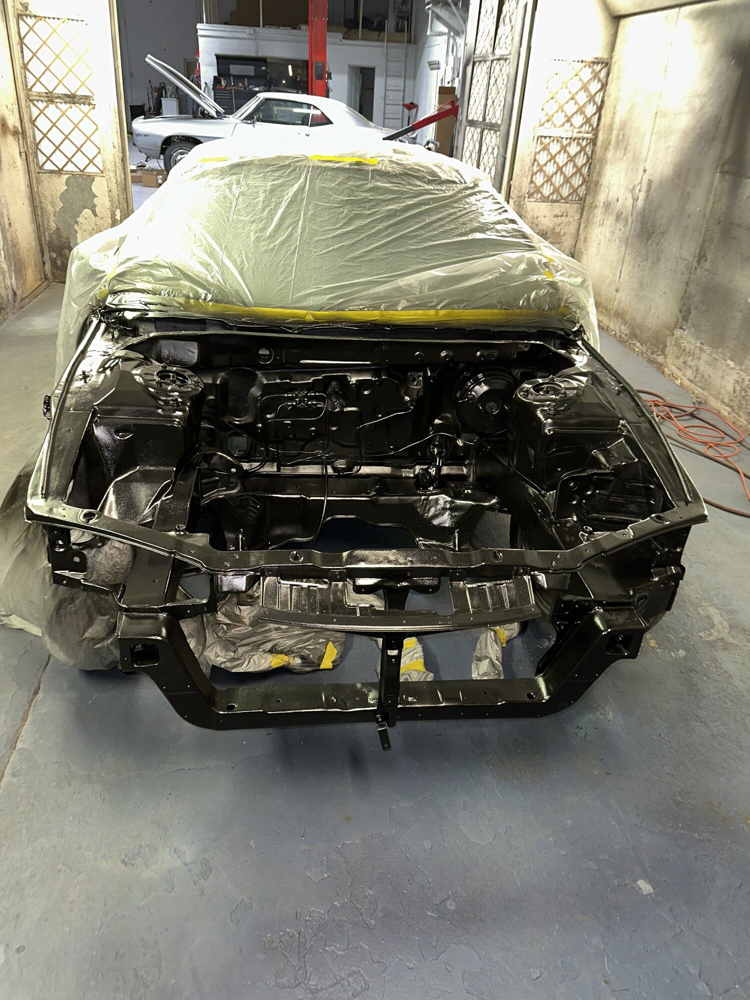

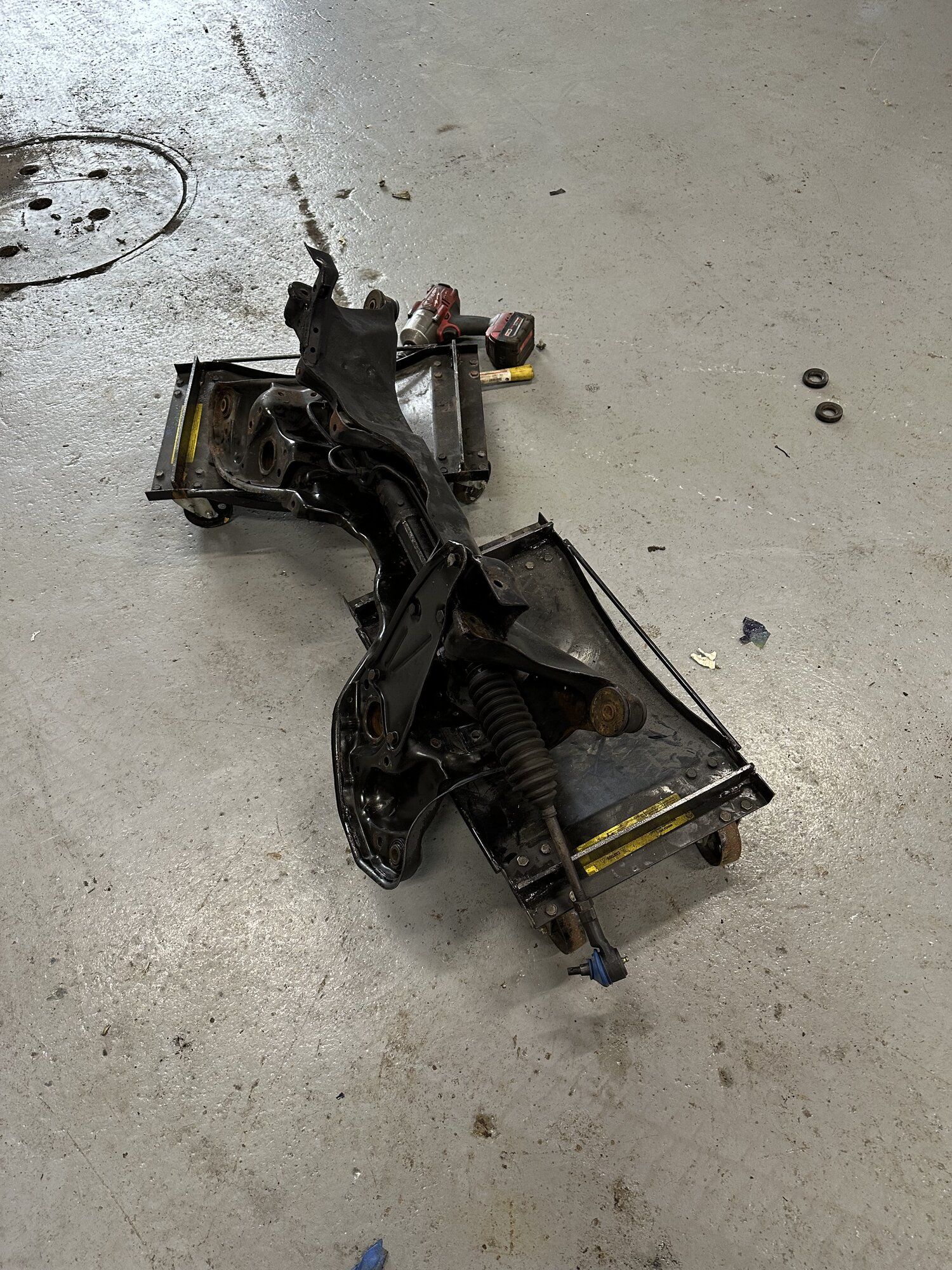

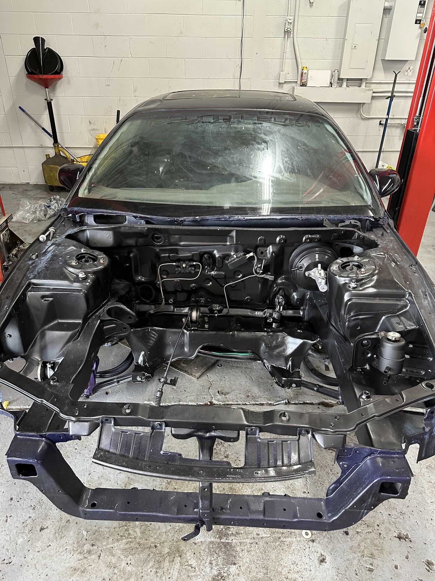

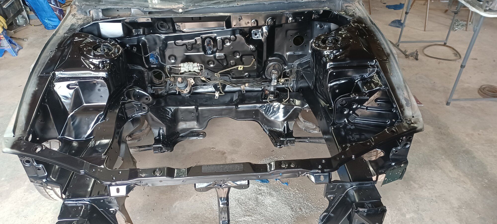

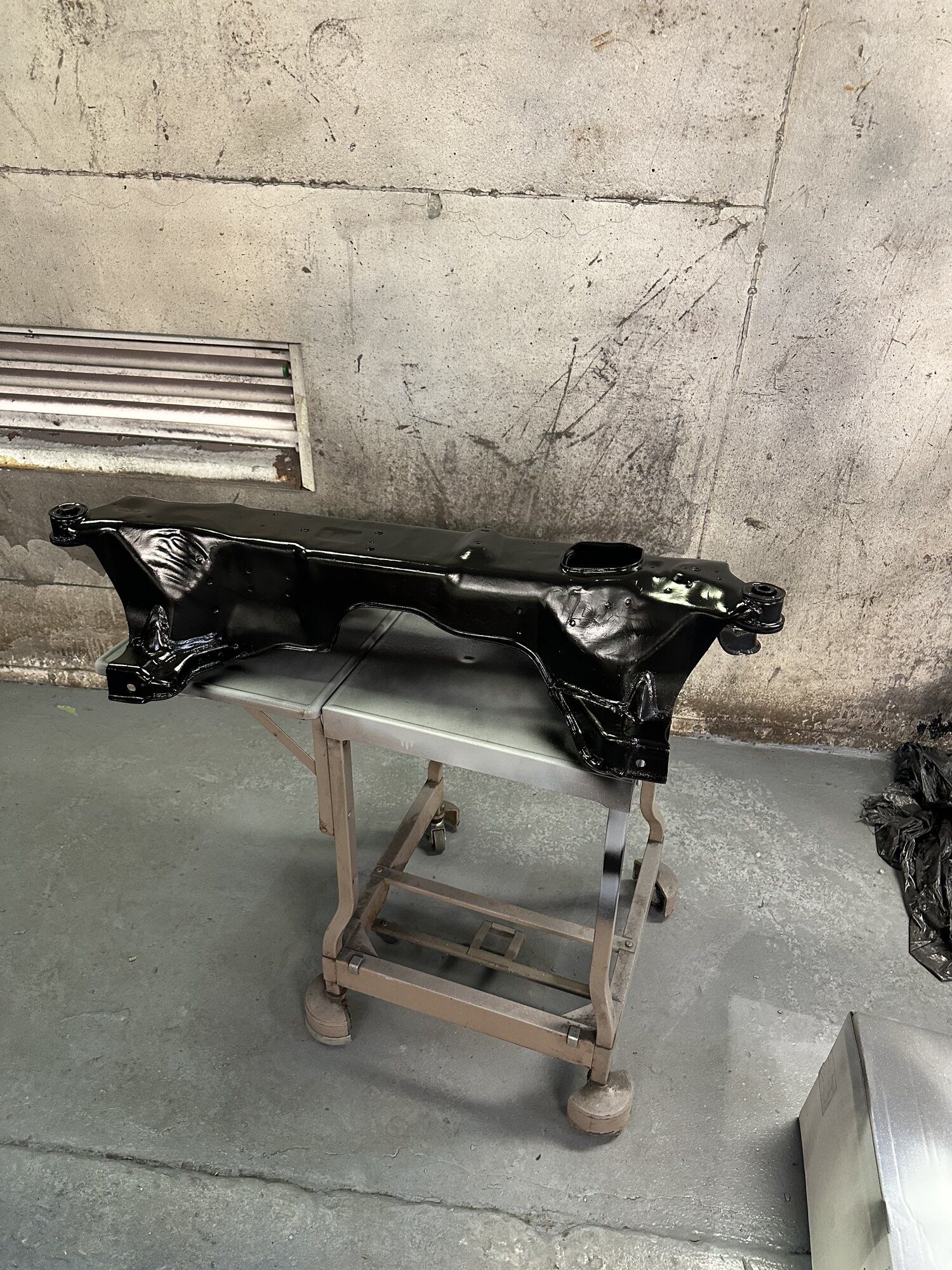

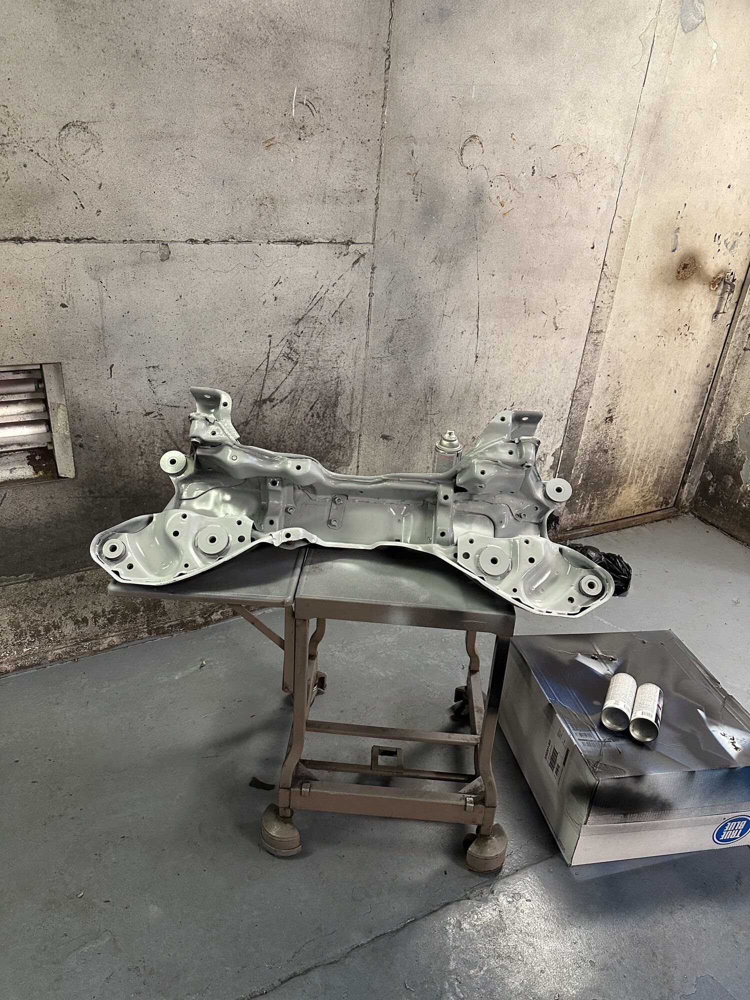

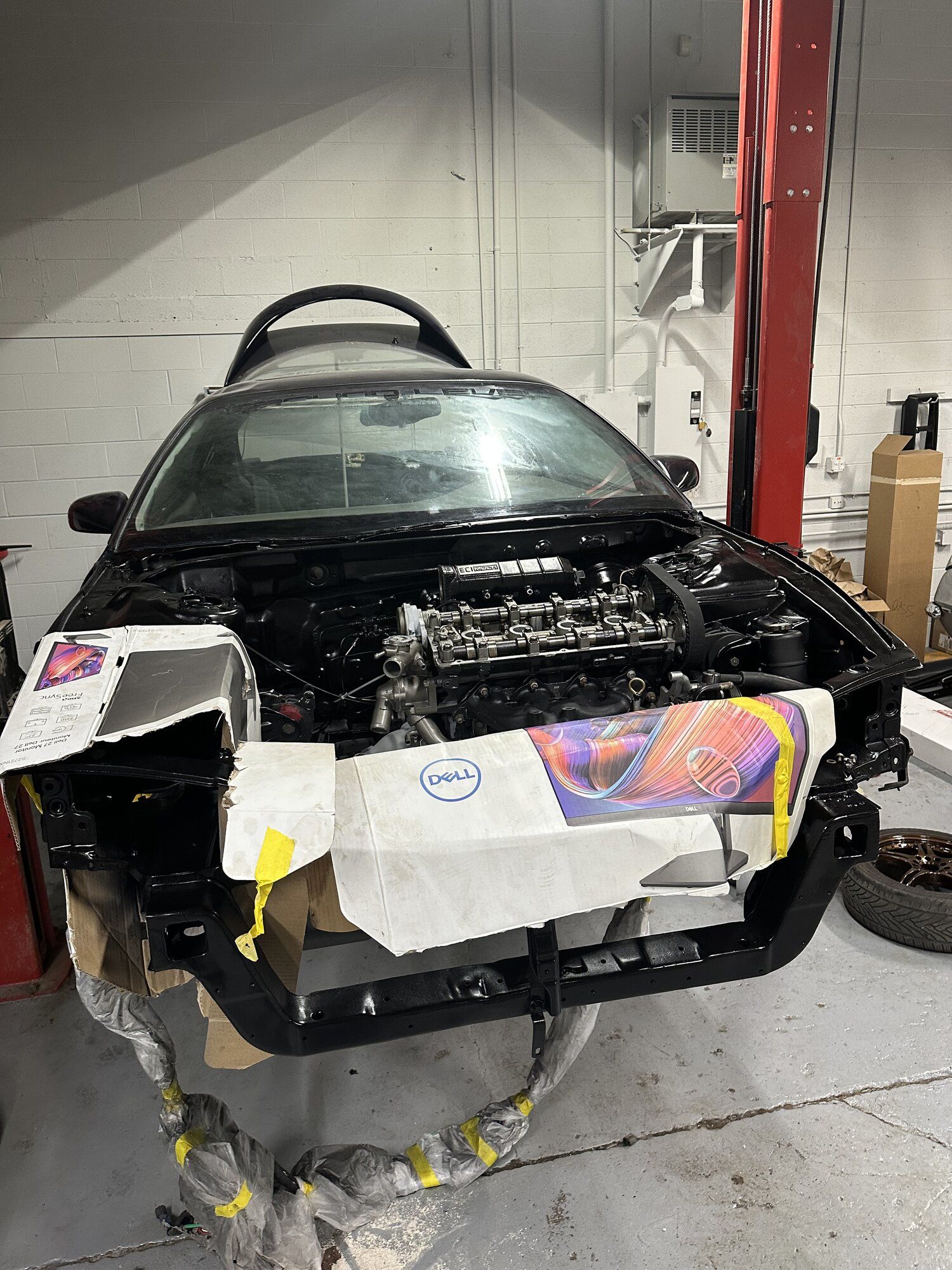

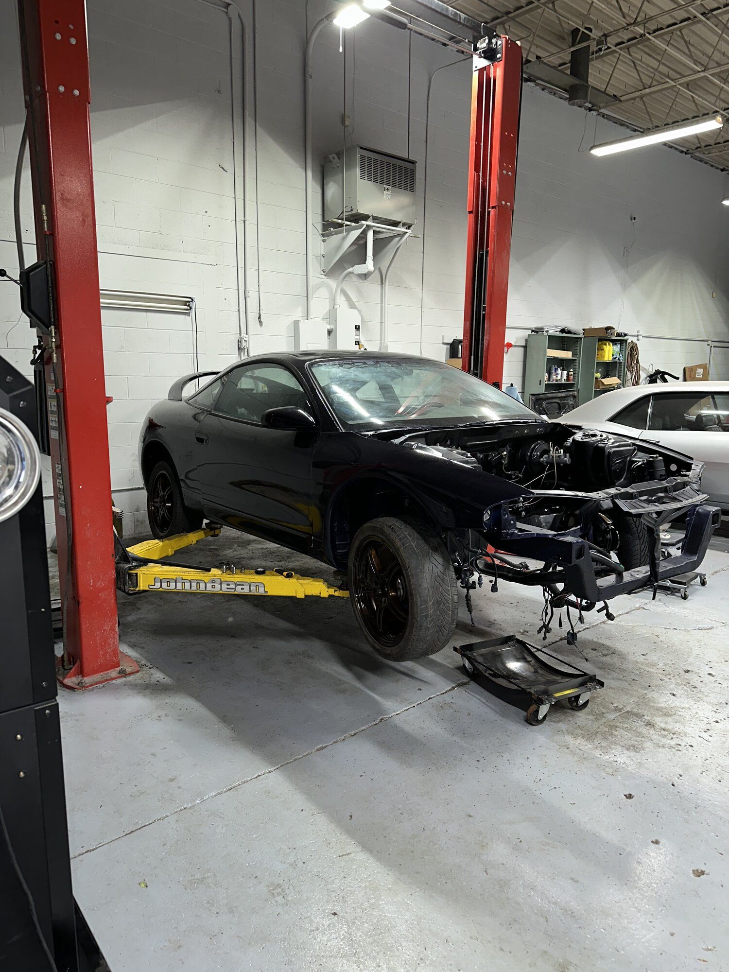

painted subframe ✅

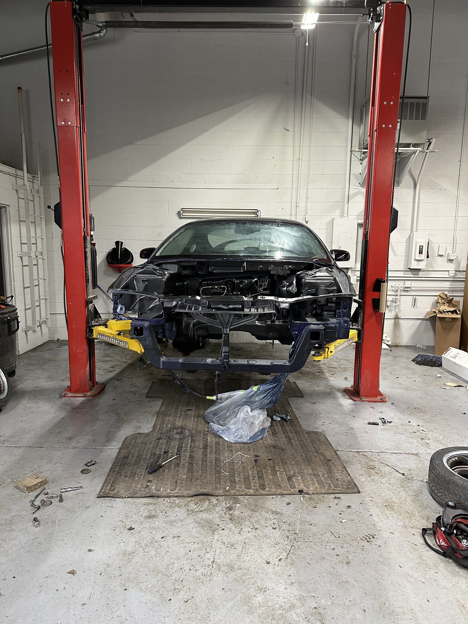

re installed ✅

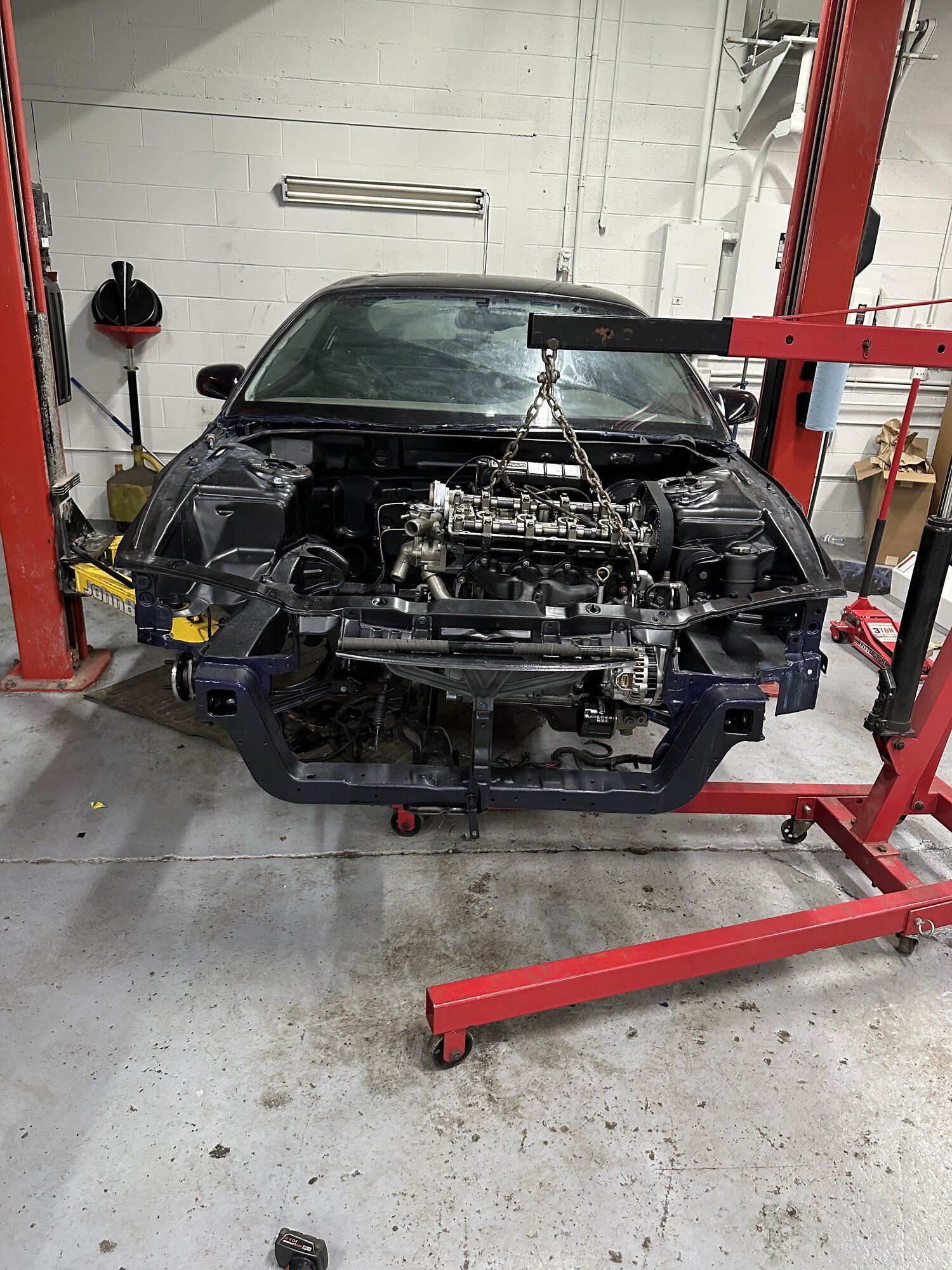

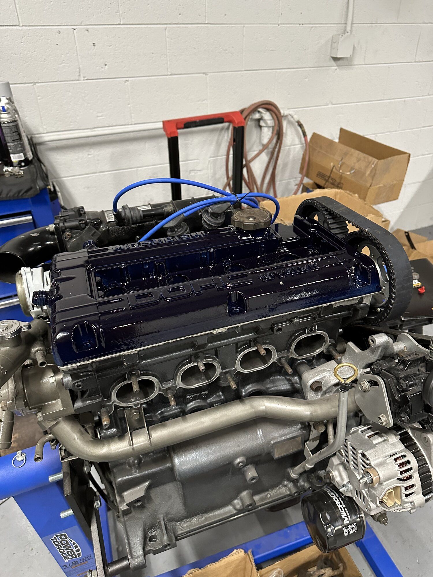

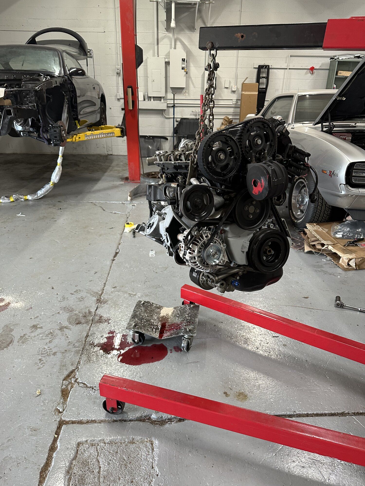

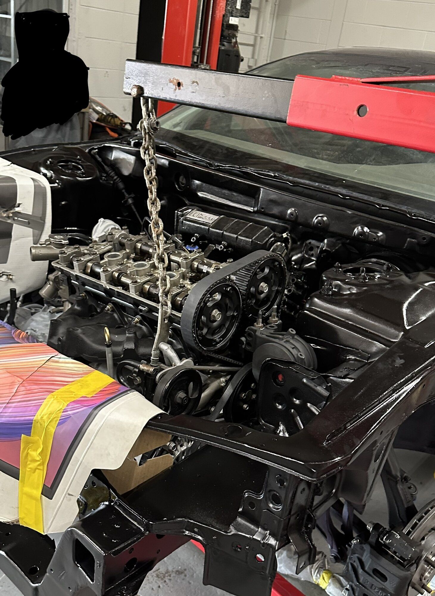

motor in ✅

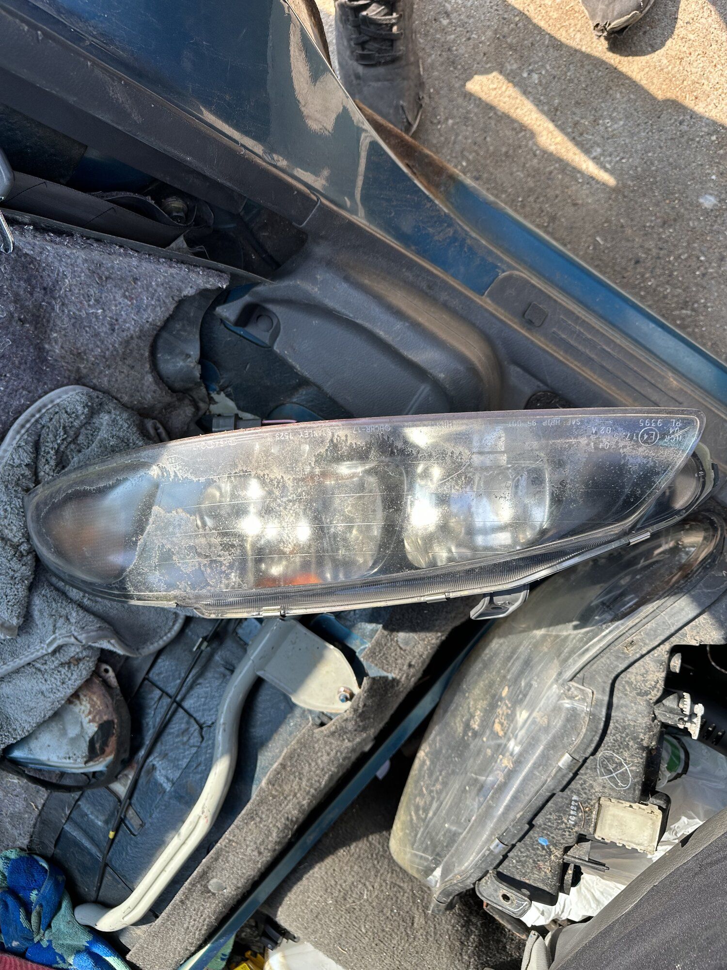

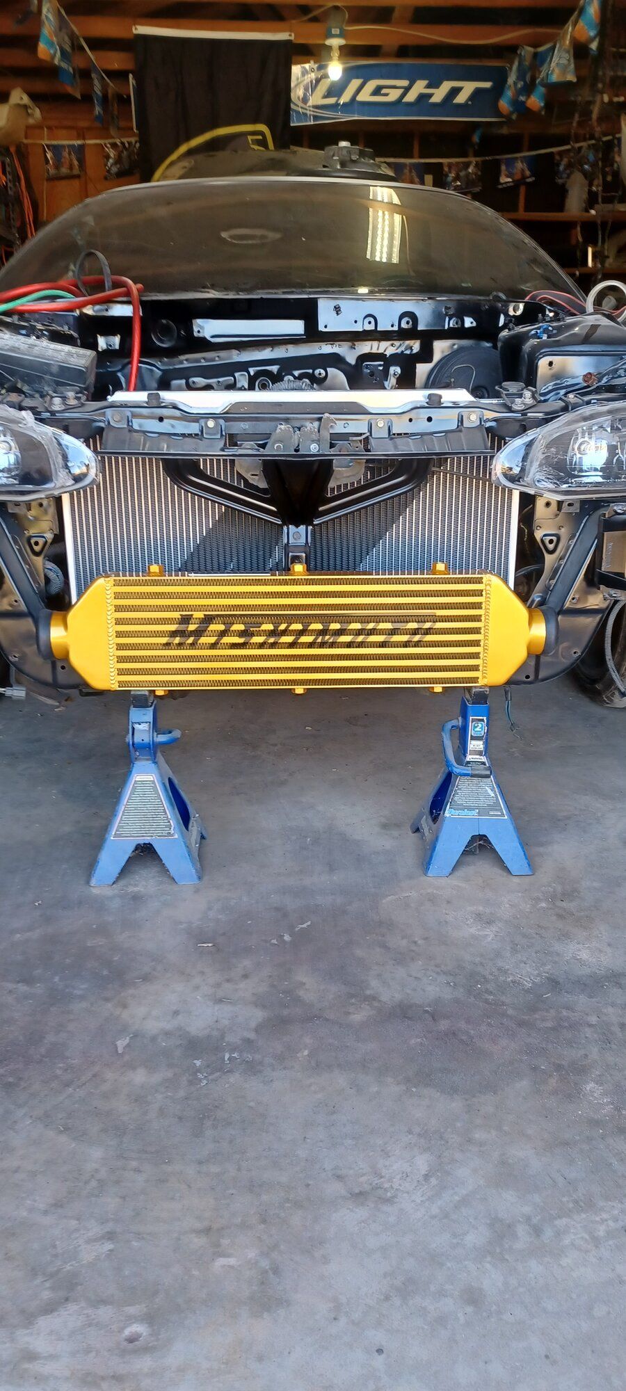

picked up some headlights going to do a custom set up.

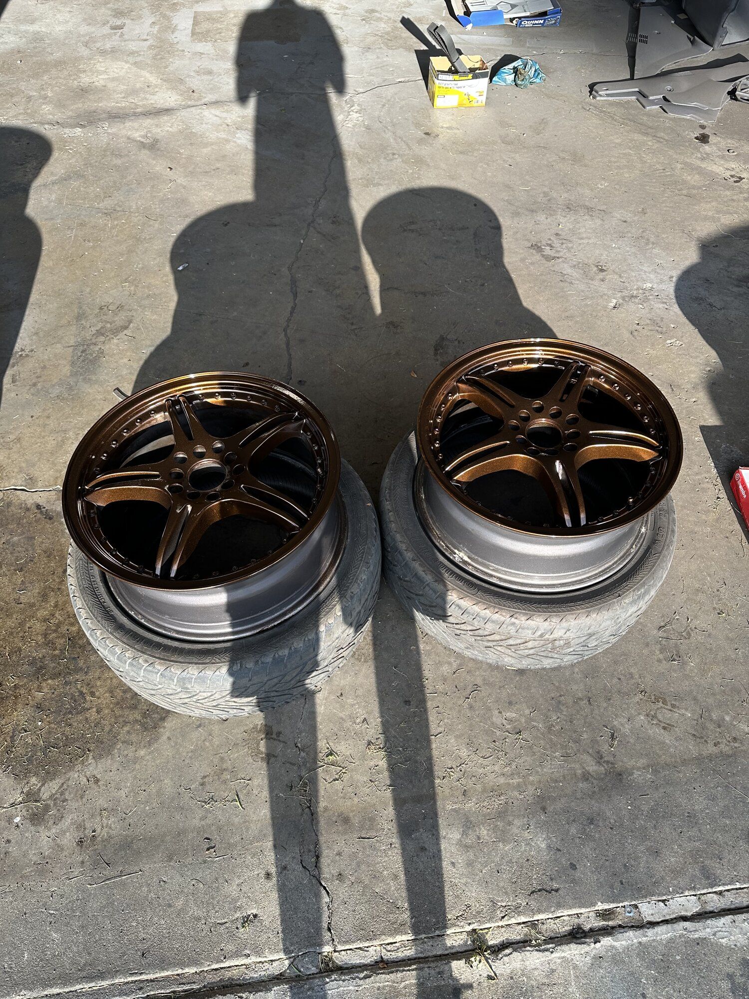

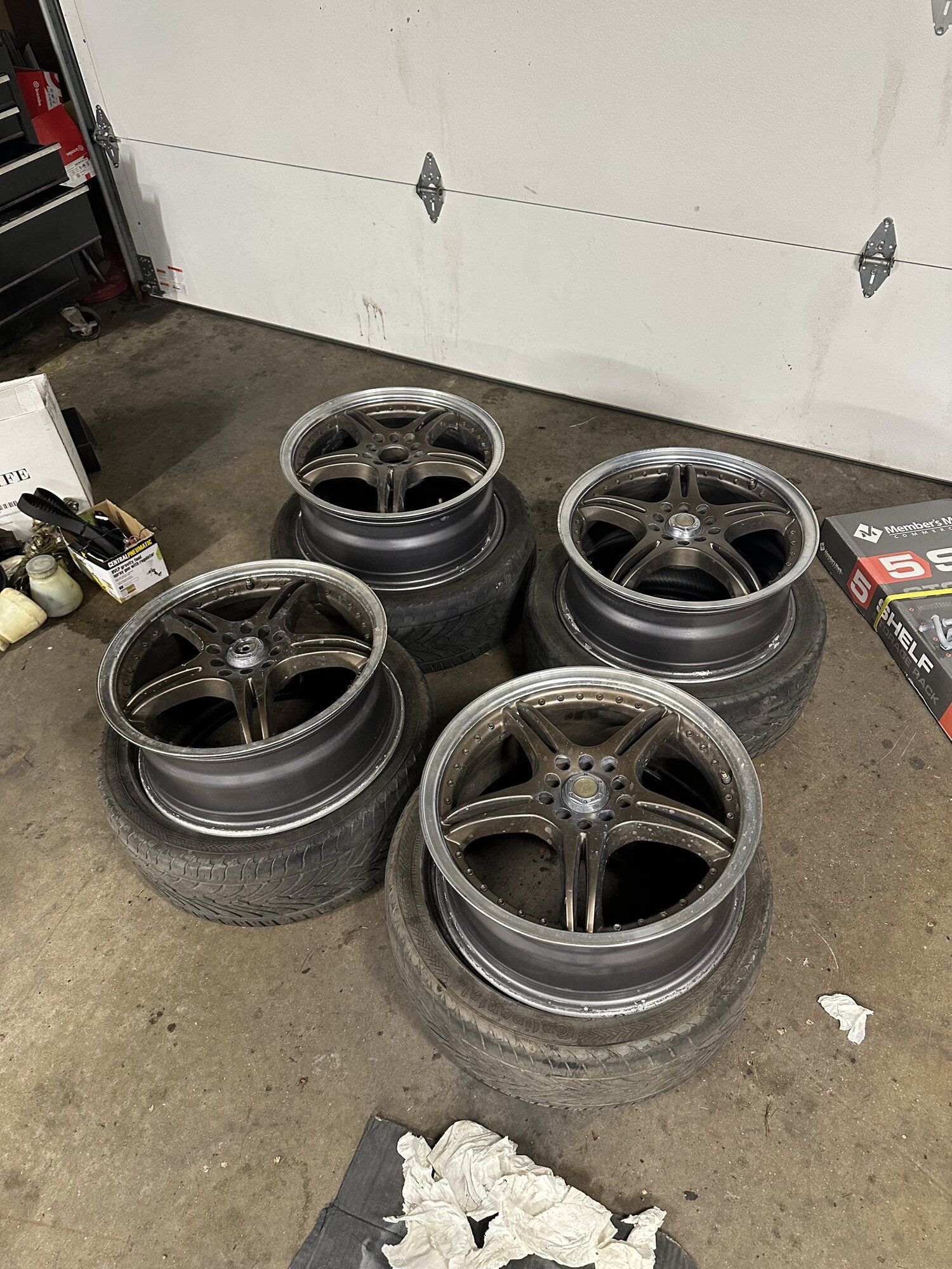

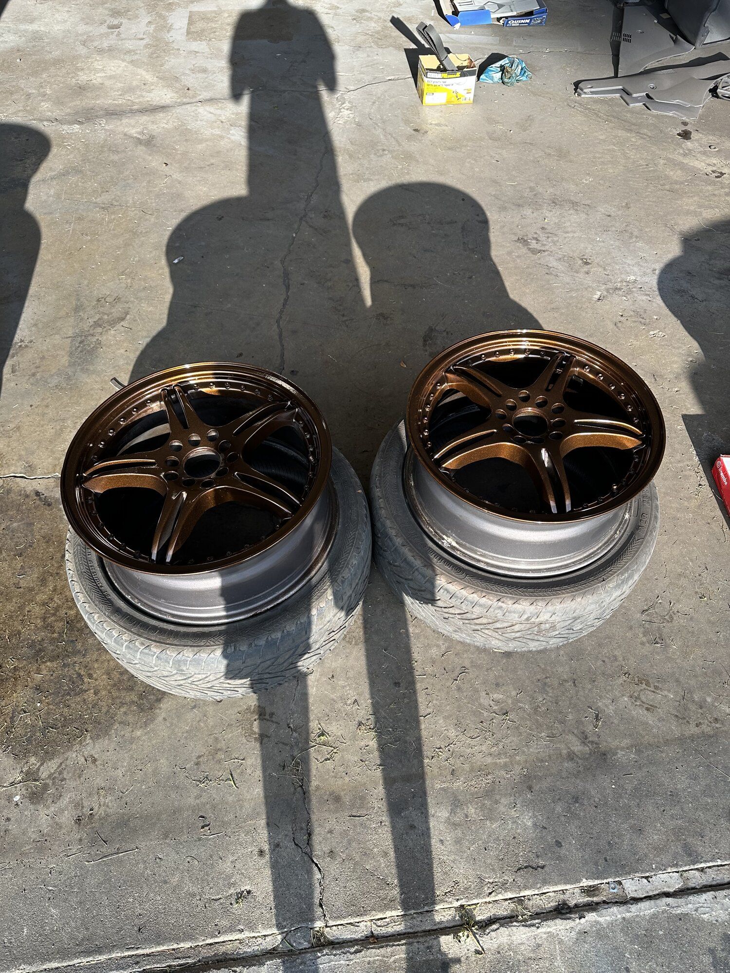

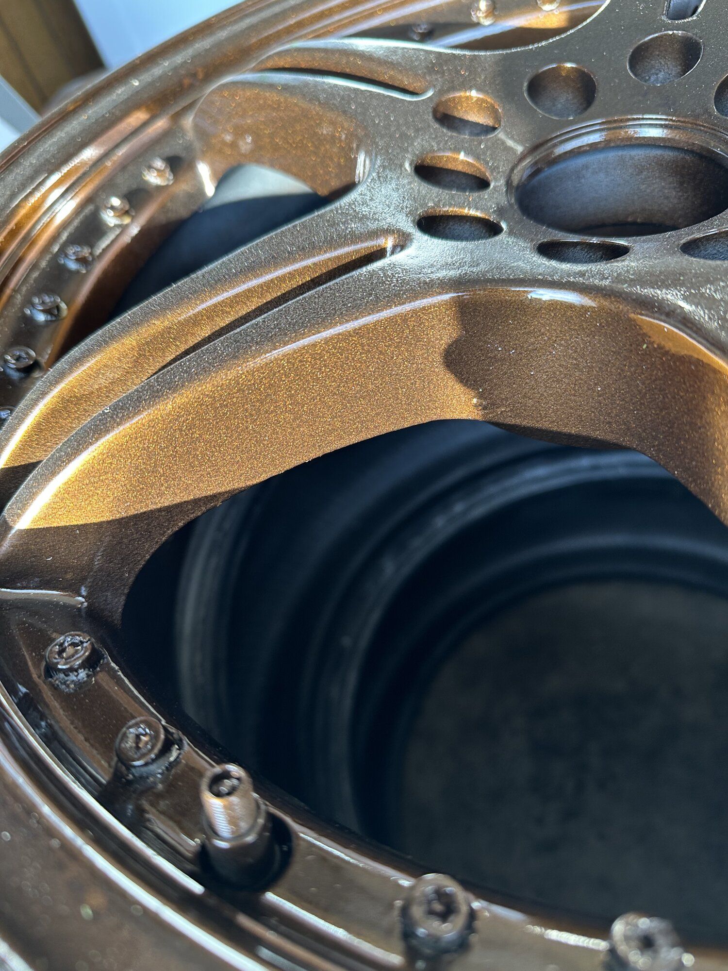

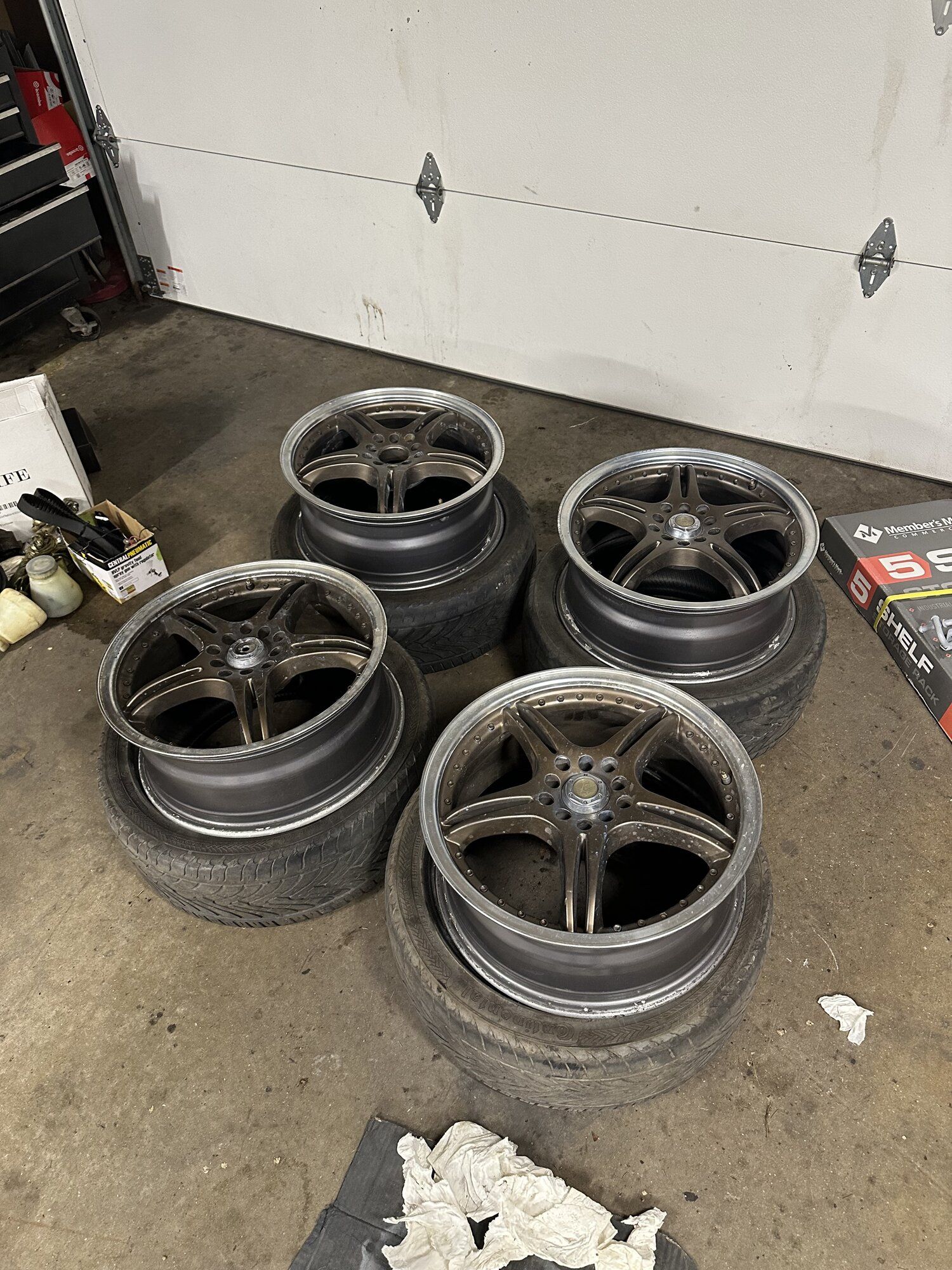

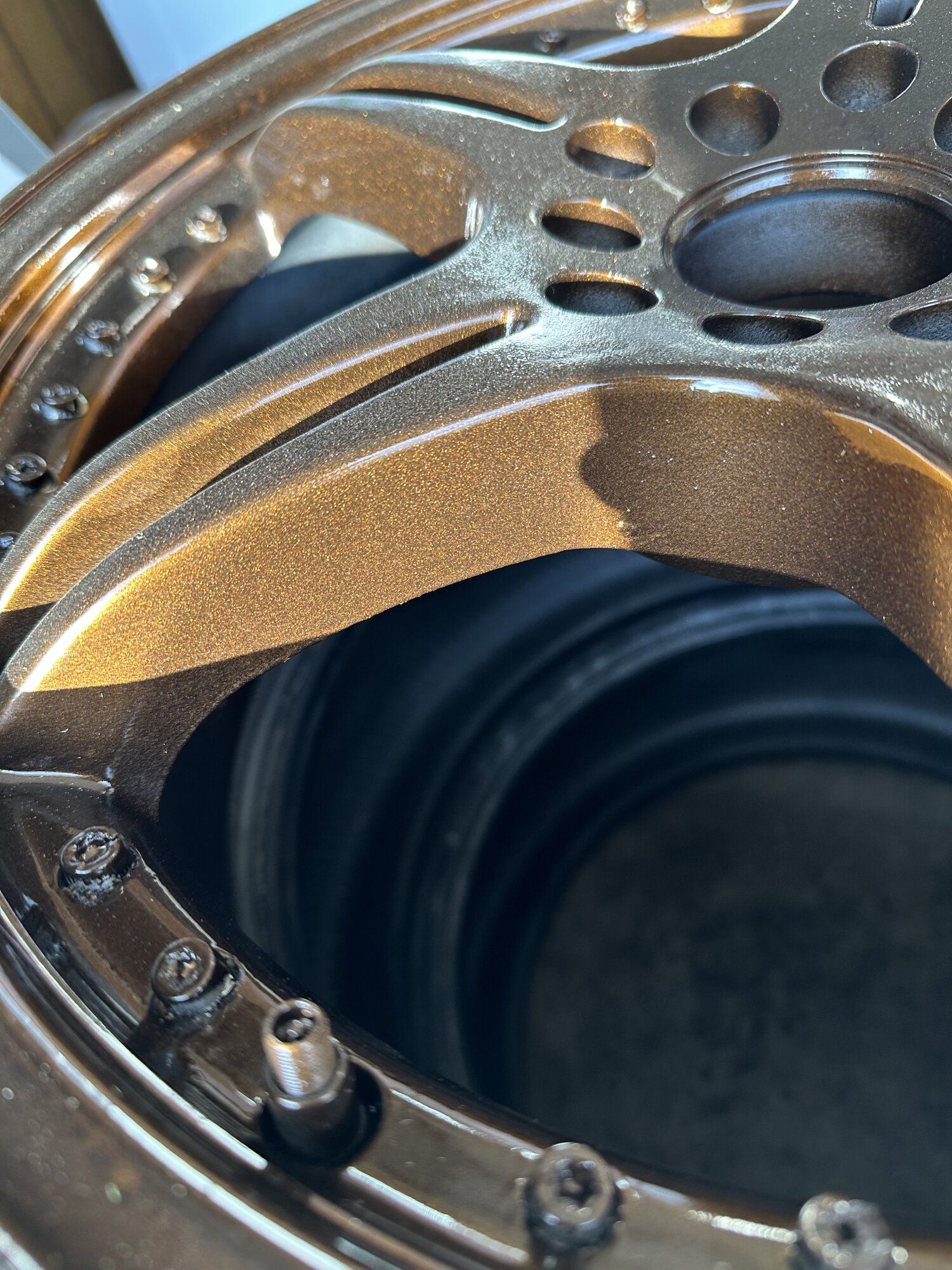

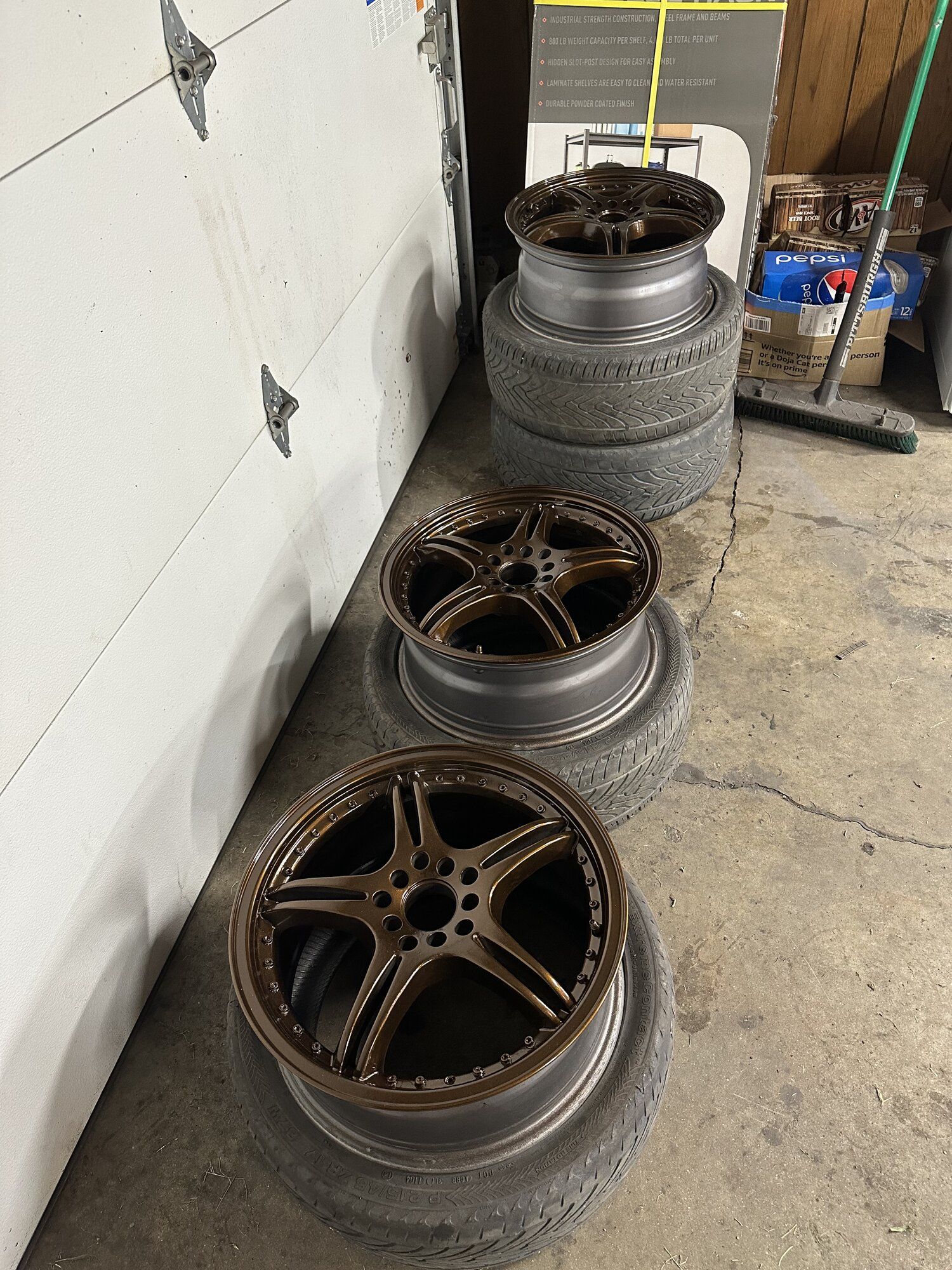

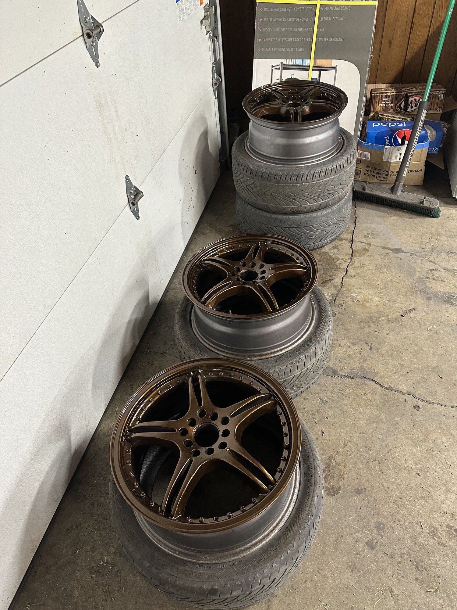

time to freshen up the wheels, going with a metallic bronze powder coat with a white trim instead of chrome

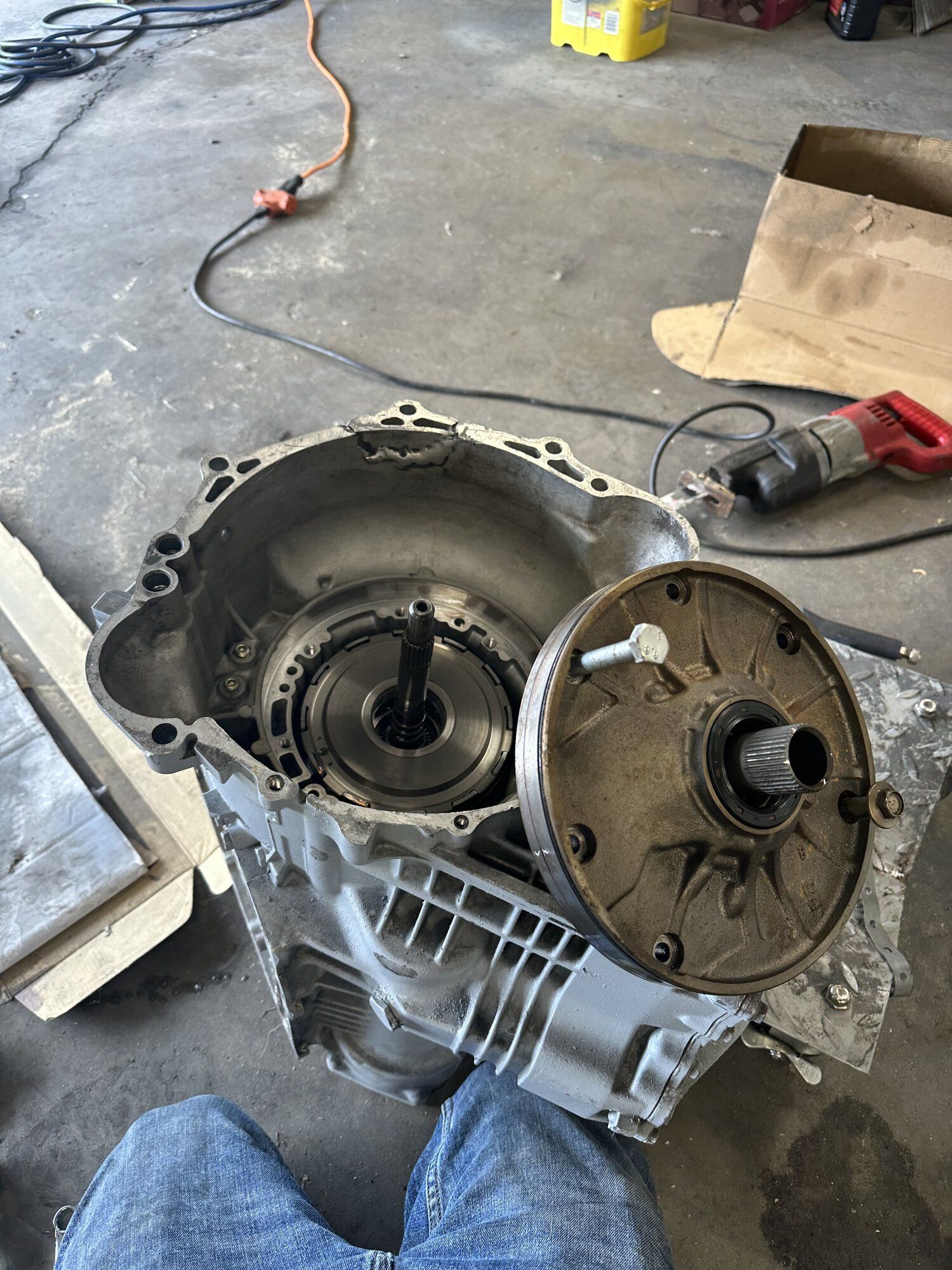

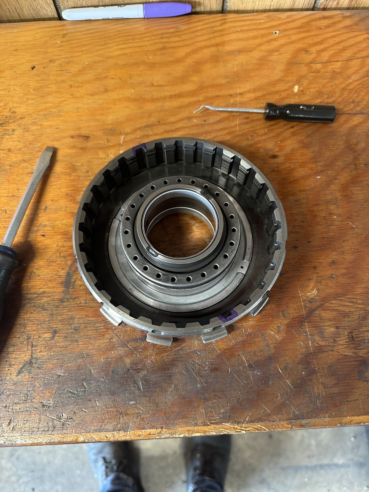

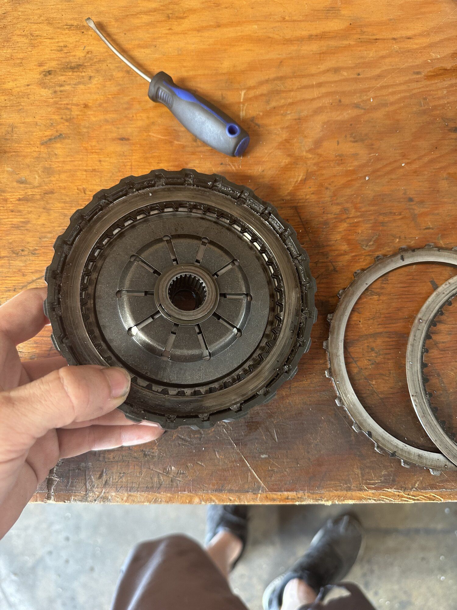

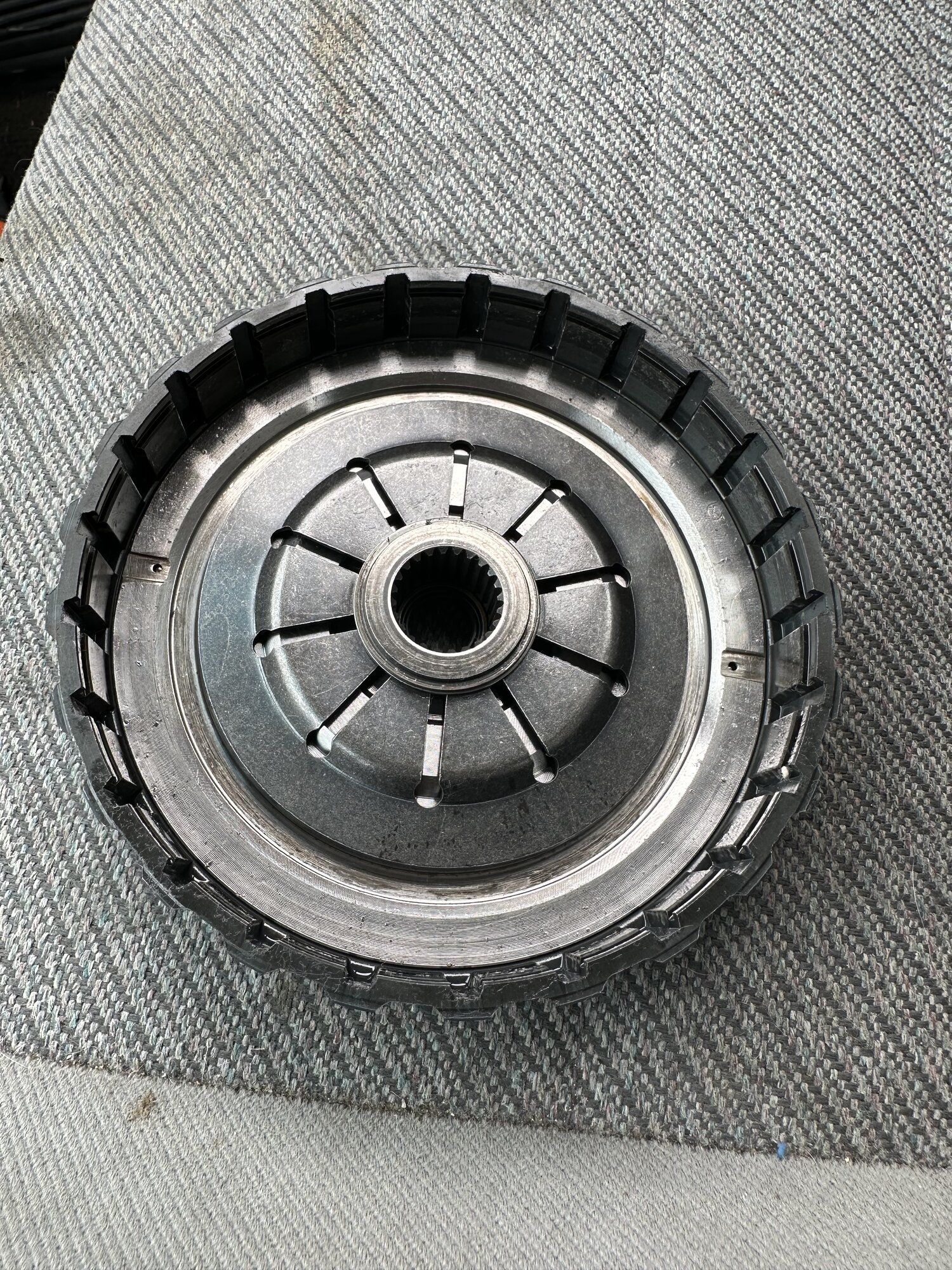

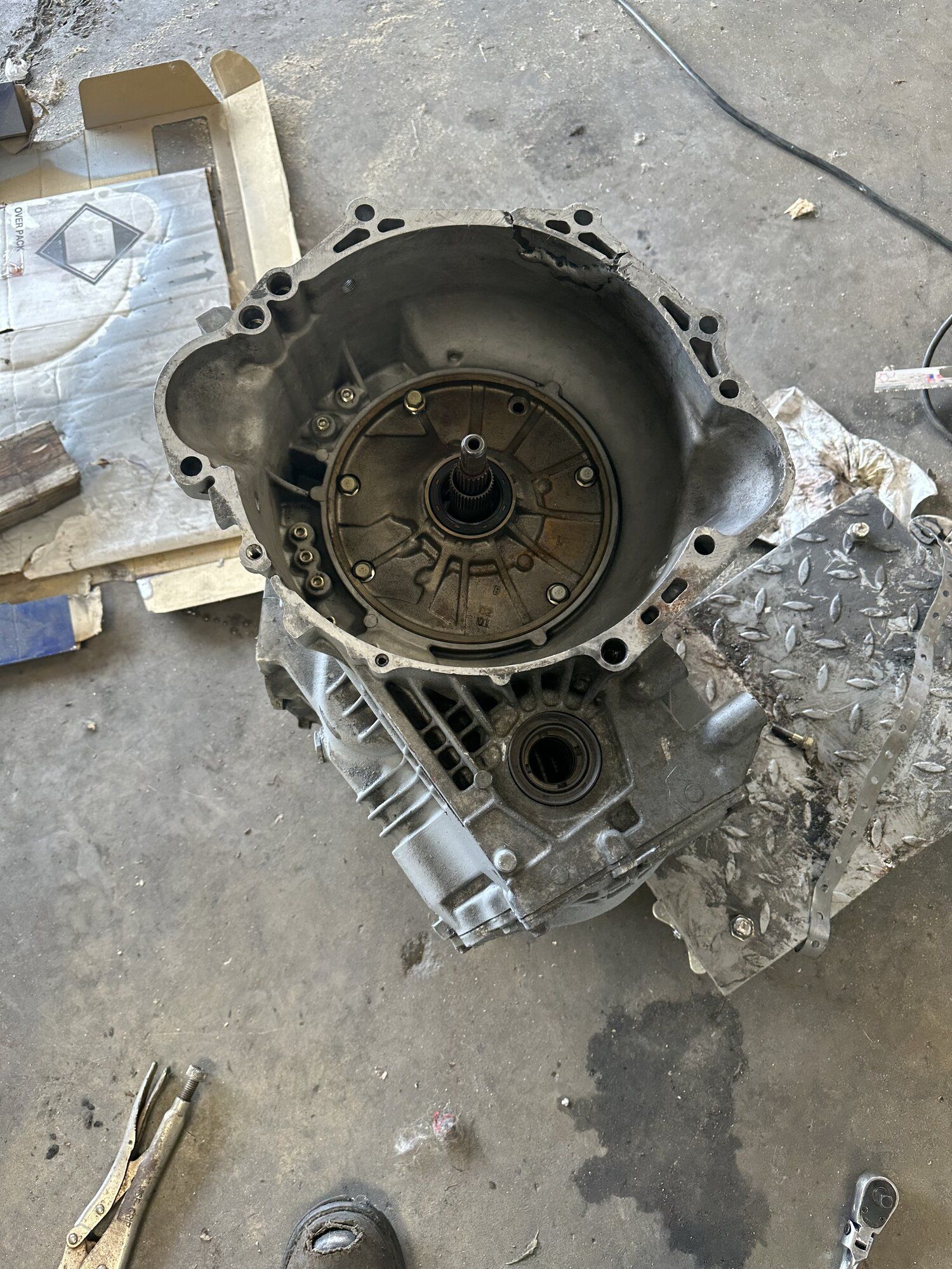

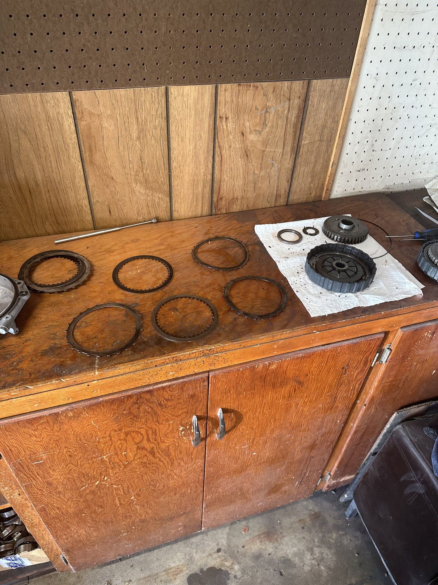

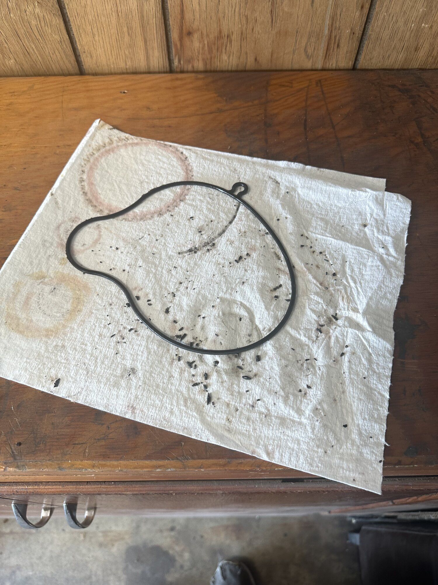

in the process of doing the clutch ends, this was in my talon that didnt shift so good never tore it apart til now. now we see why, these clutch ends are so f***ed there bent, they wouldnt even come out of the housing without a pry bar they were so burnt up. kiggly clutches going back in 🫡
Damn, man. Good find. That pack has seen some heat!

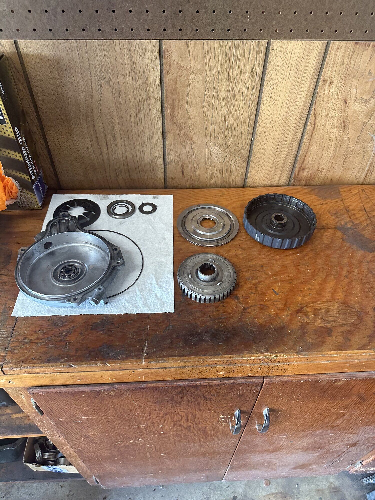

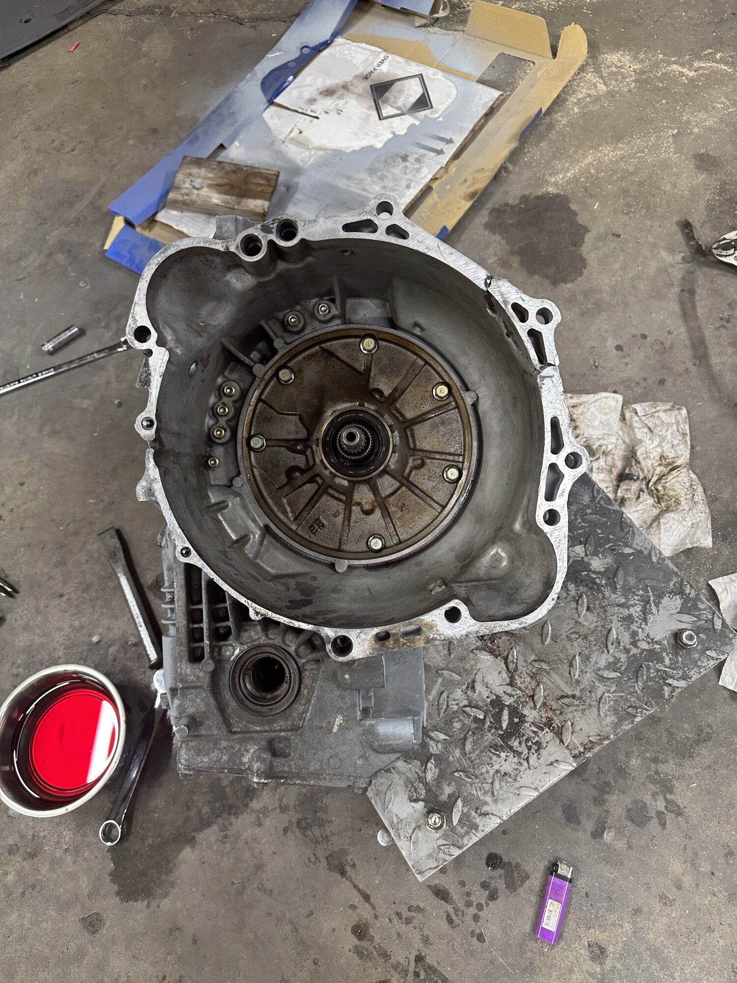

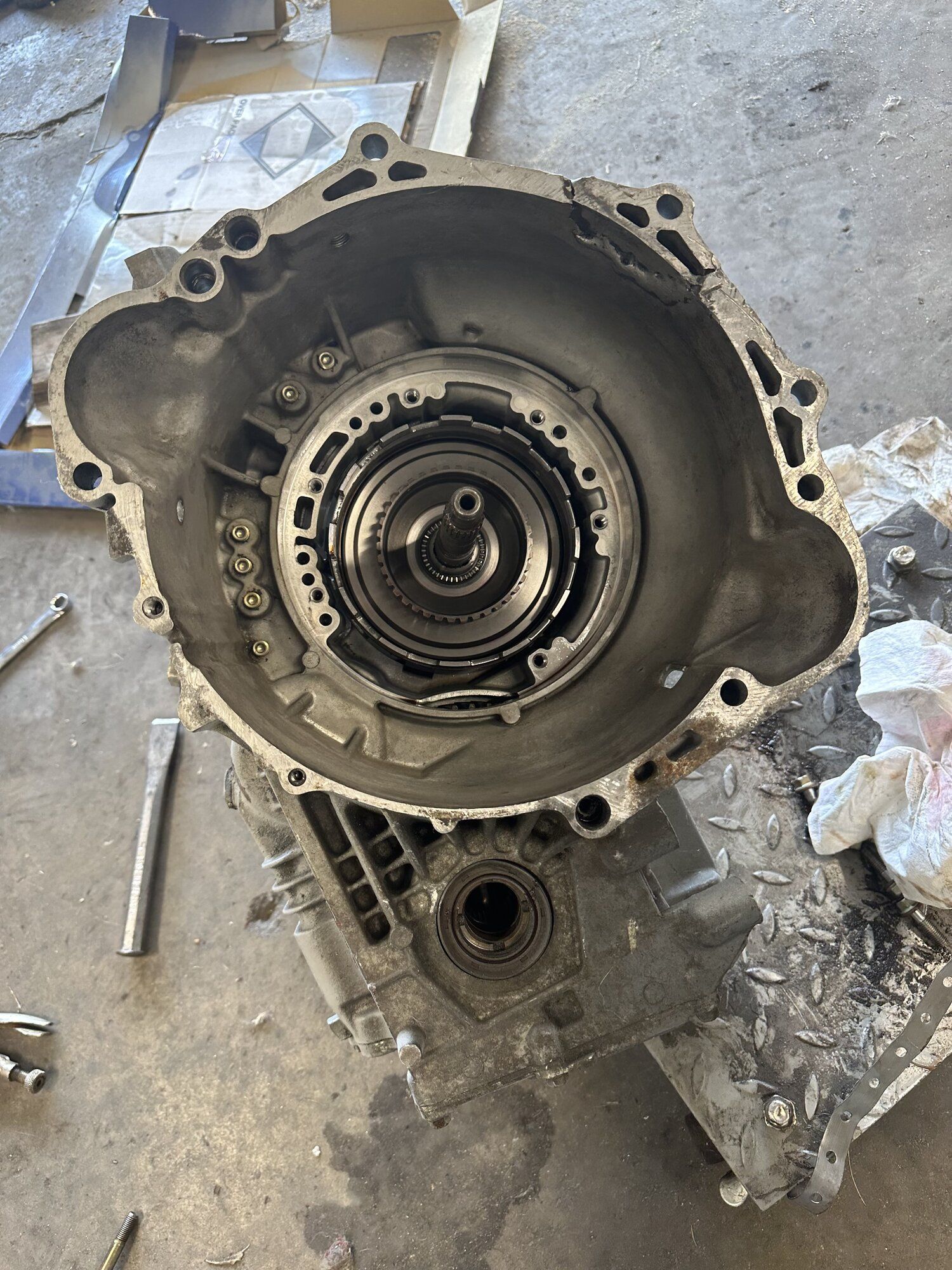

didnt have a press to finish this part of the job, good thing my local trans shop was kinda thrilled i dove into the trans myself so they did it for free. now for it to go back together and get put back in the car 🤟🏼

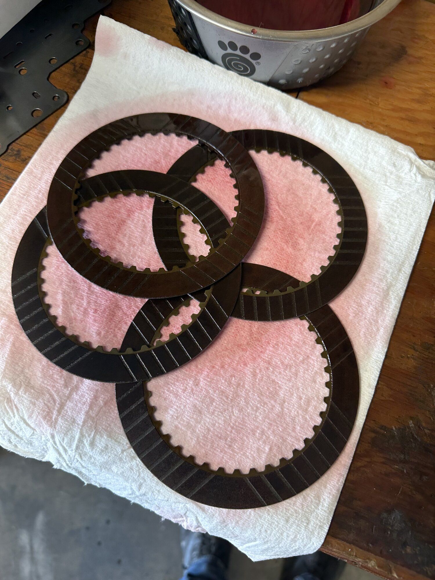

right on to the next one 🫡 didnt think id be doing damn near a whole trans rebuild but dont want it to blow so here we are kiggly clutches going in 💯 after this its back in the car with the motor this time 😉
Good call, man. You're right in there, might as well, especially how those end clutches looked!

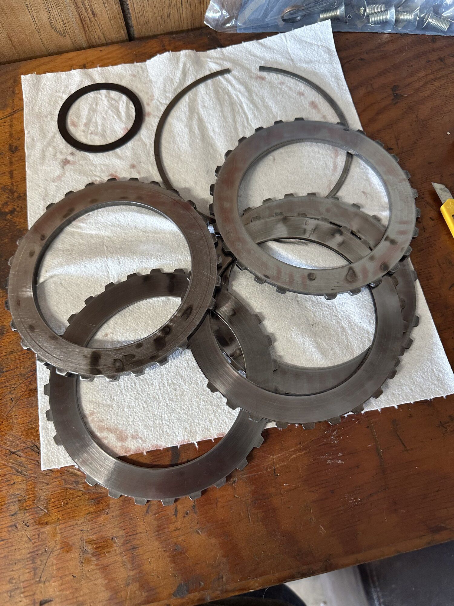

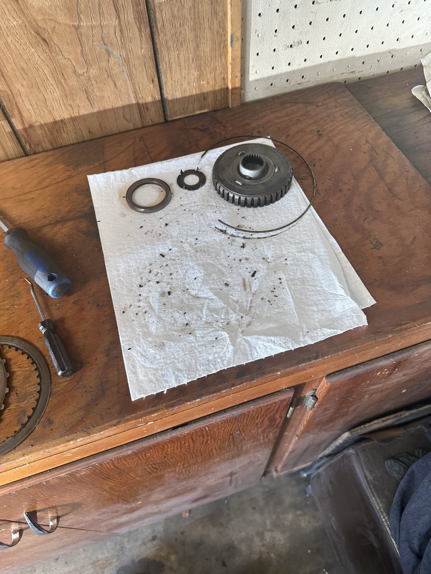

okay baskets and clutches are out, these ones didn’t actually have any marks on them they all look good none of the clutches bent, or burnt so thats good, the metal plates look alittle rough tho, still replacing it all. ill finish once i get home its time for work

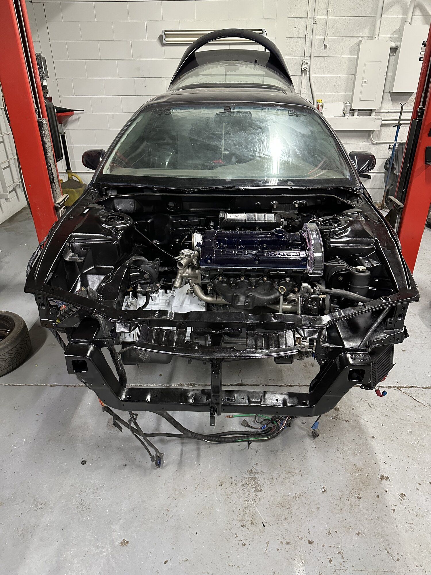

motor and trans could have gone in last week, but i was missing the 2 dowel pins for between the trans and motor what a joke LOL, i must have sold them with the other 4 transmissions i had. oh well new ones are here installed ready to go!

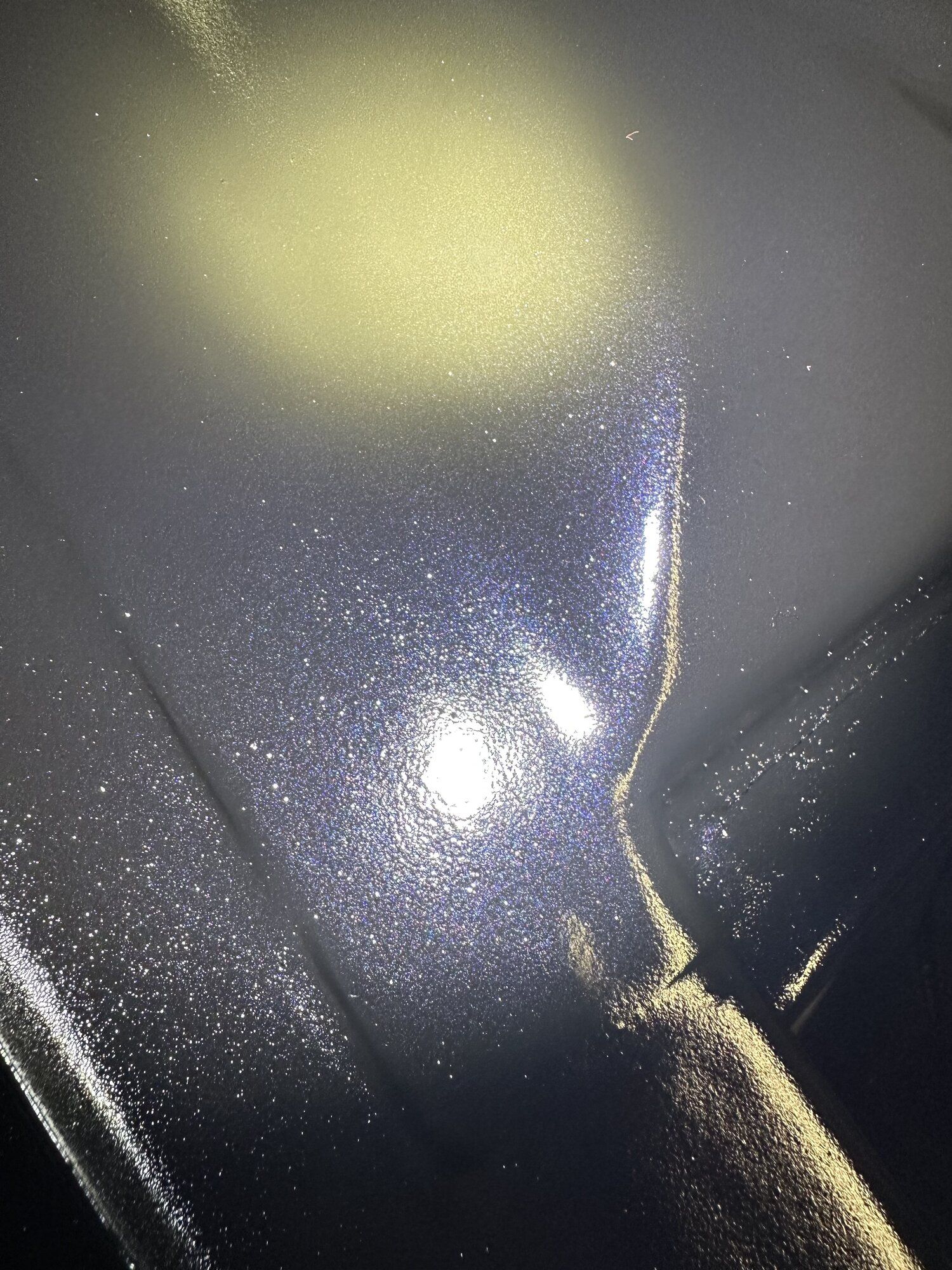

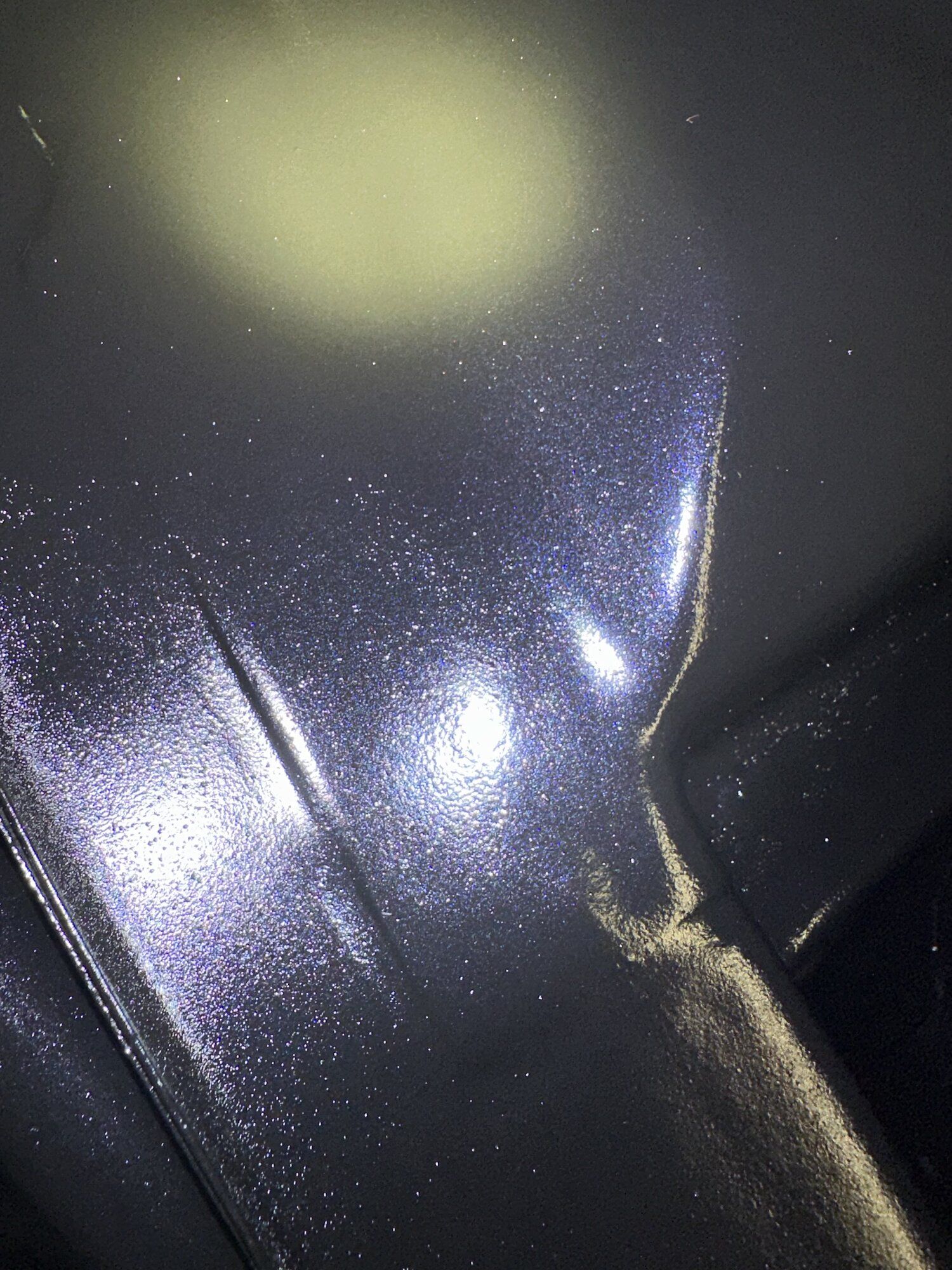

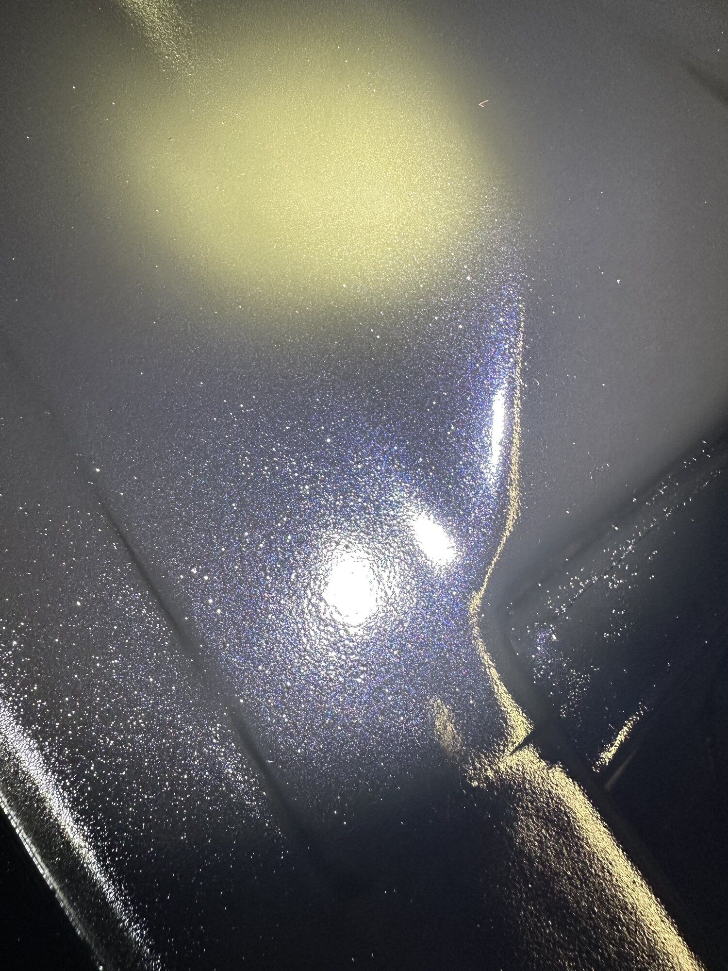

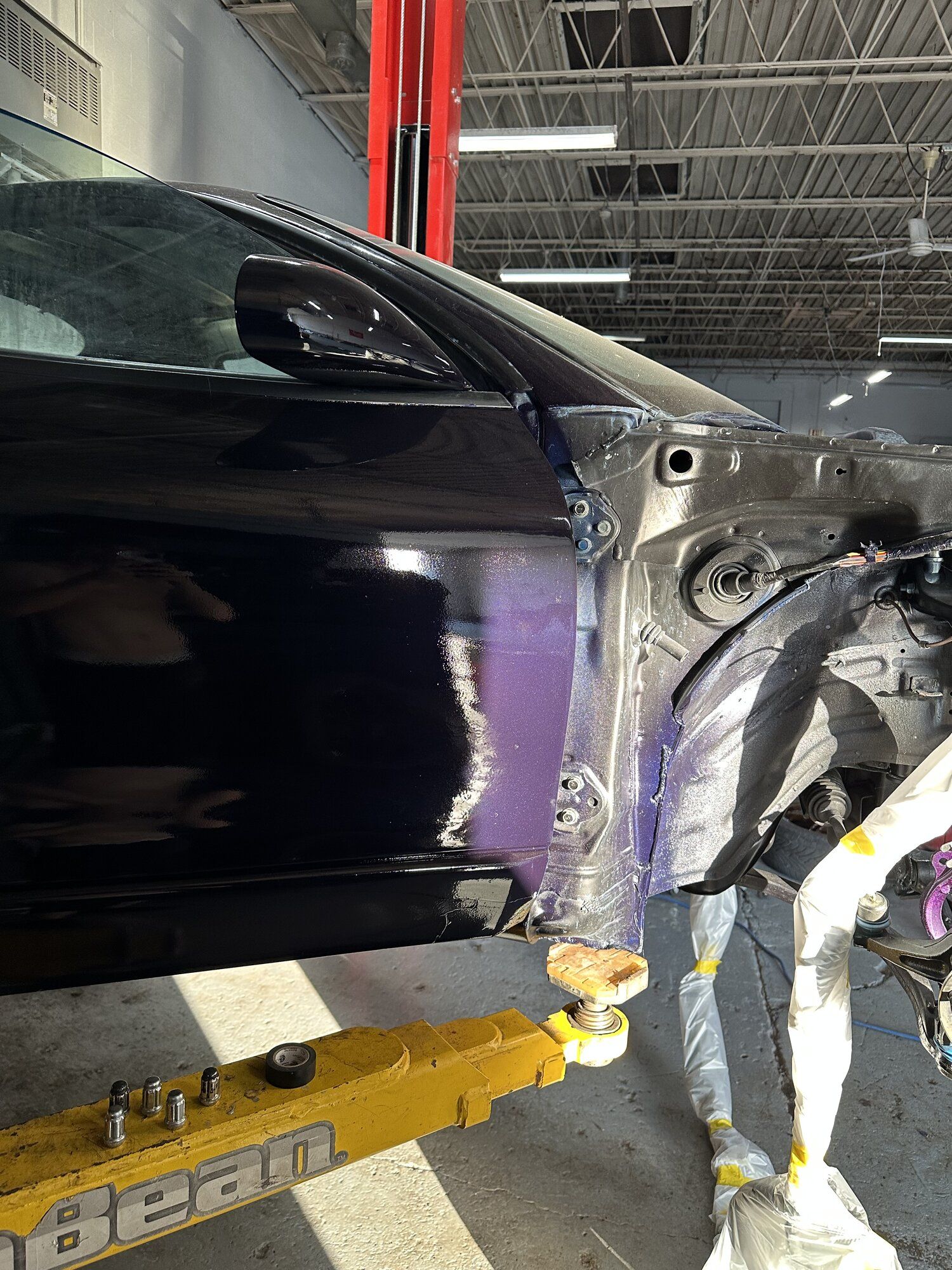

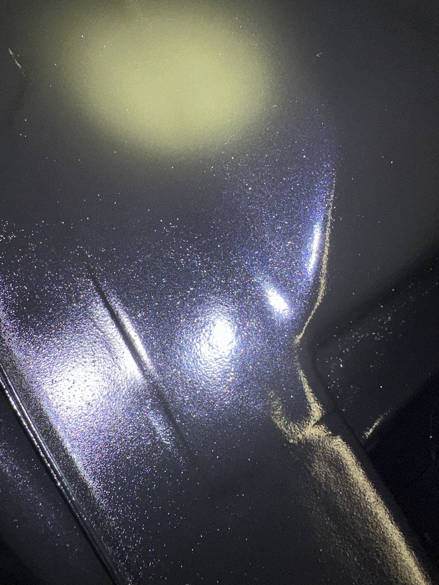

i love the color of the purple when the sun is hitting it just right, im wondering why it didnt look that purple outside? sun was still shining on it?
