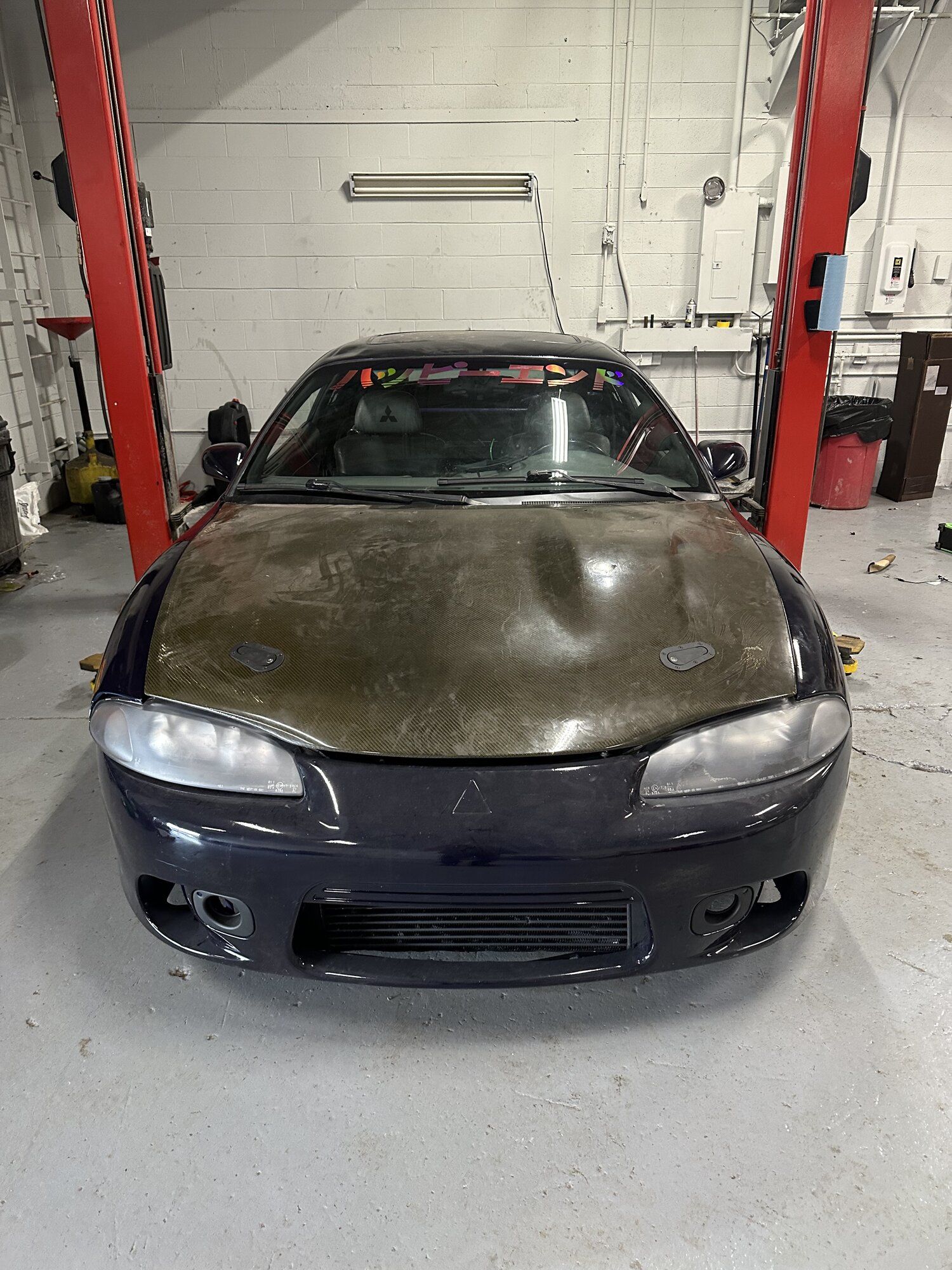

oem exhaust heat shield no holes yet, one small blemish in it before any sandblasting
cleaned the windows up
oem exhaust manifold heat shield installed

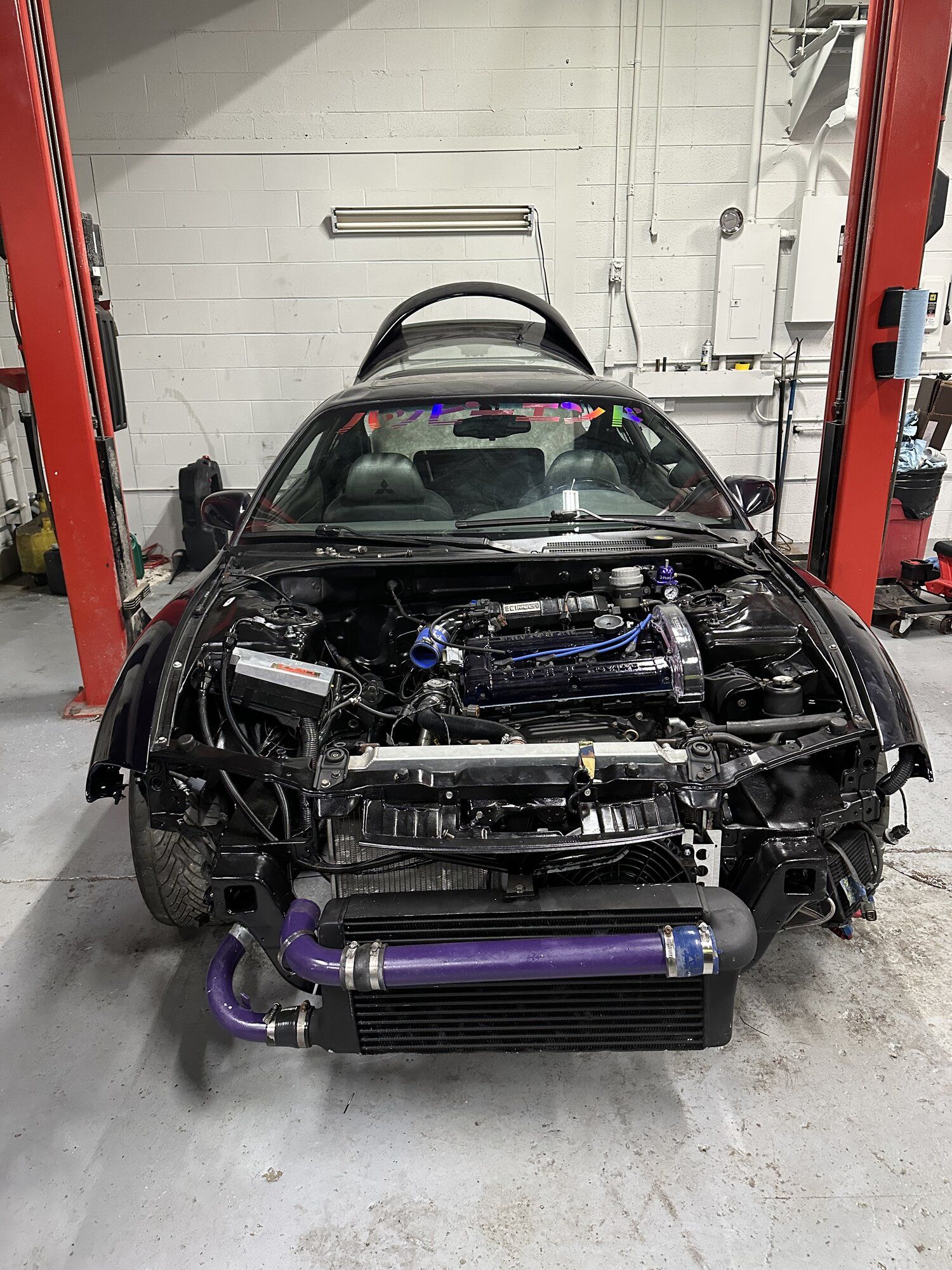

then it was time to fill it with oil, of course it started a leak at the turbo drain, brand new gasket, will add rtv and try again,
even worse news, i didnt tighten the flex plate bolts down all the way on initial install of them, so when i went to go tighten them all up, one is stuck between the trans and the motor. hopefully i can get this out without unmating the trans andd motor big bummer
Damn this is way too good for a first build!
I would recommend changing out that turbo drain hose though. I'm not sure what it's rated for but it doesn't look built to handle the heat of being so close to the downpipe and has a pretty gnarly looking bend at the bottom. At a minimum give it some heat wrap. I did something similar 15 years ago cutting the flex section out of a 1G drain and replacing it with Aeroquip AQP style hose (no outer braid) and some constant tension clamps covered by DEI heat sleaving and it still looks as good as new to this day.
Also be careful with that flex section. The sticker on it looks like the brand they sell at Autozone and a hot turbo set up will eat up a low quality flex section in short time from the inside out and cause a blow out or some nasty restriction. I've been using the interlock style ones forever and they hold up amazingly well.

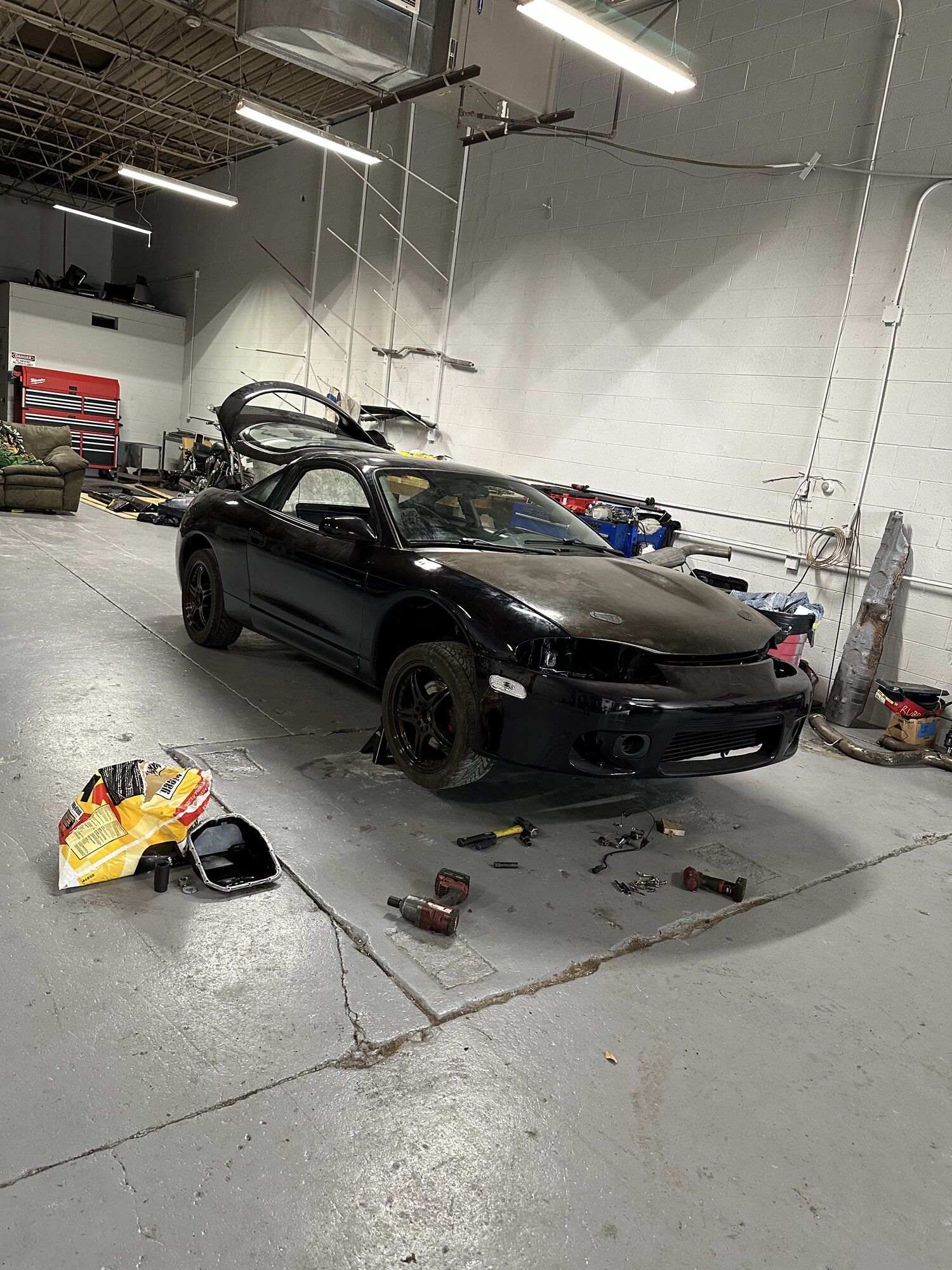

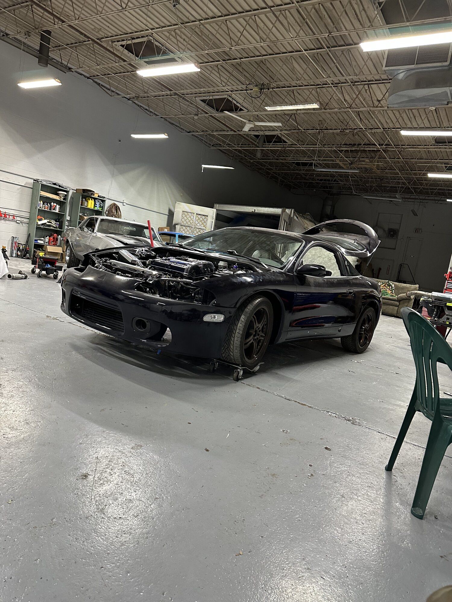

i got the flex plate bolt figured out and tightened up, for some reason the car doesn’t want to engage gears anymore, shifter connected or not, theres no valve body in the pan yet. hopefully it’s something dumb and simple. got the turbo drain leak figured out to im pretty positive.
anyone know about auto trans?
theres no valve body in it right now, nor is there any fluid in it,
it stopped wanting to roll backwards it would roll forwards but not as easy as it should, i poppeed out the cv shaft and now i can move it back forwards however i want it move’s great now, the transmission is going to act like its in neutral in every gear, and it wont engage drive or reverse til it has fluid and a valve body correct?

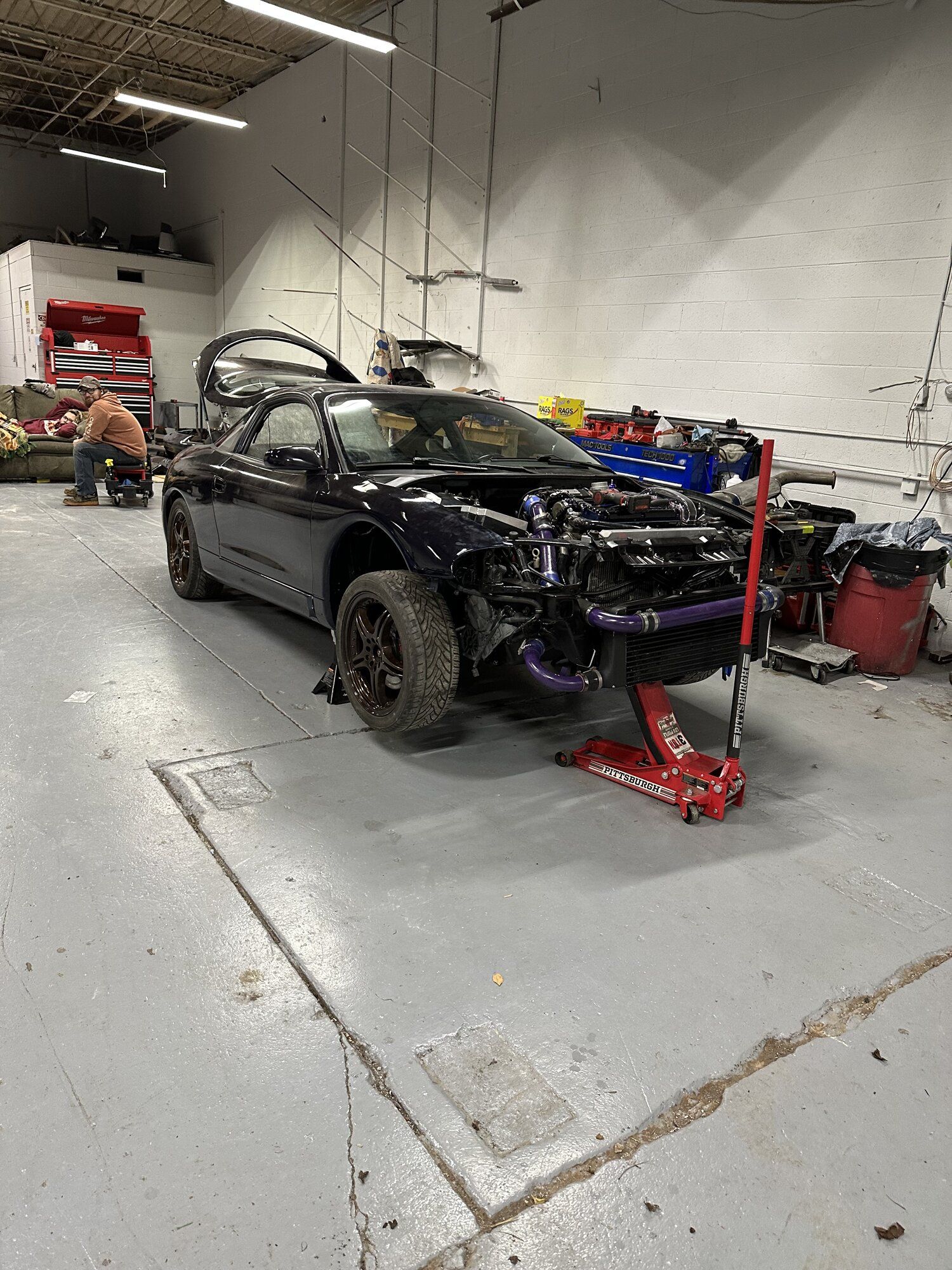

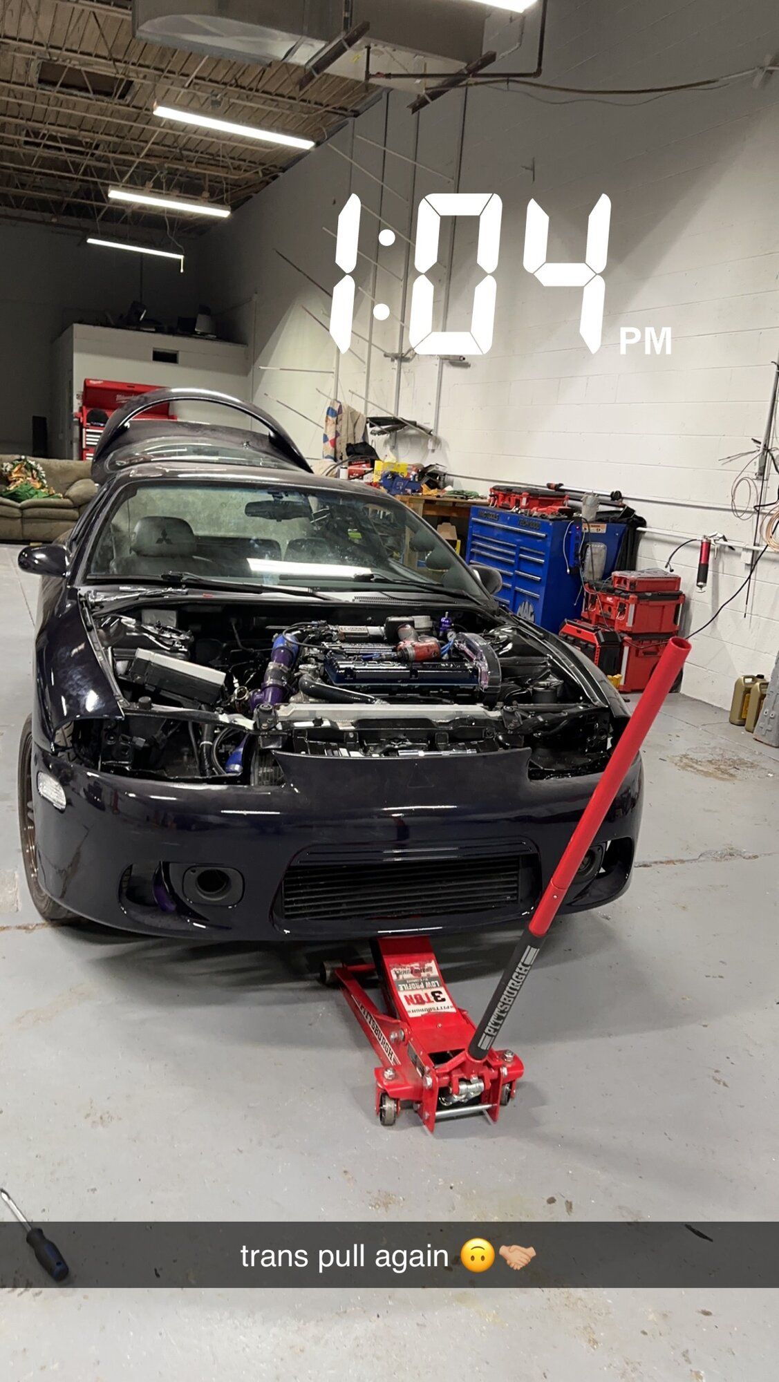

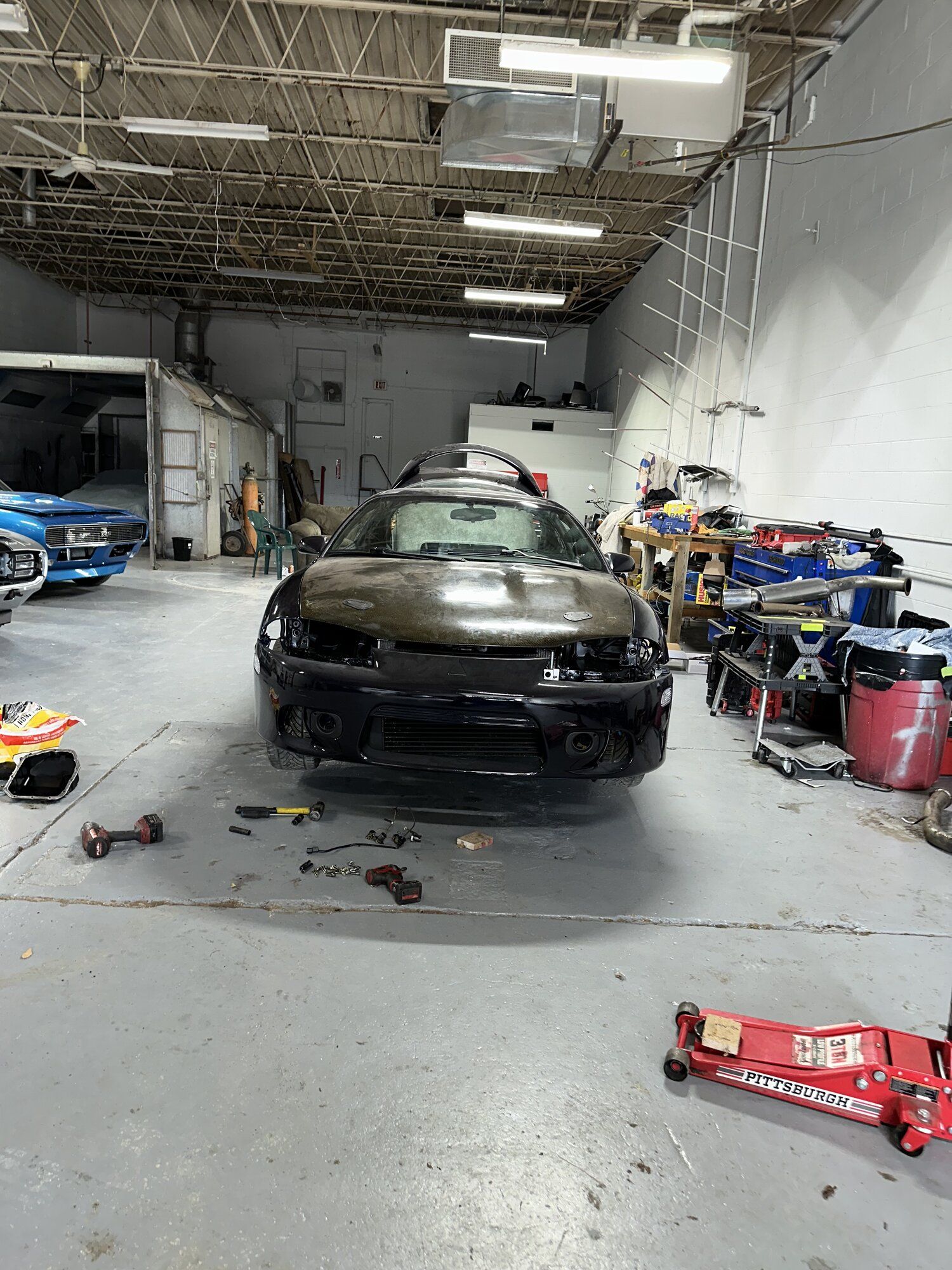

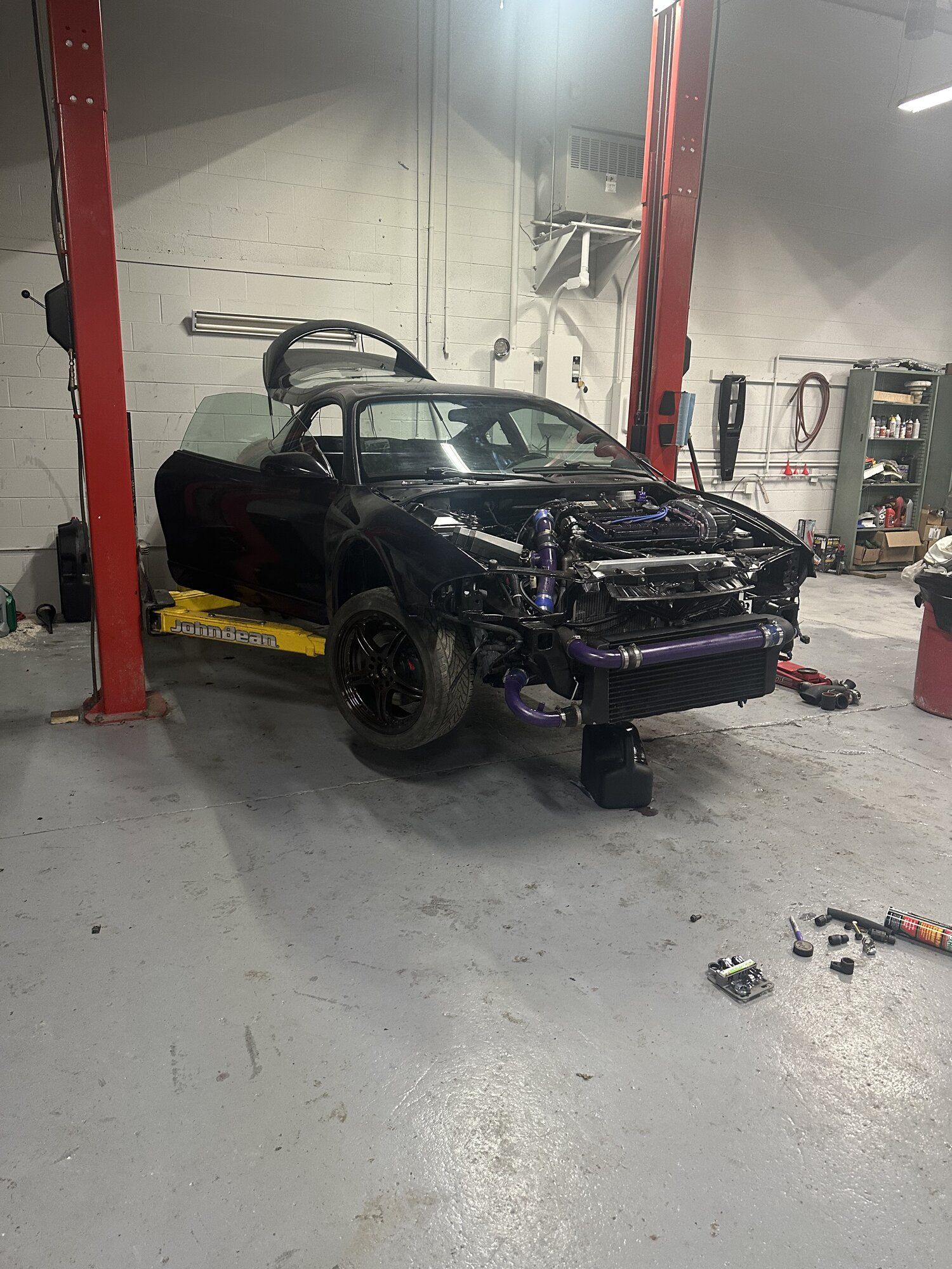

well with my no reverse problem, the trans has to come back out what a headache. its not a hard job or really that time consuming, its just the fact that like damn bruh i just put you in there 🙃
i must have missed something or somethings misaligned, lets get it out and crack it open and see if we cant figure out what i did. hopefully its in and out by the weekend i really want to start it 🤟🏼
almost ready to come out 🤟🏼
- flex plate bolts
- passenger side cv is being a bi***
- trans bolts and mounts while lowering it out

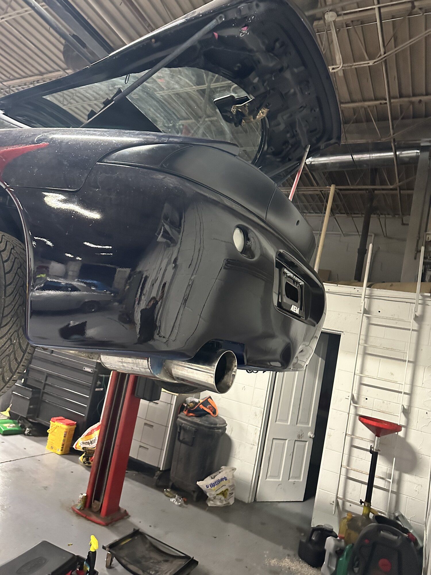

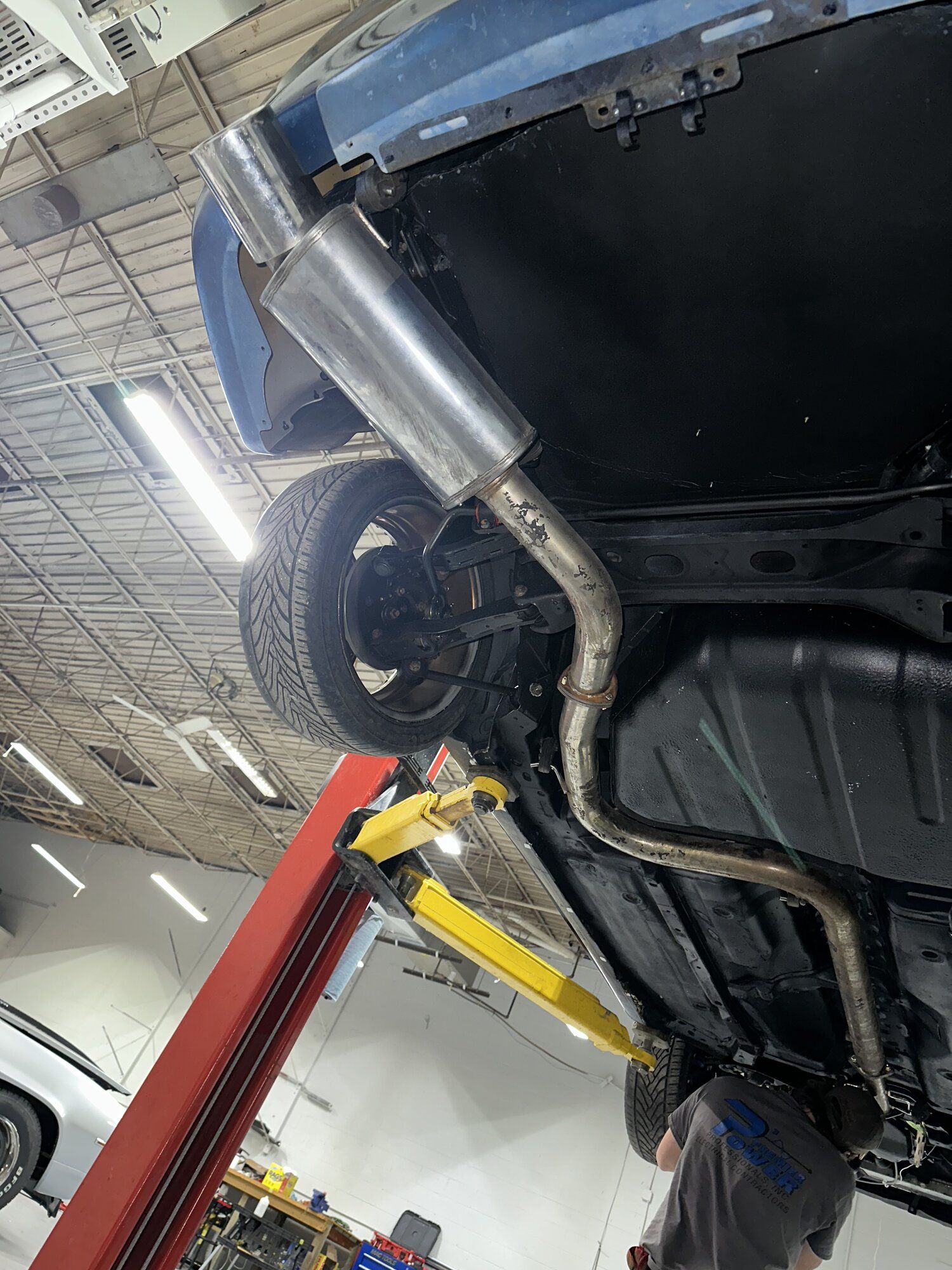

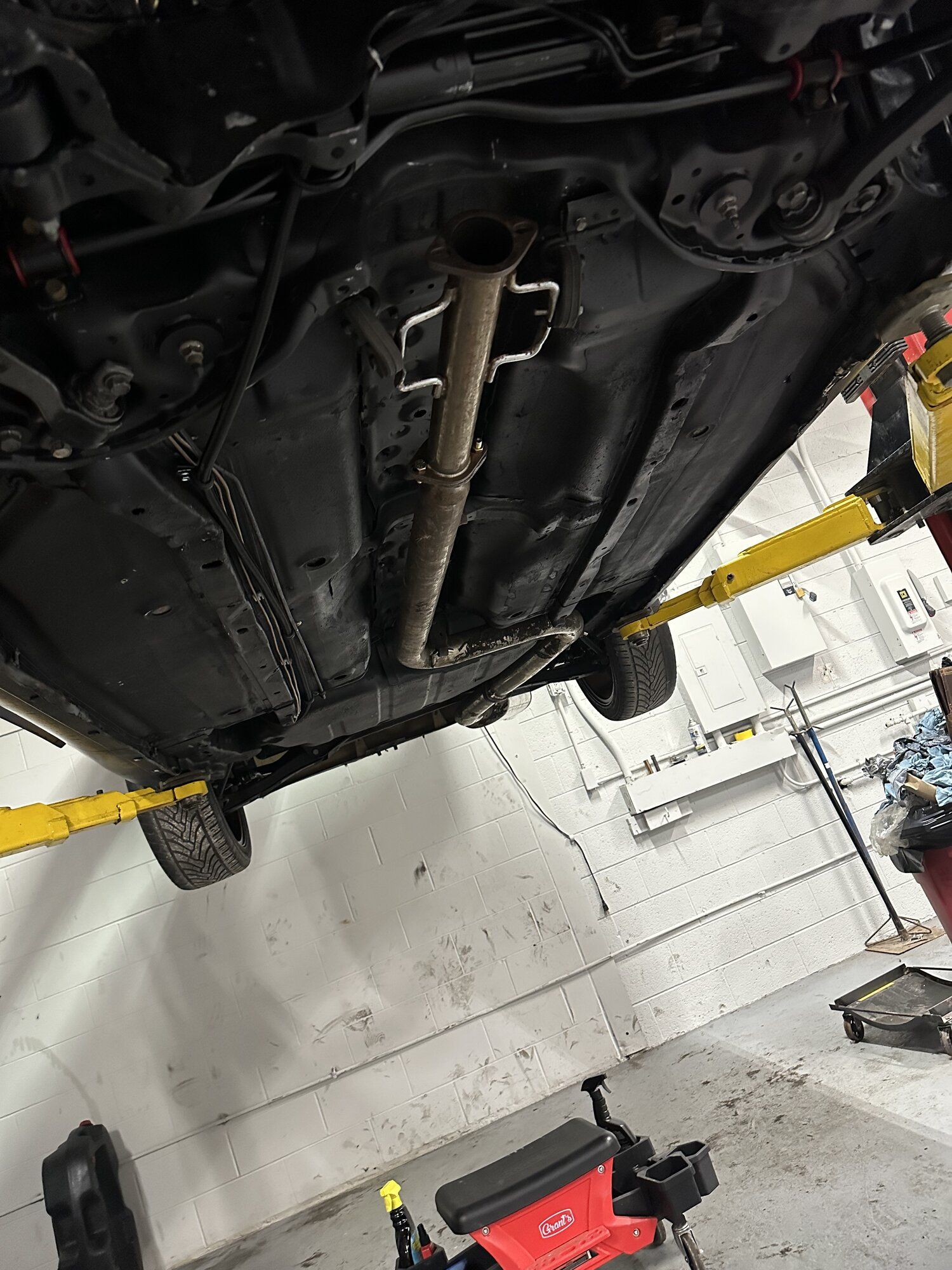

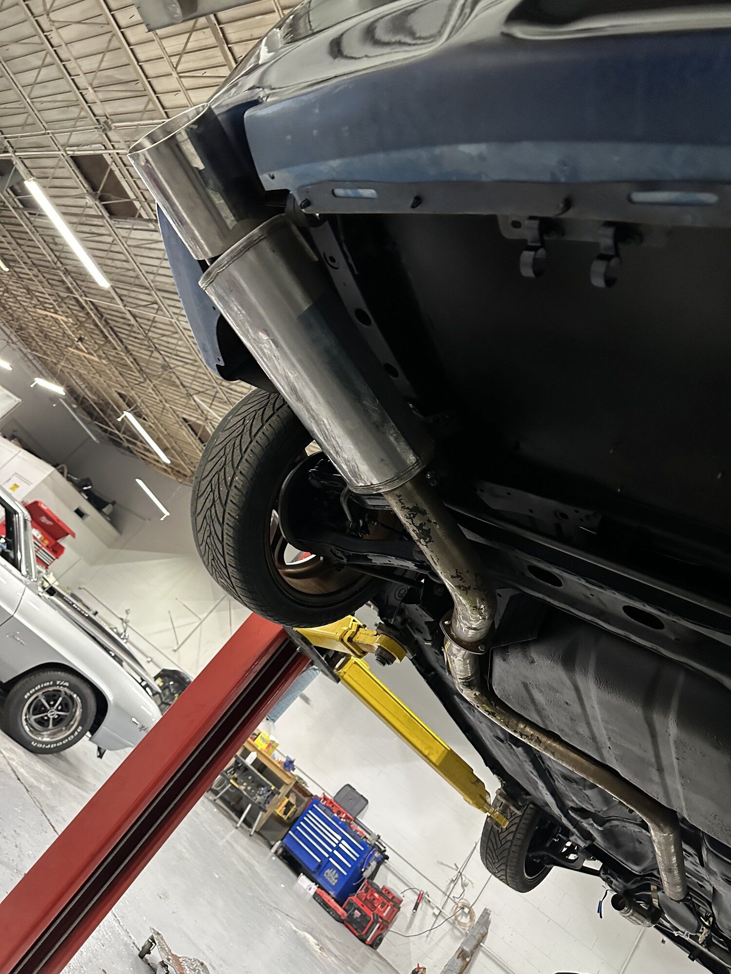

finally got the exhaust situated 🤟🏼

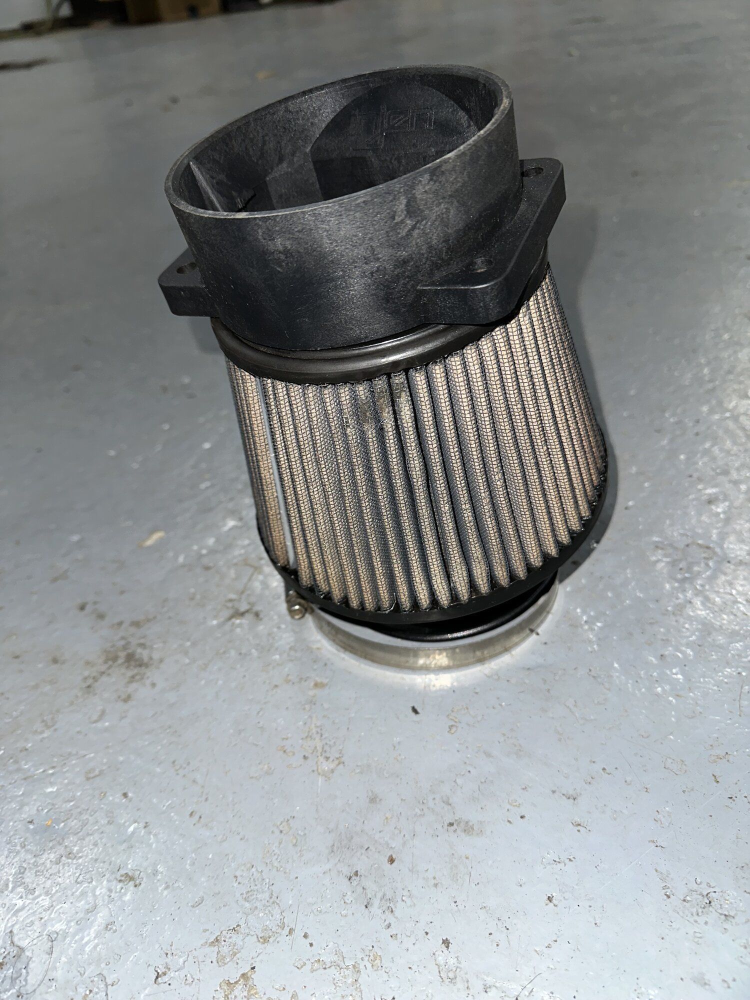

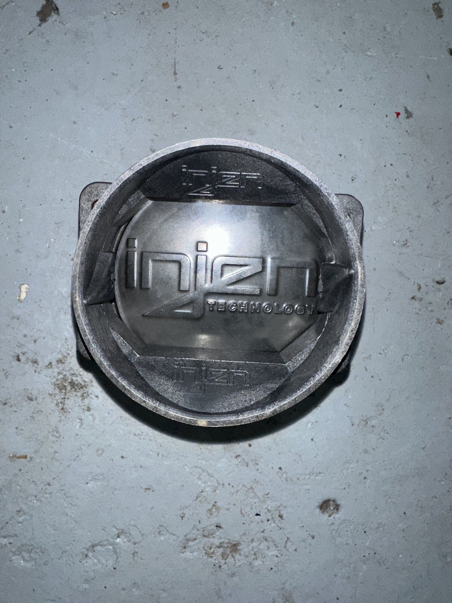

i was missing an air filter the bracket and a mass so for $30 i picked up this injen bracket and filter to match my injen fuze cover, im going to get the spark plug cover here soon. 🤟🏼

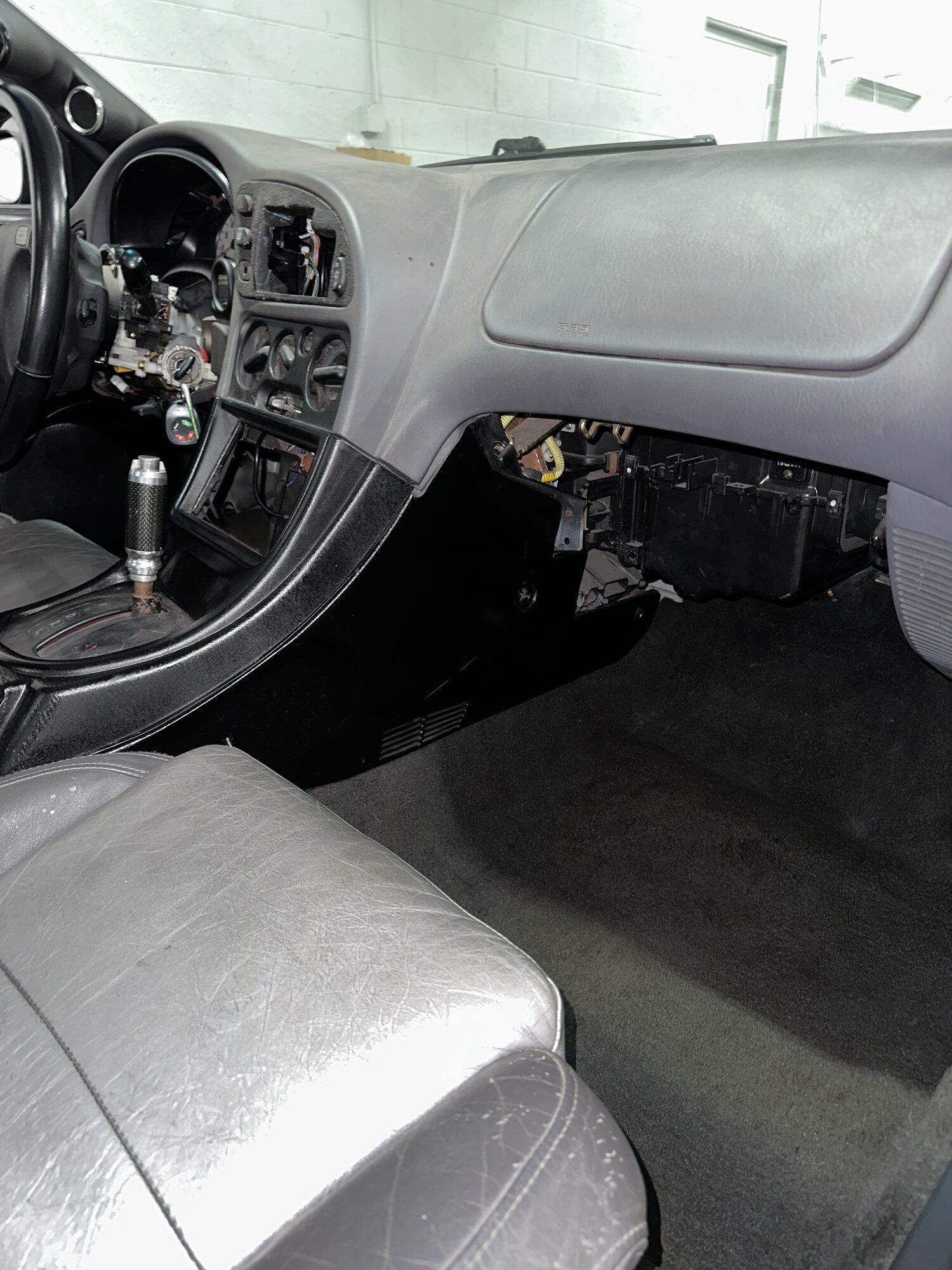

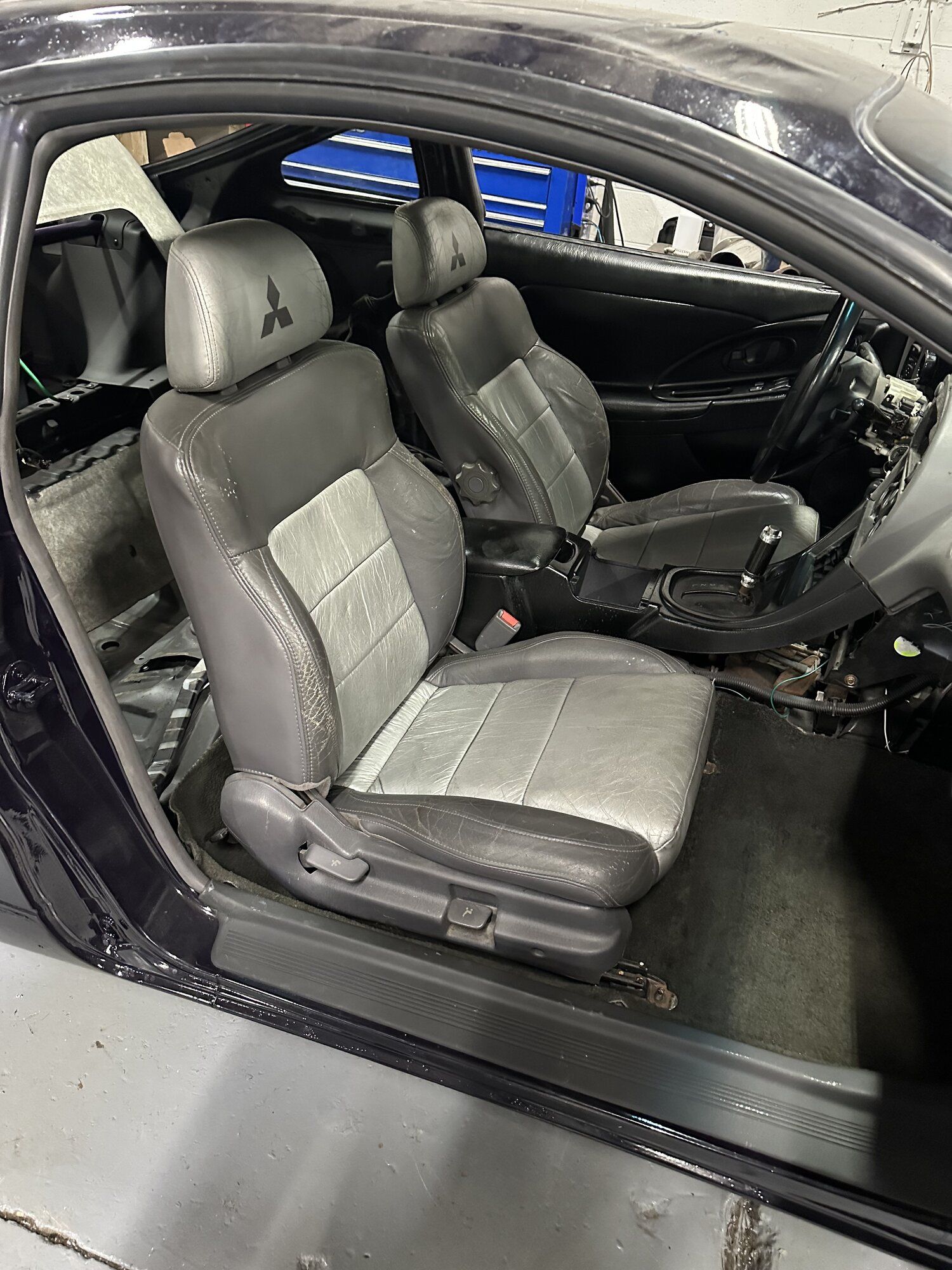

when i bought this i was told it was an old 90’s build and then sat in a garage for 12 years, obviously you cant believe much of what anyone says really, but a couple things got me believing it, this is the radio that came with the car, this is the song that was playing when we first got it to turn on. notice its even a cd 😂
also when we open up the glove box for the first time there was a ps2 all wired in.
under the car i noticed c clips for actual round led bars for underglow.
just alittle throwback
Damn, that's awesome. It's a time capsule and you can't beat that!

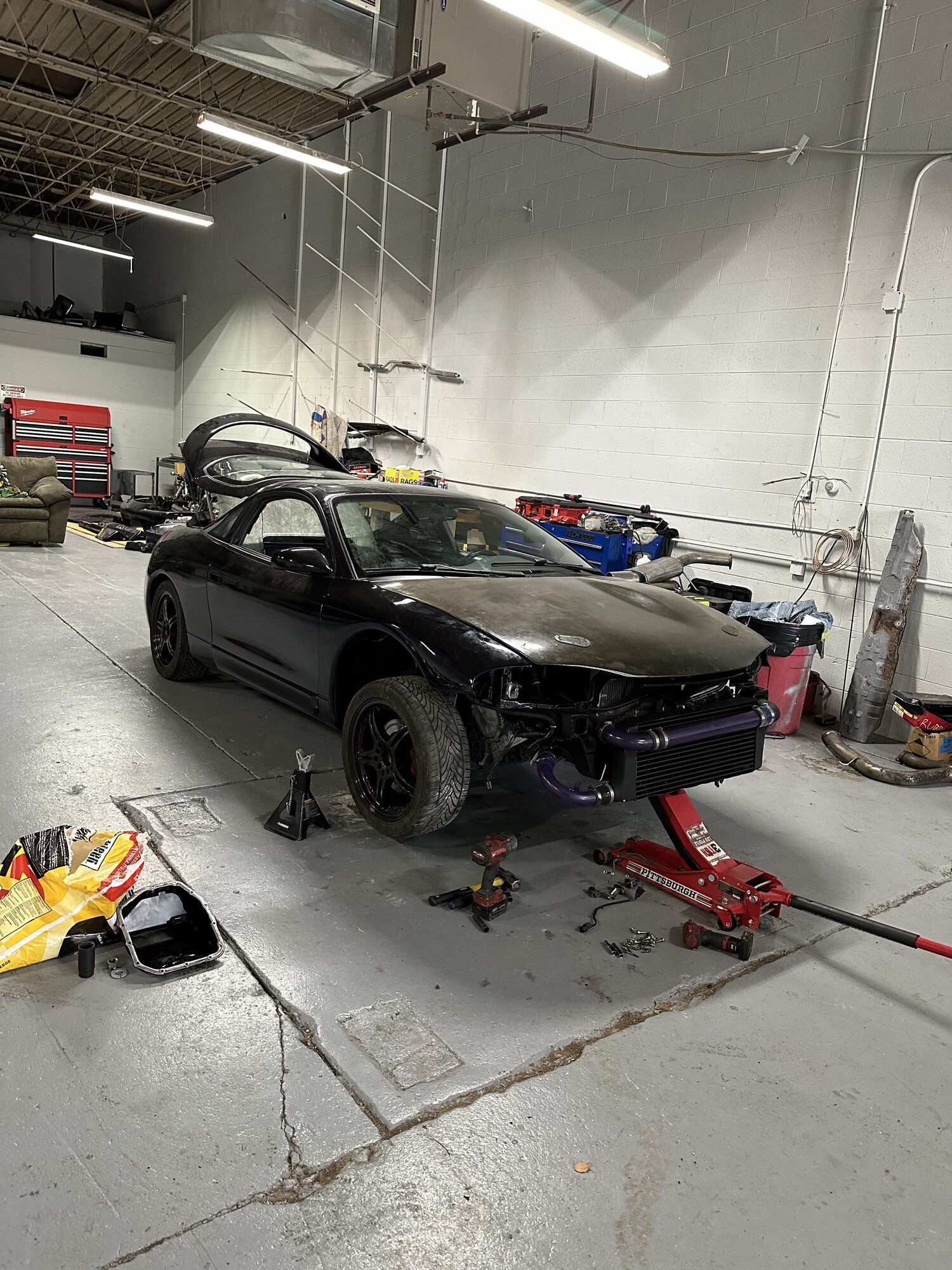

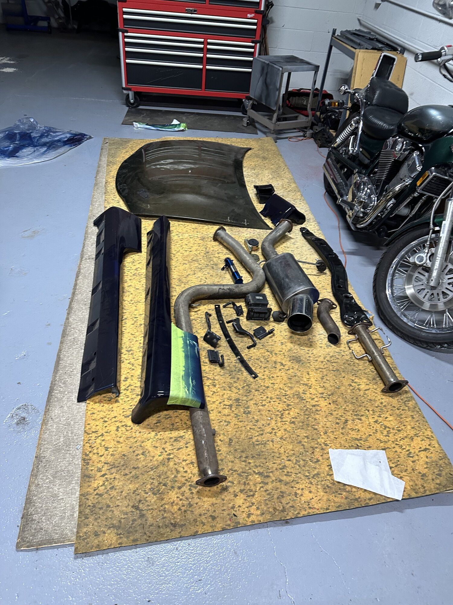

trans shop called, said everything in the first picture was fried. to bad i didnt dig this far into it myself.
with 5 transmissions laying around you forget which ones which. the red one was my talon, we had the trans cooler drop out on it while we were driving it, it lost all gears in less then a mile. thats the trans that i ended up using for my build and i didnt know til they called and said it was fried. so i will end up paying the trans shop to fix it up for me. now we play the waiting game 😕
