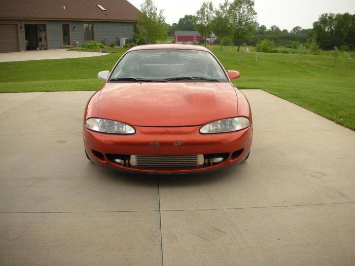

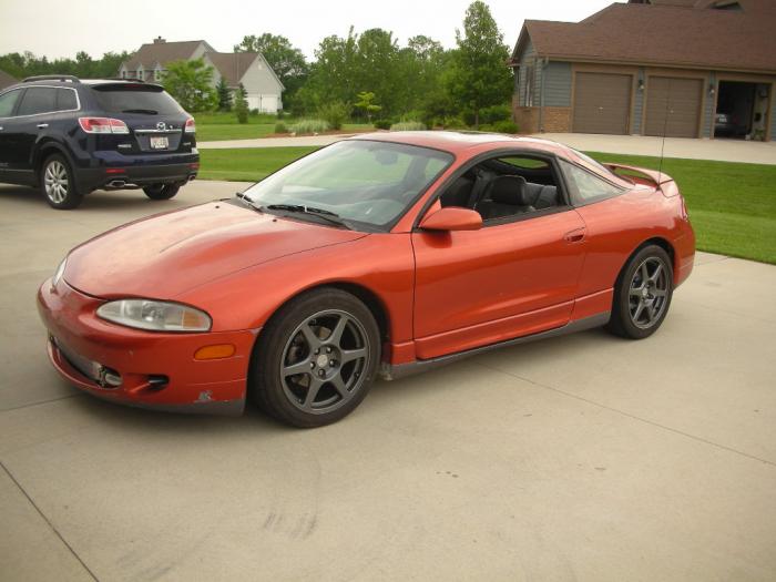

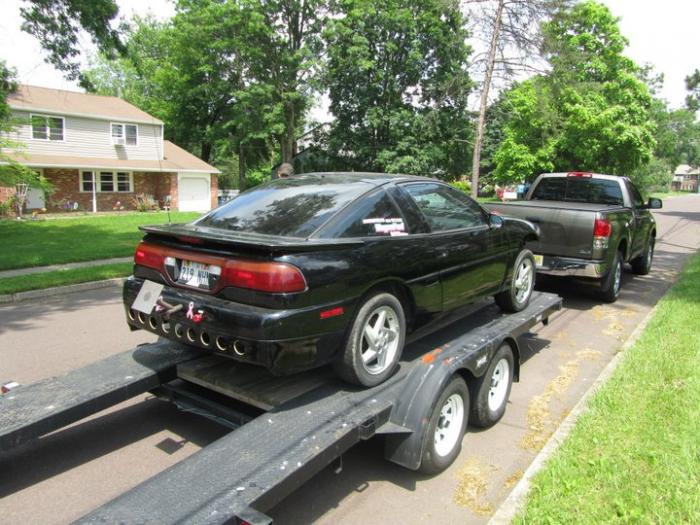

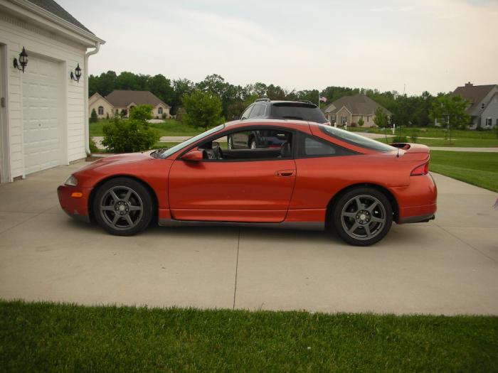

wouldnt the 1g gsx weight less then a 4 door saloon? i still woulda used the gsx for racing then the galant
Yes the Eclipse weighs less then the Galant and I bet its going to turn a corner better and have a higher top speed. But it also doesn't have a back seat and Steve's head hits the roof when he has his helmet on driving the Eclipse. So the Eclipse was not an option for us. I promise that I am doing my best to get that VR4 to go around a track as fast as I can.
It should be noted that the Galant VR4 has some advantages over the Eclipse. First is the chassis. Its much stiffer then the Eclipse and that lets the suspension do its job easier. The second area is cooling. The front of the Eclipse is a sucky design to get cold air into the radiator. As much as I tried running a frontmount wouldn't work for me. The VR4 has a both a fascia and a grill to bring cold air in. That means I can run a big frontmount and keep the car cool. I can't wait to see how much more power I can make through a big spearco on the Galant as compared to the Supra sidemount that's on the Eclipse. Maybe a little extra HP will offset the weight difference?
