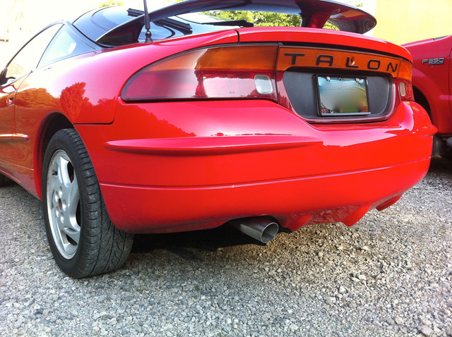

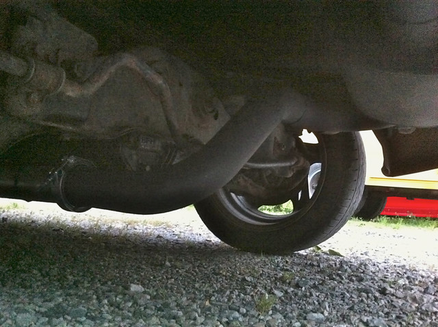

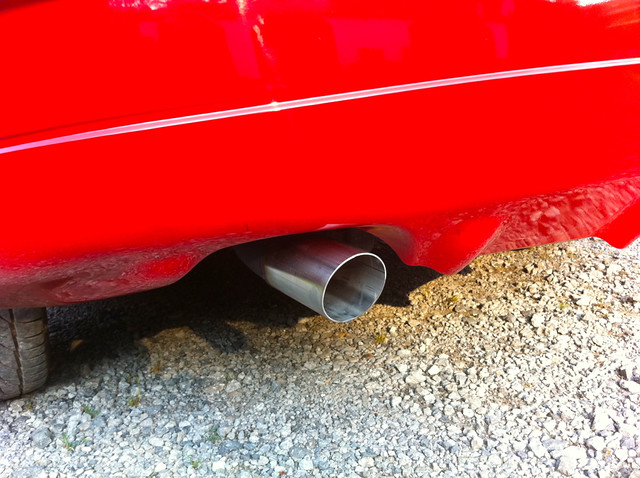

As you can see below here, I v-banded the exhaust at the rear diff for easier removal of the exhaust in sections when I need to work on things. I was able to add some more piping and ran it up and over to the passenger side and then mounted a Magnaflow muffler up where the spare tire hump used to be. Then there is some tailpipe and a 90 to go out of there to quiet it down a little bit without sacrificing flow. It sounds pretty good now too in my opinion... Then the other two pics you can see how the tailpipe/tip sticks out... Gives it more of a stock appearance than having some big exhaust hanging right there for everyone to see... Oh and of course I did all the piping and muffler in a high temp flat black even though it was stainless...
