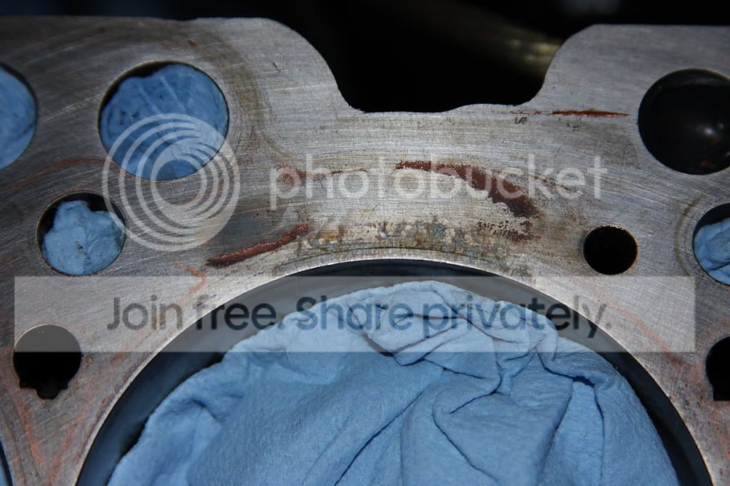

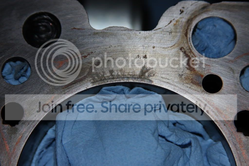

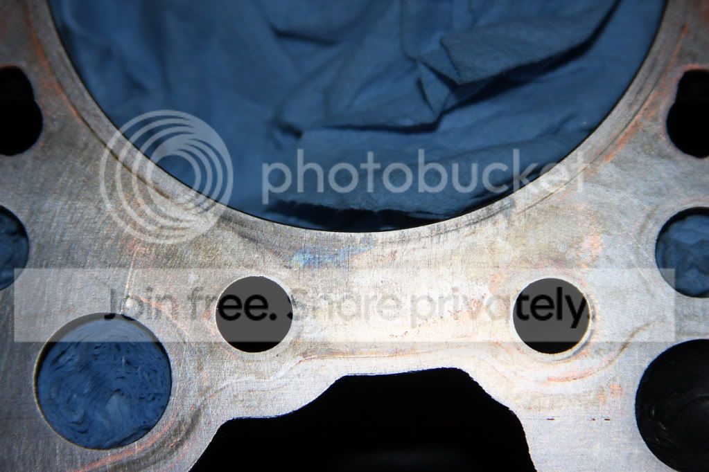

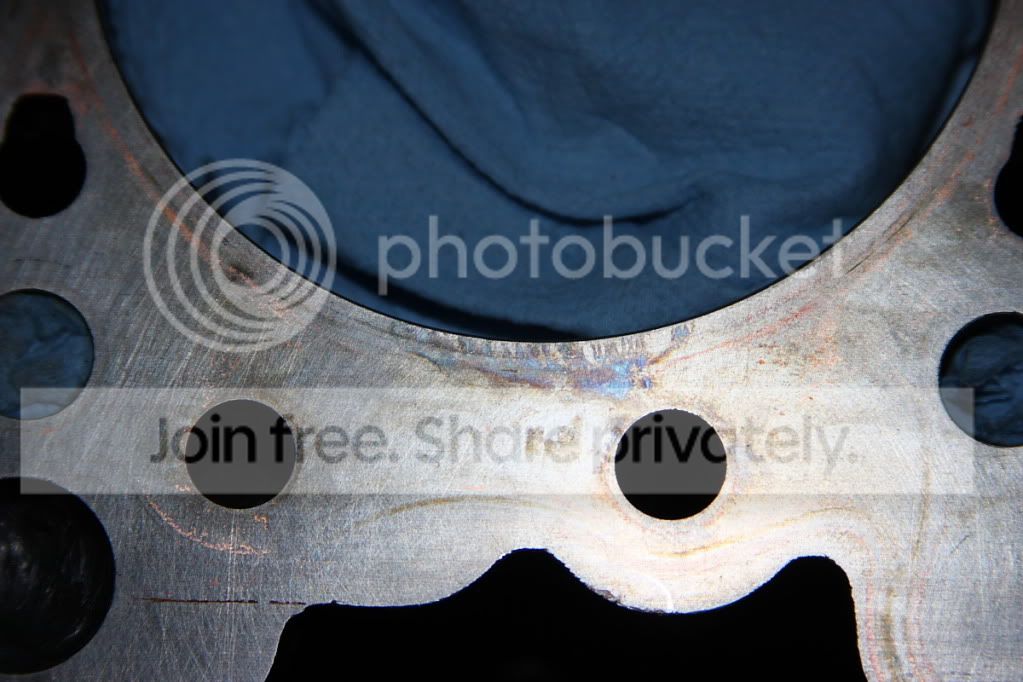

Once I got the deck cleaned up to start lapping I noticed that the gasket actually failed in 4 spots, the worst of them being on cylinder 2 at the front of the block. Both cylinders 2 and 3 failed directly in front and in back of the cylinder:

I then lapped the block with 800 grit until the scarring from the gasket failure was no longer visible and the deck surface was clean and mirror-like.

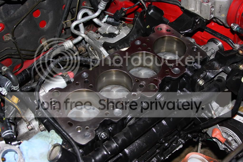

I had ordered another 87mm 0.066" thick gasket from Cometic and it was finally time to assemble it. I put a couple light coats of the Hylomar spray on it, but I really didn't like how this stuff goes on. It sprays quite uneven, like a silicone spackle.
I bolted the head down and noticed a slight amount of the Hylomar pushed out along the gasket edge. I didn't like how it looked and wanted to make sure it didn't find its way into any of the coolant/oil ports so the head came back off. I probably put too much on but practically all of the Hylomar had moved away from the flat surfaces and into the coolant/oil feed ports. The flat parts of the gasket were solid black and nearly free of any Hylomar... If I were to use this stuff again I would only put a very light single-coat "spackle" on the gasket.
