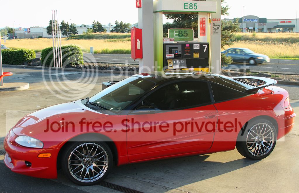

I drove it up to Pacific Raceways this last weekend for a road-worthiness test and it performed flawlessly. Going up in the morning when it was cool it ran a constant 165-170F. Coming back going down the highway at 70mph, with 90F temps and the AC blasting on full, coolant temps stayed between 183F-190F. Not bad for a stock radiator 2g with a big FMIC!
Ducting FTW.
It made the 300 mile round trip with no issues and managed 21mpg on E85.

Ducting FTW.It made the 300 mile round trip with no issues and managed 21mpg on E85.
