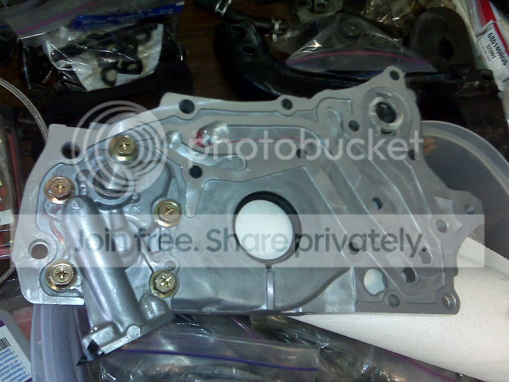

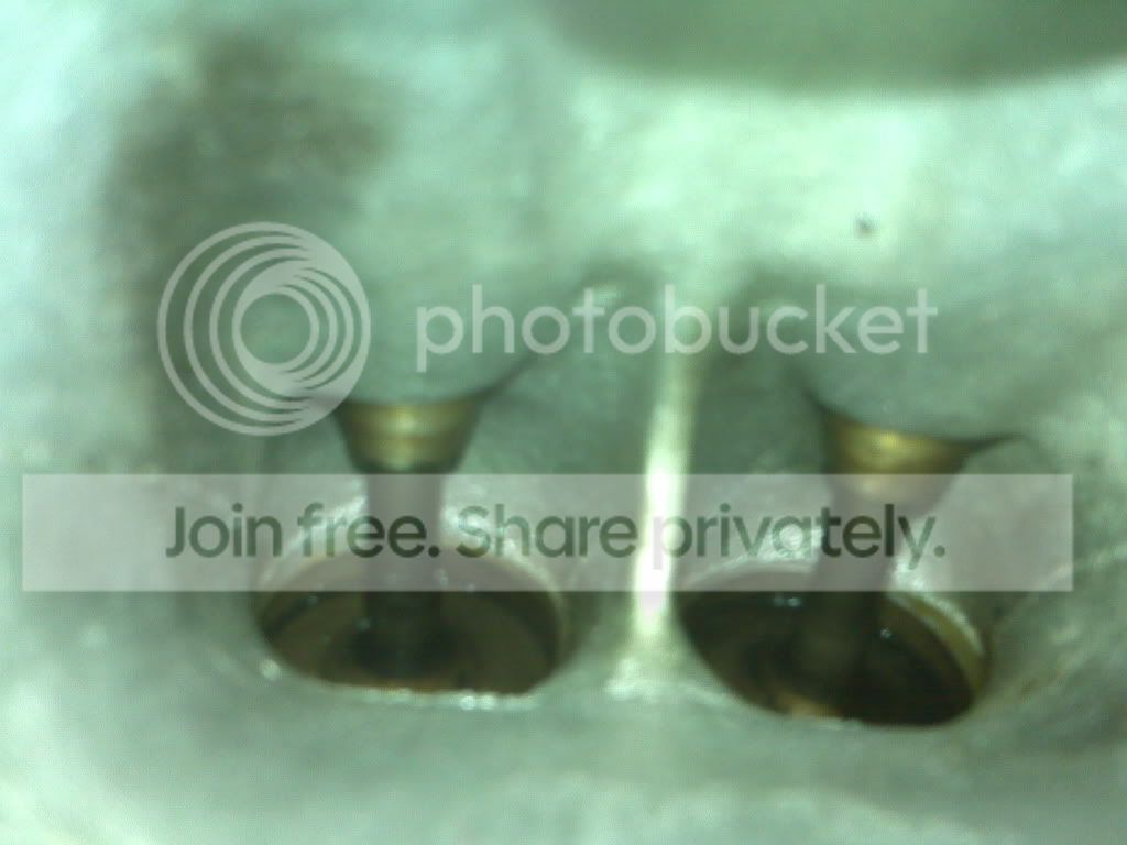

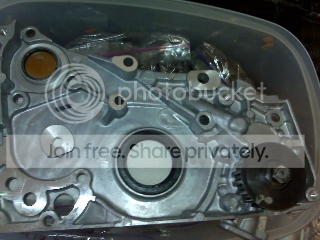

Ok well the motor would be running by now but im waiting on the pistons, rods, rings, and bearings from dsmgrave. Anyways i put the oil pump together, Used an OEM kit form slowboy. Filled the oil pump with white lithium and a Assembly lube. Installed new castle plug also. I also got some pics of the head has new bronze valve guides, vitton valve seal, and a little port work. eveything else was checked and re used stock valves and springs.

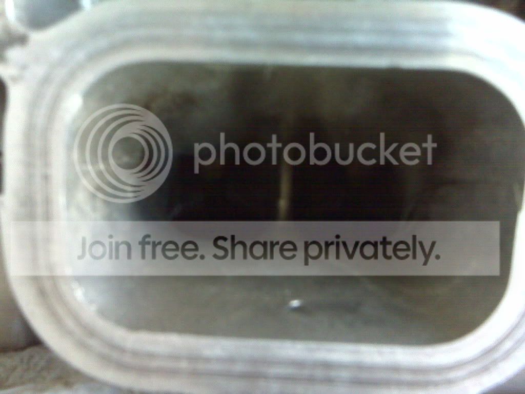

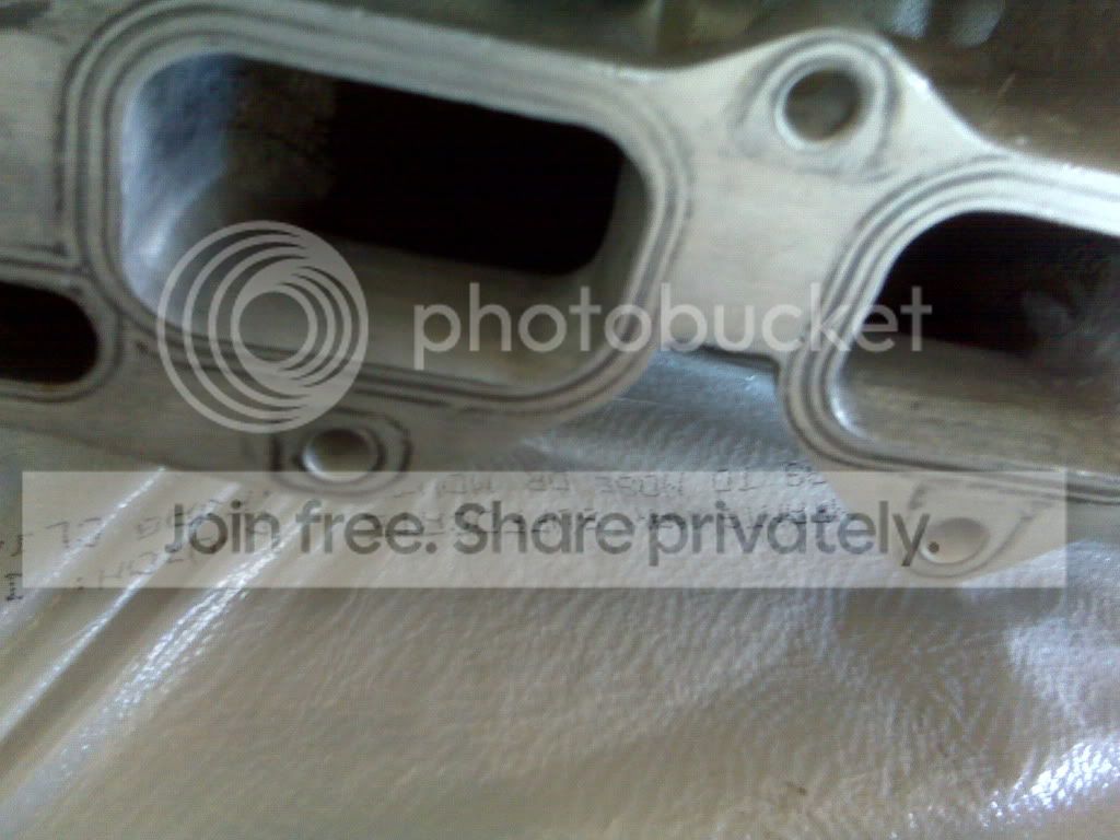

Also the 1g manifold was previously extrude honed. lucky me:thumb:
