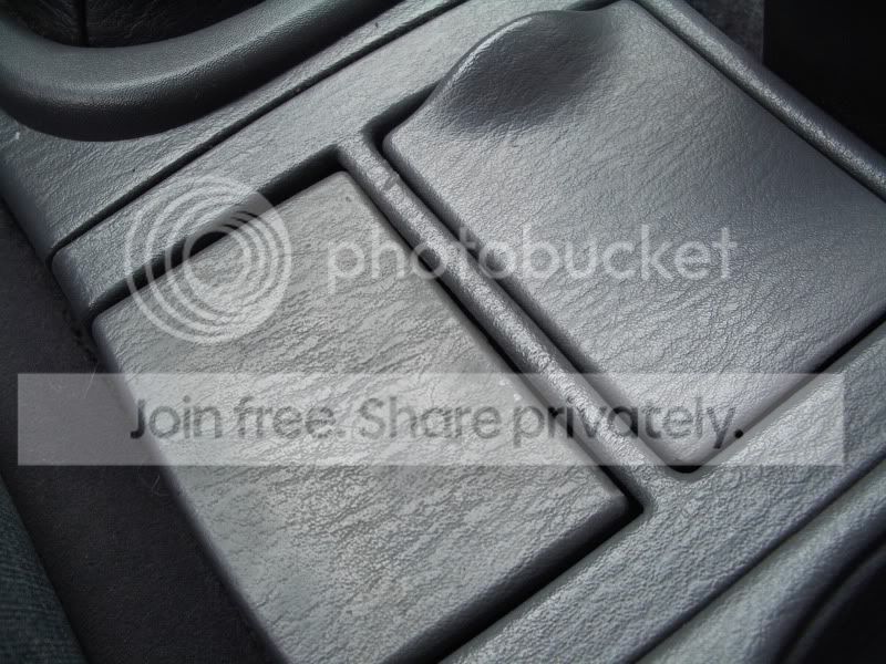

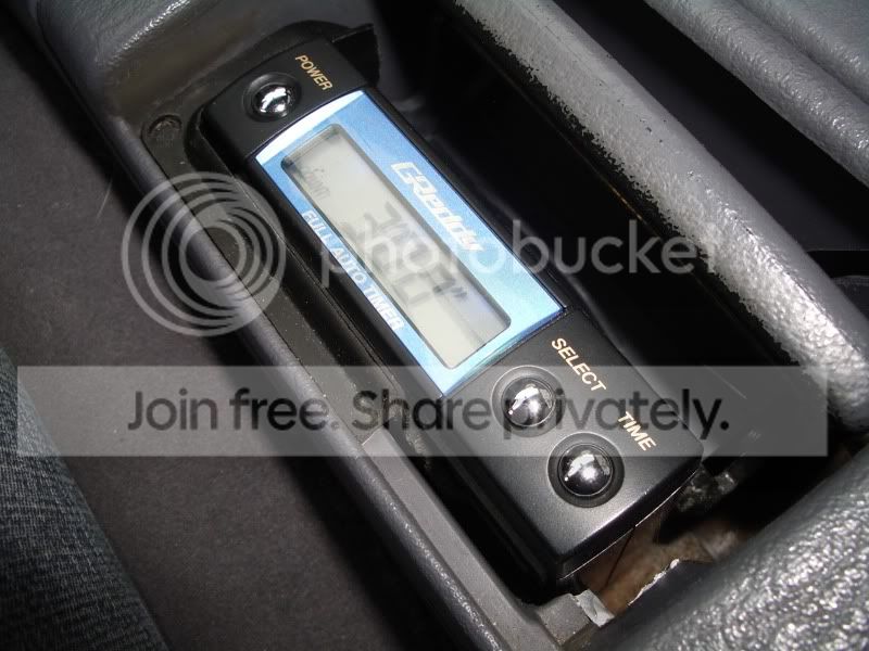

Got my turbo timer installed. The ash tray made a perfect hiding spot, especially because I'm trying to quit smoking again.
Now you see it.
Now you don't.

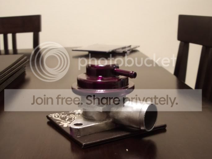

Cleaned up and painted my 1G CBV/BOV.

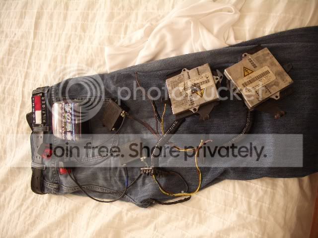

Lastly, traded some parts to get some Bosch AL Gen 2 ballasts and D2S bulbs for my HID retro to go with the Eclipse front.
Nice to see someone still rockin the tommy jeans, LOL... looking good bro!
I like that turbo timer install. I might have to steal it.
diddo on that! i have been trying to figure out where to install mine thats not gonna look ugly!

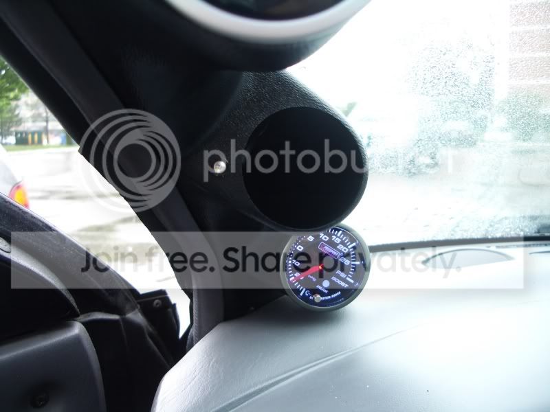

most of my gauges are crooked so that when everything is 'Normal' the needle is vertical. It make it really easy to see if your over boosting overheating loosing oil pressure ect.. without having to read the numbers. I started doing that just for track days and eventually never changed back.
haha i was going to throw in a tommy jeans comment too.
I was going to tuck my turbo timer in that same spot in my laser! I like to conceal things like that when I can.
Also I like the idea of the gauges, i'll definitely have to use that.
