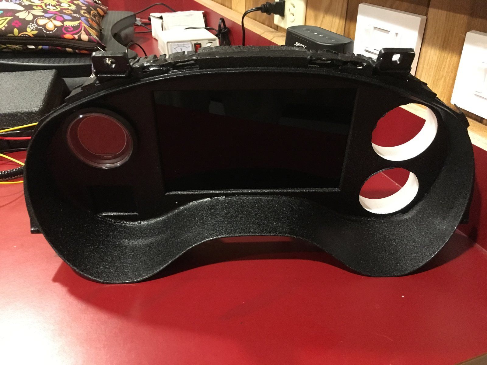

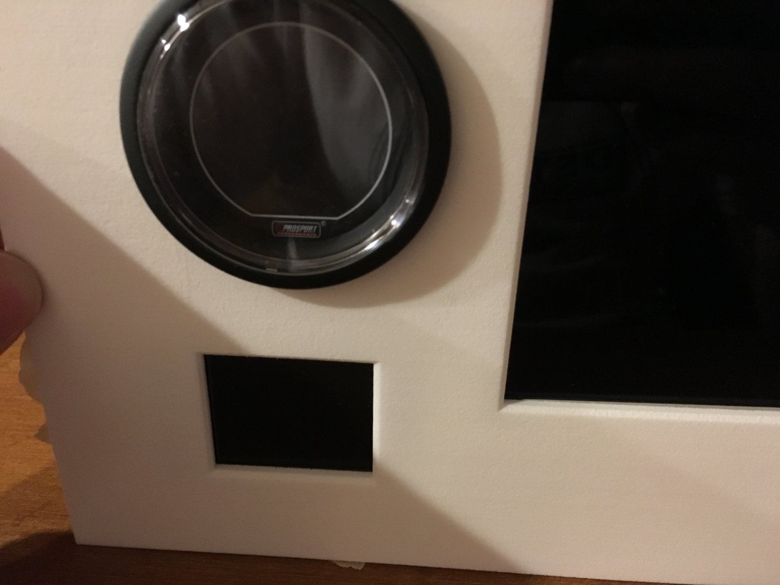

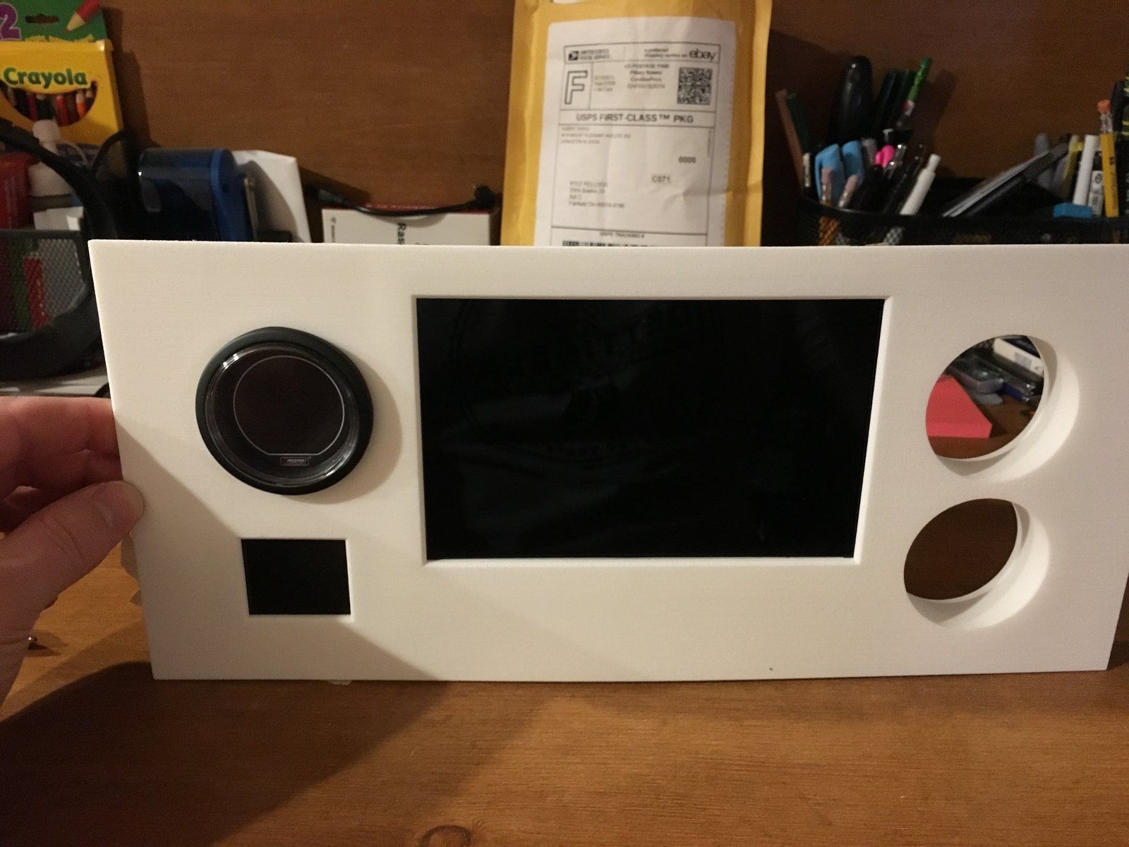

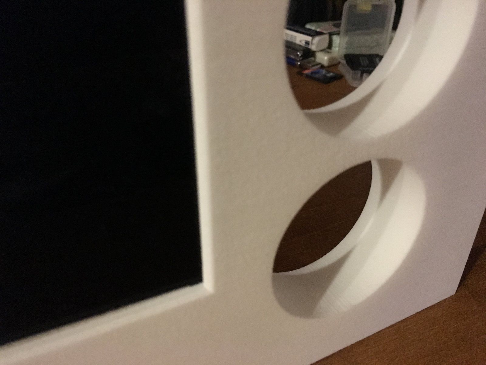

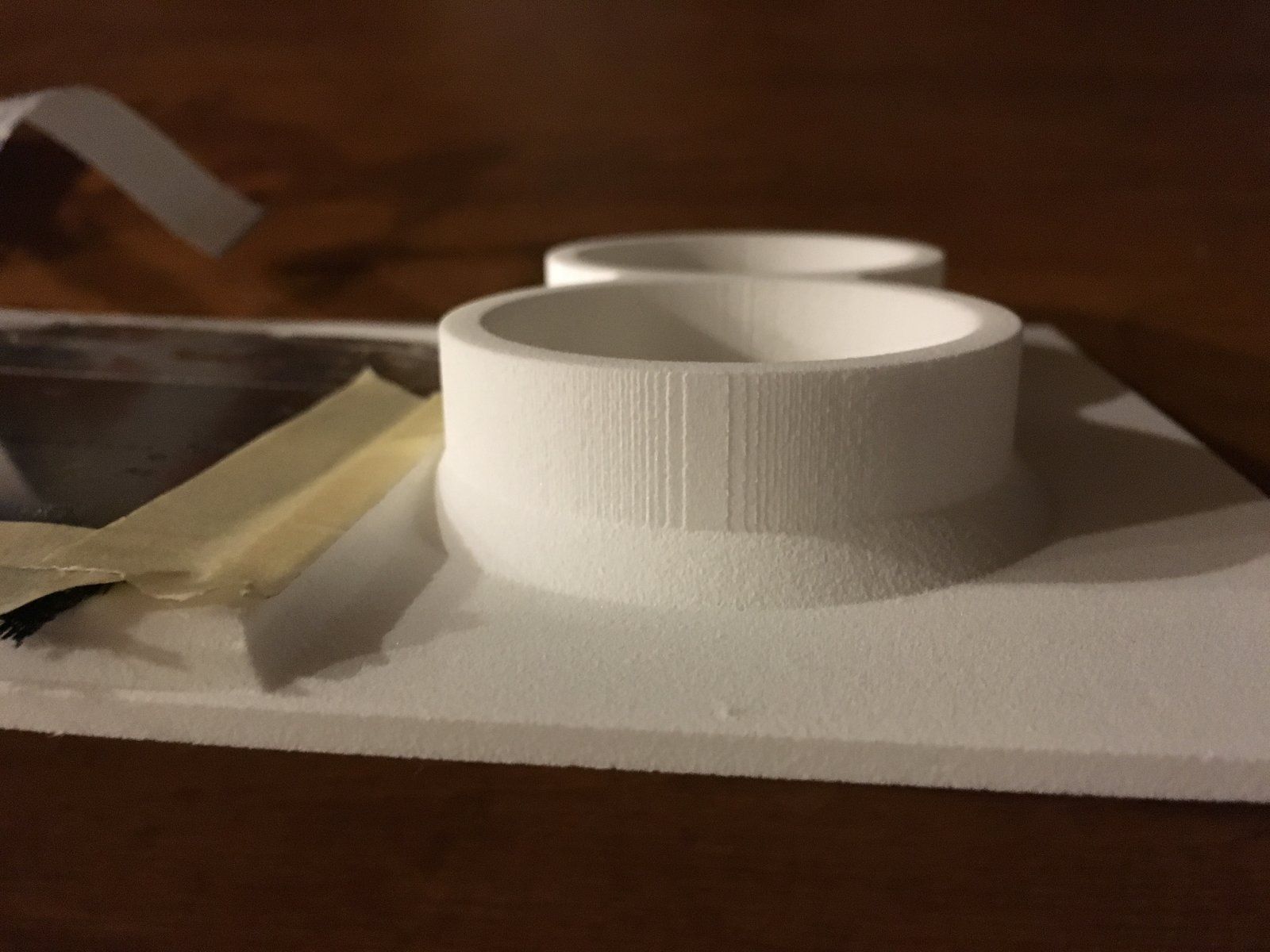

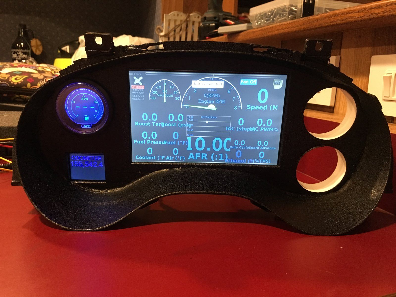

Here it is!!! The 3D printed bezel came in. Still need to trim the outside to fit the curvature of the 2g bezel.
Also need to finish up coding the small screen. It's run by an arduino uno. Currently it's just displaying the images and text. It will turn the turn signals/high beams on/off and serve as the odometer.
Other 2 gauges will be egt and oil pressure which are still in the car currently. Nice to see the project starting to come together. It's been a pile of parts for a while!!

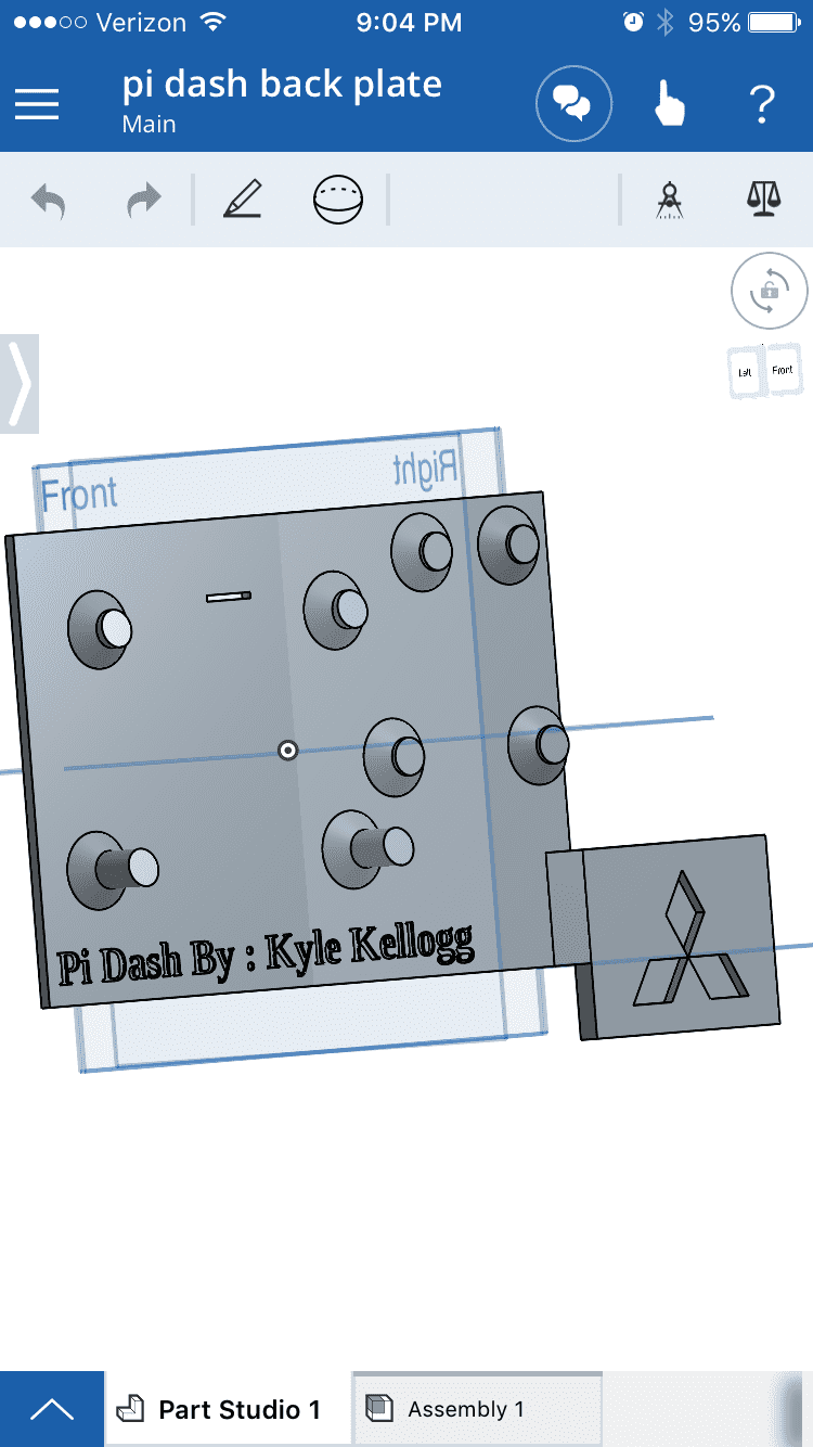

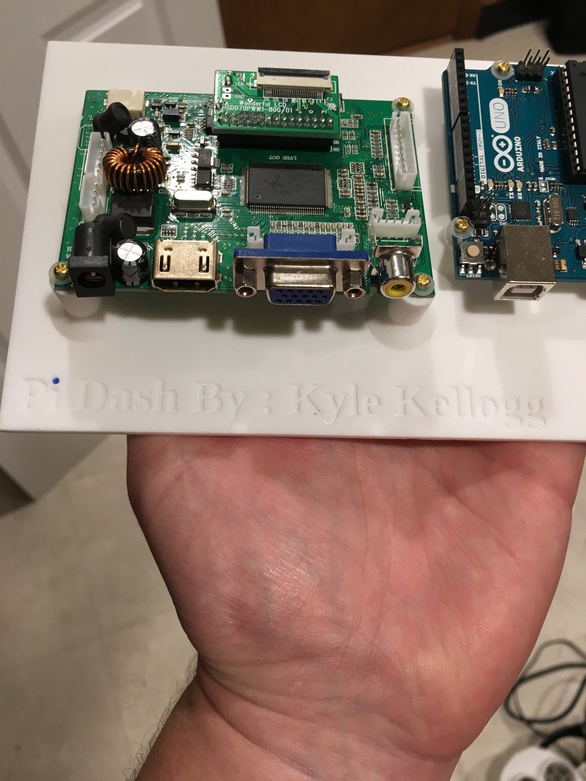

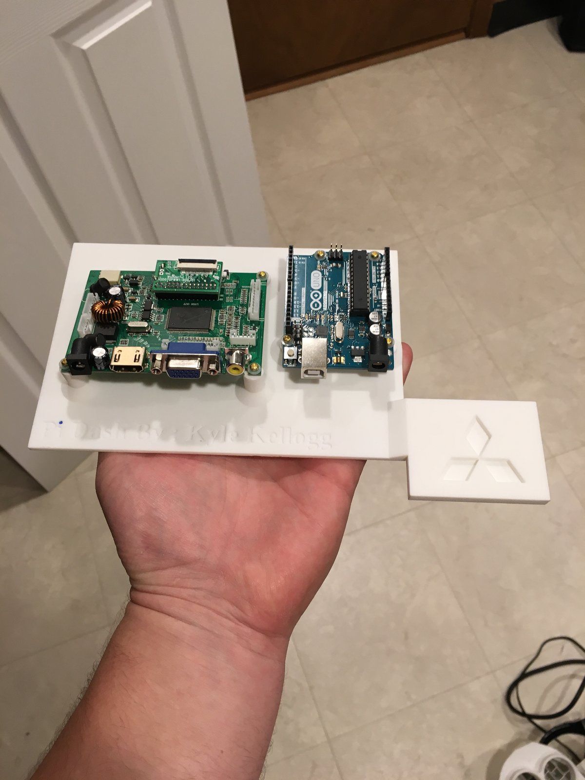

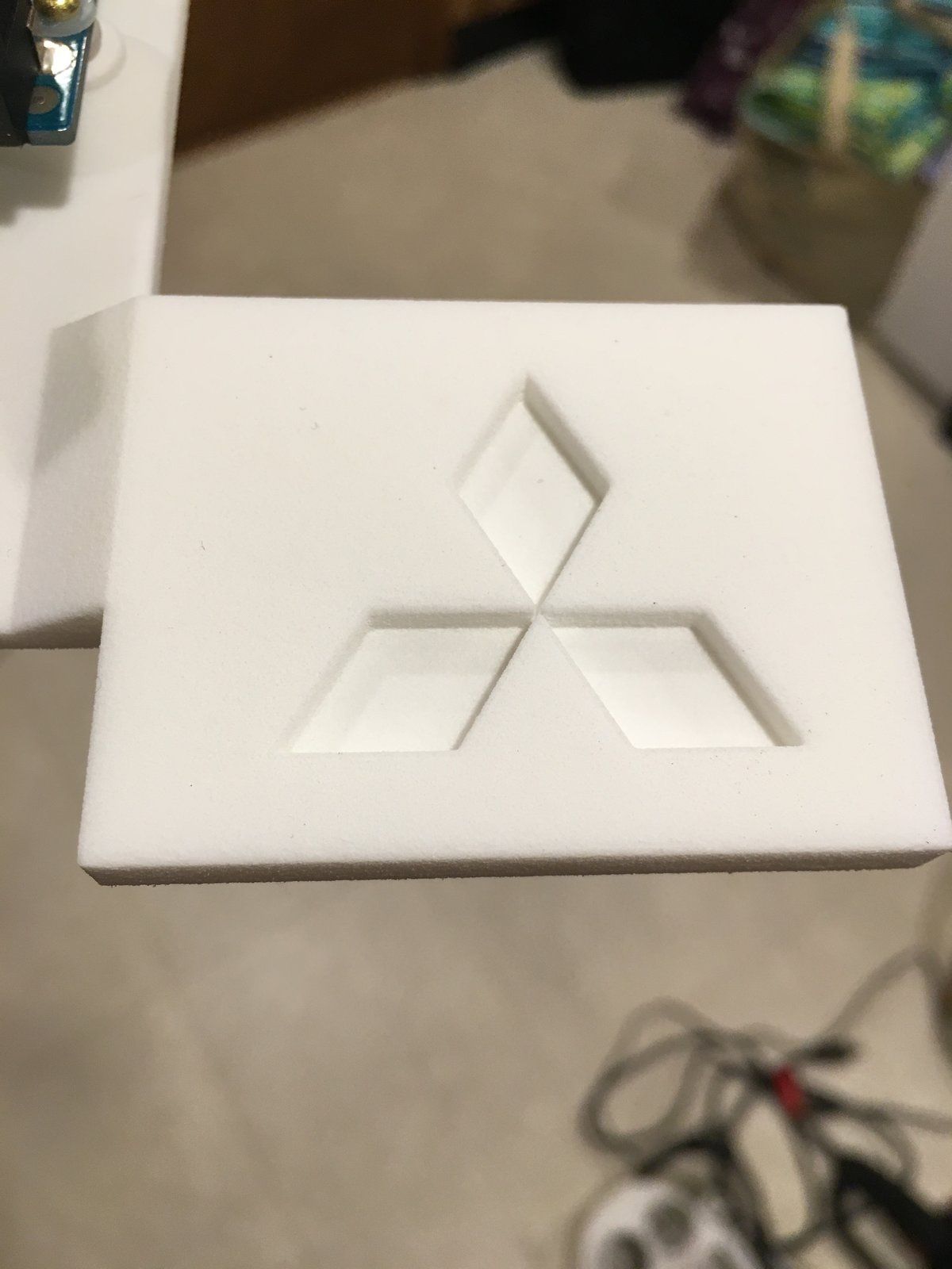

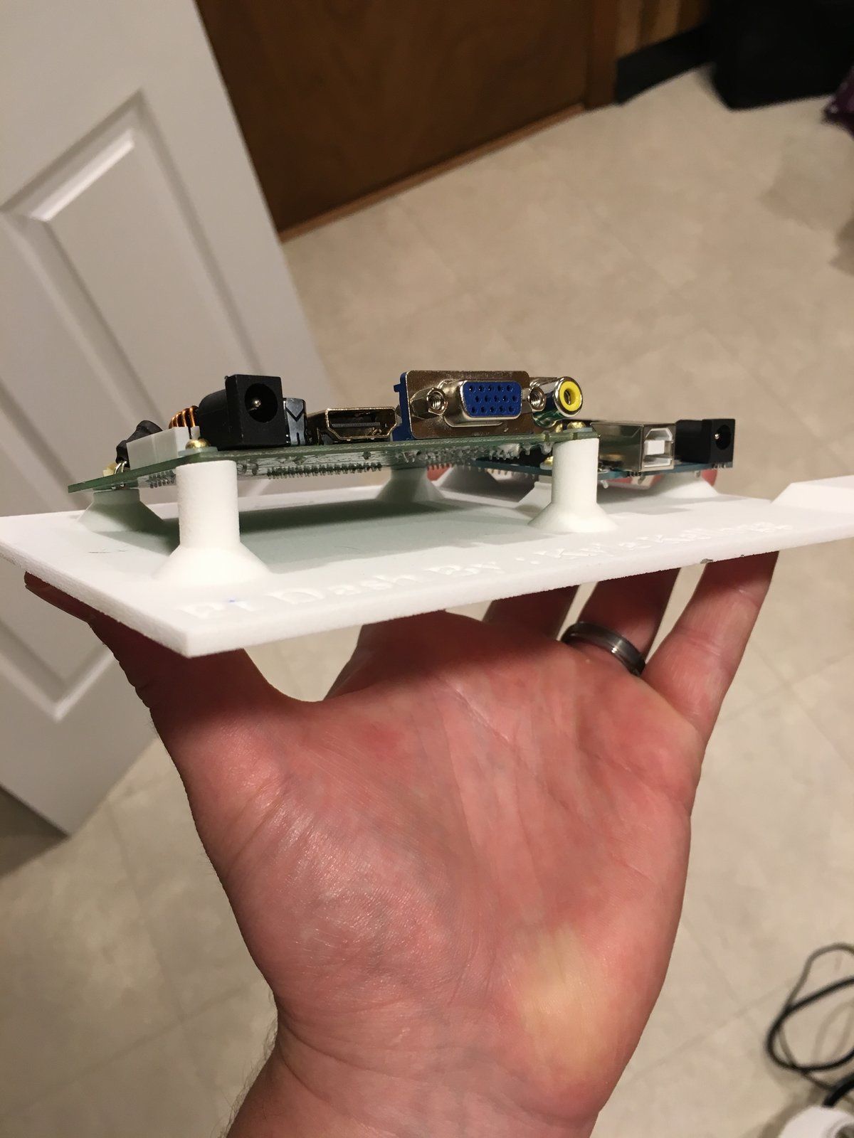

Designed the back panel tonight. This is the piece that will secure the 2 screens and has standoff for the lcd driver for the 7" screen and stand offs for the arduino. The raspberry pi will be mounted remotely in the dash as there was not much room. Added a few small details as well that you will never see when it's installed but I think it's a neat feature.
Submitted it tonight to shapeways so it should start printing tomorrow. Should have it in 1.5-2 weeks. Gives me some time to finish the code on the arduino for the turn signals, high beams and odometer.

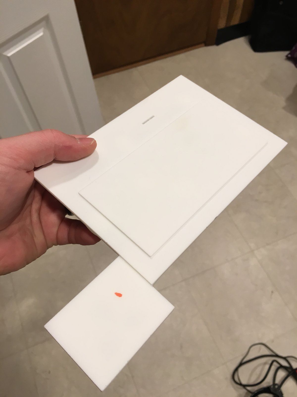

Got the back plate in Friday and fit the lcd driver and arduino uno to it. I also started cutting down the main plate shown above to get it to fit into the stock cluster. Will post pics once I get it mocked up. Here's the back plate though.
This is pretty sweet man, i really like that center pod replacememt! Well done for that as its brilliant!!! Keep up the great work your doing

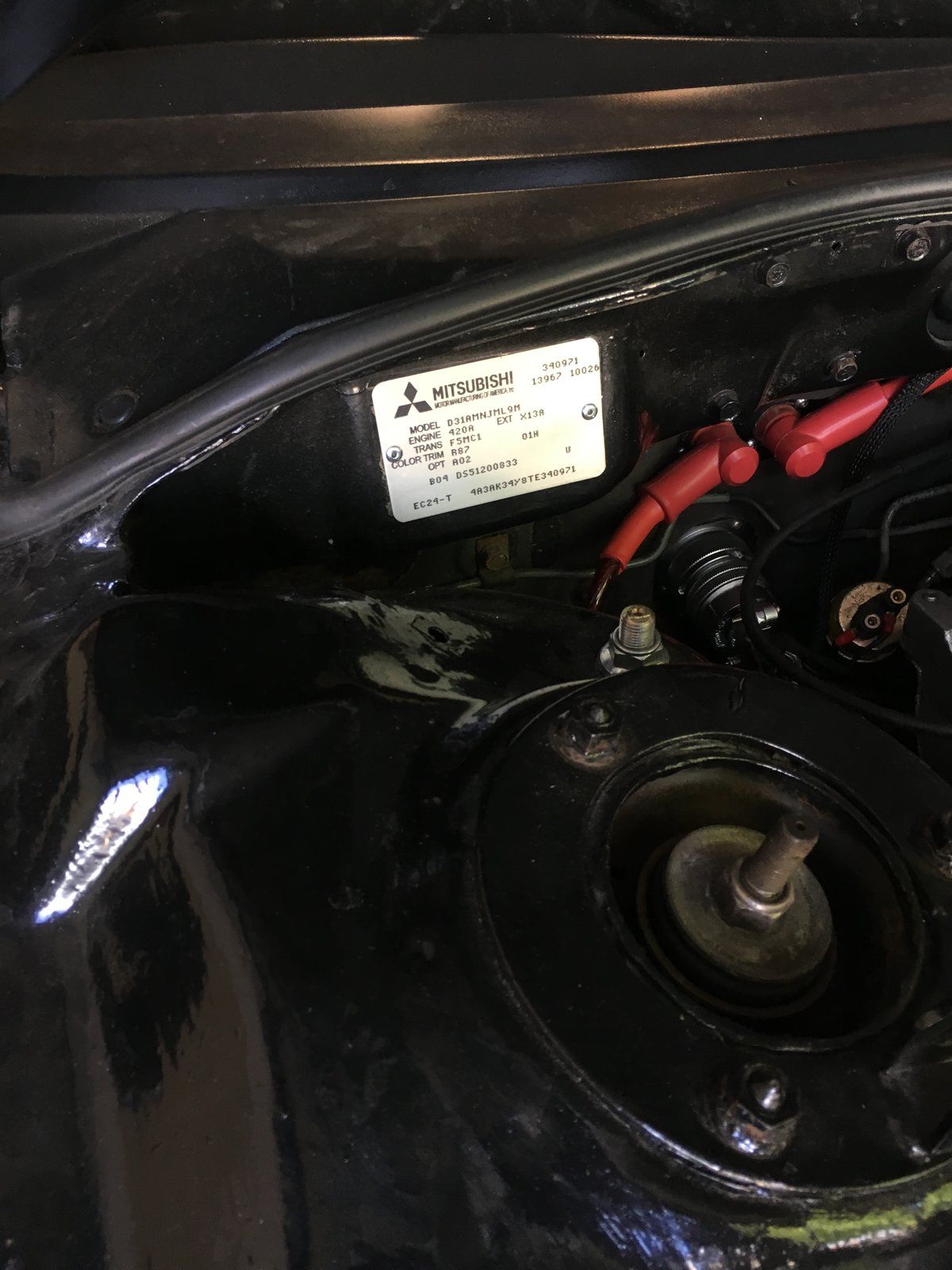

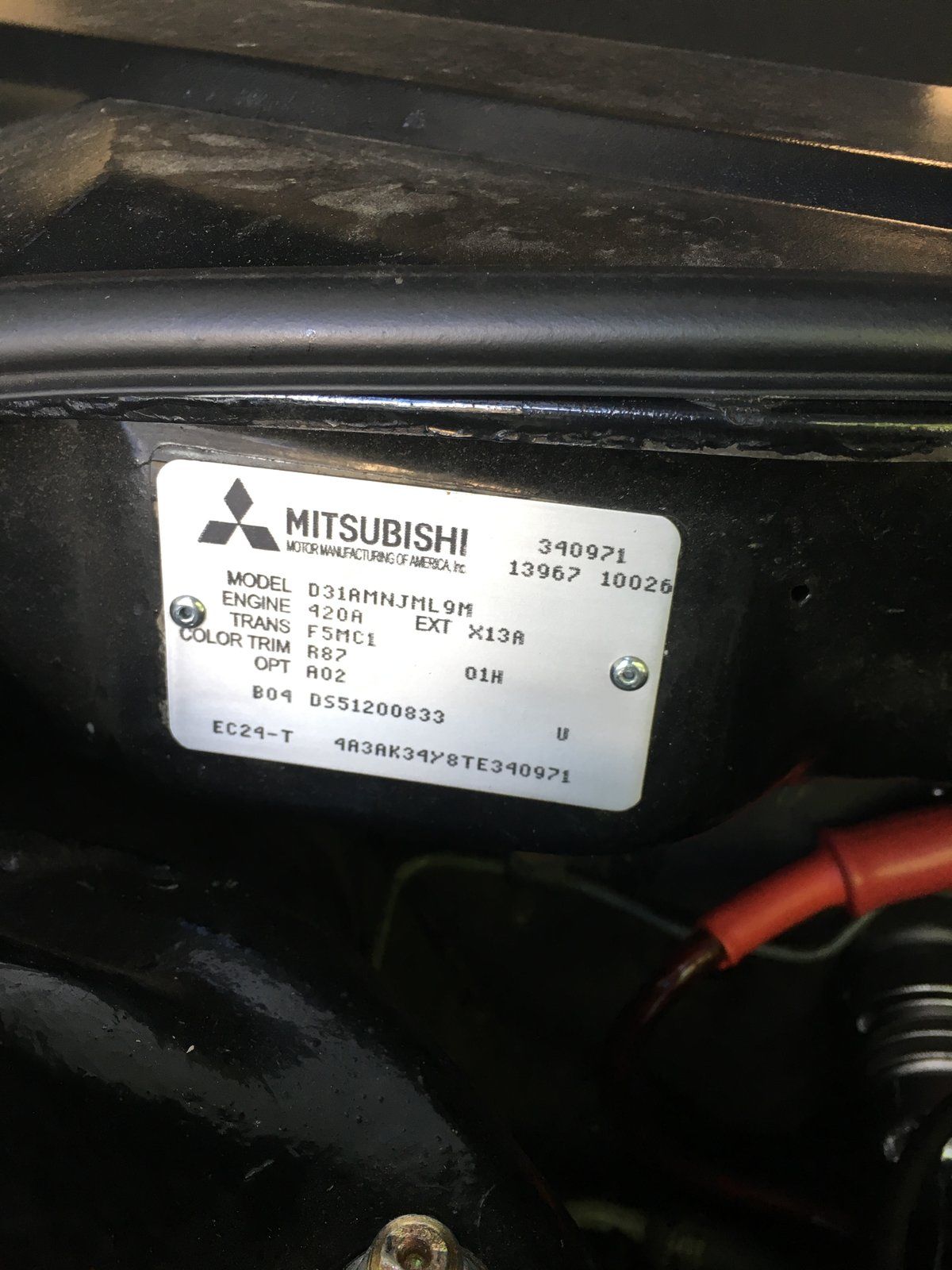

Well I had some time today to work on the dash, install my b&m shifter and got my vin plate installed.
I had an eBay short throw shifter in for many years. I can't believe how much smoother and solid the b&m shifter is over the eBay one. I'm very lucky to have grabbed up one of these.

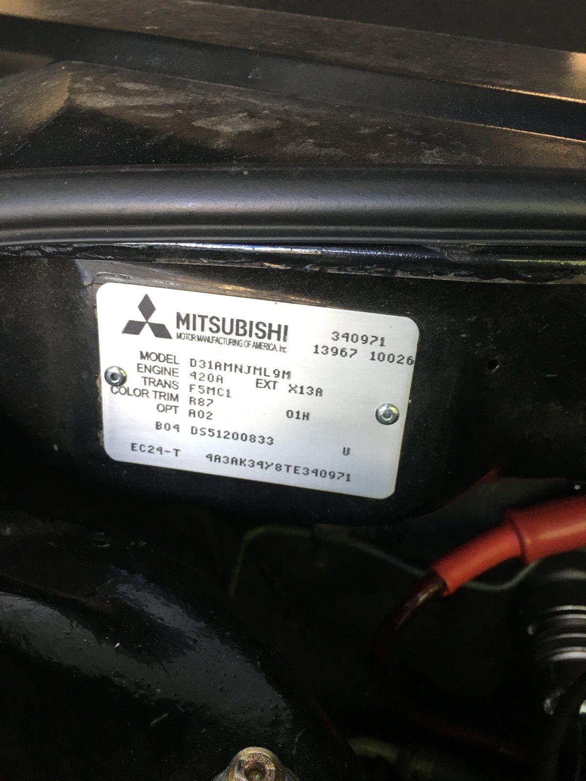

Here's the vin plate installed. Man the little things can make such a difference.
I

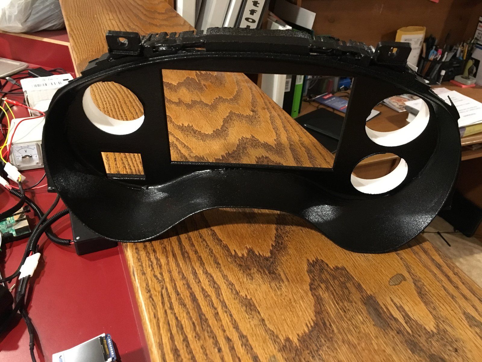

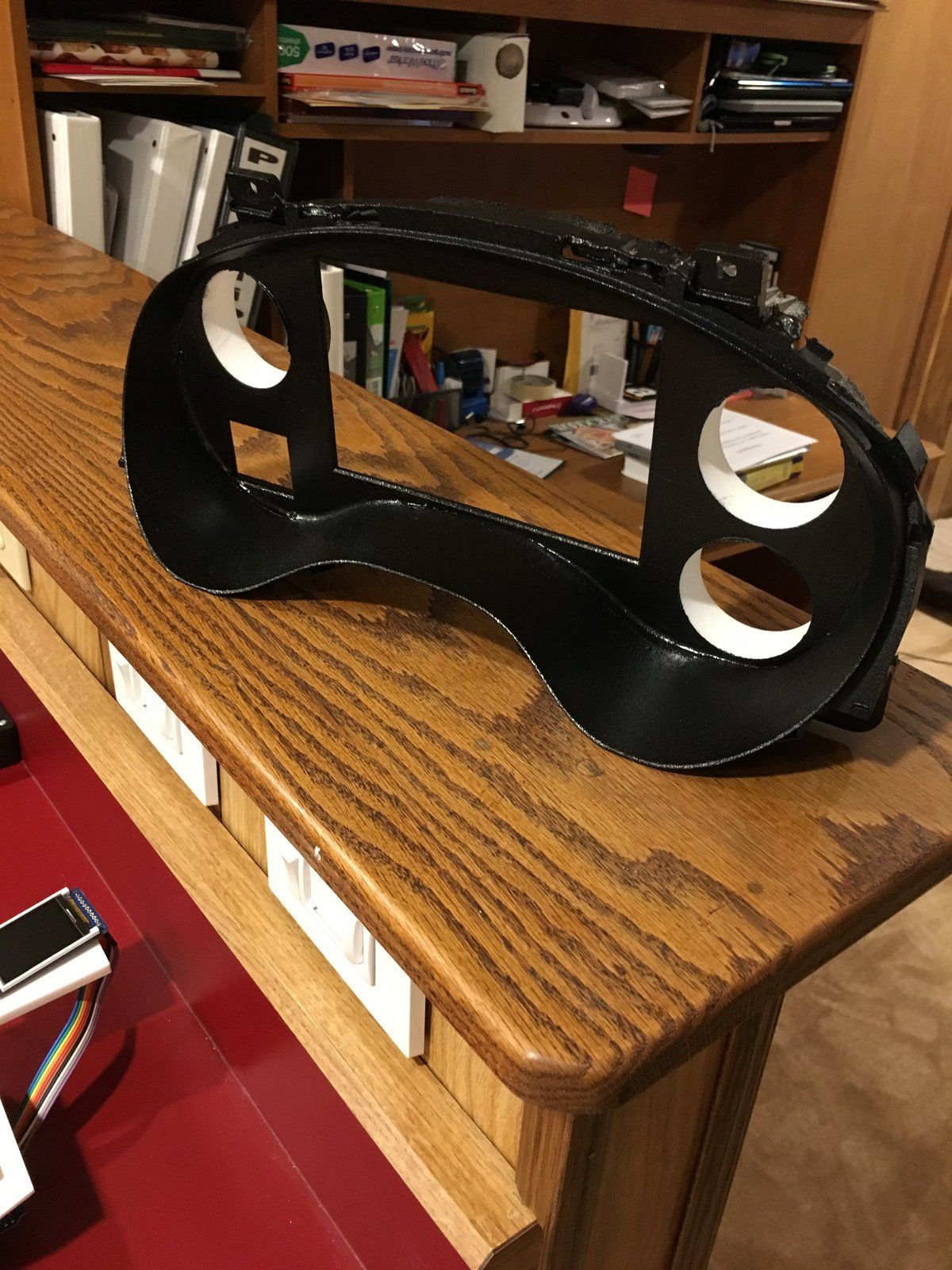

Got a chance to get the bezel installed on the oem trim. I ended up hacking up the back most white part of the gauge assembly to retain the stock mounting holes. Gotta love jb plastiweld. Painted it using truck bed liner to give it the texture.
Looks great, really nice going. How did you get the main screen to read all the functions of the car?

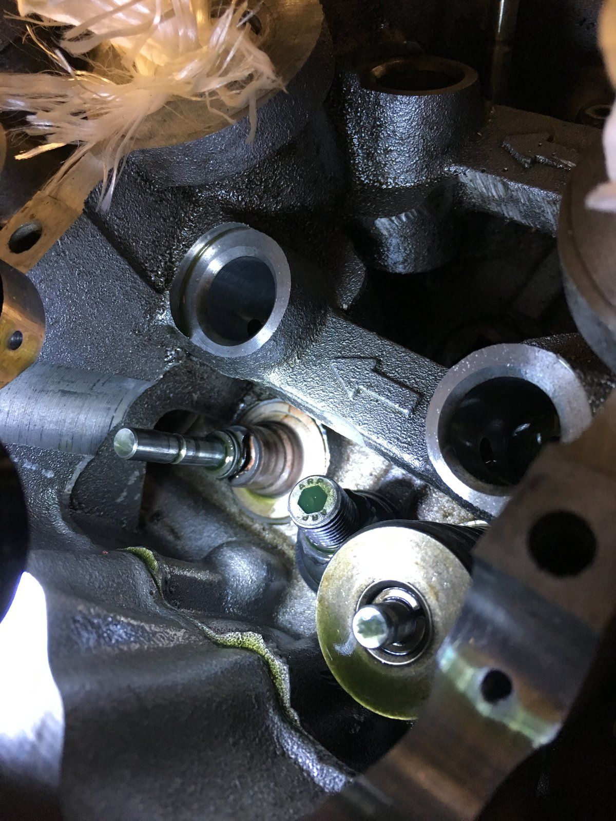

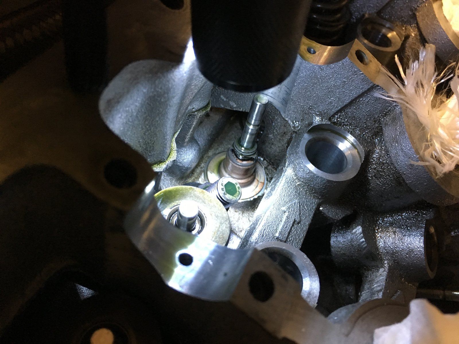

Well work and school have been insane recently. For a few months now the car has been burning some oil. I suspected valve stem seals since it really only showed signs at start up and idle. I have been super busy and it's not my daily so I was hoping I could limp it along and enjoy the car some more before winter. Recently it started to get worse so I took today and tomorrow off of work to have time to swap them out. Guess I was right...
These were felpro valve stem seals that had under 3000 miles on them. Not sure why they failed so early. I went OEM this time. Hopefully they hold up. Better

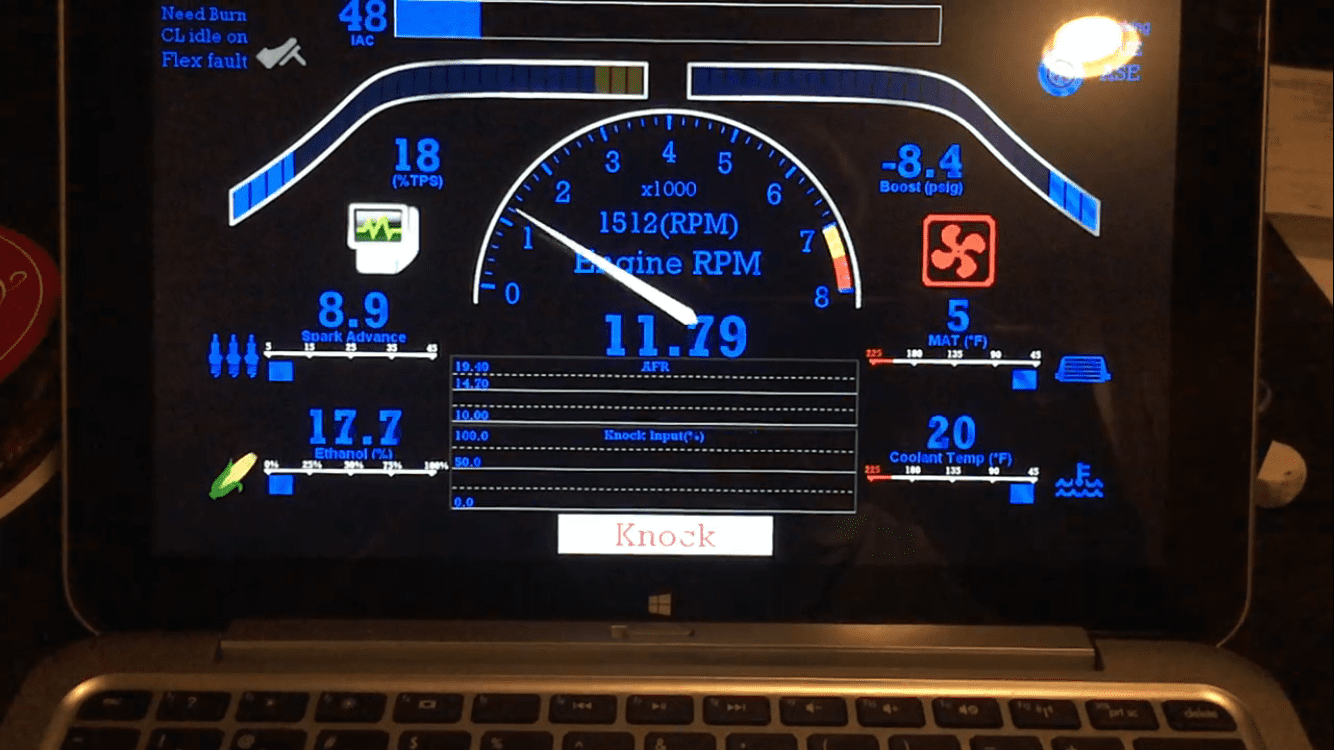

Also started playing around with dash design layouts for the pi dash.

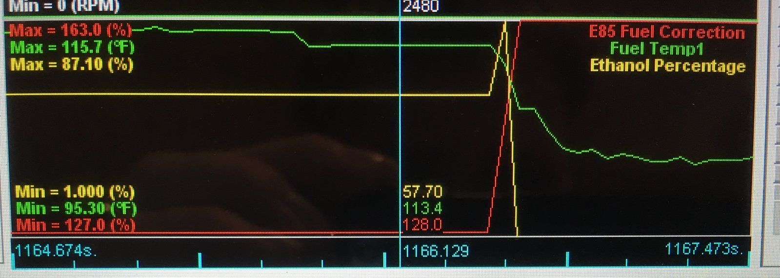

Oh and my ethanol sensor died as well would be too bad if I didn't have some random mixture of 93 and e85 in the tank right now. Even caught it dieing in a data log.

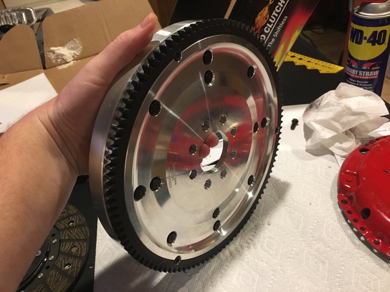

My stage 1 south bend clutch can no longer keep up since I have turboed the car. This does not come as a surprise since that clutch was only rated for 250 ft lbs. First choice right now is a non-modular stage 3 south bend clutch. Since the clutch needs to be replaced and the trans has to come out, that triggered the axle seals, axle and bearing replacement since I'll be in there anyways. I would like to refresh the trans too but I don't have the press needed right now to do so, so that will wait.

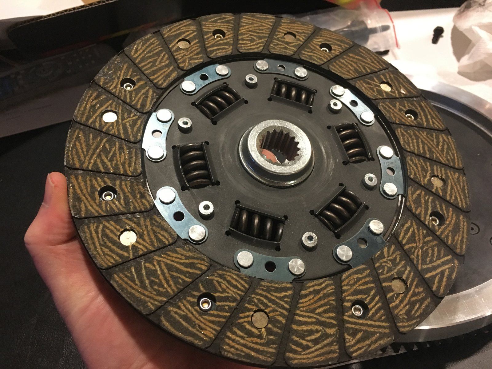

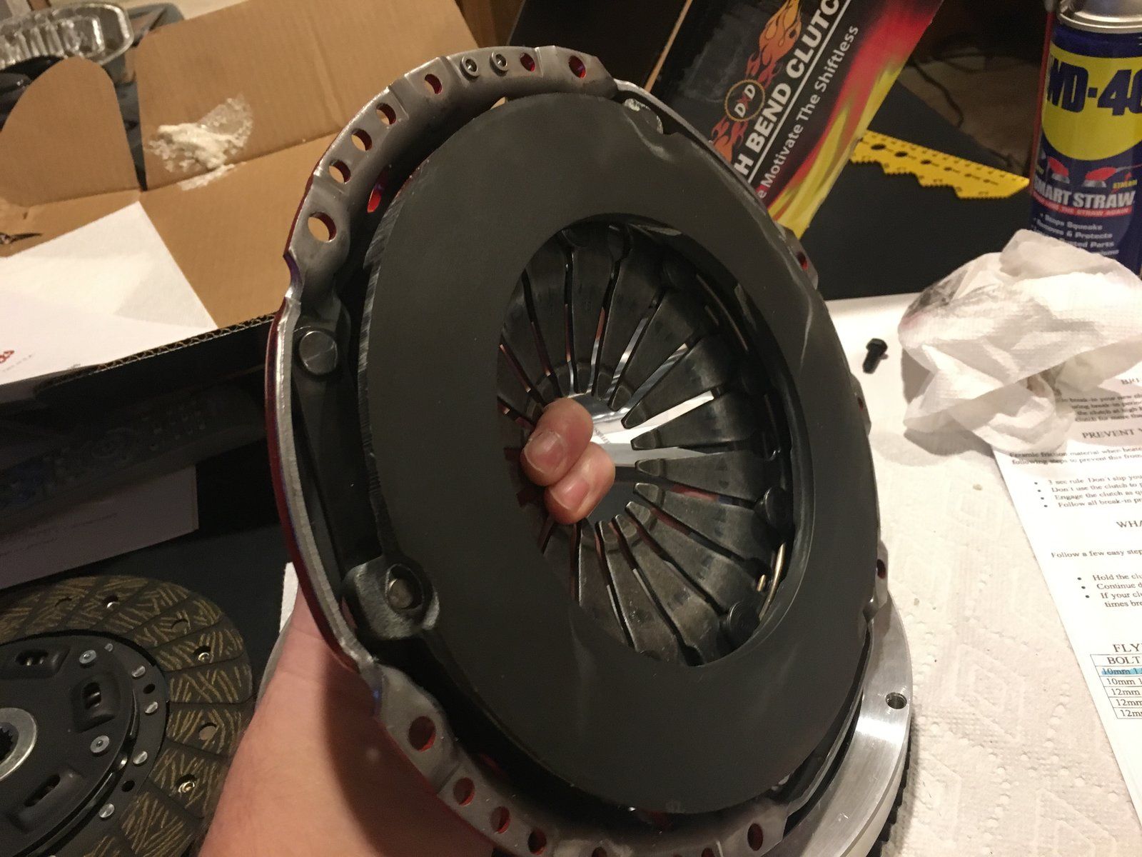

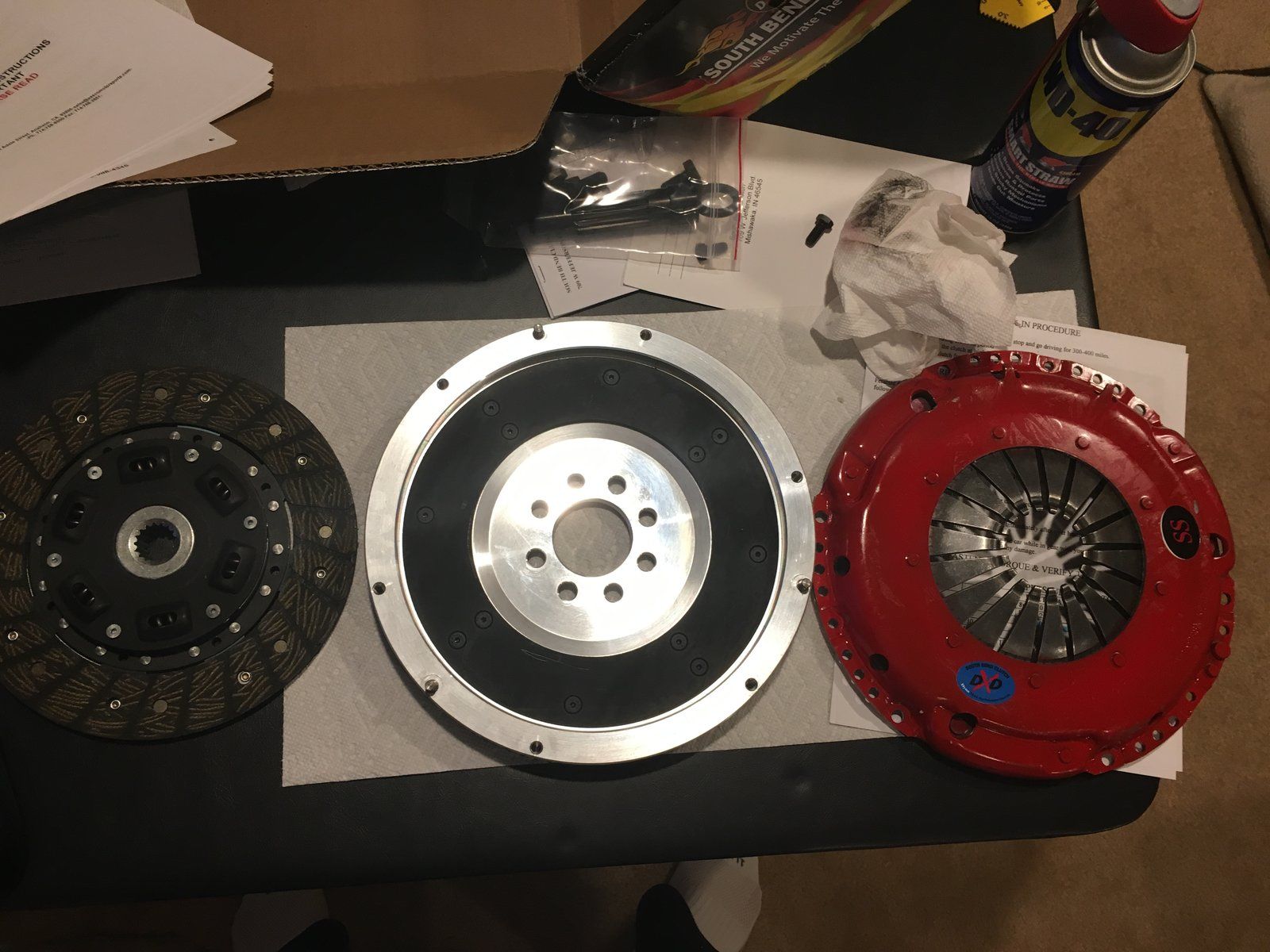

My new clutch came in the other day. It's a south bend stage 3 clutch rated for 400 ft lbs. this should be plenty for what I'm looking to do and still be decent to drive.
This will go in along with an OEM TOB, new axles and bearings once I can get some time off work and brave the cold garage.
