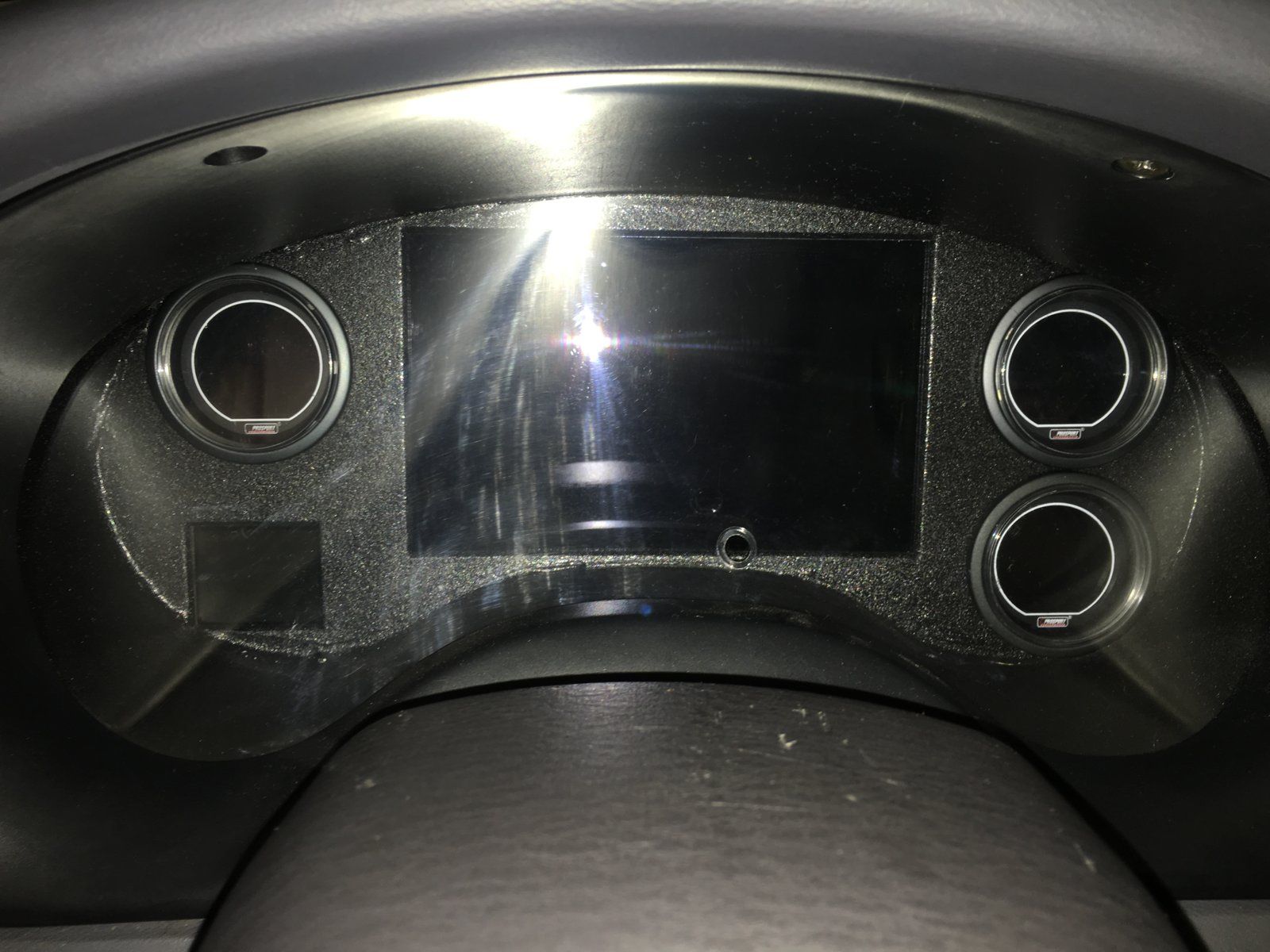

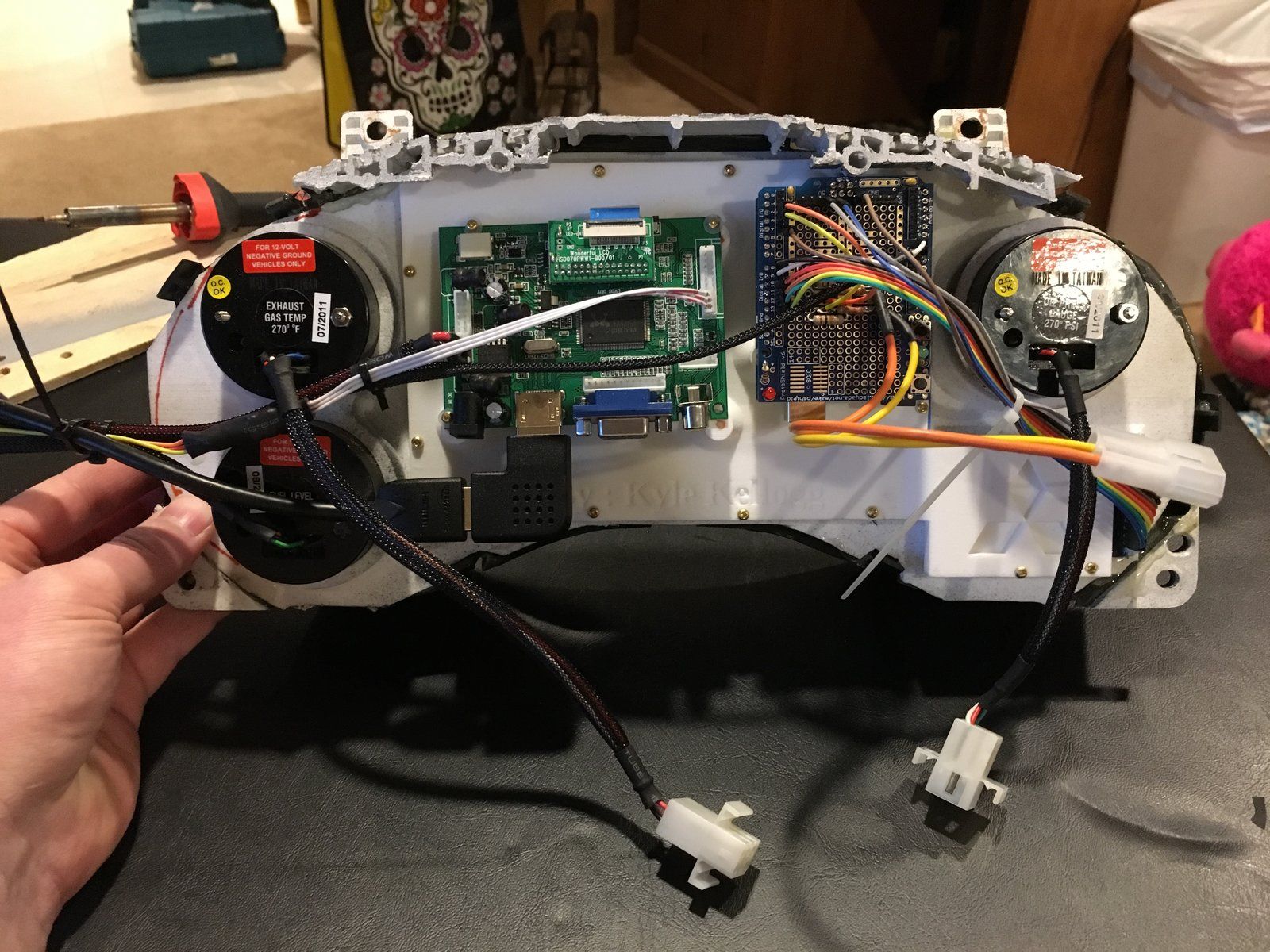

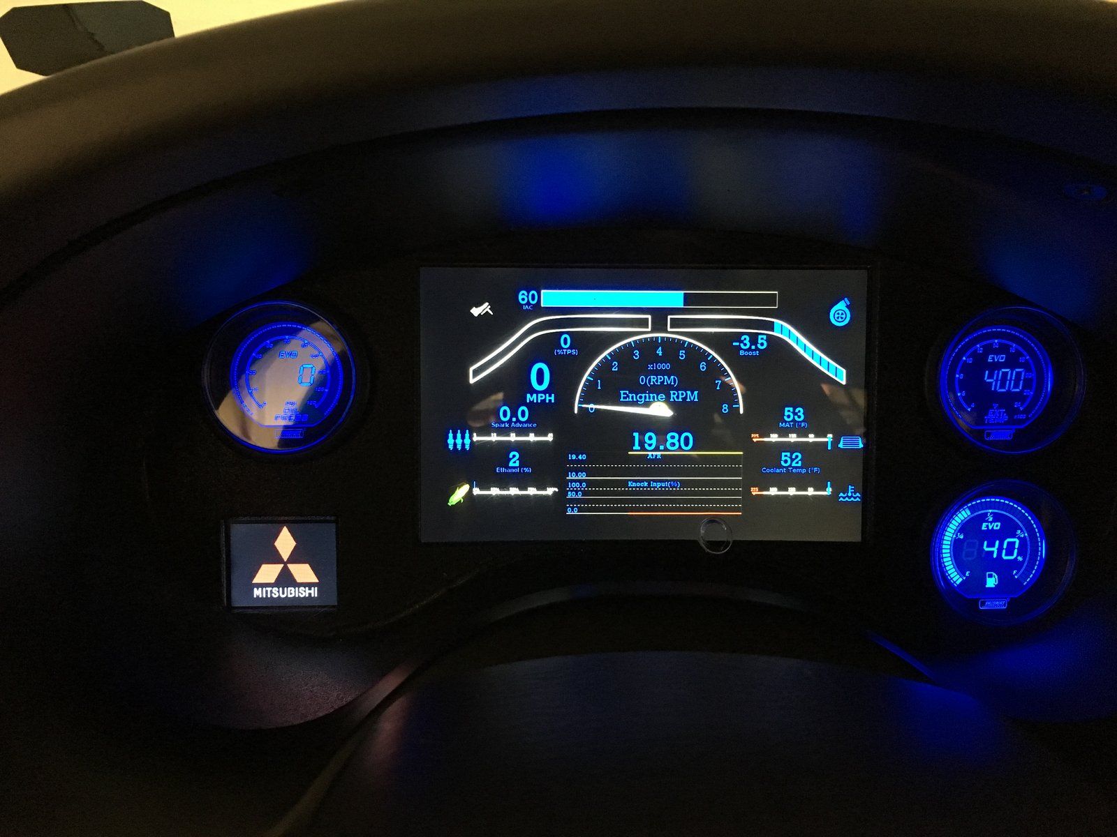

Well I got the digital dash finished up and installed! Need to figure out why the turn signals aren't working... but I think it's a grounding issue since I tapped into them for the signal to the arduino.

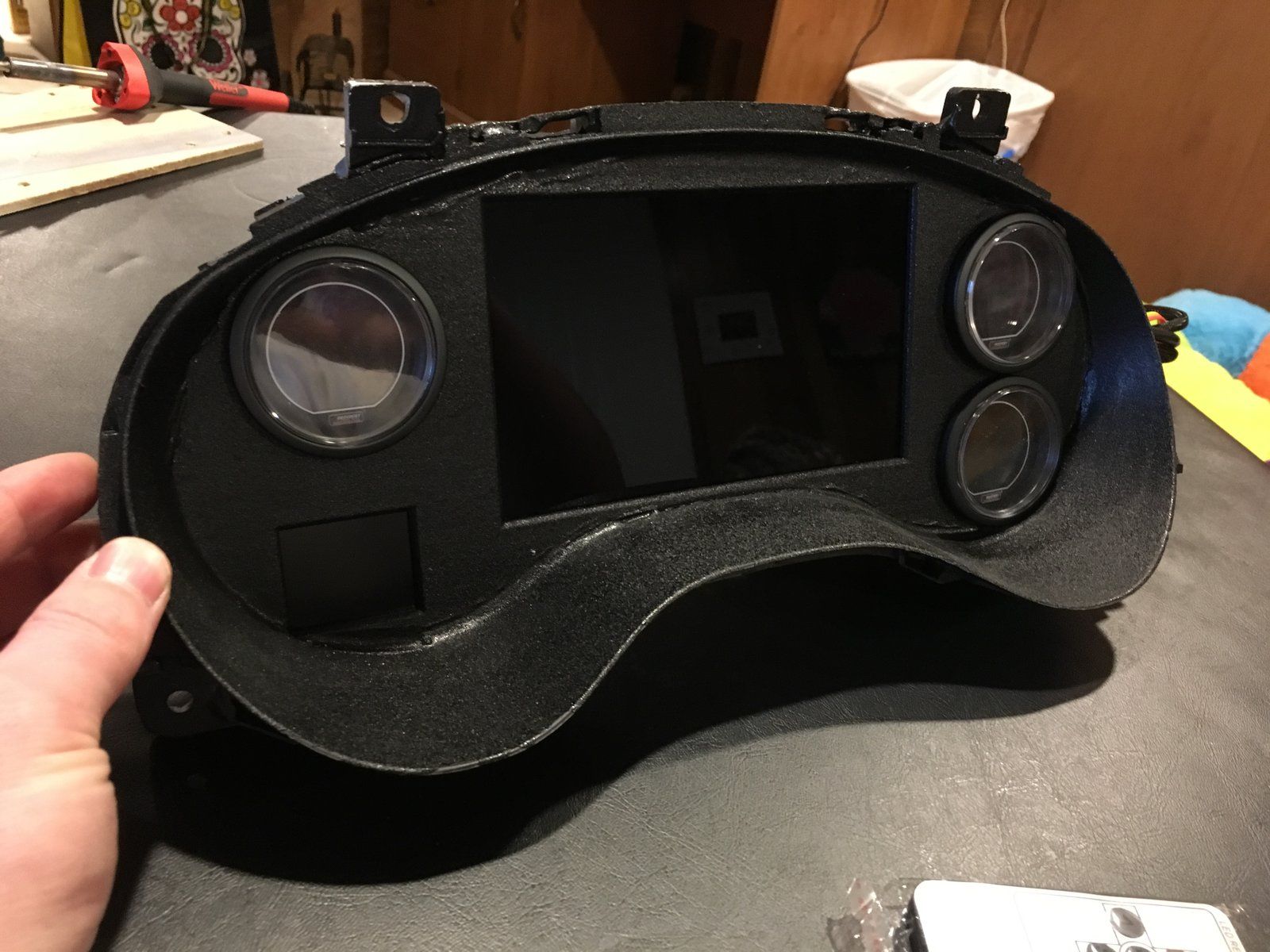

So I still have some clean up to do... but man does it look good! The camera doesn't capture how good the display looks.
Think of it more as an in dash computer. The display is a raspberry pi running a program called tunerstudio which is connected to my megasquirt via a USB cable.
I would think it could be possible with dsmlink is the tuning software was also Linux based (that's what the raspberry pi runs on)
Got a few kinks worked out on the digital dash. If you zoom in when it's on, you can see how it's not centered. Turns out when I broke the hdmi port off the original LCD driver and ordered a new one, I didn't get one with the right firmware to run a screen of that resolution. I was able to reflash the firmware after banging my head against a wall for a week. There's a reason I went into mechanical engineering and not computer/electrical engineering...

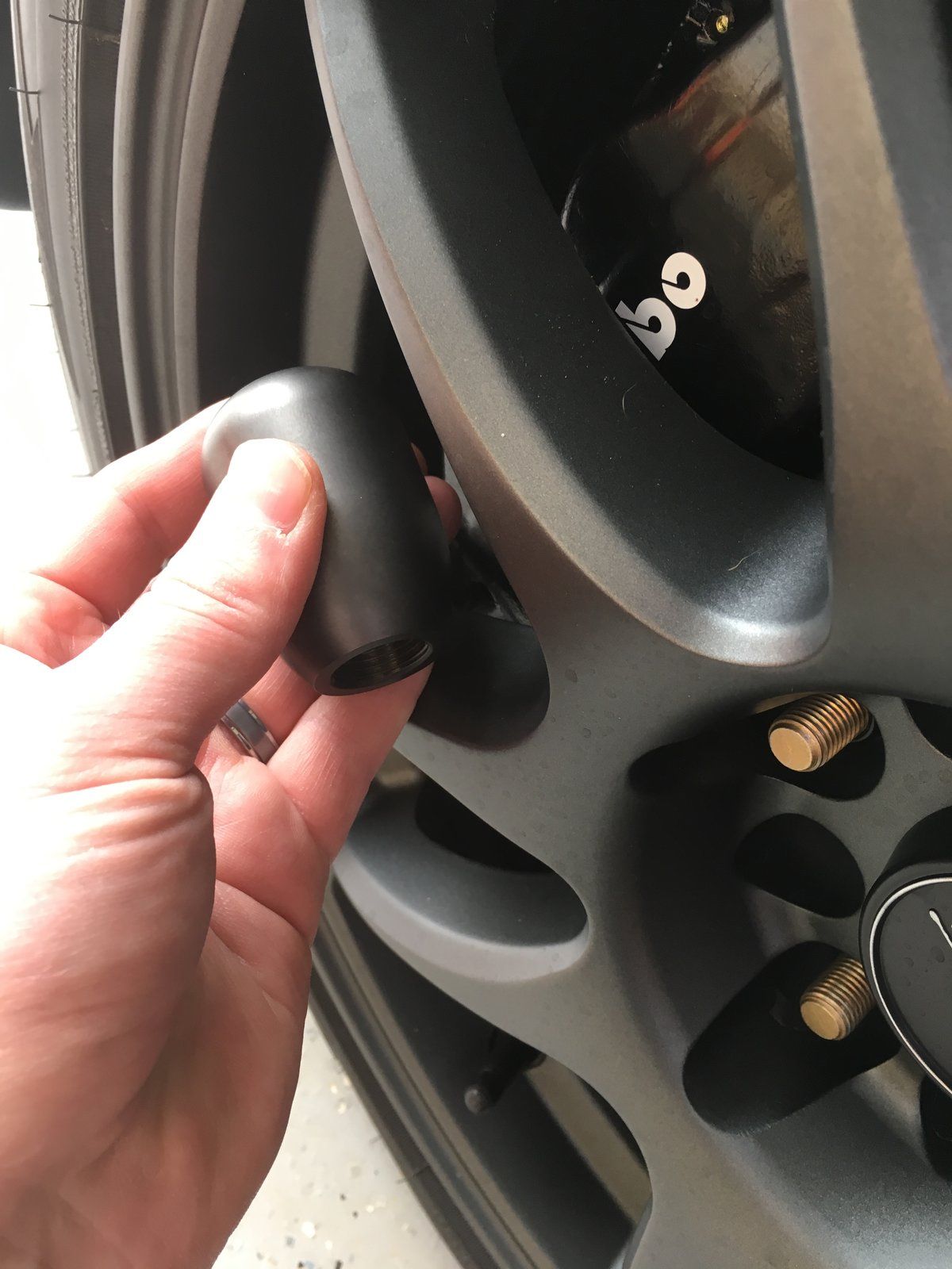

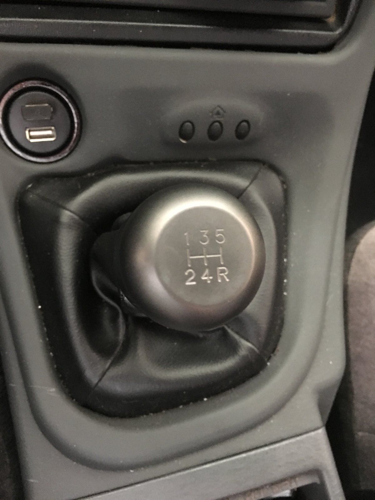

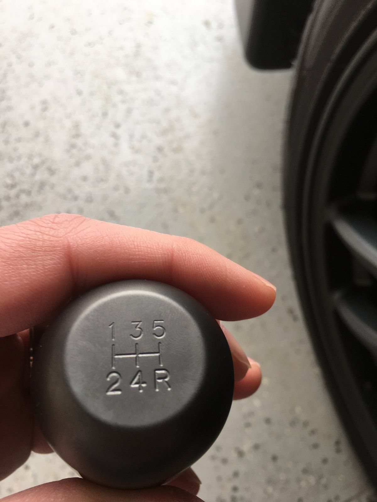

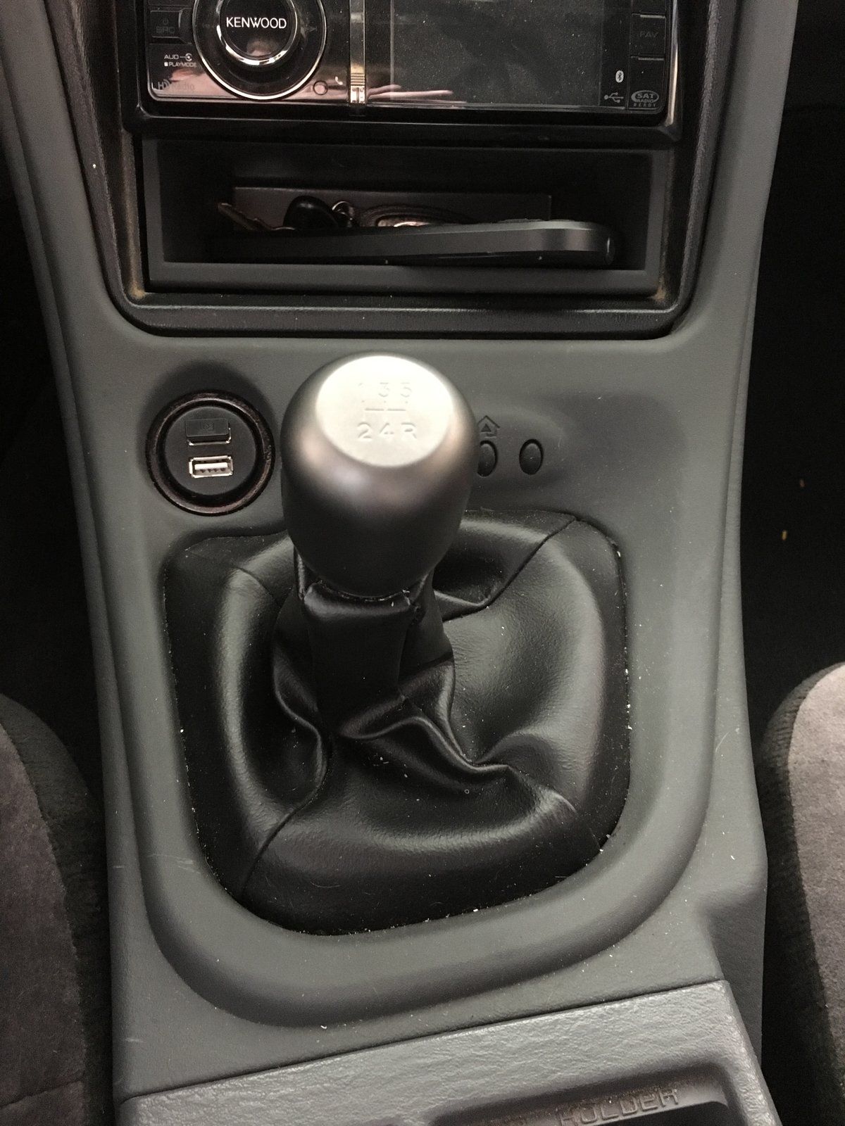

Also I have 1 week left of my masters degree in mechanical engineering. Can't wait to have some free time back. Going to school and working 40+ hrs a week as an engineer was not an easy task. To reward myself I bought something I have been looking at for a very long time. Something that was completely over priced for what it is, but every review I have read on various forums praises them. Plus it matches my wheels! TWM's type R shift knob in graphite. Can't wait to see how this feels vs my plastic one I have rocked for years.

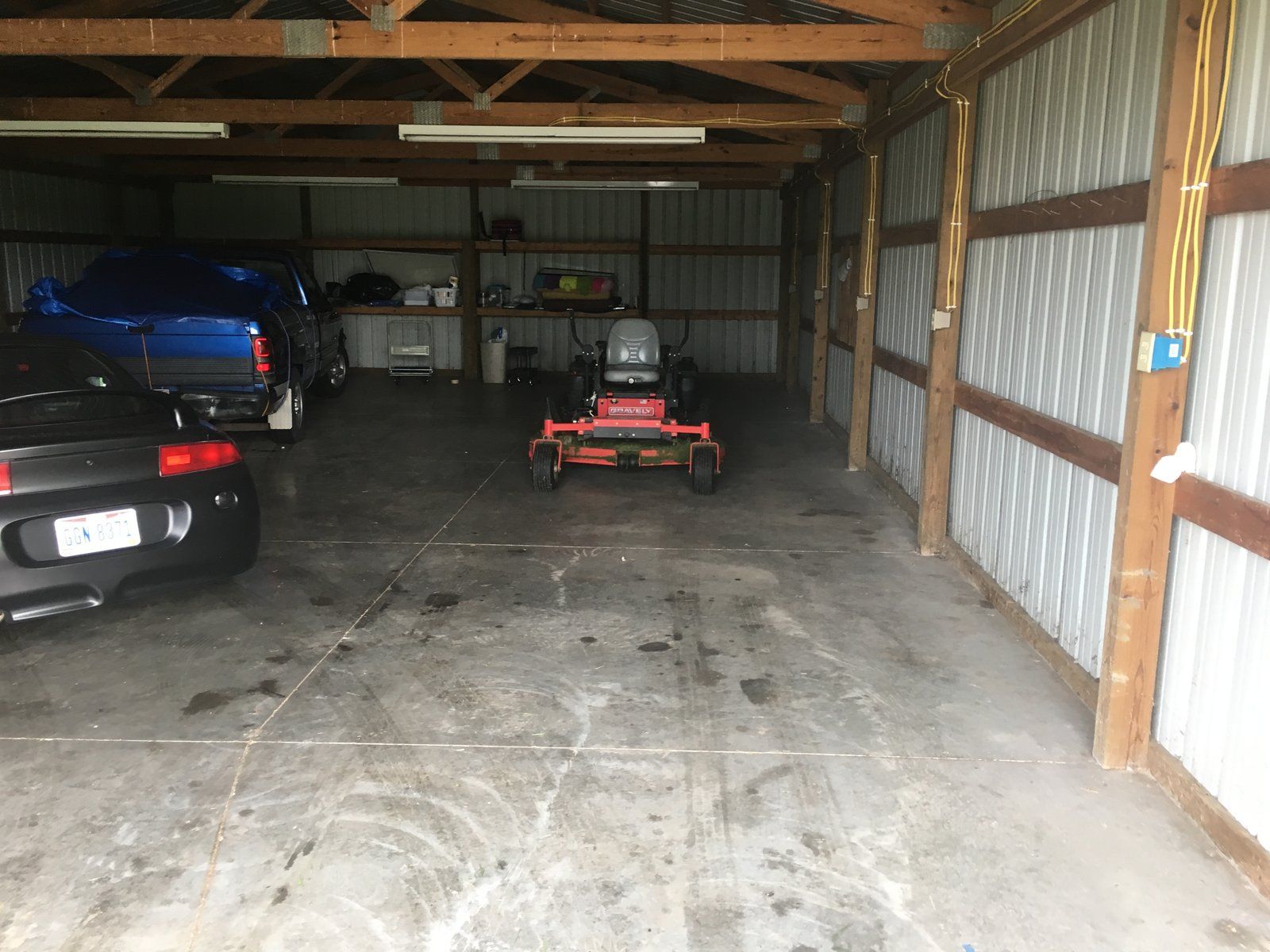

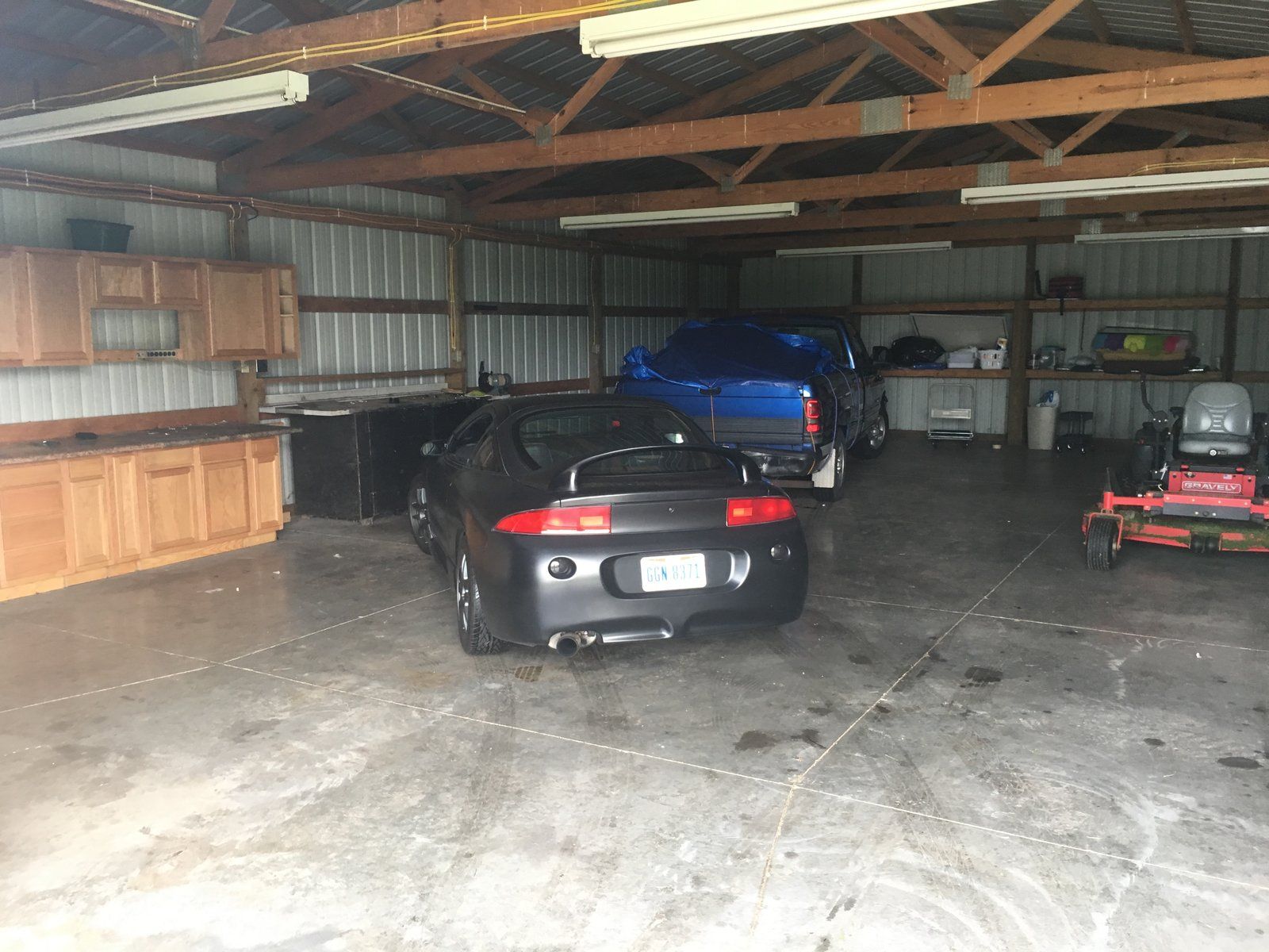

Well it's been a while... been busy with life... all good things though. My wife and I just closed on a 4 bedroom 2.5 bath house on 5 acres with a 30'x50' detached garage!!
Might not have a ton of time to wrench on the car this summer but I will definetly need to finish the inside of the garage and get it heated.
Also bought a beater truck. Just a $1,000 96 ram 1500. V6 with a 5 speed trans and 8' bed. Nothing special at all dents and dings all over it, but it is so nice to have a truck!!

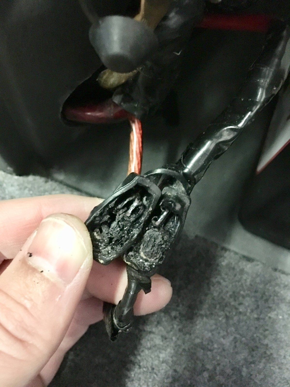

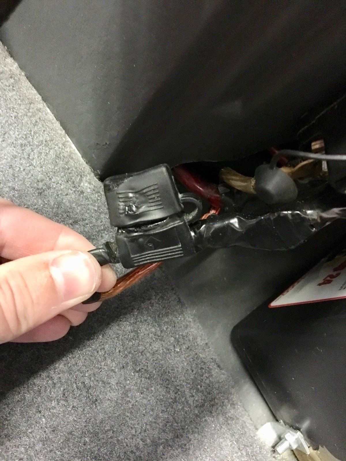

Man I can’t believe winter is basically here. Well I got the fuse fixed. It ended up being a relay that shorted out. Relocated the relay and replaced all the wiring. Zero problems since.

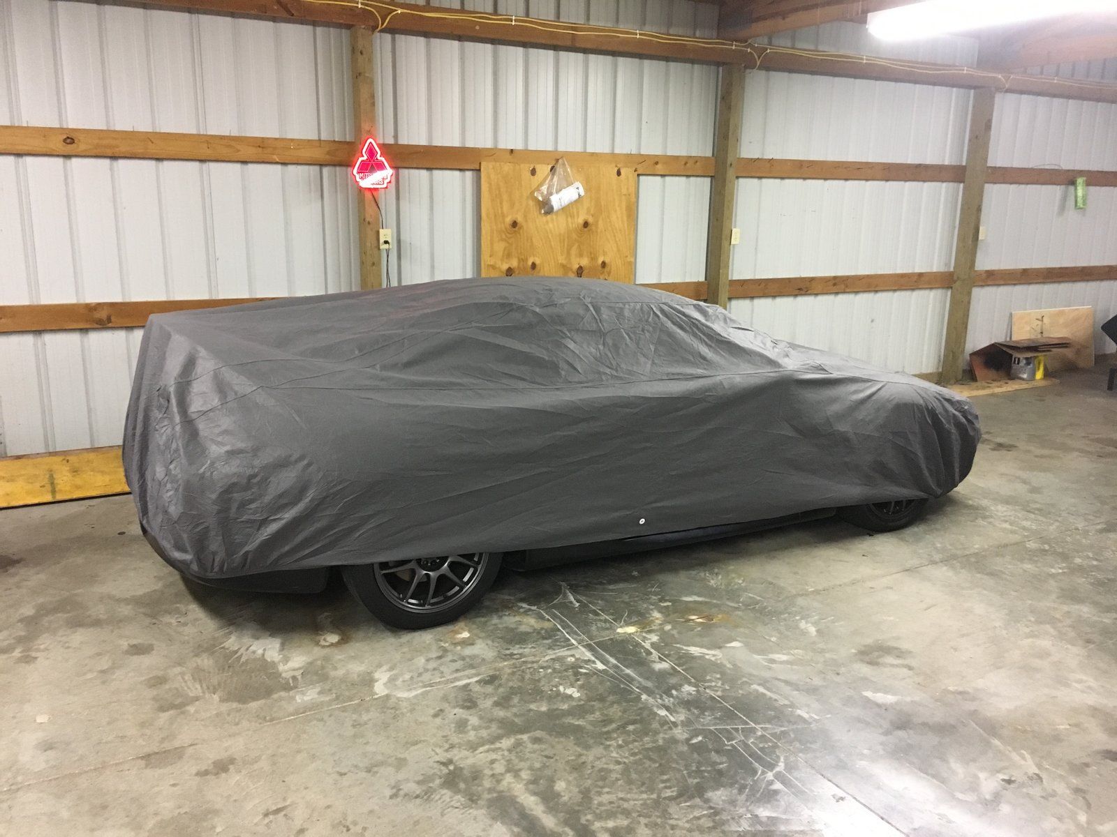

The car is currently in hibernation mode. All covered up. Plans for the winter are to install my fender braces (finally) and install the rear upper control arms I got from Bobby. I plan to pick up a new Braille battery once spring comes around. This one to be exact:

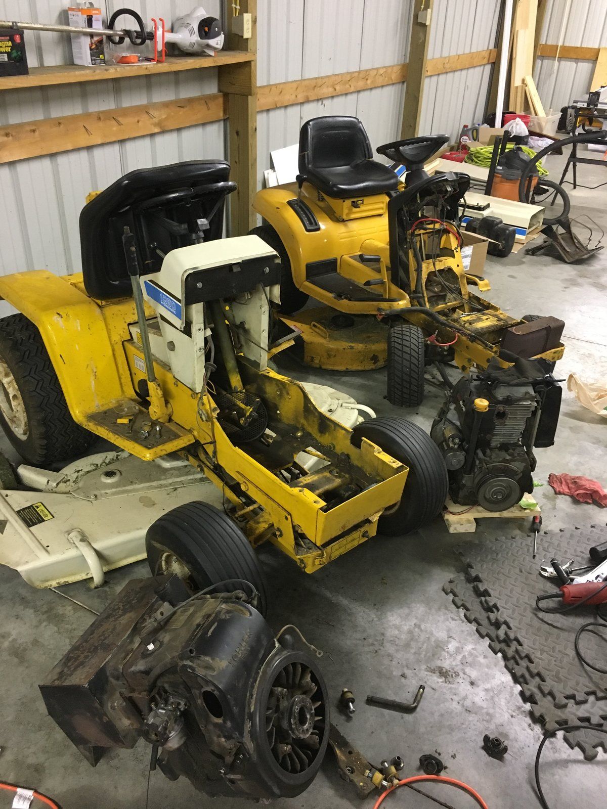

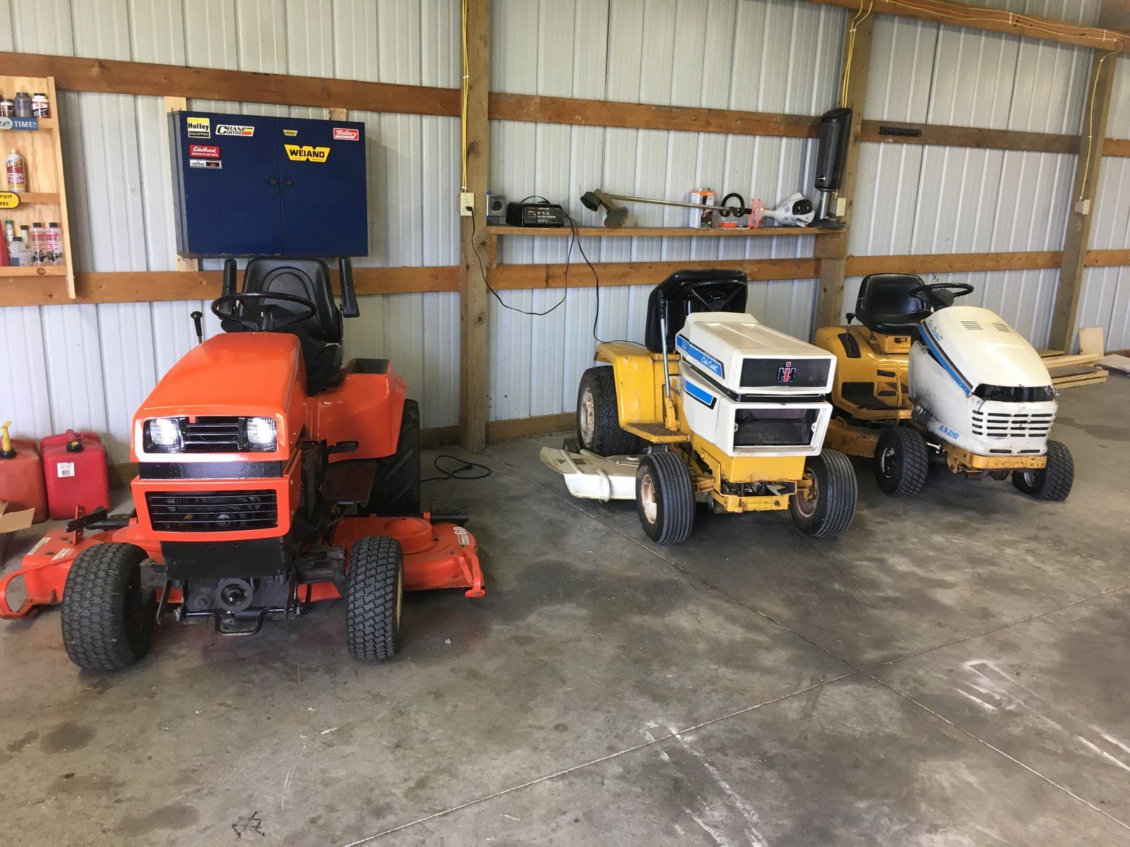

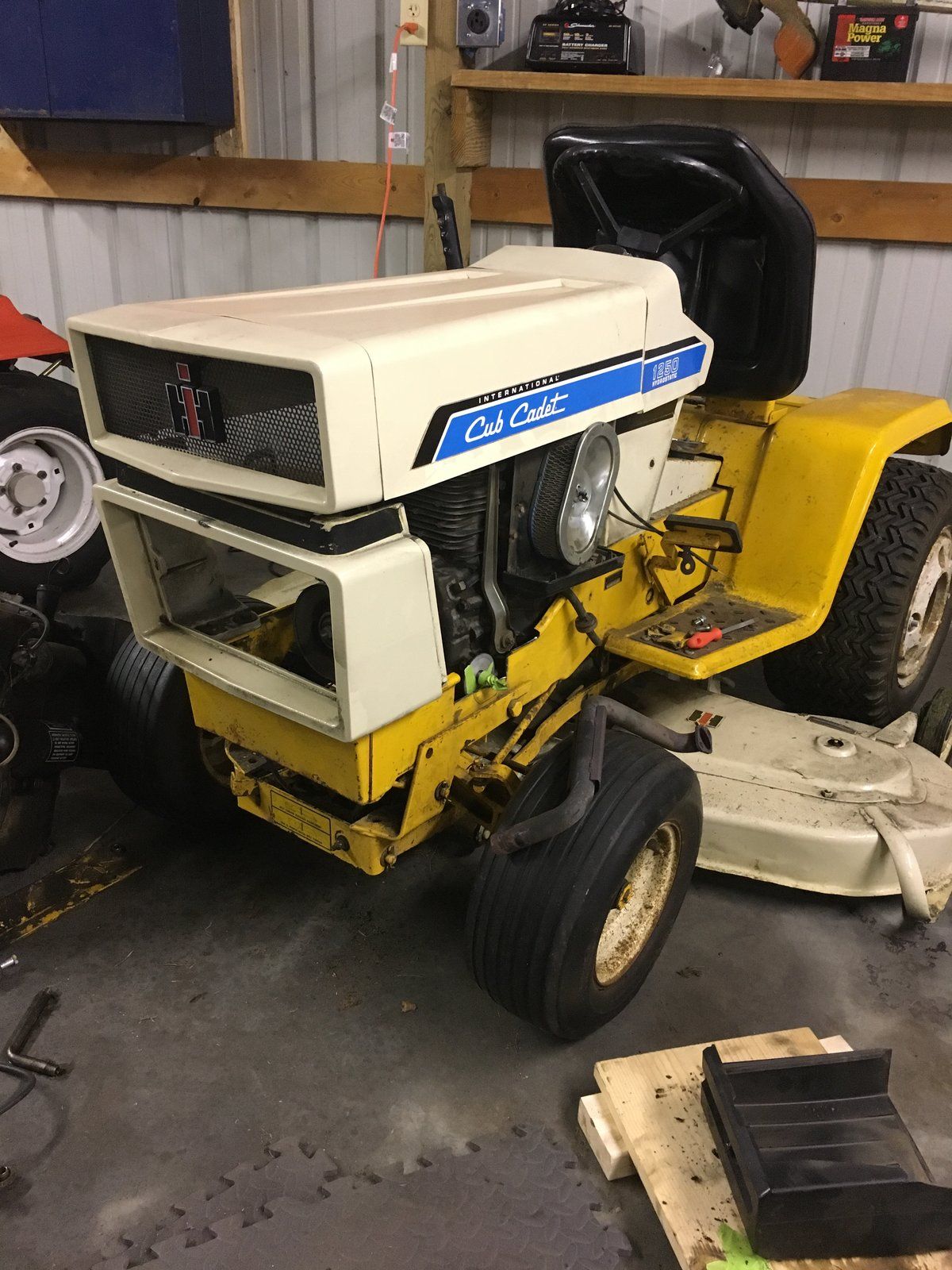

When we bought the new house my dad was nice enough to give me two of his garden tractors. It’s a bit of a hobby of his. He has 5 more of the orange Ariens GT tractors. The one he gave me is an 18hp twin cyl engine with Power steering, hydrostatic trans and hydraulic lift. He gave me a 60” deck and a 48” deck with it. He also gave me the middle tractor (late 70’s International Cub Cadet).
The third tractor I bought off Craigslist for $250 to keep up with the lawn as my dad couldn’t make it out here for a month (12 hr drive). Well I had my ups and downs keeping up with mowing 5 acres. At any one time 1 or more tractors were down so I limped along. Now that winter is here I am tackling a few things.

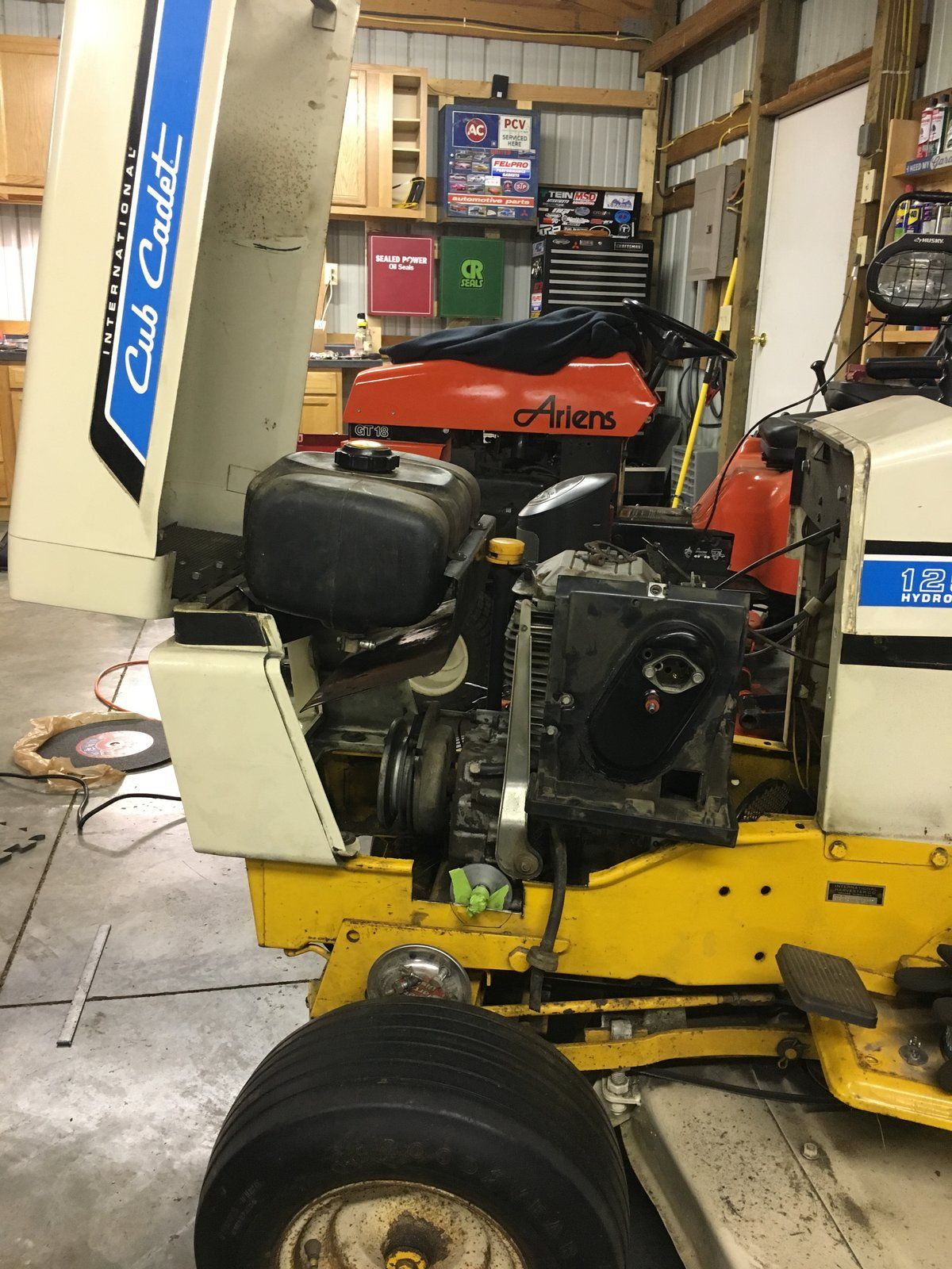

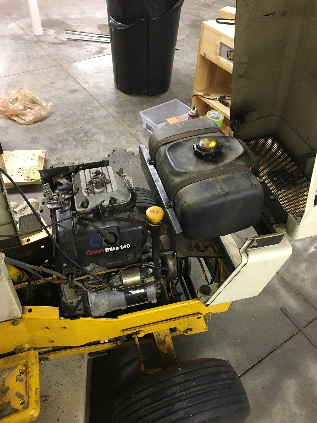

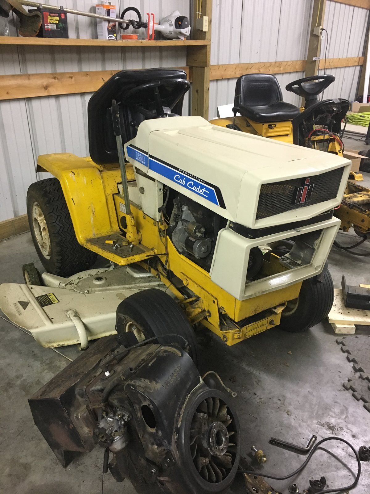

The cub to the far right or the junk cub as I refer to it has a crap frame and deck but a solid engine (14 hp Cummins Onan engine). The middle cub (IH cub) has an old 12 hp Kohler engine that sat for about 20 years in a barn. My dad got it running but it seriously lacked power and couldn’t keep the 50” deck moving.
So with a shoe string budget and needing to be able to keep up with the lawn this coming year, I decided to swap the two engines. Still have some work to do but it has been a fun project. Also nice to have the space to mess around with this stuff. I’m so spoiled now going from a one car garage to a 1500 sq ft shop!

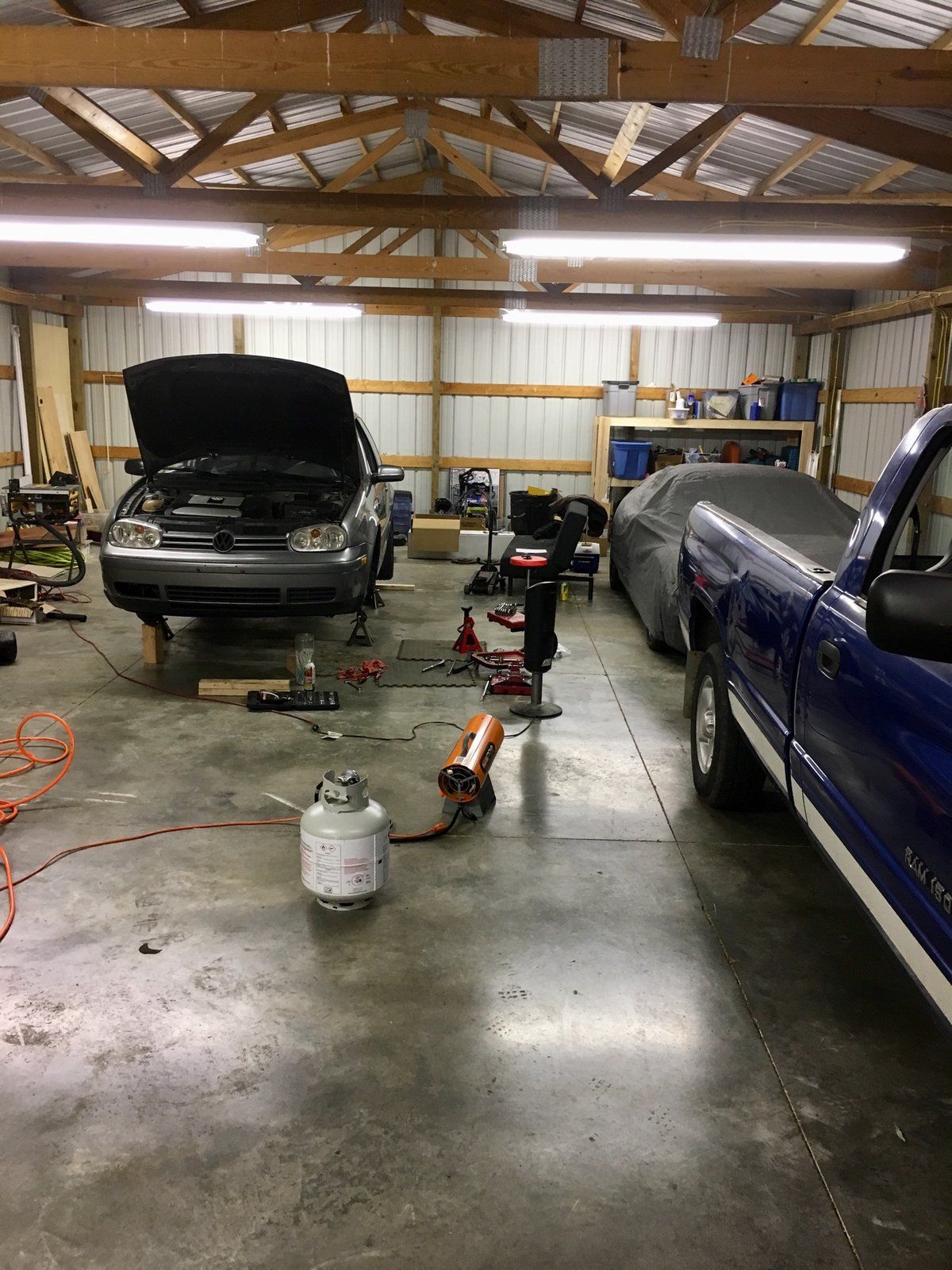

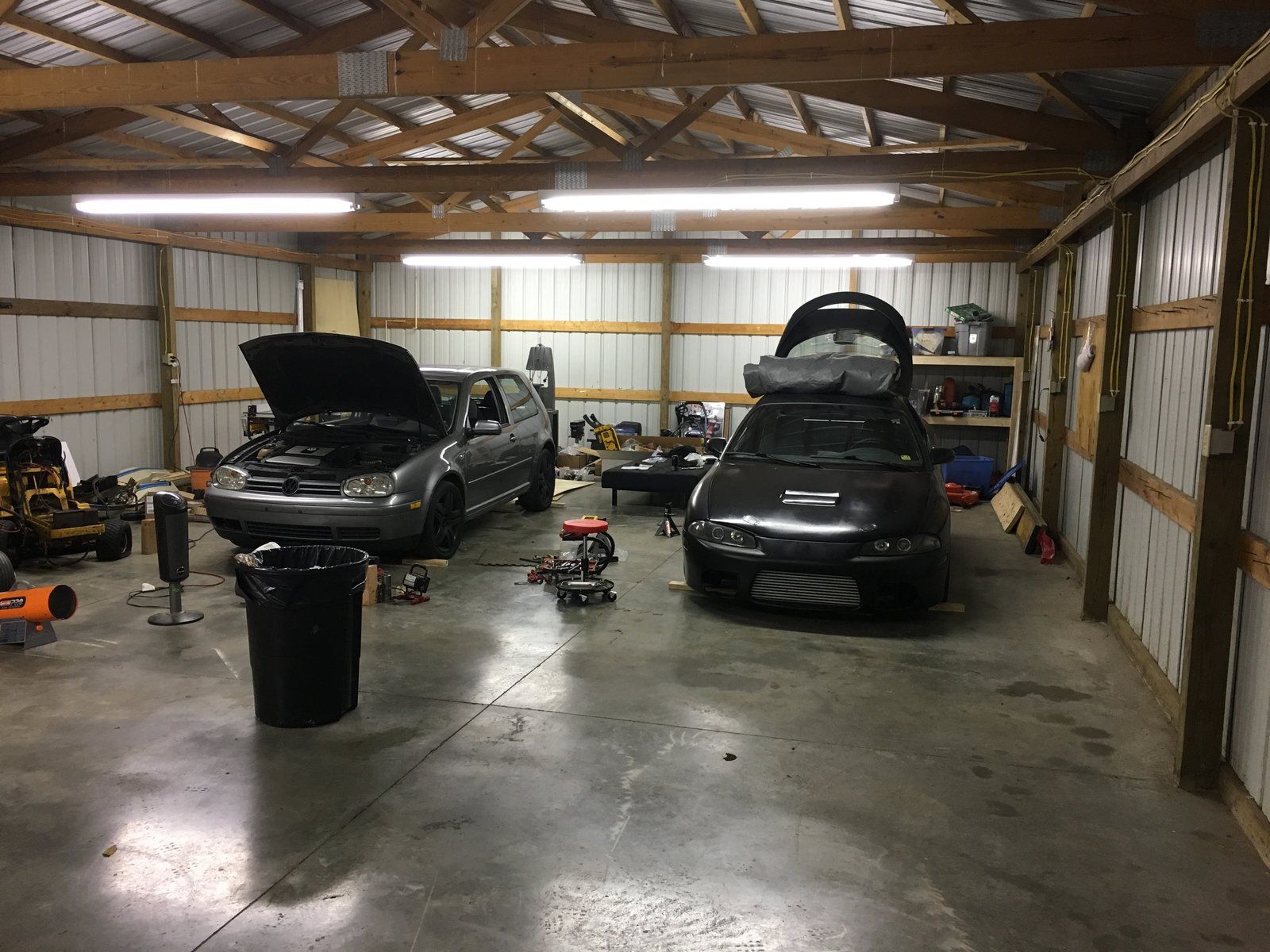

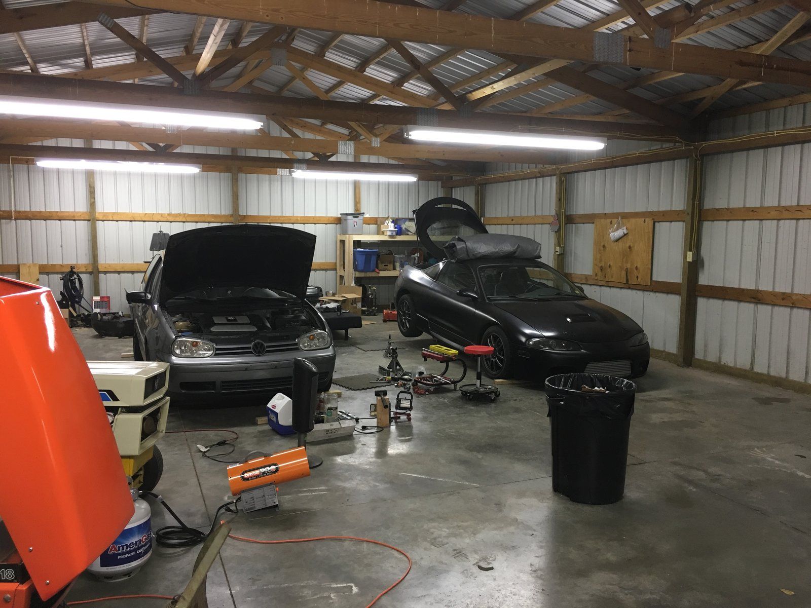

A good friend of mine finally decided to pick up a project car of his own. For now the car is being stored and worked on in my shop. My friend can do basic things like change oil and such but have never done anything past that. His car is a 2003 VW golf GTI with the VR6 engine. There is light body rust which we will take care of come springs, but the real this this car needed was an overhaul on the front suspension. Every bushing, ball joint, etc was shot. We have been tearing into it bit by bit and ordering parts here and there.

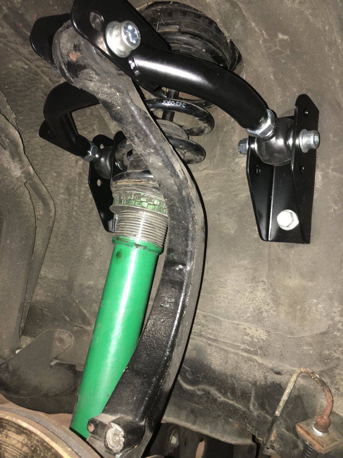

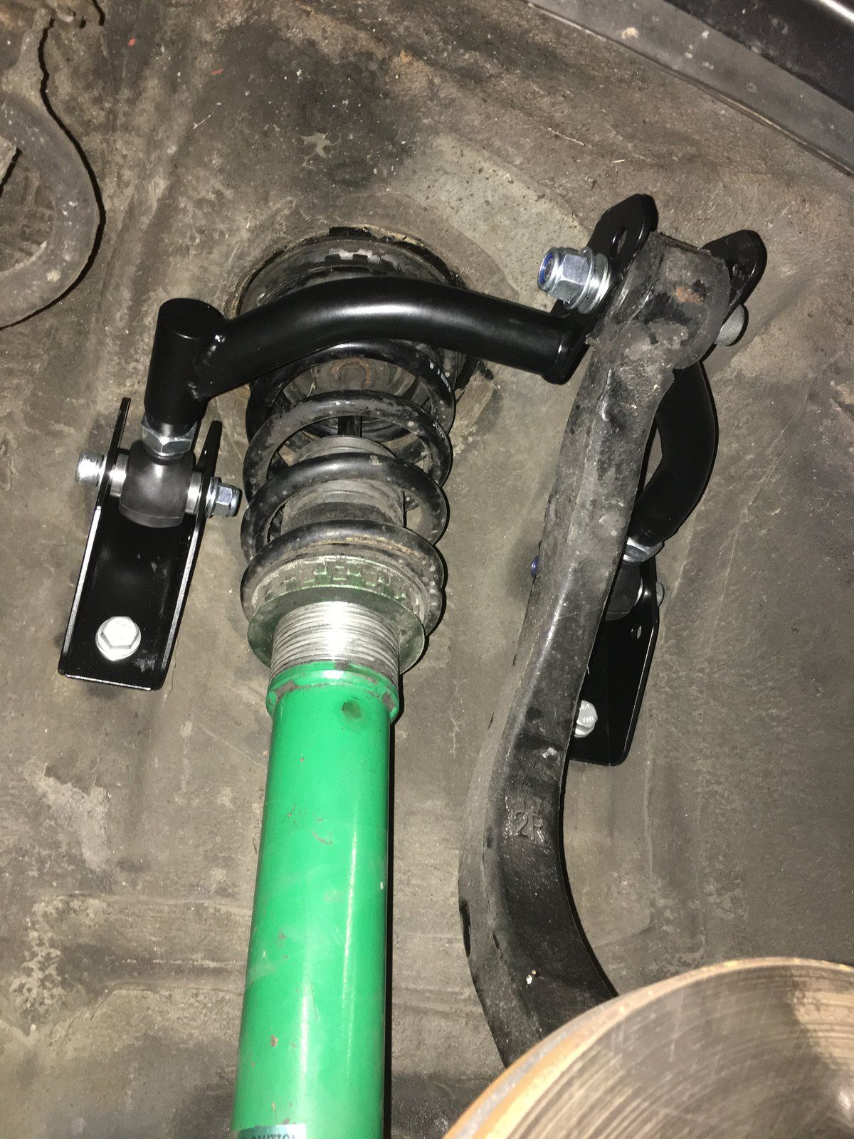

While he was working on some disassembly, I stepped over to the DSM and figured I would get to work on some suspension work of my own. For a while now the rubber bushing on top of my coil over springs have seen much much better days. So I took the coilovers out and replaced that bushing. I also decided it was a good time to install the custom rear upper control arms I got from Bobby like a year ago. Still have some adjustments I need to make, but I have to hand it to Booby. These things are on point! Perfect fitment! Can’t wait to see how the car feels once it’s back on the ground!

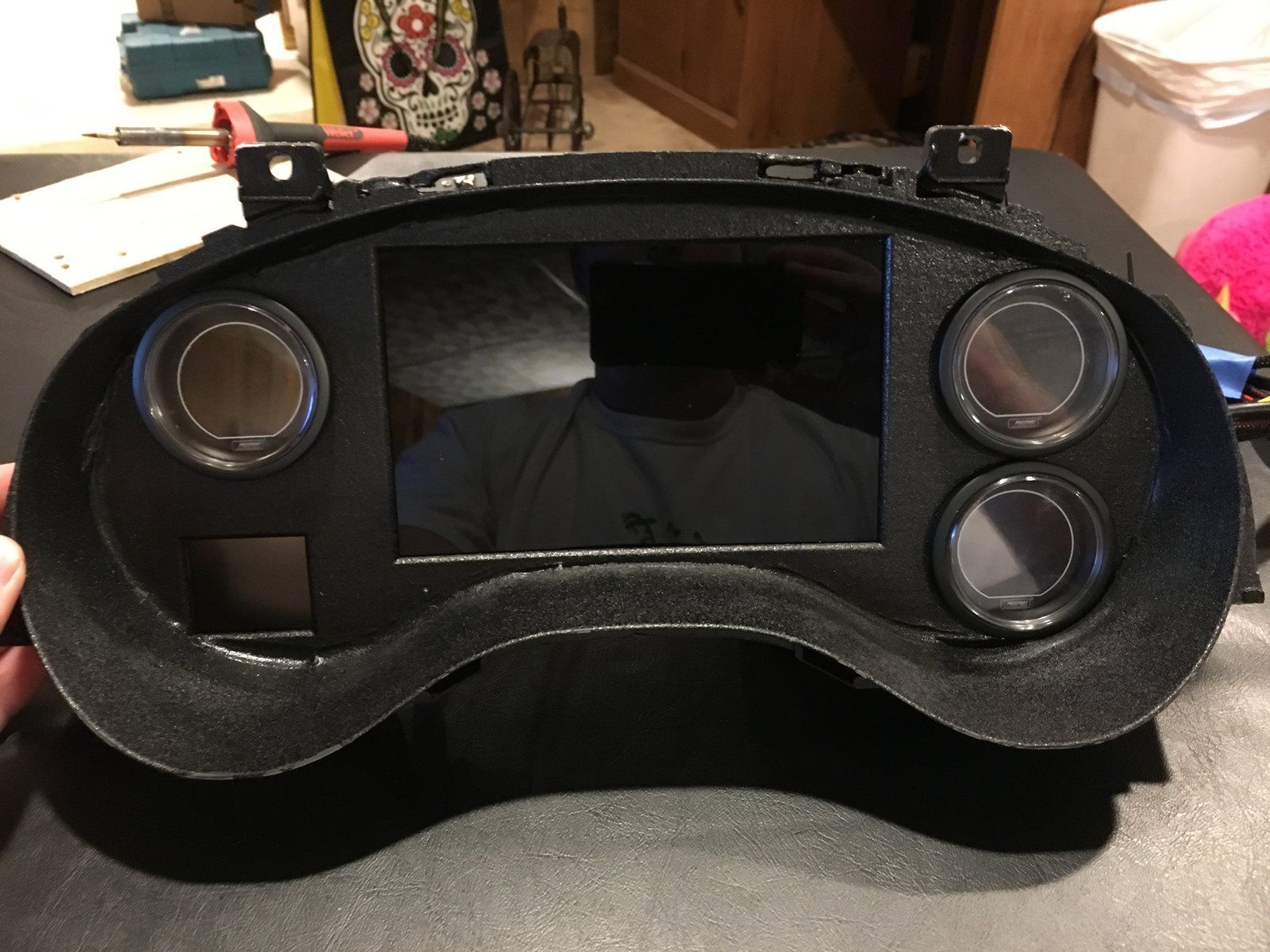

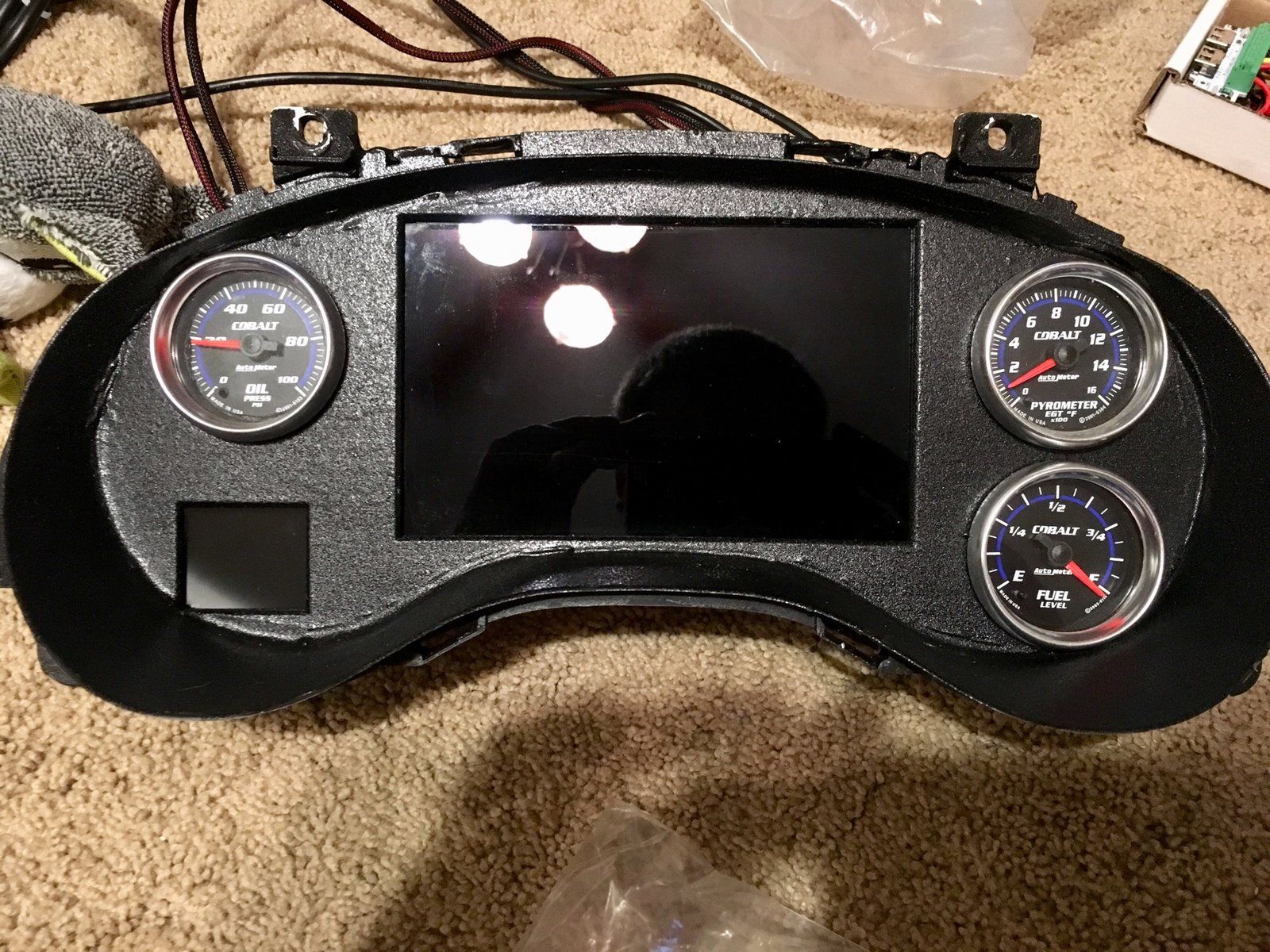

Picked up these auto meter gauges from a member on here. Finally had a chance to get the digital dash out and install these. Not crazy about the silver trim rings... but being able to read the gauges in day light will be nice!
Also updating a few other things for the raspberry pi. I backed a Kickstarter for a single board computer that has the same footprint as a raspberry pi, but has more ram. This should help smooth out the gauges and give it a more professional look when running. Not that it was super choppy... but enough for it to be annoying.

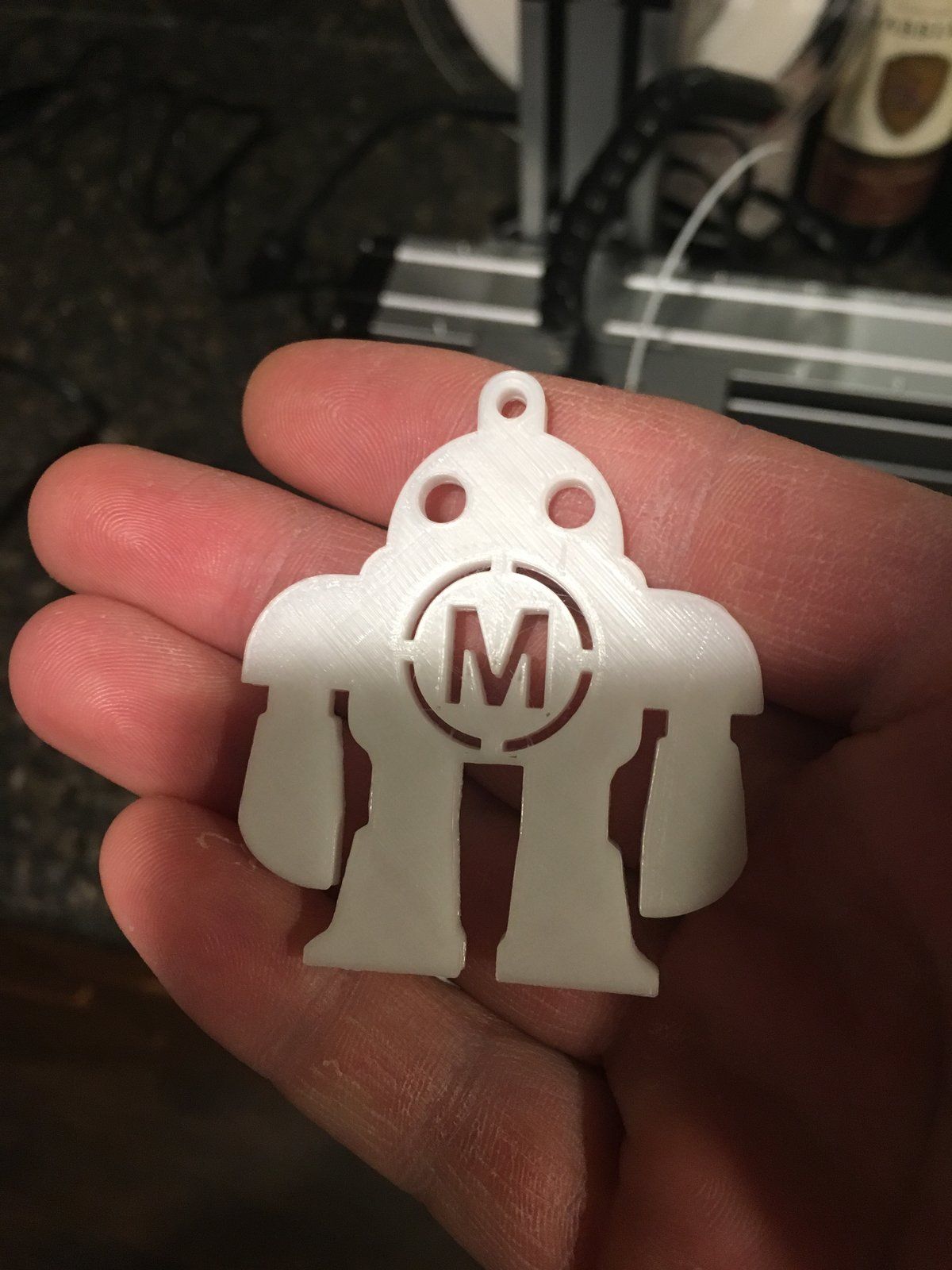

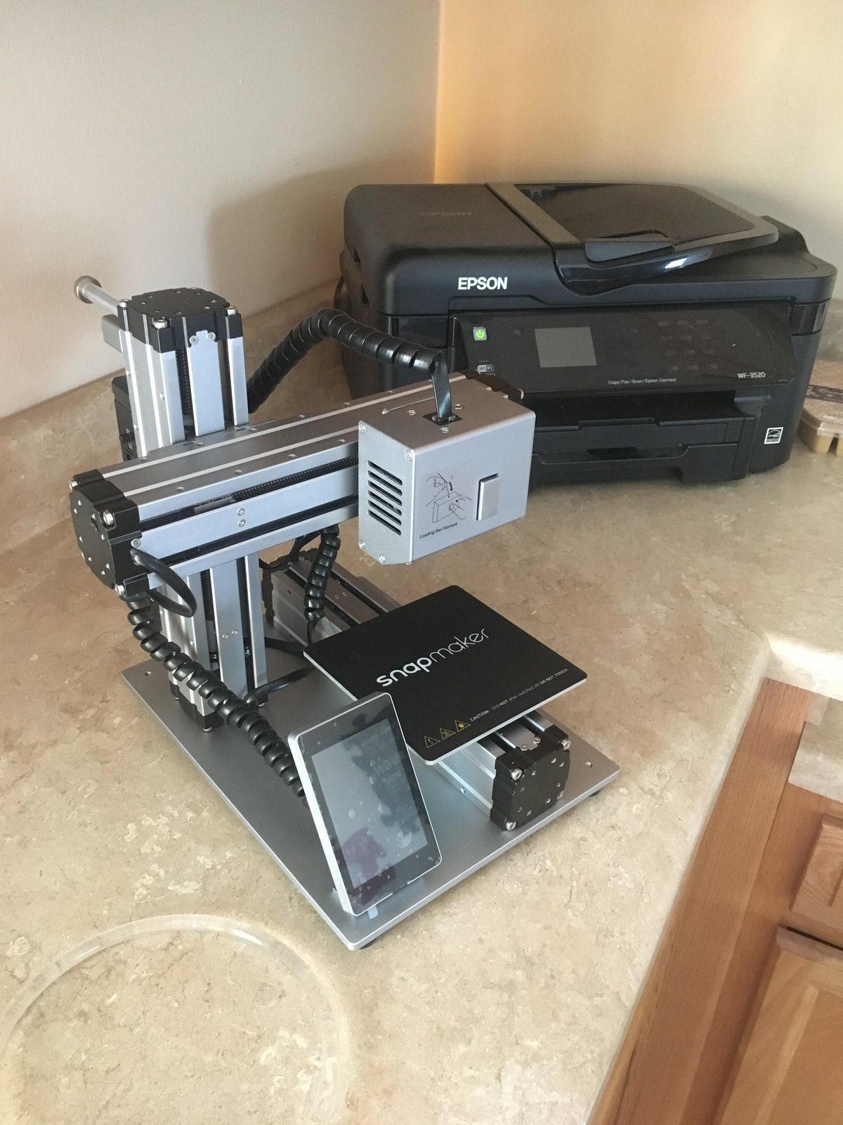

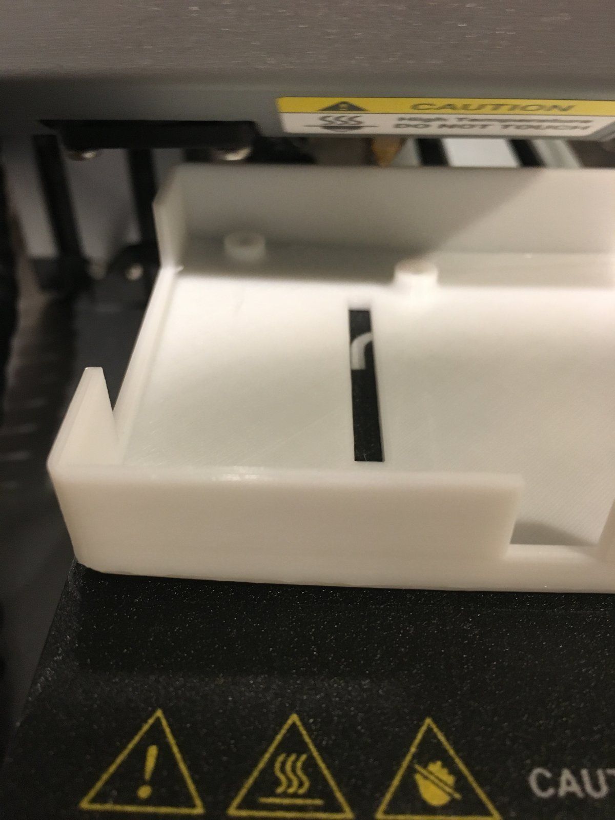

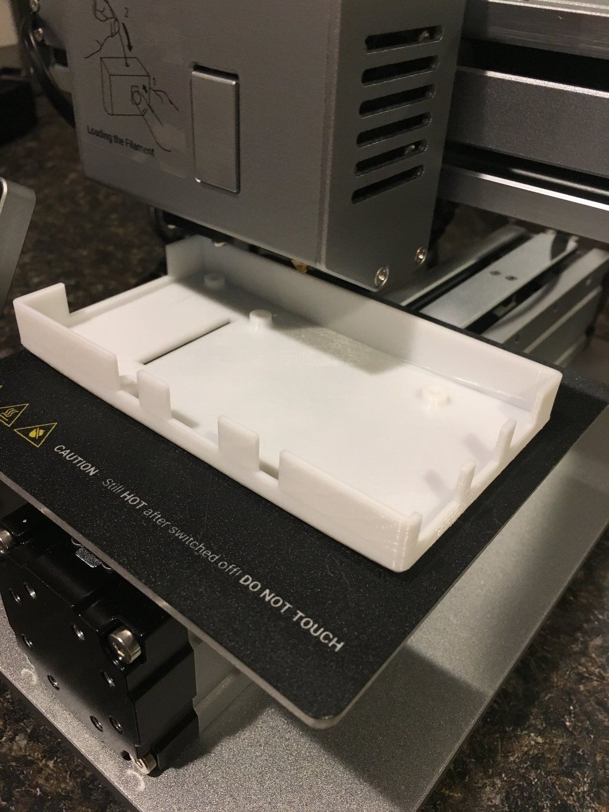

Back in March of 2017 I backed a company on Kickstarter called Snapmaker. Their goal was to produce a 3D printer that also had a CNC head and a laser engraver. The cnc and laser are capable of cutting/engraving on wood, plastic and other soft materials. Mine finally showed up the other day after waiting almost a year.

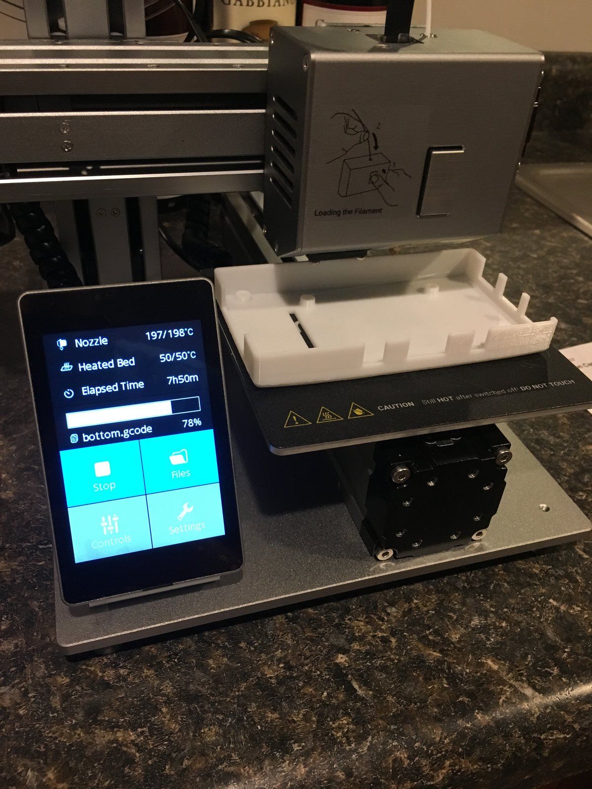

After a quick test print to make sure I had the settings and calibration correct, I kicked off a 9 hour print for a new case for the raspberry pi and shut down timer that run my digital dash. Right now the bottom is being printed. I will kick off the top print tonight. The reason for doing this is to add two fans over the pi/shutdown timer to help with board heat inside the dash. Also makes a nice package vs the RadioShack project box mess I had previously.
Pretty neat to have this capability right at my fingertips now.
