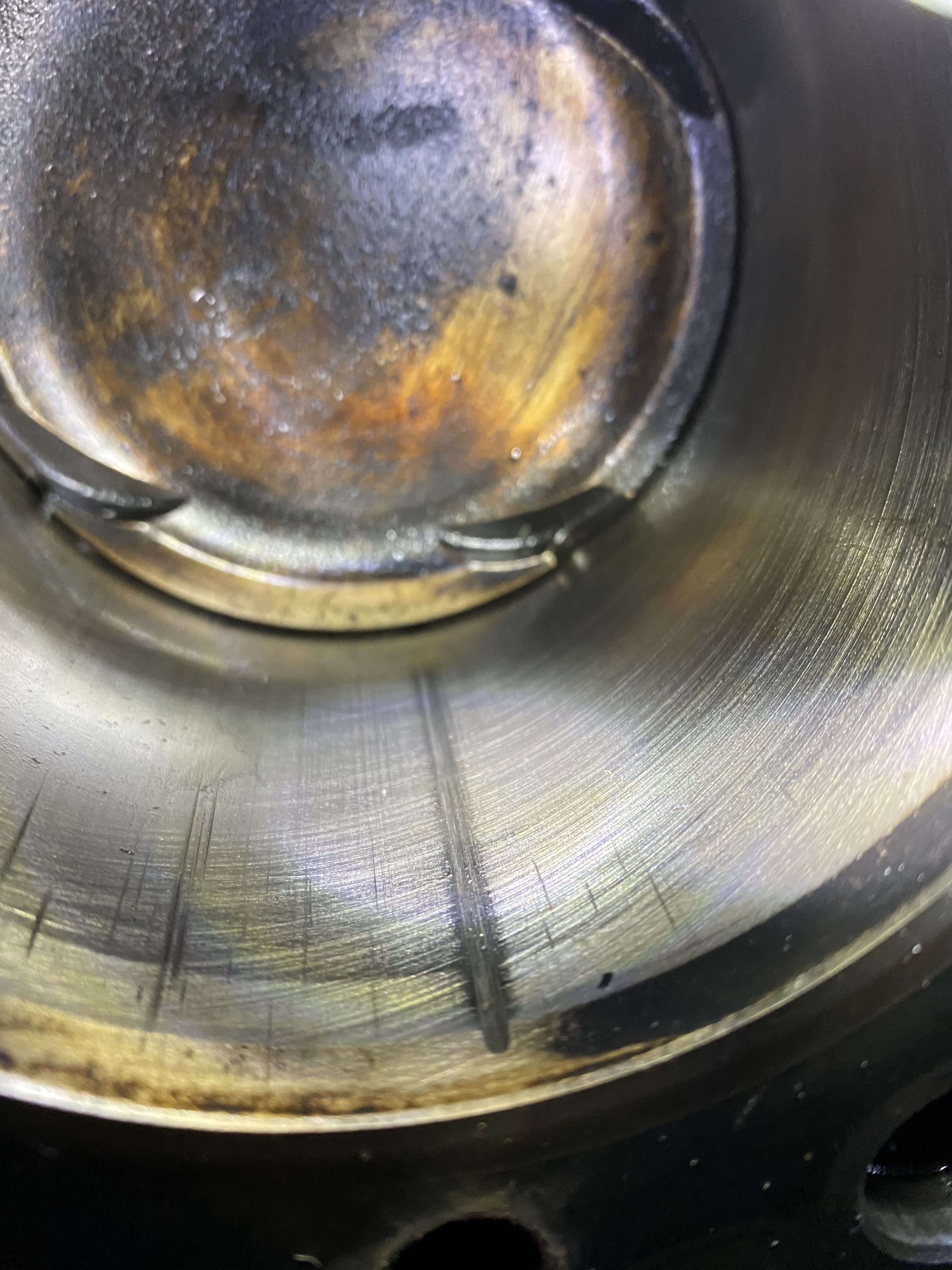

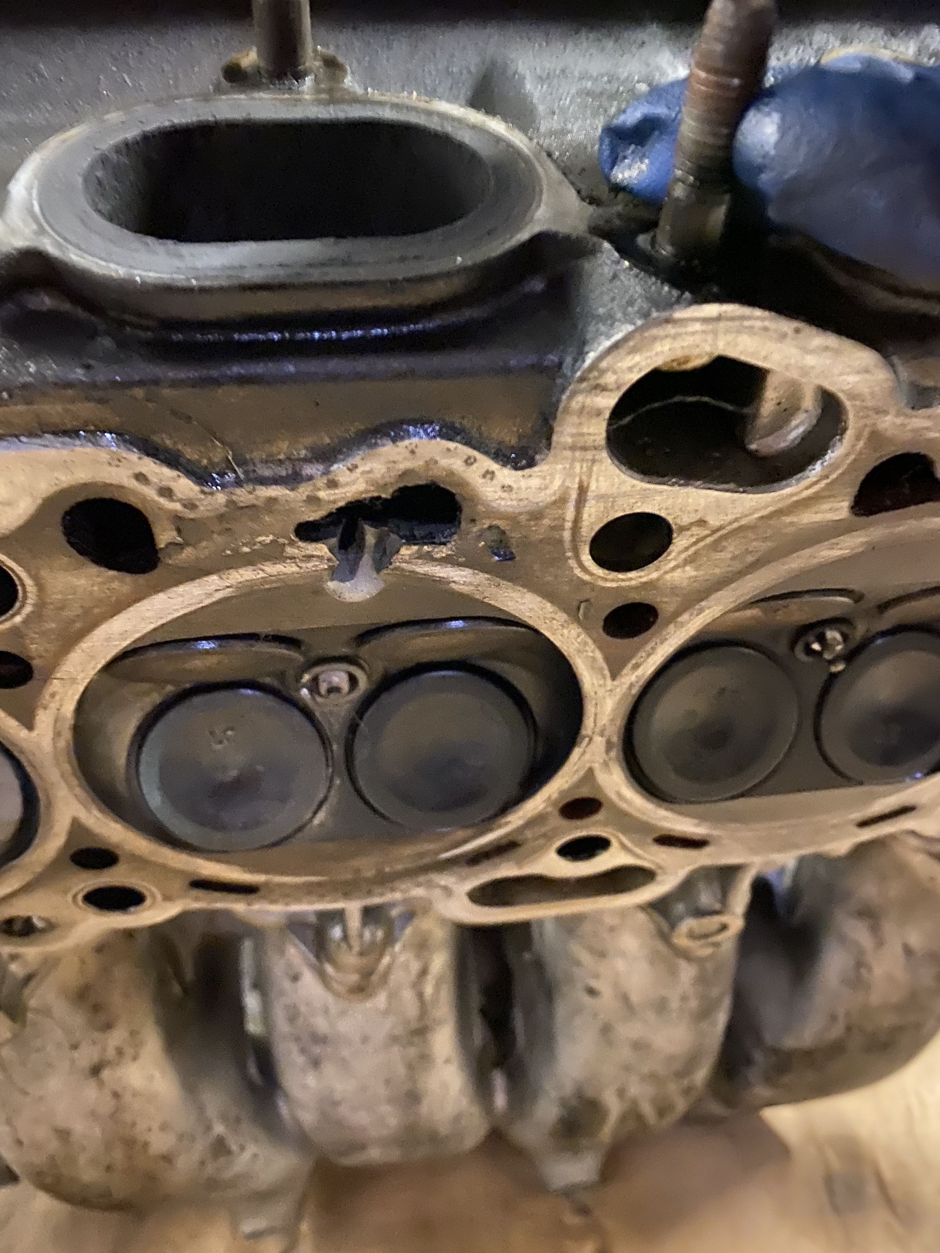

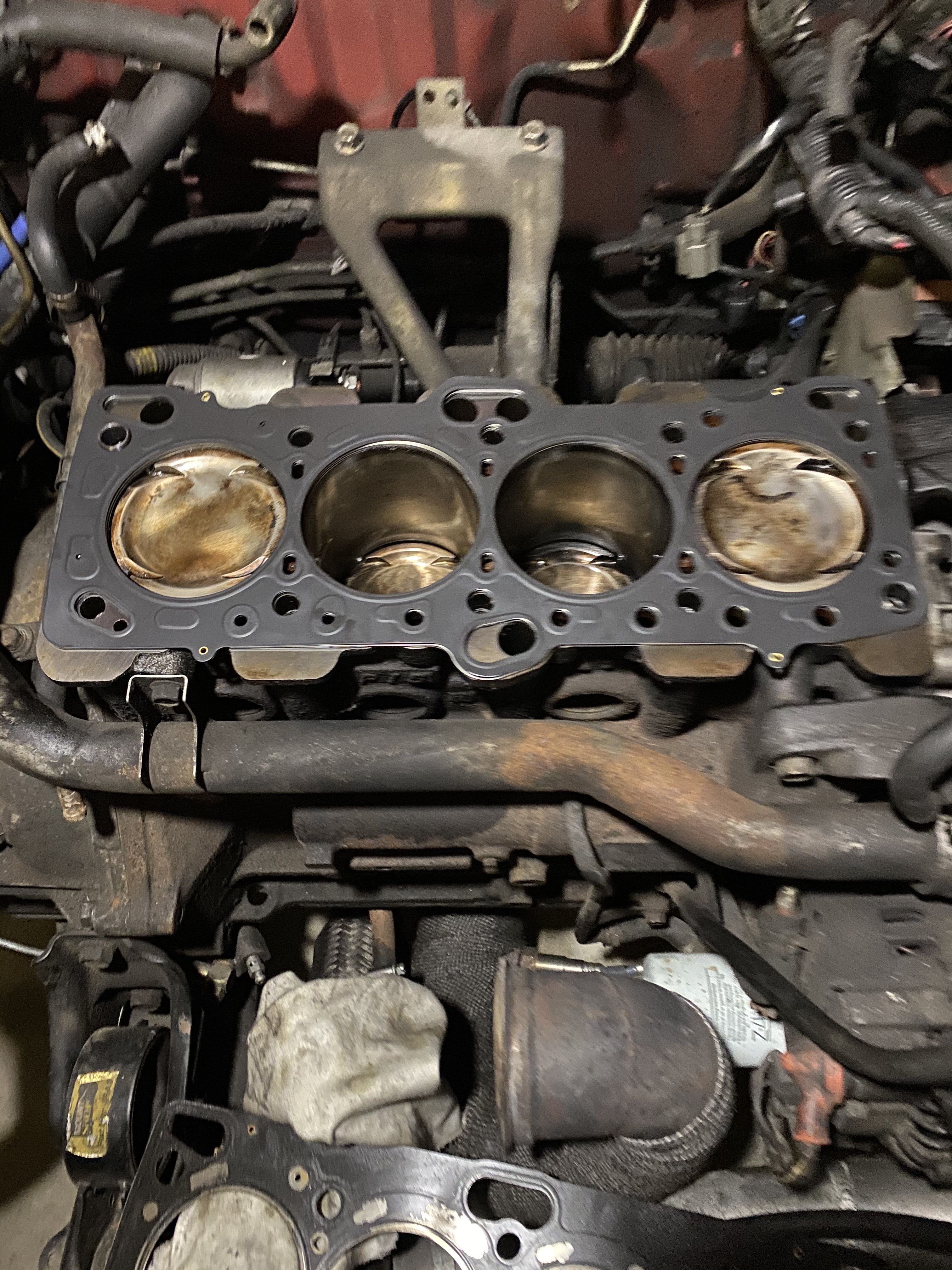

Here is the damage:

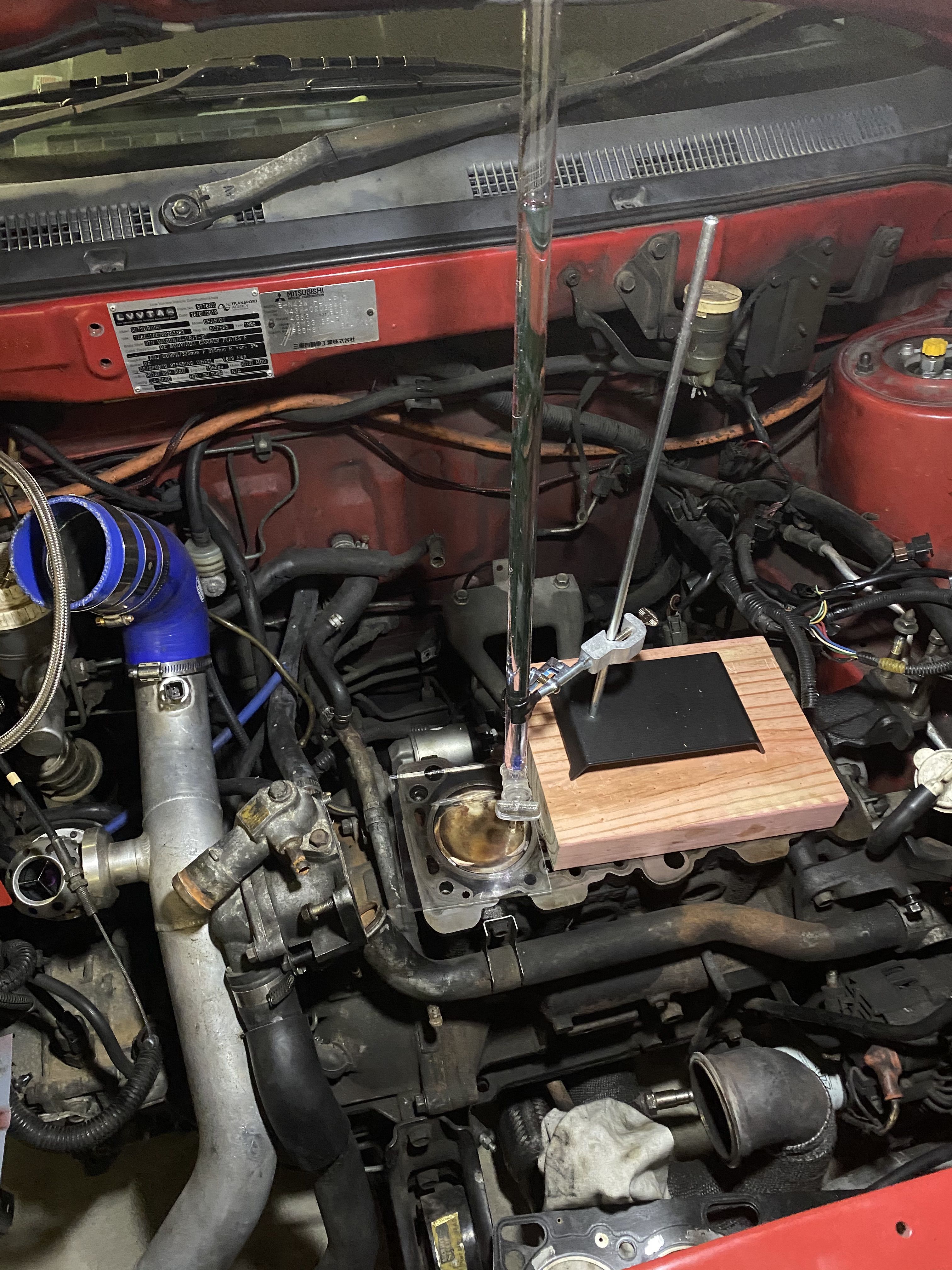

Block surface looks ok but not sure about this bore. I'd rather use another block and start again but don't have a workshop at the moment (I'm doing this in apartment parking building) so will throw it back together and see what happens.

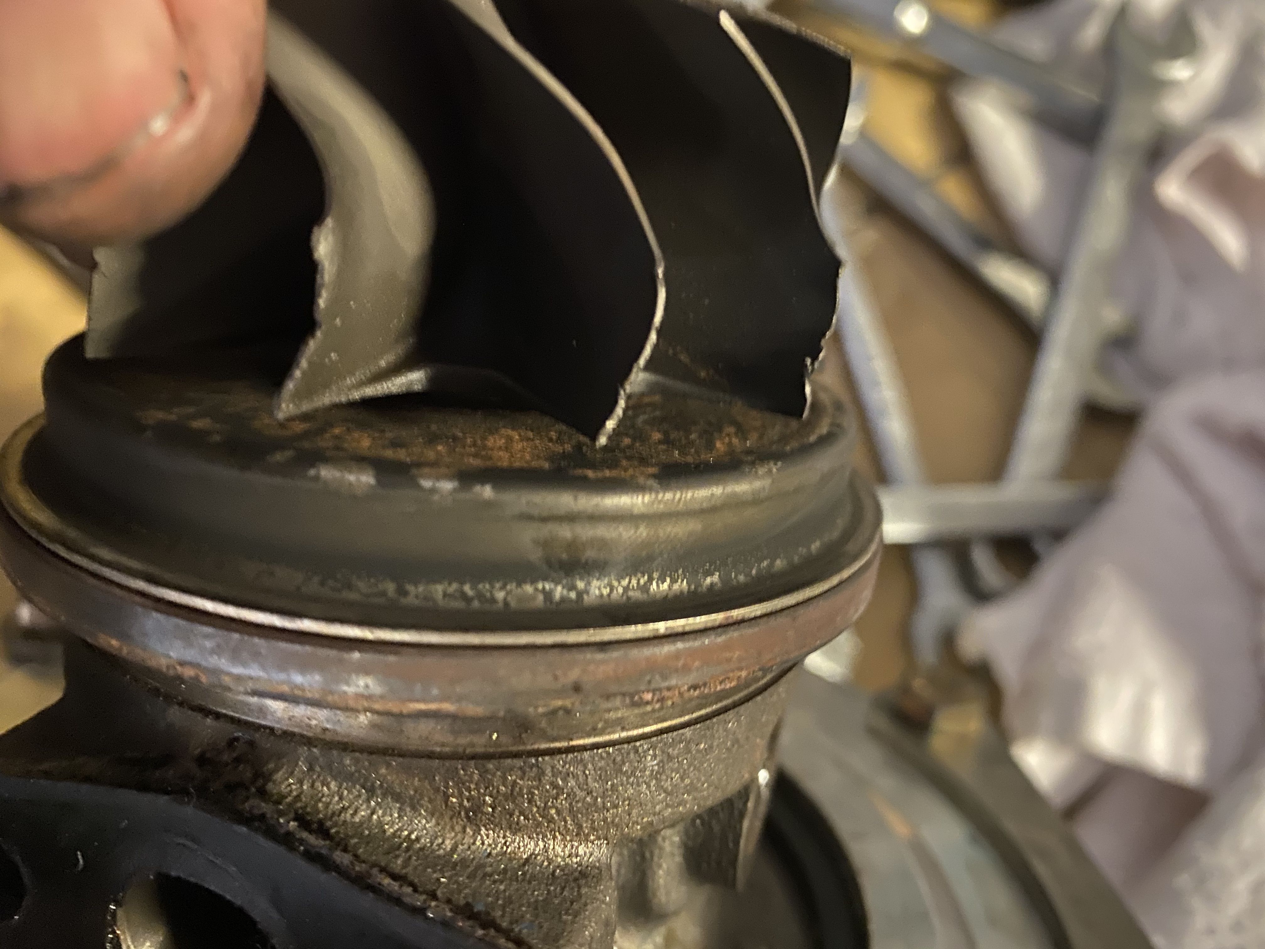

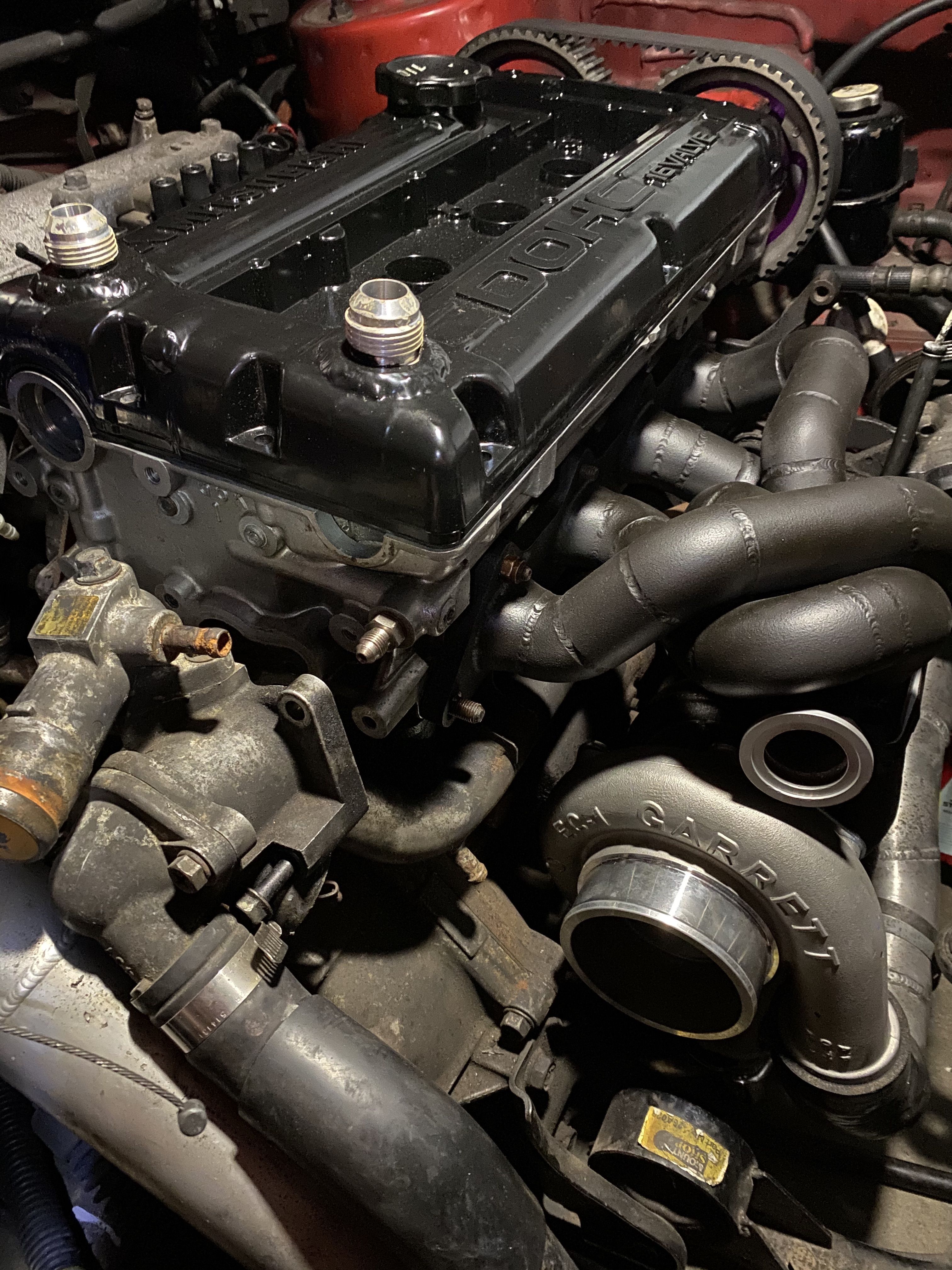

The above turbo was a thrust bearing chinese GT3582 with a Garrett twin scroll .82ar vband turbine housing, obviously it ate some of the head as it was coming apart. I've since had the manifold and turbine housing coated with hypercoat extreme from HP coatings here in New Zealand. Have also swapped out to a Garrett GTX3582r for some quicker spooling goodness.

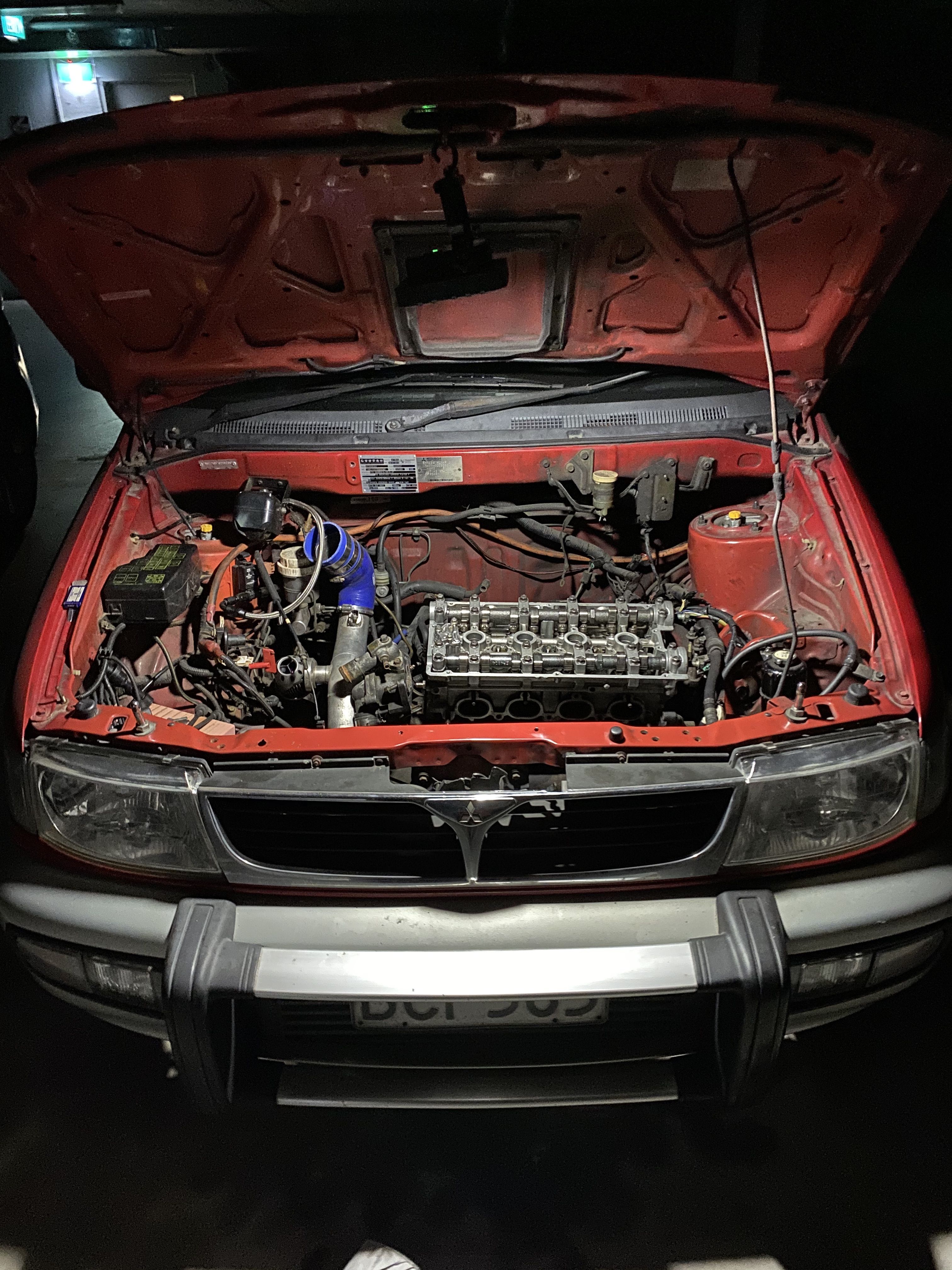

Shes all back together now. Just have a few bits and pieces I need to put back on. This Covid-19 lockdown is slowing me down though, I need to get some wire to make a loom to make the move to a 1G CAS. (removed the cam sensor that was attached to the stock cam gear)

Brand new GTX3582r
HP coating turbine housing and manifold

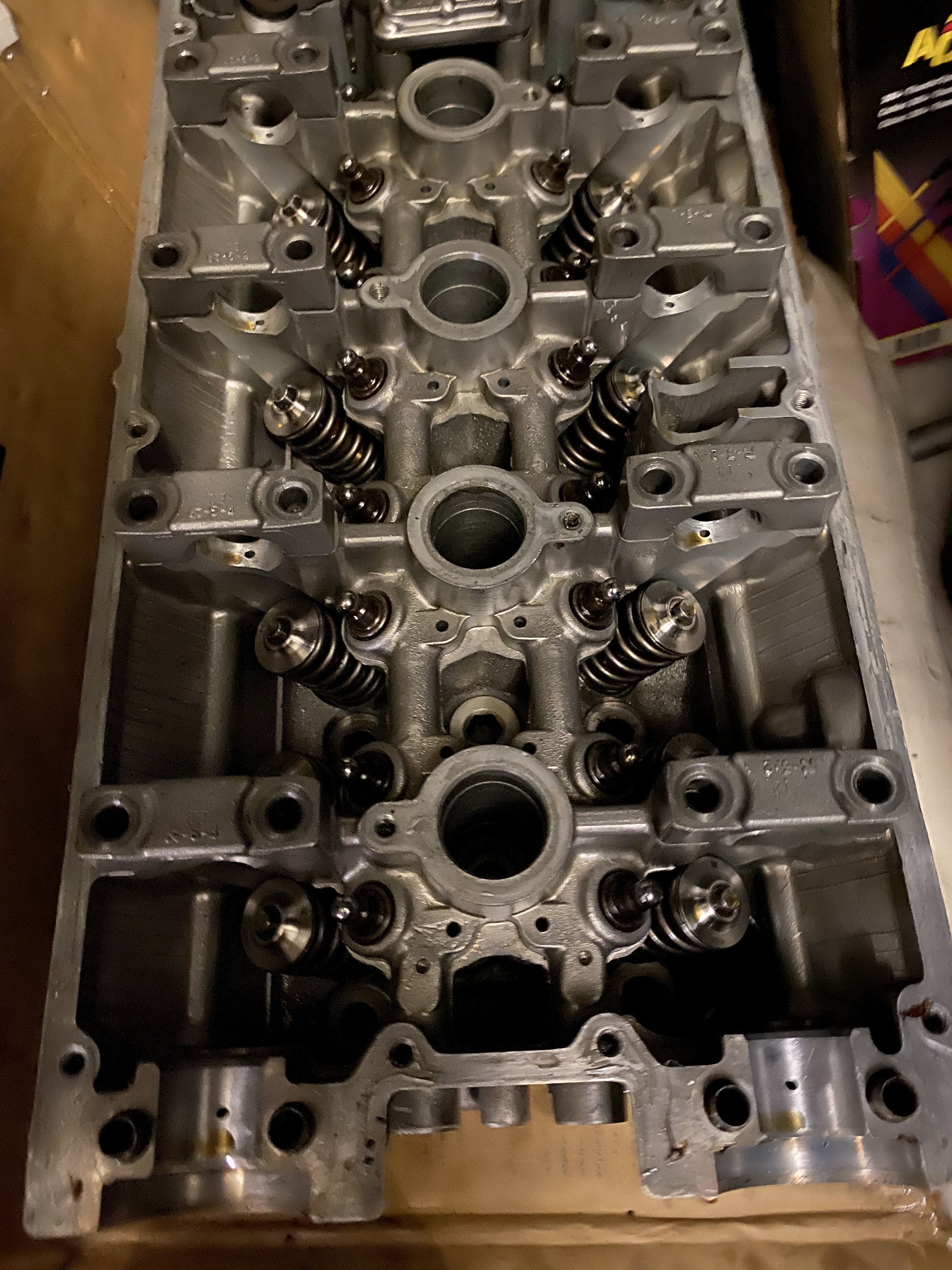

Ported head with 1mm oversized intake valves
Crower 280° exhaust cam and 282° intake cam (unknown vendor)
Crower valve springs with titanium retainers
HKS 1.6mm headgasket.
ARP 625 11mm head studs.
HKS adjustable cam gears.

Block with 1.6mm HKS head gasket. (gasket and bore are 86mm so block is .040" over)

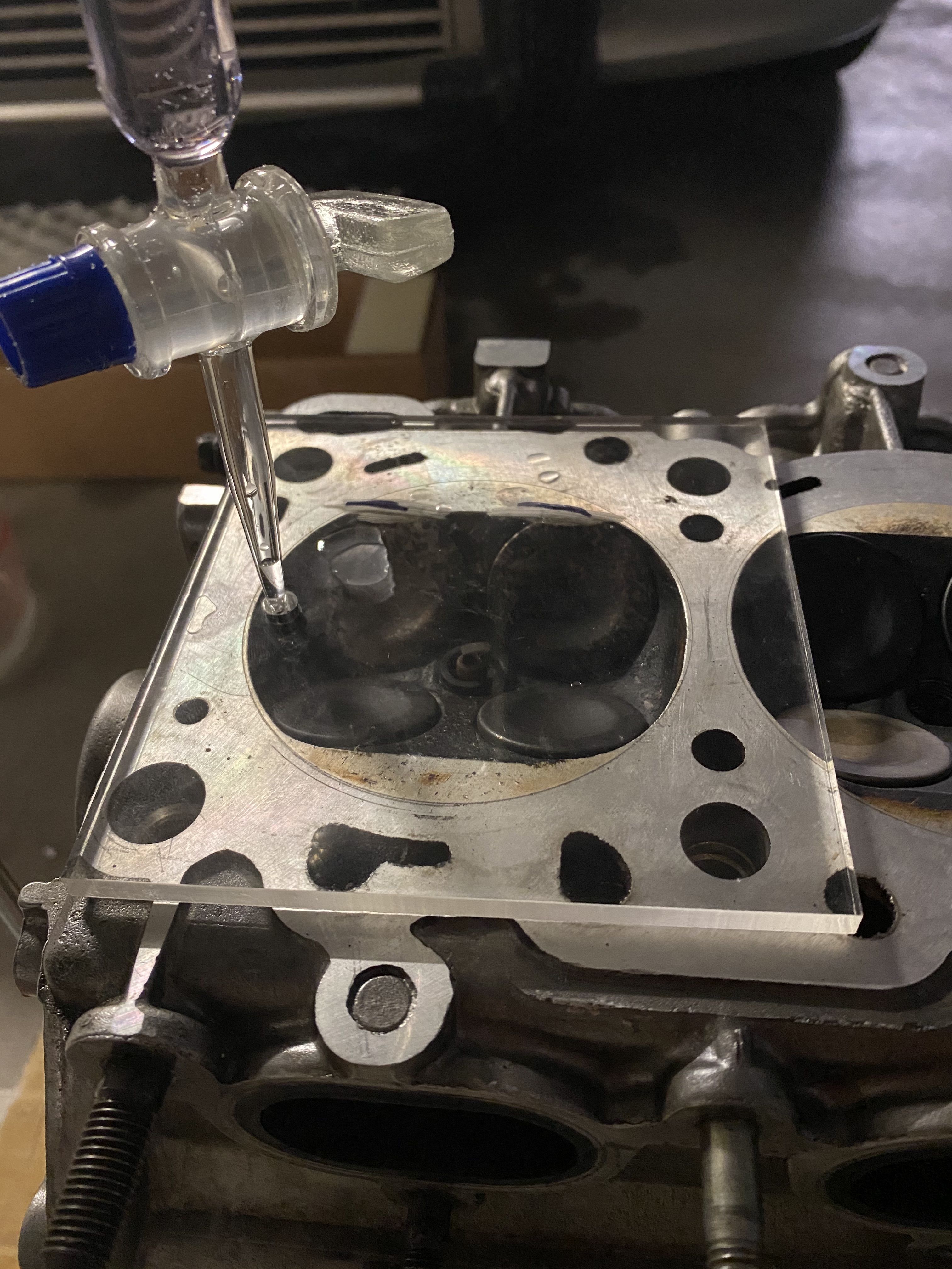

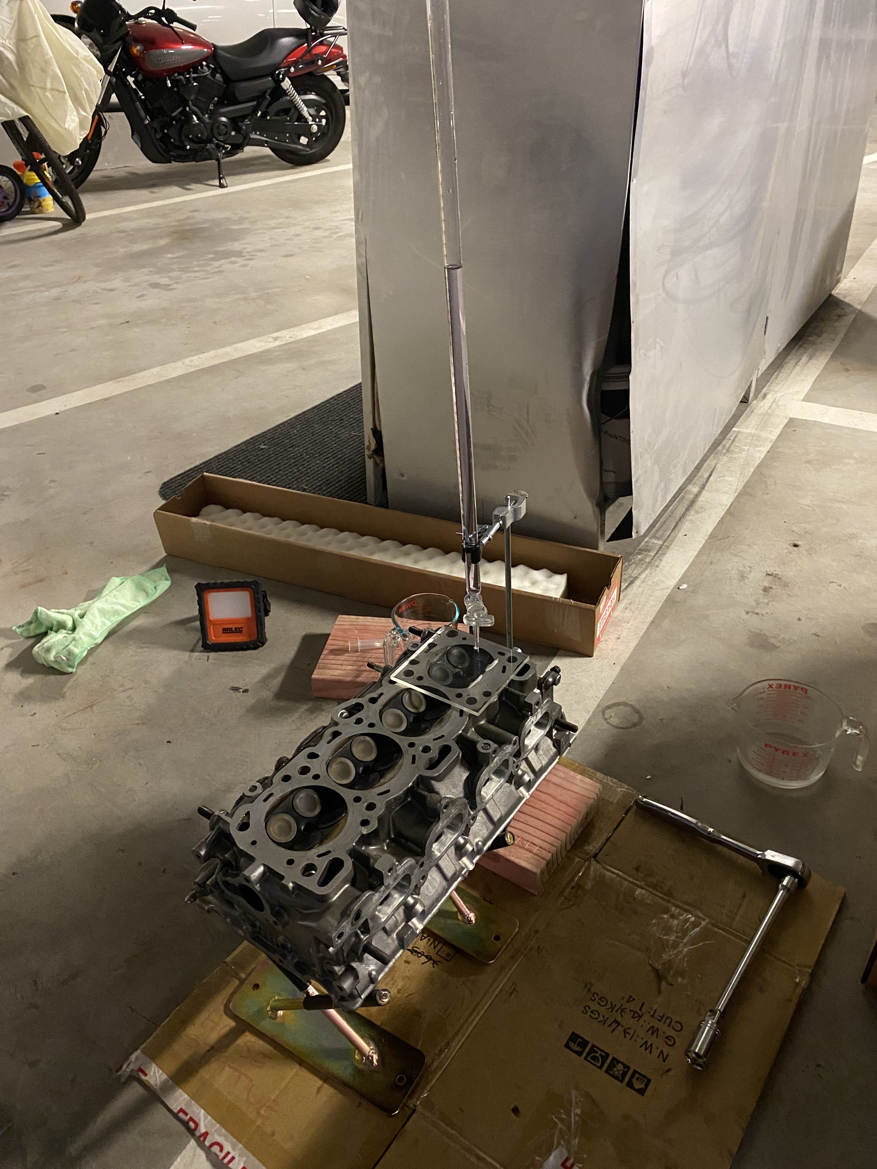

CCing the head and block. Static compression came out at 8.8
