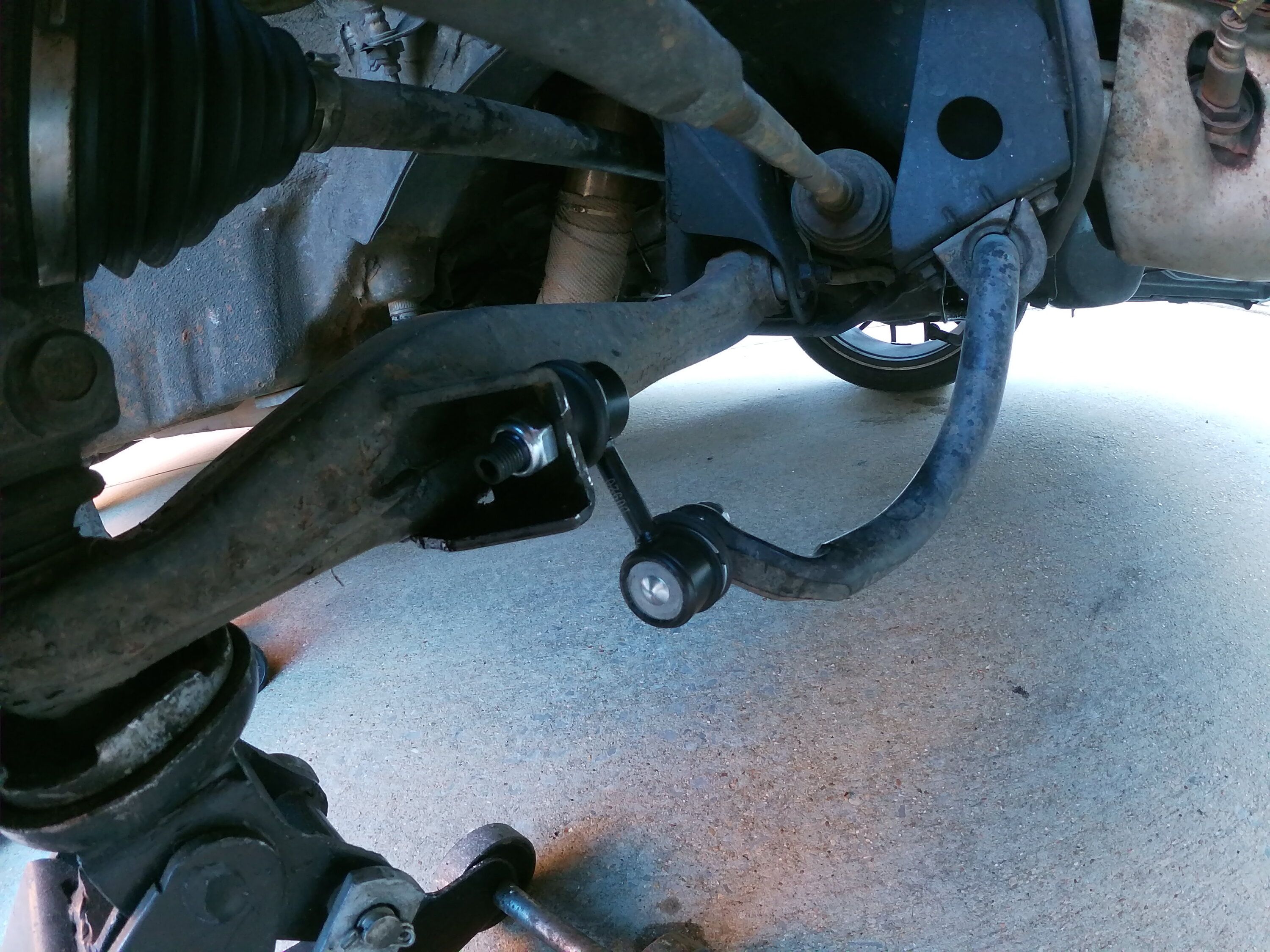

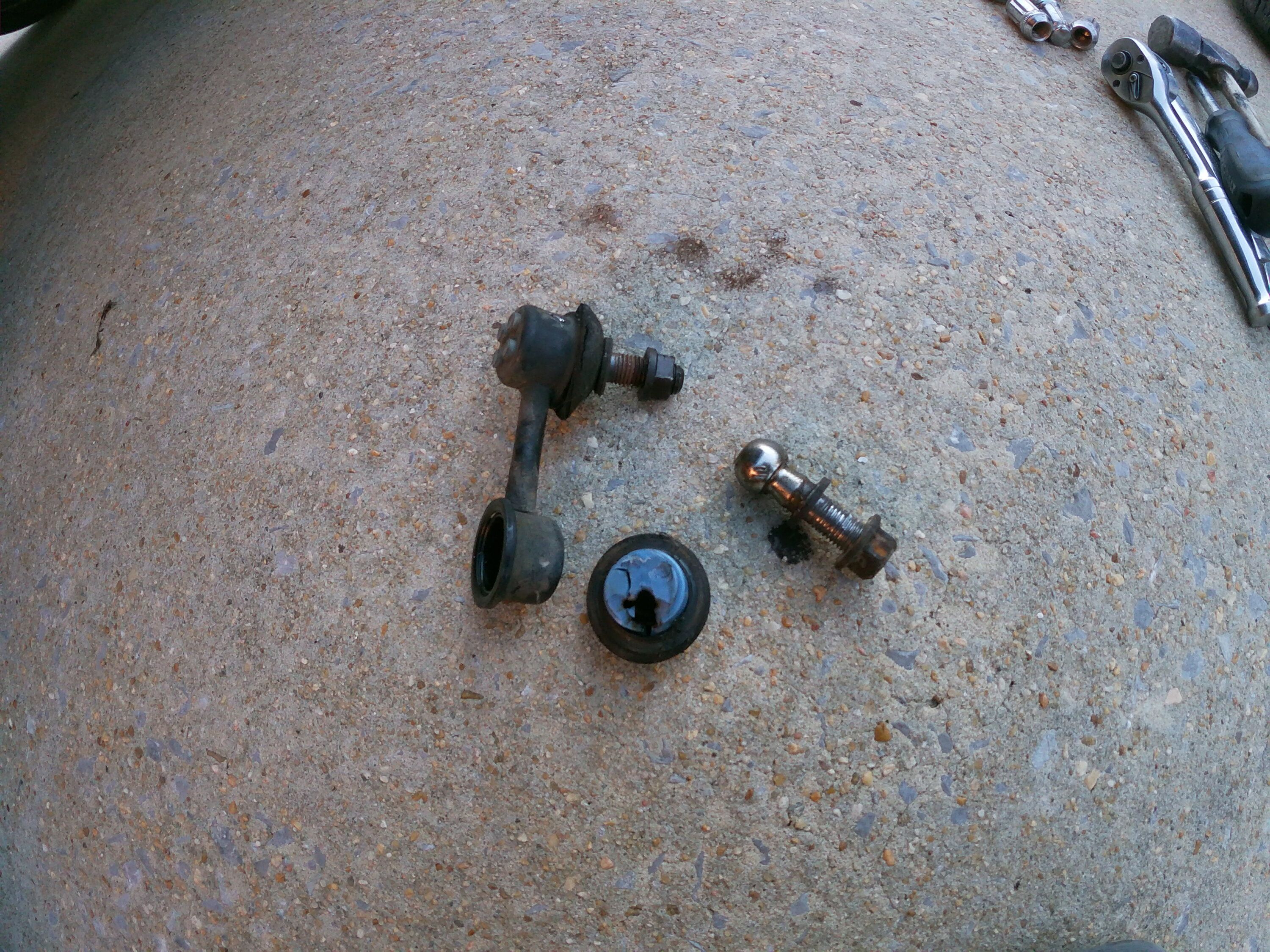

I replaced the sway bar links. The old ones were trash. I'm not really sure why they were so worn out, the car only has 100k miles on it.
Could be from less suspension travel, i notice you have lowering springs in the suspension on your mod list. Maybe the stiffness is adjusted too tight or too much spring preload. Thats a nice wrx by the way.

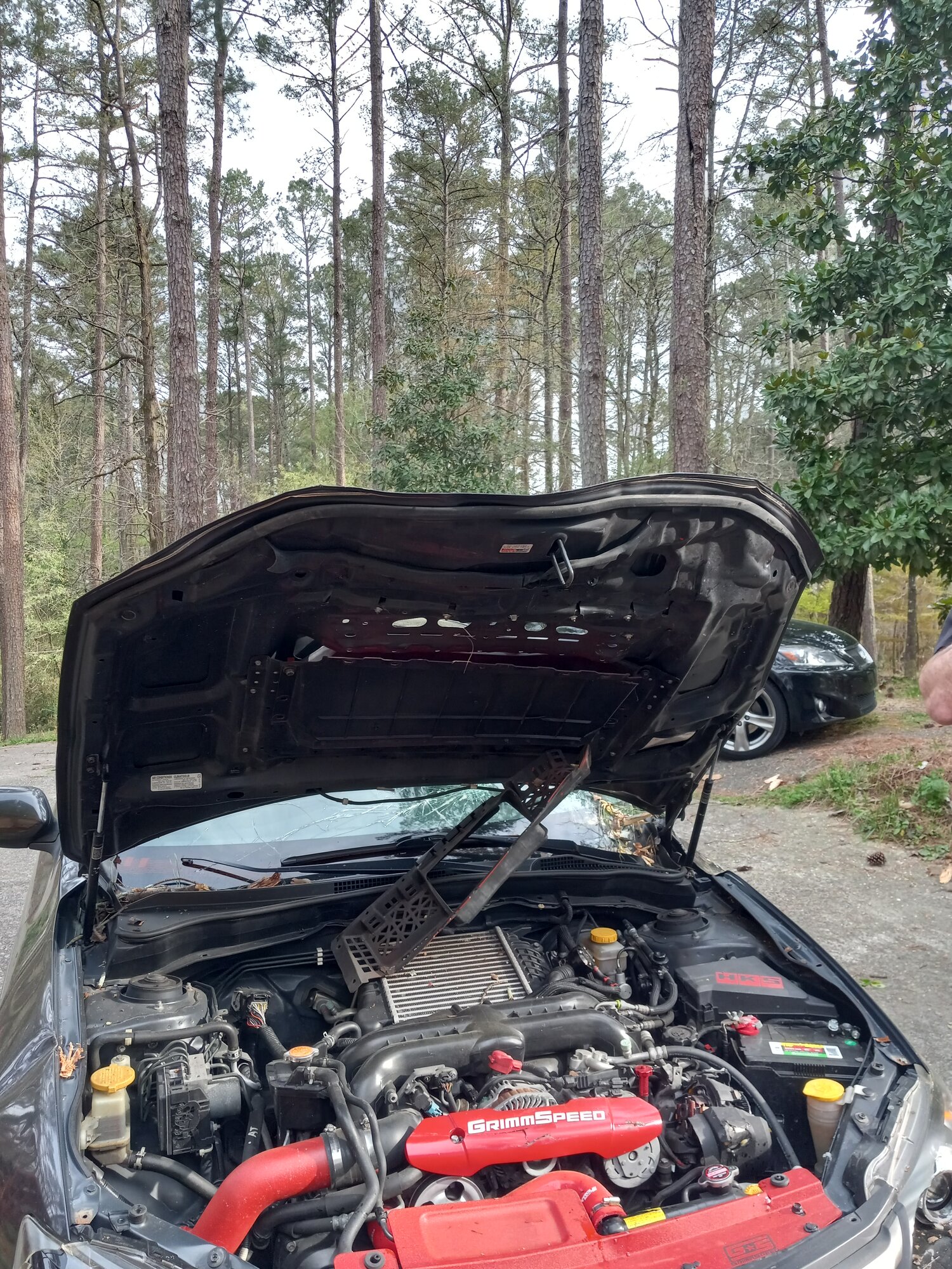

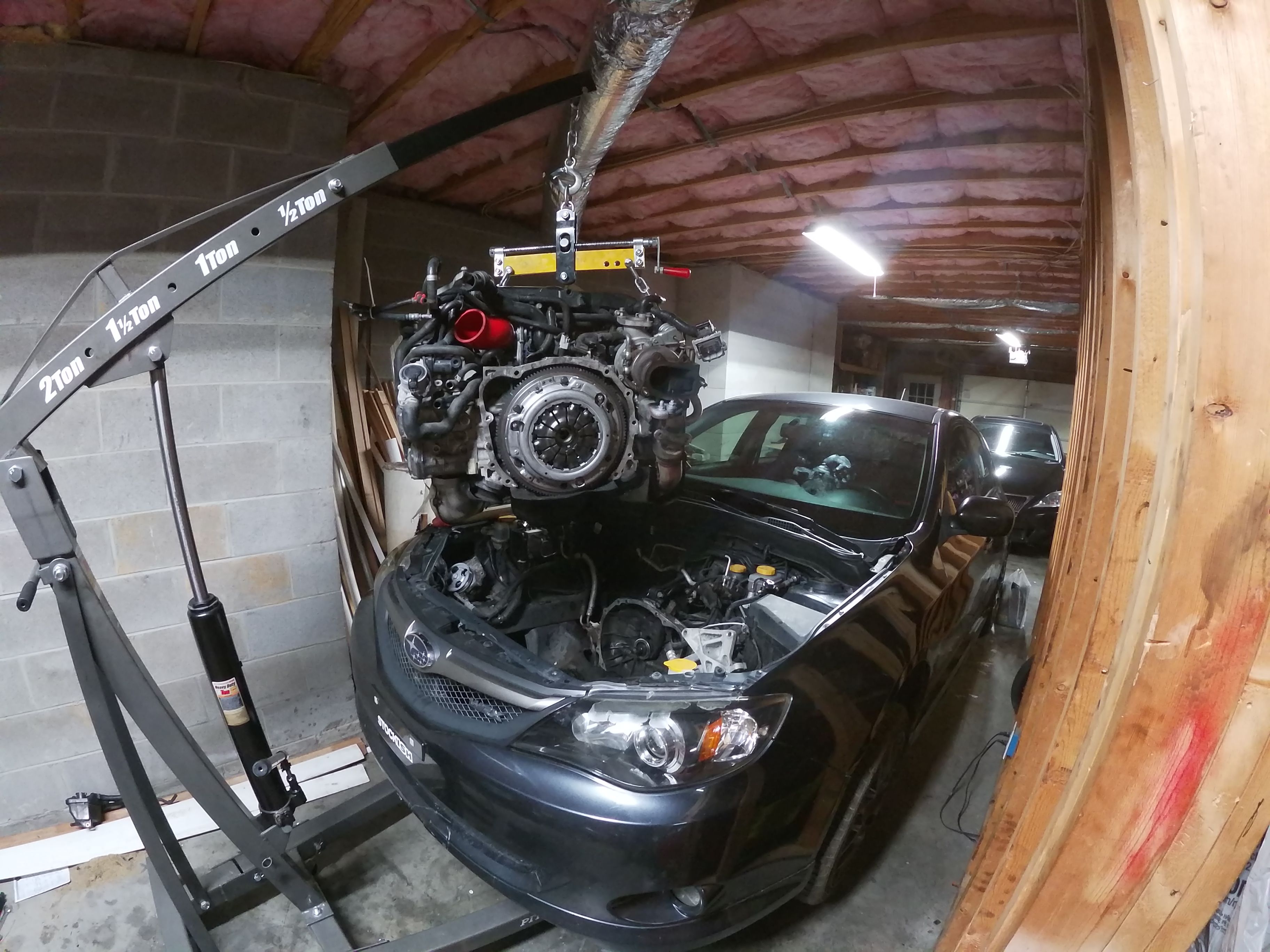

I forgot to update but I did replace the clutch. The whole system was fried so I got a new kit & flywheel. While I had the engine out I did a few upgrades, like replacing the notorious boost leaking intercooler hose with a Mishimoto one. Now the gauge reads a full 17 psi and it can smoothly build boost without that clutch slipping..

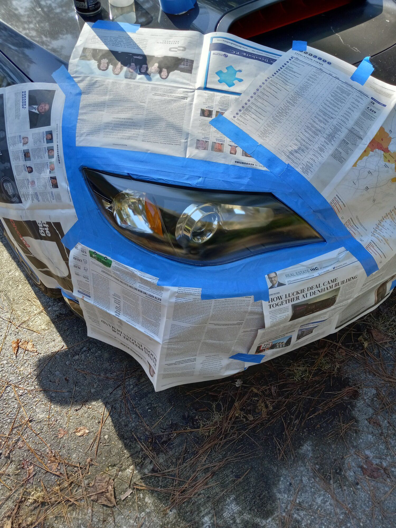

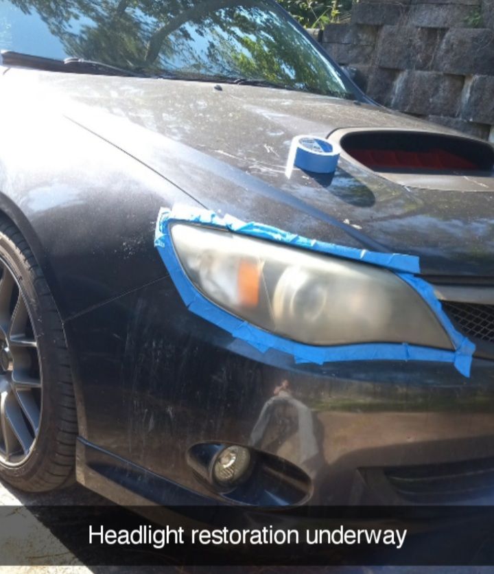

Pretty soon I'm going to restore those headlights. OEM ones are expensive and I've learned my lesson with ones from Ebay.

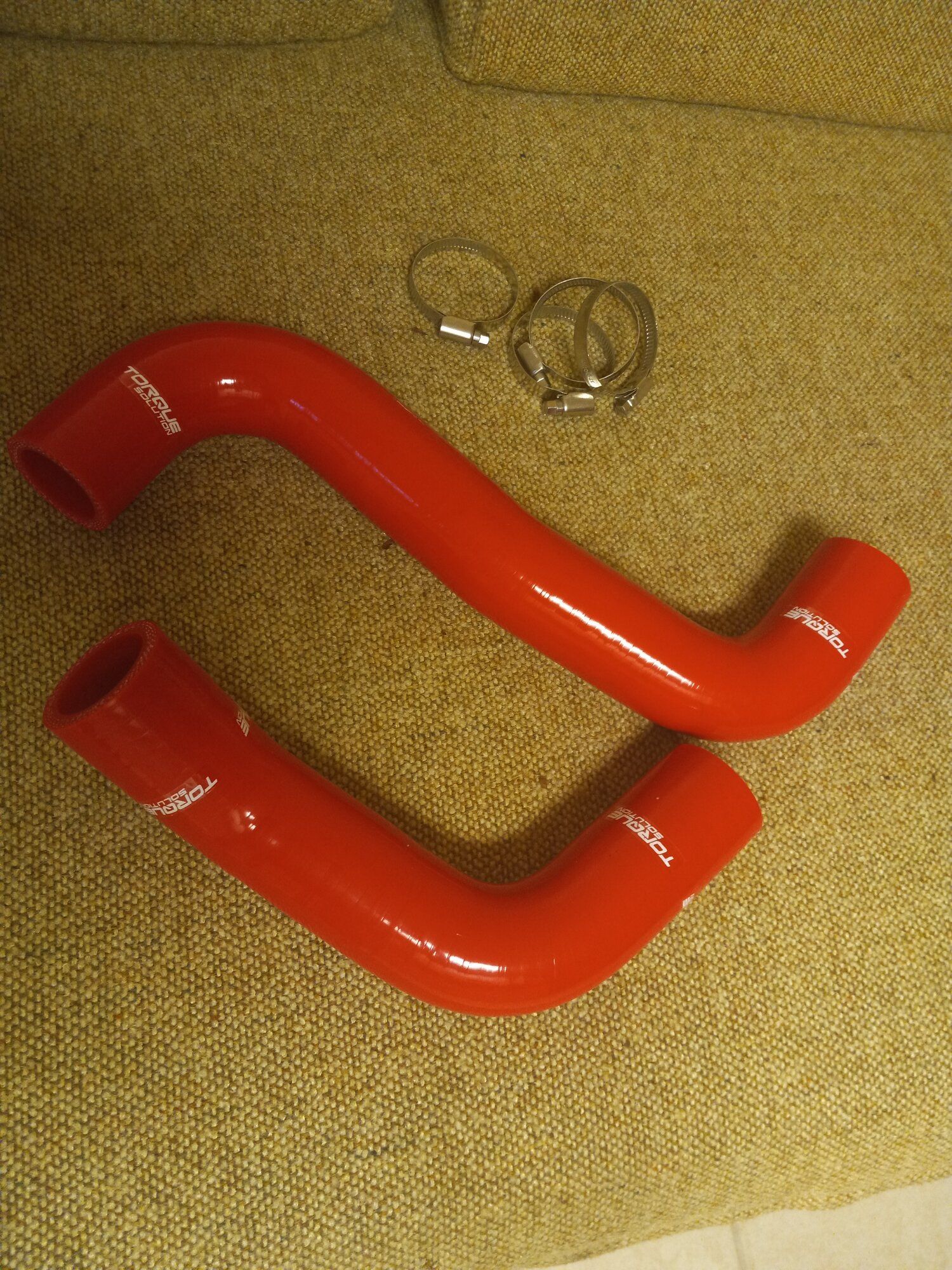

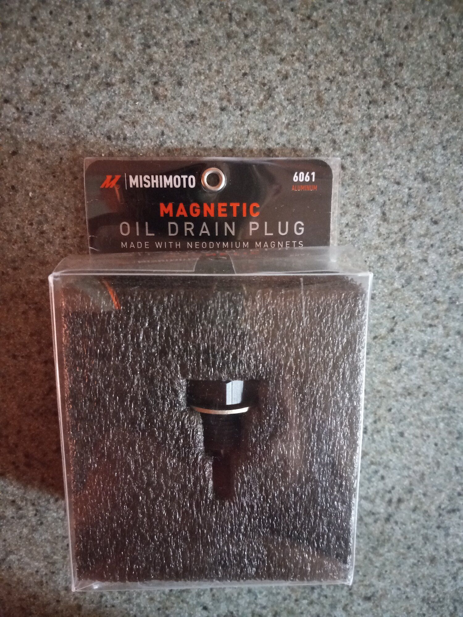

Been a few months since I updated. I've actually done a ton of work since then. This week's mods are silicone radiator hoses and a magnetic drain plug.
Dude those magnetic plugs are awesome for catching engine and turbo ware. I got one in the oil pan and one in the radiator and are fantastic preventative maintenance measure. Those torque solution hoses are clean looking, i have only bought their motor mounts i didn't know they made hoses too.

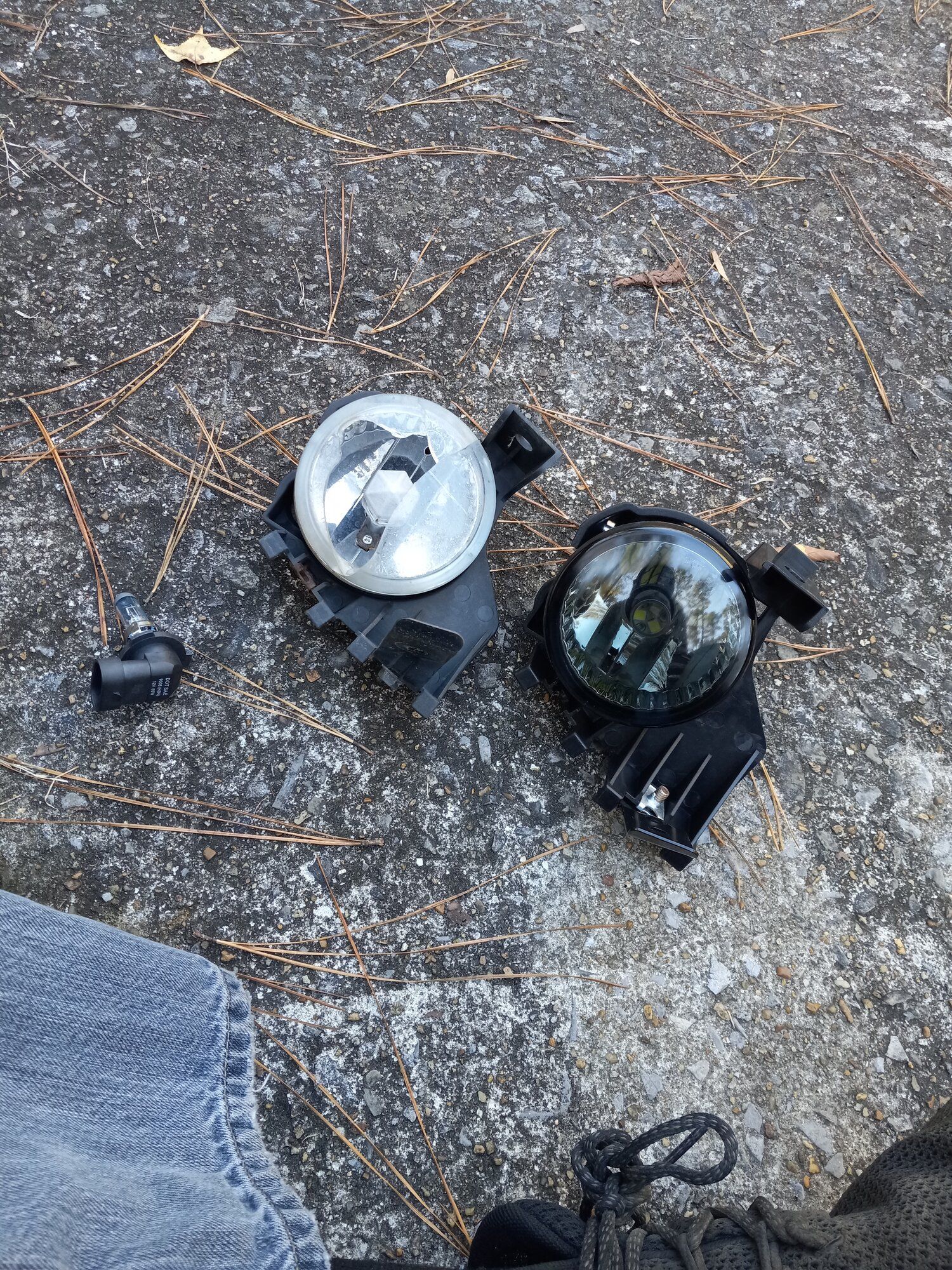

Since the headlights were done it was time to do the foglights. I went with tinted glass. To ensure there wouldn't be any visibility issues at night I also swapped over to HID projector bulbs. Very sleek during the day and very bright at night. You can see the original lights had taken some damage over the past 11 years.

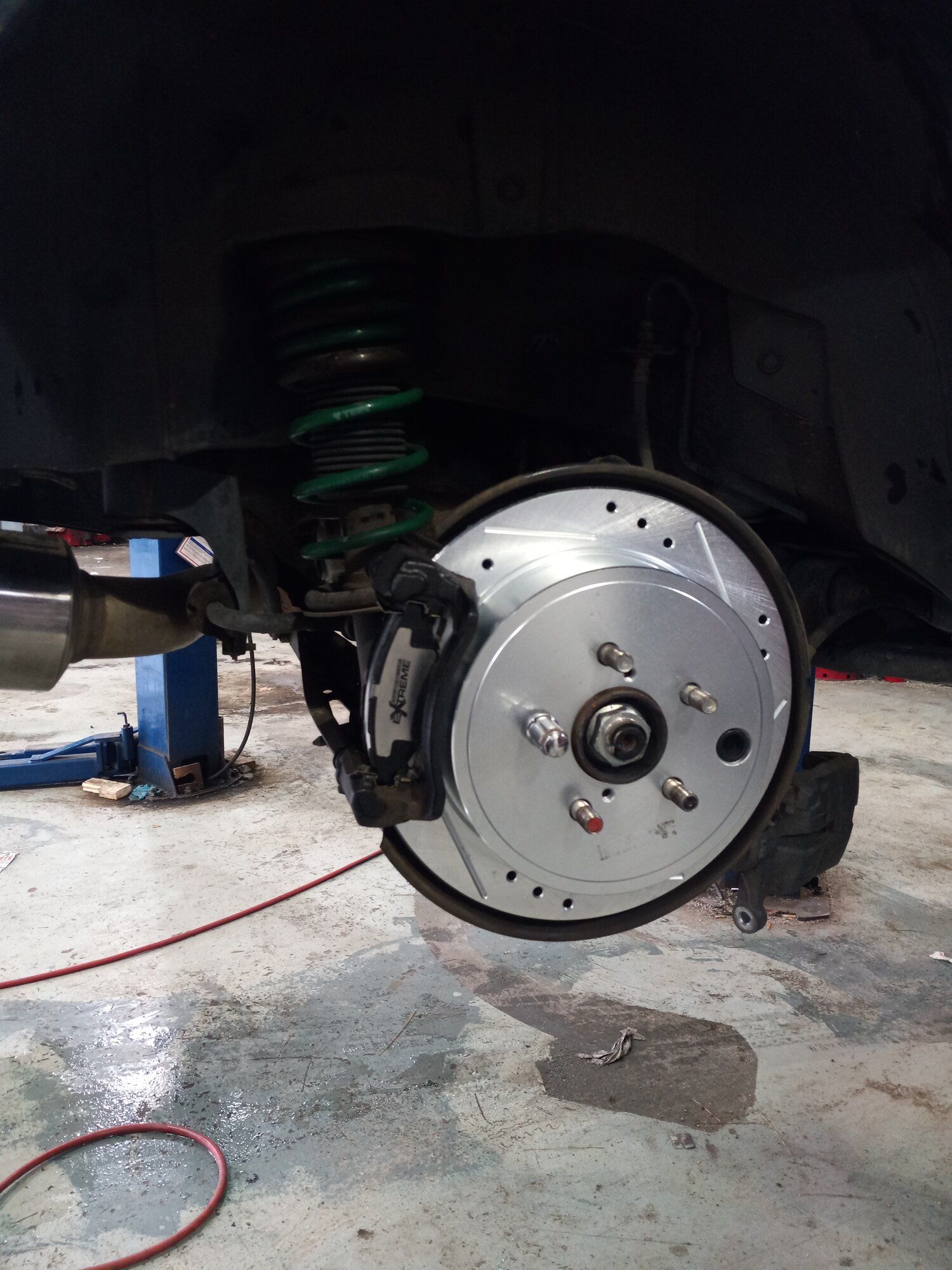

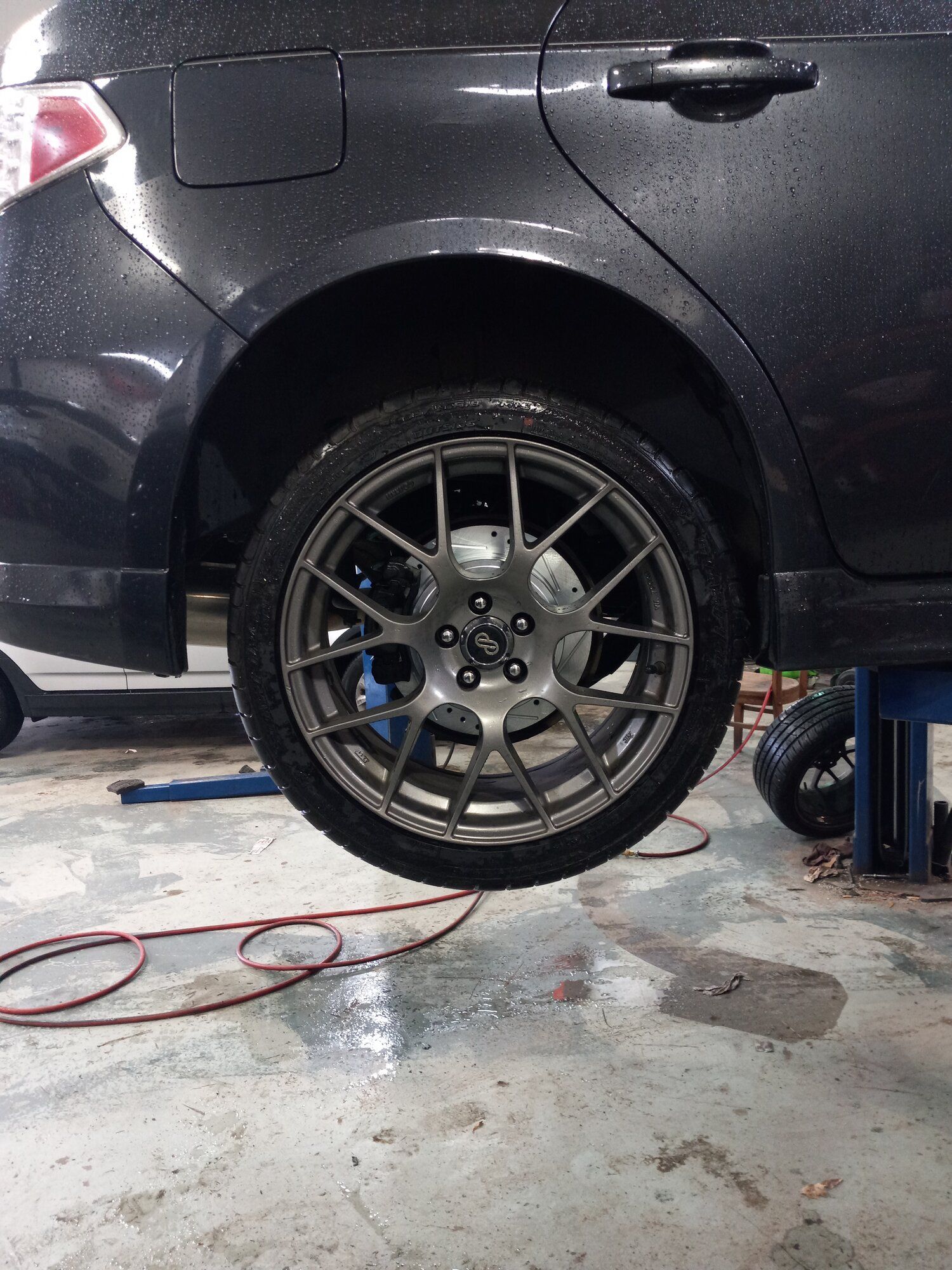

Time for the projects has been limited, but I'm doing the best I can to make progress. I did the brakes on the WRX. Powerstop drilled and slotted rotors and Extreme pads. The car looks and stops much better. At some point in the future I'd like to do a big brake upgrade, but for now this will work.

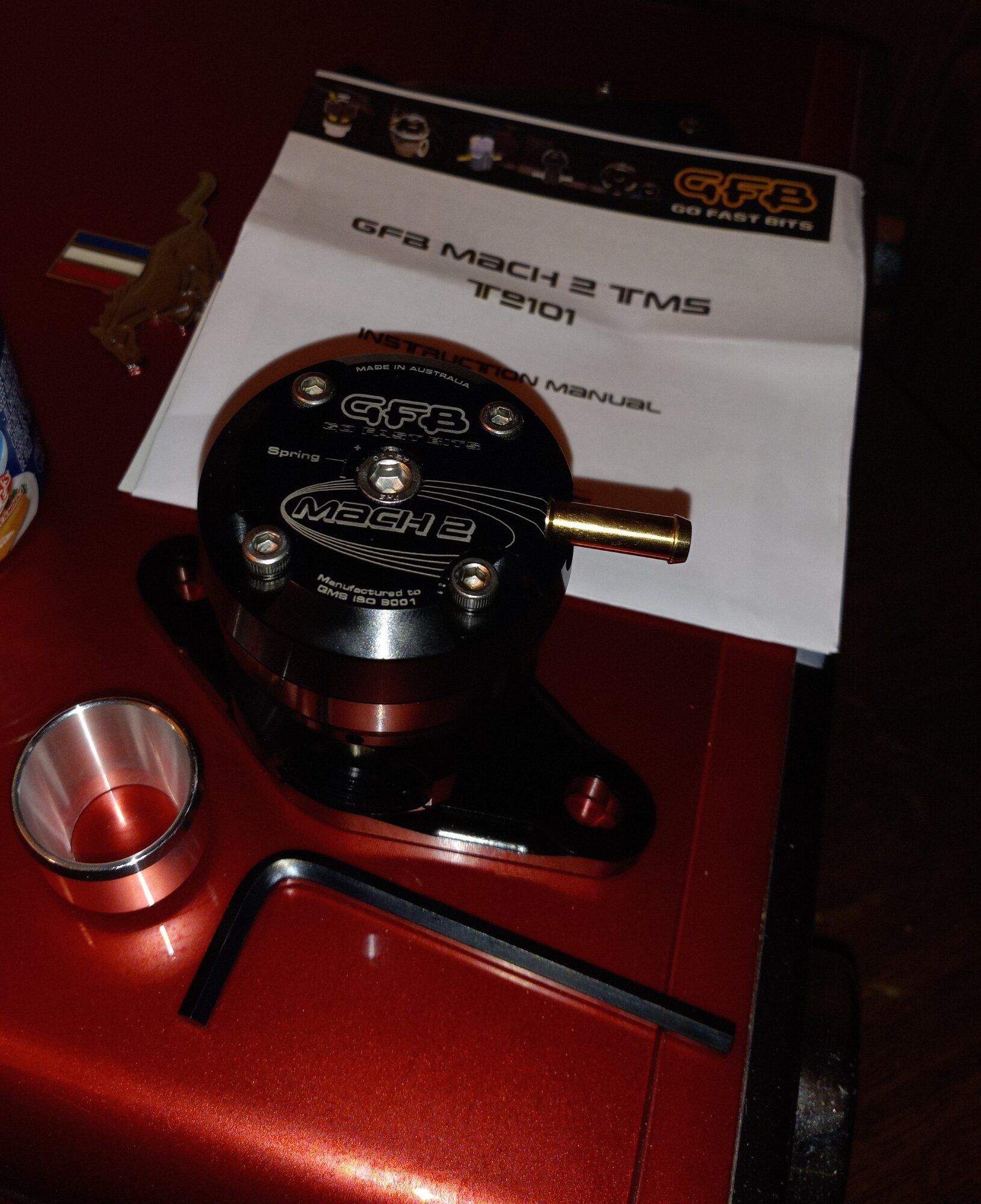

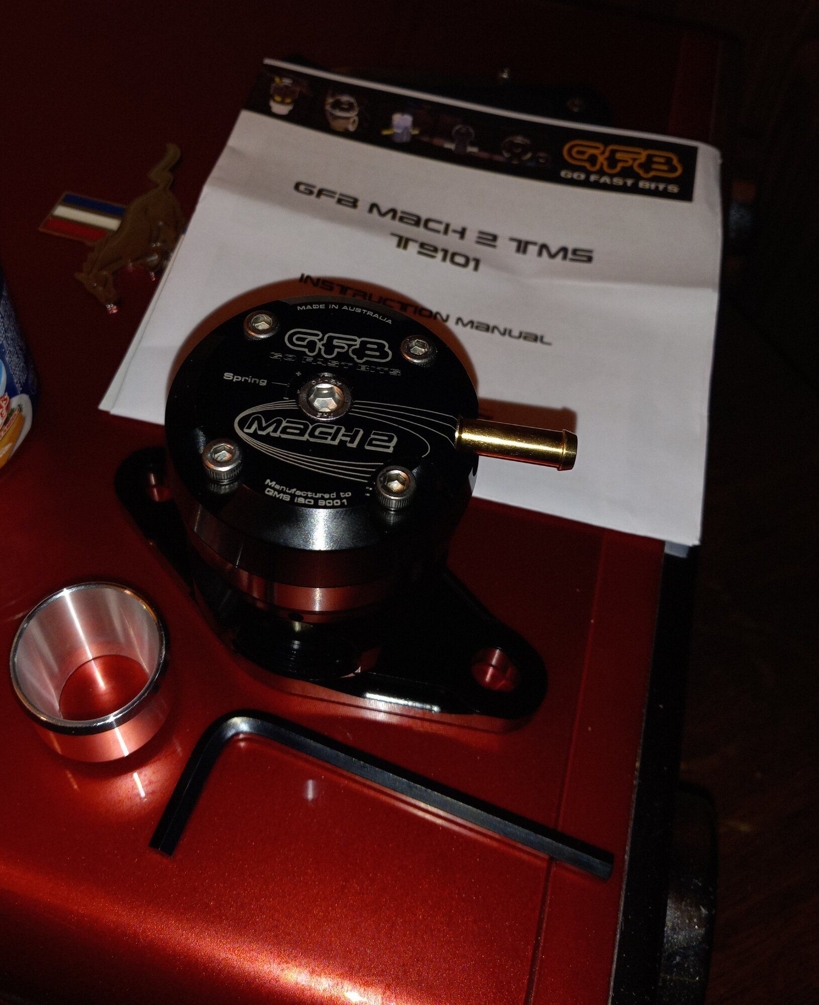

Dude GFB stuff is awesome! Is that the one that can vent to atmosphere and recirculate with an adjustment so you get the sound and the benefits of recirculation?
Yea it came with 2 separate fittings. One to hook back up to the stock recirc hose, and one to convert it to a blowoff valve. I'm currently going to have it set up to recirulate but once I get time to retune it I'll switch it over to blowoff

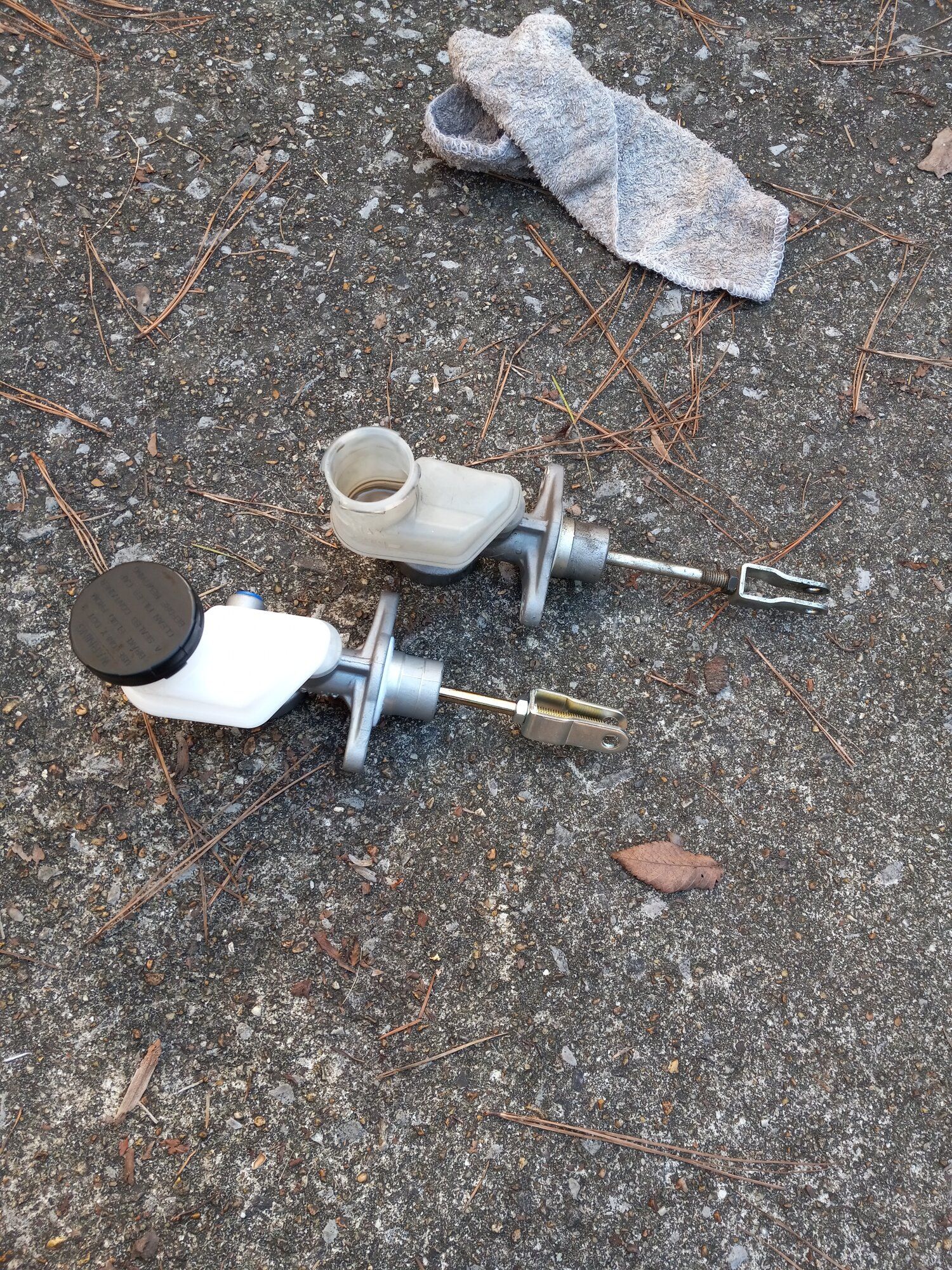

I replaced the clutch master cylinder. It started making strange squeaking noises when I pressed the pedal and air was entering the system. It's back to proper functionality now. I also like how the new one came with a black reservoir cap. I never was a fan of the yellow accents that Subaru chose.

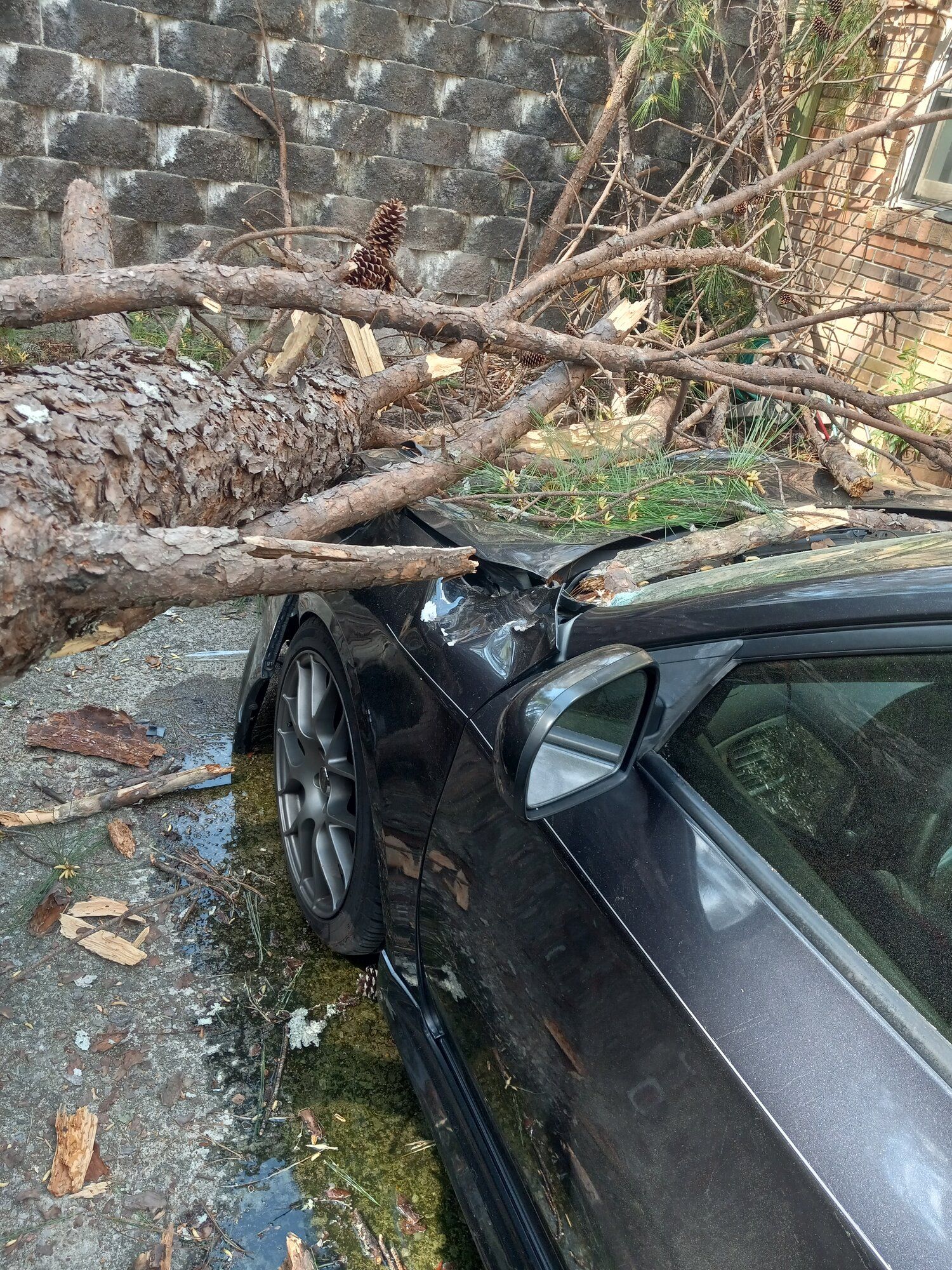

Earlier this evening this monster of a tree came down due to some high wind speeds. And it smacked down directly on top of my WRX.
This car is simply irreplaceable. There's no amount of money I could place on it, and the simple fact is I will never find another like it.
But I can't change what happened. I just have to take my insurance payout, buy another car, and let this one go. The frame damage is too severe.
