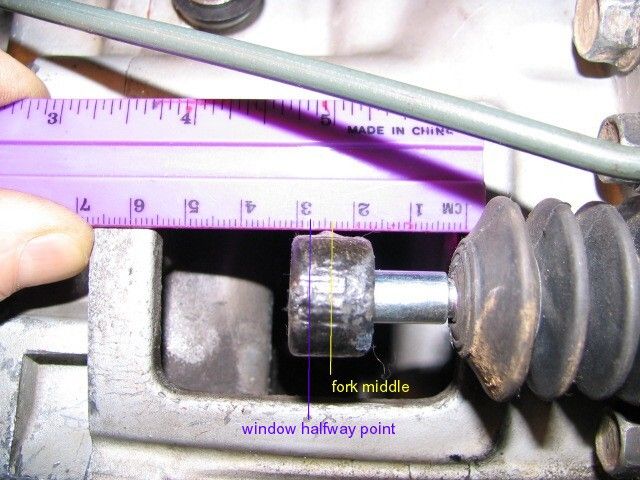

Yes that was way to far to the passenger side. https://www.roadraceengineering.com/eclipsetech/clutch/armcentered.jpg
Here's mine: https://www.dsmtuners.com/attachmen...-fork-shimmed-pivot-ball-at-0-071-jpg.148436/
This is the first time I have ever used a competition clutch fork I usually just buy an oem I never checked the slave rod depression point to the tob pivot point and I already tossed my oem.
Well I'm sure the competition fork must be the same length (or nothing would work for everyone), probably just stronger. I was just wondering if you had compared them before the install. Don't worry about it.

Show us the position of the clutch fork now.
