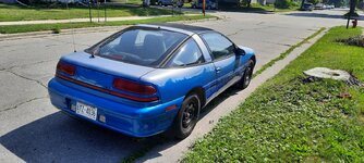

I have a 1992 Plymouth Laser RS and it ran fine for the first two months I had it and now the CEL is on and there a huge loss of power and sputtering whenever I give it gas from a stand-still.
