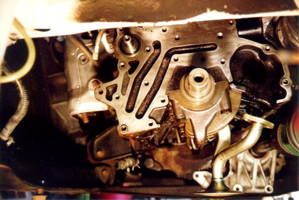

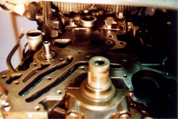

So, I have my rotating assembly in, everything is good, I have my front case with balance shafts installed and everything, and I slide it in and the oil pump shaft is fine, but the B shaft is tight enough I have to turn it with a wrench. It is not binding on the case, everything turns freely until the B shaft (front Balance shaft) engages the last half of the rear bearing. I popped the balance shaft out, flip it around and verify the front bearing is fine by inserting the front journal of the BS in the front bearing, backwards, and it’s smooth as silk at all points. It’s definitely the back bearing on the front shaft. I looked with a small camera and it was a tiny bit marred from installation. (Although not bad enough I thought it would cause the issue.) So I knocked that bearing out just to be safe, and ordered and installed a new one. I used a bit of thin oil and it drove in straight and looks fine, but it’s still the same tightness. I’m just testing it with the shaft by itself now, and the last 1/4” or so of the shaft feels hard to install. It spins freely all the way up until I pop the last 1/4” in and then it gets hard enough that it takes a wrench. I mean, just like barely using a wrench, it takes maybe 1-3 ft-lbs on the ol’ biological torque-o-meter. And it does spin smoothly. I can’t find a spec for the oil clearance on these bearings, but my old motor the case came from was really easy to turn the shaft with two fingers...nobody seems to make a oversized bearing for the BS either. I’m the bearing is not ridged or mushroomed or scratched at all, and the oil hole is lined up right. I’m baffled. I was giving some thought to “honing” it with metal polish and a spare balance shaft, does anyone think that seems ok? How would I know when I’ve removed enough? Just by feel? Should I just have the shaft turned down .0005-.001? Should I just try to have a machine shop line home the balance shaft bores and get new bearings again? I hate that idea, I just got the rotating assembly in. (I’ve learned my lesson there too, make sure the damn BS works before putting pistons in!) Or, finally, should I just give up and delete the shafts? I have a GSC elimination kit and I could just put that in. I’m trying to keep the BS for the sake of the synchros in my Jack’s built trans I just got. It’s just a full synchro build box and I REALLY don’t wanna trash it.... Any advice would be very much appreciated!
I am gonna throw in the towel tonight but tomorrow I’m gonna mic out the two balance shafts I have, I’ll post the numbers. Unfortunately I can’t measure the bearing ID because my bore gauge is not long enough. Maybe I can rent one. For the clearance, based on the size of the shaft I would imagine a clearance of .0015 +/- .0005” would be appropriate, right? Would I be better a bit loose on the BS bearing since it has basically no load?
I don't have any answers to those questions but am interested in how this all turns out. Just FYI I replaced the front case with the engine still in the car! So anything is possible when you set your mind to it.
