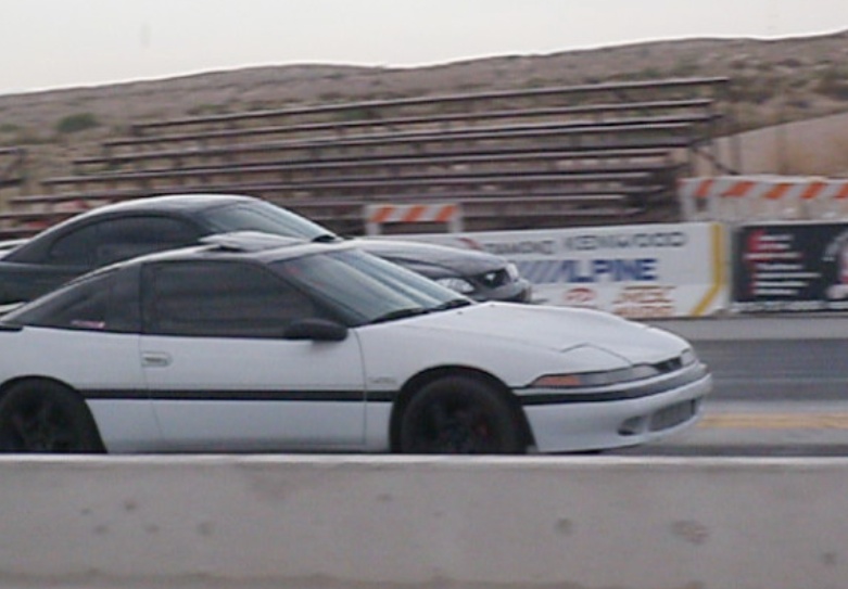

I went to the track May 22 nd and I ran a new personal best of 14.1 @113 which is .2 and 12 MPH faster then my previous best pass. Once again there was no track prep and it's killing me. I'm on E85 now though which is as awesome as they say. Now if I can go on a day with some track prep so I can get my ET down some more I'll be good to go. Here is my timeslip info:
Pass - 60' - 1/8 ET - MPH - 1/4 ET - MPH - Time - Notes (changes listed were made prior to pass)
1 - ????? - 9.507 - 90.10 - 14.155 - 113.52 - 6:34 - No slip 1st pass, this was 2nd, HL, CEL cooltemp 229*
2 - 2.551 - 9.666 - 89.57 - 14.330 - 113.06 - 6.51 - I raised the VE table a little before this one.
3 - 2.468 - 9.596 - 89.78 - 14.256 - 112.95 - 6:56 - HL
4 - 2.516 - 9.721 - 89.14 - 14.362 - 113.12 - 7:34 -
5 - 2.621 - 9.940 - 89.49 - 14.573 - 113.63 - 7:40 - CEL 3.9* of knock, spinning 1st & too much timing, HL
6 - 2.580 - 9.688 - 89.32 - 14.350 - 113.35 - 8:34 -
All of these passes were on E85, 20 psi of boost (still 14b with 6cm hotside), 24 psi tire pressure, burnout on passes 3-5, timing was 12-19* advanced, HL = hot lap

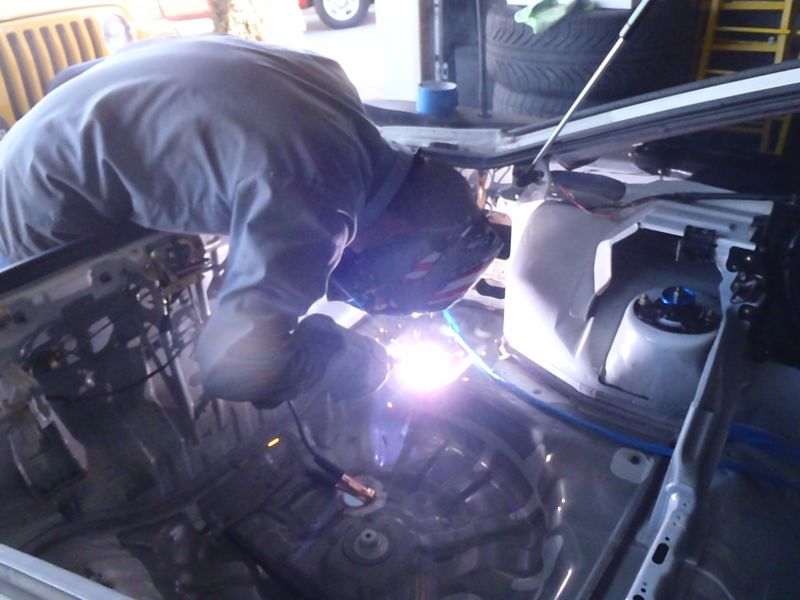

The July SCCA SOLO event was cancelled and I didn’t see much point going to the drag strip without better traction so I decided to take on a new little project, my trunk. I removed all of the sound deadening material from the trunk and the rear seat area. It actually came out pretty easy. I used a hammer and a paint scrapper to get all the big stuff off and then some adhesive/decal remover to get the rest of it. In the end I removed about 7 lbs of sound deadener tar. After that was done I found several factory trunk brackets that I had no use for and I removed them as well. However in the process of removing the brackets I ended up with a few holes in my trunk. Here is where my welded (which I had been practicing with) came in handy. I welded all the holes up and then grinded everything smooth again. Once I was happy with the floor I cleaned and prepped it and sprayed it with a beautiful gloss white. Also my trunk and back seat area trim had some sun damage form the last 20 years so I cleaned those up and painted them back to charcoal grey. It turned out fantastic once I got everything painted and back together. Here are some pictures.

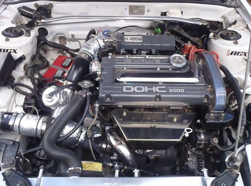

I bought a Tial 50mm BOV back in May and I just got around to having the flange welded to my UICP and getting it installed. It sounds way different then my crushed 1g BOV. It sounds more like a bark then a woosh to me. It's going to take a little while to get used to. Here is a picture of how my engine bay sits as the end of July, 2011.
