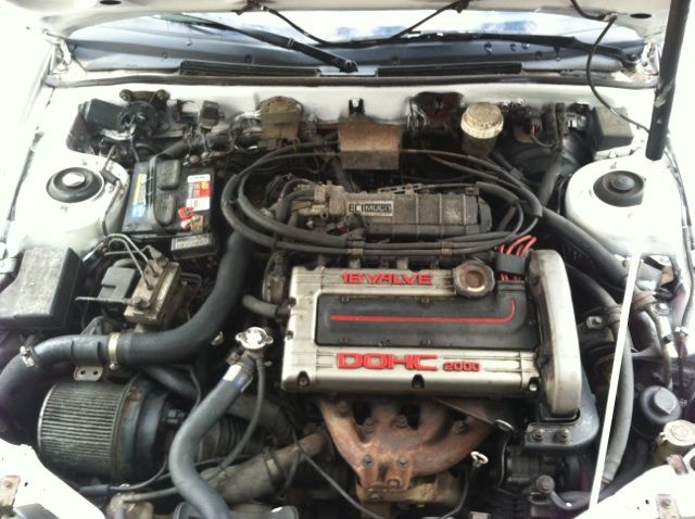

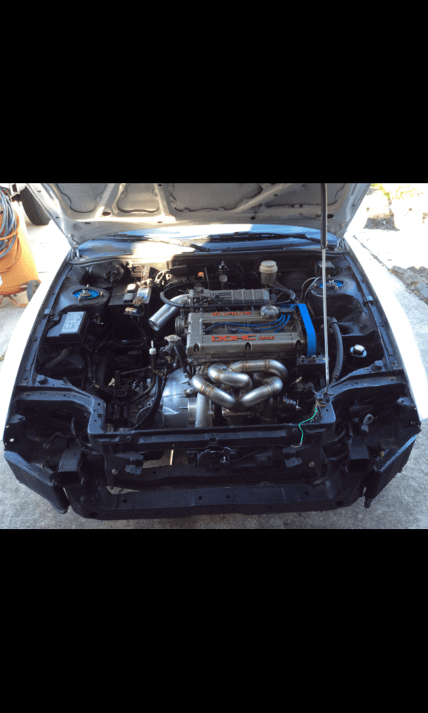

Bone stock engine bay.
Not sure whats up with the pictures. I'mm using the IMG code provided by photobucket and pasting directly into the reply. if this is incorrect or if someone knows a fix let me know because I have alot more pics to post
Cool car should be a great base to start with. Looking forward to the updates.
Not bone stock, but pretty close. Has a hacked aircan (stock one is fully covered) and someone took the exhaust heat shield off (probably because it was rattling.) I'd recommend some kind of shield again because the manifold gets everything super super hot without it. I ran without one for a few years and there was a noticeable difference putting it back on.
Good eye! Hahah the air can wasn't hacked, just removed and put on the back seat for some reason :idontknow: and I removed the heat shield to check the condition of the manifold.

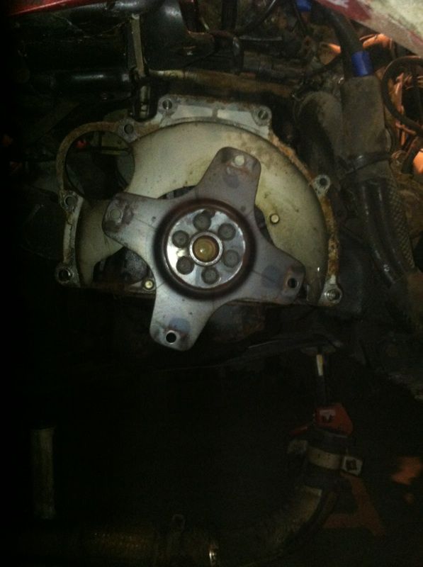

About 2 months ago I pulled the trans at a friends house to have it built and confirm that I have a 6 bolt (wasn't sure up until then) so that I could order all the right parts in the future.

6 bolt :thumb:

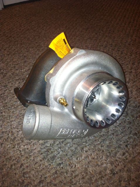

Precision 6262

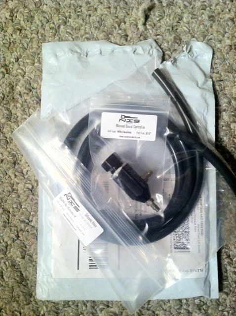

Manual Boost Controller

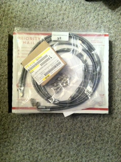

STM ABS Delete Kit

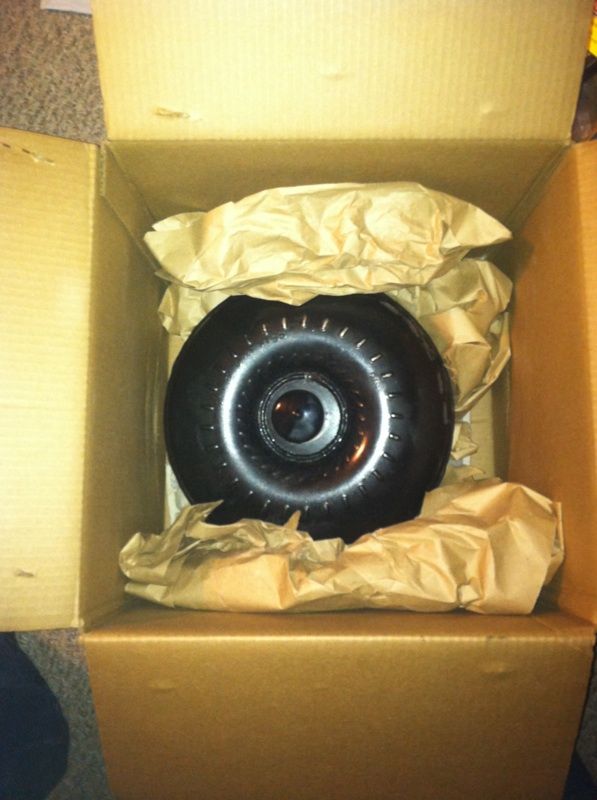

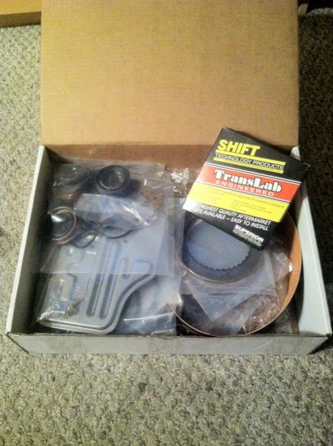

IPT Trans Rebilld Kit + IPT High Stall Converter

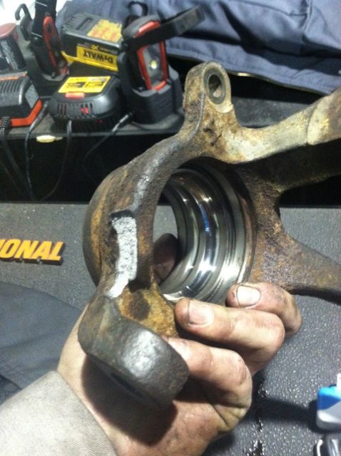

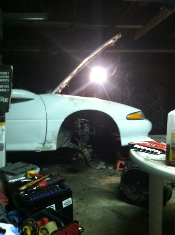

So this is why I will no longer let anyone I don't fully trust do anything to my car...
:banghead: If anyone has a spare drivers side spindle they'd like to sell me or some info on where I could fine one that would be awesome. I've checked most of the local junkyards and parts stores... no luck.

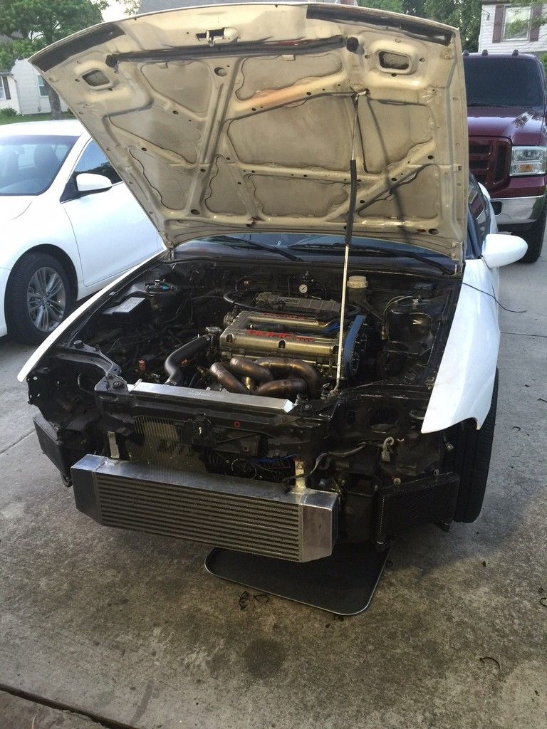

Currently tuned @ 20 PSI (gate pressure) on 93 pump gas using Ecmlink V3. The tune is pretty conservative, still working out a few bugs. I quickly learned after my first 2.9 60Ft that the stock 2.0 bottom end + big turbo + cams + not enough converter= no power untill 6k RPM. :notgood: So I think I'm gonna try a healthy shot of nitrous. :hellyeah: The car is currently apart while I address a few things that need to be done before worrying about going any faster. I.E. crankcase ventilation set-up, coolant overflow set-up, power steering delete, solid motor mounts and battery relocation. Going to try my best to update this thread from here on out. As always all comments are welcome! :thumb:

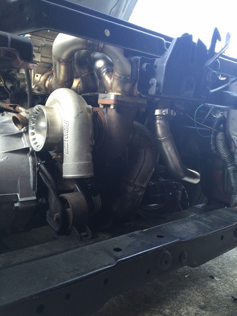

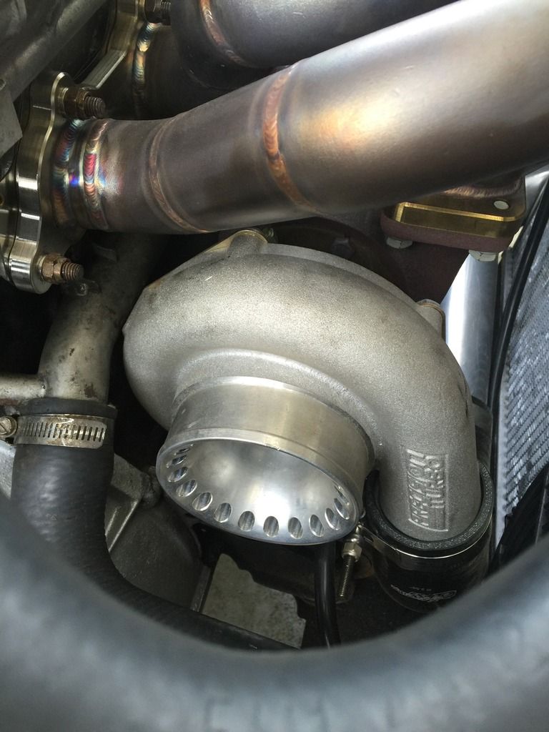

nice build so far man, could I ask for a pic of how close the turbo is to the water pipe? I am looking at running a similar turbo and want to see the fitment.
Thanks man it's come a long way but there's still so much more to do. As for the turbo fitment. It's very close mabey an 1/8" between the compressor housing and water pipe. I had to do a little bit of gentle persuasion with a pry bar to get clearance.
Awesome thanks for the picture man , it seems no matter how I go about it I will have to give that water pipe a little coaxing in order to fit the turbo I would like to run. Very nice set up so far man keep up the great work.

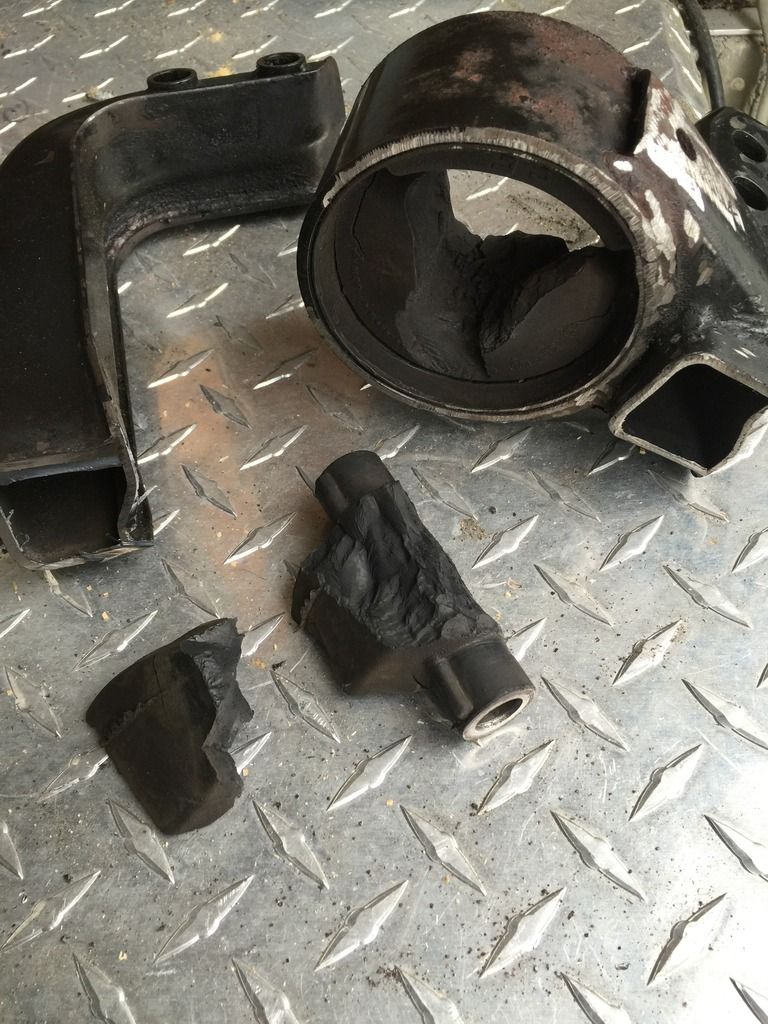

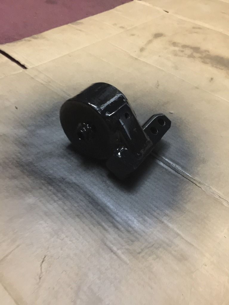

Started working on my driver's side motor mount tonight after work. It was SHOT. Got it all welded up and ground smooth. Getting painted and reinstalled tomorrow. :thumb:

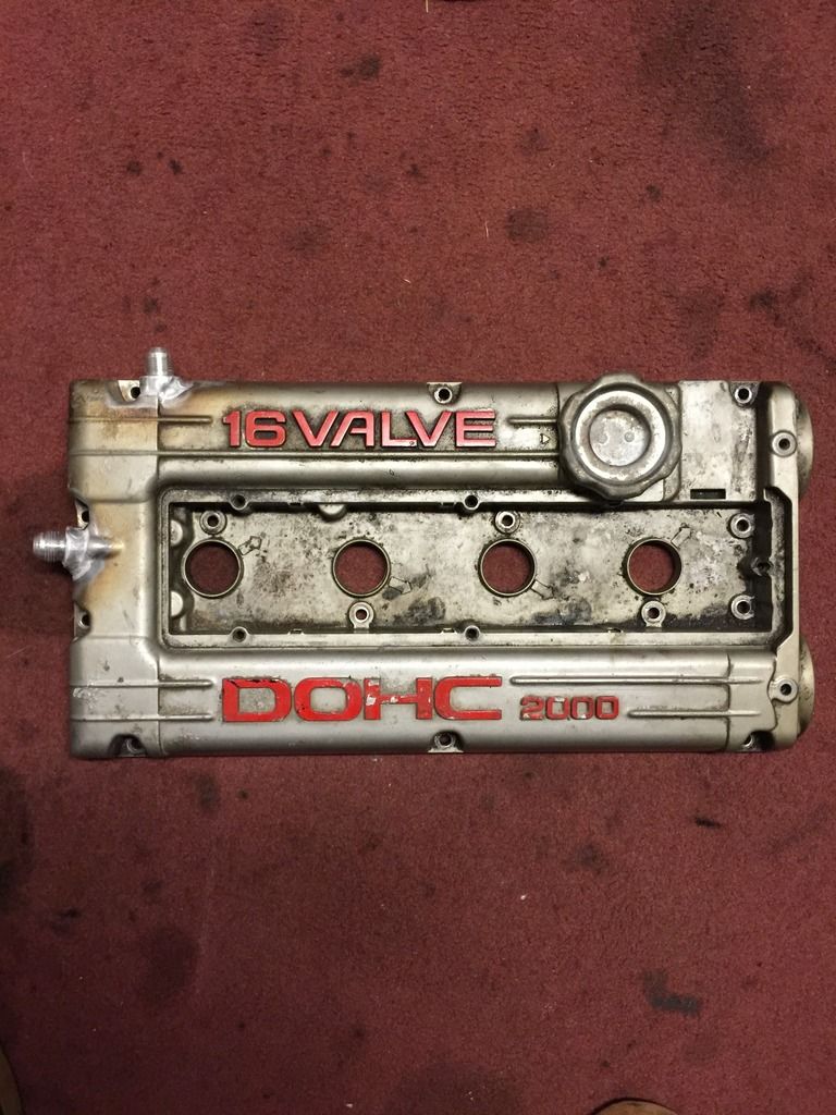

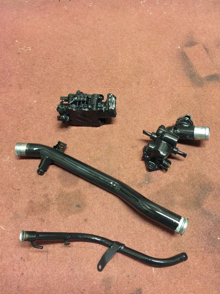

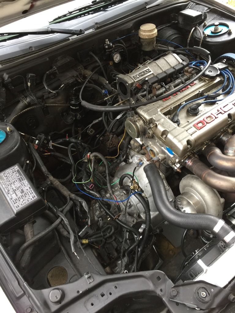

Small update... got the motor mount all finished up and had my valve cover welded. I removed a few other parts to be cleaned and painted while waiting for stuff to be delivered. I decided to relocate the battery to the back of the car. I'm currently addressing the birds nest of wiring that was hiding behind/under the battery tray. :banghead: I'm also making a new upper I/C pipe, modifying the trans mount, adding a catch can and coolant overflow resovoior.
