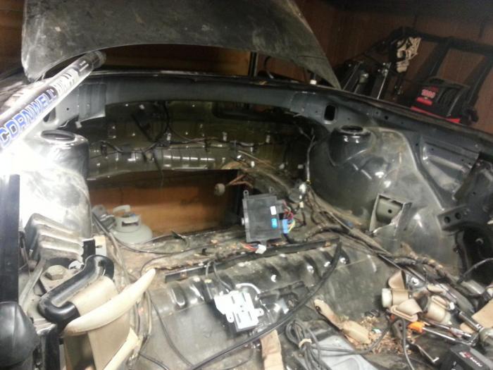

All the trim and seat removed and this is what is left.

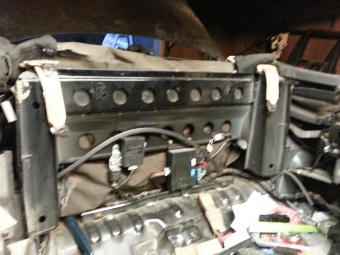

The interio plastics behind the front seats is a no.I to have read up on the handbook and see what I need for a rear firewall . As u can see in the last pic, I can close off the trunk area if need be.

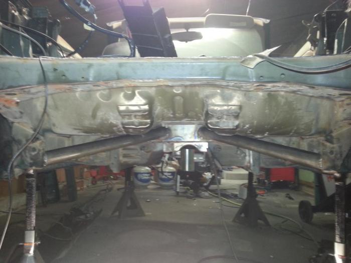

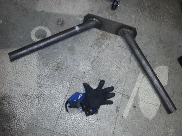

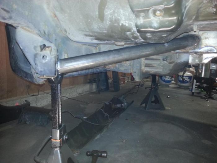

2 1/4 dom tubing and 3 1/16 plate steel. this brace ties into the rear lower front control arm mounts and ties it into the floor pan brace. this combined with a roll cage should stiffen up venom.

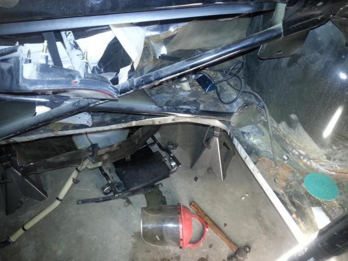

Np mat . I got the rear sub frame bolt mod done and started on the front ones. Well come to find out that big brace that I cut out goes all the way down to the base of the frame rail. Thier is a sheet metal cap inside that box, Punch that out and walaa . The floor hole is the same dimession as the brace.Will post pics later in the week.
