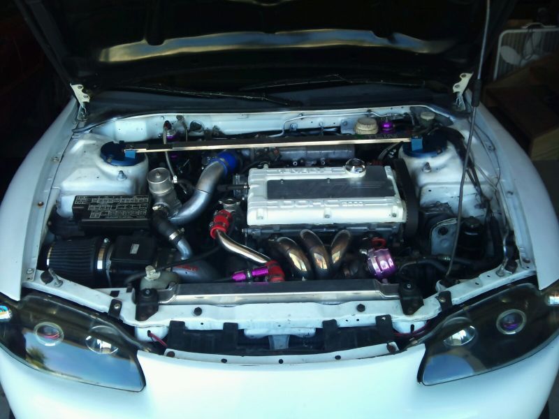

My Gosh.... Once again, you have the cleanest engine bay ever!
Thank you man, because I have seen some clean bays. Thank you for that.

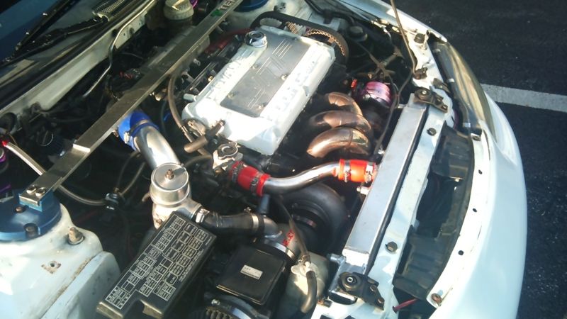

THE CAR IS ALIVE AND DRIVING!!!
My girl and I went and got the car yesterday. I drove it home about 140 miles. Everything went well, the car drove great. The new transmission is a bit to get used to, but not bad at all. The car is tuned on Speed Density to 26lbs at 8krpm making 400awhp! On the dyno it kept making power, with no knock, so they will retune the car at 9kprms in a few months. They think it will be around 420hp when said and done. Also, if I get rid of my HKS272 cams and get GSC S2's then I will pick up another 30hp or so. So basically if I put in the new cams and have it retuned for 9k RPM's then I should be around 450awhp on pump gas! We will see, I just want to enjoy the car as-is for a while.
97 GSX - 400awhp - 8k RPM redline - 26lbs - PUMP GAS with more in it!
I am super happy to be able to drive my car after 7 months of work.
Thanks to English Racing for helping me with the car. Really good people that fully stand behind all of their work! Thanks to my girl for not killing me at times LOL... Thanks to my friends that have helped me along the way.

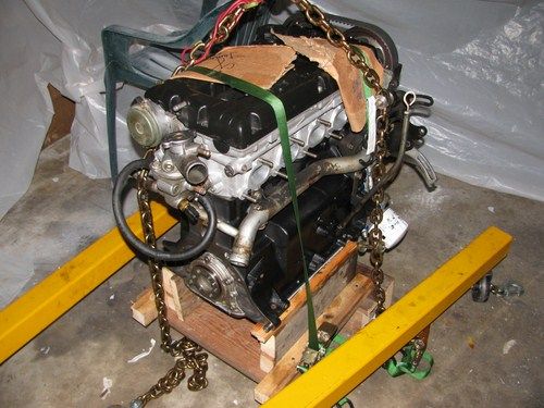

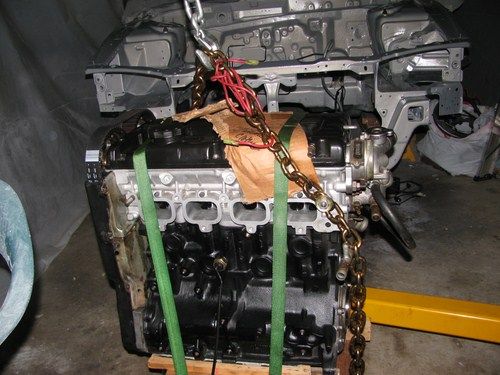

I took the small three hour drive and went and picked up the motor. Very happy so far.
What I had done to it, 6 bolt longblock, build by English Racing / Wiseco HD 1400 Forged Pistons 9:1 compression / Eagle H-Beam Rods / ARP Head Studs / OEM Crank / ACL Race Bearings / Head upgraded with GSC valve springs, TI retainers, Chromoly seats, Supertech valves with the 4-angle intake valve grind and the 4-angle radius exhaust valve grind / HKS 272 intake and exhaust cams / HKS adjustable cam gears / Cosmetic hg /
It's coming along, pics below. Oh and the crate it is sitting on, I custom made for this engine to fit into perfectly. I needed a way to strap it into my truck. I doesn't look like much but it is very functional and strong.
