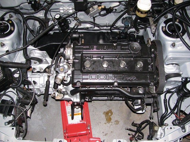

My vote is on flat black with polished letters.
I did mine with a steel brush on a dremel, so it's not a high polish but a good luster, then paint the entire thing flat black, and use acetone on top of the letters.
It looks great that way.

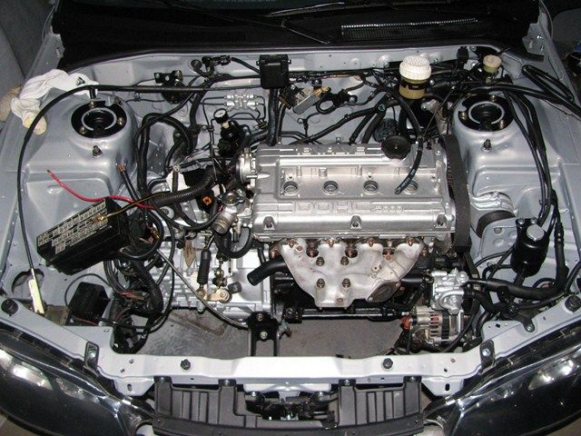

DUDE your engine bay looks so clean, all your wires look so black and fresh! haha love it man!
Thanks man lots of rags and simple green to clean up the wires, two cans of electric cleaner, and then new loom on most of the wires.

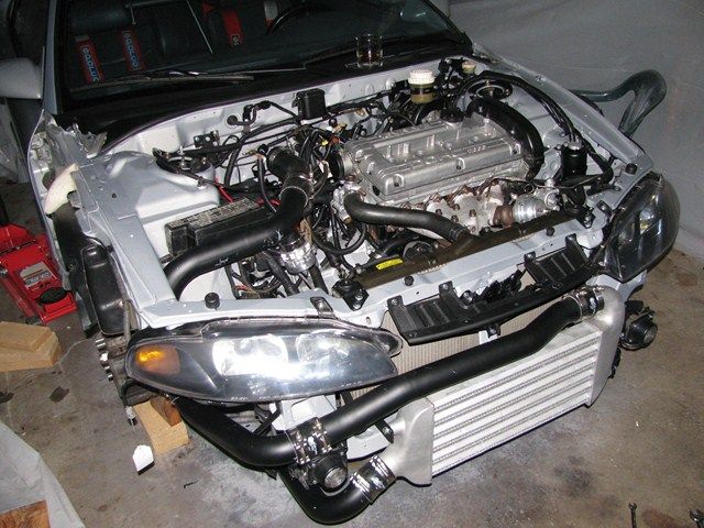

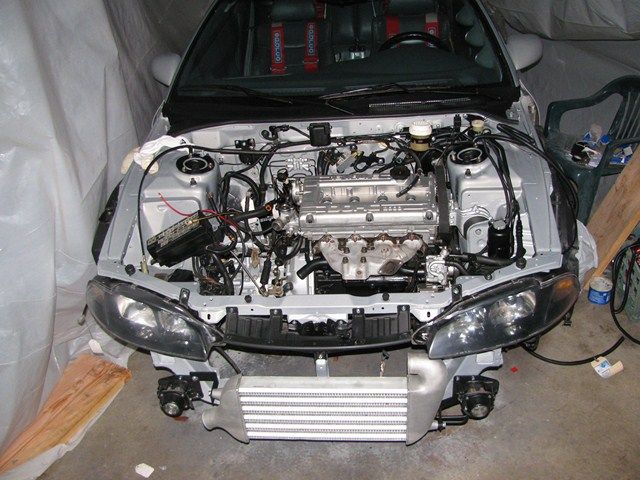

Ok so last night I installed the radiator, intercooler pipes, routed some wires, torqued a bunch of the suspension bolts, reclocked the turbo to better fit the intercooler pipes, tightened down the new turbo oil supply line. A few other things... Here is the most updated picture as of last night. It is possible that I can start this thing up this weekend, but I need my intake manifold brace from the machine shop to finish. If I don't get the brace before the weekend then I will be starting up the motor next week!!! (The reason that I can't just add the brace on later is that the intake manifold will need to come off to install the brace onto the manifold because one bolt will go threw the manifold flange into the brace.)

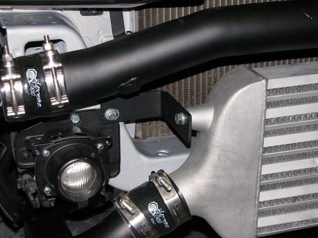

Intercooler bracket that the machine shop made for me. Believe it or not when I bought the car years ago the intercooler was just "hanging" by the pipes that connected to it LOL... (intercooler was soda blasted)
