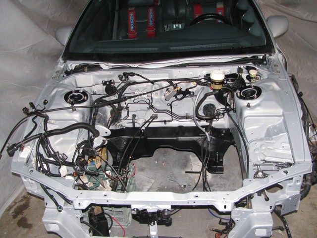

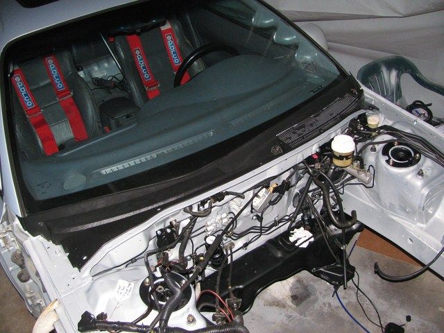

So I have been working on the car every chance I get. For the first time yesterday I felt like I could see the light at the end of the tunnel, so da speak. I am happy with were I am in the project, and can't wait to finish up the motor install. Here is an updated picture of the engine bay. I am now woking on cleaning/sanding/painting the P/S lines, P/S pump, ect...

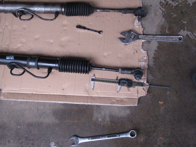

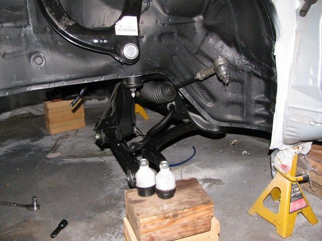

I have got lots of work done over the holidays. I installed the PS lines and am ready to install the rebuilt steering rack with new moog tie rod ends.

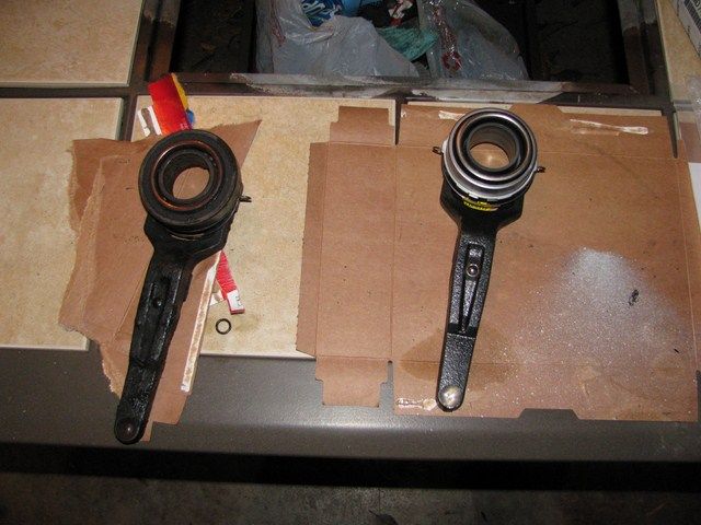

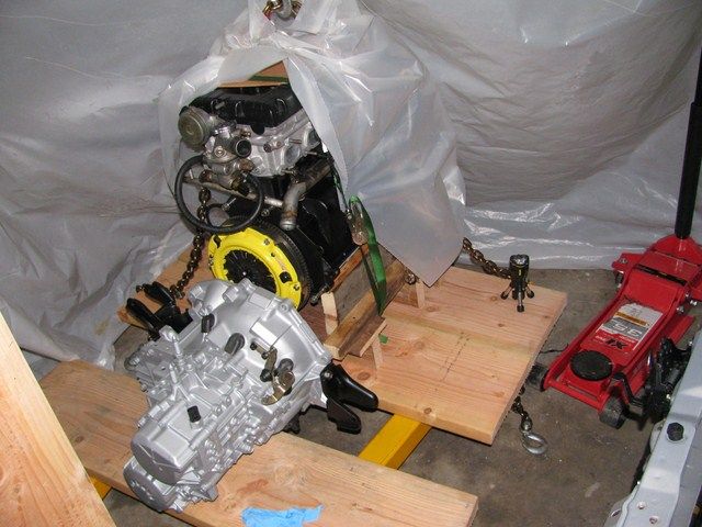

I installed the resurfaced stock flywheel with ARP bolts, red loctite and lube under the head of the bolts, 100ft lbs. A New ACT 2600 6-puck clutch kit. I used a new stock TOB instead of the one ACT supplies in the kits. I have heard bad things about the ACT TOB, plus the stock one is one like $32. I also put in a new OEM clutch fork.
Last night I lifted the transmission onto the block. Thank god a couple friends stopped by the house last night, so they helped me lift the transmission while I lined it up properly. There's nothing better than friends that can help out with the car stuff. :thumb:

On the left = ACT TOB and old clutch fork.
On the Right. OEM TOB and new clutch fork.
Below is an Example of what I am doing to every part in the engine bay. (The before and after), to give you guys an idea of how much degressing/sanding/cleaning/wax remover/painting that I am doing. I am so sick of sanding haha...
Measuring things on the new steering rack vs the old steering rack.
Windshield Cowl cleaned/installed. P/S lines and pump installed, ready to connect the lines to the steering rack after I bleed air out of the lines a little bit.

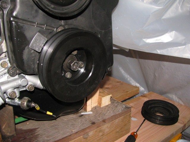

Fluidamper pulley installed.
Upper arms in place, lower compression arms in place, steering rack installed, and the sabilizer bar with new mounting rubber installed.

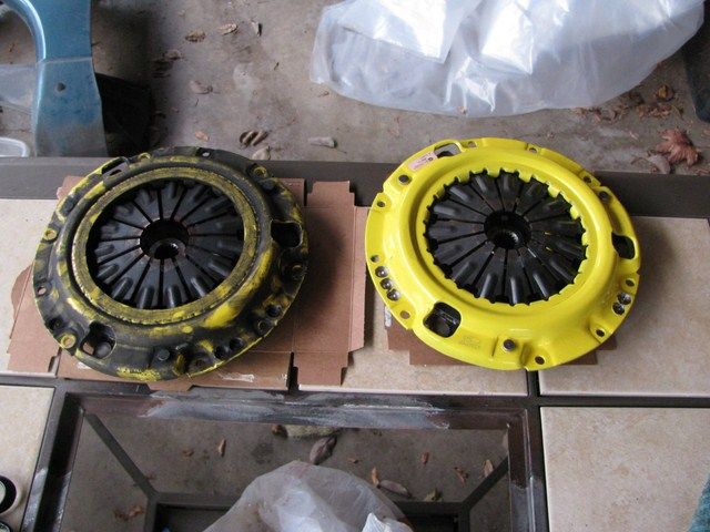

Update: So here is a video of things before I installed the motor. I installed the motor, and then the next day when I was putting the boxes away for the clutch pressure plate ( I keep all my boxes), I saw that I was sent the wrong ACT pressure plate I got the ACT heavy duty pressure plate and not the extreme pressure plate I ordered. So guess what, last night I uninstalled the motor AGAIN to take out the pressure plate to send back to Extreme PSI to get the proper one that I ordered. (basically I ordered the ACT2600 6 puck sprung disk kit, but received the ACT2100 6 puck sprung disk kit.) It was way past 30 days for the return but after telling them my situation they made an exception.
So the motor is back out waiting for the new pressure plate. On the bright side I was able to remove the whole motor/trans from the car in under an hour LOL…I am getting fast with this car..
