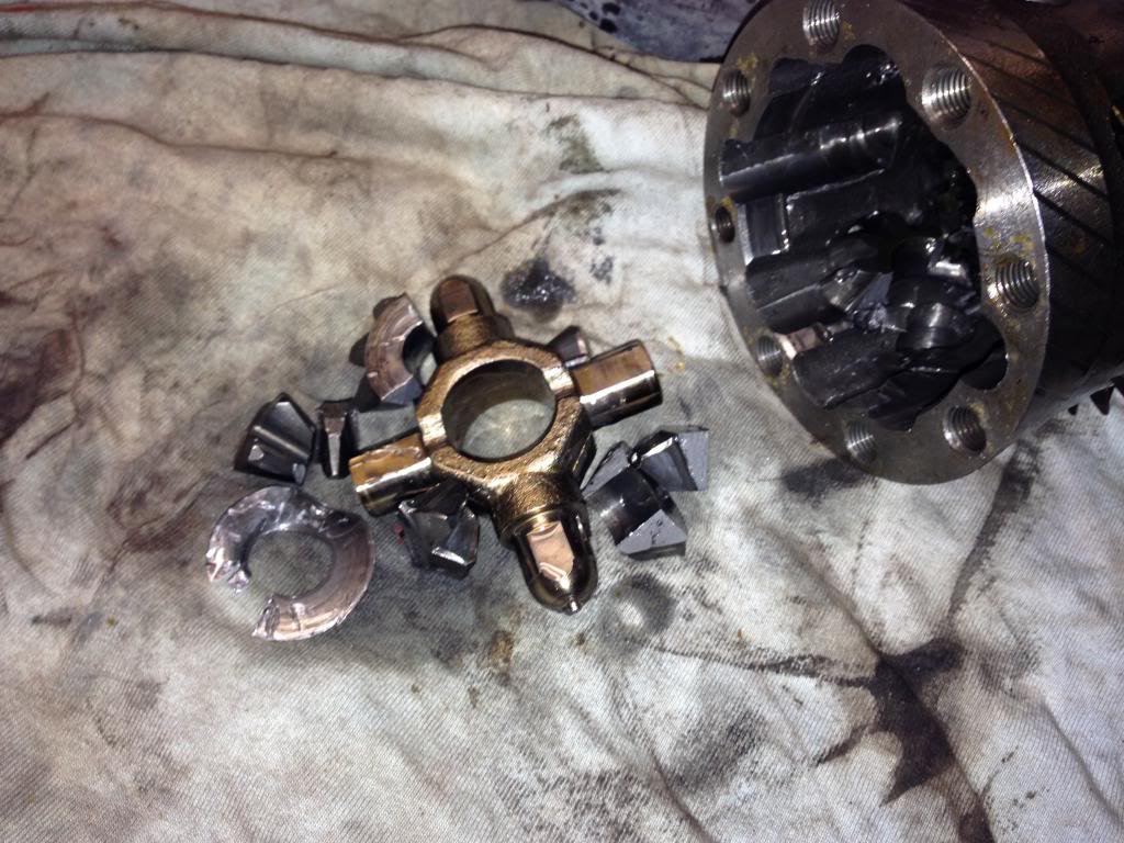

The parts i broke from the 1/8th mile include the stock 2 spider center diff and a driver side rear axle.
Luckily enough of the center diff survived that i could weld it up.

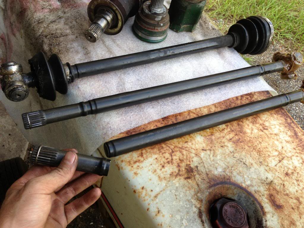

I then decided to drop the boost way down for eliminations, i dont know what boost it was because i broke the front passenger side axle.
So maybe next time after i fix whats broke AGAIN i will get some passes in where im not limited by a index. :thumb:
