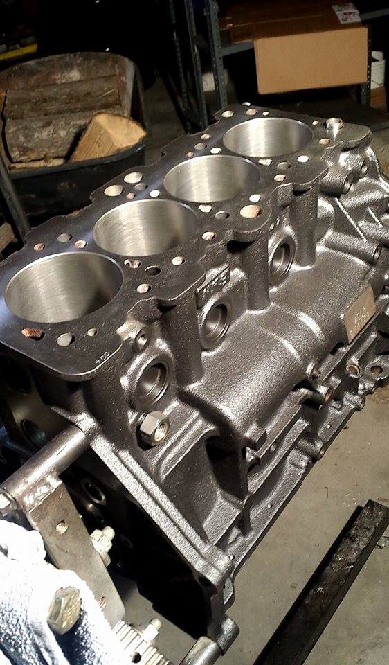

Sooooo, it's been a bit for an update. Got my head back awhile ago and it's pretty gorgeous how shiny it is. The block is in being decked and hot tanked now for the cometic mls head gasket. Just bought plenty of parts, but sort of had to go budget as I have been helping my parents out with a lot of money and school is draining. I have a complete gasket overhaul kit for the engine, along with a gates timing belt kit (did research on them and it seemed quality from reviews on forums) OEM timing belt, and OEM tensioner. Oh and a gates water pump.

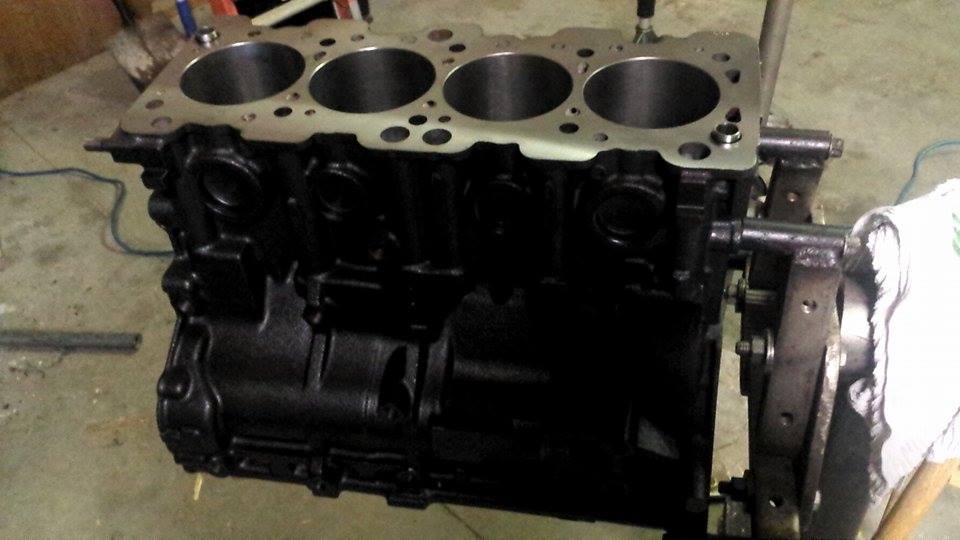

So I've actually got the car all back together, and have been working on it quite a bit, but with school and work and everything, I havent had time to upgrade my journal here.

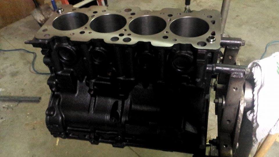

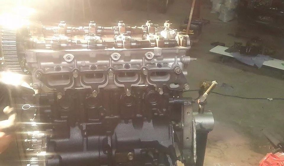

Basically, when reassembling my block, I didn't run into any problems, everything micd out how it should have, and went pretty smoothly. I cleaned and painted the block a darker metallic color, along with the valve cover. Cleaned miscellaneous parts that I was reusing. Mostly covers. And the t-case took awhile from all the previous owners oil leaks.
Ive got a rebuilt s16g arriving tomorrow that jusmx actually rebuilt for me. (Awesome guy to deal with BTW). Along with the oil line he recommend with the restrictor. extreme psis intake kit with a k&n filter coming in. Manual boost controller and ngr bov will be in soon as well. As soon as those are all here, if all goes well, should fired up. But we all know that hardly ever works that way. Essentially its all done, I'm just waiting to boLt on a couple parts, trouble shoot what I did wrong with wiring most likely. And then be on my way.
Unfortunately I didn't get to clean up all of my parts as well as I wanted to, as I've been in a little more of a hurry to get this car on the road. Using a loaner car at the moment. probably around spring break I'll hopefully get a sand blaster and just take some primer and paint to a few parts and rust areas.

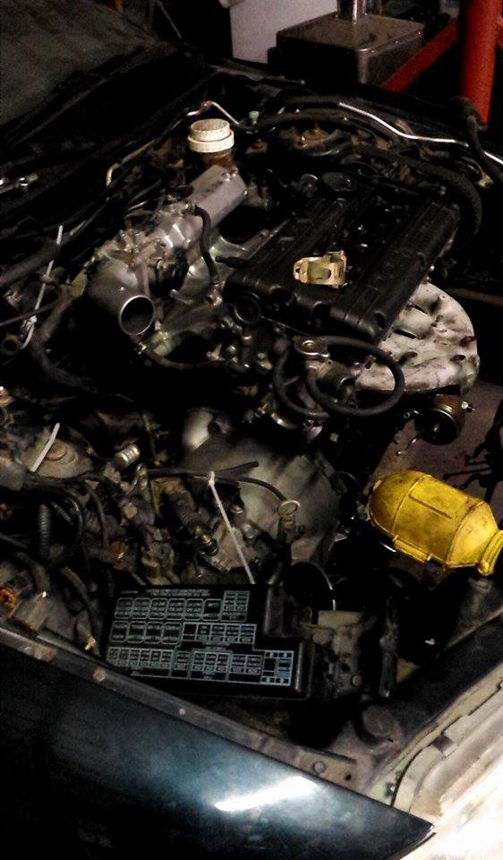

After first start, which just a quick start up to see if it would start, I found that I need to fix a couple leaks. One of them coming from a transmission oil coiling line, and one coolant line. Then I will break her in, not sure on the method yet. And perform a leak down test.
