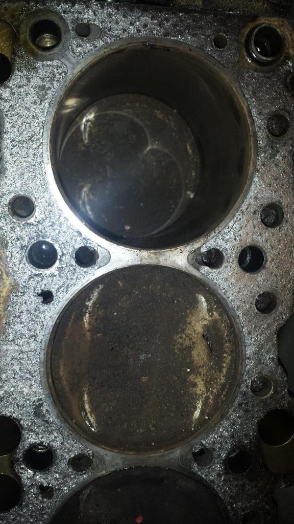

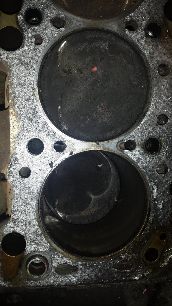

So tonight I tested my CAS, it was fine. Tested timing using http://www.dsmtuners.com/threads/1g-2g-quick-timing-belt-alignment-check.306607/ and found my crank super hard to turn when it was around tdc, Near impossible. Suspecting some things are hitting each other in the head. Compression test still isn't reading anything, making me think there just any compression haha. Anyways, I've started pulling out the motor tonight. About halfway there, should be out the next couple of days depending on school and gf.

I had the plugs pulled, was following quite a few different threads for advice. I never actually found out if the timing was okay, as the crank would come to a point where it wouldn't turn, felt like parts were conflicting. I could just do the head pull, but I figured I might as well pull it all out, clean it up, new seals and gaskets for everything. Makes me feel better. Will have pics up as soon as I have the engine pulled. Been taking pictures to keep track off all the wires, tubes.

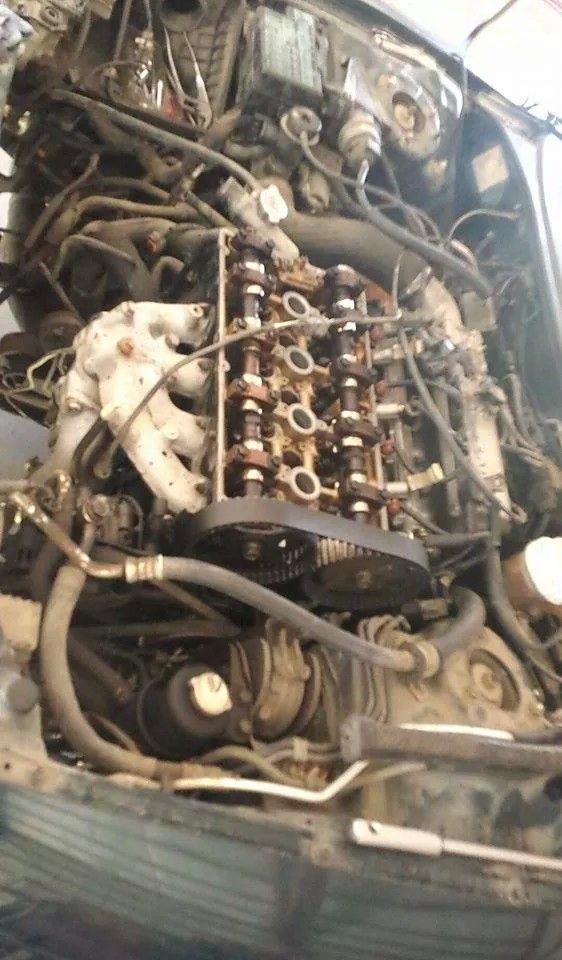

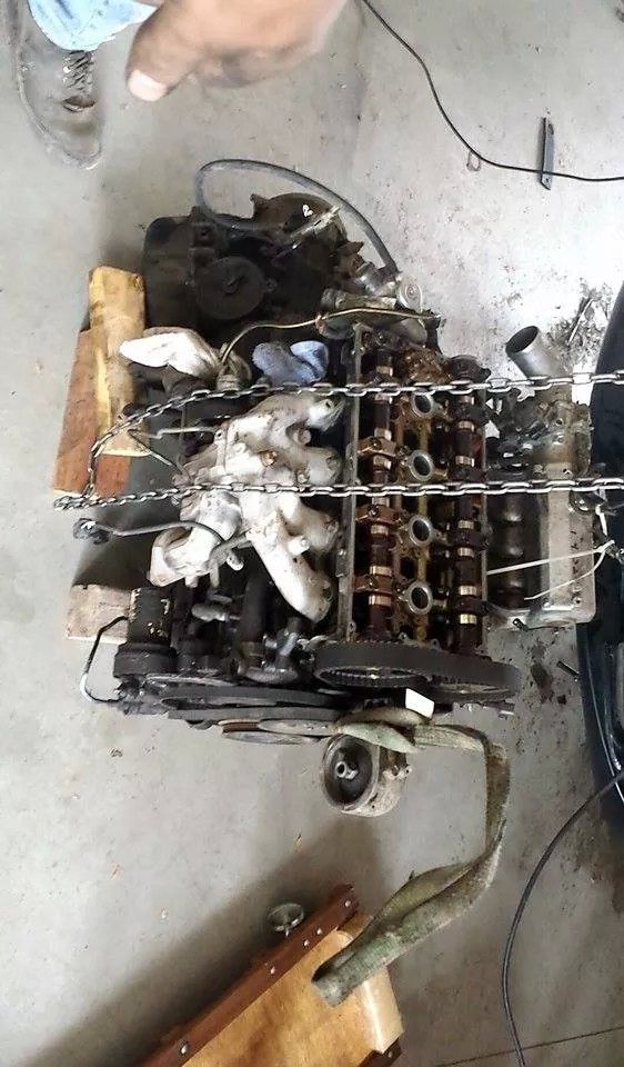

Update, these last couples of days I've gotten both axles pulled (intermediate shaft bracket bolts on the drivers side sucked, took me forever.) Drive line disconnected and transfer case dropped down. Just about all hoses and wires disconnected from the engine, I'm sure I missed something. Was getting ready to pull it today before time ran out again (school and gf ha). Was going to pull it using a 12mm bolt on the top left of the engine, right below the valve cover. And the top right of the engine, using a power steering bolt hole. But 12mm bolt on the top left broke as it was being tightened in so I bailed on the twelve mm. Made me a little wary of them. I've now hooked up my hooks to the left back intake Mani stud, and am going to try and use the right side engine mount (one in front of the cams) to pull the engine, Should be out tomorrow.

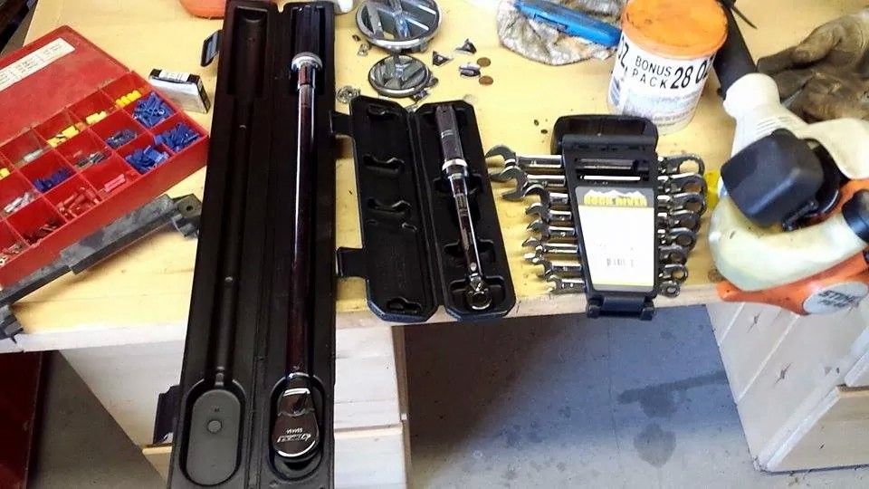

I got my t.wrench at Lowe's it's a kobalt. It's a awesome torque wrench for the price. It comes with its own certification for accuracy hand signed with matching serial numbers, certified accurate within .5% !

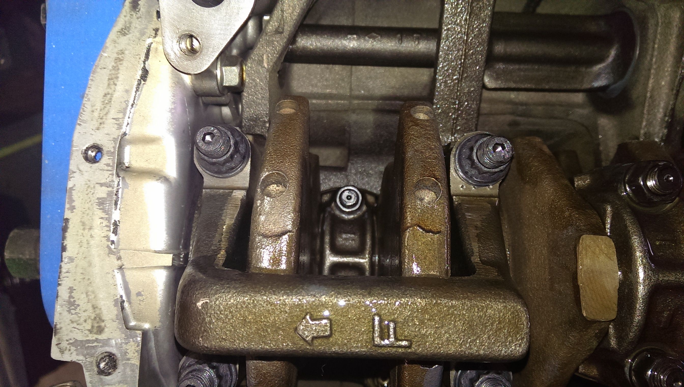

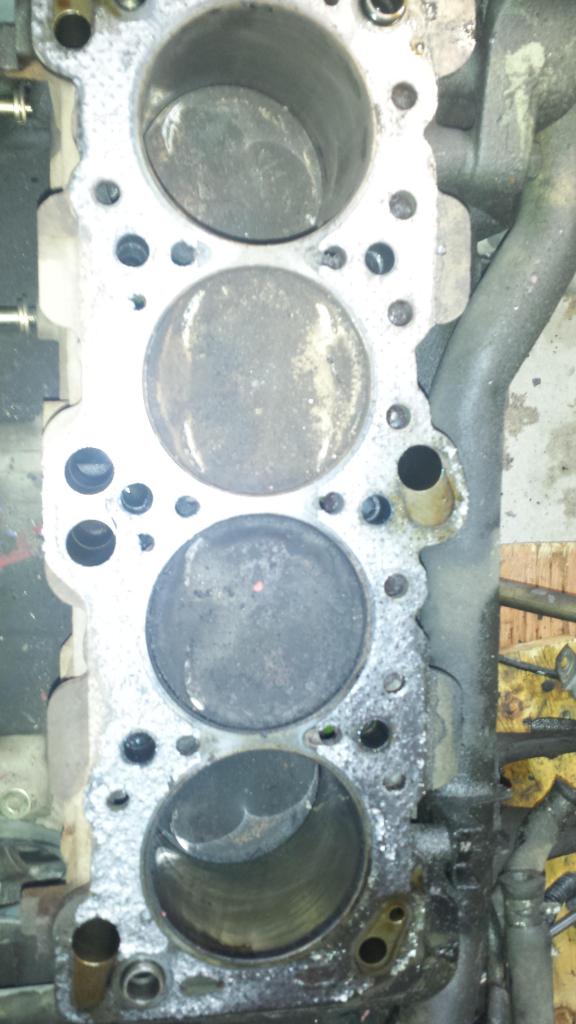

So update for today, I got the engine out. Have started dissassembly. Oh ya, and I got a couple torque wrenches (ft lbs, and In Lbs.) and some rachet wrenches woo
Few Pictures

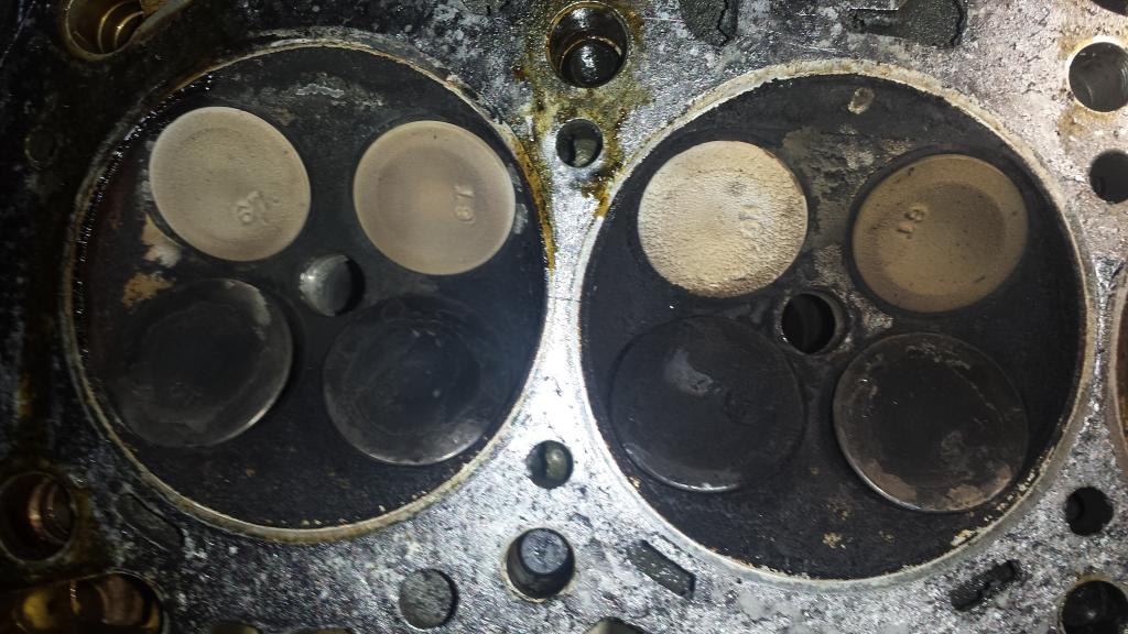

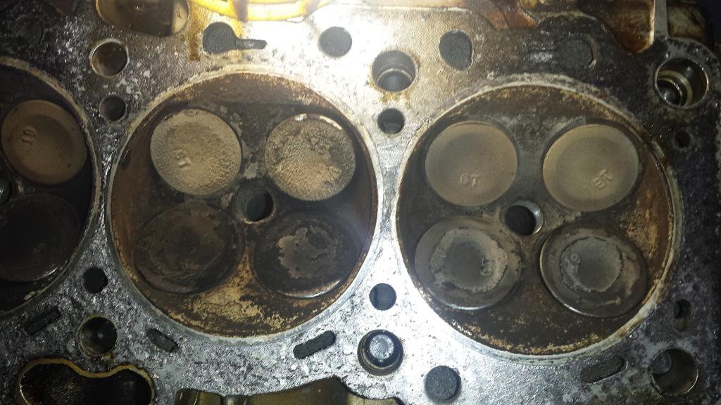

Took my head into the machine shop this morning. Really confident in the machinist, he seemed to know a lot about our engines, and works on them all the time. I am going to have the deck milled, a valve job done, replacement of bent valves and cracked guides, and cleaned. While the head is in the shop, I will be working on disassembling the rest of the block, and taking off the transmission. After the Block is fully taken apart I will be bringing it into the shop as well to see what he recommends.

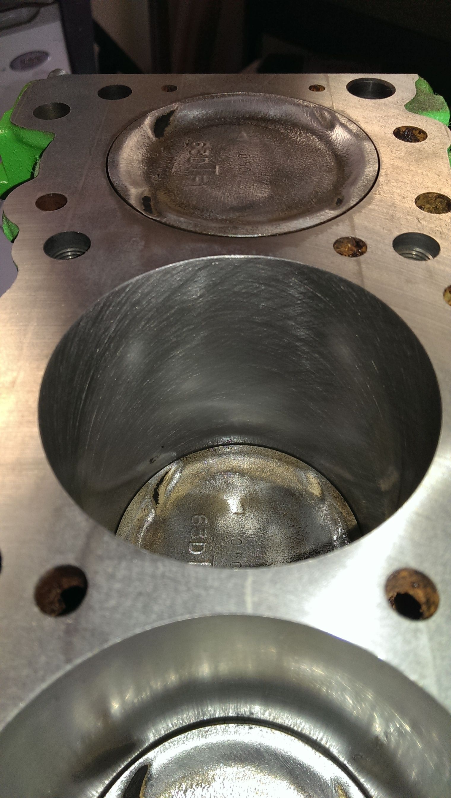

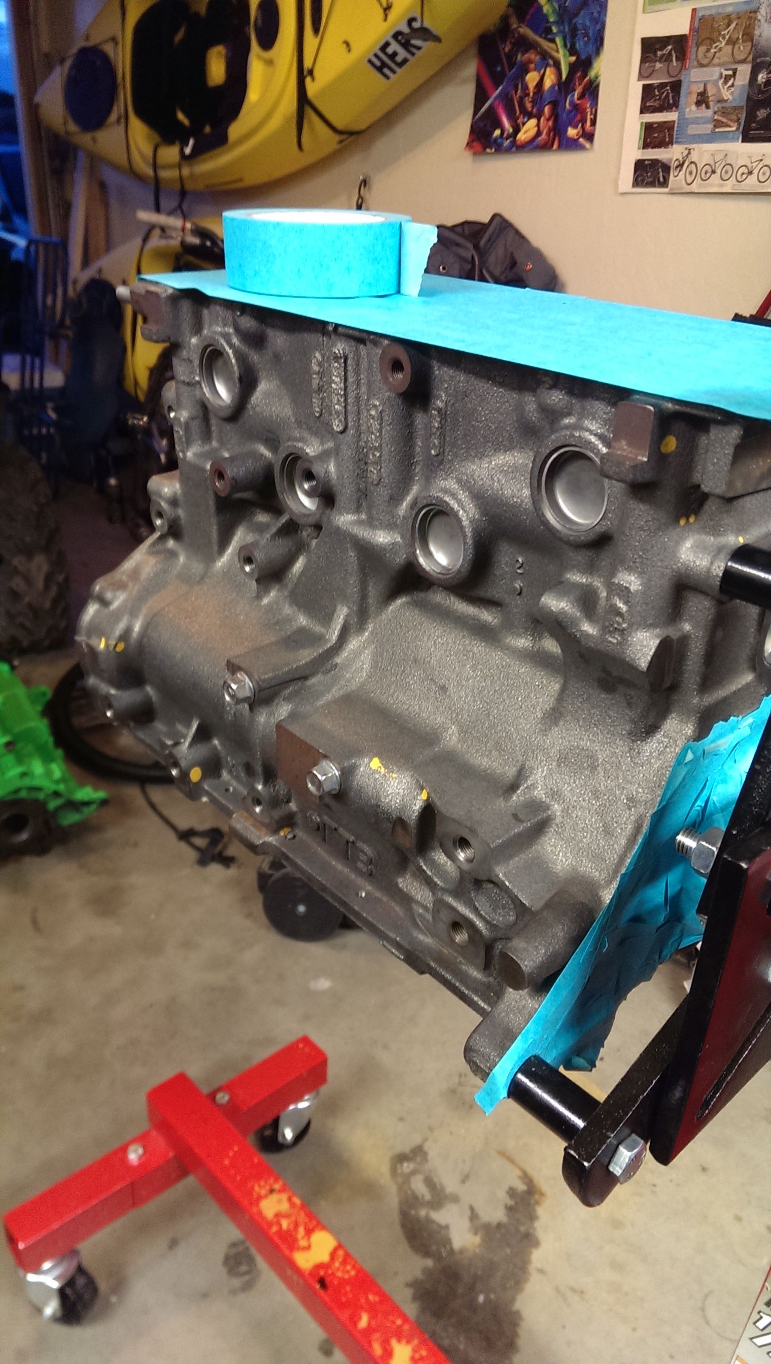

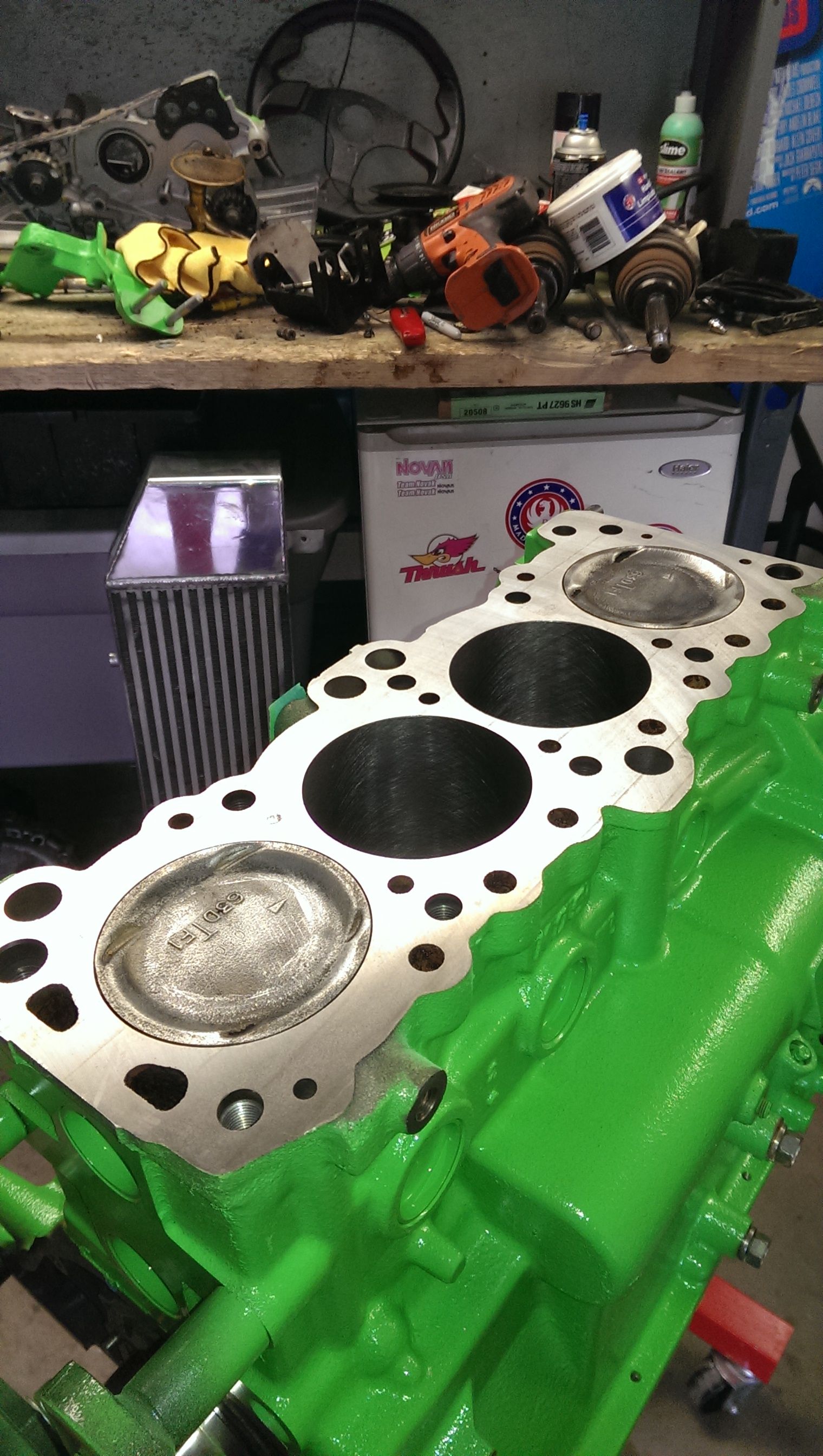

I took my block to my local to a local shop, had the deck milled , bored .020 over, honed and hot tanked two times. I had the tech at the shop assemble the bottom end for me, since I don't have any of the gauges required. He did a great Job I'll post up some pics.
From my build, I wish I had gone forged on the pistons. I'm sure my 2g piston, 1g rod combo will hold up fine, but now that I have gotten use to the power and I want more. The shop owner at my machine shop is a old school guy, and set up my block with a 45 degree hone on the cylinder walls. I was a little doubtful at first, but man I gotta say those rings sealed up fantastic! Great compression.
I went with OEM Mitsubishi rings for the 2g pistons, .020 oversized of course. They were pricey, 160.00 for the set but I figure what could be more important than the rings.
