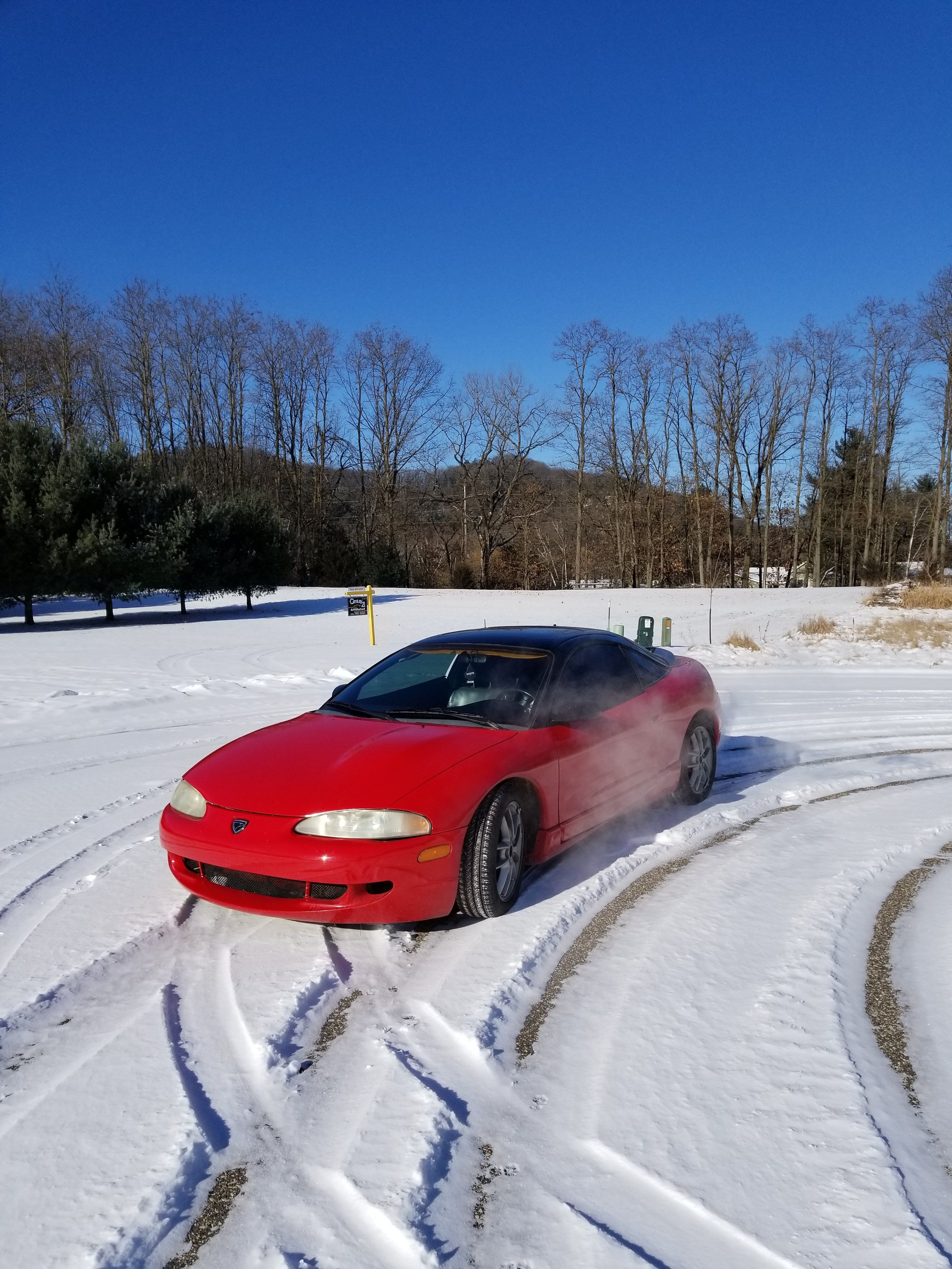

'95 TSi AWD
Red Talon. Puts up a fight sometimes but gets me there and back
