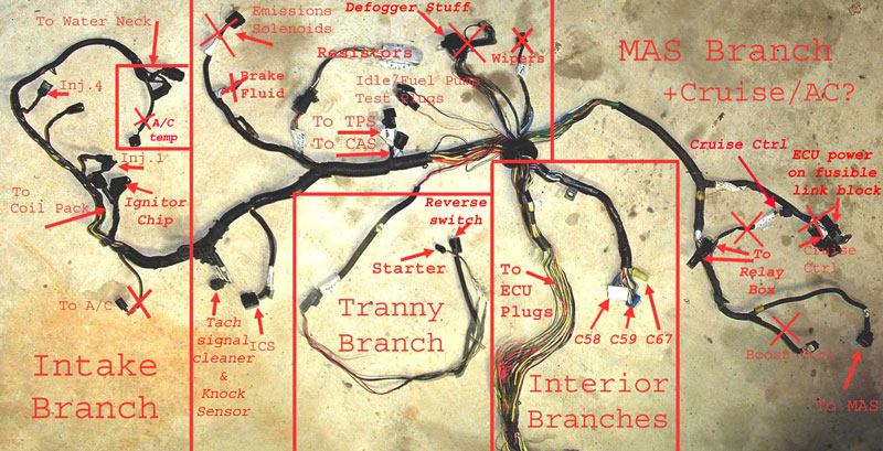

whatever is not needed in the wiring harness, please tell me. whatever can be eliminated please tell me through out this build. i have spent the last two hours researching and studying and cant get solid information on what can be eliminated.

Hope this helps
USATUFF- thank you so much for that picture and link you have no idea how much it helps. thanks for all the support and help guess. if you have any ideas or any opinions let me know
