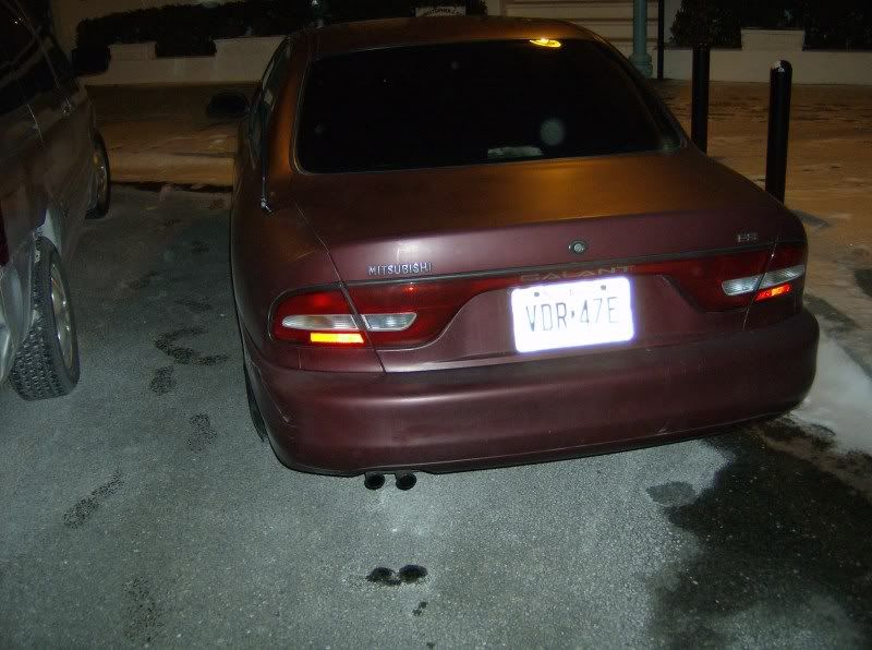

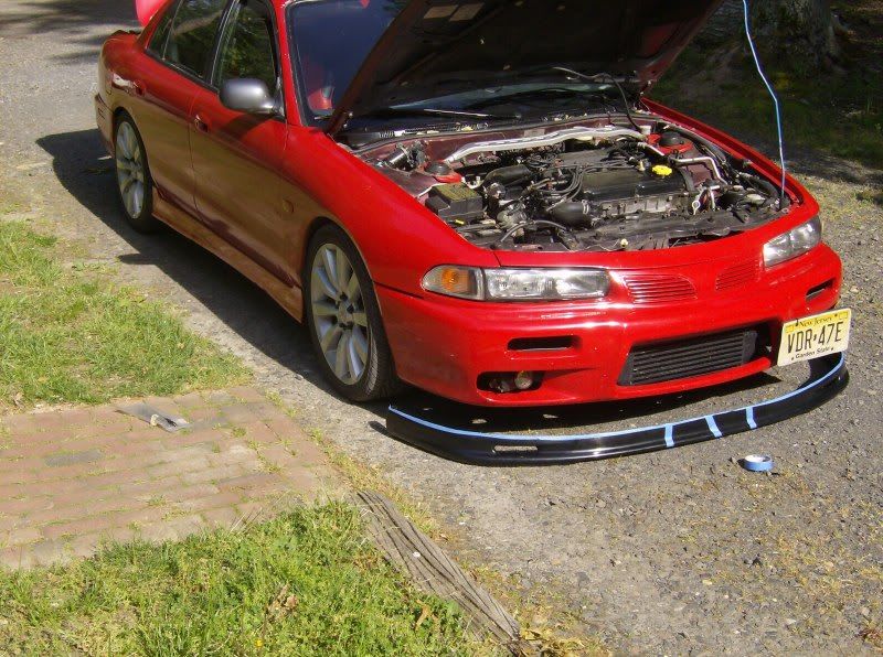

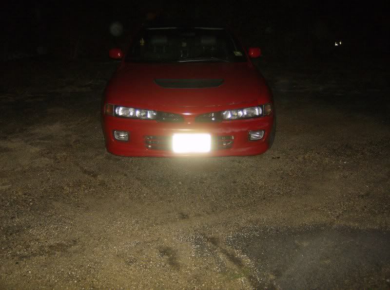

This is how my car looked when I first took it home back in 2006/winter/ - just another galant on the street. That didn't work out for me very well; having experience in painting and detailing cars, some basic knowledge of mechanics I can proudly say that my car hasn't been in shop for any repairs. So here we go:

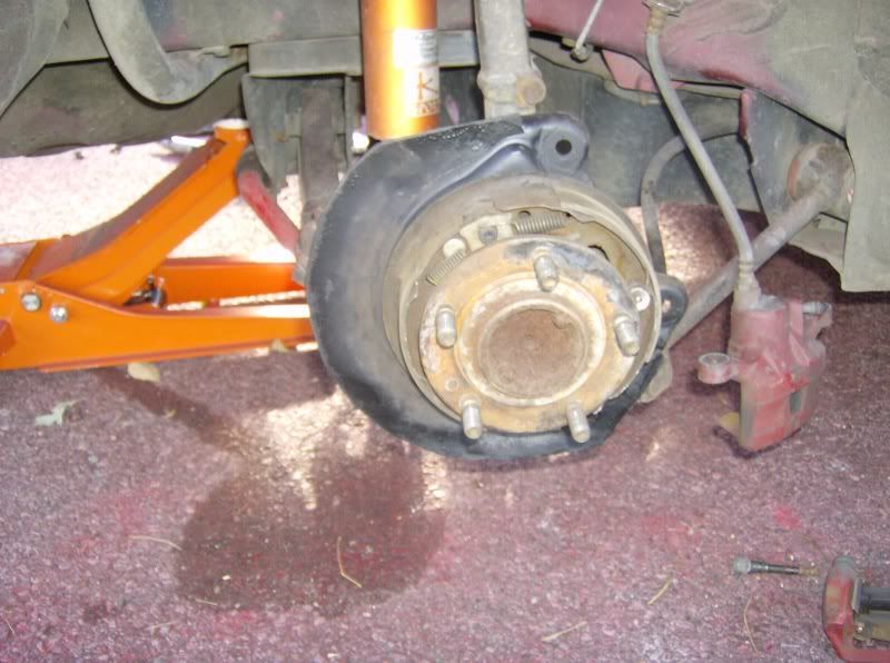

Second mod - rear disc swap, dual piston front calipers off 2G GSX, and 5 lug conversion to all four corners

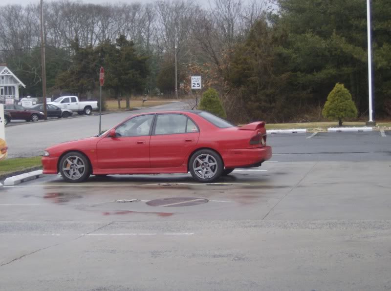

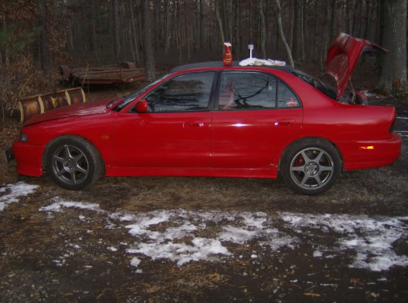

After some painting she looked like this

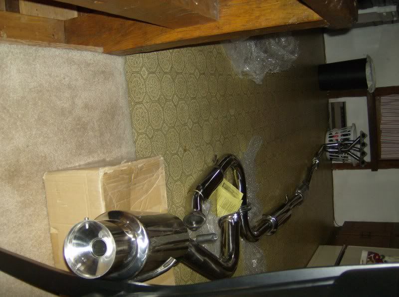

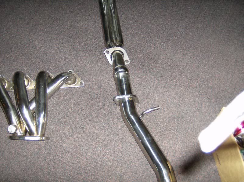

New exhaust: 1g Eclipse Tsudo SS header, 3'' Magnaflow cat and 3'' Ebay GST catback.

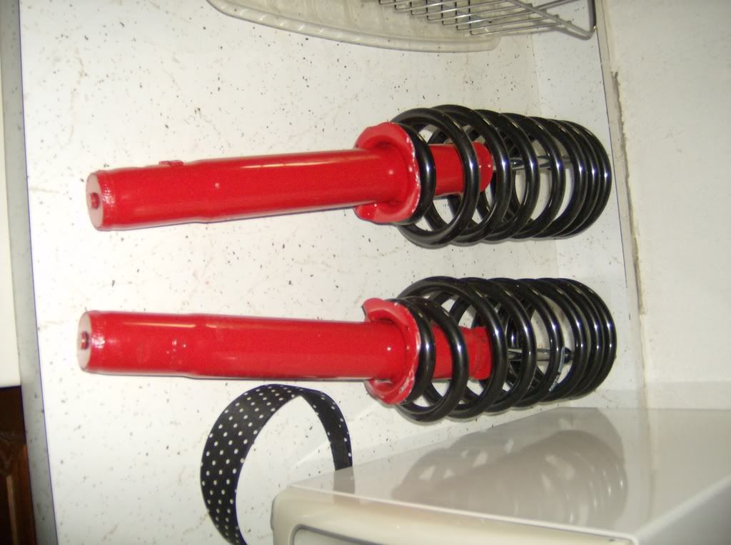

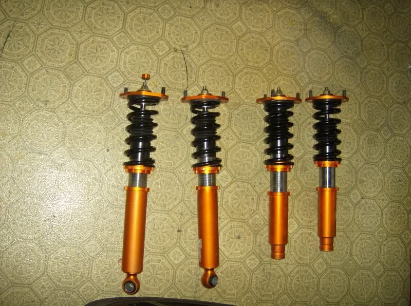

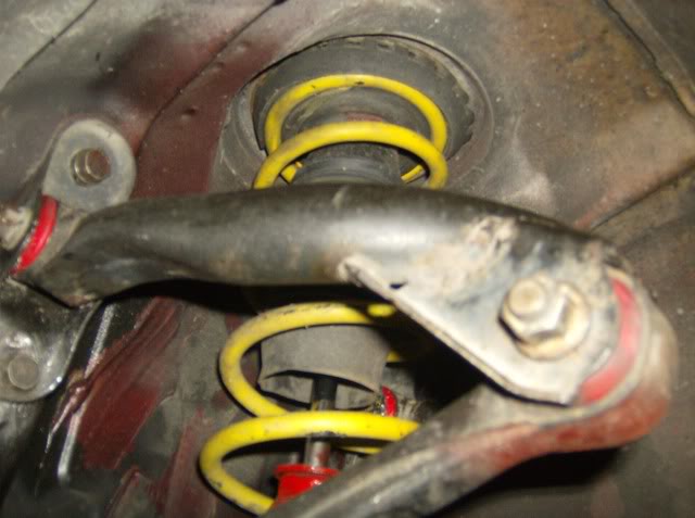

Went and bought 2g KYB AGX and Eibach Pro kit

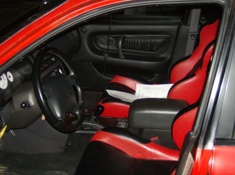

On December 7th, 2008, I finished the 5spd swap and installed 2g leather steering wheel which was a bolt on BTW. All parts besides the trans came out of 2g GST

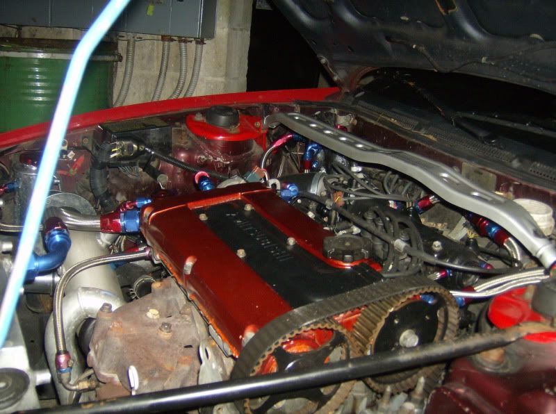

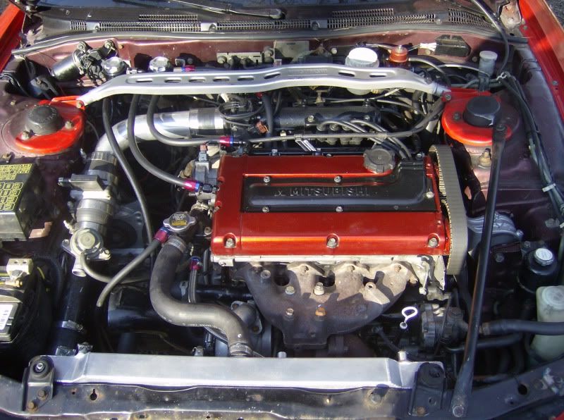

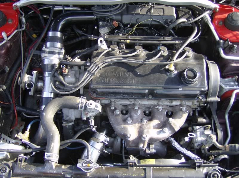

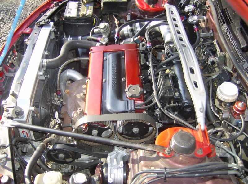

My engine bay in late 08

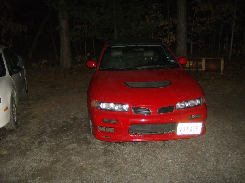

cleaned up - went with the back theme

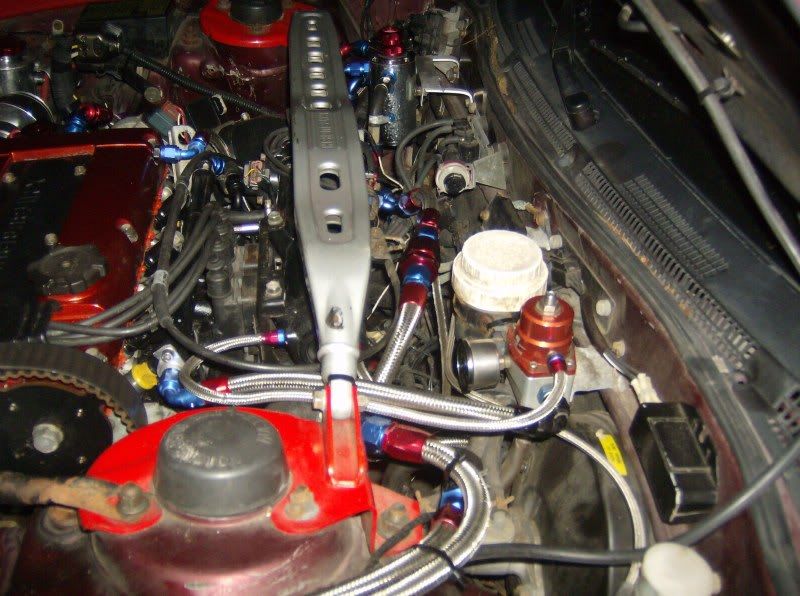

More goodies
4 - point Ralliart under brace

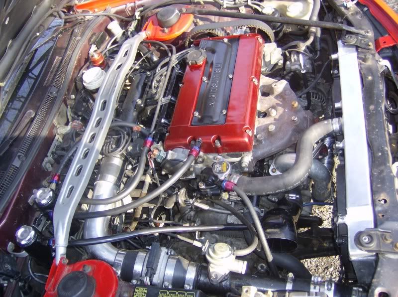

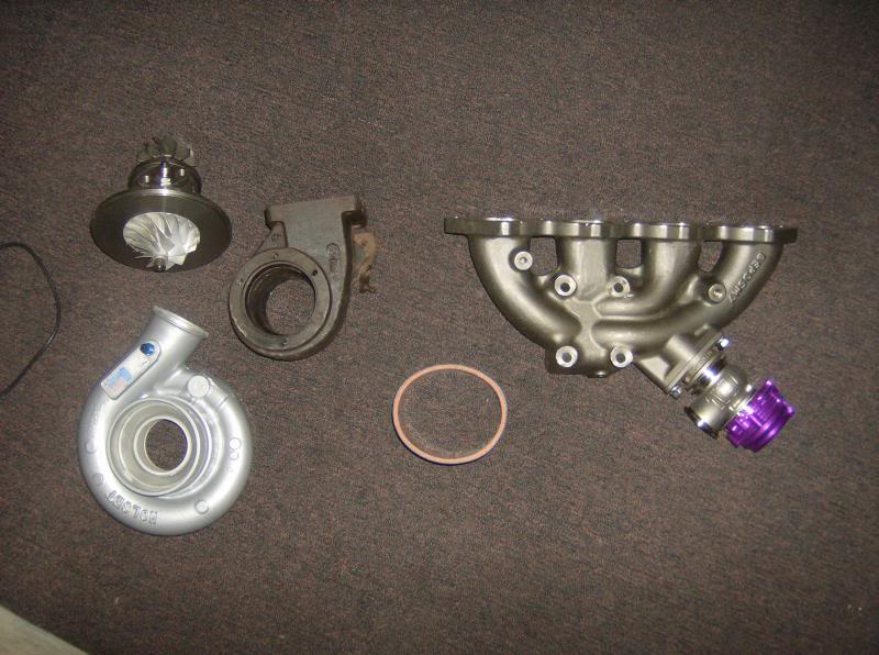

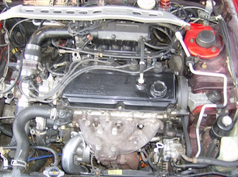

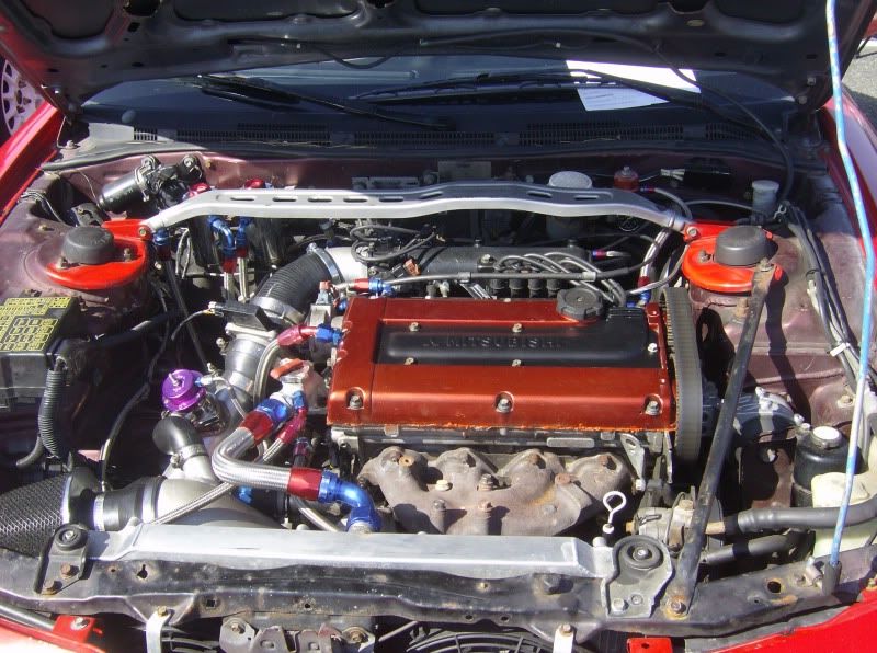

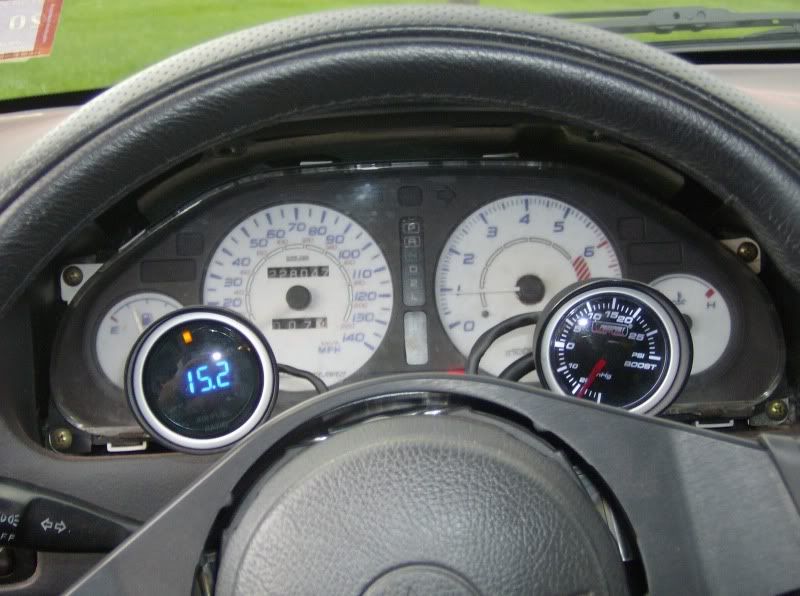

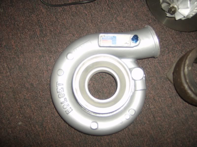

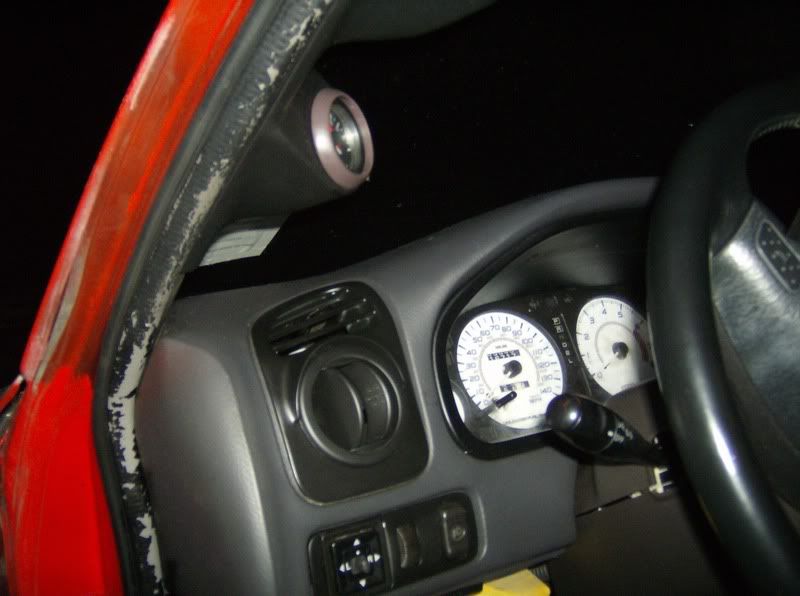

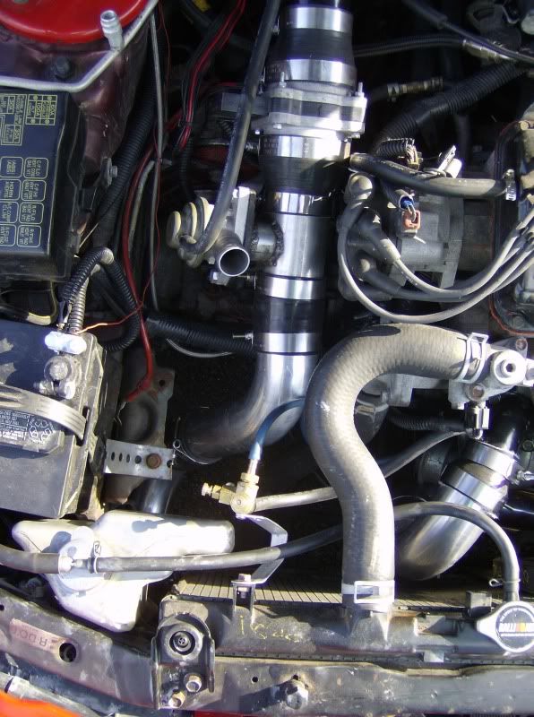

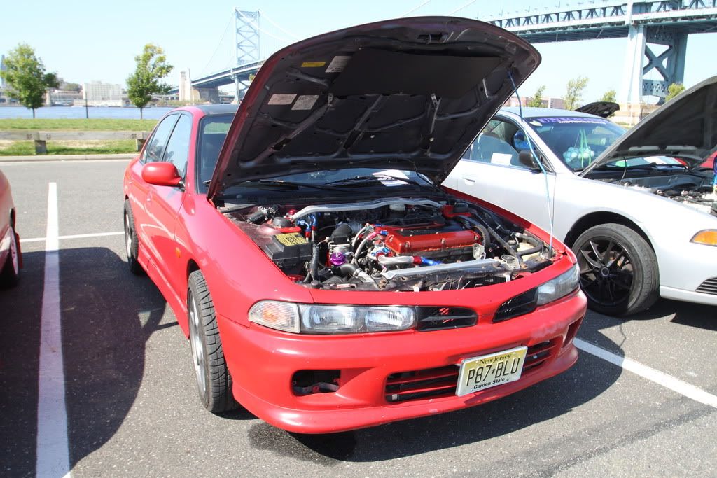

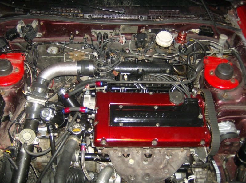

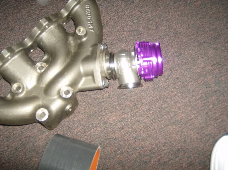

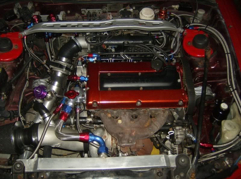

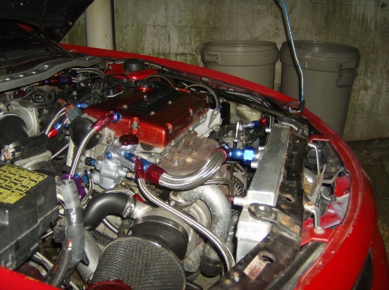

Sometime in the spring of 09, I went turbo. Tuned with MAFT and SAFC on 510cc Evo3 injectors. The setup was s16g, Bullseye hotside, Evo3 manifold and o2 housing, 3'' Ebay DP, Adjustable FPR.
updated

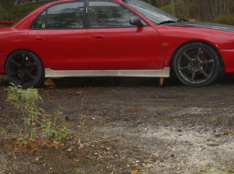

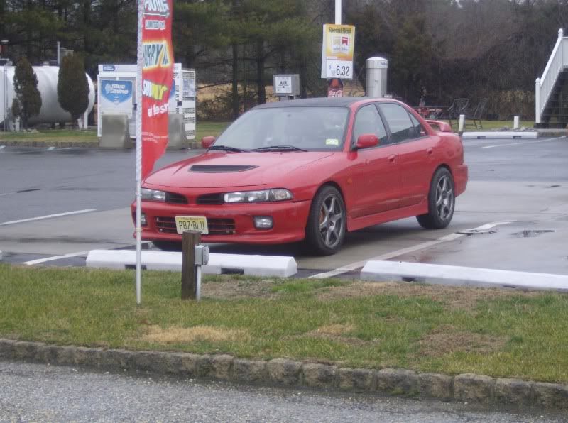

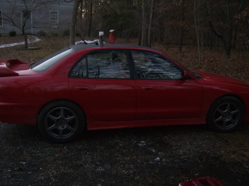

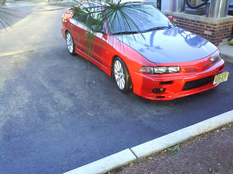

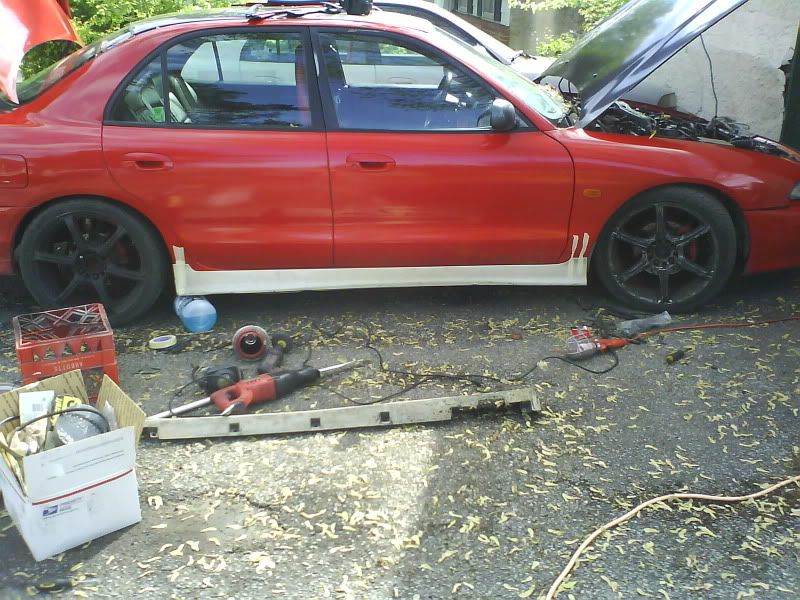

Got me 02 Infinity g20 side skirts, Integra Mugen lip (LOL) and 09 Lancer GTS rims

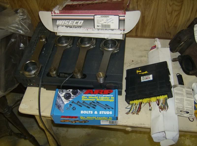

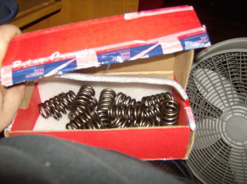

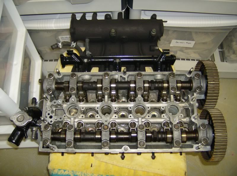

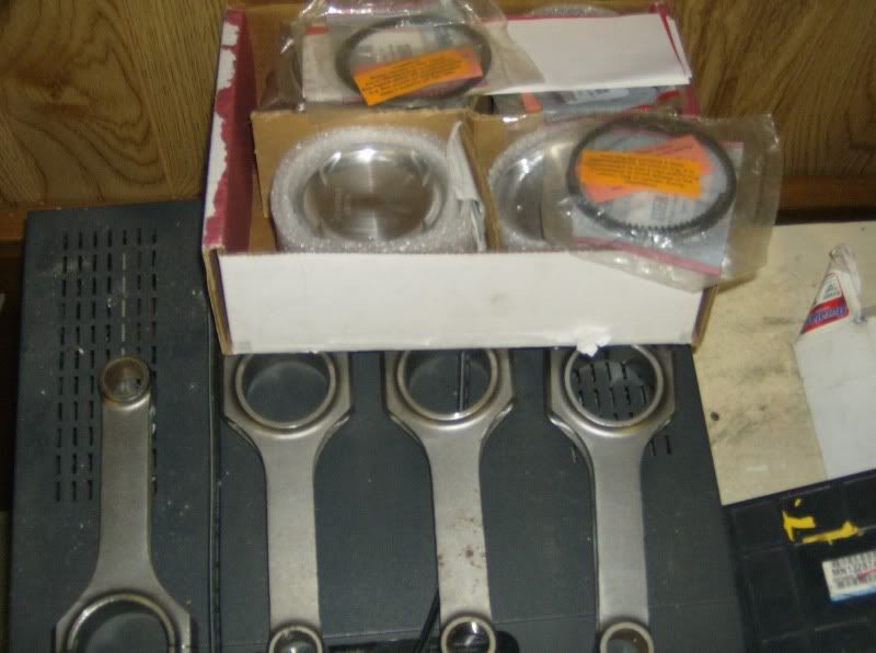

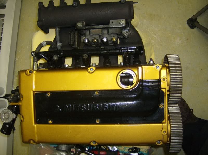

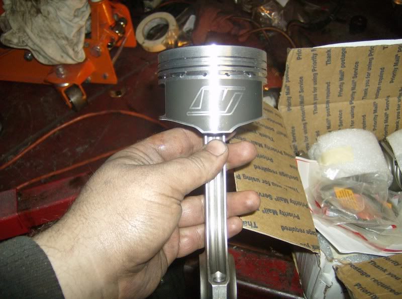

More parts came in - 2.4L Wisecos, Eagle rods, ACL bearings, Evo3 oil filter housing, Sonata 43cc head, Evo3 intake manifold

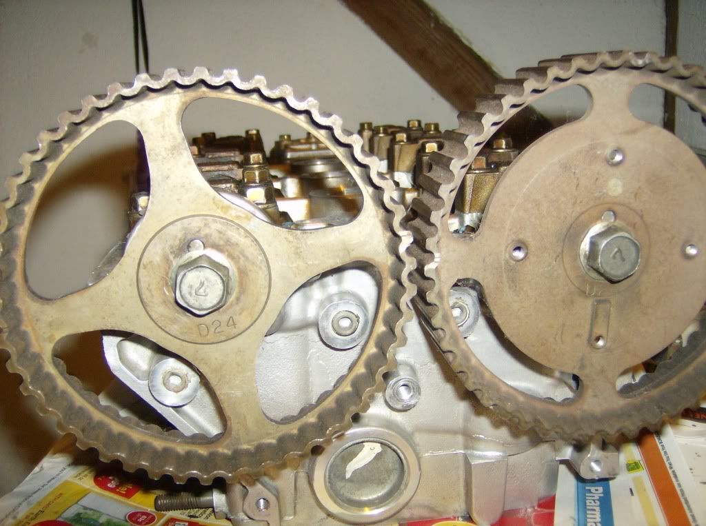

The OEM 2.4L Cam gears

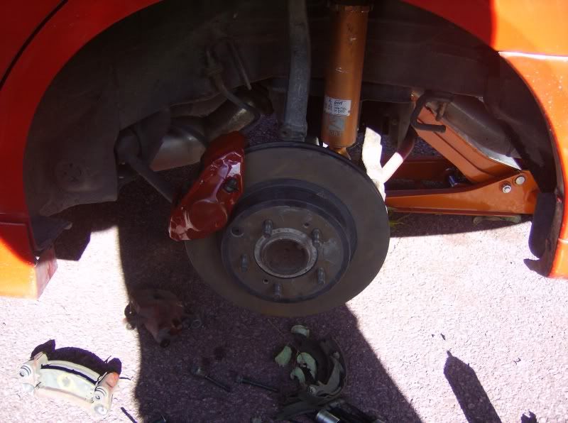

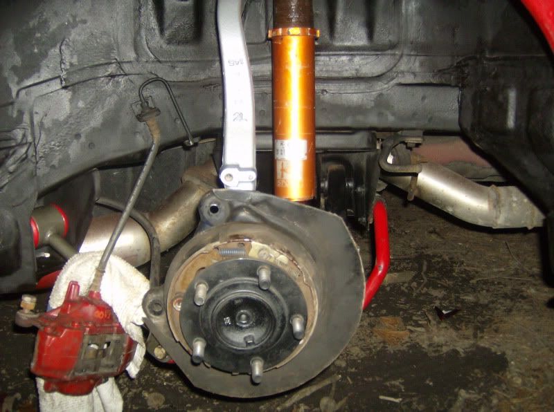

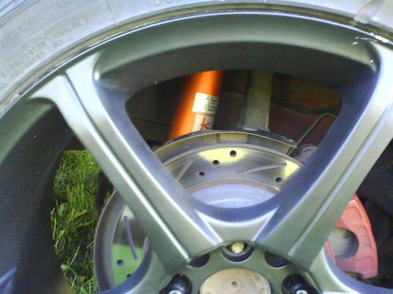

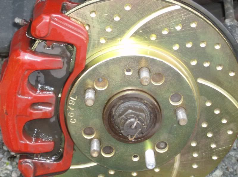

Did thge rear Evo brakes

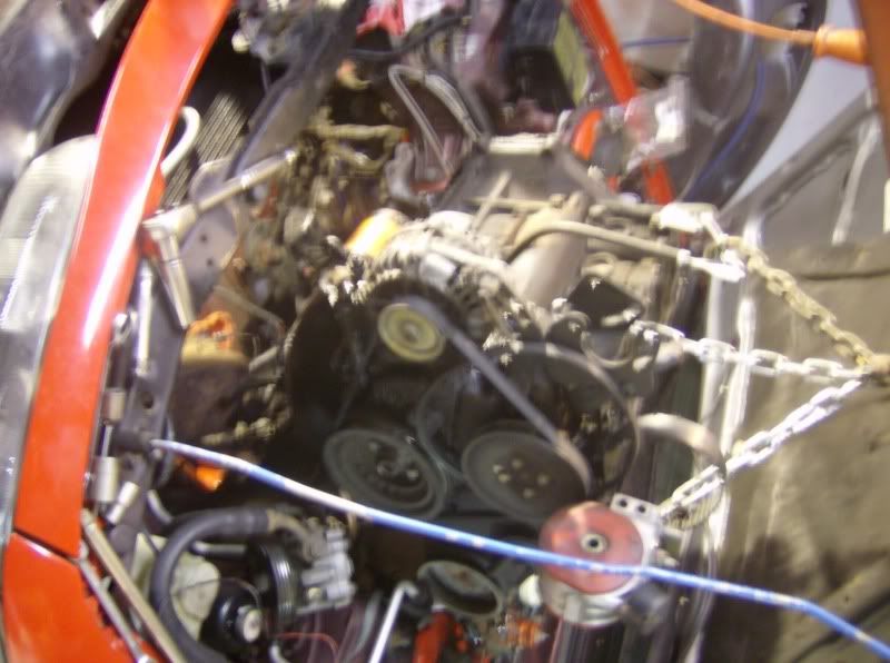

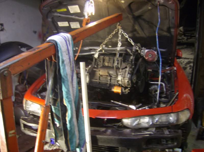

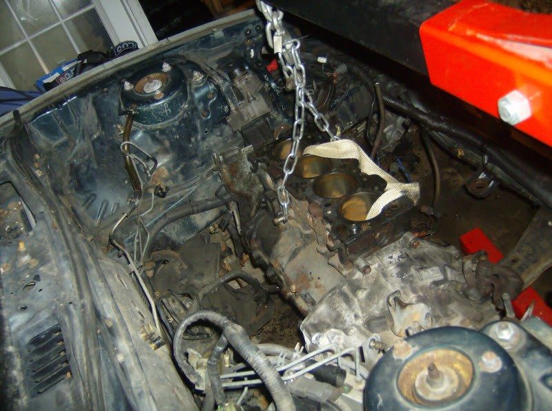

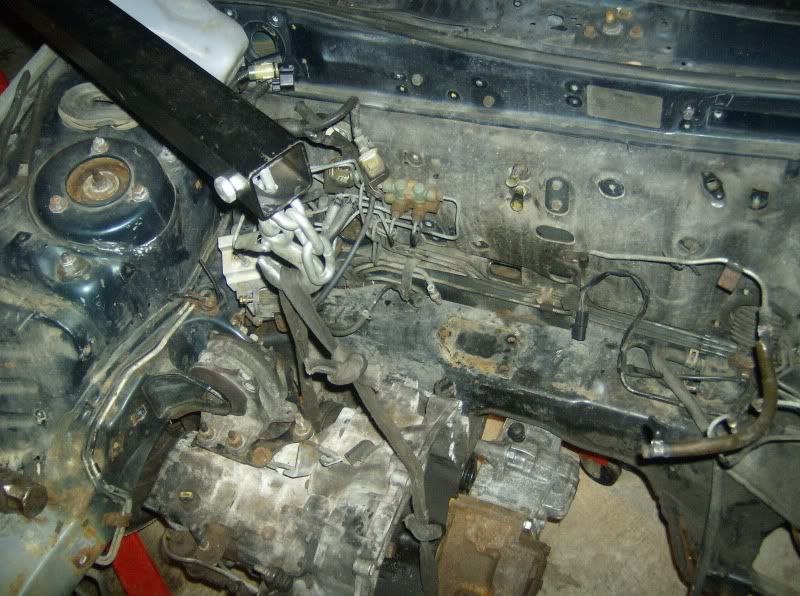

In January 2010 I pulled this out.

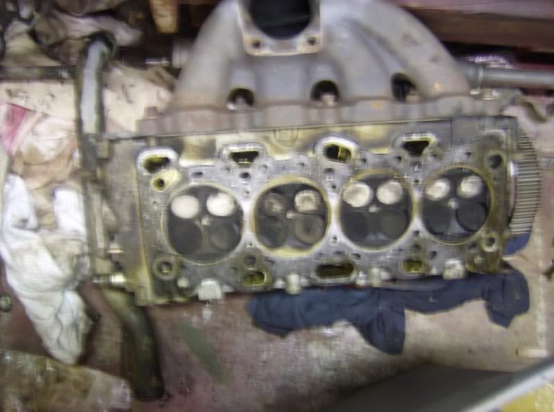

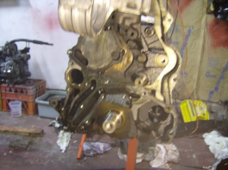

The shit is so dirty and sludgy its not even funny
The head isnt looking right

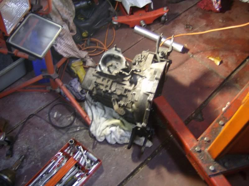

Trans is ok, no play at the shaft, im gonna replace the pivot ball and the throw out bearing

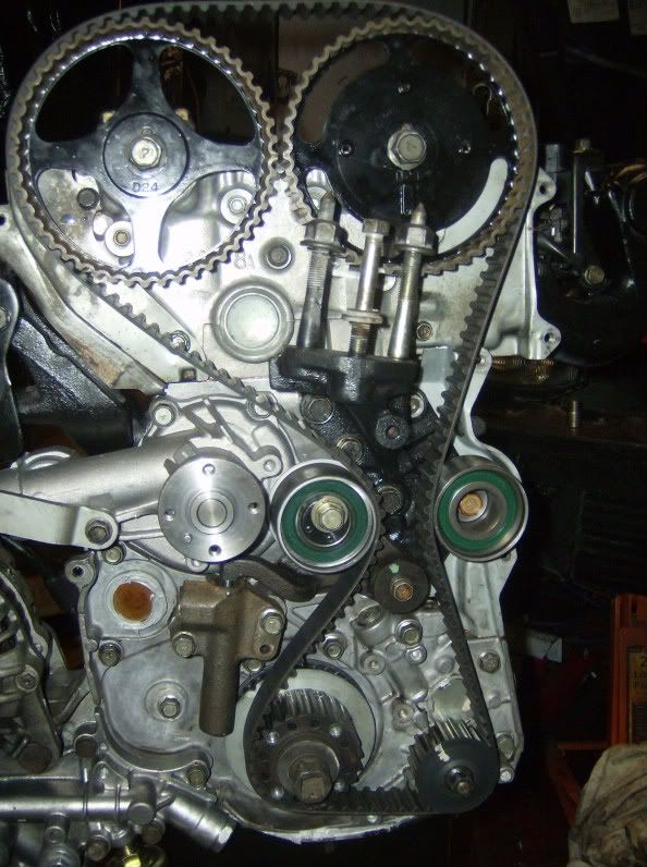

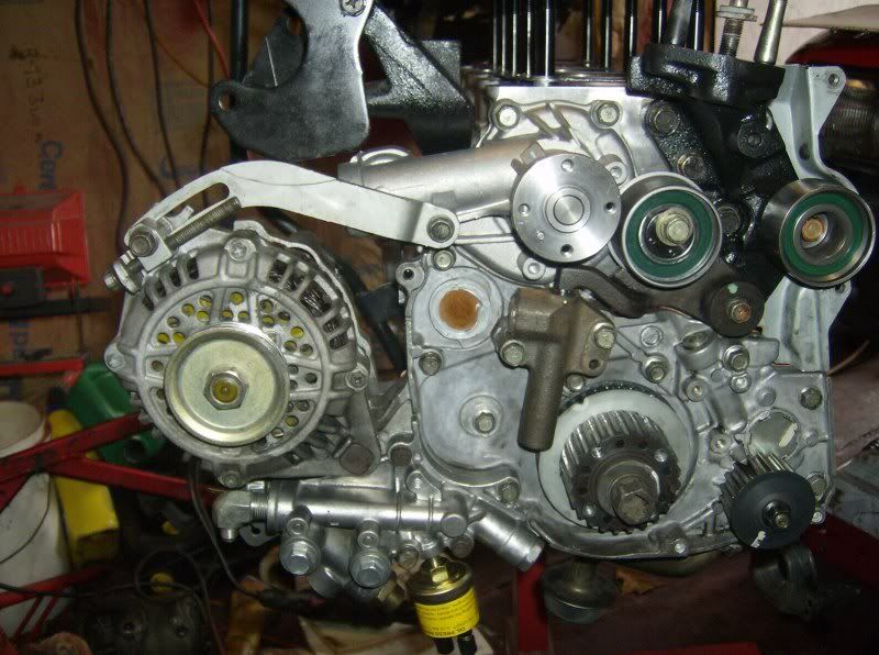

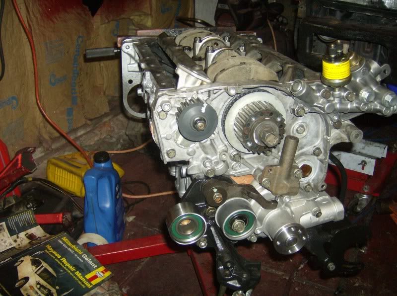

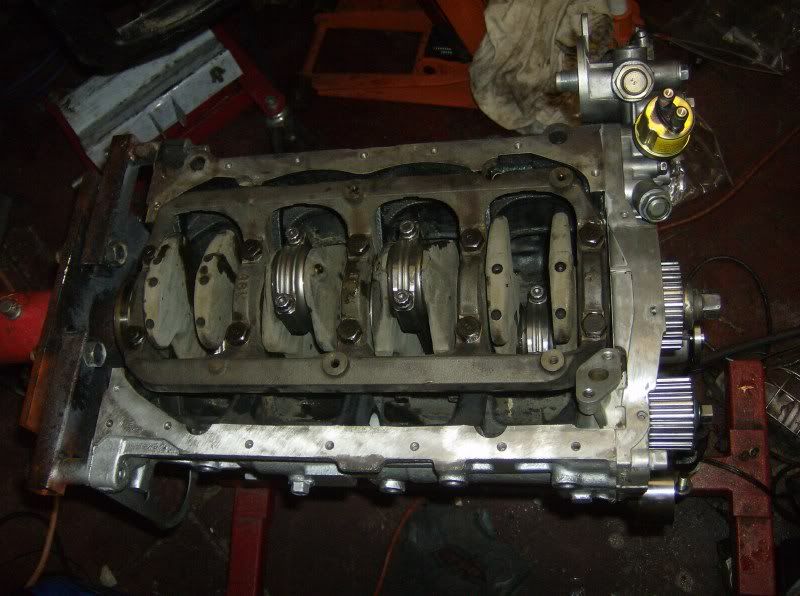

Well, I happened to find out that I was driving w/o balance shaft belt for the past 3 years
More Shats, Im gonna leave the pics do the talking!
All cleaned up

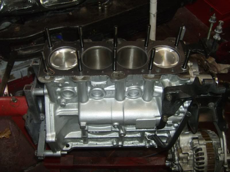

Balanced and assembled!
Everything is in!

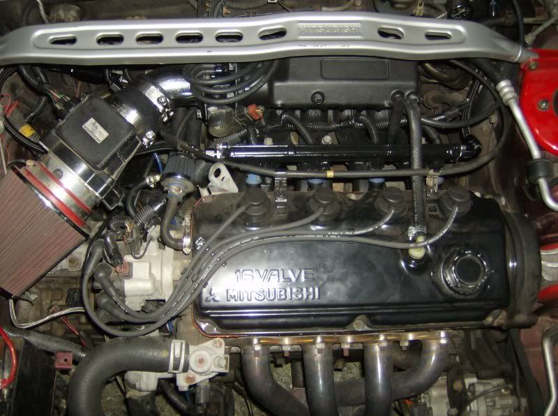

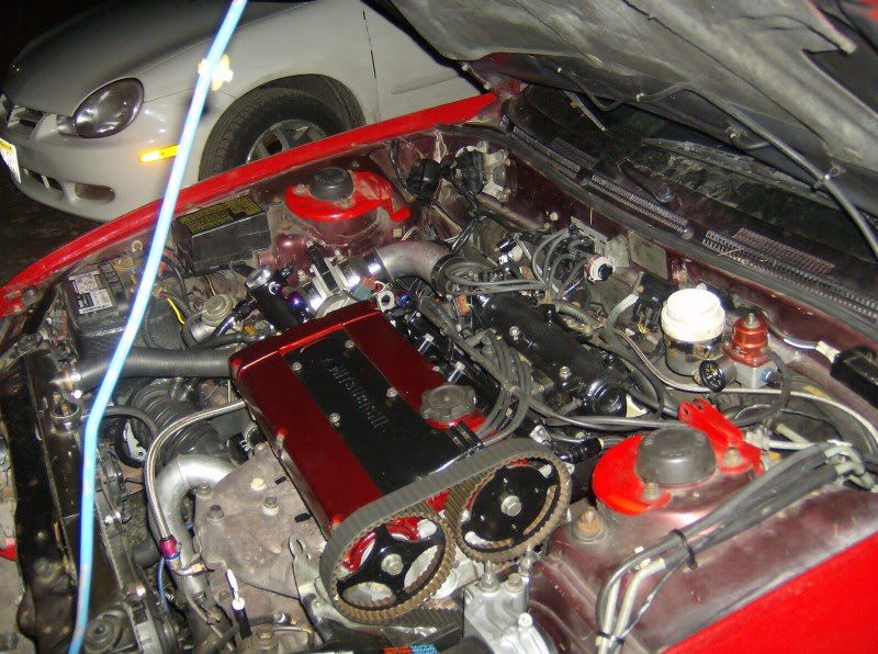

A few engine shots

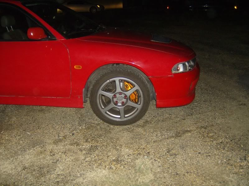

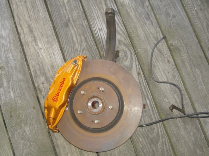

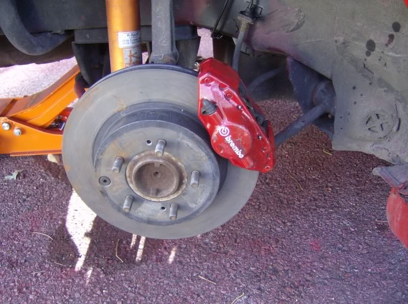

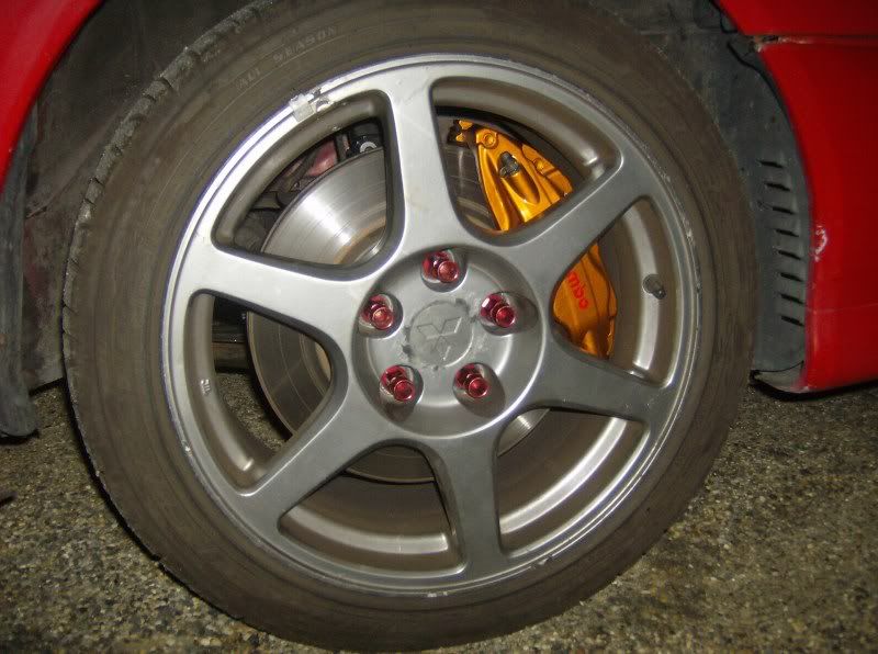

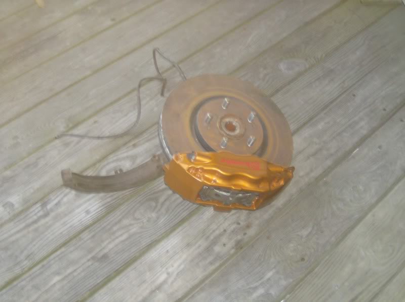

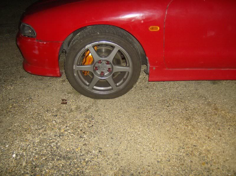

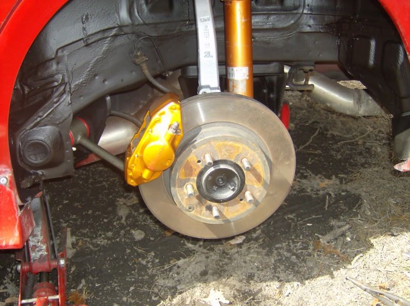

Finally some progress on the from Brembos. I used KMV brackets
Newest pictures:
From East Coast MOD
My car is spitting antifreeze ..LOL

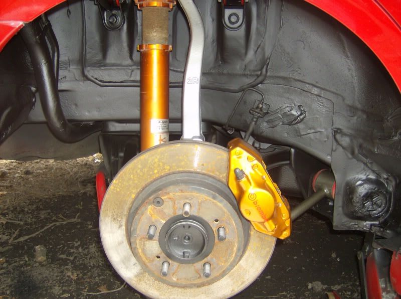

Finally done!!! Moar braking powa'! Daym, its been a while since I bought these!

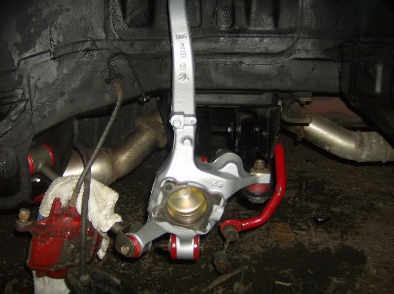

I found out that my curved control arms have bad ball joints after just 3 1/2 years. WTF??!! I need to buy new ones again!

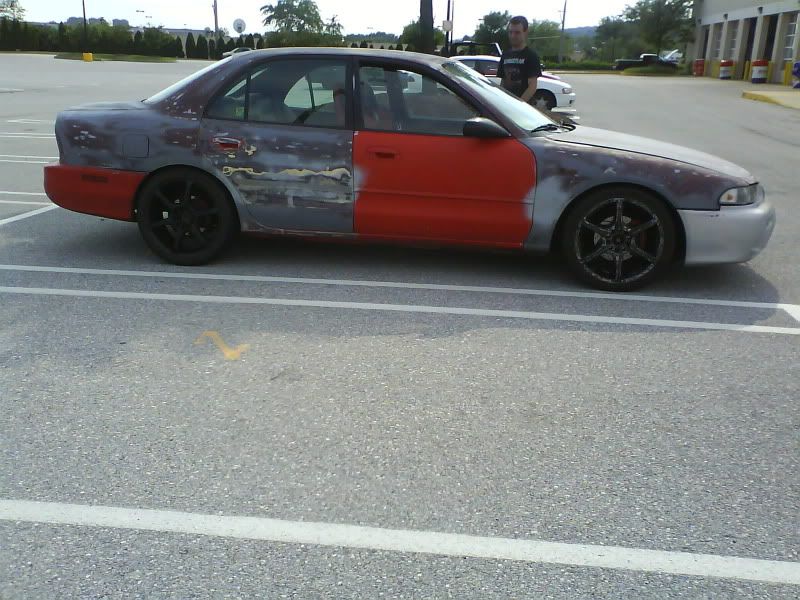

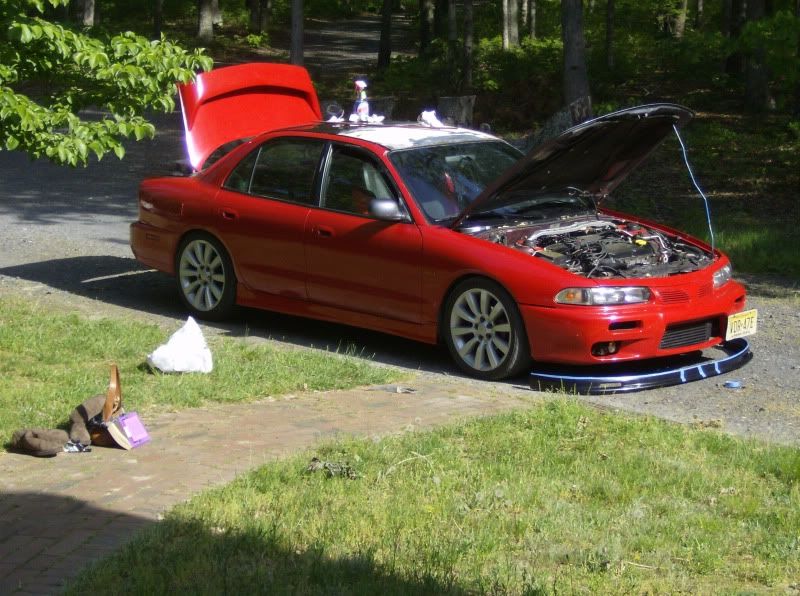

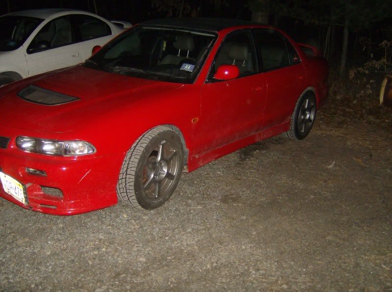

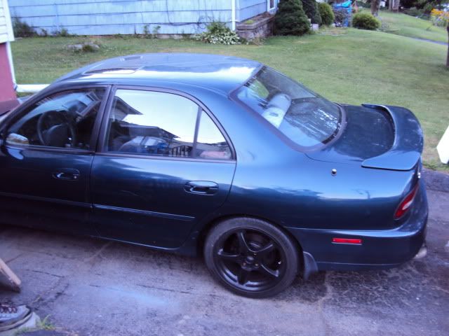

My car was in two accidents that I know of, and the last one was with a deer. Half of the roof was smashed in. I repaired as much as I was able to, but the chassis started cracking windshields - its on the 5th windshield.

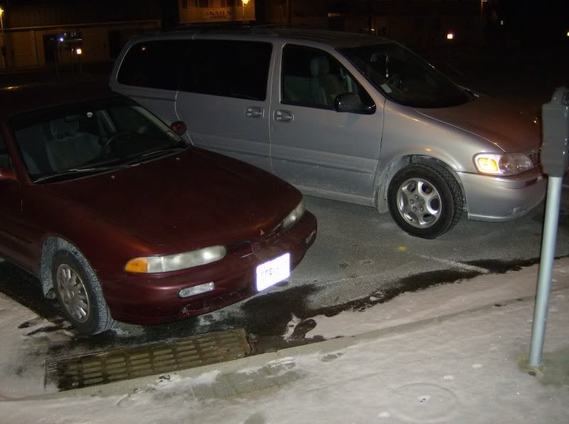

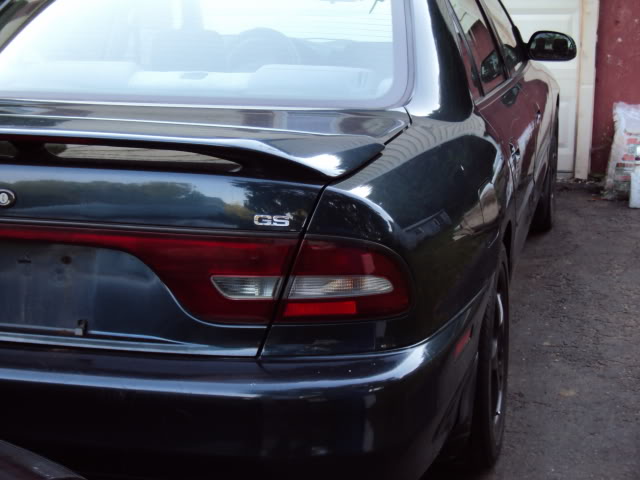

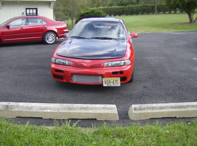

Either way, I just picked up one of the rarest Galants in the US. Its a 94 Galant GS. The 94 GS takes second place of rare Galants after 91 Galant GSX. The GS was made only in 94 and only 1700 of them were made.
Here are some pics

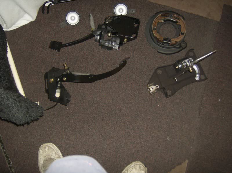

Everything from the red one will be transferred over to this one plus AWD swap.

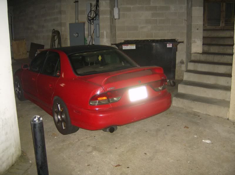

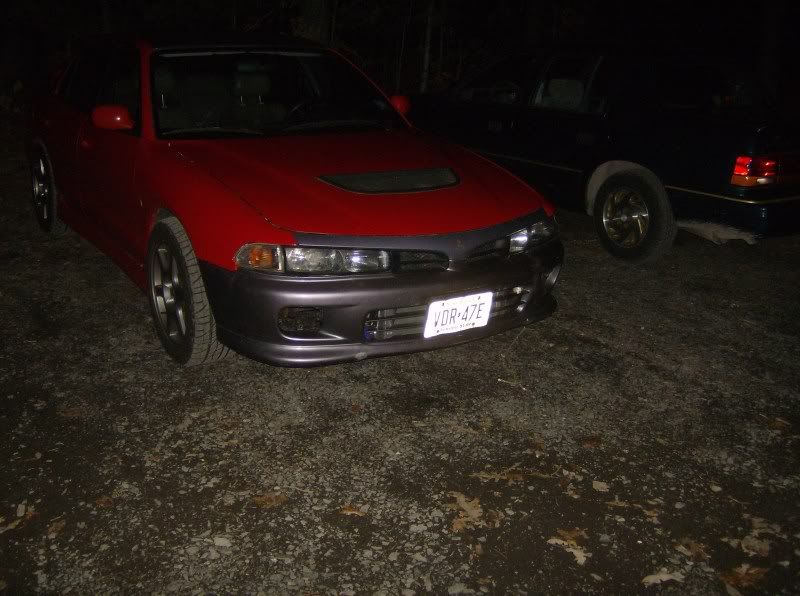

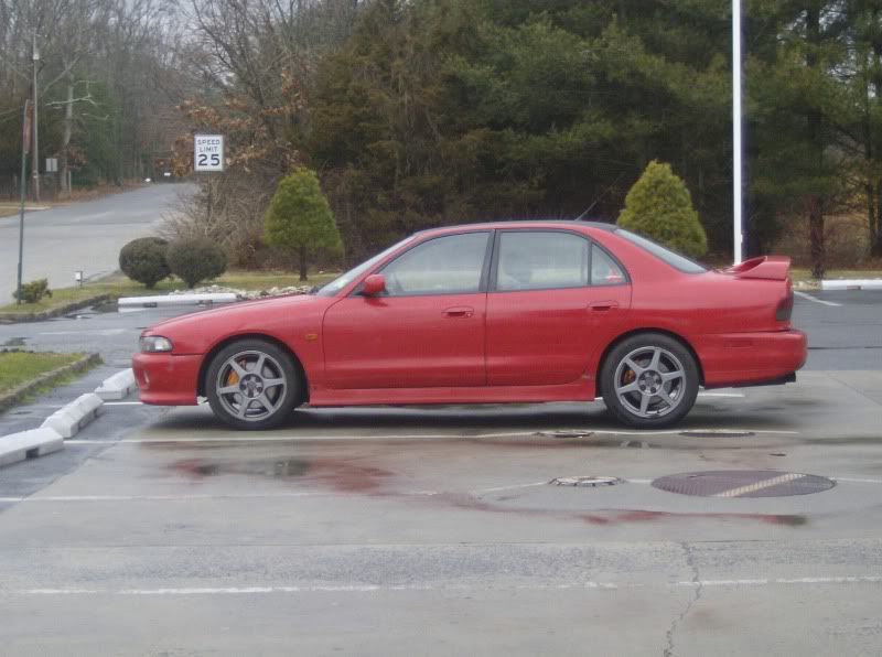

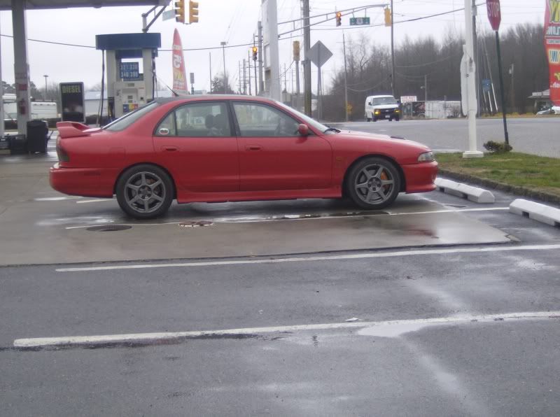

A few last shots of the red Galant

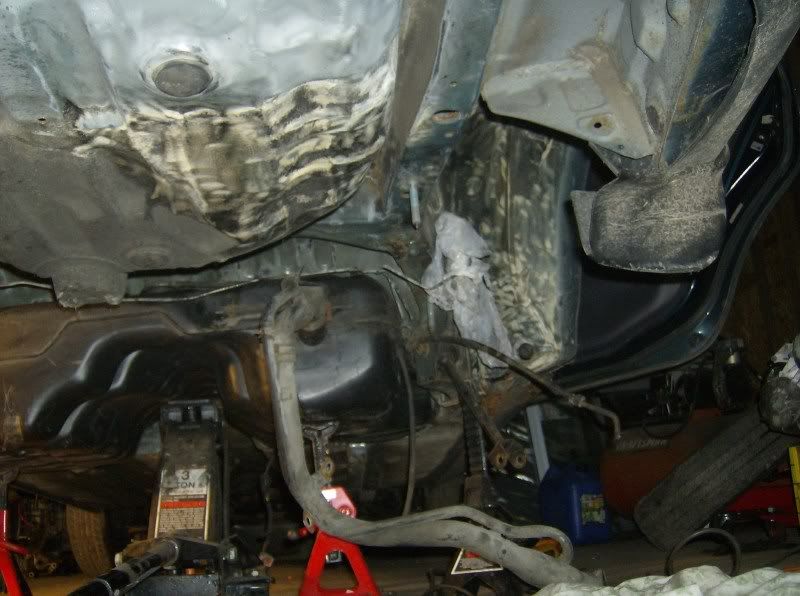

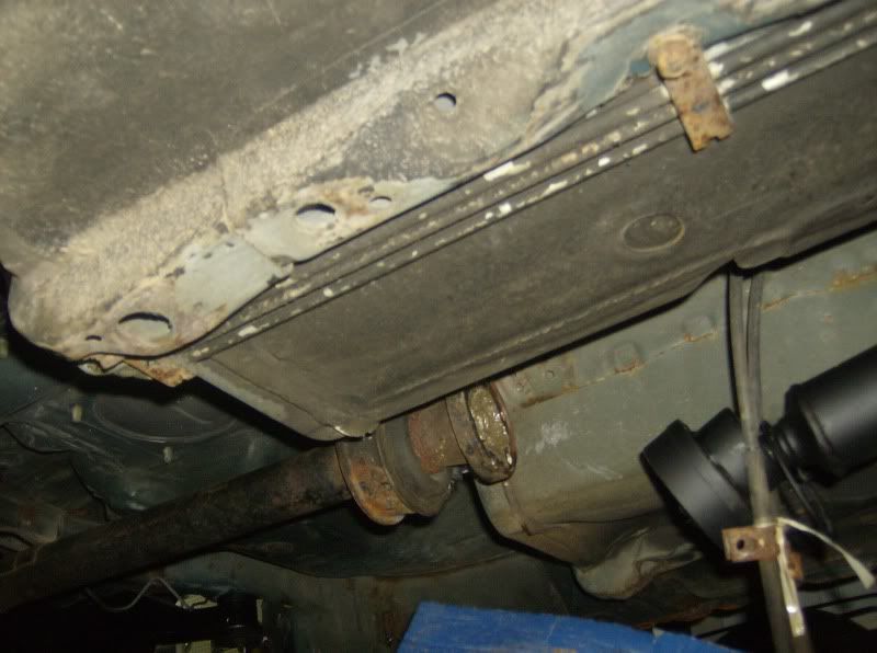

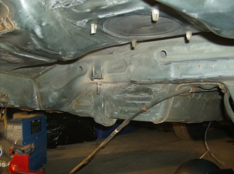

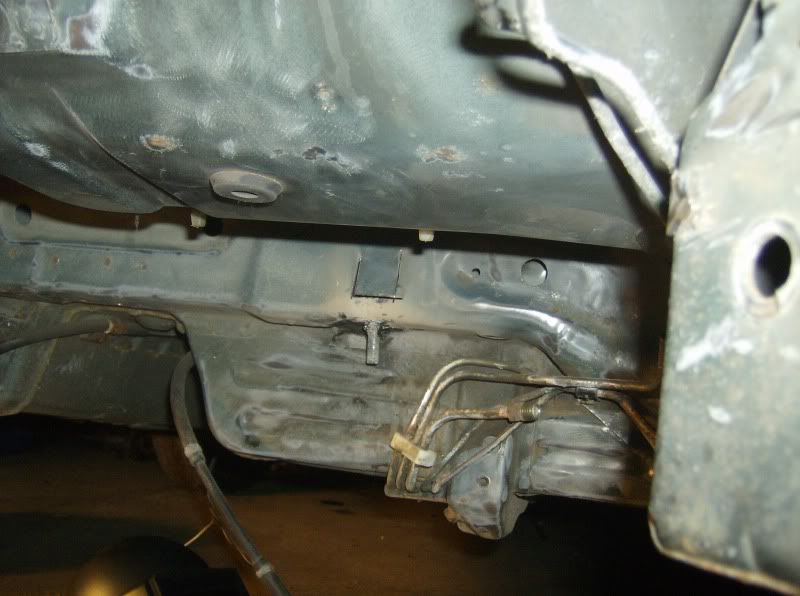

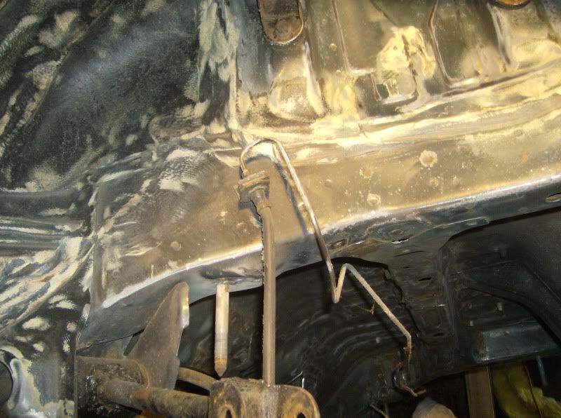

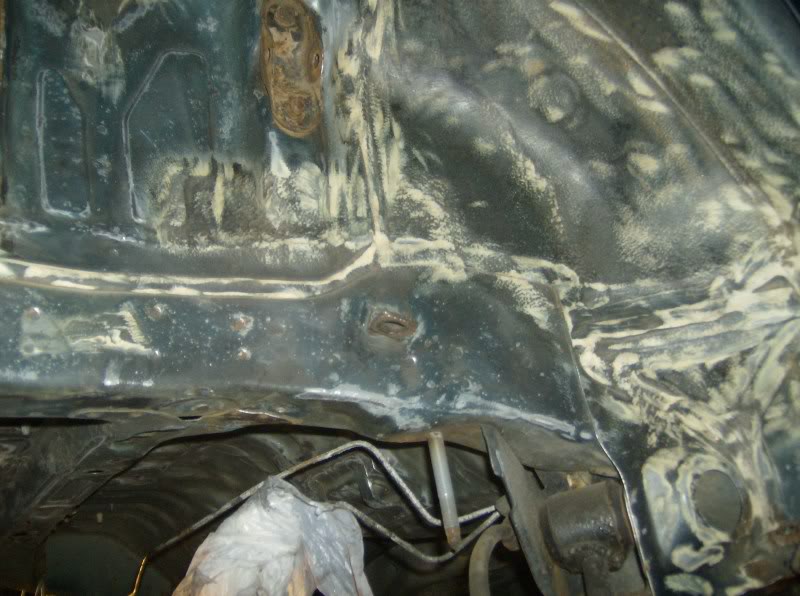

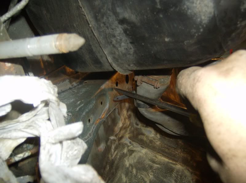

Its a mess!

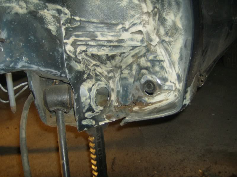

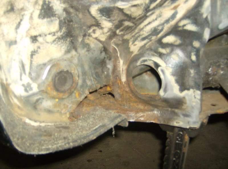

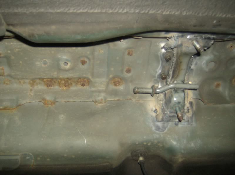

Pass side rust spot
Driver's side rust spot
I refuse to half-ass it! Do it once and do it right!

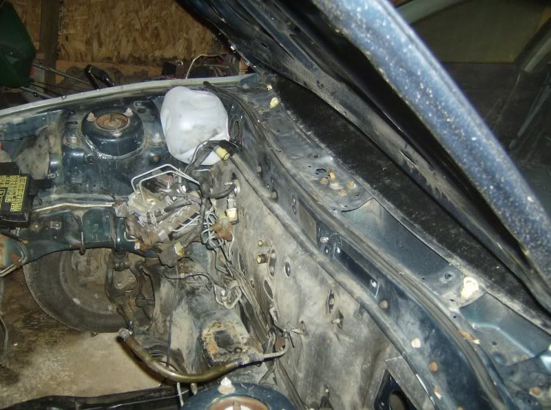

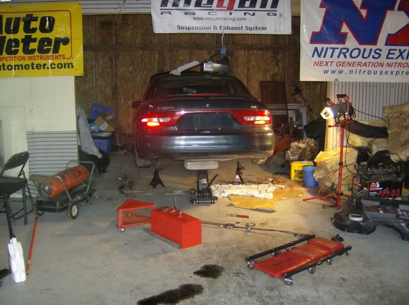

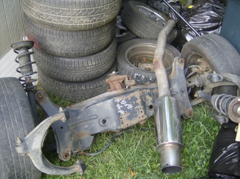

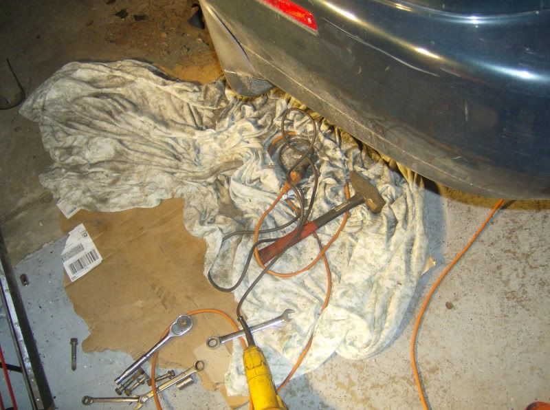

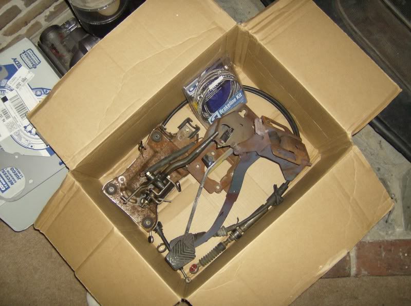

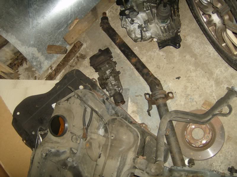

All the shit that came out from under the car

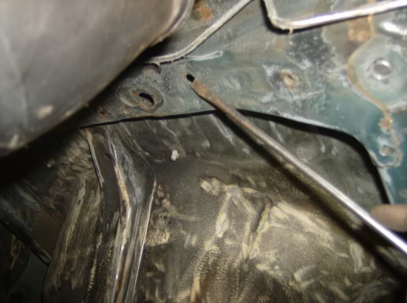

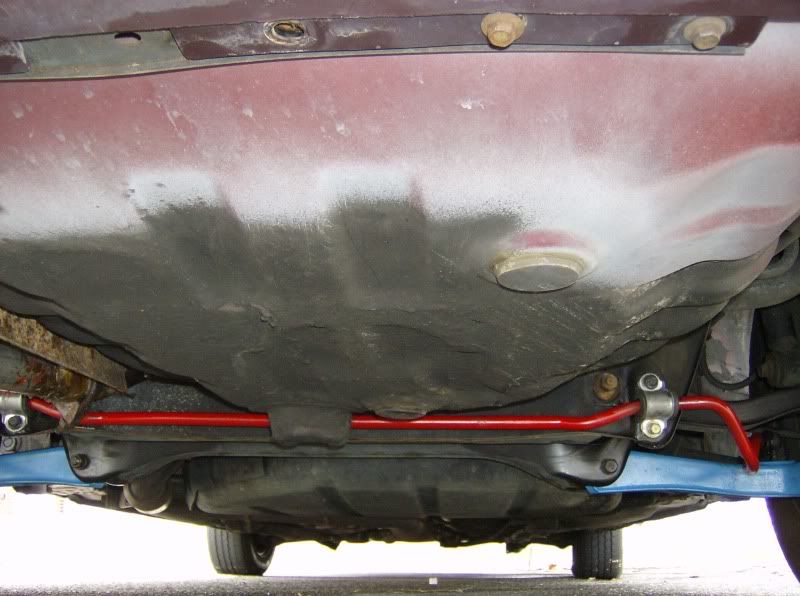

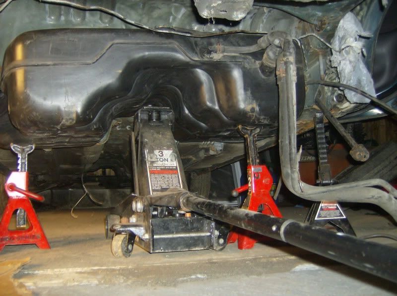

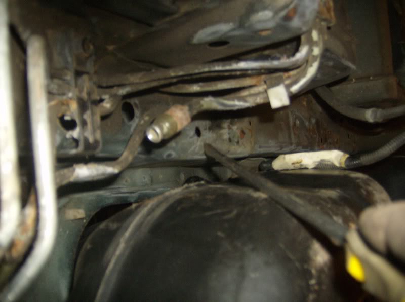

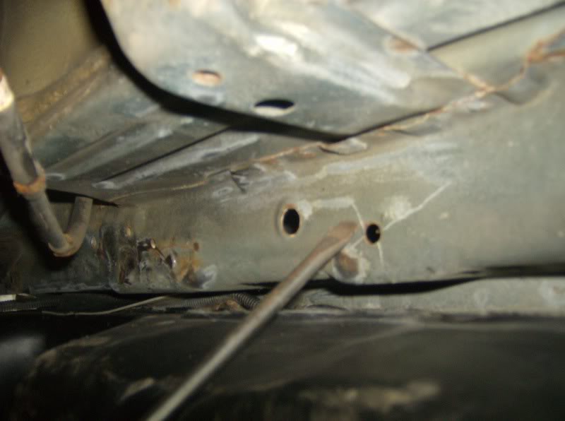

Test fitted the AWD tank to see which holes to use for the AWD tank straps
Driver side rear hole
Dr. side front hole
Pass side rear hole
Pass side front hole
Dropped the bolts in
Rear subframe

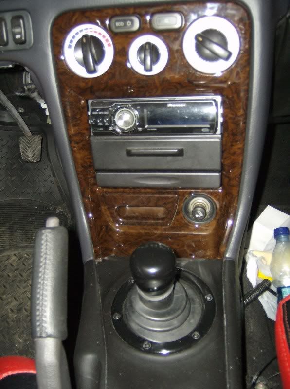

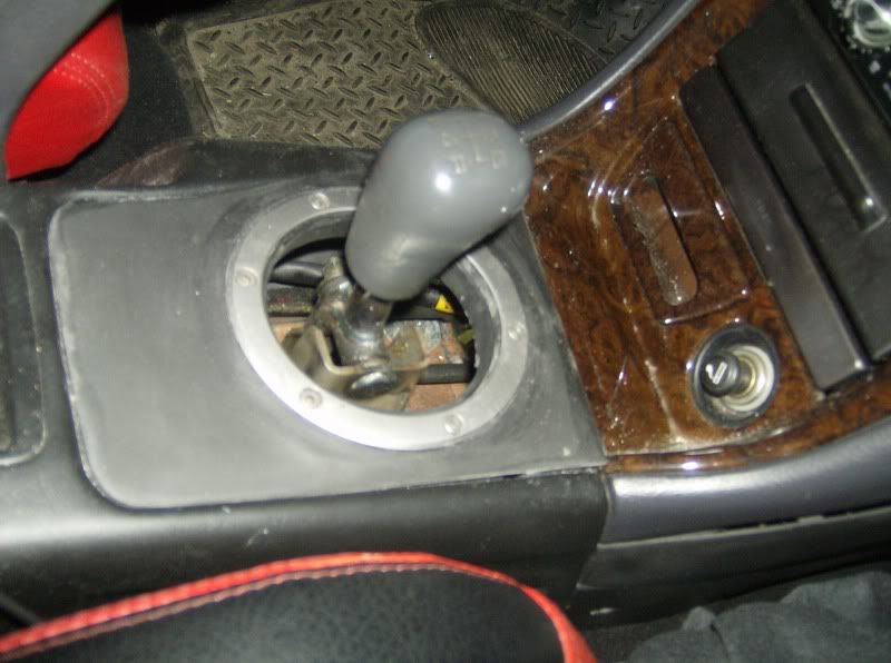

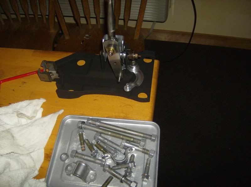

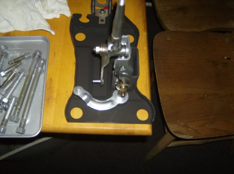

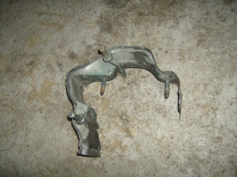

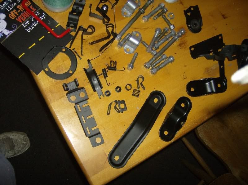

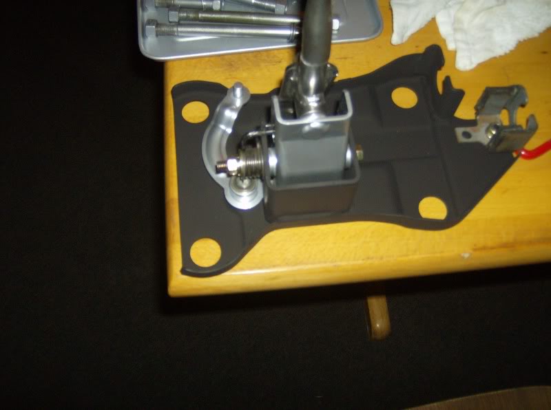

The advantage of having your own powder coating system. Thats my new short shifter (home made type of deal) and some of the rear subframe bolts

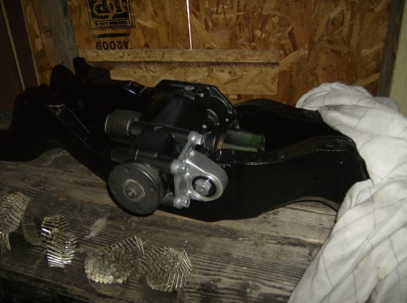

The rear carrier
The front carrier - its pretty trimmed so it fits there.
What do you think - its about 6'' short?

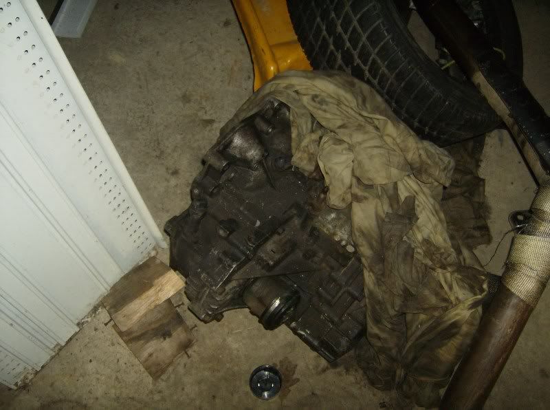

My quick trans installation

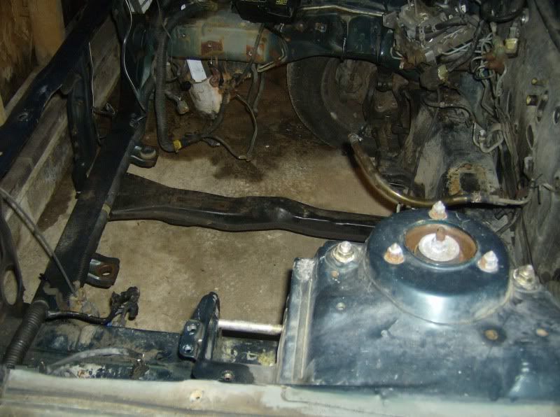

Installed the spare 4g63 engine I have.

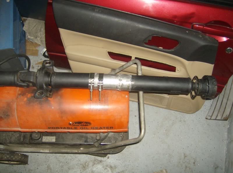

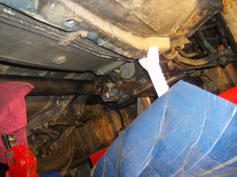

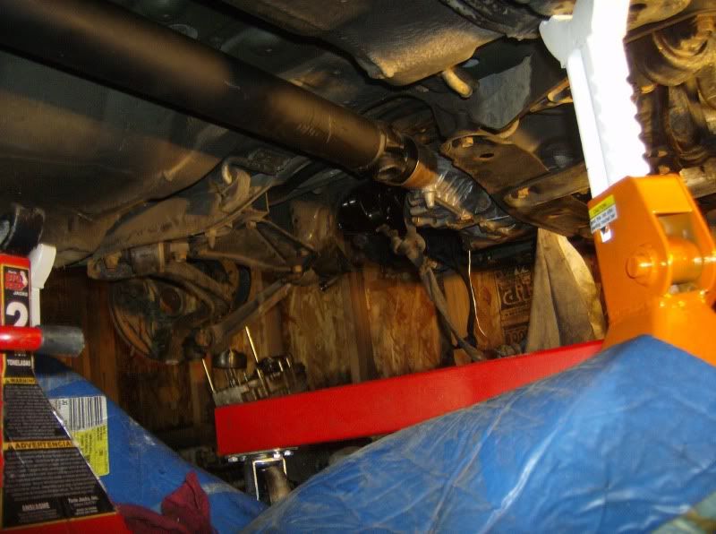

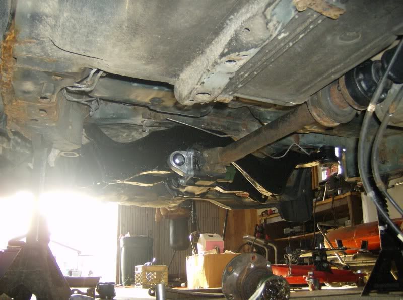

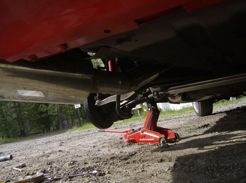

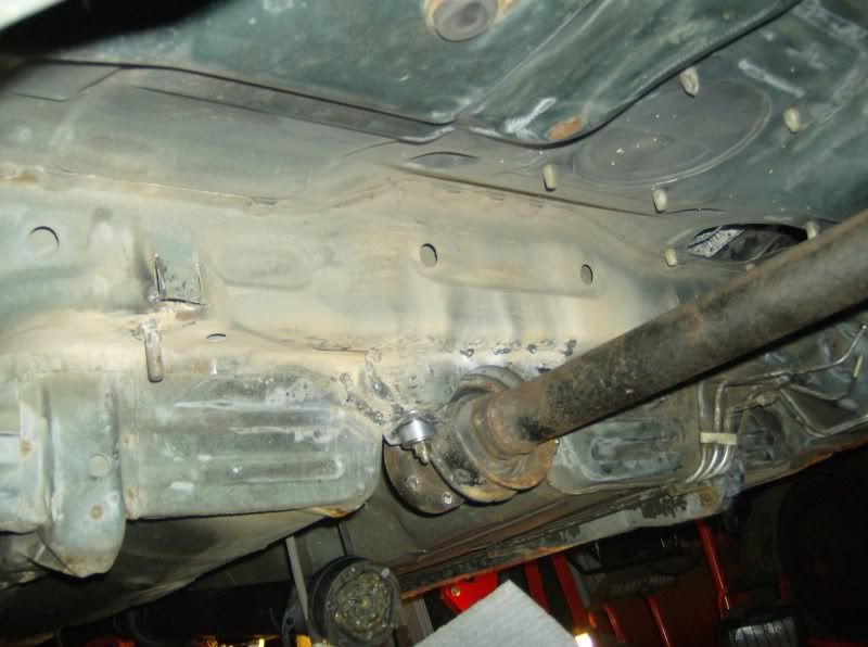

Eclipsh suggested that I cut the drive shaft in the middle, so there it goes
I used some exhaust pipes and t-bolt clamps to get the shaft to its correct length. I'll be taking it to the drive shaft shop this coming week

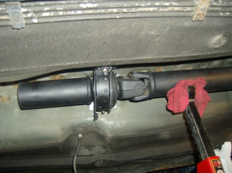

Full drive shaft installed.

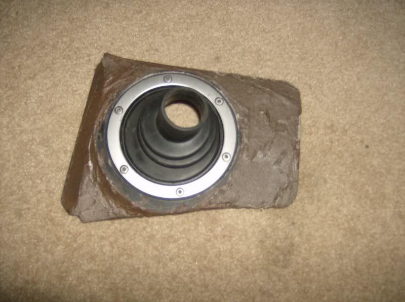

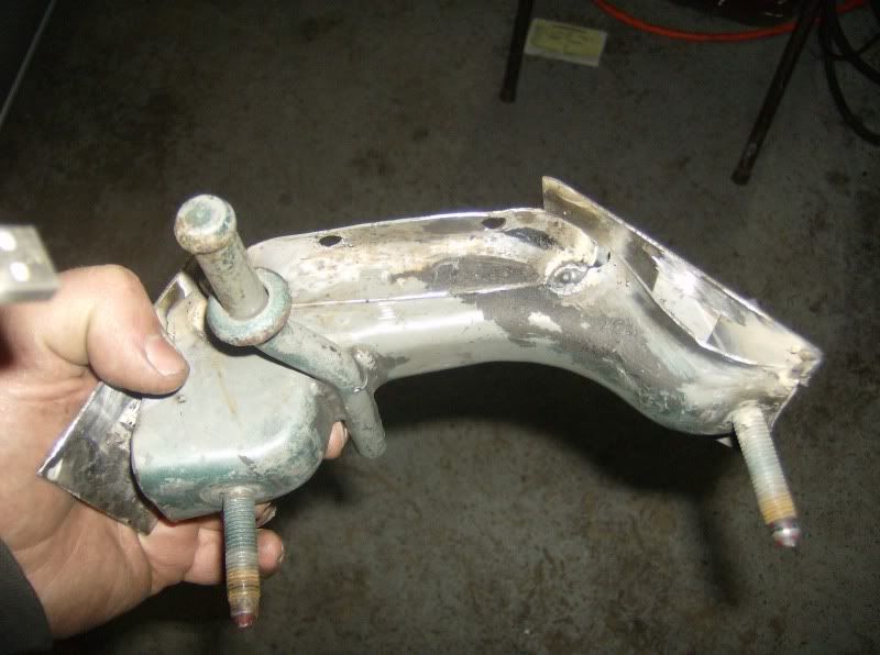

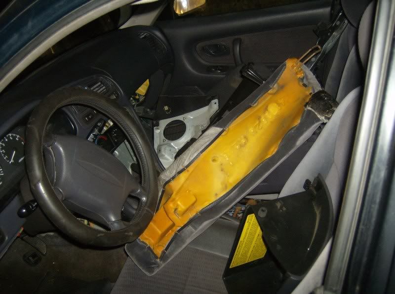

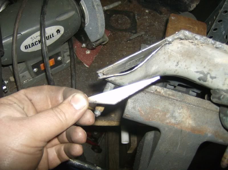

This is the piece that can be fit in the Galant's tunnel. I had to fab up a housing for it to make it beefier.
from this
to this

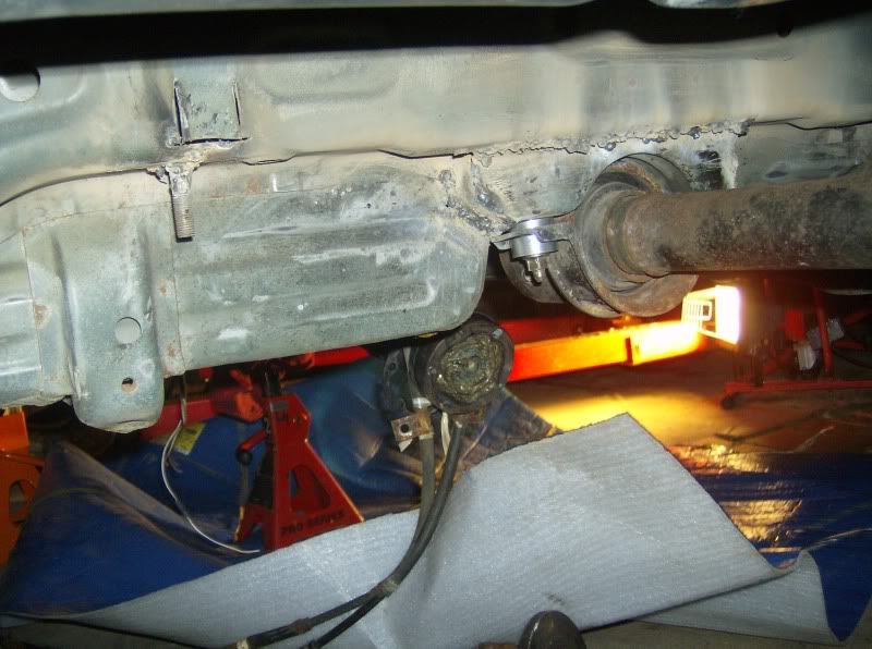

Filling the gaps
Carrier bearing tacked in its place.

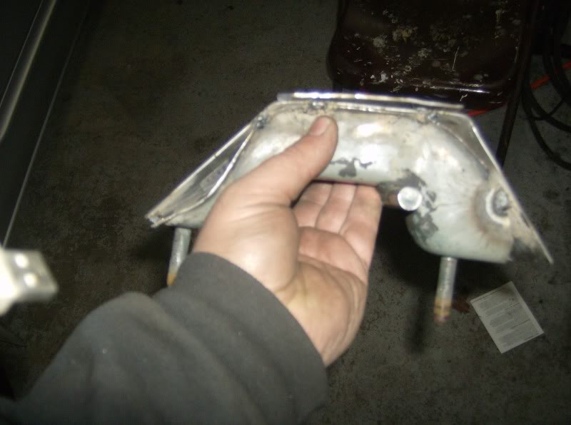

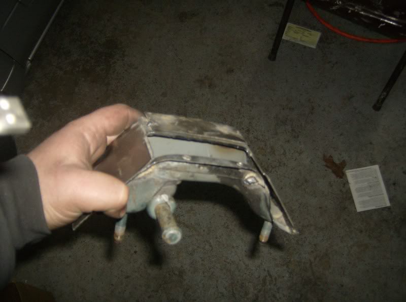

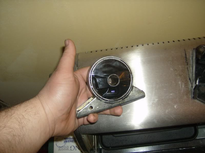

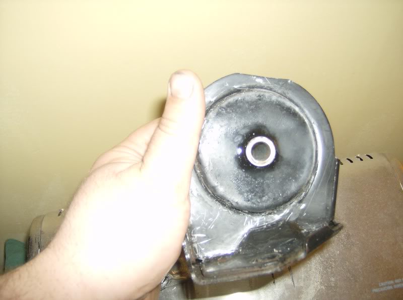

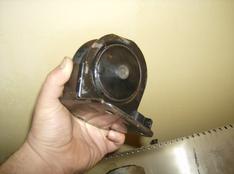

I did the roll stoppers with liquid urethane and its not the Windo weld urethane or any home depot roofing urethane, but the very same that the motor mount inserts are made of.
I had the partial insert in the rear one and full race welded front one which actually was kind of harsh.
If anyone cares, this is what I used:
dSt DIYMMI Do It Yourself Motor Mount Inserts - Liquid Urethane

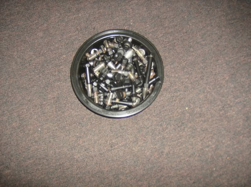

Everything is coming off tomorrow and I'll be coating the undercarriage.
Just a quick few pictures of all brackets, bolts, nuts and washers being coated.
