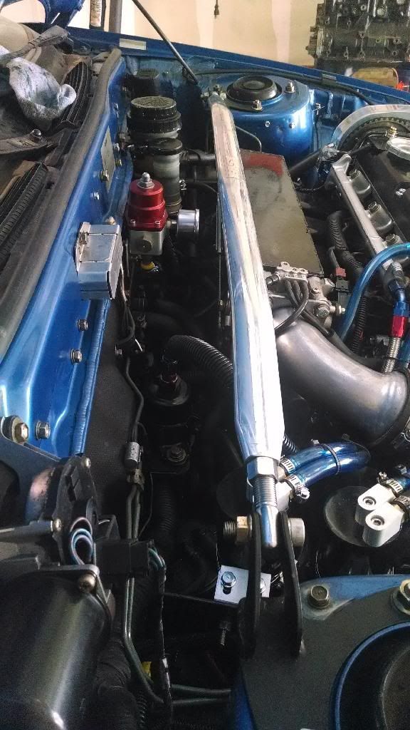

I then moved on to cleaning up more of the engine bay, tightened the down pipe, made up a throttle cable (actually used the factory cable from the throttle to cruise box), added the gear oil to the trans, routed all the vac lines for the emissions crap and added coolant. I also installed a spring for the dipstick, not sure its needed, but figured it was cheap insurance.
Some Pics:
Cleaned off all the decals (too rice for my old ass)
Mostly cleaned firewall
Throttle cable tucked under intake manifold
Spring installed

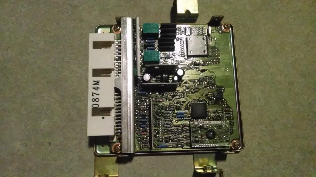

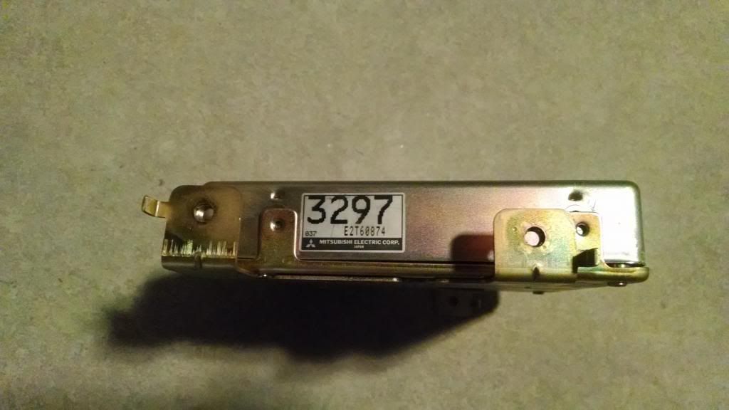

So I called up the PO (my buddy) and I guess I was wrong about the ECU... I guess he bought it off of someone because it was socketed already, so I have idea if its good or not. Anyone know if I can just swap the socket to my spare ECU? (Which is the factory ECU to this car) Im hoping I can just have the socket swapped over and be good to go?
***Edit: It seems after some research, I cannot use this ECU because it is Non-EProm... Sigh
Pics:
Best update of all, I pulled the console apart again, messed around w/the ECU some... Plugged in the laptop again and got it link up. I made all the necessary changes in Link and it fired up first turn of the key!! So stoked!! Have one small oil leak to track down... Its running down from above the front water pump outlet, any ideas? I didn't have time to really look at it and it was all hot by then...

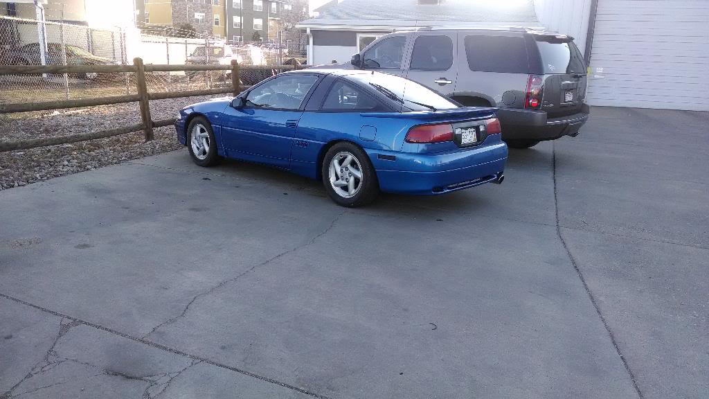

I drove the car to work today (only a few miles) to see how she does, doing great so far! Here are some pics out in the sun finally!

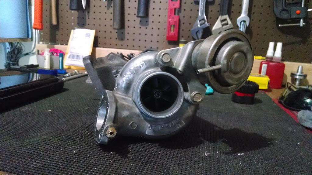

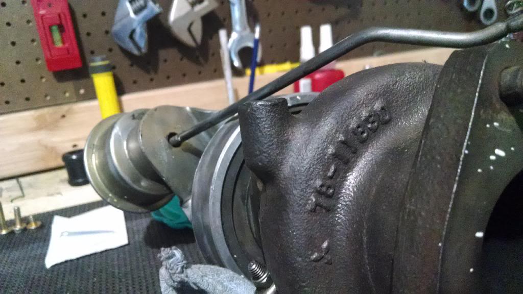

I also picked up a real 16G to use after the break in is over and I get a short route FMIC kit.
At the alignment shop
Engine back together
16G
