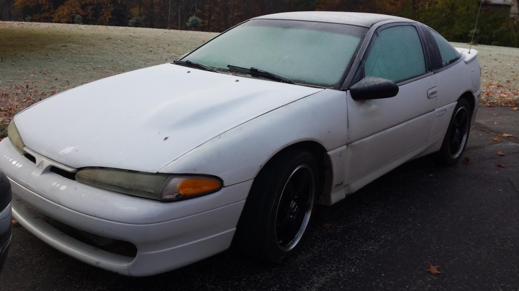

I titled it this because I haven't come across one modification on this car that's been done correctly. I've got myself a 92 TSi AWD with *low miles* according to what I can only assume is not the factory cluster, which shows 65k miles. The thing has been severely mistreated and I'm determined to bring it back to where it should be. Guy I bought it from had it for 2 months and had no freaking clue. He just seemed proud that he got the radio "working".

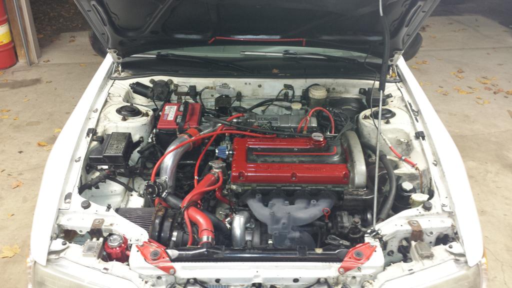

Engine/Drivetrain:
  • Harness from a 90 has been hacked, spliced, molested, far beyond repair. It had a 90 EPROM ECU, which I'm guessing is why someone rigged a few other 90 parts in it, like the coil pack. Harness by the radiator started sparking and smoking, will have to dig into that more later.
  • ECU fried right after I limped the car home. Literally went up in smoke. Looks like the driver chip fried on the board, commonly caused by the ISC motor. So I'll be replacing that before swapping another ECU in.
  • Oil. Oil leaks everywhere. Most concerning is the leak on the timing side, which might be coming from a camshaft seal or something. Idk, once I get the thing put back together with proper wiring I'll look at that. Oil pan is dented and has red RTV gobbed all over the damn place. Oil return also gobbed with rtv and is obviously leaking. I think the P/O thought RTV worked by putting it on top of leaks.
  • Vacuum/boost leaks- I haven't done a BLT yet, but right off the bat there was just a missing hose off of the throttle body. I think it once ran to the EGR system that was I'm sure properly deleted.
  • 3 missing exhaust studs/nuts.
  • Bigger injectors, no tune. Dude claimed they were 560's or something, but he didn't know his ass from a hole in the ground.
  • Air filter was not connected to anything, just chilling next to the stock intake pipe.
  • Intermediate shaft carrier whatever thing is not bolted all the way down.
  • Clutch doesn't fully disengage, grinds sometimes when shifting. The pedal feels like poo, the slave cylinder squeaks, and I think the master is adjust out as much as it possibly can be. So that'll be a fun combo of things to diagnose.

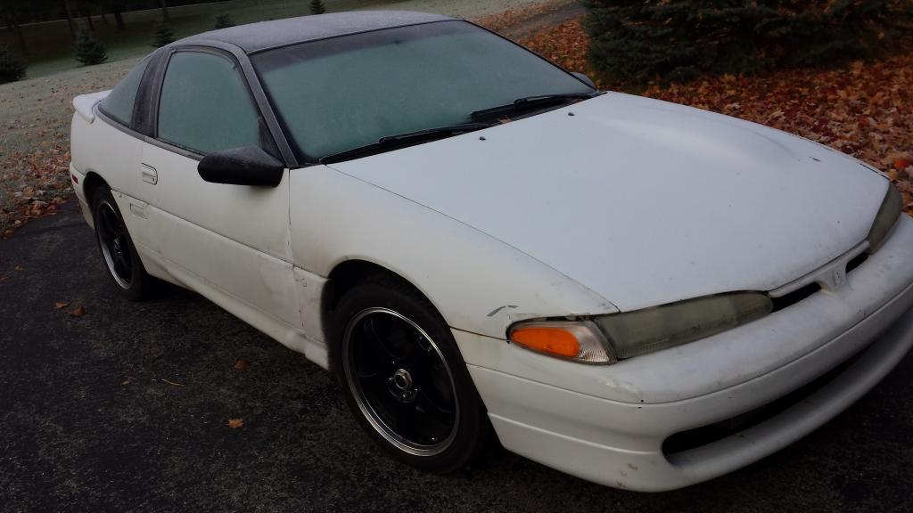

Body
  • Actually pretty rust free, but there are many dings, zip ties, and spray bombed areas. I'll get some good pictures of that stuff eventually.
  • Eclipse front bumper, Talon everything else. It was involved in some kind of collision at one point.
  • 2/4 wheels have bent lips. I can probably fix them with a piece of wood and a hammer.
  • Rear bumper is all tweaked. Exhaust melted and covered some of it with black soot.
And so much more. I'll be updating with pictures as I go along, mostly so I can keep track of parts, cost, and the long to-do list.

On a brighter note, this car supposedly has some decent parts in it. TRE Stage 2.5 trans, 4-spider center diff, lsd diffs, small 16g, and idk what else. Aside from the turbo I haven't verified these things yet, but it makes me at least a little happy to think those are all true.
As of right now I have the entire dash ripped out, as well as the ECU/engine harness. I'm waiting on a replacement harness to get here and a replacement ECU. Both of these are from 92 TSi's.
Also purchased stock 1g injectors and the appropriate coil pack from a 92.
