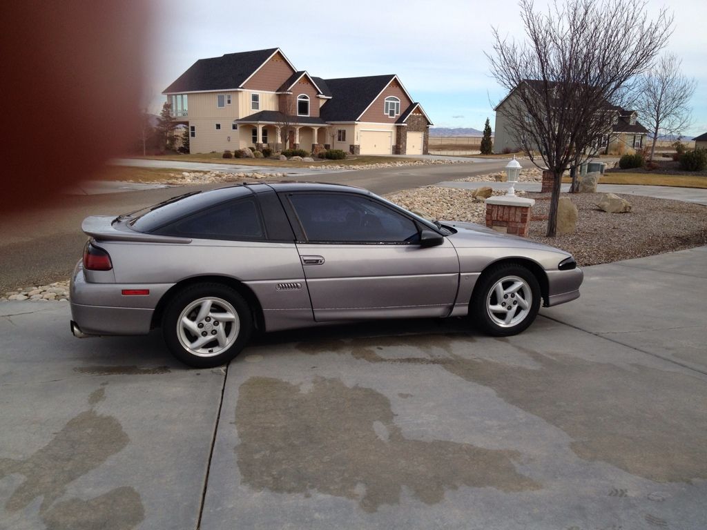

Before and after pic. Valve cover was changed to the purple cus of a small crack. It also came with a new catch can that got ride of my wind shield wippers
