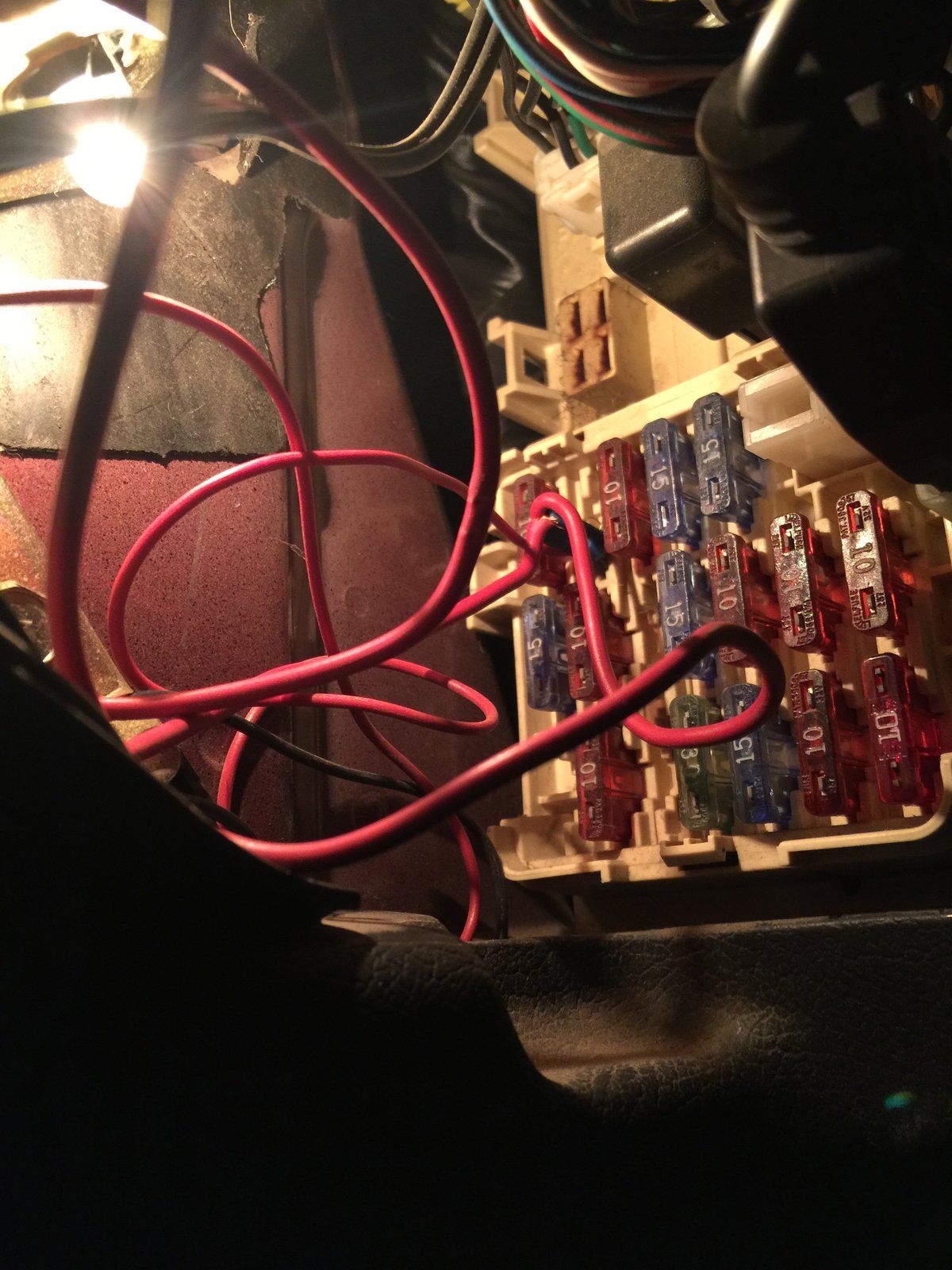

Well the motor is off at the machine shop, they called me oblast week with a run down it sounds like it was about 4 times what I had planned for so that will slow me down some. But the good news is I have plenty of time to fix a lot of the last owners wiring and do some cleaning up.
