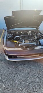

Found out about an hour ago the ECU in my car is a MD193299. The ECU has a ECMLink V3.
I found this by digging into why ECMLink isn't connecting. It's not a 90. And that's a different problem.
Earlier in my time on the forum, I posted my tach wasn't working and I never found the fix for it. I just moved on. After finding the ECU was not a 90, I started digging and found posts that the ECU pins 6 and 14 need to be changed. I checked and they were changed. Ok then. I saw this thread a little while after.
https://www.dsmtuners.com/threads/1991-1994-ecu-swap-into-a-1990-dsm-ignition-wiring.302812/
The Power TR Unit is still a 6 pin (90). I just want to confirm that the thread I listed above is the correct path to resolving the issue for the tach not working. And to add, is this a reason why the car won't run correctly? Turns over and spits like it wants to start. If it does, sounds like it's on 2 cylinders.
That ECU part number was from a ‘93 model year AWD car with manual transmission. By swapping the wires at ECU pins 6 and 14, the ECU should be compatible with the 1990 electronics to start and drive the car.
The tachometer is a separate issue. In and of itself, an inoperable tachometer will not cause the car not to start. You state that you have the 6-pin power transistor unit. Do you also have a 4-pin coil pack? Do you have a noise filter mounted to the intake manifold or intake manifold stay? Is your gauge cluster a 1990 version (do the speedometer values end in 5’s)?
As a no-start, I would recommend running through this thread to narrow down what isn’t there to allow the motor to start: How to Diagnose a No-Start
Good to hear, that's all I needed to know on that part.
The car is a 4pin coil pack.
Cluster is a 90.
2 connectors are unplugged behind the manifold.
The big one had a Black/Green and a Blue/yellow wire to it.
The smaller one that looks like it goes to the filter has 3 white wires going to it. I used a bore scope to locate a noise filter and nothing there. I'm 90% sure the small plug is the filter after looking at pictures on the forum.
I appreciate your response. I'm chasing down and trouble shooting on a car I never worked on before. DSM's are new to me. But trouble shooting on this car leads you down a rabbit hole.
Yep, the smaller one is for the noise filter. Without the noise filter, your tach will not function. Again, separate issue from a no-start.
These are some different versions of the noise filter. It was originally mounted to the intake manifold stay (bracket supporting the intake manifold, attaching to the block).
The other plug is for the EGR temperature sensor on vehicles with California emissions. It is an open connector on vehicles with federal emissions.
