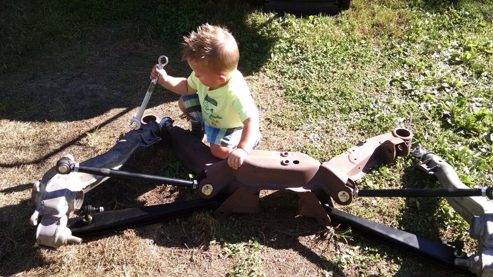

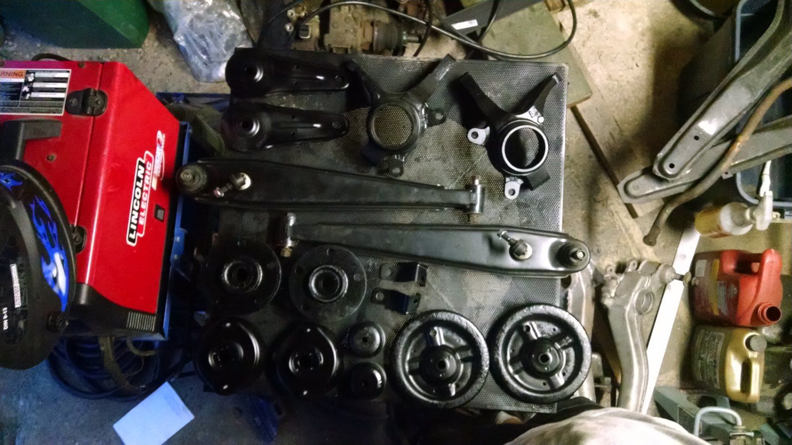

Maching up the rear suspension with the 3SX upper arms and Jay Racing active toe eliminator. Still have some cutting and welding to do on the trailing arms and subframe for the 3KGT rear end. My son was giving me a hand.

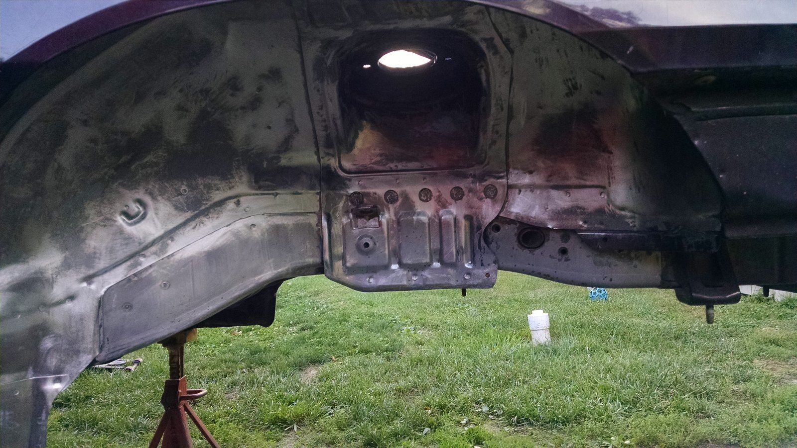

Taking vacation time next week to do the rust bullet on the under body. Trying to get this car back on wheels before it snows, it's blocking my garage!!!!!

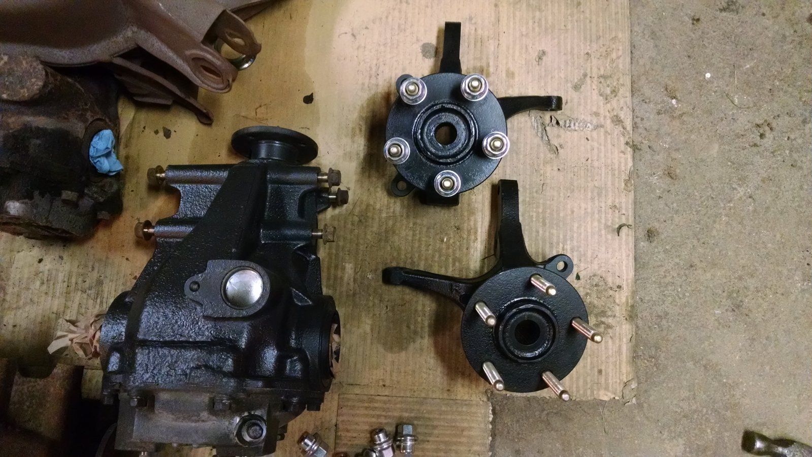

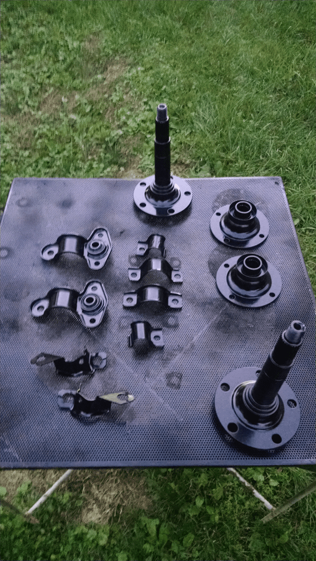

Here's a picture of the 3KGT rear diff and the front hubs with ARP extended studs, new bearings, and seals.

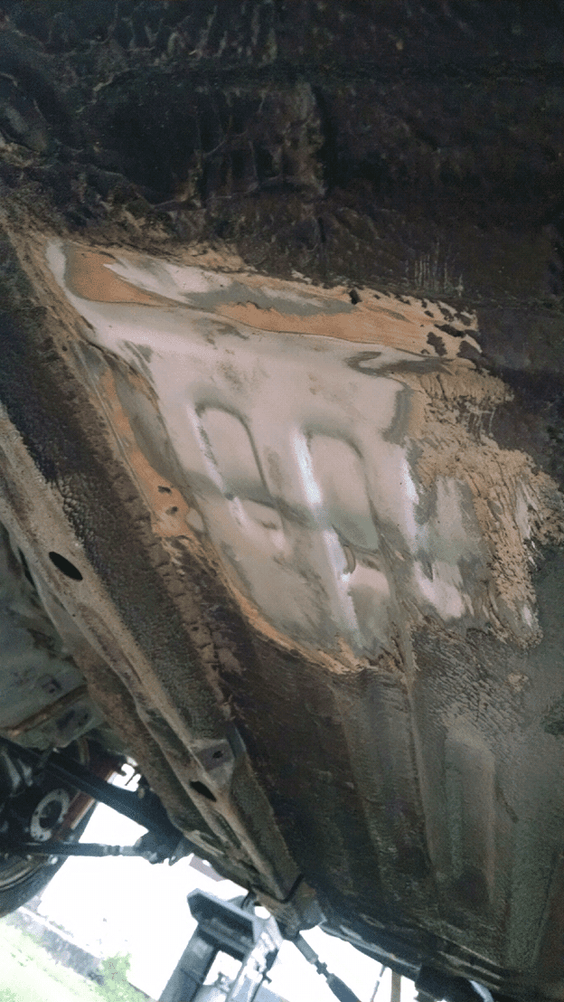

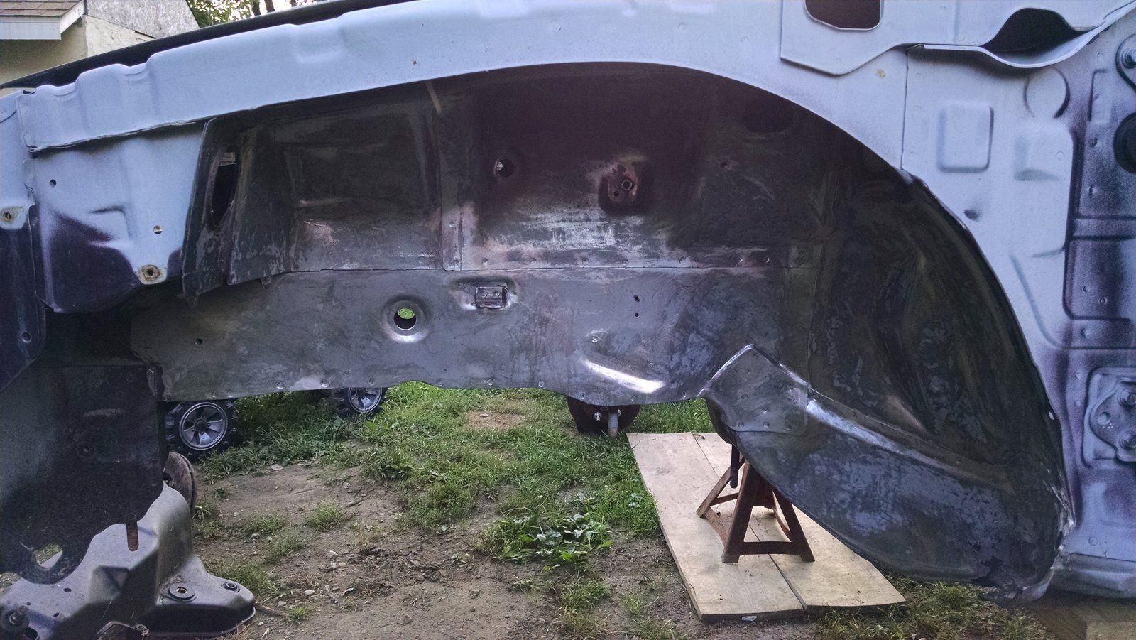

Finally hit it hard today got almost 2 wheel wells stripped of undercoating and ready for rust bullet. Here's a pic of the passenger side front. Thankfully my wife was willing to help.

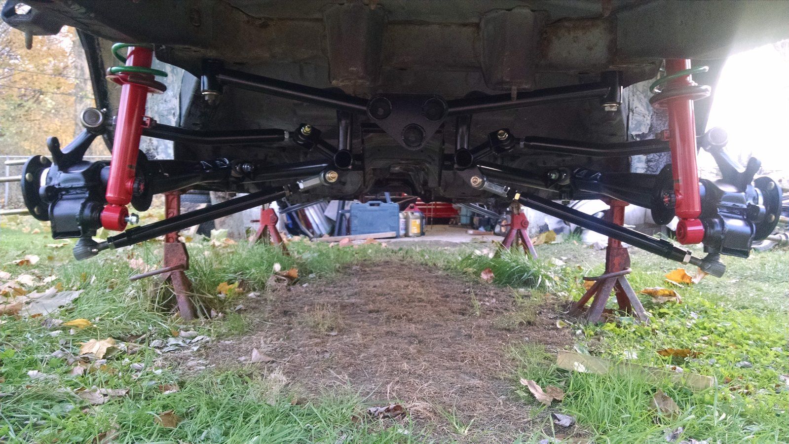

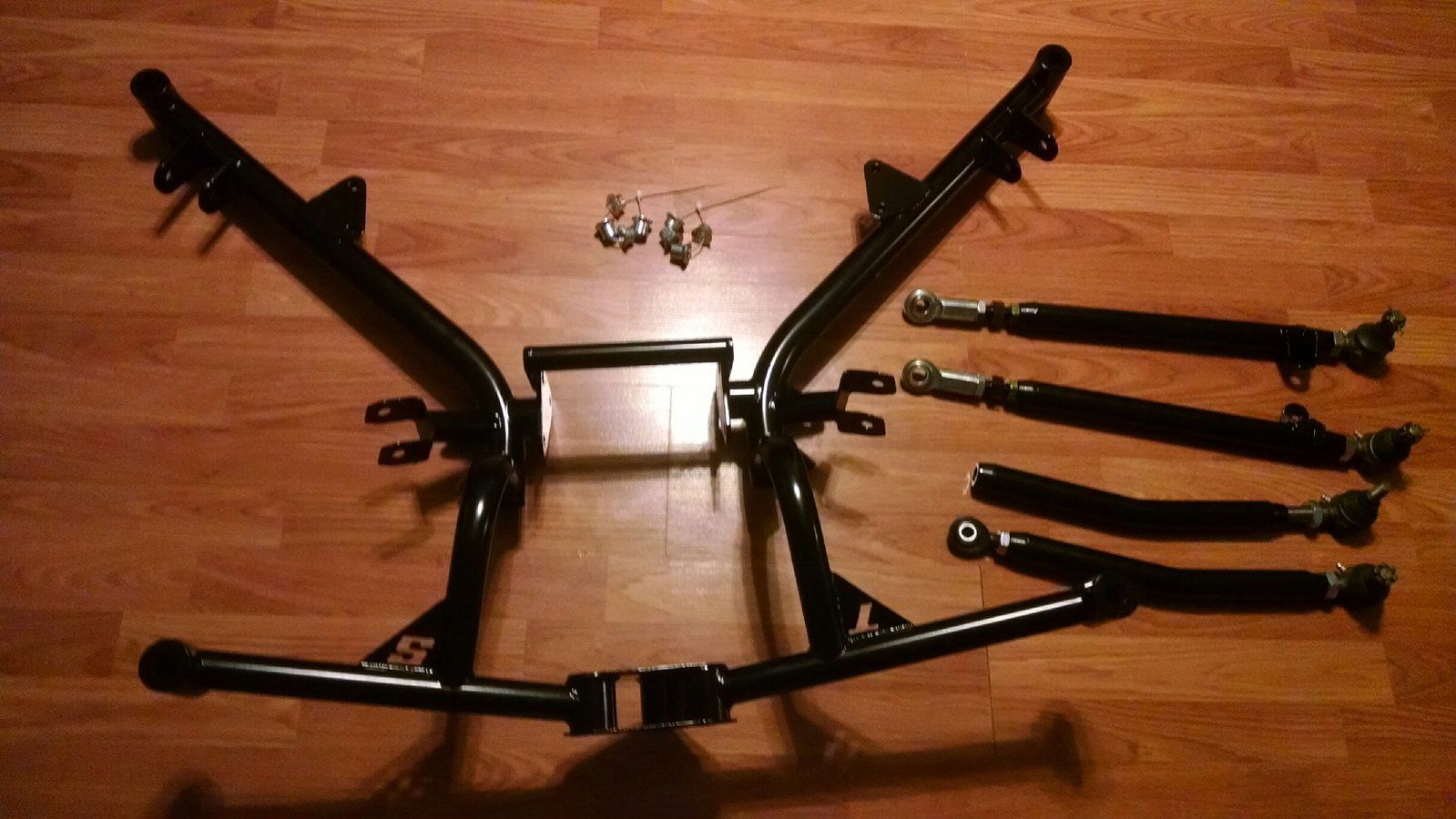

Haven't got much done recently been cold and the car was outside on jackstands. Took advantage of the 60* weather here after work and got the car back on 4 wheels again. First time in 7 months. Didn't get any pics of the car on the ground because it got dark on me. Here is a pic of the rear subframe and tubular control arms.

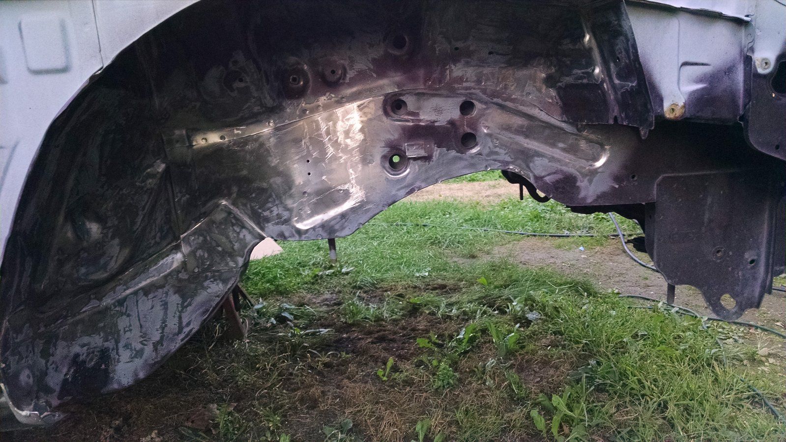

It was 90* in Columbus, OH on Saturday, but that didn't stop me from stripping more undercoating/seam sealer off the car. I finished both driver side wheel wells.
