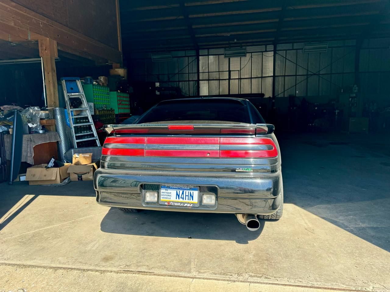

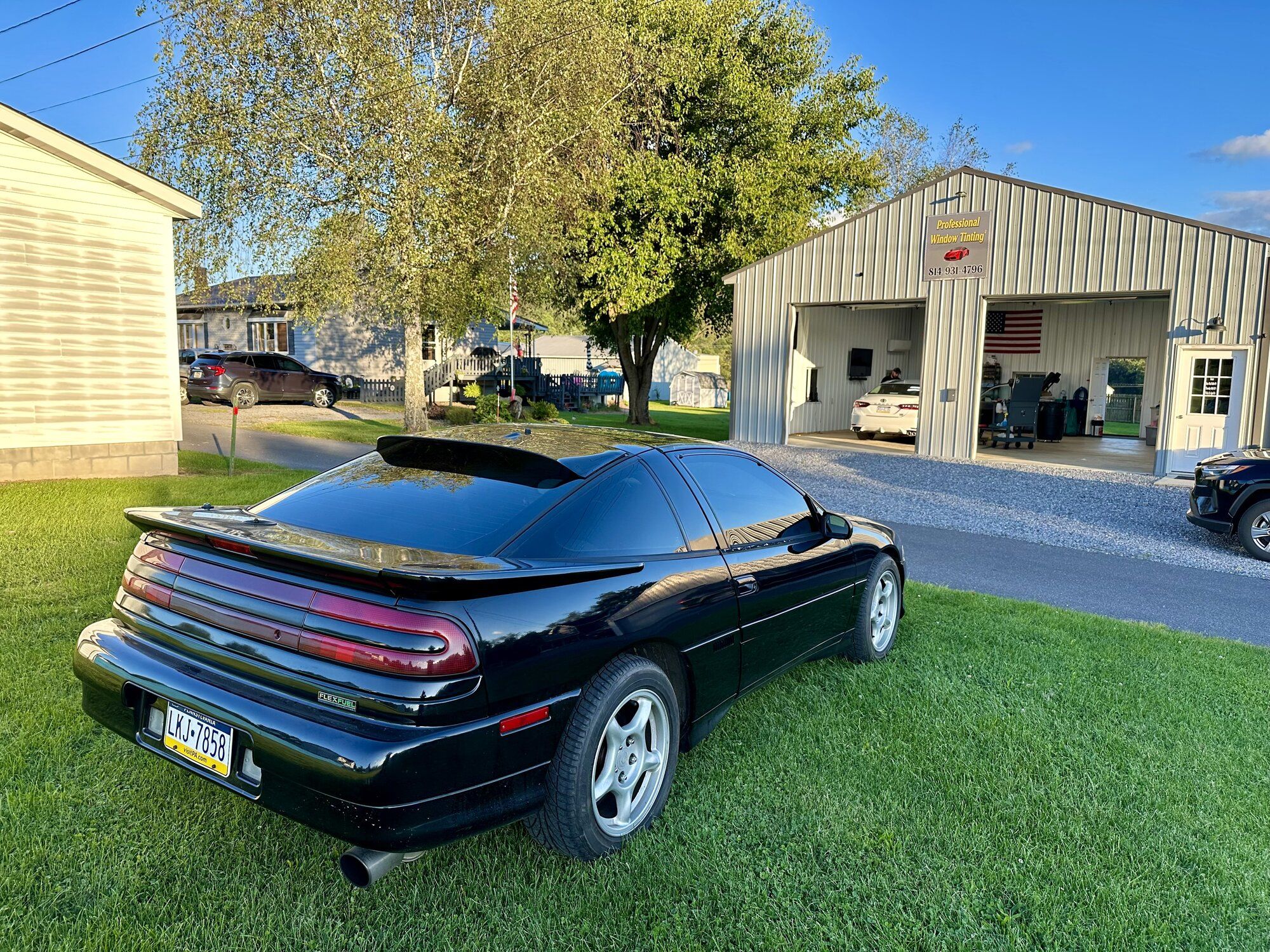

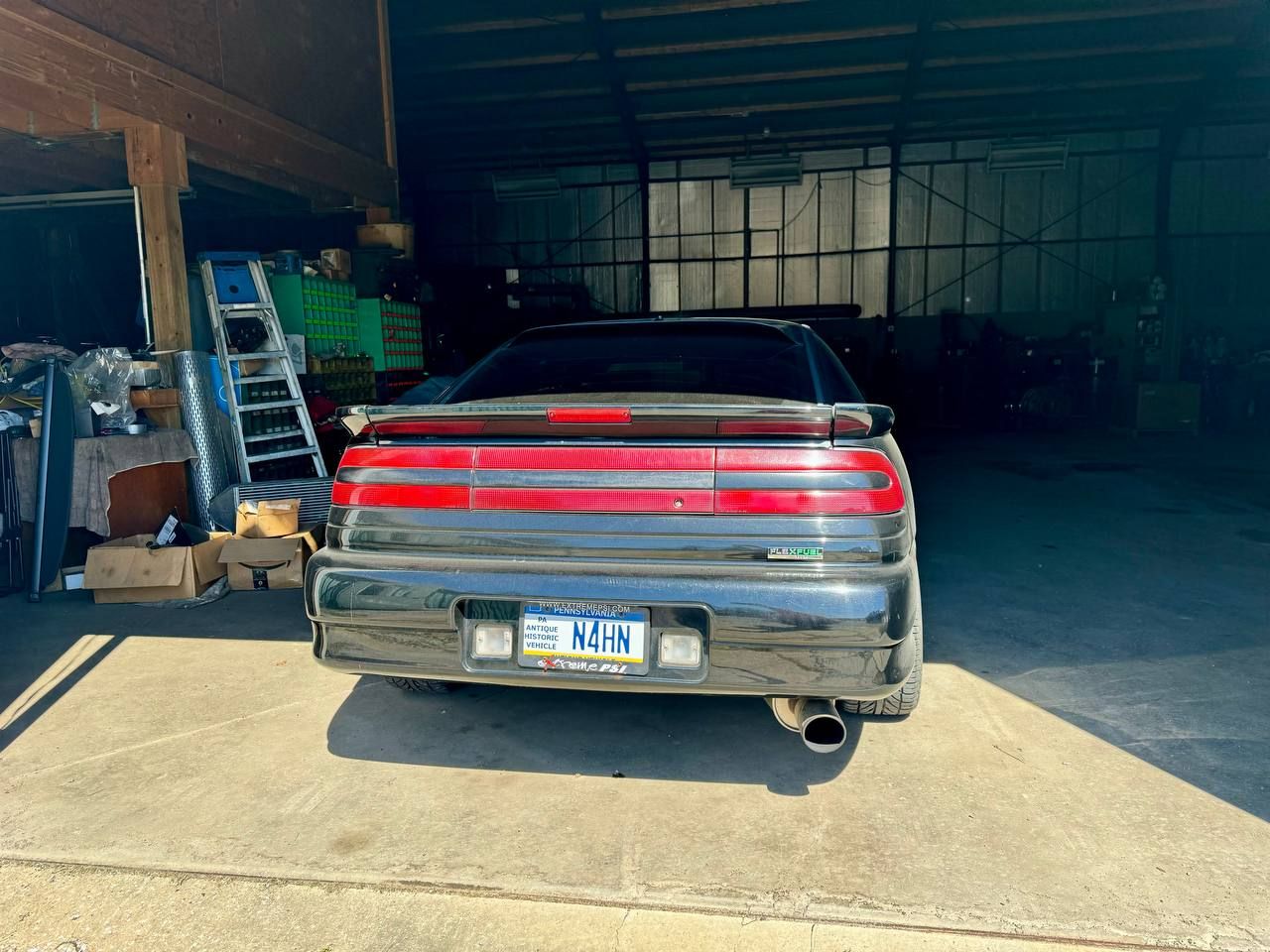

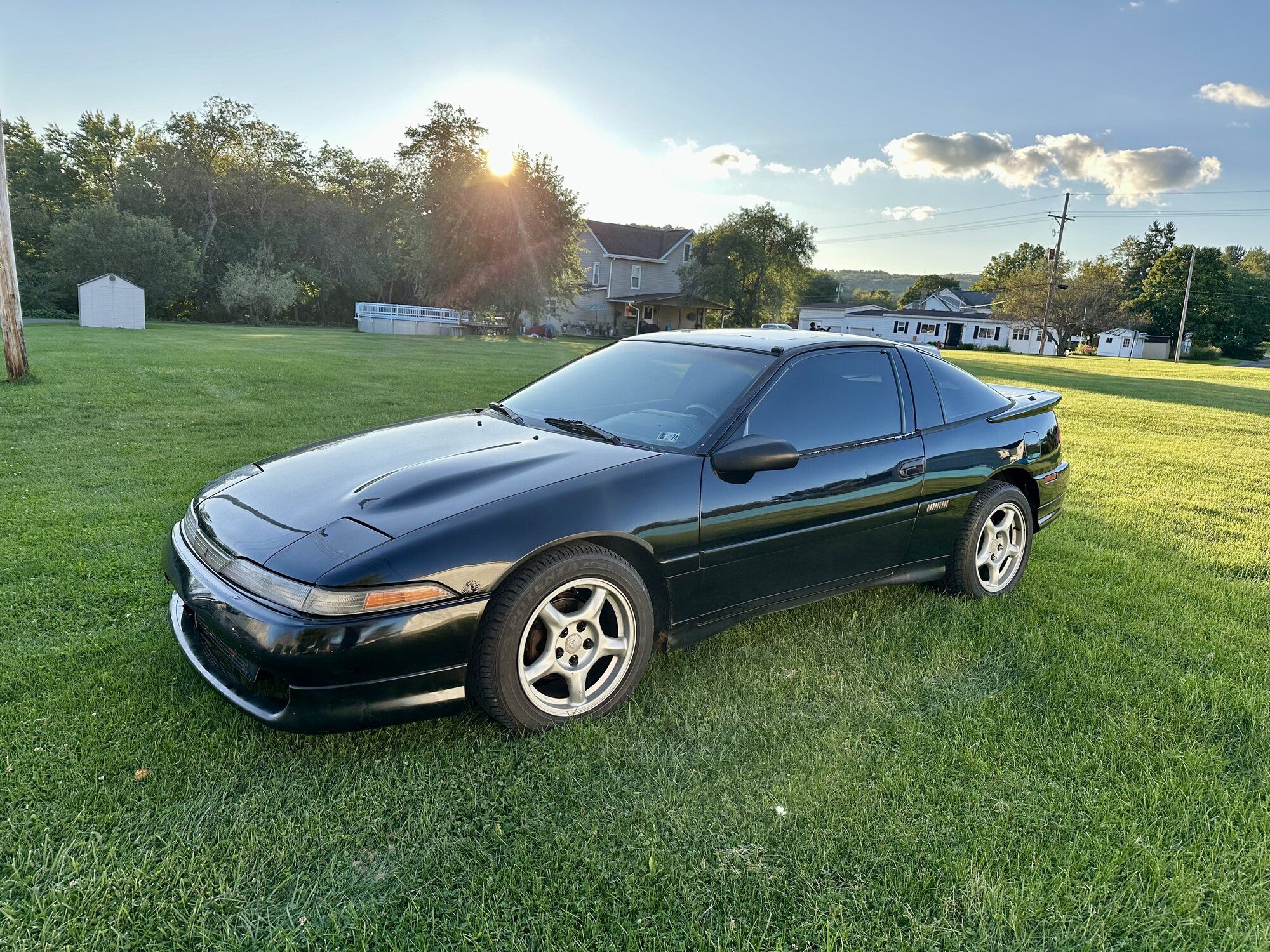

My center section, between the two tail lights, says Mitsubishi on my 1990 GSX but not on my Laser or Talon (but the Talon has a Talon logo). It that the original part or did it need replaced at some point? Not nit picking, more ADMIRING how good the car looks. I also run the "Flex Fuel" badges on my cars, LOL.

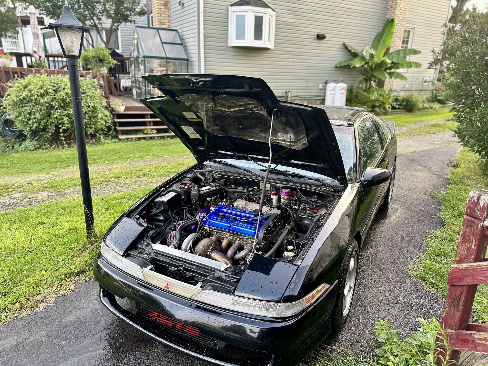

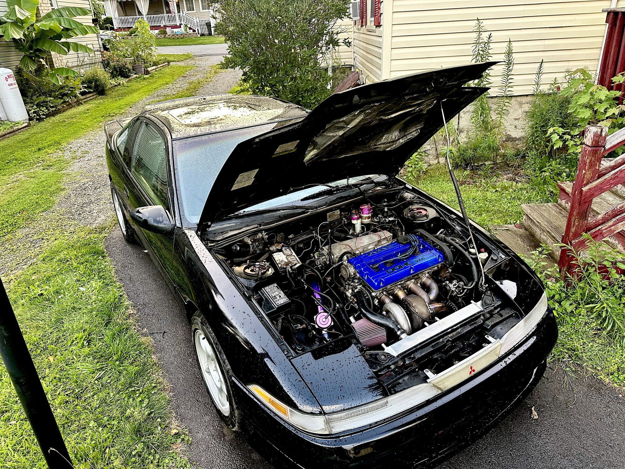

Now for the fun things, TUNING PULLS. Spent the day with my buddy doing pulls and getting timing and fuel trims pretty happy. All thus far the car has only been plumbed from the turbo to the external gate because brand new motor things. 18.5lb spring, 8000rpm redline in these recordings
If it was ever replaced, it wasn't me. I have seen other mitsu cars listed with the blank section so i can't say for sure

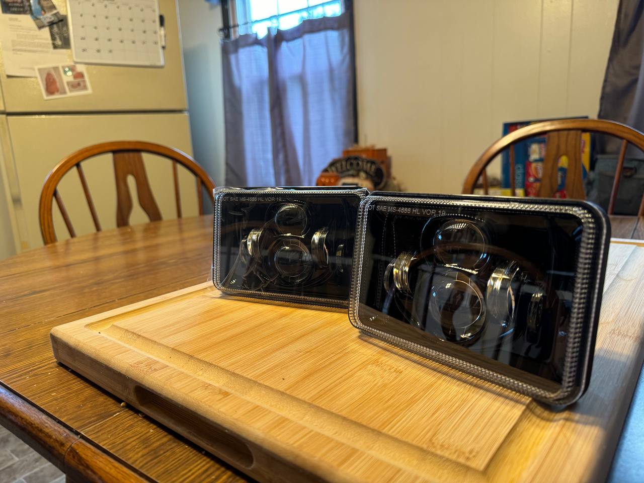

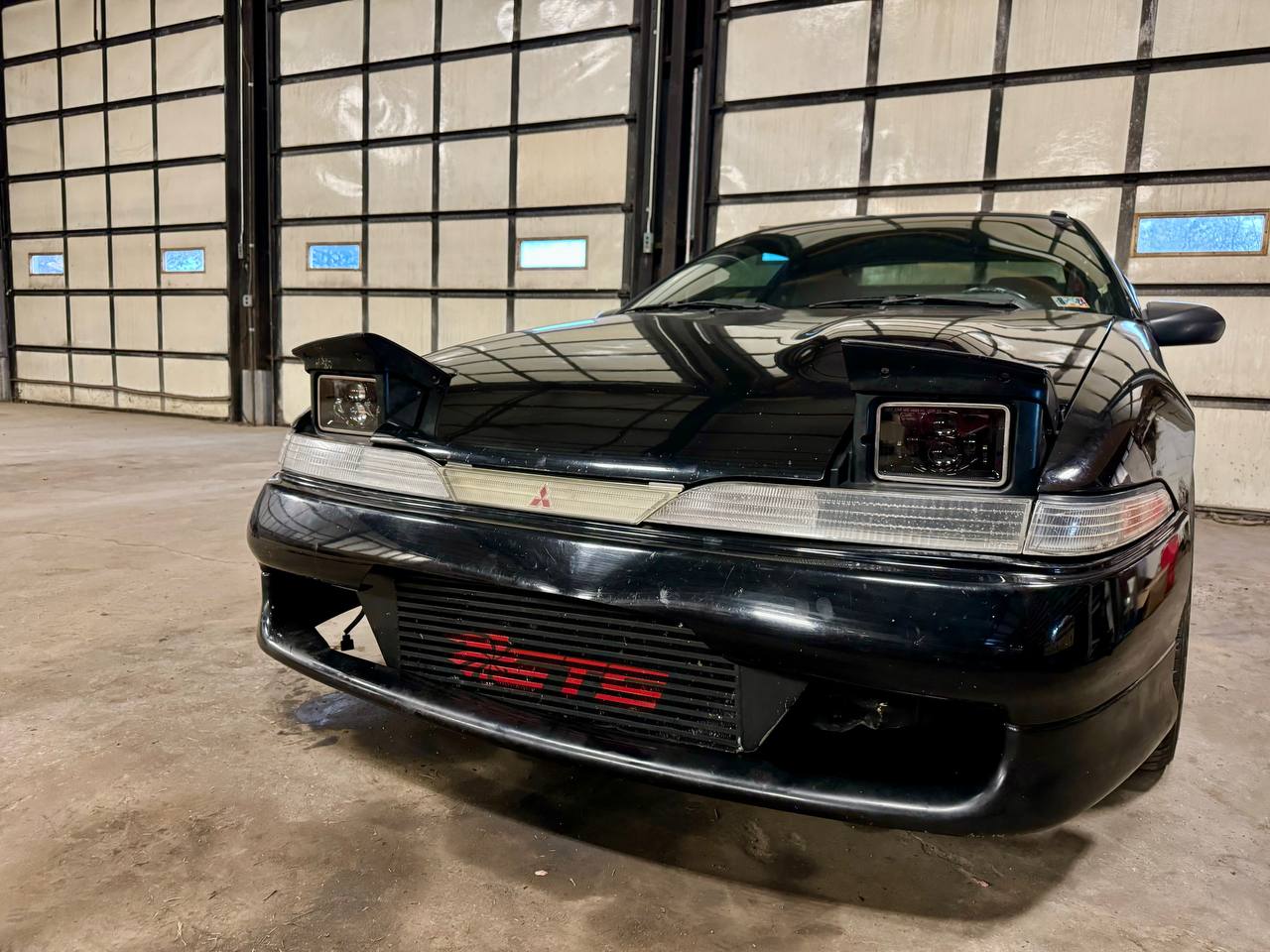

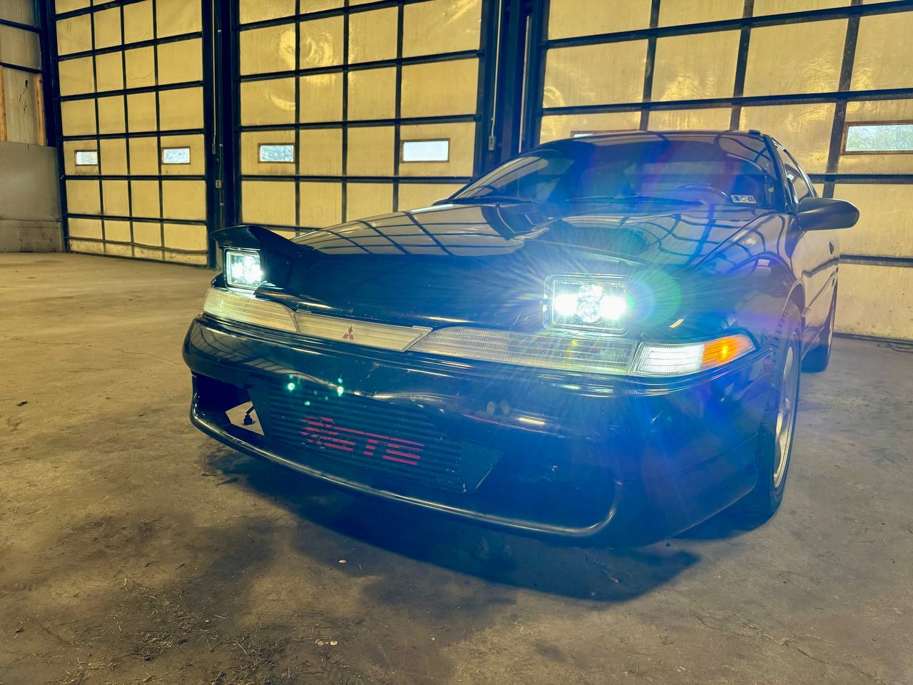

I picked up some sealed led lights off amazon for around $70-80 iirc they seem to be pretty bright. the only issue i ran in to was these cars use a common power for the headlights and switch the high and low beam off that so i left it with just high beams only because i try hard not to drive this at night. i've seen some things online that i can change this but i haven't monkey'd with it yet

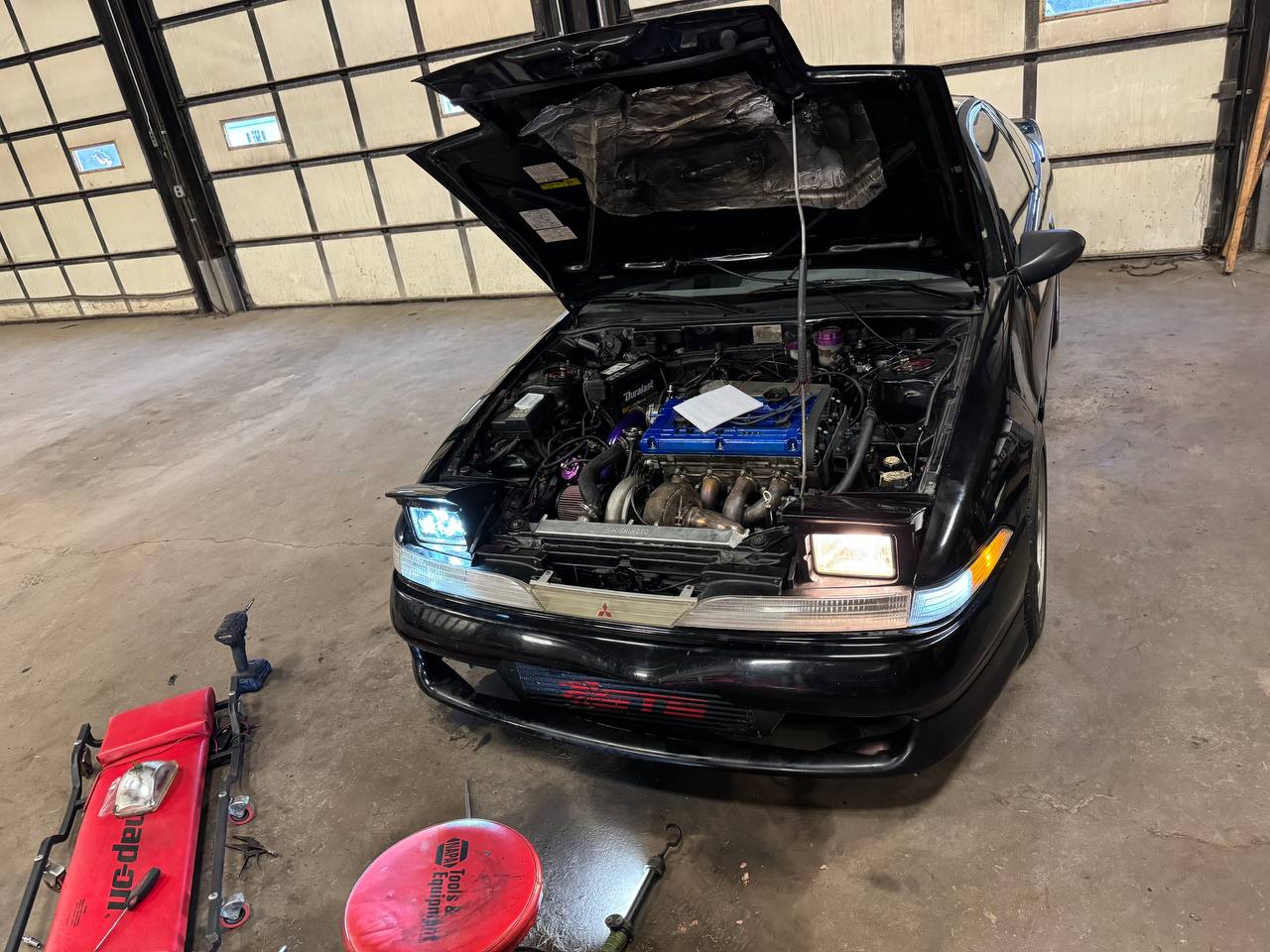

last outing of 23 was to cars and coffee sometime mid-late october. had happened to me at least one other time that the car will vibrate a bellhousing bolt loose and i never caught it quick enough and one of the bolts fell out. limped the car home and put it away not to be touched for the rest of the year
now we're here in 2024, i did at some point go and blue loctite my bellhousing bolts and replace the one that got lost. car had been sitting for a few month with e in the tank and it wasn't super happy about waking up but didn't fight too hard. this video was taken here at the beginning of march. plans before the season start include redoing my charge piping, doing some wiring cleanup, a good polish on the paint, thinking about swapping from the buschur muffler to a vibrant that i have sitting around, and some other odds and ends. then it's time to work on turning the car up. goal is 600hp, should roughly be somewhere over 400 at this point after playing with the rx8 and that same friend has a 400hp supercharged H6 swapped legacy that dyno'd at 400 and i seem to pull from it
