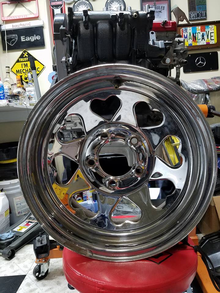

Got some rare wheels for my LUV. Keep it chrome or poweder coat it?
Let me know
5 lug? Has a swap been done? Maybe I missed it in your build thread. Those are rare though. I think it would look good powder coated black/gun metal with the hearts and lip being outlined with what ever the color of the luv is gonna be!
Deep purple wheels/black heart outlines. Keep truck black with purple pinstripes.
Actually if you're keeping the bumpers and whatnot chrome then keep the wheels chrome as well. With silver sparkle black paint.
Or convert all chrome to black chrome. PITA but looks badass.

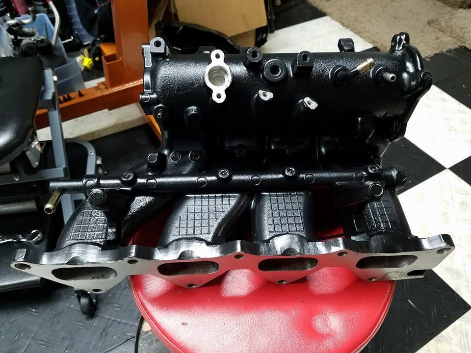

Small update. Picked up an evo 8 intake manifold and sent it to Bill's auto fab to get injector holes welded. I cut part of the egr hole and evo fuel rail standoffs and then painted with high temp black. Looking good on this 2G head.

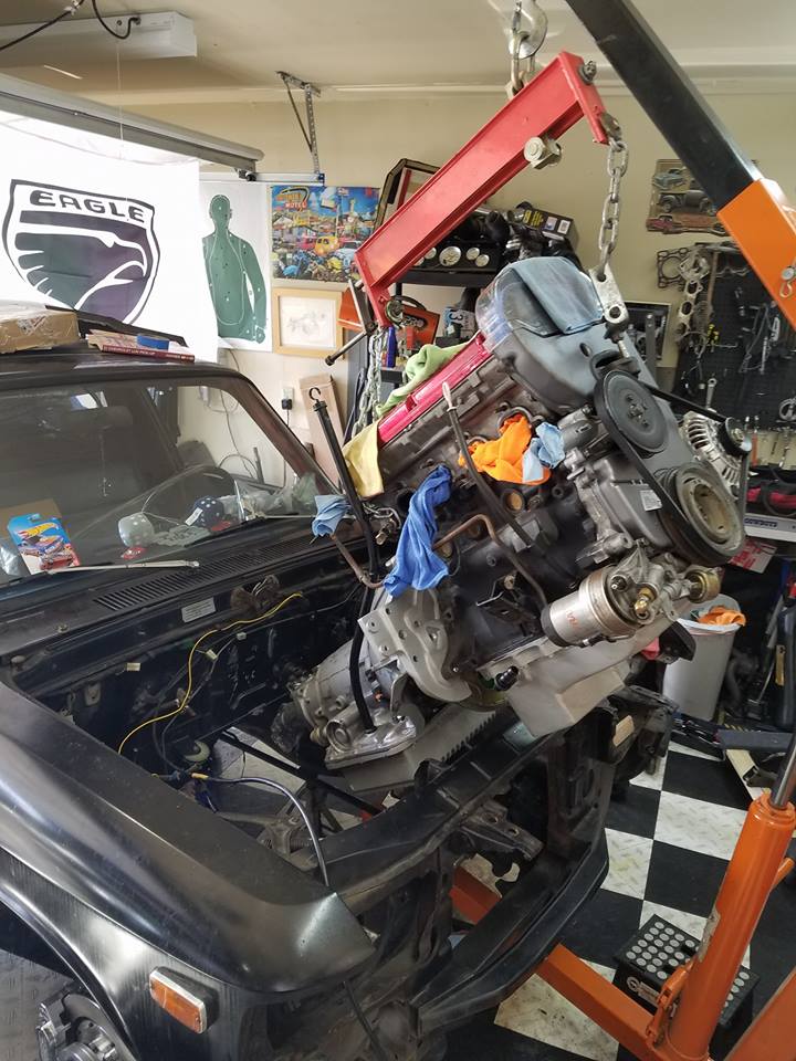

Almost getting ready to join these two together to be able to mock up some motor mounts. Bumper and headlights n grill are off. Project CHEVISH update!
Well here are some engine shots of me test fitting the motor mounts. Looks right at home and the trans tunnel has lots of room. Adapter installed provided by Bill's fab shop to mount my TH350 to my 4G63T. Next attaching the adapter, flex plate, starter. I'm in the middle of adding new suspension oem parts.

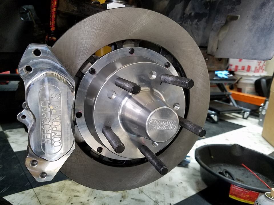

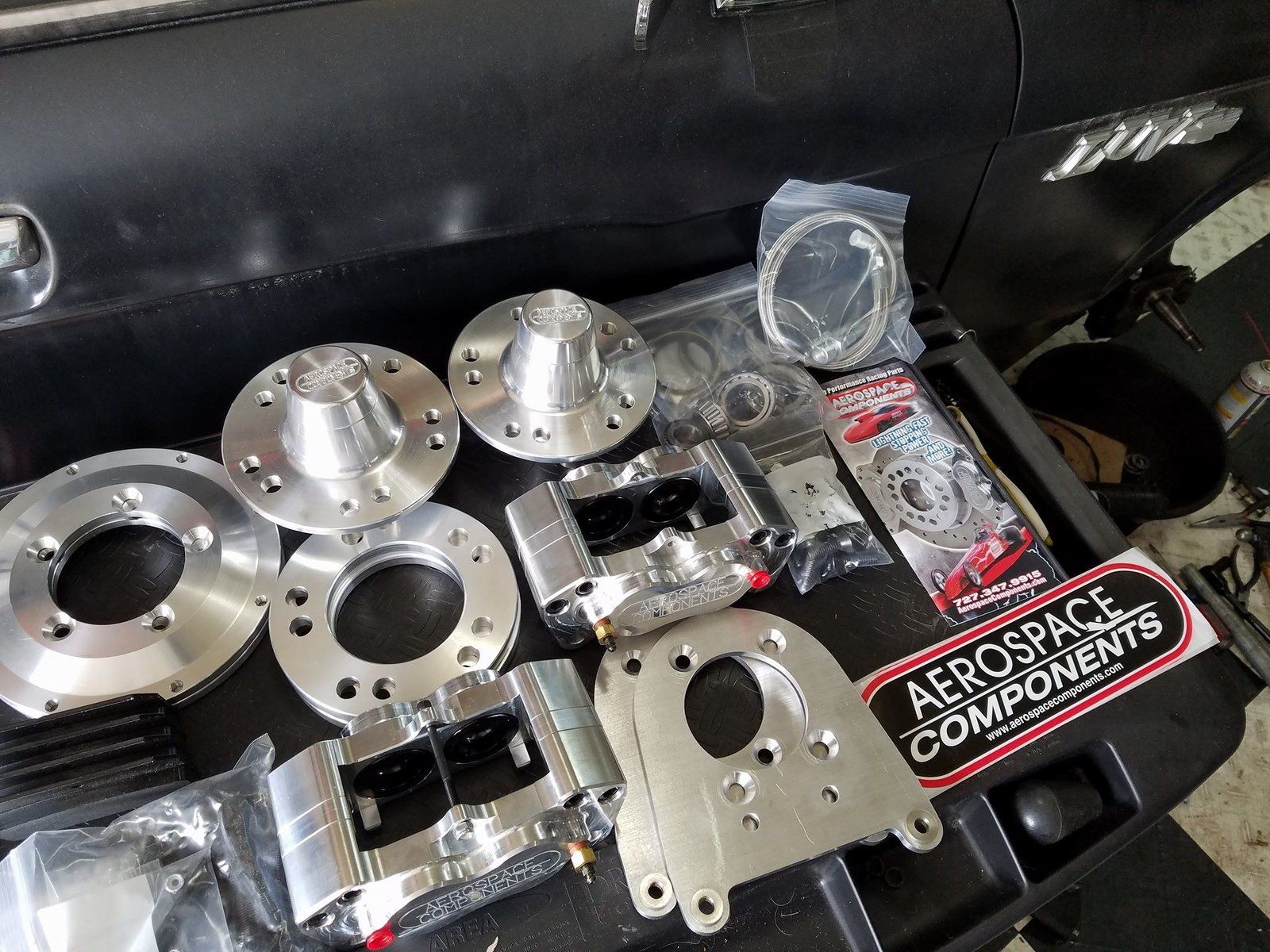

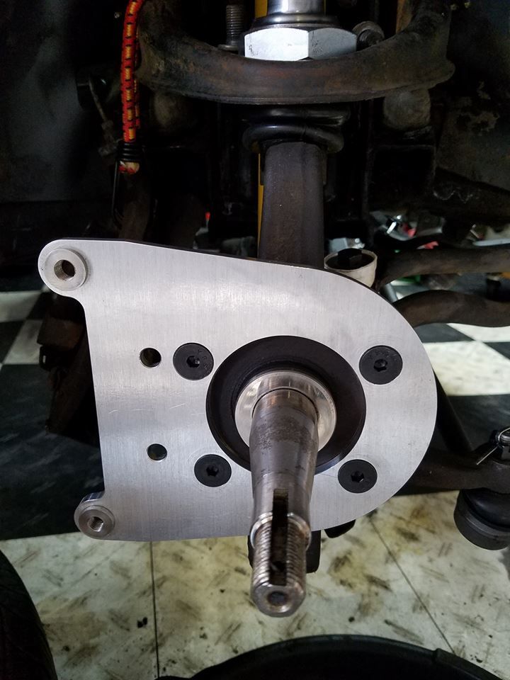

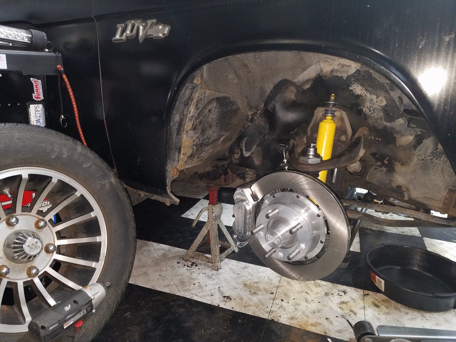

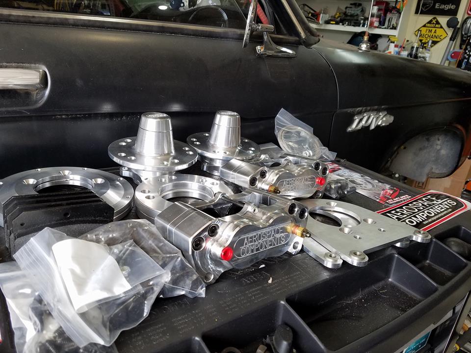

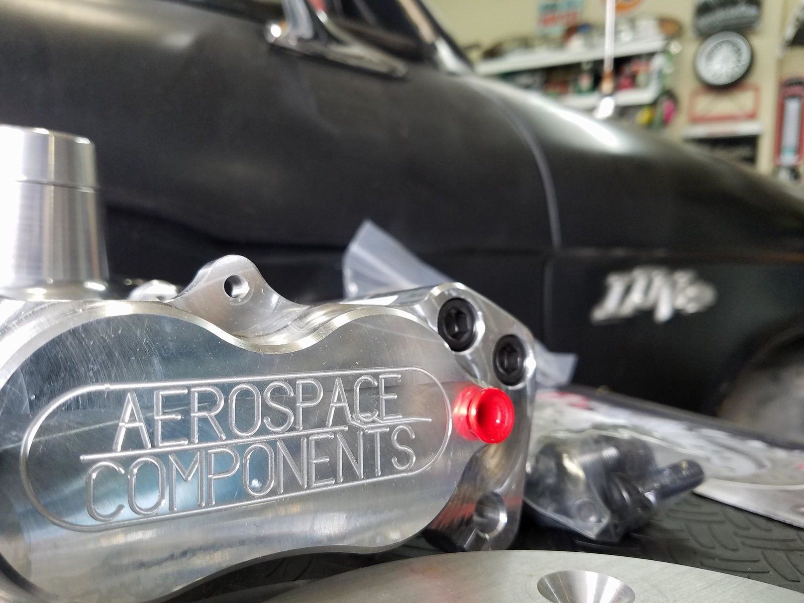

Thanks to Aerospace Components Inc. For their awesome street brake kit. They look fantastic and great quality, can't wait to install them on the LUV. I highly recommend them
These brakes are sweet! Can't wait to "brake" these in. Thanks to Aerospace Components Inc. For the awesome brake kit and awesome customer support! LUVLEE is coming together slowly but surely.

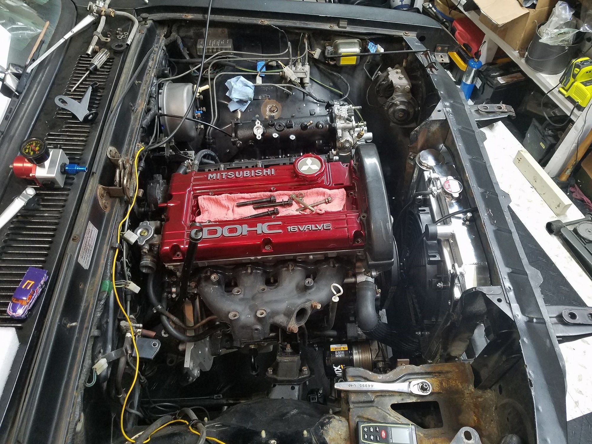

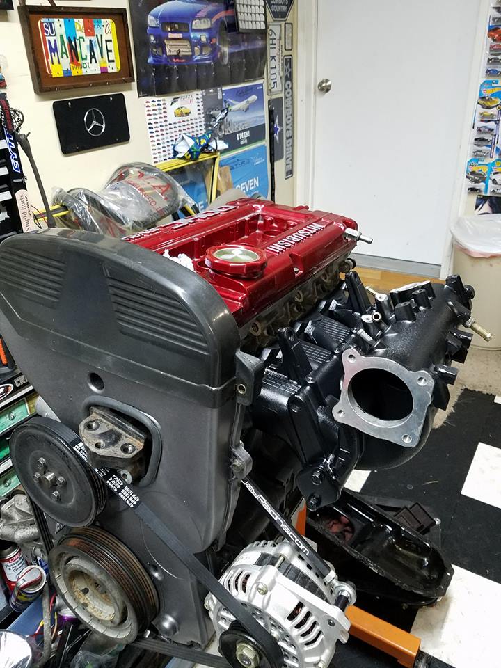

Well the engine fits with the trans. Just need to add the trans bracket, then I can start peicing the coolant system. LUVLEE is coming together more n more.

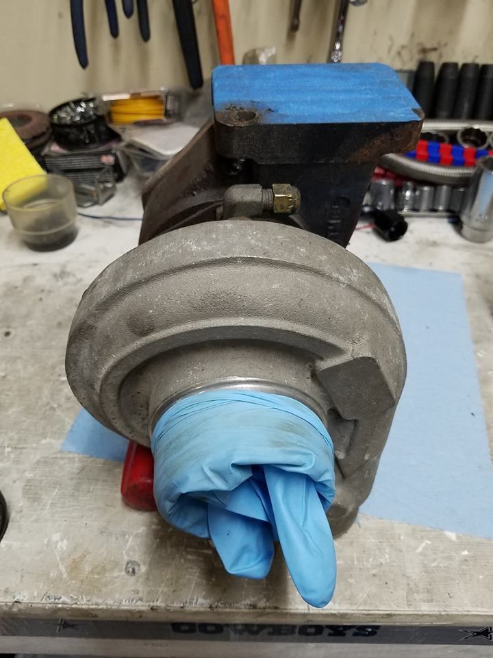

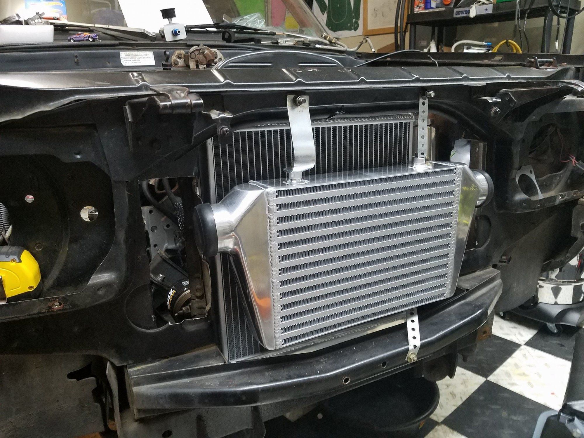

Long over due update. Got a Honda radiator with fan and shroud installed. Also a small intercooler for the tiny horsepower 350hp installed. Intake manifold installed. Missing brake master cylinder until I get it bench bled. Working on centering trans mount, thanks Derrick for welding an extension. And working on clocking the turbo to make it work. Thanks @JusMX141 fixed my stripped bolt holes. More to come!

That upper radiator hose looks like it's gonna be a pita to route.
Looks really good though, can't wait to see more updates!
I got a plan for that. Once I get the turbo in and temp gauge routed
