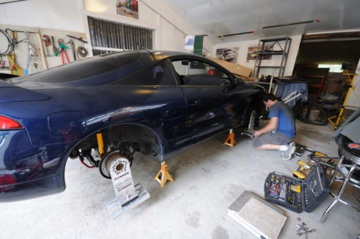

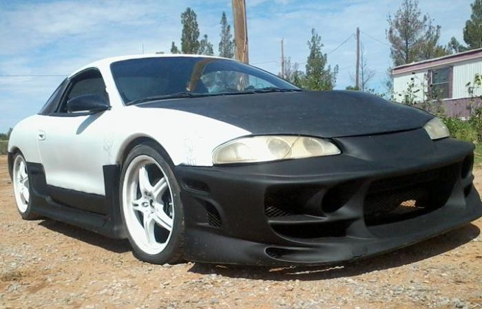

I was thinking about this after posting last night, as long as the rear wheel center was after the motor then you would probably be just fine. The handling still wouldn't be as good as it could be but if you ran e85 and had an efficient tune then you could have 400hp in a 1500lb car. Dangerous... yes, crazy... yes, badass cool... HELL YES!
