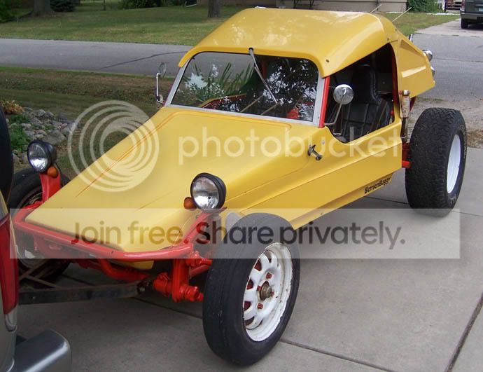

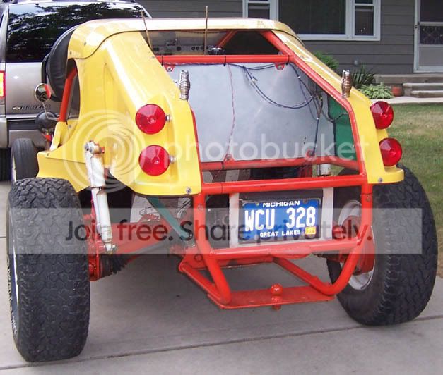

How she looked when i got her -
Front:
rear:

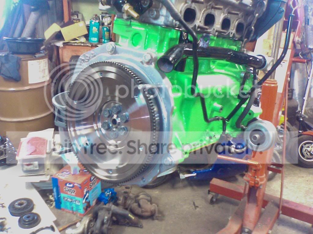

Adapter Plate/flywheel:

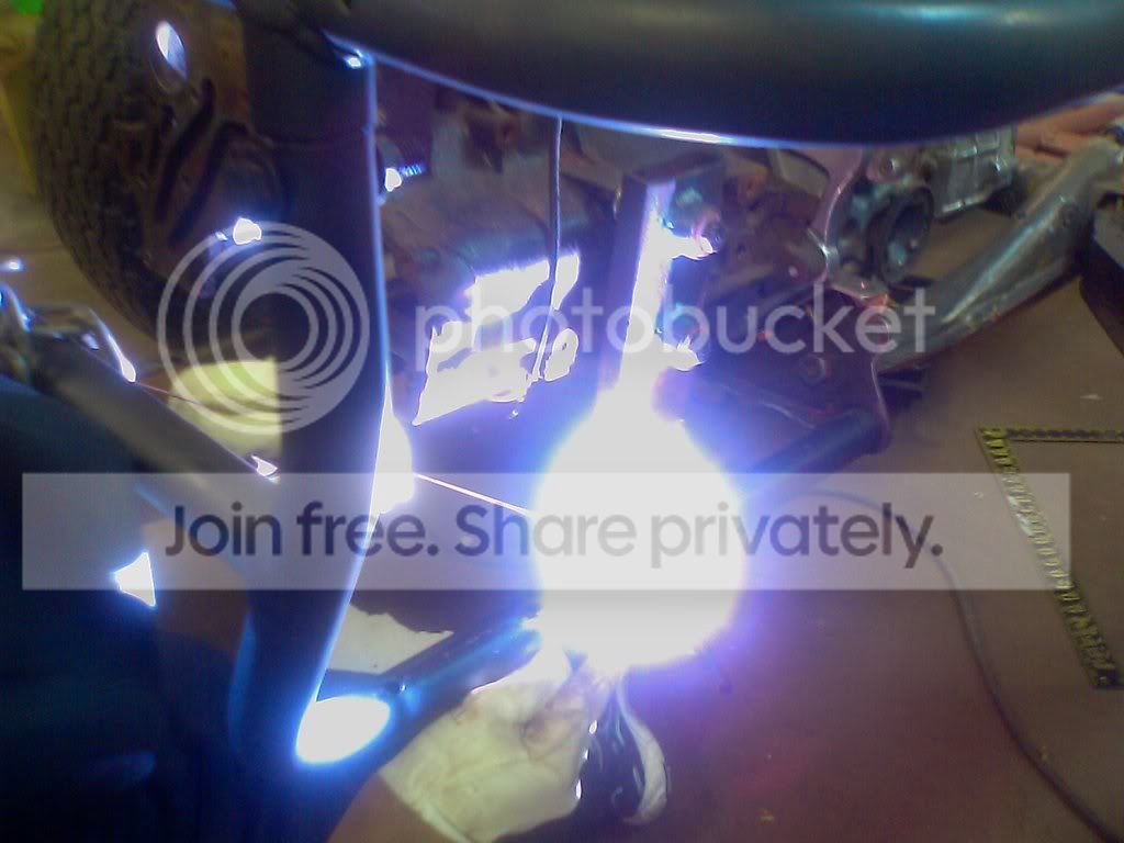

a Friend (eric) TIG welded the motor Mounts:

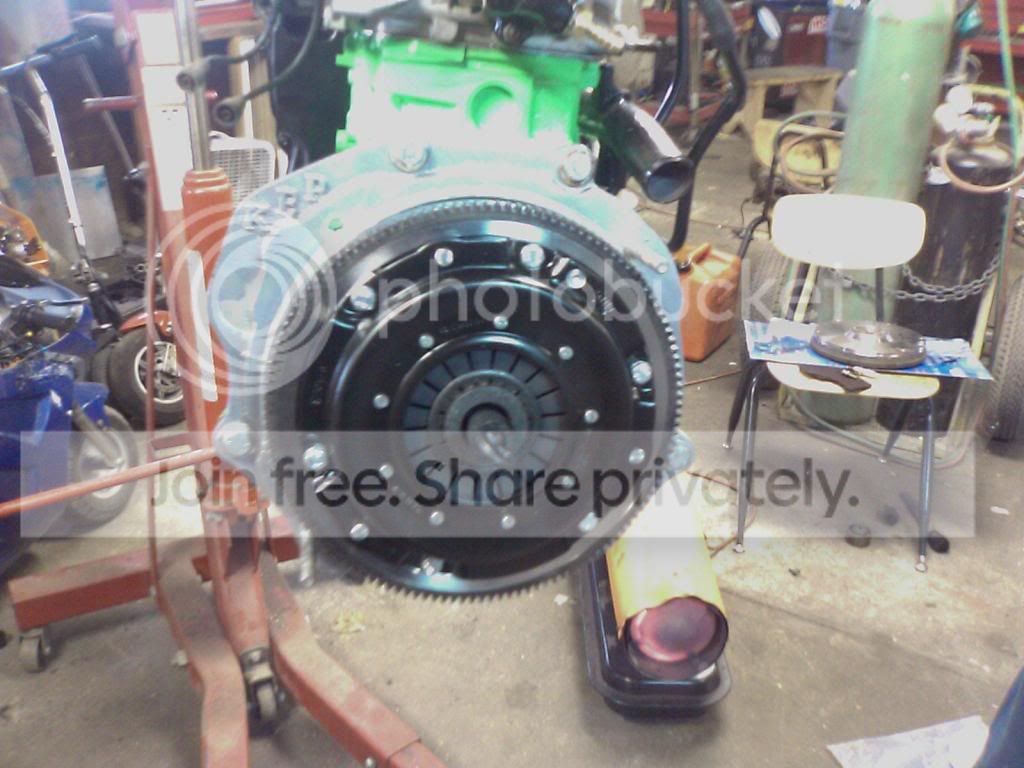

Clutch:

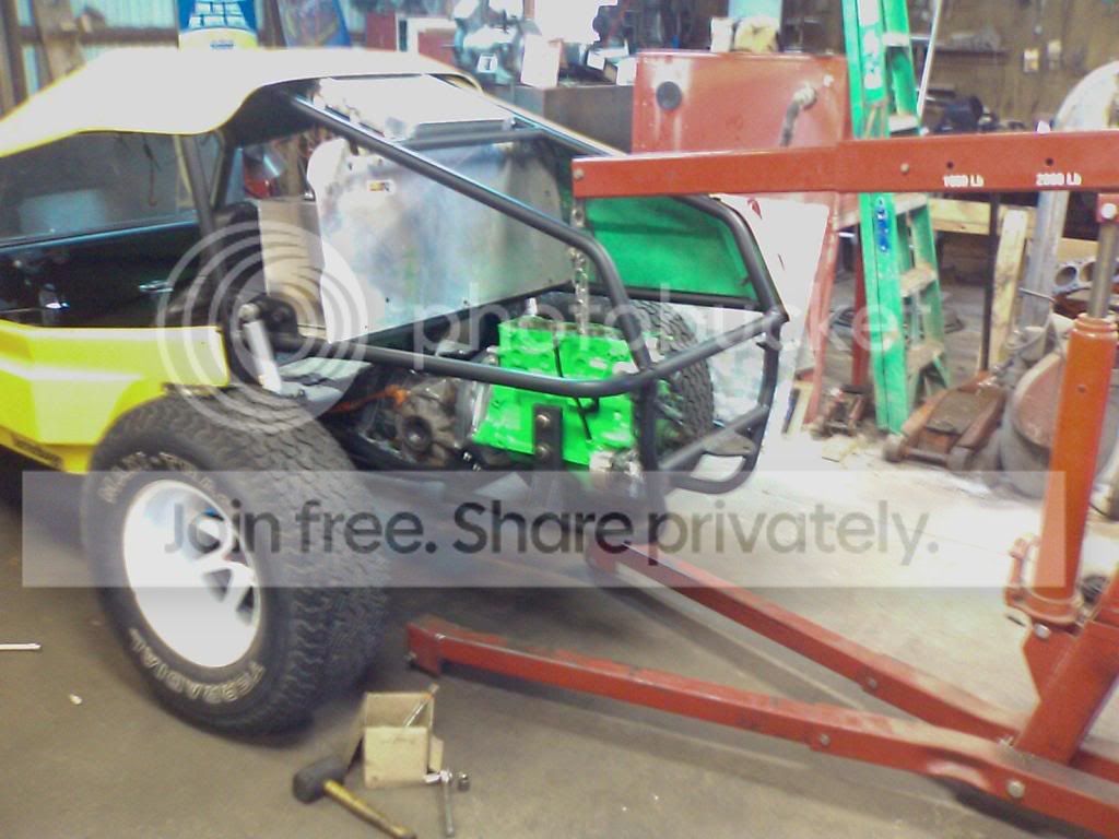

Motor:

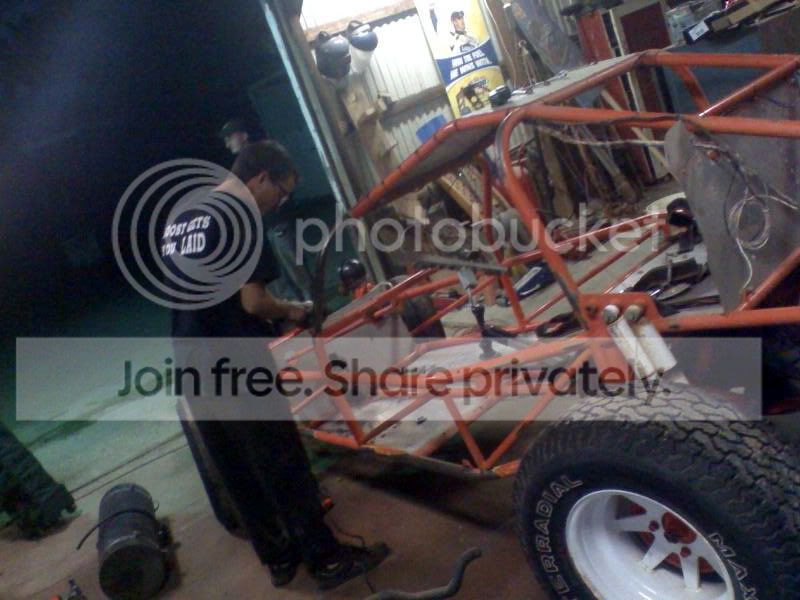

This was the VERY start of me stripping the Frame
