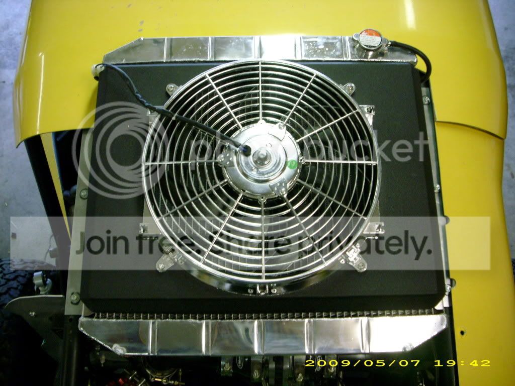

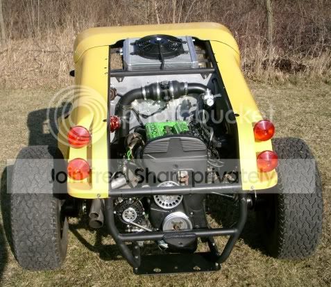

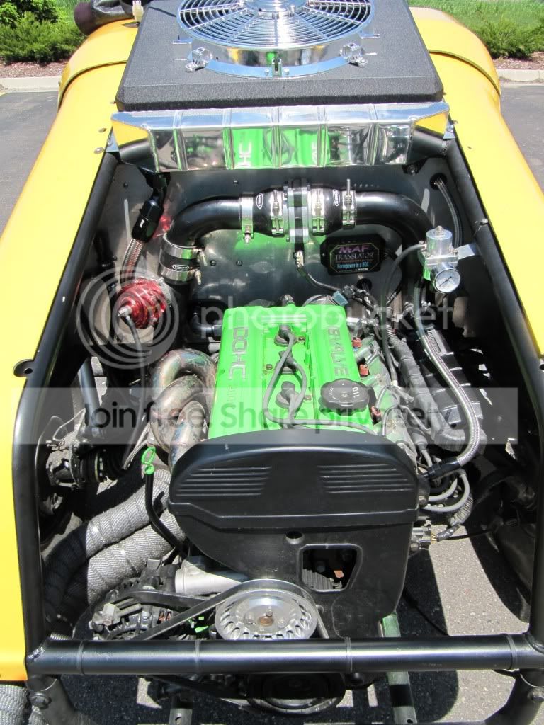

The old radiator/fan set up didnt come close to cooling the motor. Here is the new Setup.
Notice the HDR Couplers are gone :) Coolant lines are now -16AN .
The radiator was custom made with a wrinkle powder coated shroud. The fan is 16" and around 2600 cfm.
