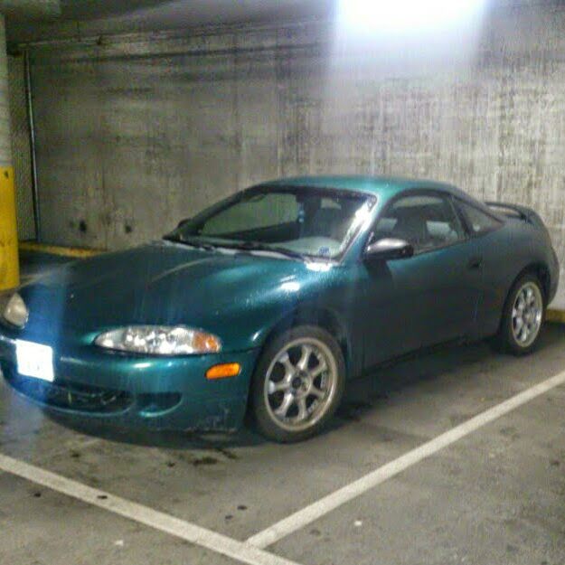

420A Track Worthy Street Build (1996 Mitsubishi Eclipse RS)
Doing it all myself. Trial by fire; will I rise to the challenge, or hit a wall on the first turn?
