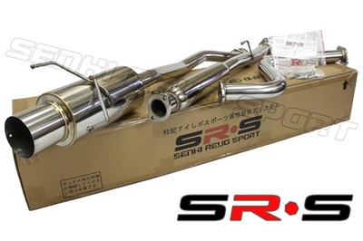

SR*S is a good cheap brand. Their rs gs exhaust is only like 379, they sound good, and are quality stainless.
Edit: Added link
