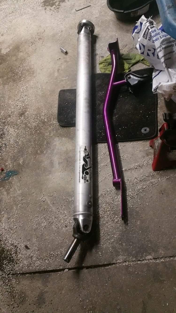

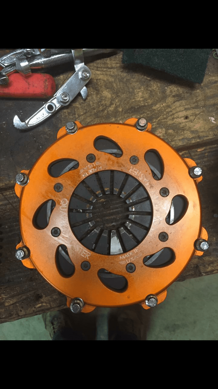

Scored a sweet deal on a barely used Quarter Master 8 leg twin disk clutch.
Also scored this bullfab cross member and DSS driveshaft(Obviously this purple will be going..red is more my flavor)

A good friend of mine parted his car out and between me and my other buddy we tried to get as much as we could off it to keep his parts in the friend group haha. That's where my carbon hood and hatch, DSS driveshaft, Bullfab cross member and steering wheel is from. My buddy got the built 6 bolt and Clutch Masters twin disk from him also. His 2g lives on with us now haha thanks Sam!

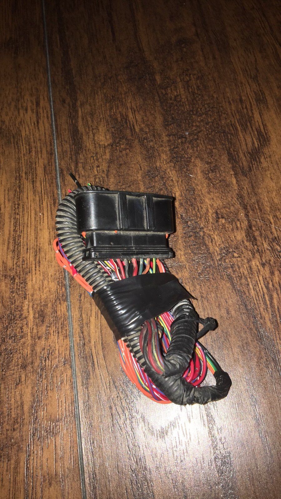

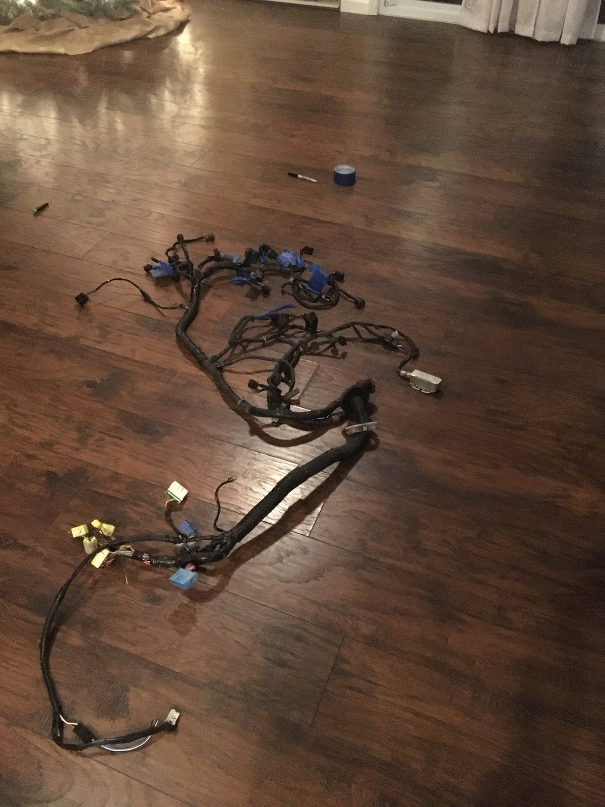

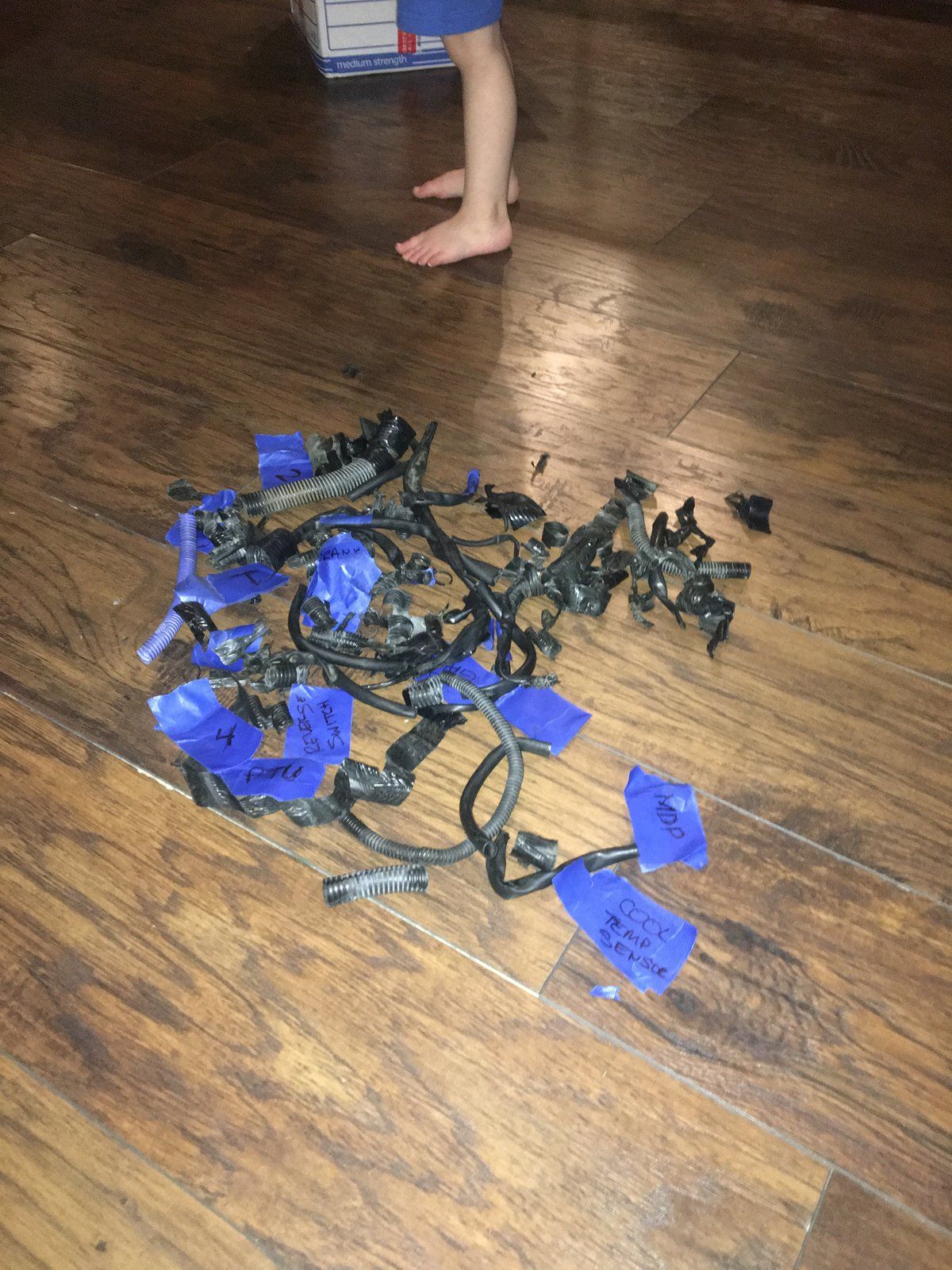

Started to tackle the new harness last night. Always fun spending hours peeling off 20+ year old electrical tape! I managed to get the majority of the harness labeled and clean of old tape and wire loom. Once it is fully cleaned up I will be removing all of the unused connectors and depinning them at the ECU.
Here is what I have removed so far, YUCK!

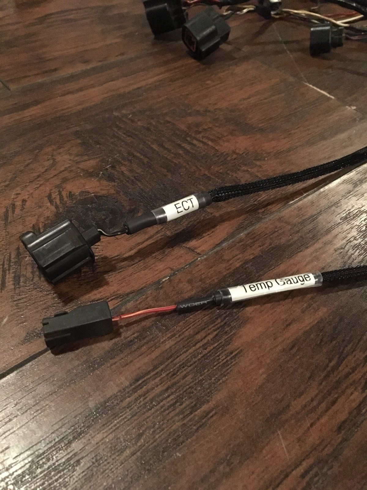

From here I will be depinning each connector, sliding some heat shrink on, labeling and clear heat shrink over each end with the nylon braided wire loom. I actually enjoy doing this stuff!
Did some more work on the harness last night, got two connectors depinned, labeled and repinned. The temp gauge sensor needs a new connector that's why there is so much extra wire.
Just did these two labels. Back to pulling wires through the rats nest back to the ECU connectors and depinning.. 1 done-500 more to go!

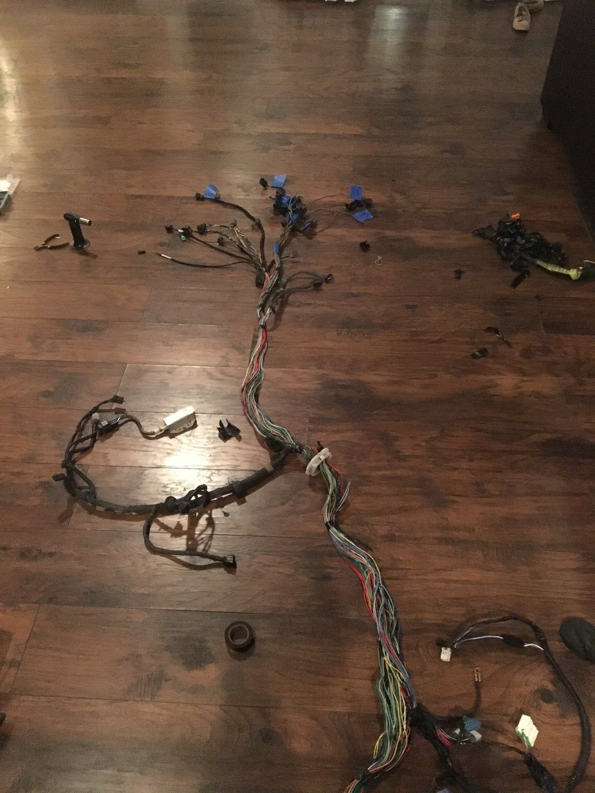

95% of the harness is cleaned up of old nasty tape and wire loom
