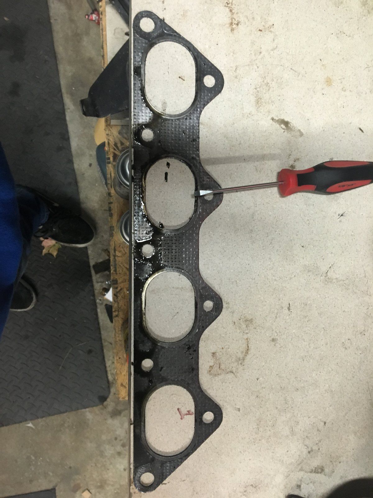

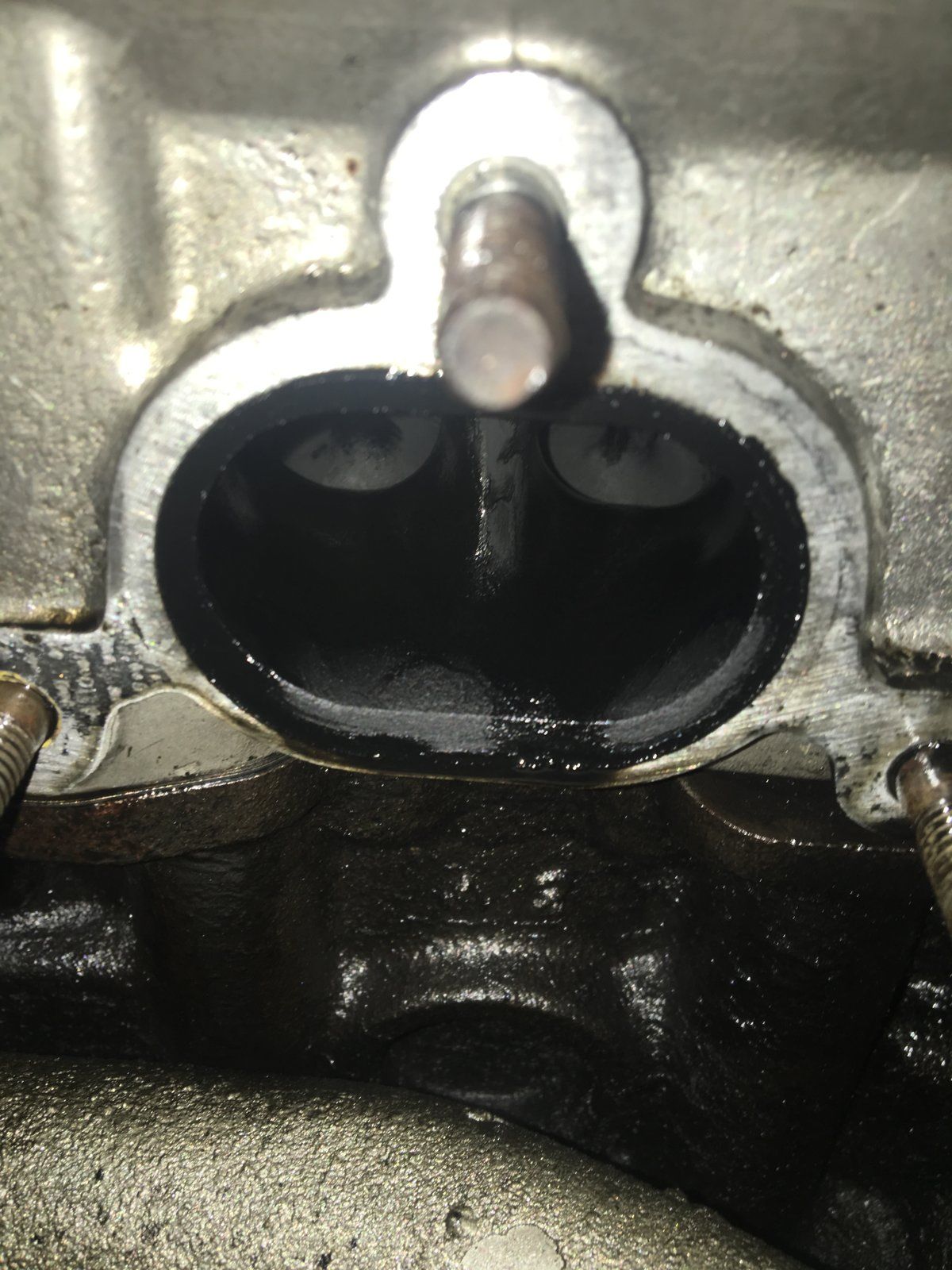

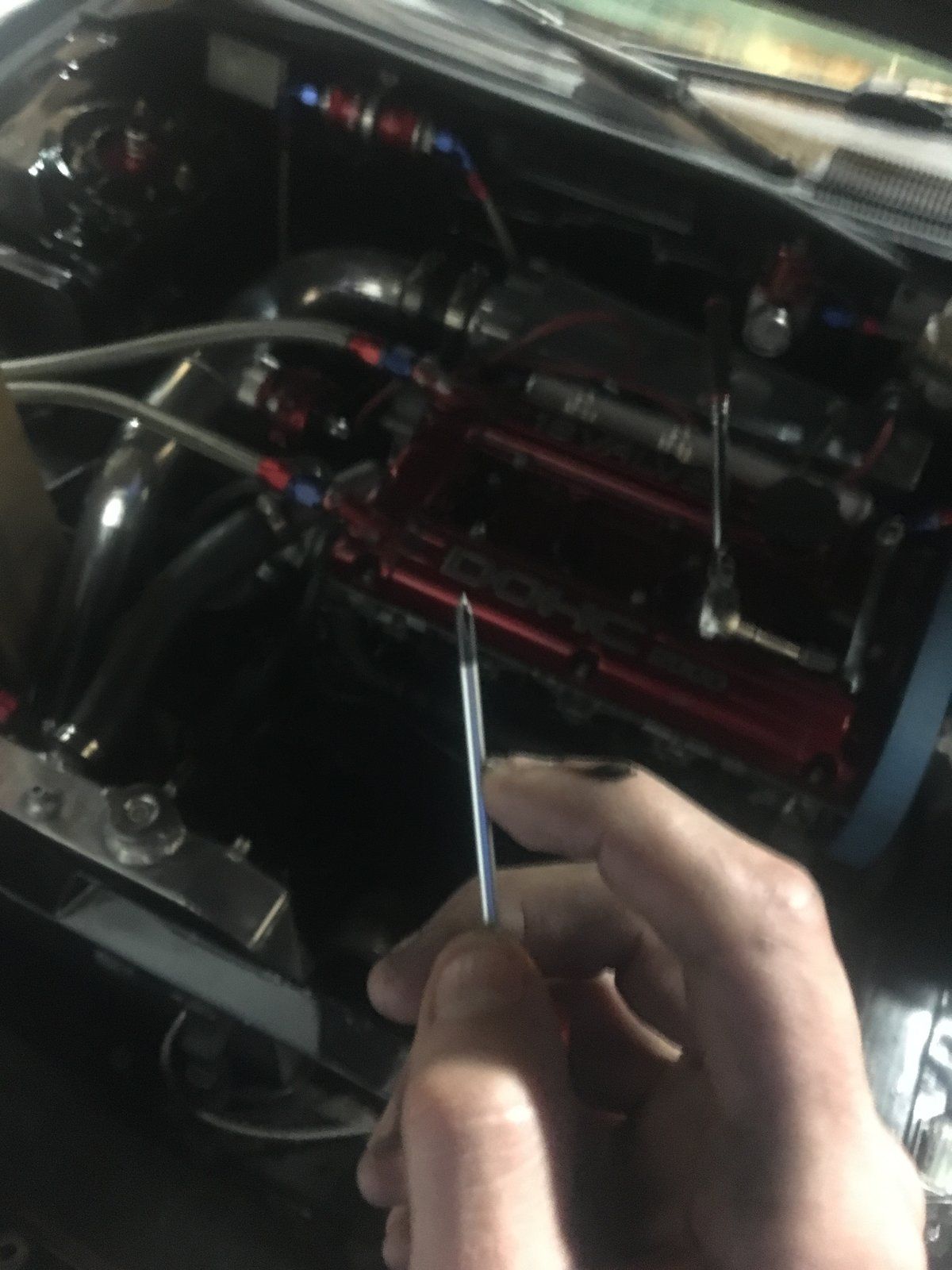

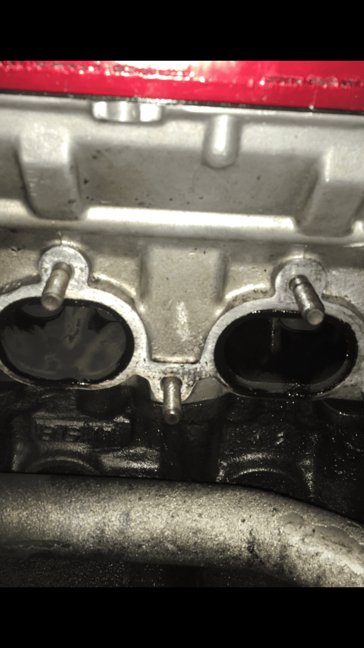

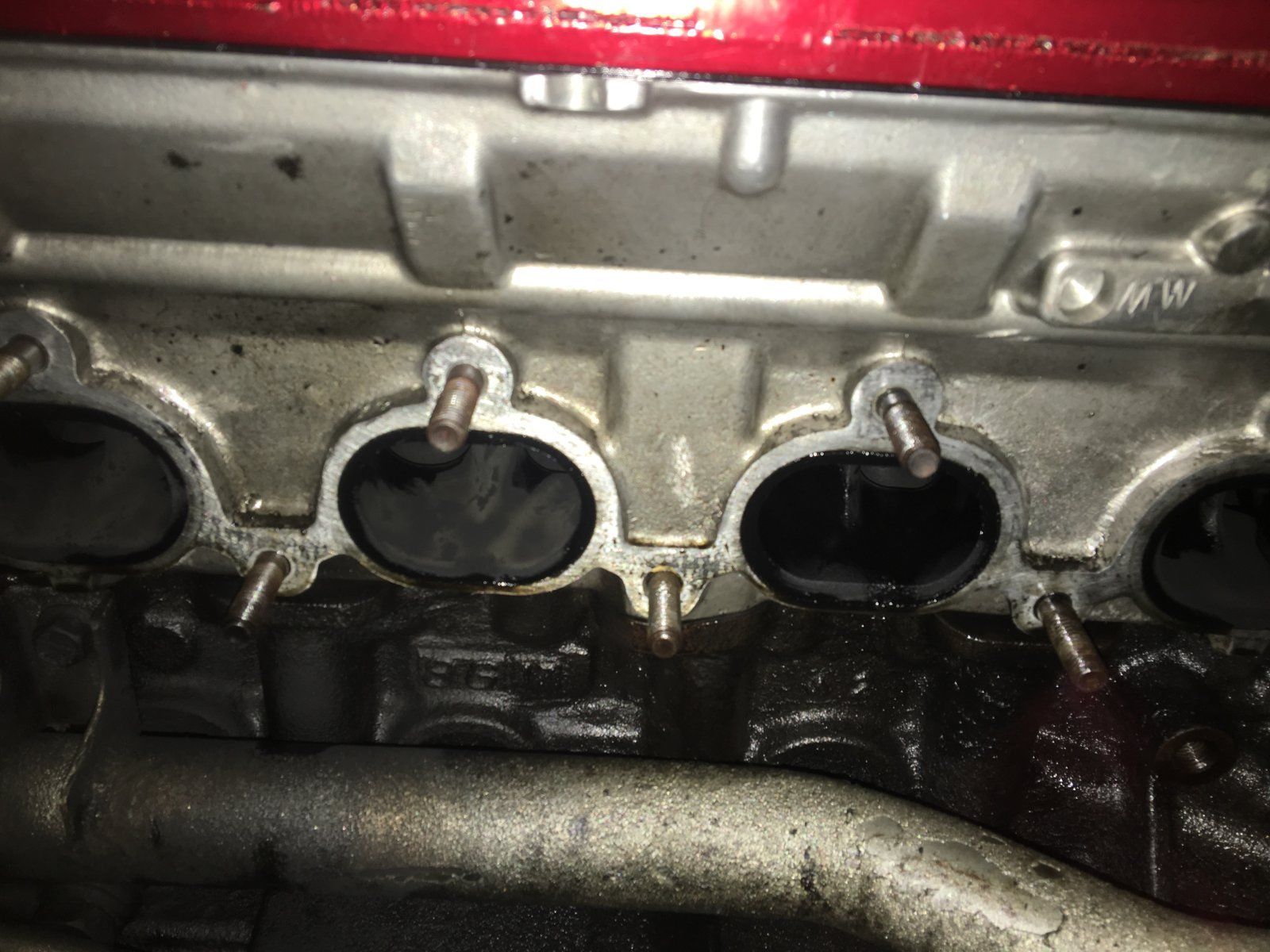

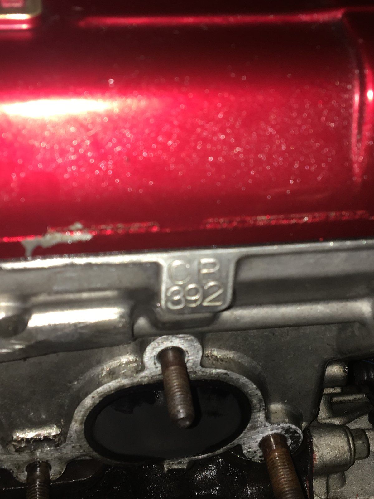

So last night I decided to work on my car again to figure out why it is smoking so bad. First things first I took the manifold off and immediately figured (or so I hope) out my issue. This is my philosophy; I took the head to Curt Brown for a rebuild and a few things needed heli coiled. He does not do the heli coils the machine shop does. I think they drilled the bottom center exhaust manifold stud out to heli coil it and drilled right through into the oil galley. If you look at the pictures of the screwdriver- that is how far I can stick it in the bottom center exhaust manifold stud hole. It seems like the oil was coming out of the stud, seeping across the head side of the gasket(see picture) and found its way into cylinder 2. So according to every one else who has had this issue they say just RTV the stud and reinstall it. Last night I did that and this evening I will be getting the car back together. The unfortunate thing is I wont know right away if I fixed my issue because of residual
Unfortunately I don't think this fixed my issue. I know there will still be some residual oil in the exhaust that will burn but it is still burning just as much at cold start up and WOT. :banghead:
