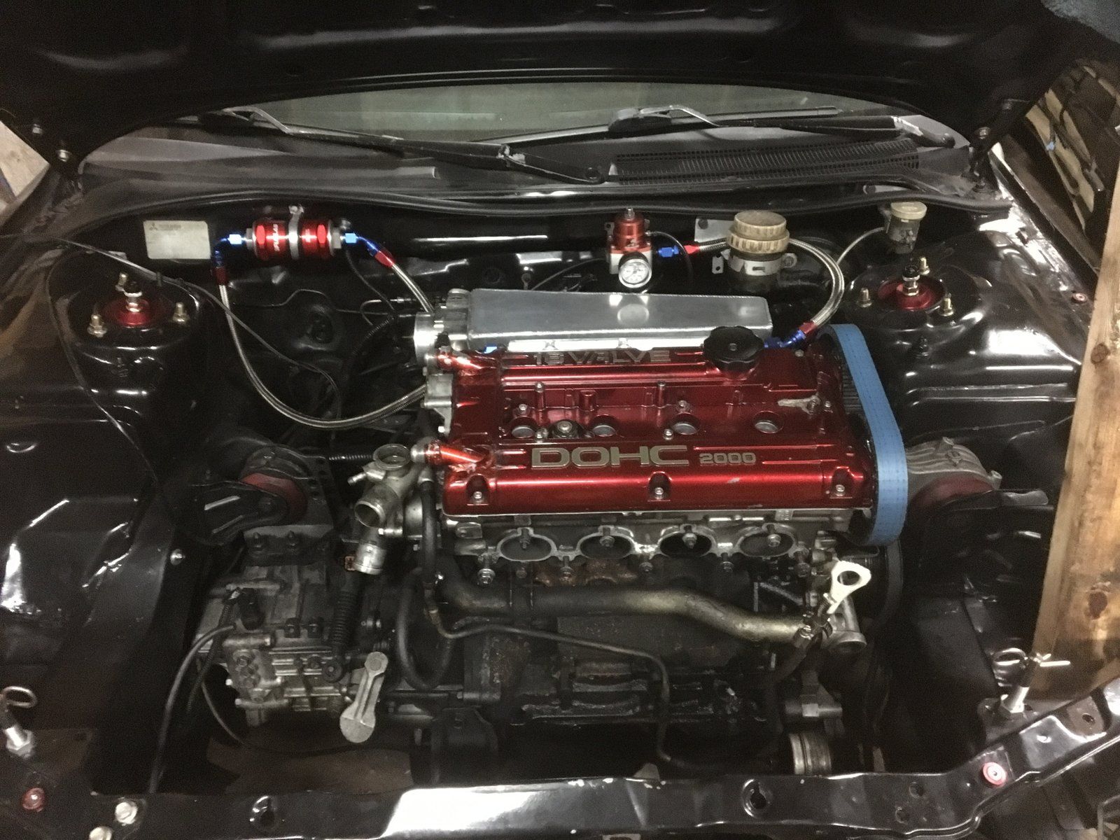

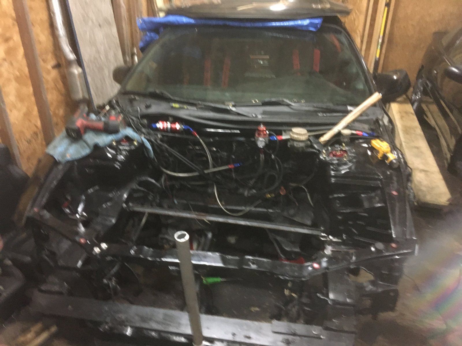

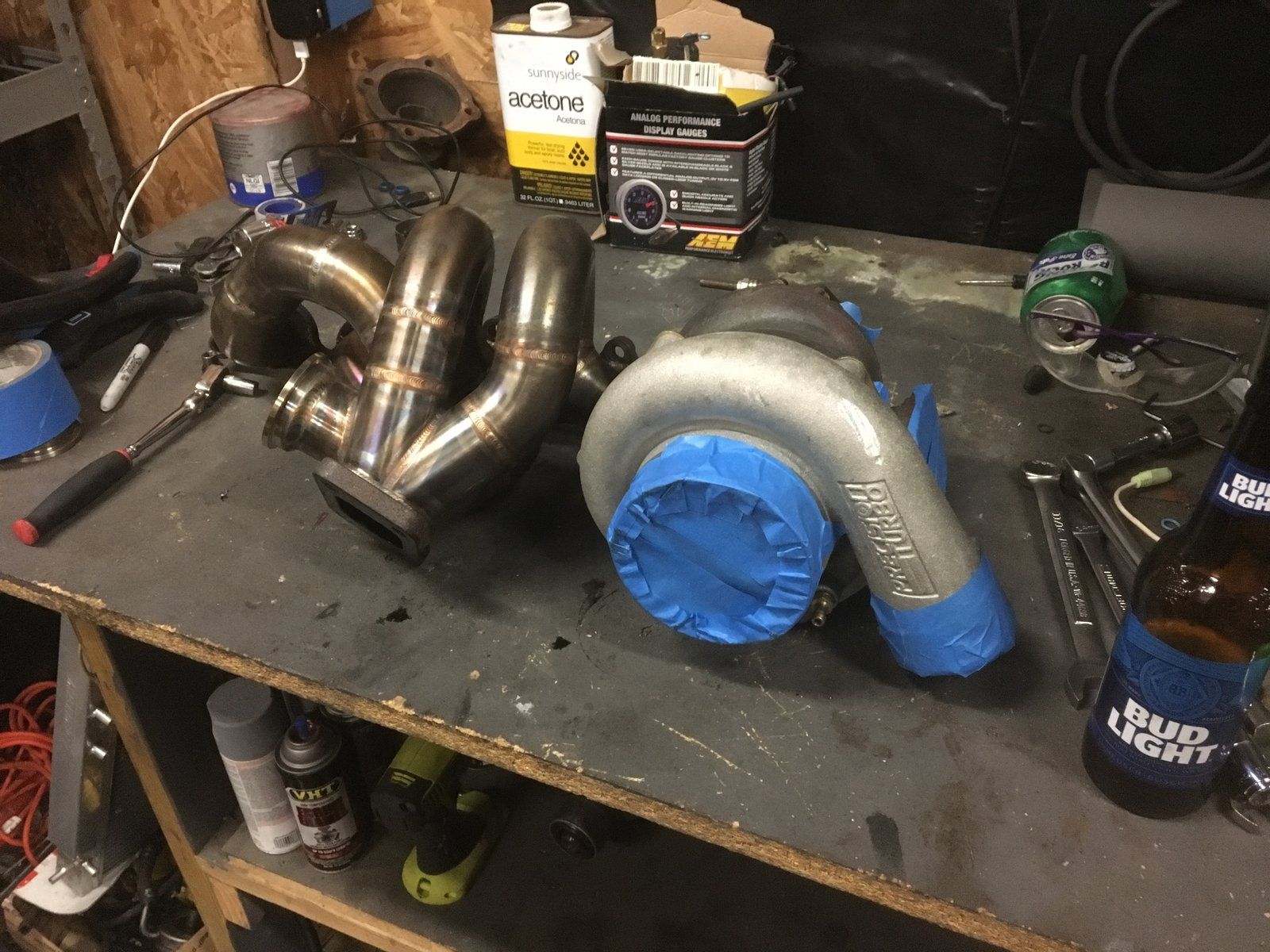

Got to work on the car for a few last night. The new manifold supplies will all be in by the end of the week so it was time to pull the old one off and get the turbo shipped out so Eaton Motor Works can start with his magic making a new one! Got just about everything taken out of the engine back except for the fuel system so I can get ready to pull the motor out. Unfortunately I DO have to pull it so I can tube the front end :(. I was looking forward for once not to have to pull it haha!
Here as it sits, by this weekend I will have an empty engine bay!

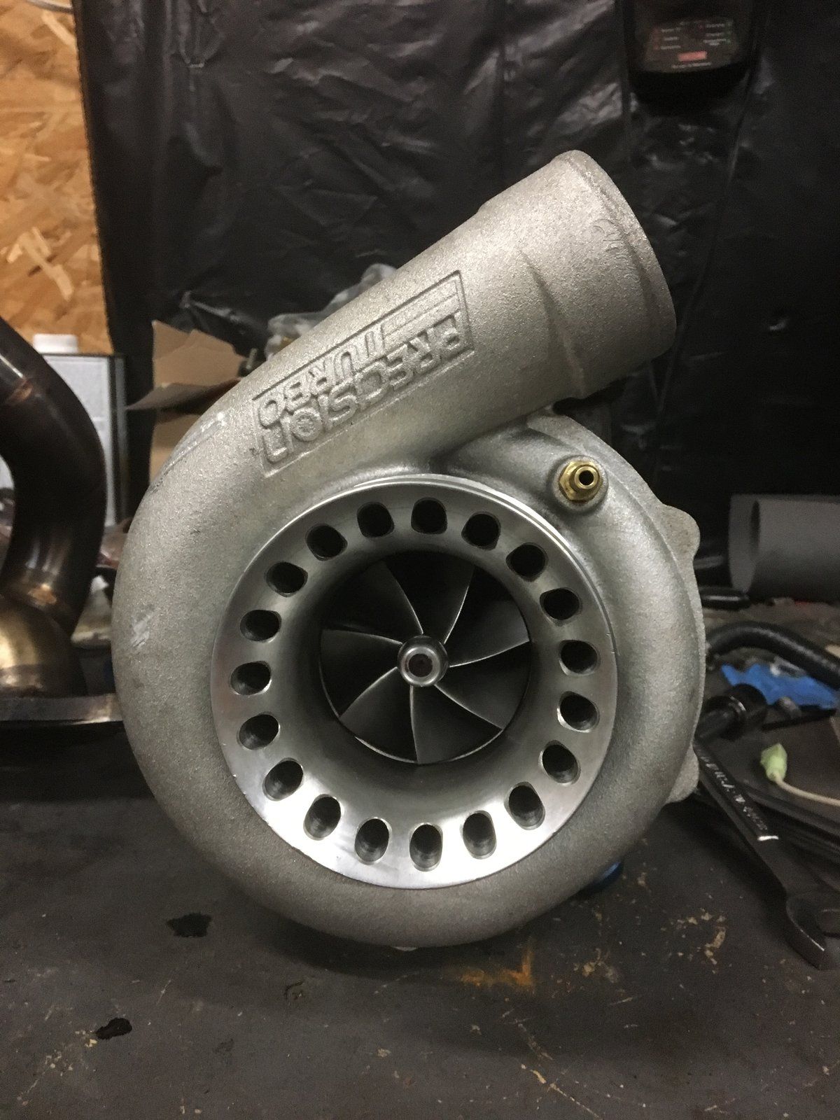

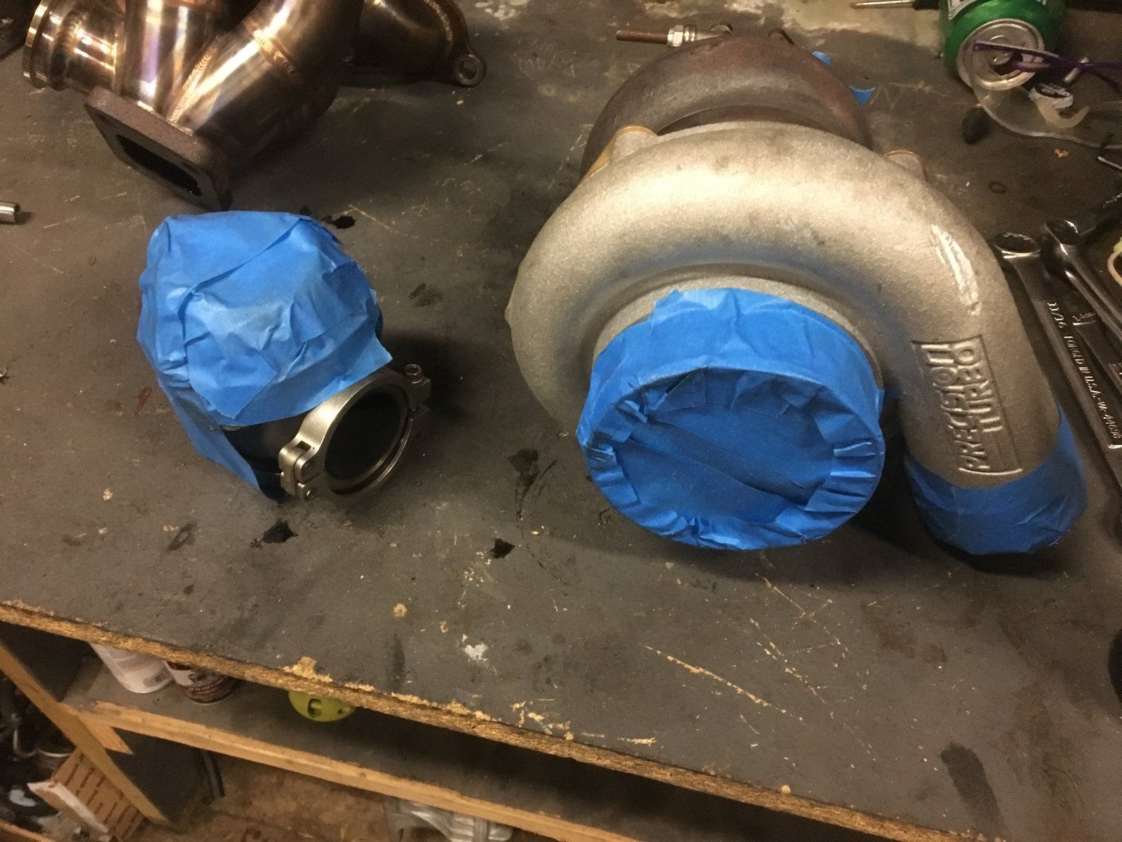

Off to storage
Ready for shipping!
P.S. This manifold is still up for grabs! PM me for more information :)

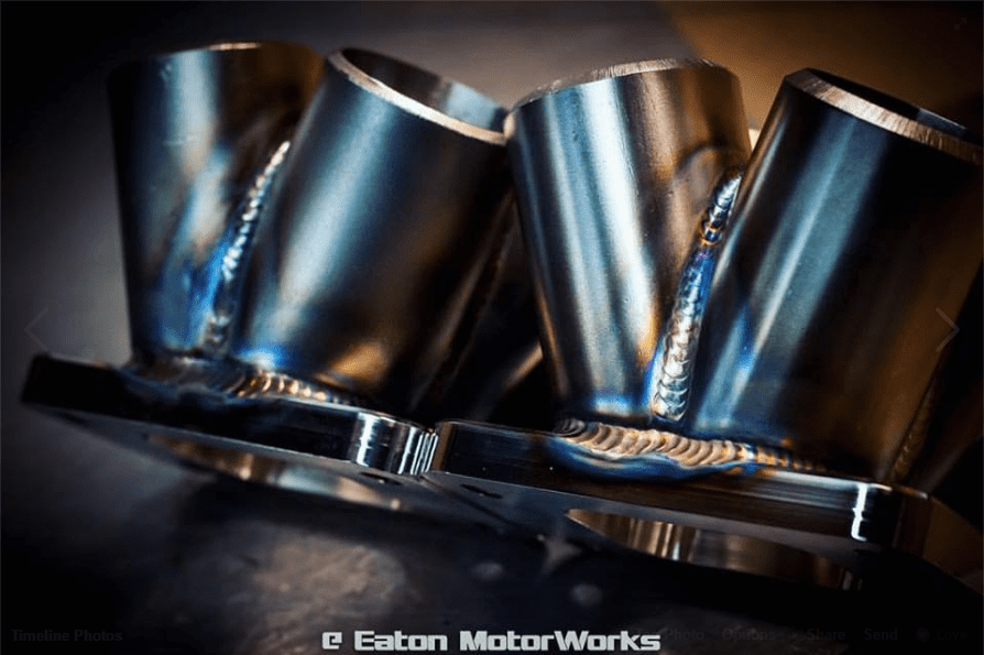

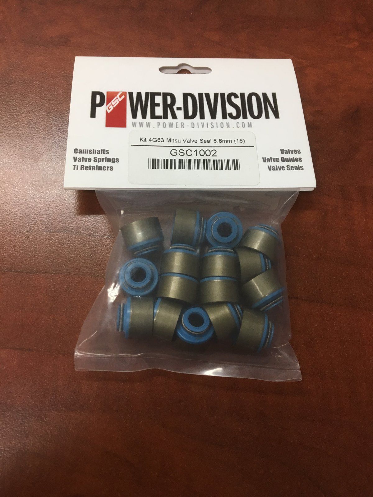

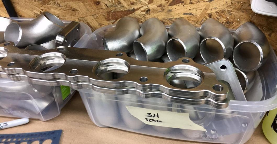

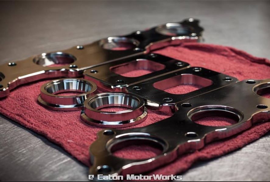

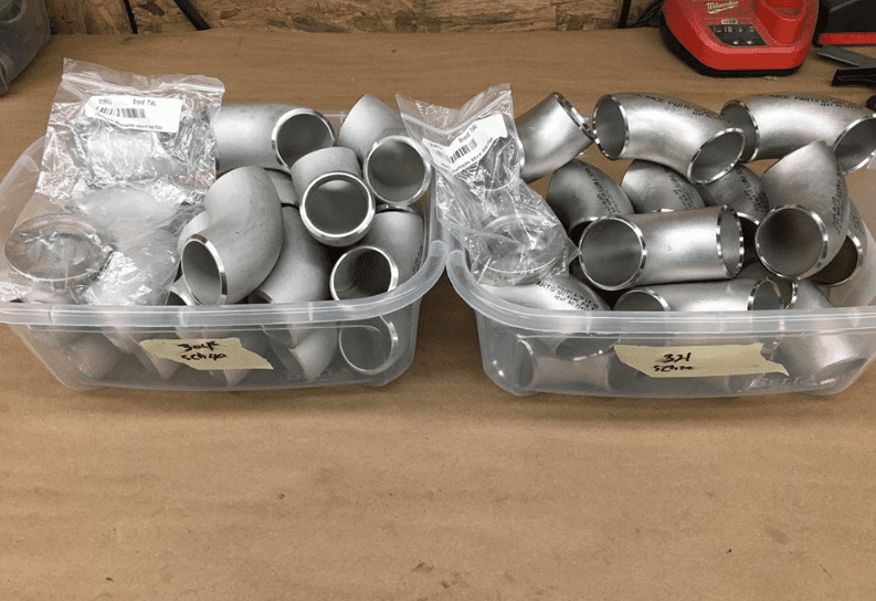

The day I've been waiting for! My flanges just got delivered to EMW. Looking forward to updates in the build process, I will post pics here as they come in to me! Also, if you have been reading my build journal you will know that I have been chasing a smoking issue all year. After thinking I have fixed it many times I finally found the culprit. I was hoping this wasnt the issue since this is a brand new Curt Brown head with literally 300 miles on it but the valve seals in cyl 2 and 3 are leaking bad! Cyl 2 is the worst and 3 is just starting to leak..

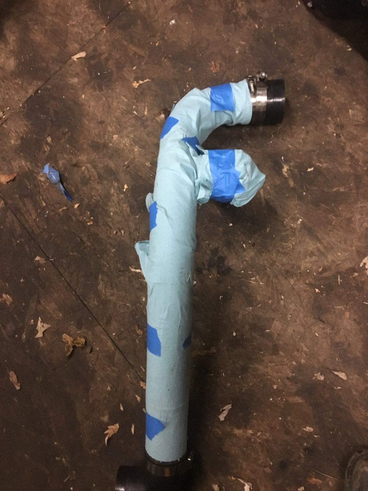

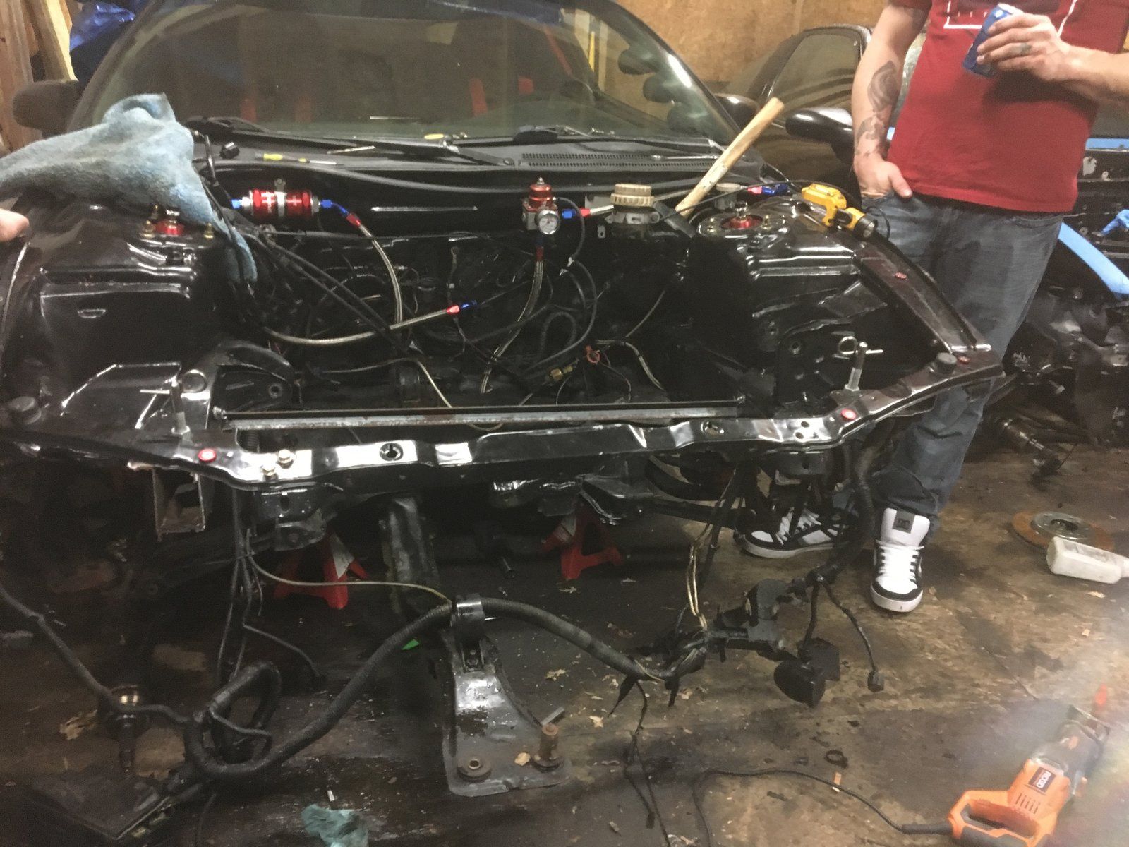

I should get some real wrenching time this weekend to pull the engine out and get to work with the sawzall cutting the front end off. Meantime heres a small update:

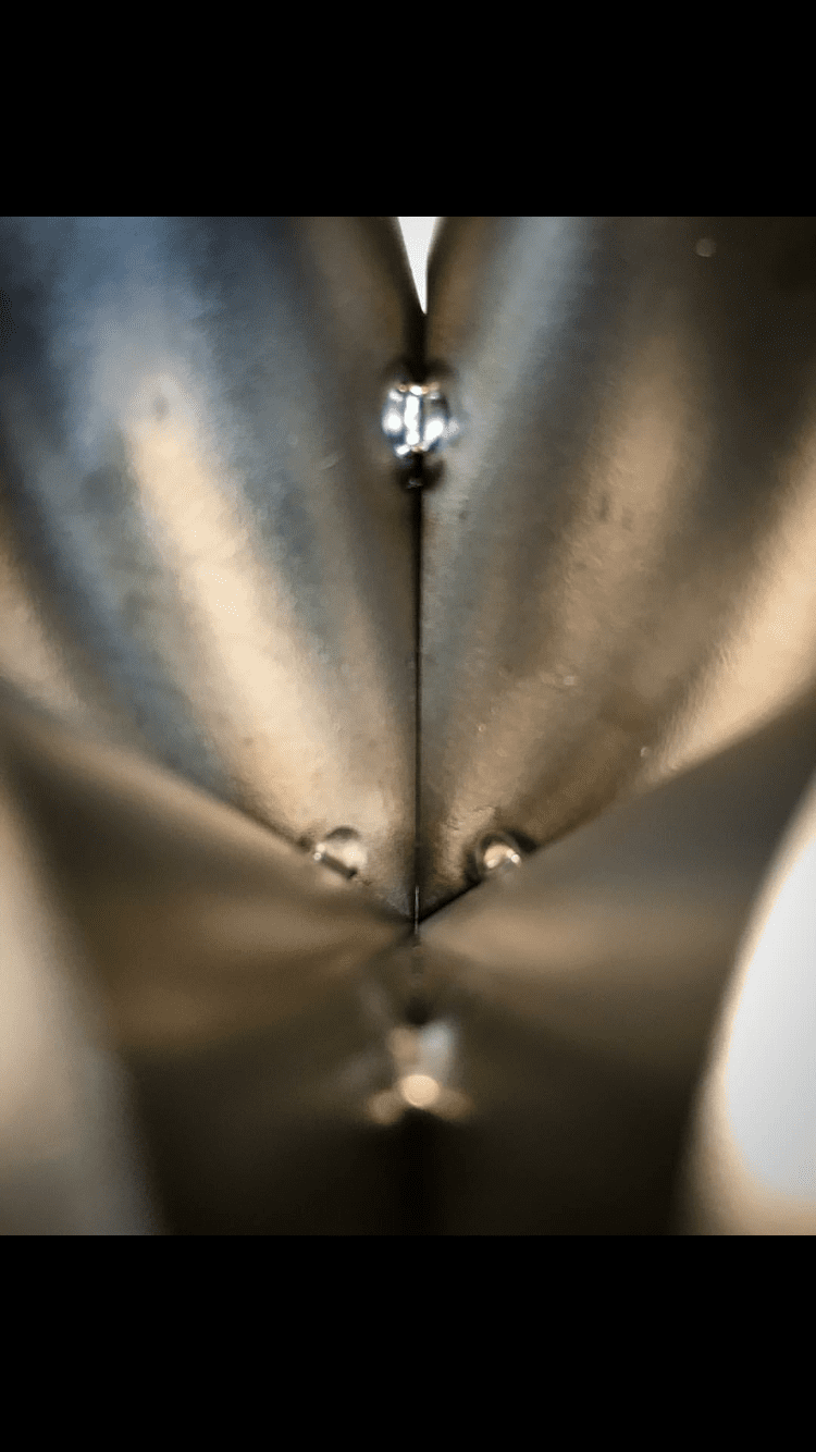

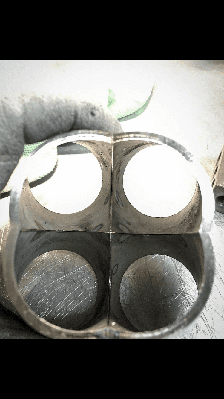

The collector has been started and looks incredible!

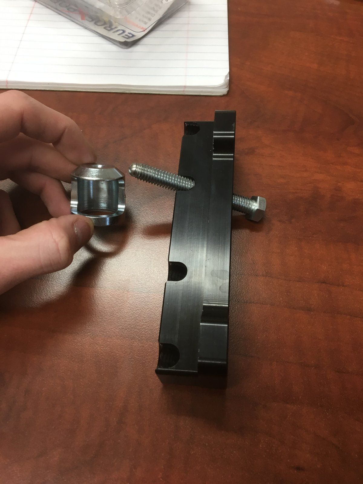

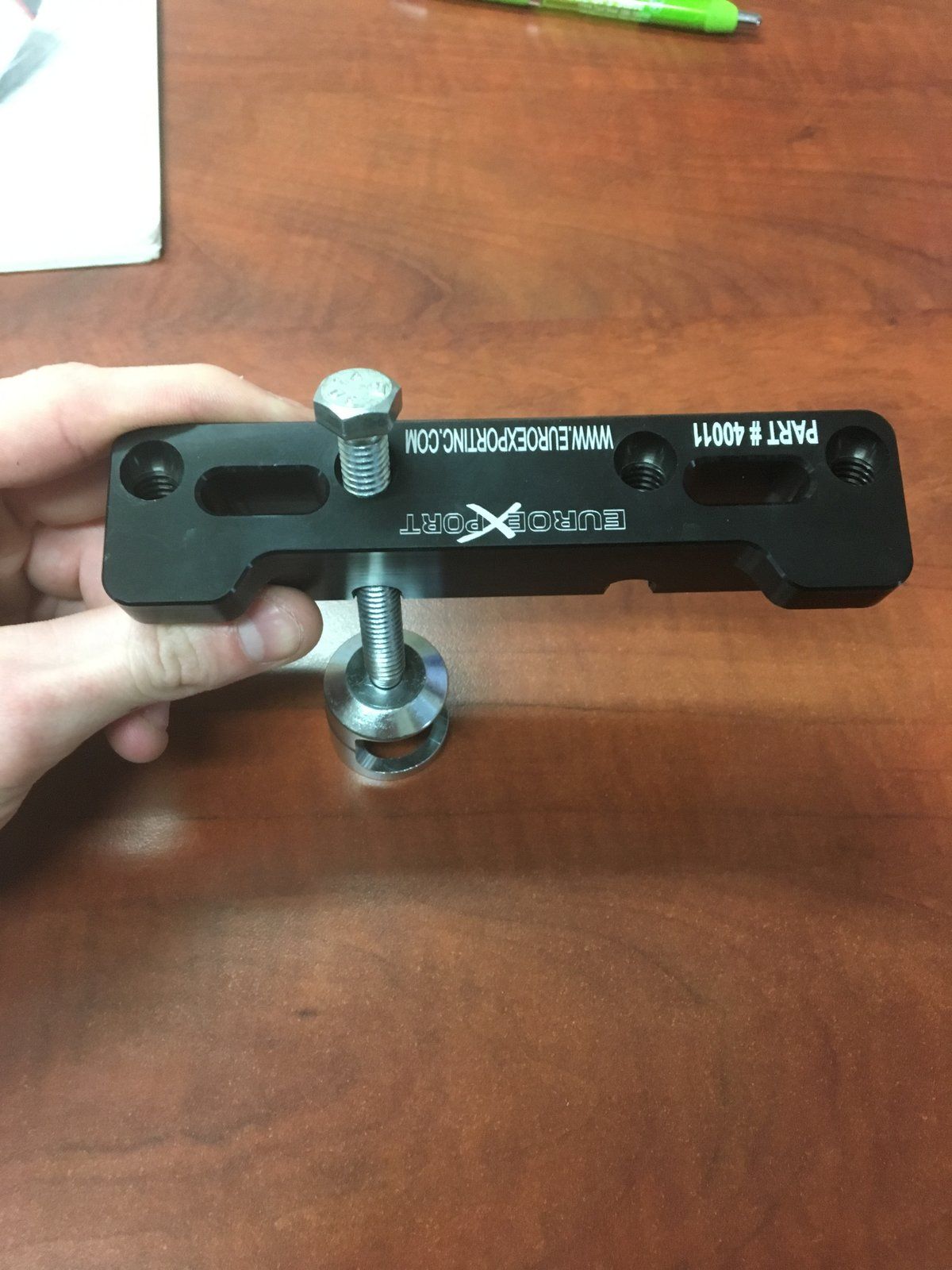

Also, got my hands on this Euroexport valve spring compressor and new GSC viton valve seals. I must say for the price this valve spring compressor is bad ***!

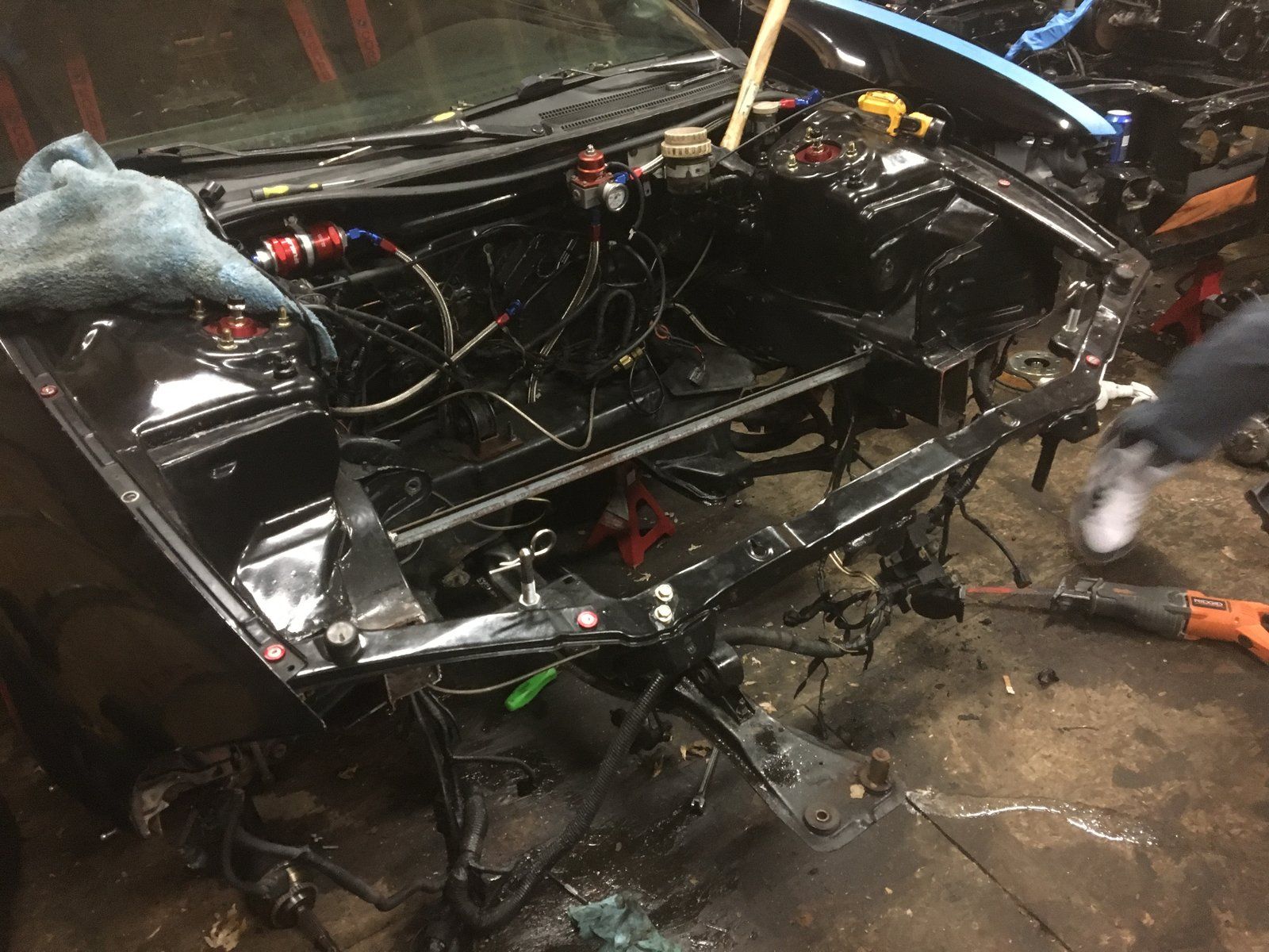

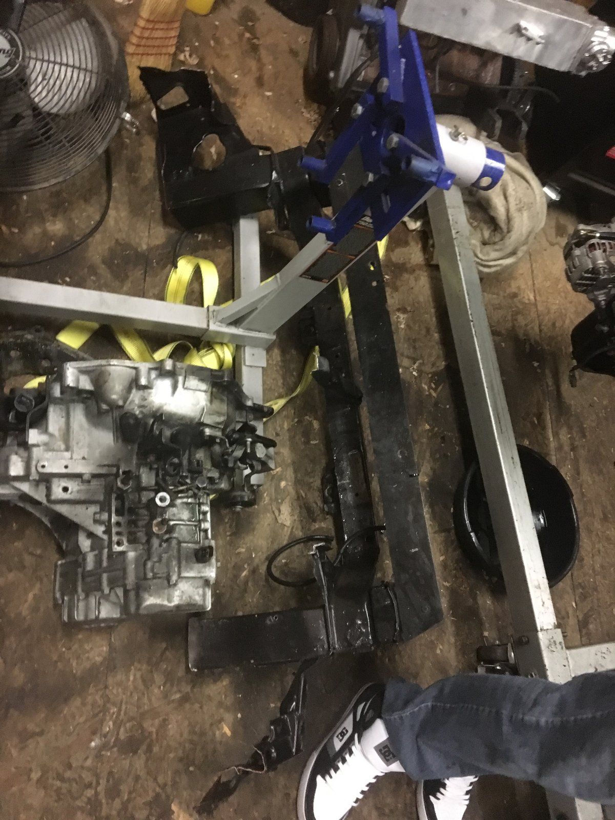

Got to work on the car a bit more over the past weekend. I was able to get the engine and trans out and bust out the SAWZALL! Got the core support cut off and time to start playing with some tubes!

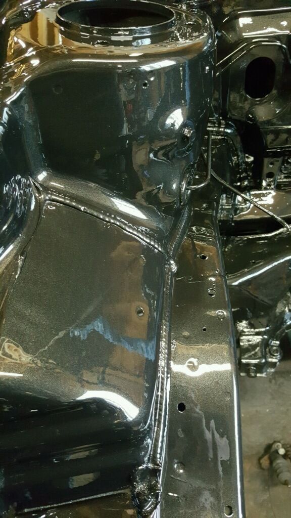

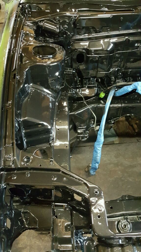

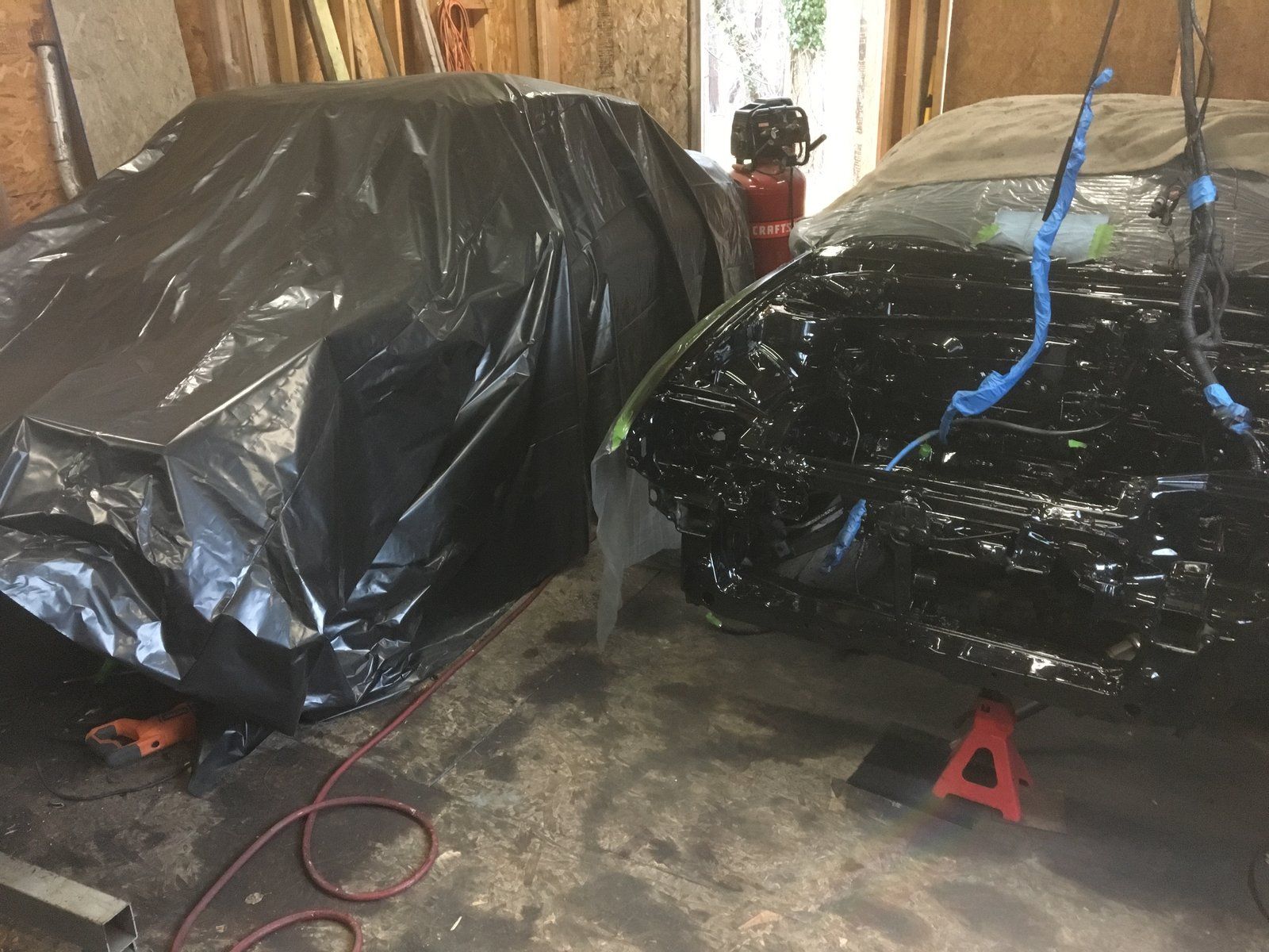

Not an update on my car however, this is my buddies car that we keep at my house. Built motor/trans, comp 6465 when our cars are done they are going to be very similar! Brandon went to town cleaning his bay out over the last week prepping for paint and I'd say he did a hell of a job! This is going to look absolutely beautiful when its done.
Dude I have the same valve spring compression tool. I got half way through the head and the bolt was already stressed out, and wouldn't come thread in smooth anymore. I had to buy a new bolt for .85 cents works now but that was disappointing.
That engine bay looks awesome! what color is that looks gunmetal with flake?
I hope the tool lasts for me haha! As for the color of his bay its a one off. He had some left over paint from school he made with a lot of flake in it and also had another half quart of another black paint with flake that he mixed together and I'd say it turned out awesome!
